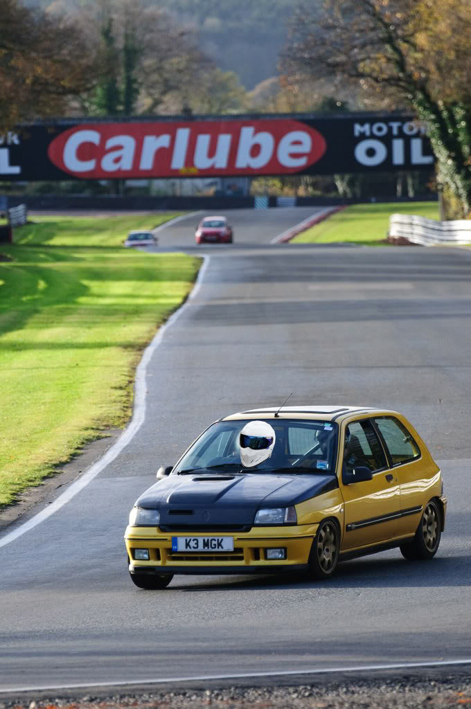

Just seen this. The cars defo faster up the straights, in that video chris was tailing me causing the air to float over the top of him and meaning i was pulling him along if you see me weeving trying to get rid. on the begining you see how i am pulling away, i dont think at the speeds that we were getting up too that there would be much differene in top end... i let off far afr afr too early compaired to the boys
The lads will even comment that the car is faster up the straights, and like i said my driving is at fault tbh.
The restriction of bonnet is holding the car back massiev ammounts we cant get enough air into the ITBS, its all blocke doff by the bonnet, Some thing that we need to reslove, as far as i am aware we are the 1st f4red ITBs clio in the UK, so have no help on what other shave done as the trumpets sit so far forward.....
Defo worth every penny spent. things will get better once the handleing is sorted out :)
Side ways Danny - Well you can, we had ours working leik that, my mapper is very very good
  PH1 loads of boost!
Look at the exit speeds of the corners, if both cars were going thru the corners at the same speeds then Andy's would drive away on the strights.
Get someone with a bit more experience behind the wheel of the yellow one and I dare say it will drive away from the camera car.

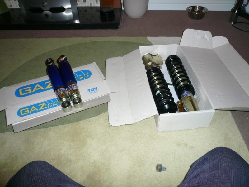

So i had to order some coil overs to suit the New wide track so i got my self some GAZ Fully adjutsable coil overs front and back :) Coolio

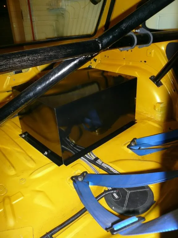

Now with this all being up back and open too us, we were told to get it covered over, so i contacted my local lads who do steel work and they made us a box to protect us in a crash... i know this adds weight but i feel safety is a prime concern :)
Here are soem pix :)
