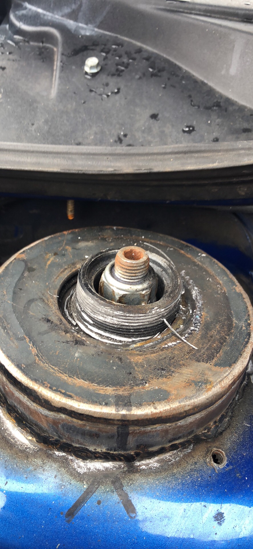

After about 5 miles the suspension was knocking bad.
This top mount being the culprit
So after a last minute rush to find two standard mounts. I got them fitted and tracked the night before the rally

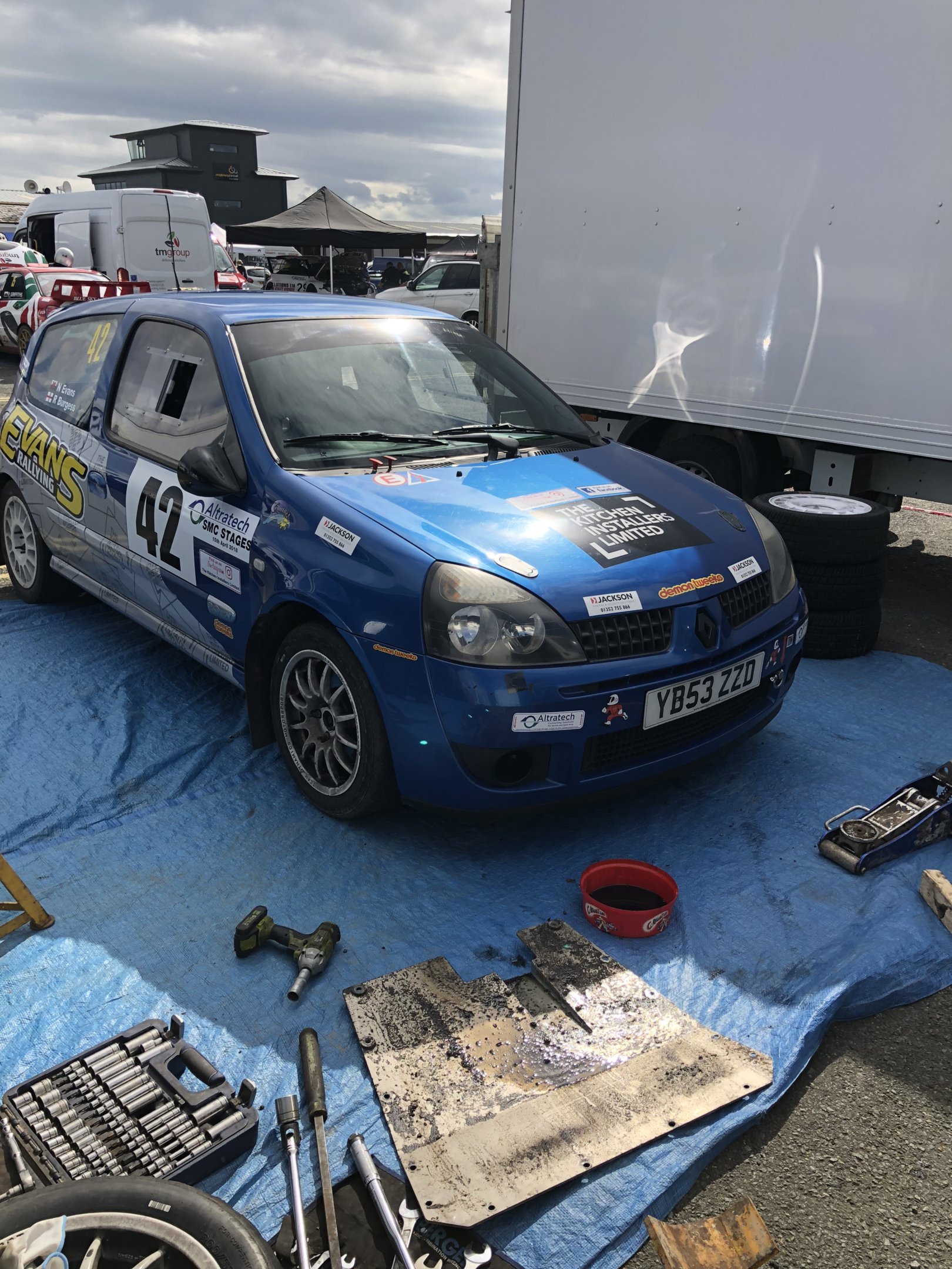

All the stages used a part off the circuit where you go off the broken tarmac at the top of the circuit and onto gravel/rocks. It was really rough catching the sump guard on every occasion. Bit of a pointless section. No one could view up there and it killed quite a few cars today

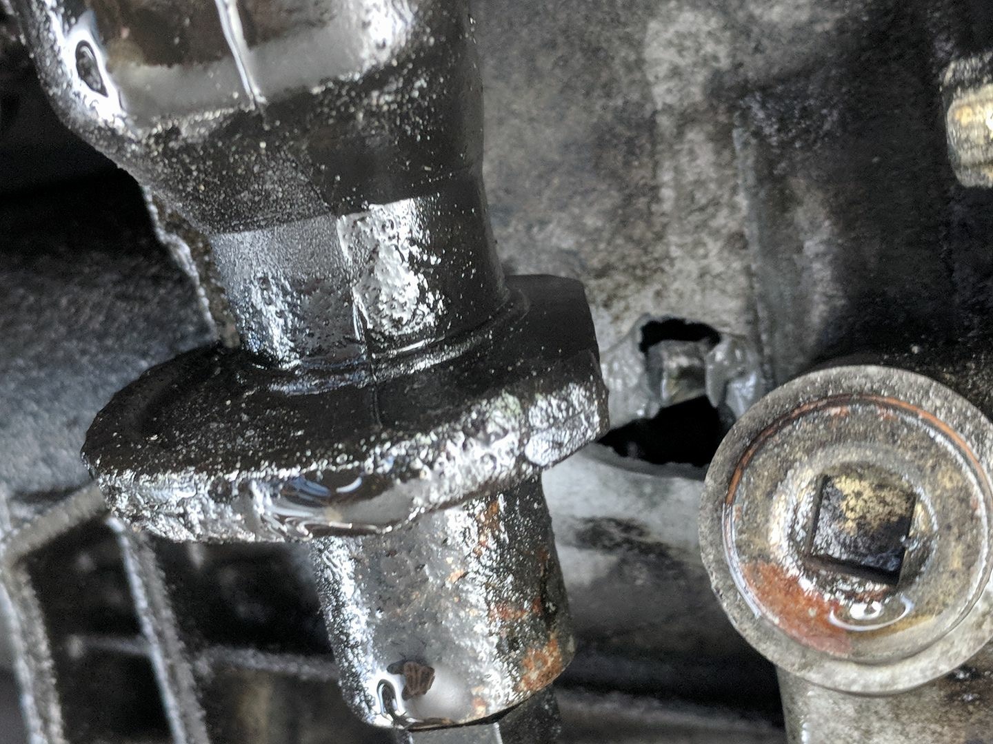

On stage 5 coming off the loose I hit a big hole, then from that went over the jump, into a tight right, dropped the box into 1st and it wouldn’t go in first time round, Then got it into 2nd and I could tell something was wrong. The car was pulling all over the place. Pulled off and seen gearbox oil all over the floor.
Got it into service and the gearbox casing is cracked and the diff is ha going out.

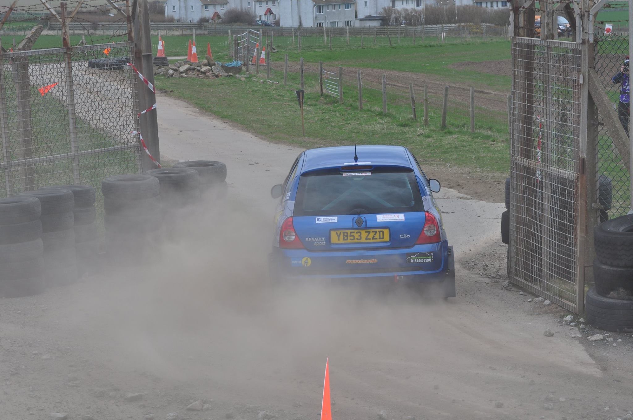

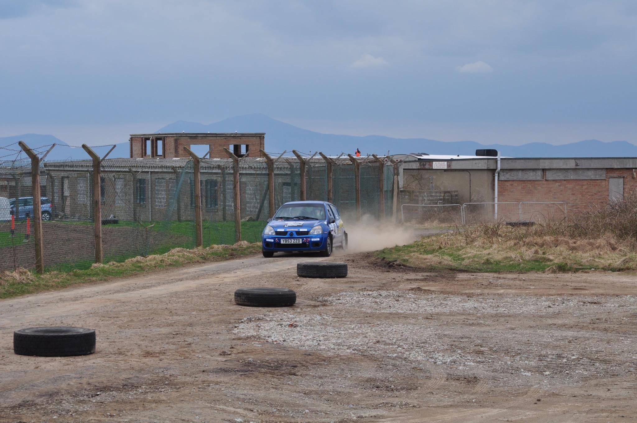

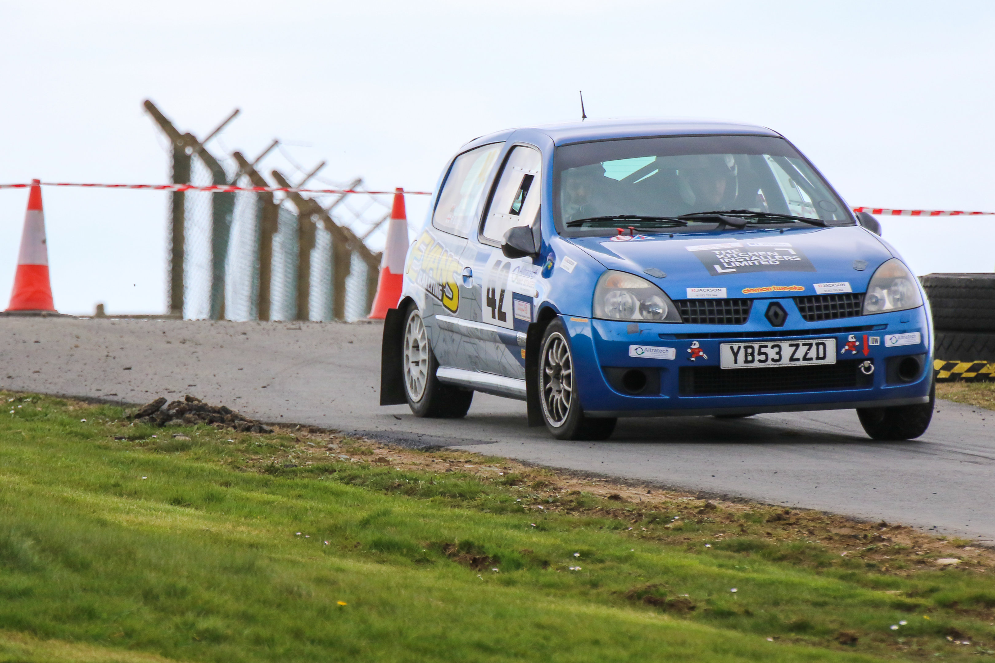

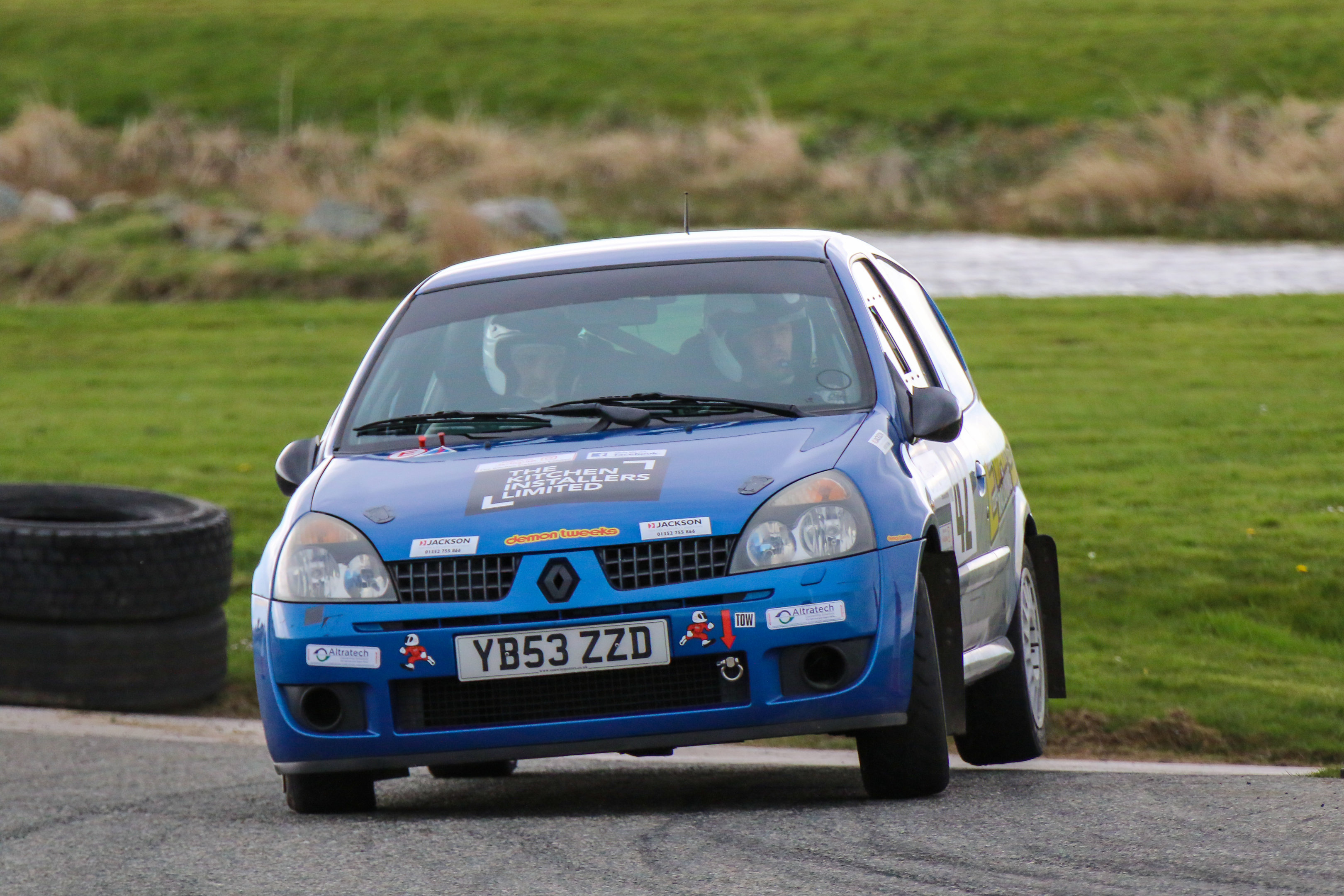

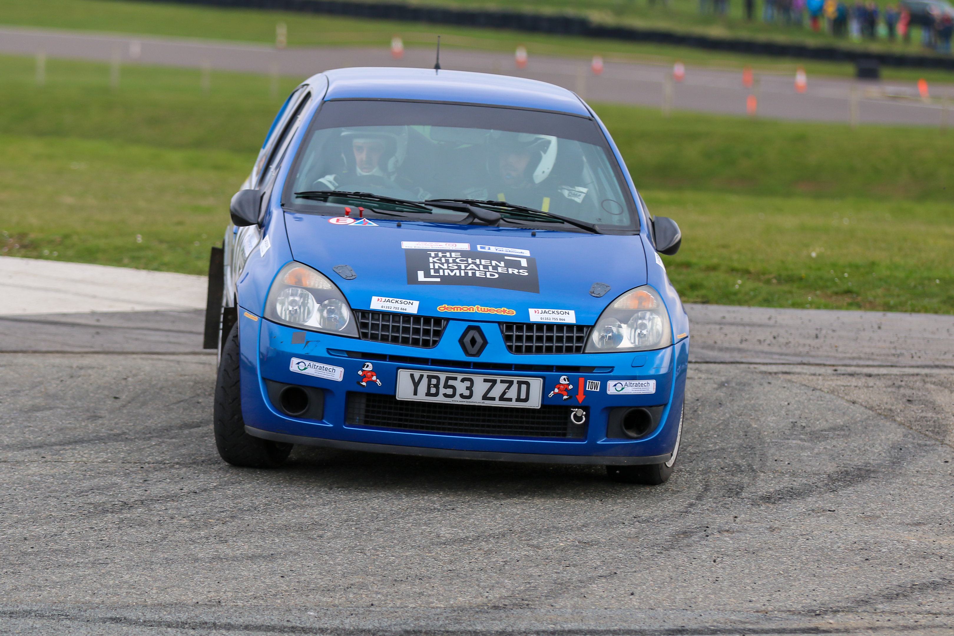

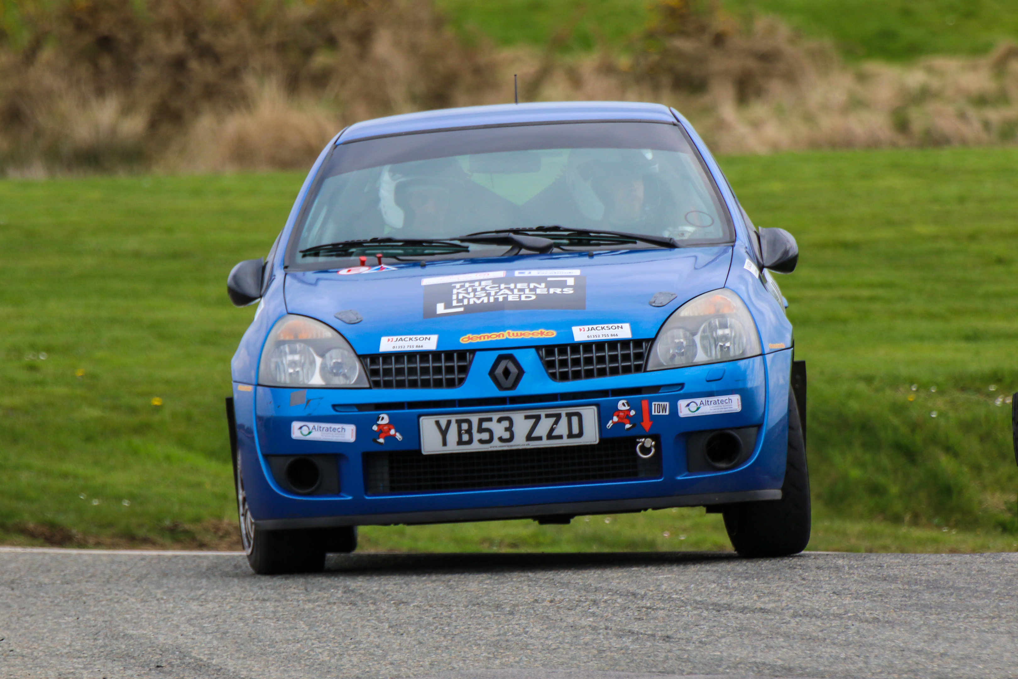

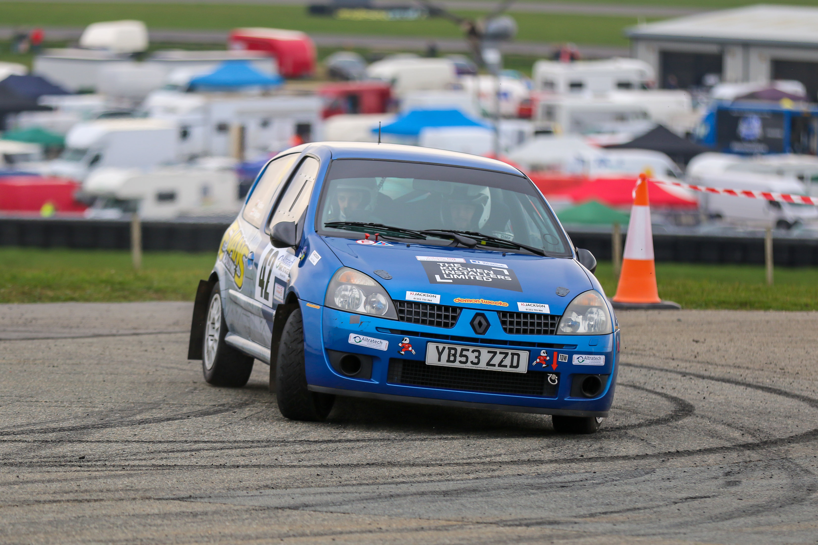

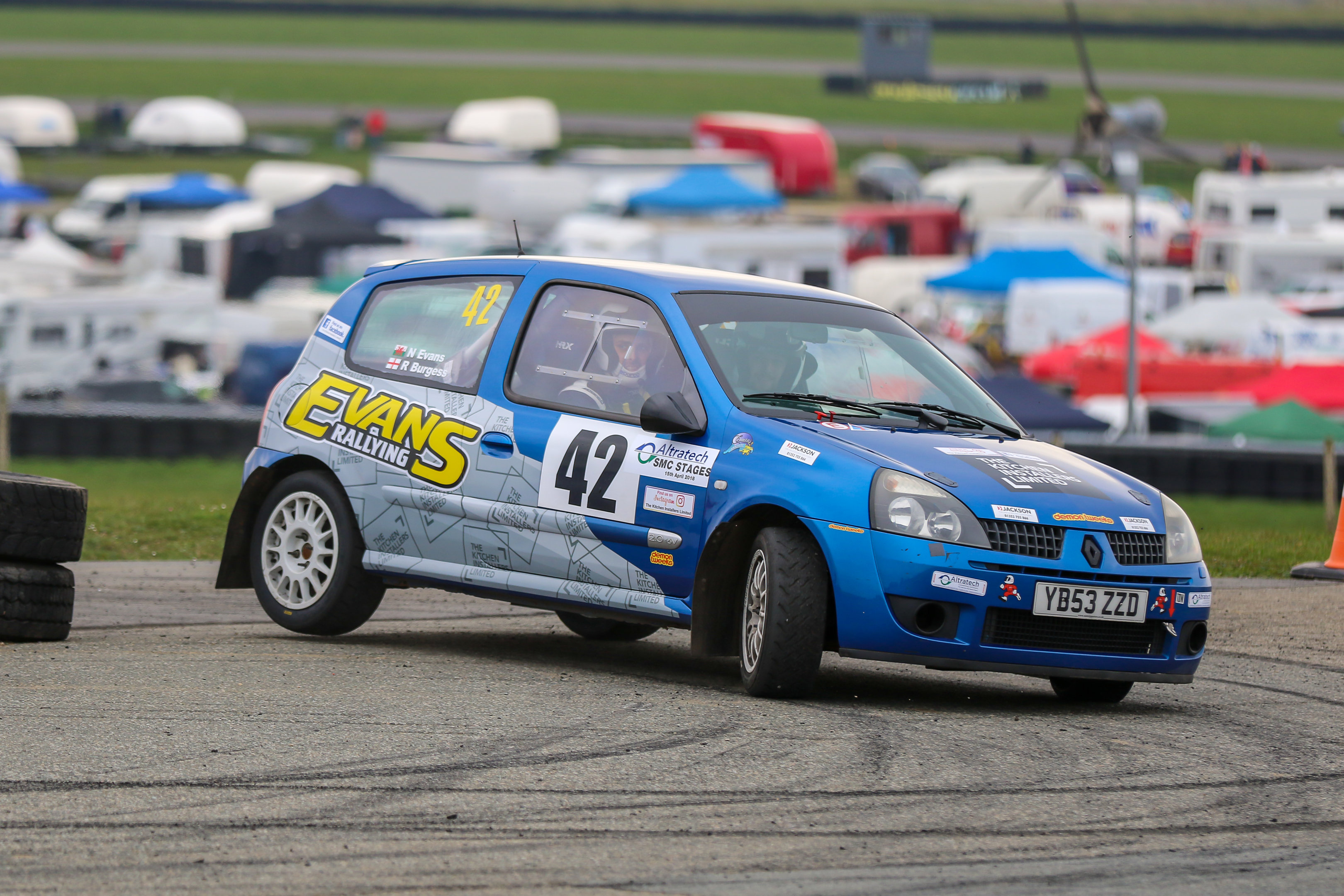

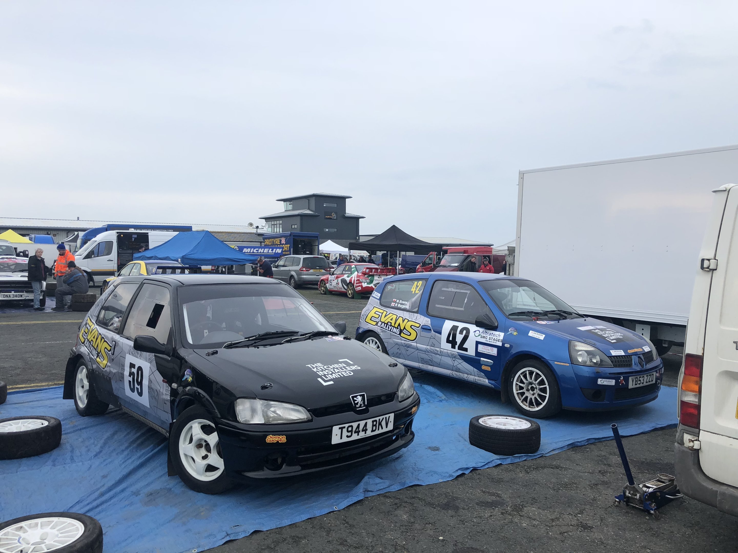

A few pictures of the car from the weekend. I’ve got some onboards to upload to YouTube and some clips from special stage
That hole shouldn’t be there

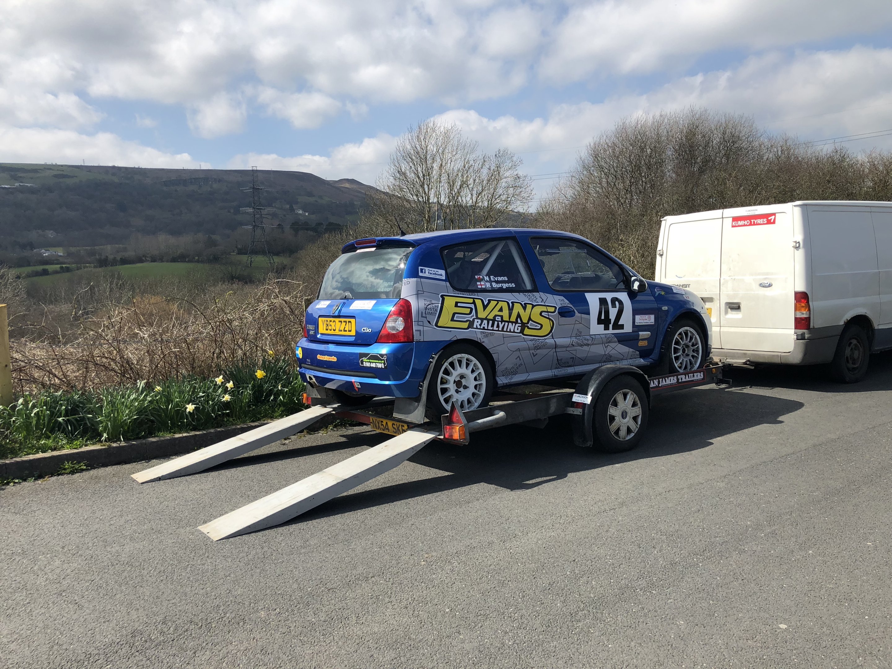

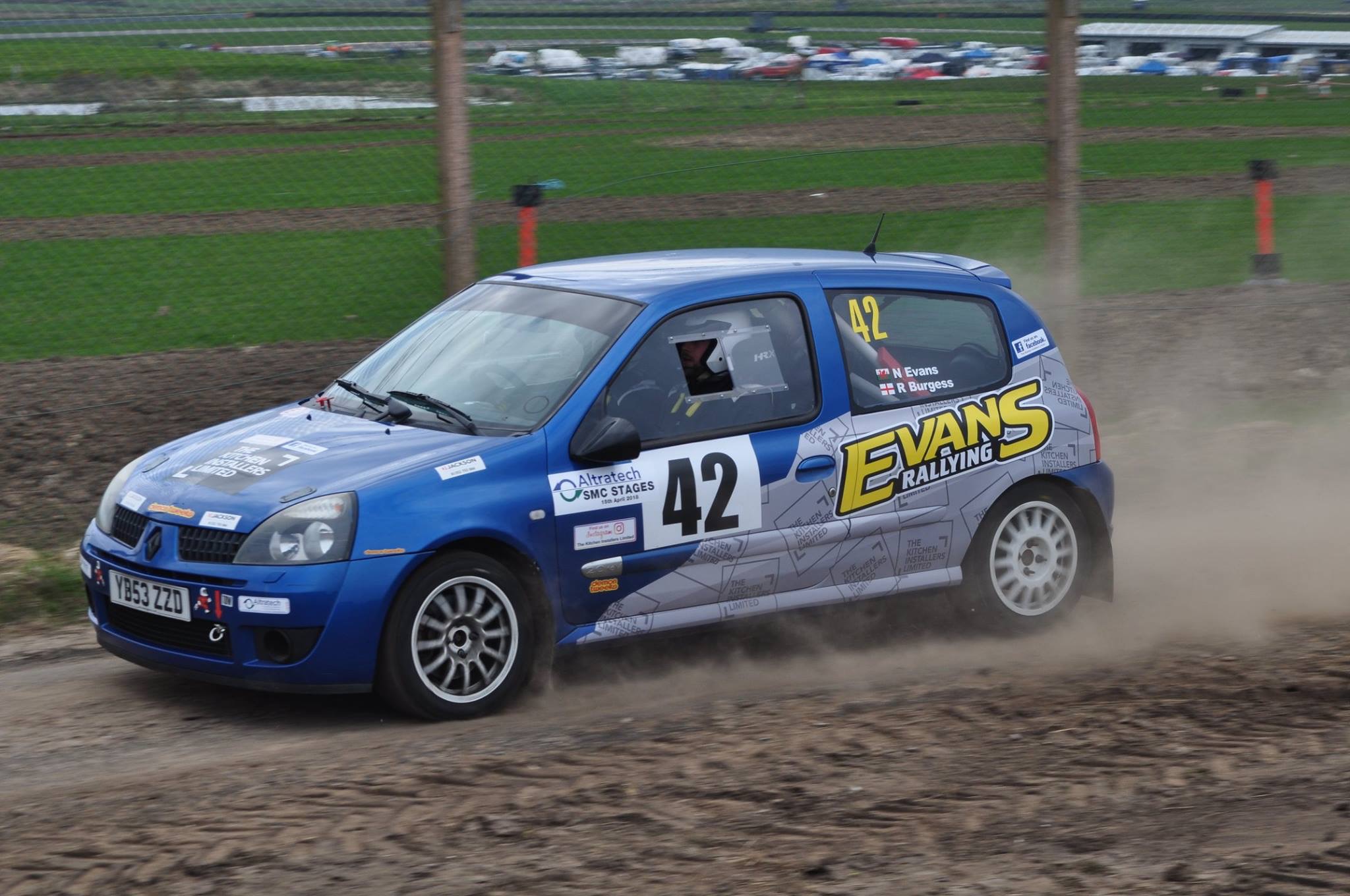

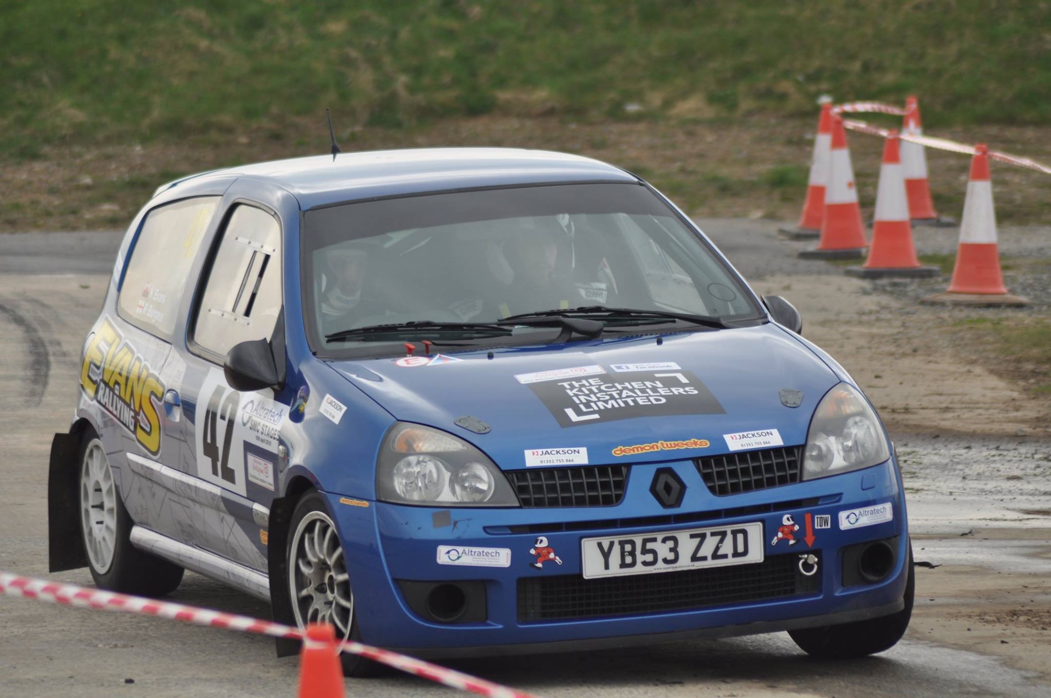

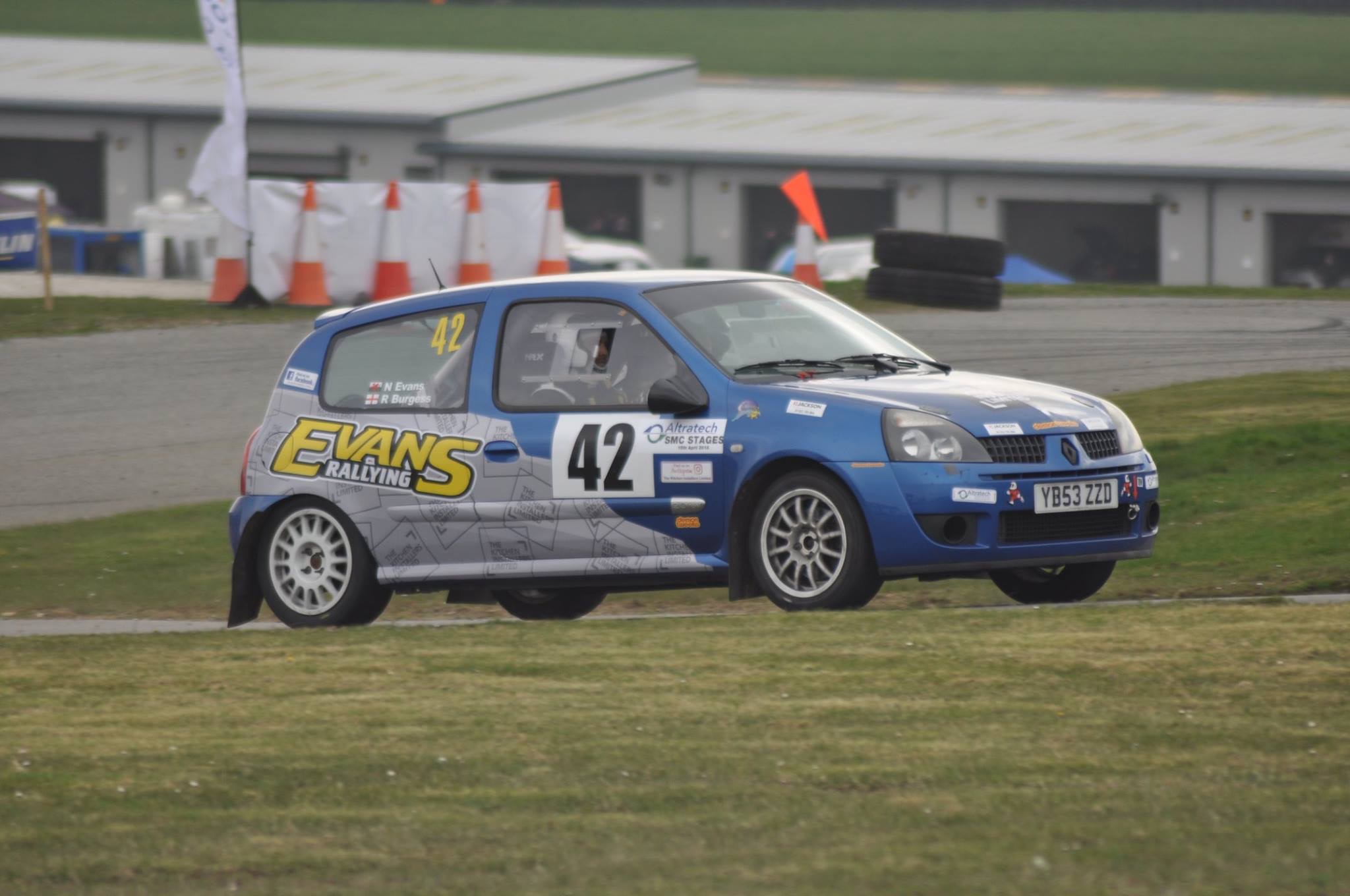

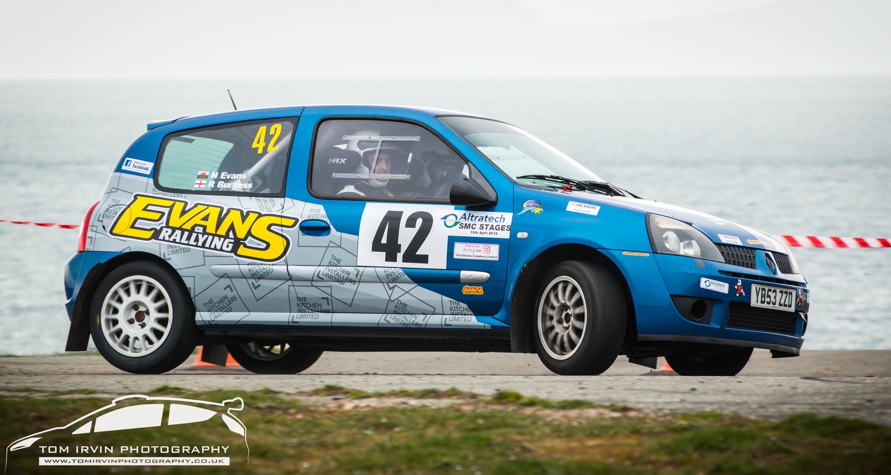

Found a couple of nice picture of the cars
One video up on YouTube.
For some reason the on boards fail after a few minutes, but I’ll keep trying

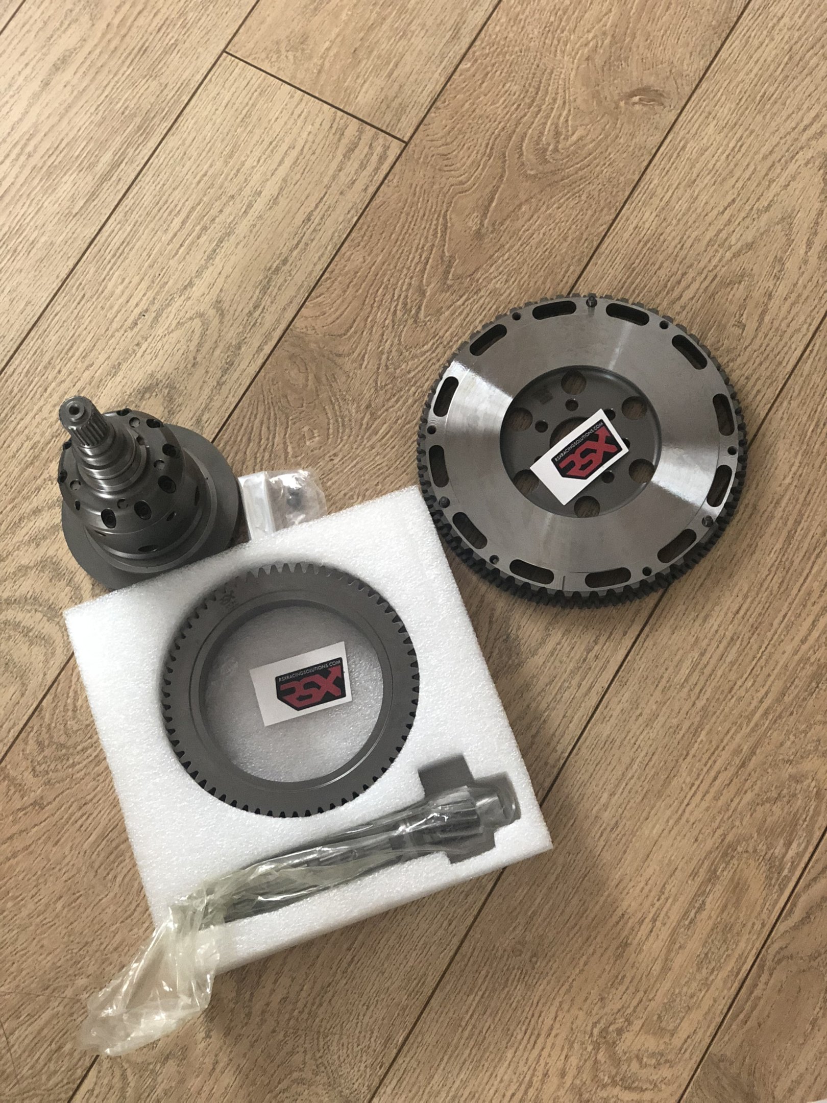

So since smashing the gearbox to bits at Anglesey I’d been waiting on delivery of some new parts.
My RSX racing solutions lsd, 5.25 cw&p and lightened flywheel have arrived from Spain over the past week but I’d been on holiday in Mykonos.
These should be fitted alone with the gearbox rebuilt over the next couple of weeks, ready for Anglesey again on the 1st of July.

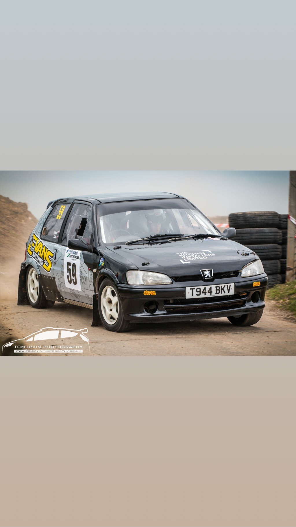

Yeah he got up to 3rd in class before his box went. 1st in class was a proper 208 r2, 2nd was an M-Sport r2 fiesta. No ones got a hope against cars like that in the class, especially the lay out they had with long straights and no chicanes.
My brothers now doing some engine work on the 106 to get around 180bhp. He’s now on bodies, gas flowed head and stand-alone.

The 106 is considerably lighter than the Clio. It’s got fibreglass bonnet and boot, with a poly rear screen.
Where as mines got the standard bonnet, boot and rear screen.
When we have to push the cars around to move them the 106 takes hardly any effort

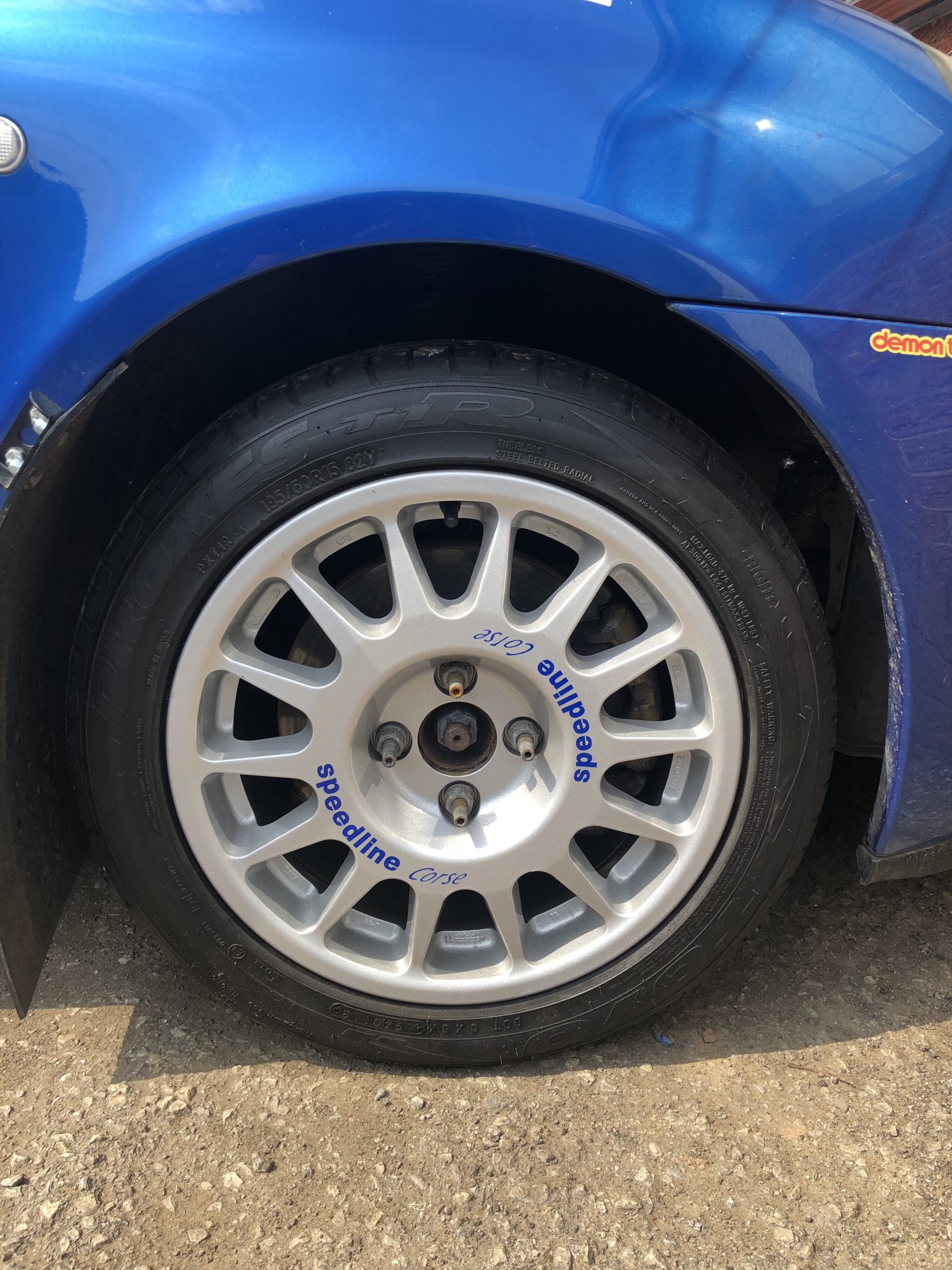

What size wheels are you using Nathan? Got the Twingo on speedline Turbines at the moment.

15” mate. Loads more of a choice with tyres. I’ve got 8 speedline 2118’s now, 4 turbines and 4 15” clio wheels

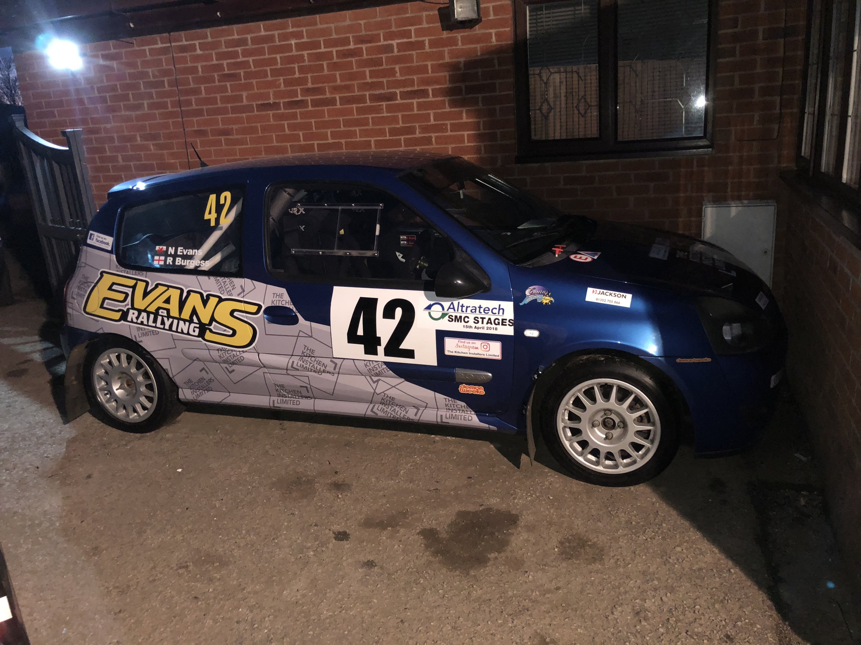

So the gear box has been dropped off to have the diff and cw&p fitted. I can’t wait to see what the car drives like now.
I’ve started getting some bits sorted for the prom stages in September. On the Friday night there’s two stage in the dark.

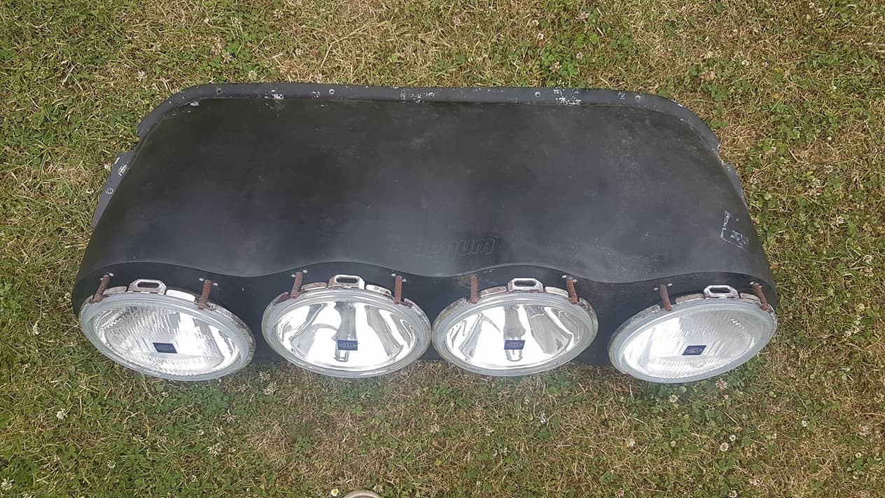

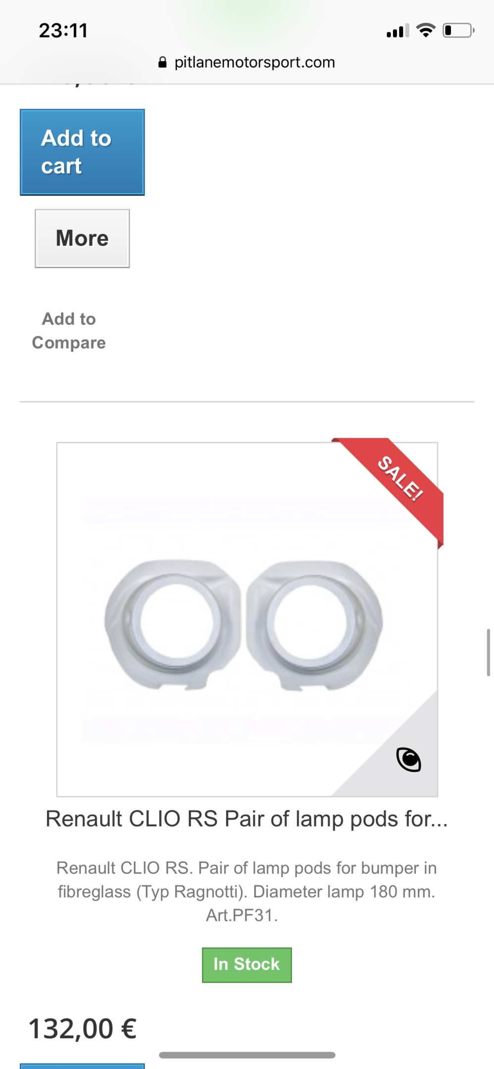

I’ve bought a second hand bonnet pod off a Saxo and some bumper pods. These will hopefully get delivered some time this week
It’s going to look like this

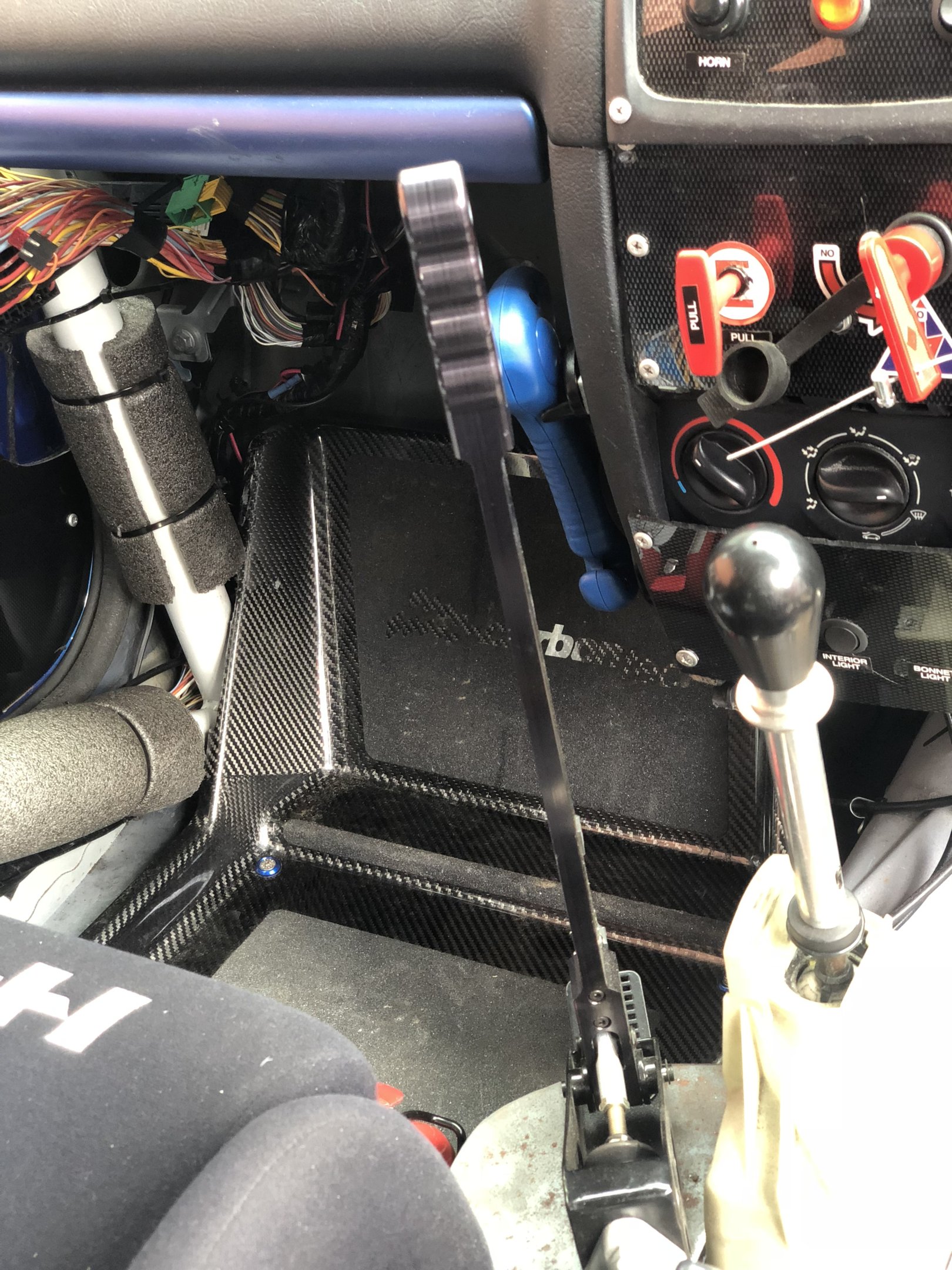

The cars still sat in the same place and not moved in 2 months.

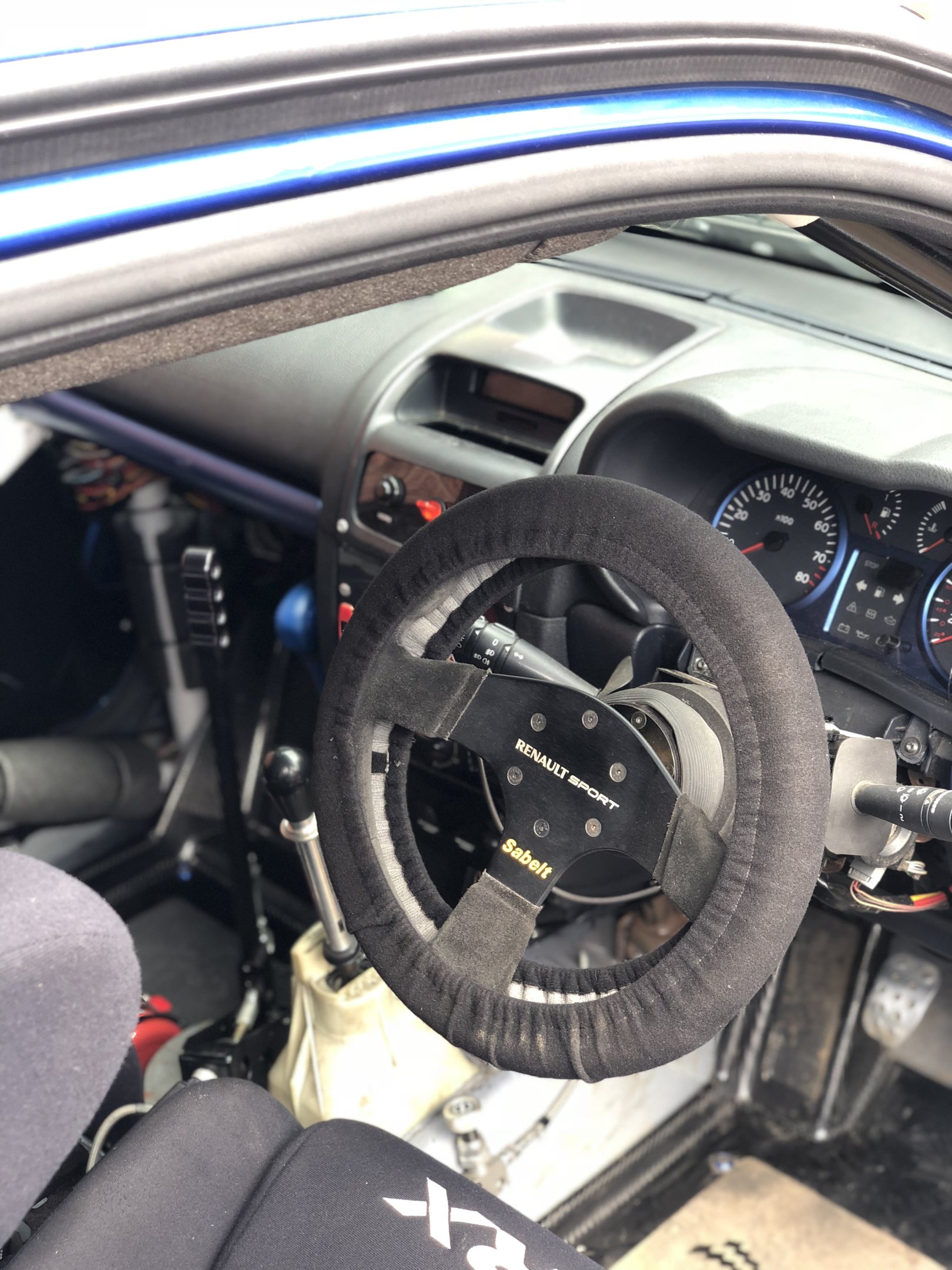

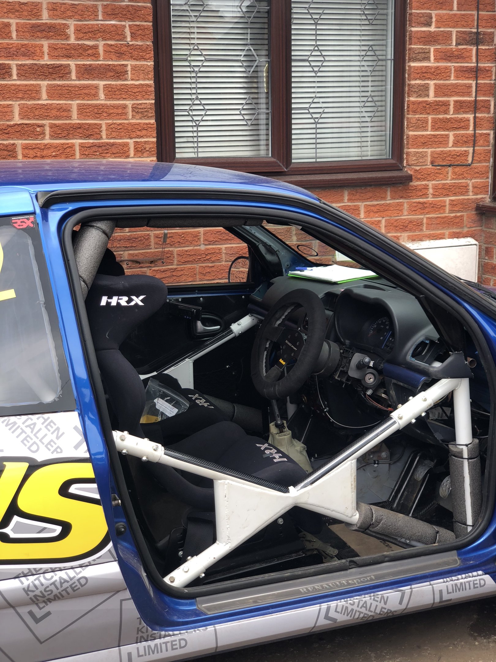

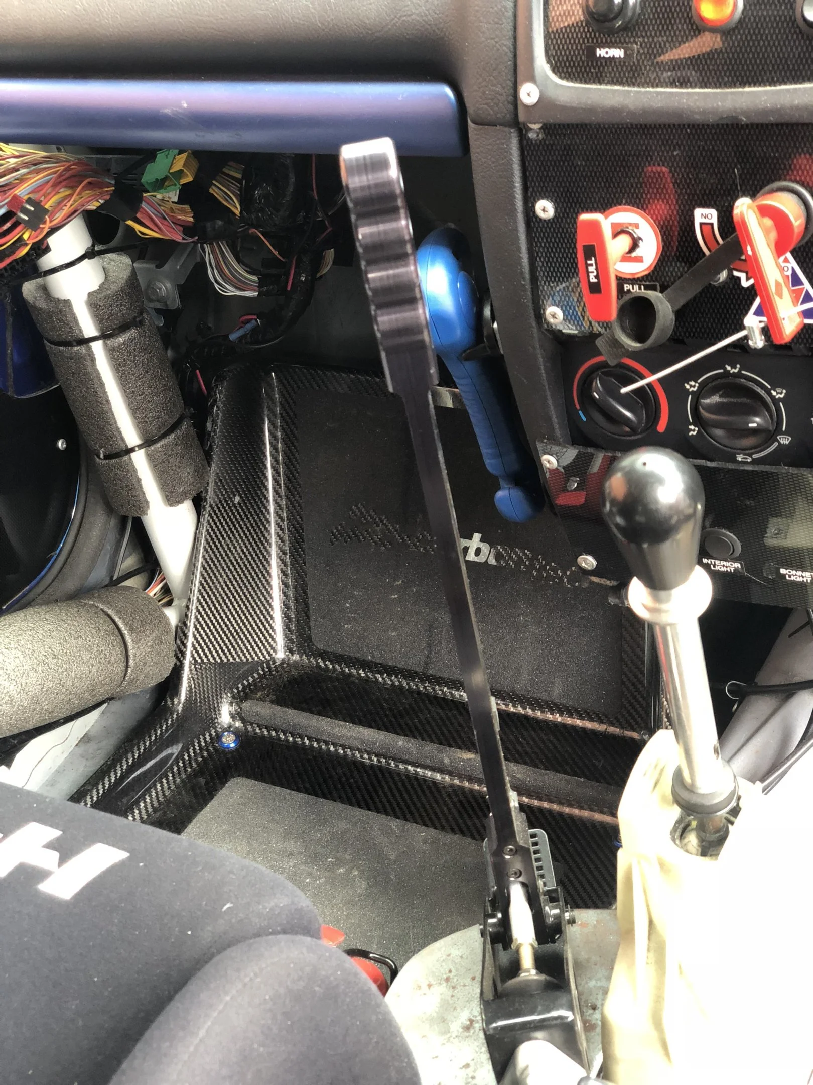

I forgot to mention I bought a carbon nav rest to match the drivers side
