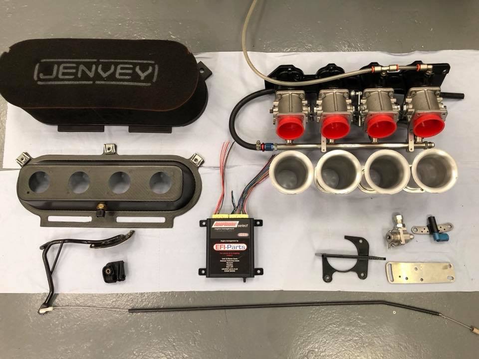

The Clio build just got serious

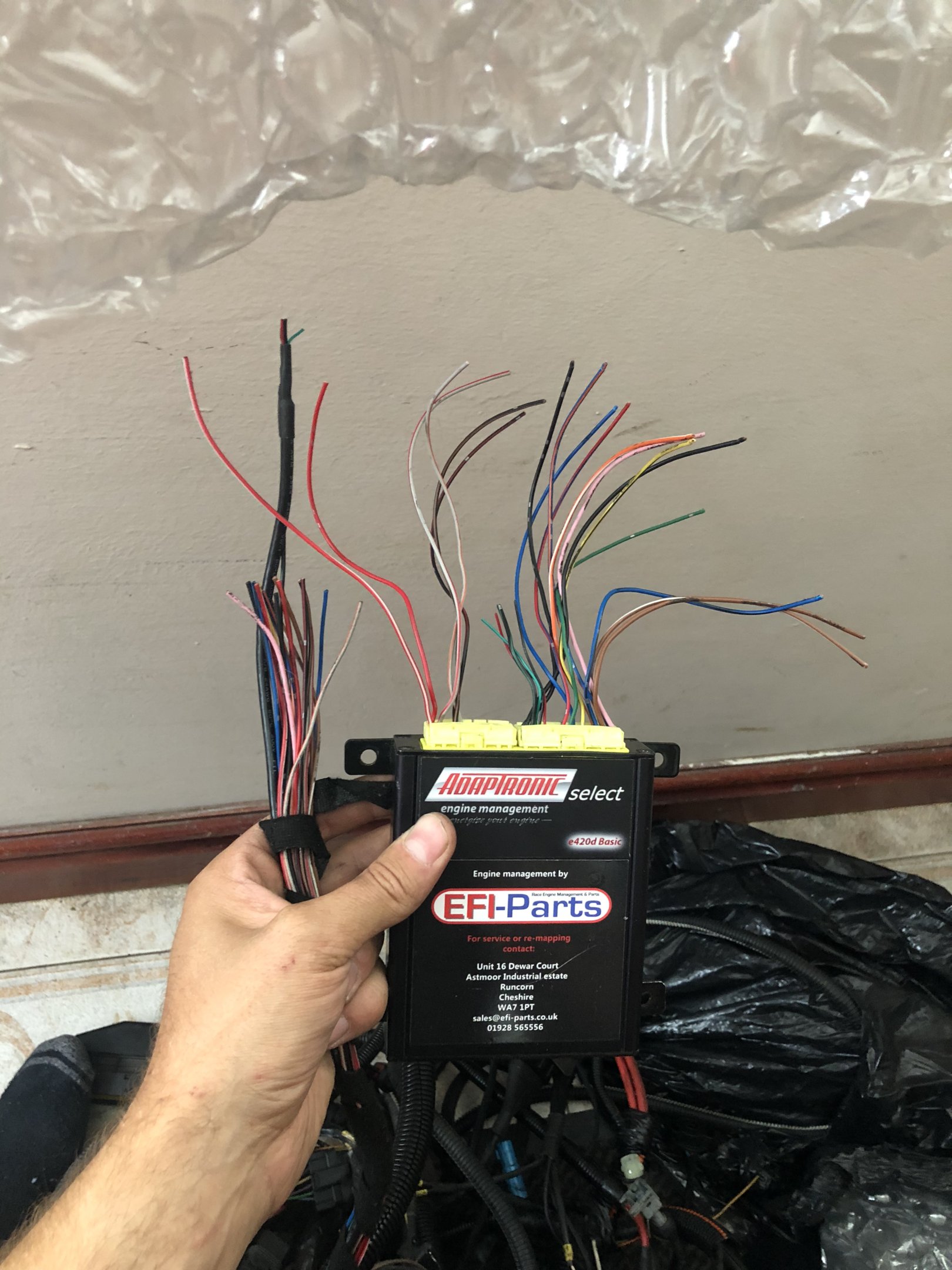

Jenvey Itbs and adaptronic ecu ready to plug and play. @bloke this will be ready for you to adjust my cam timing and take it to efi ?

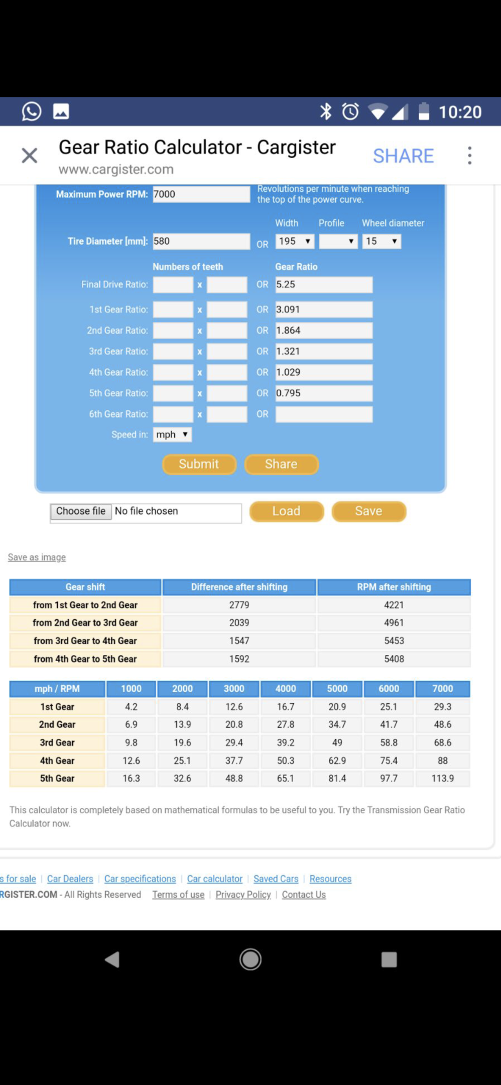

Mines going to be geared to just over 100mph now with this 5.25. I’m using a rsx racing lsd. Wanted a gripper but I’ve got this set up with a lightened flywheel for less than a gripper is on its own

Think you may struggle with only 100mph top speed Nathan, there are quite a few events needing more than that top speed

Works out at 113mph on this. Not sure how actuate it is because the tyre size is wrong. I’m happy with that though. I’ve never got over 105mph when I’ve been out in mine.
  Audi rs3/Clio 172cup
I’m sure it will be fine. WRC cars top out at about 120mph.
Steve Davies runs a 5.25 in his with a gripper. He does run a kangoo box with slightly longer ratios but at Mira there’s a huge straight and he’s not hitting the limiter
Not heard of RSX I must say. Is it a helical, or a plate? Mine has a Quaife in it. Would like to go to a plate, but it's a big chunk of money really. Would rather spend it on driving the car.
Gearing doesn't sound too bad. I'm sure @EVOgone ran a 5.25 in his pink Clio and rated it. Think mine will top out about 118, but sadly is heavier and less powerful than your car!

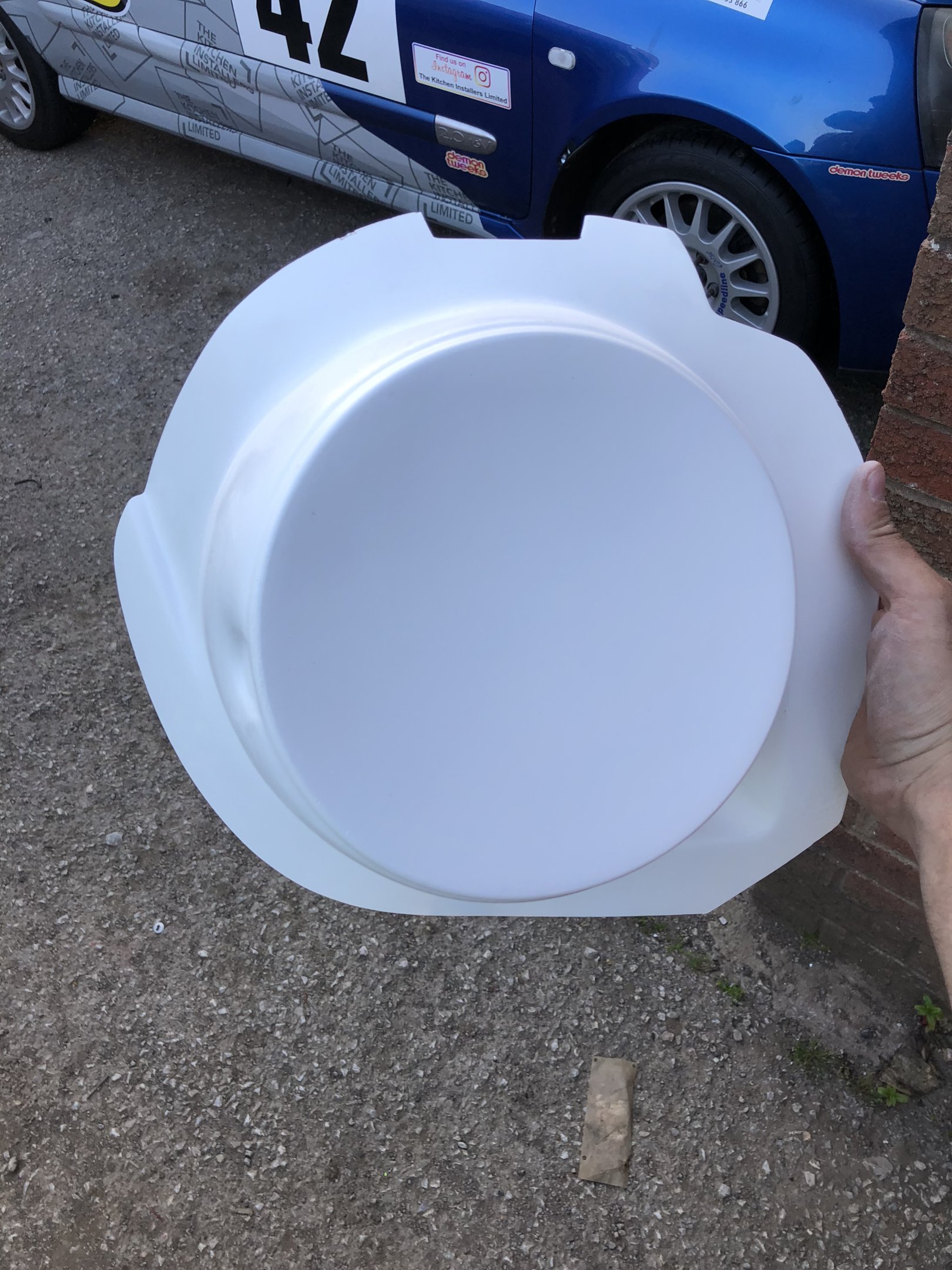

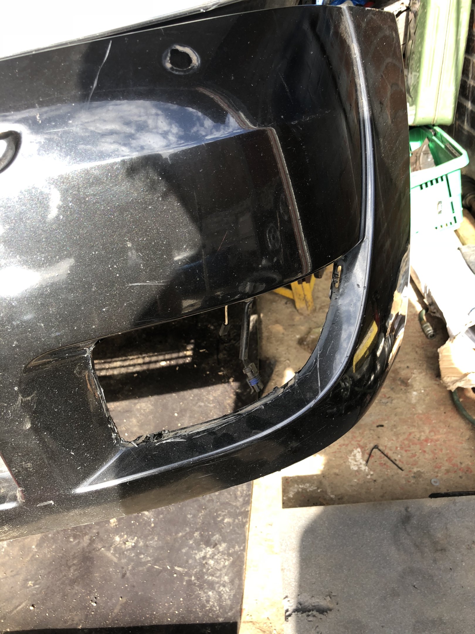

So these arrived today from maxi racing in Italy ?
The fit is perfect.
Need some lamps now and a spare bumper so I can mount them.

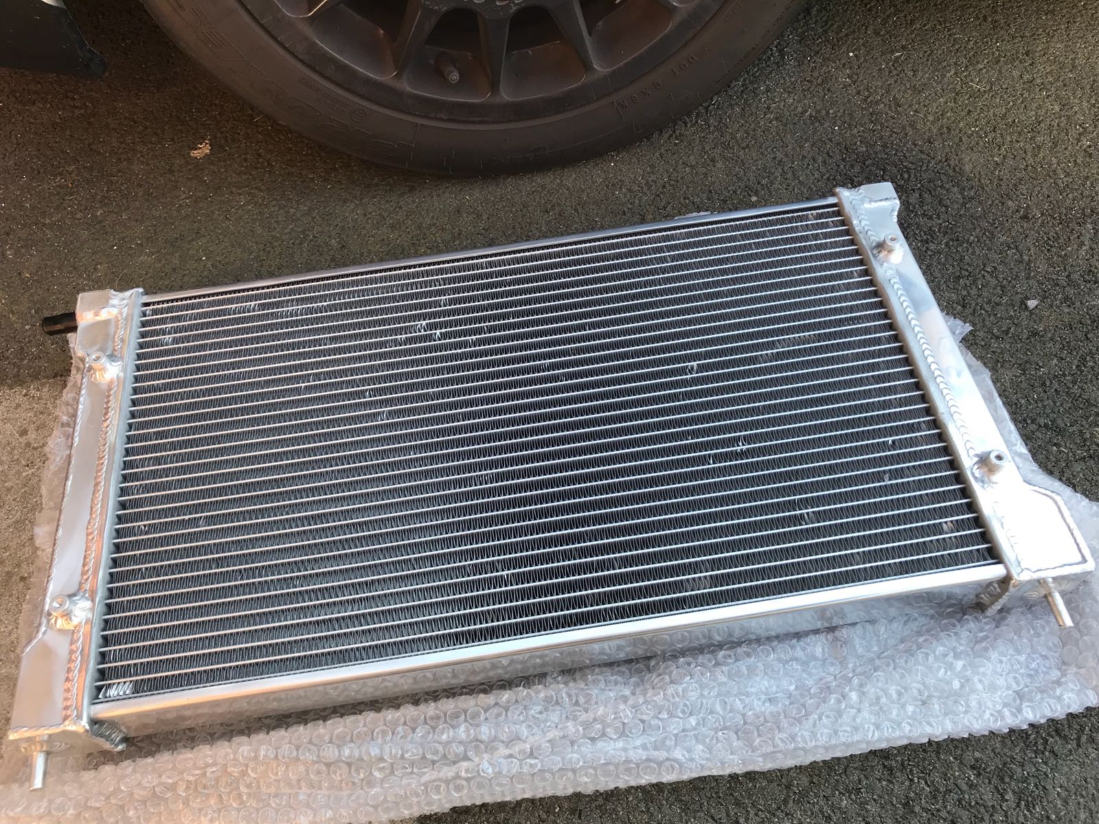

More parts arriving this week. Because I’ll be dropping the subframe to fit the new gearbox it would be rude not to fit a 182 manifold whilst I can get at it. So I’m picking one up this week and I’ve ordered the link pipe from pms for my exhaust.
I should also have a alloy polo rad and a pms breather plate this week.

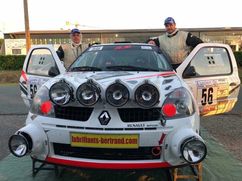

I used an LED light bar and a pair of gas discharge spot lamps for the isle of man and it was a great setup. LED gives a good flood and the spots gave the distance and headlamps do inbetween.

But what the hell is this? Why would they cut the loom? It unplugs ?

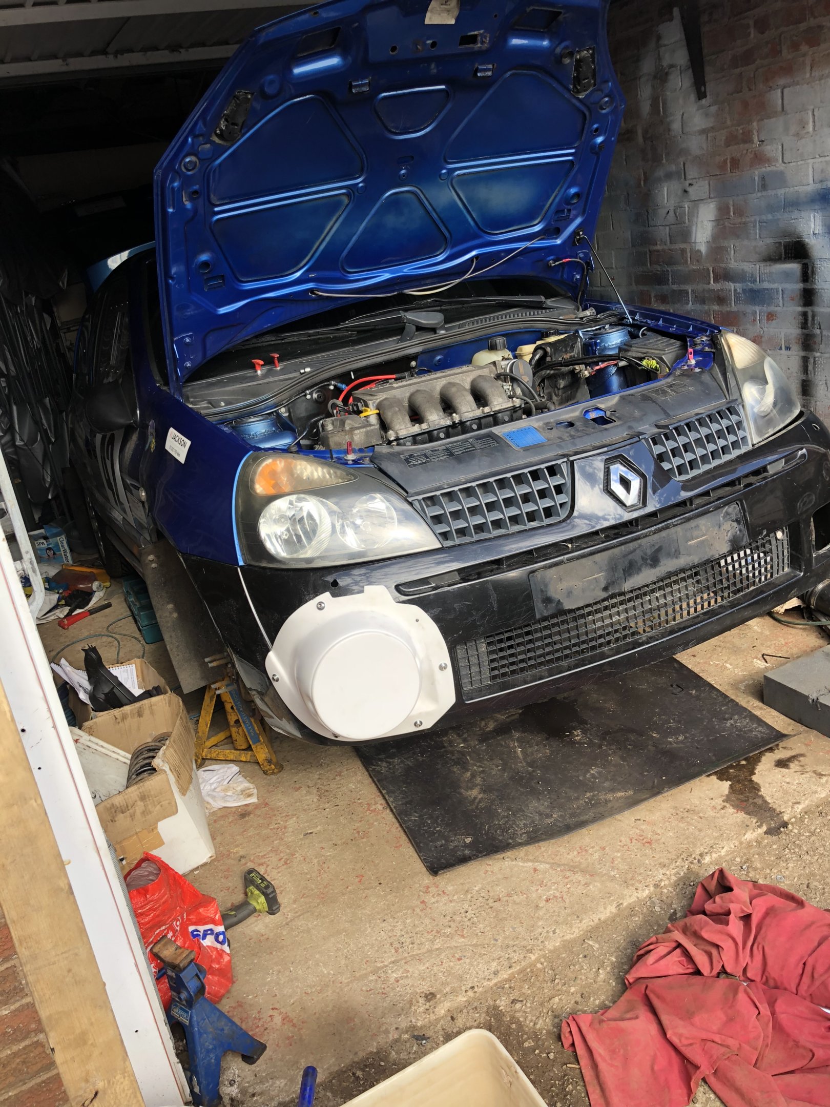

Tonight got the subframe off. All the captive nuts span ? managed to get one off wedging a spanner in bit I cut the others off. They wouldn’t budge. Even with the bigger makita impact wrench.
The box is getting picked up tomorrow. So it’s box on. Drive it up the road. Then back in the garage to fit the Jenny’s

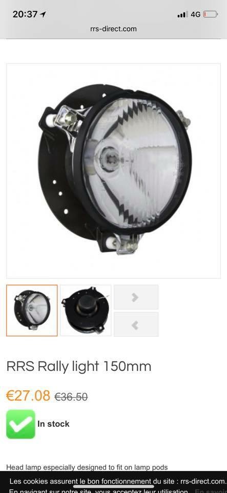

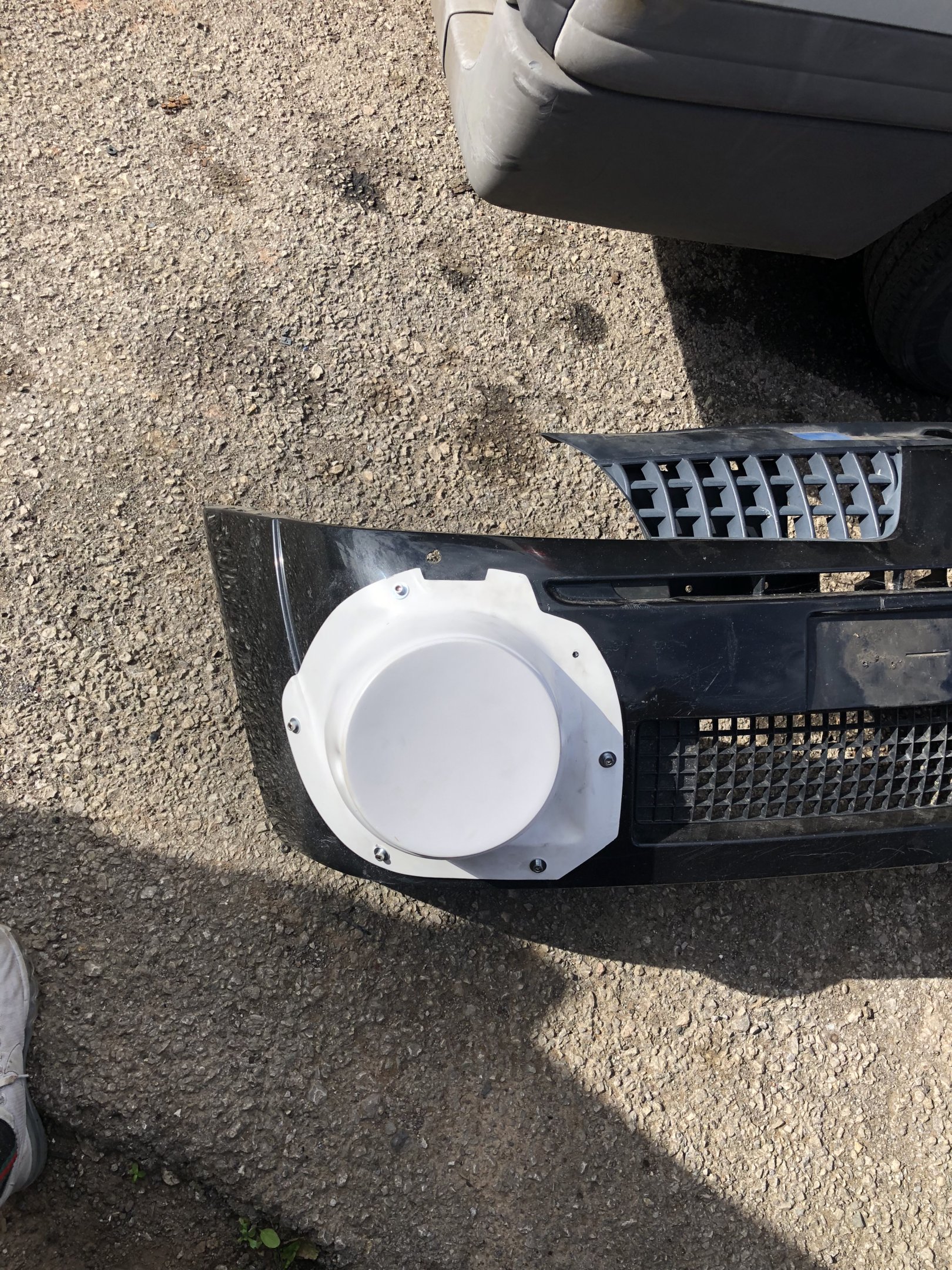

Also managed to mount a bumper pod whilst I had a bit of time. The lights for them should be here this week. Then the bumpers off the be sprayed either blue or yellow

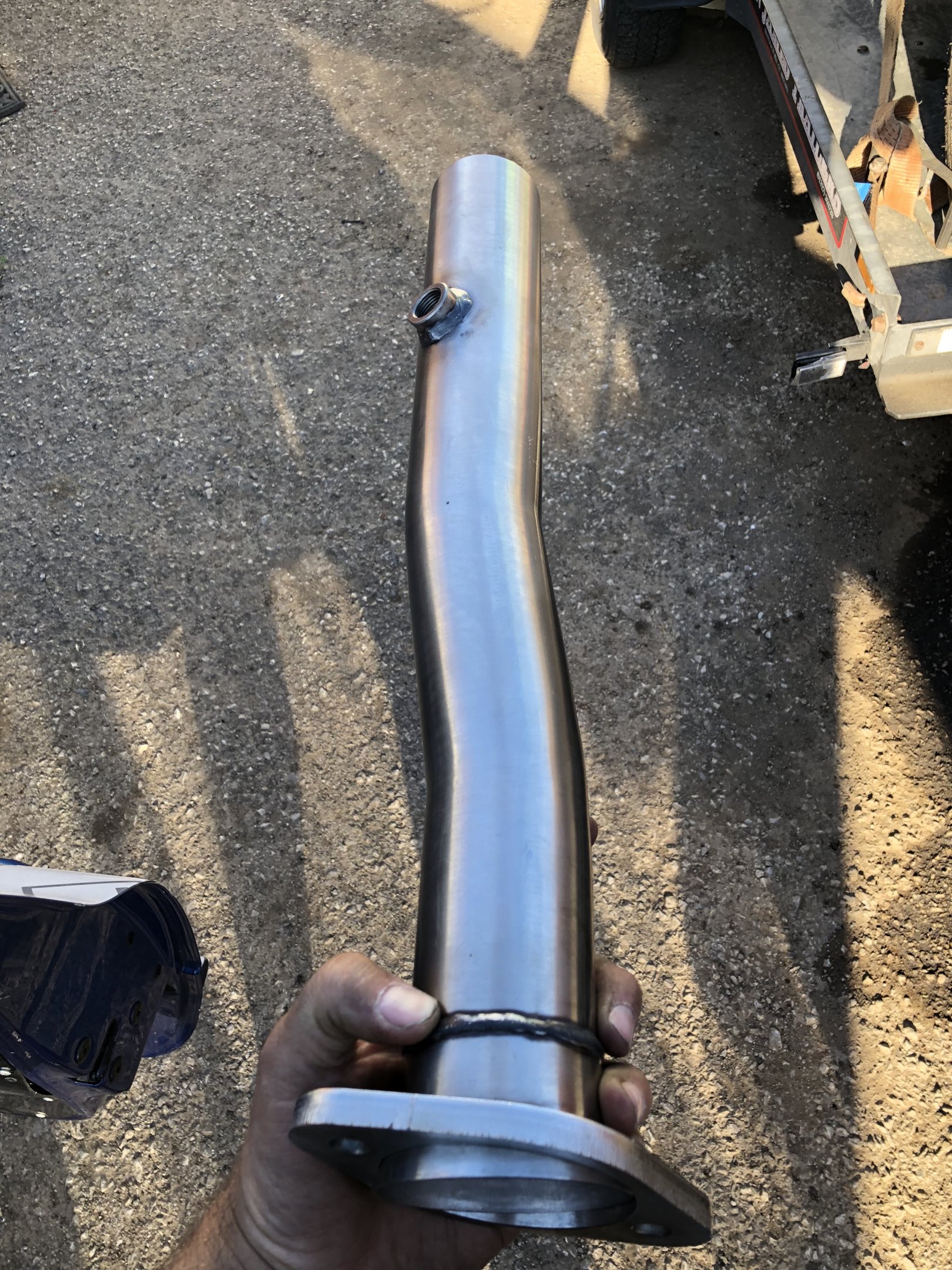

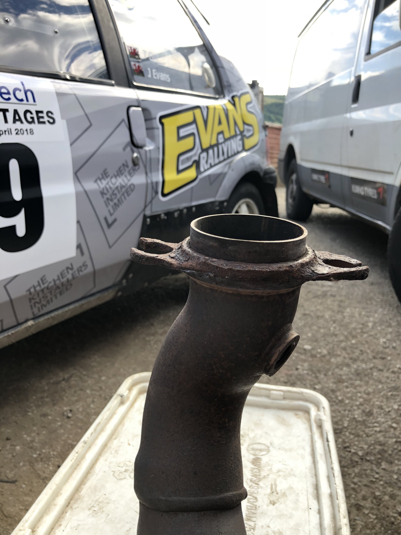

And this needs a new flange. Didn’t realise how bad it was
New bumper light from France half the price of anything in this country

Lights are from rrs-direct.com. I have been looking at a few of there things.
Nathan if you get chance any possibility of a pic of how much light the bumper pods throw out as been thinking of them for the twingo.
Yeah it will be a few weeks until they’re all up and running but I’ll get some pictures
Found them now. The RRS website is terrible lol.
Yeah website isn’t the best with it being translated. I wish I knew they were that cheap from the start. I would of got a Clio bonnet pod and bought these lights. Instead I’ve got to butcher a sack bonnet pod to fit.
