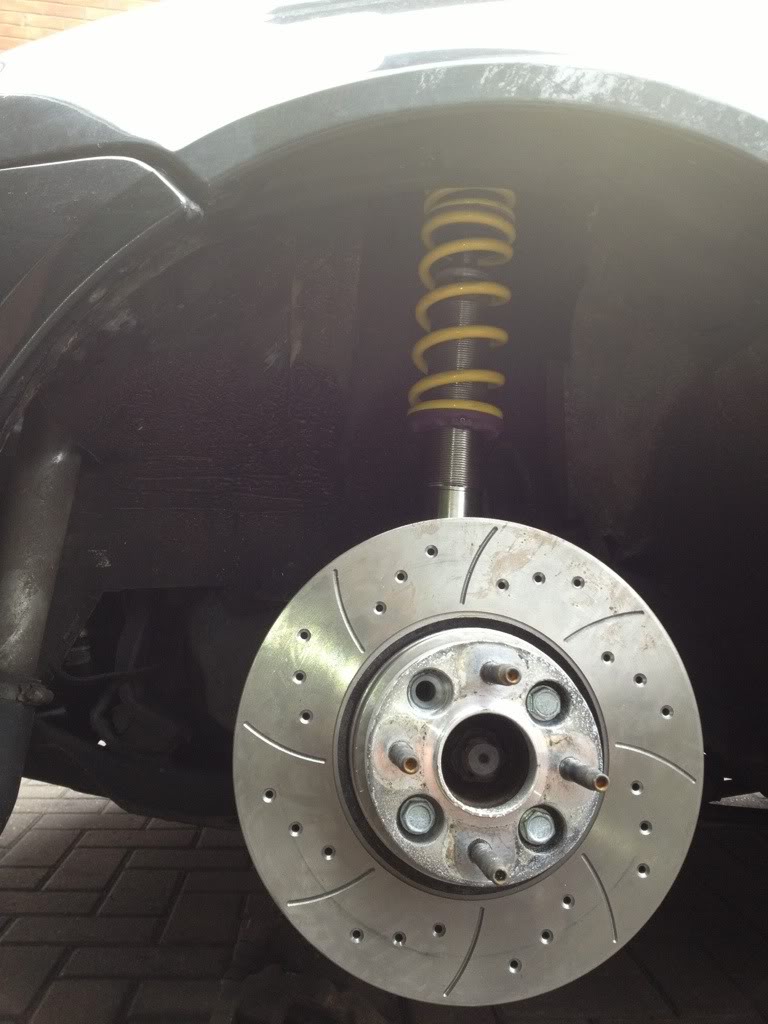

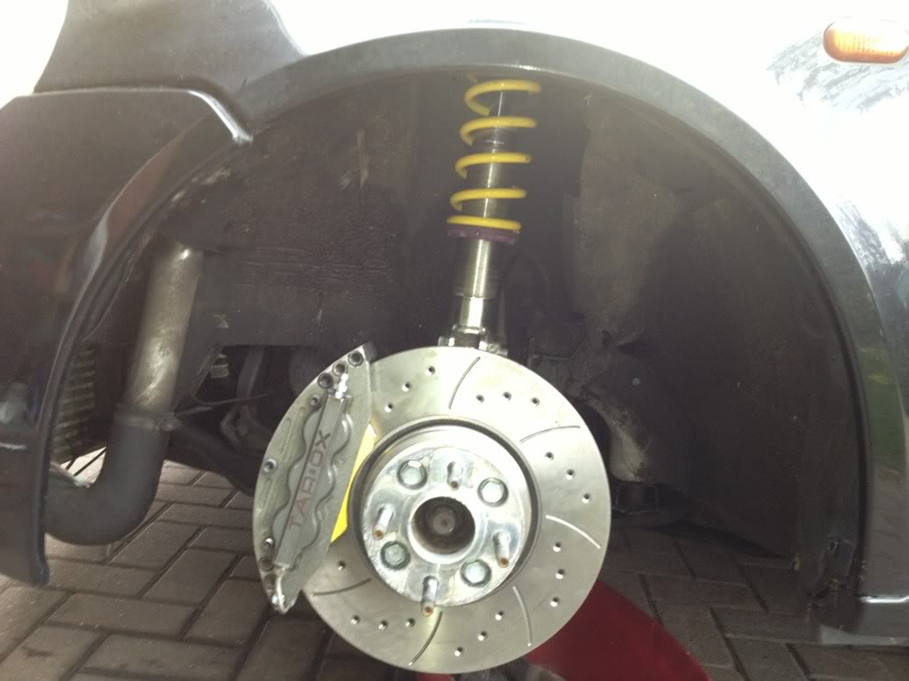

Grabbed them back off him again for the week so me and my dad could finish handmaking the adaptor brackets to fit them to my clio turbo, using some drilled and grooved 300mm disks to replace the original 280mm (iirc) ones.
Excuse the fact the pictures show the pass side caliper on the drivers side, was just a case of only had the pass one caliper to hand at the time I was doing that bit as dad was using the other one while finishing off the second bracket and the wheel I had off was the drivers one. They are identical other than the balance pipe and bleed nipples are fitted the other way though so it makes no difference which one goes which side, you can set them up either way just by swapping the bits over, and likewise I know the spacer only had 3 bolts in, was only mocking up, none of these are finished pictures, will hopefully get those later in the week if I get a chance to do some more work on it, although got so many cars to map this week its actually looking like I might end up having to just whack the old brakes back on for combe perhaps.
Coilover and disk bolted up:

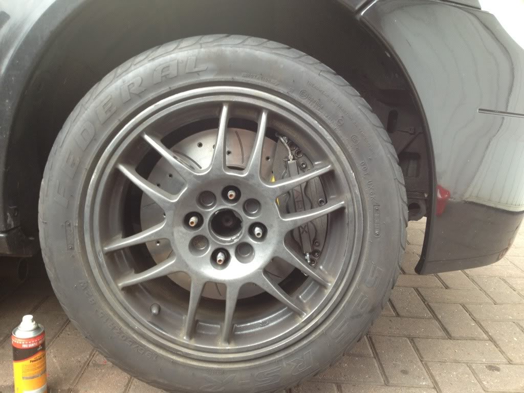

Caliper fitted under the wheel to check for clearance:

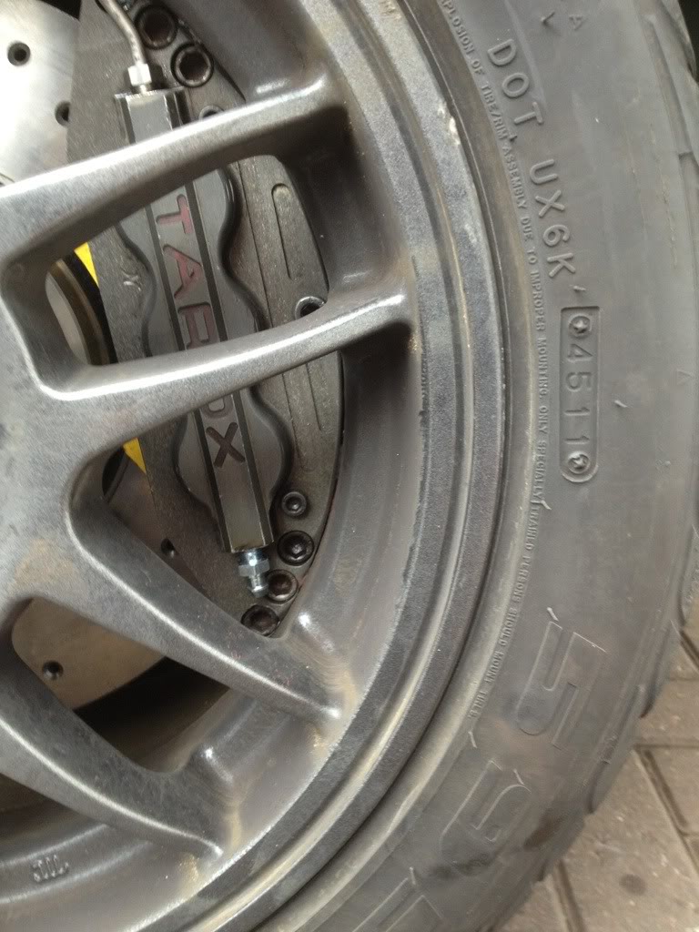

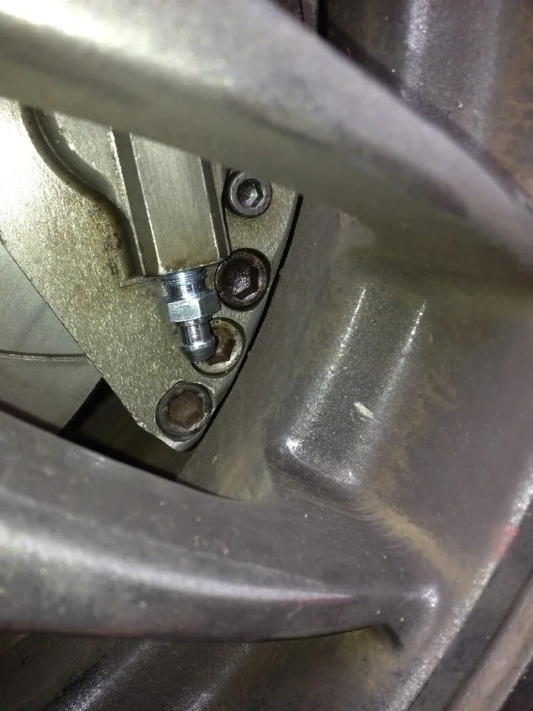

Closer shots showing just how close it is:
Might need to go for very slightly bigger spacers to get a little more clearance but will see how I get on with it first.
Fcuk that's close! Looks awesome though.
Its about 1mm or so of clearance, must confess im not actually positive yet if that will be enough, will just try them during steady cornering and gradually increase load and see if I get any witness marks or not, because is on the bit of the wheel where it changes diameter (the very outer edge of the rim is a lot smaller) it means if I put an extra 5mm of spacing on I can gain a fair bit of clearance.
The willwood setup I ran on my XE corsa was pretty close, but probably more like 3mm rather than 1mm, so not directly comparable.
Considering the OZ F1 is so easy to buckle, you may need some bigger spacers lol ;)
Lol, luckily the bit they buckle on isnt the bit thats near the caliper, thats always the outer rim, this is close on the bit where the outer and inner rims join, the bit where it goes diagonal inside the wheel.
That's fag paper close!
Lol, its probably not greatly different to the spark plug gap, ha ha

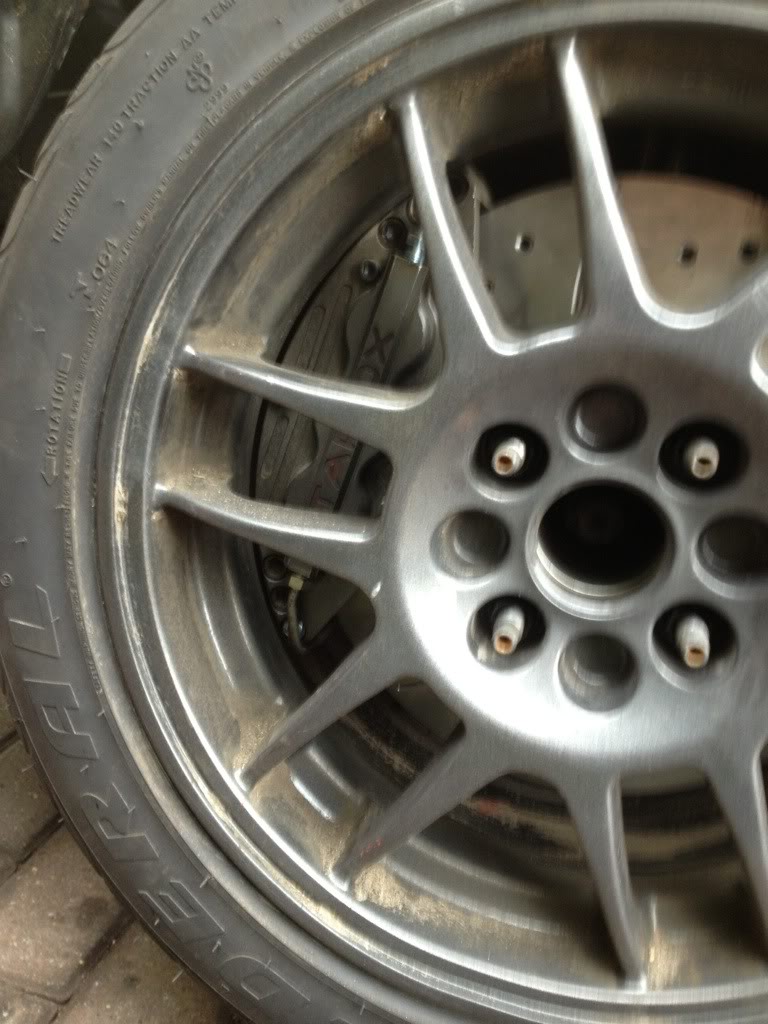

Picture of the passenger side which is now finished other than needing a brake line and the geo setting up:
This is the clearance if I run a 3mm spacer shim between the hubcentric spacer and the wheel:
Was without the spacer shim when you saw it earlier Dan by the way.
Is it sad im loving the fact my brake pads and suspension springs are colour coded yellow? lol
Added 3mm more spacing and its got a little more clearance now. Just been out bedding them in and all feels good so far.
