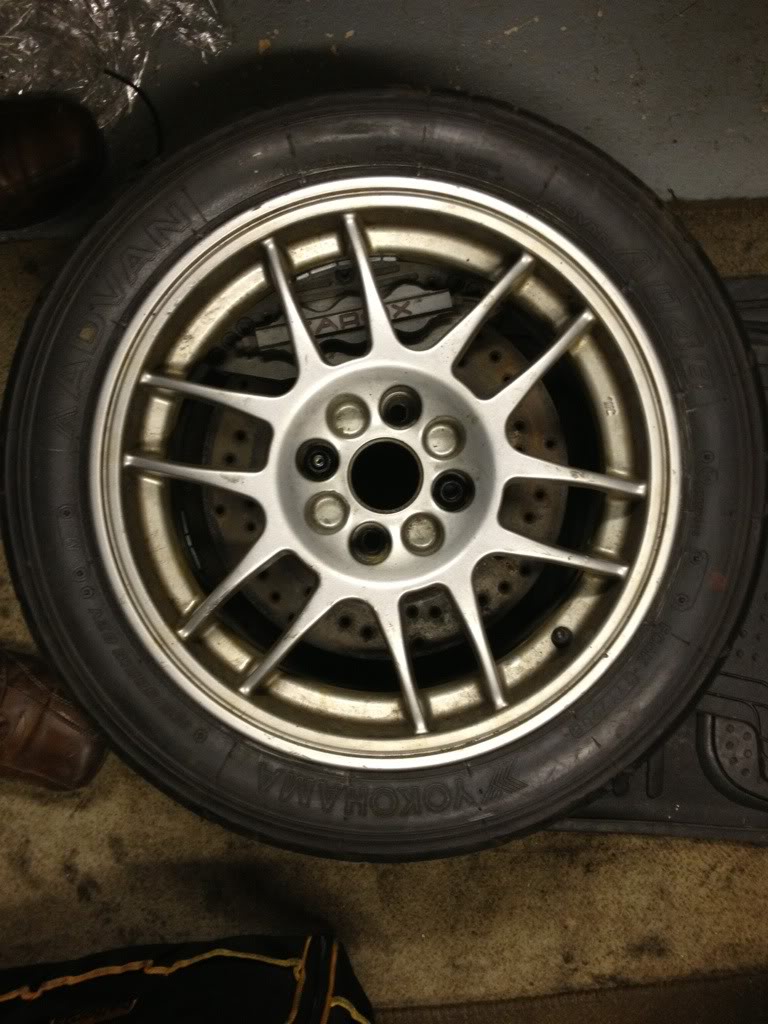

Are you running spacers at all on the front or rear?
Goes well in the videos I must say, good save on the slide. Where did the EscCos go?
Escos went grass tracking.
No spacers yet but if I make these brakes fit that I've just pinched off one of my other cars then I need to run 30mm ones :s

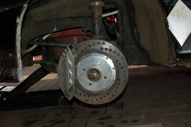

Not sure yet how practical its going to be to make the brackets to sit the calipers where I need them to in order to match the disks, as the lugs are in quite an awkward place relative to the clio lugs on the hub, could really do with the disk being 10mm more offset, but I suspect I will struggle to find one that does that unless I go for completely custom bells and even then im not sure it would be ideal.
Will have to have a bit more of a measure up when I have some free time.

Done a bit more measuring on the brakes, and there just isnt quite enough clearance even with a 30mm spacer to allow the disk to miss the hub brake mounting lugs and the wheel to miss the caliper.
Have ordered a set of scenic 300mm disks, as I reckon those might be a bit better fitment, bit annoying have to shell out just on the off chance, but worth a go, and it looks promising based on some measurements I have taken versus the standard disk (which is identical dimensions to the scenic ones other than being 10mm smaller radius)
