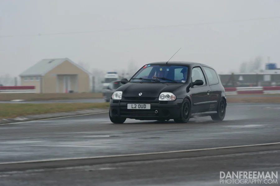

Absolutely buzzing this evening, just had such an epic day with my turbo at Llandow today.
It was great fun at bedford a couple of weeks ago which I expected but to be honest I took it to llandow today purely cause my mk1 wasn't ready as I was thinking that the power of the turbo would be a bit wasted on such a small circuit in the wet so hadnt originally planned to take it, but it just wasnt wasted at all it was epic :)
Massive thanks to everyone who helped organise the day, mainly jay and tony but also all the guys at the circuit who marshalled in the rain etc.
Lost count of how many sessions I did in the end, such a good value day, I do remember taking out all these people for a session (or more than one session in some cases)

Had to touch it once with a screwdriver to adjust a boost pipe, and had to fill it with fuel but other than that was faultless. Really makes all the hard work me and danlp6 put in over xmas feel worth it.

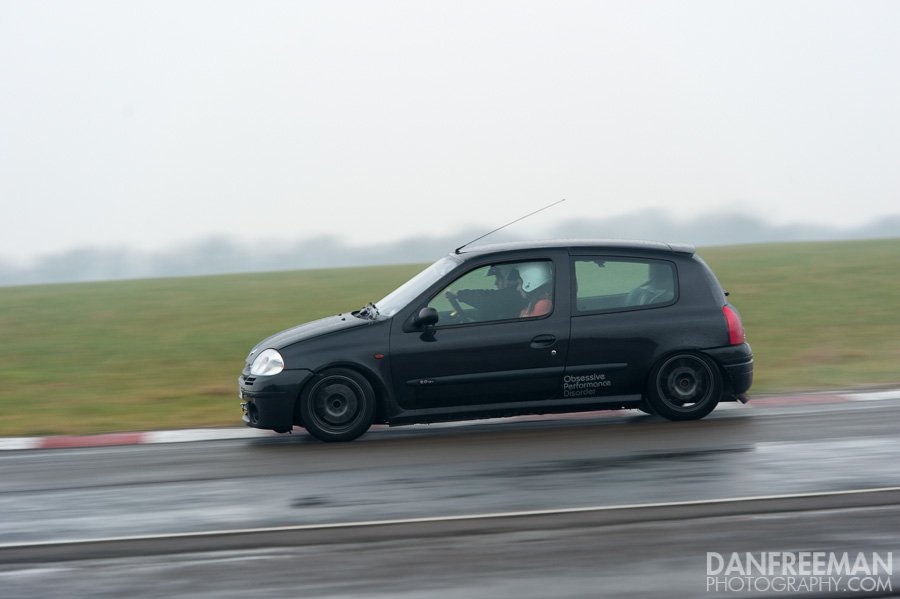

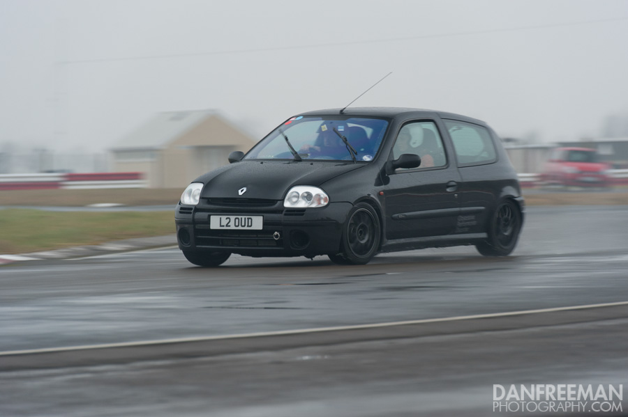

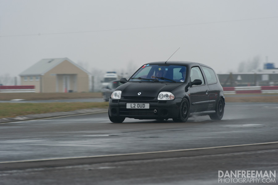

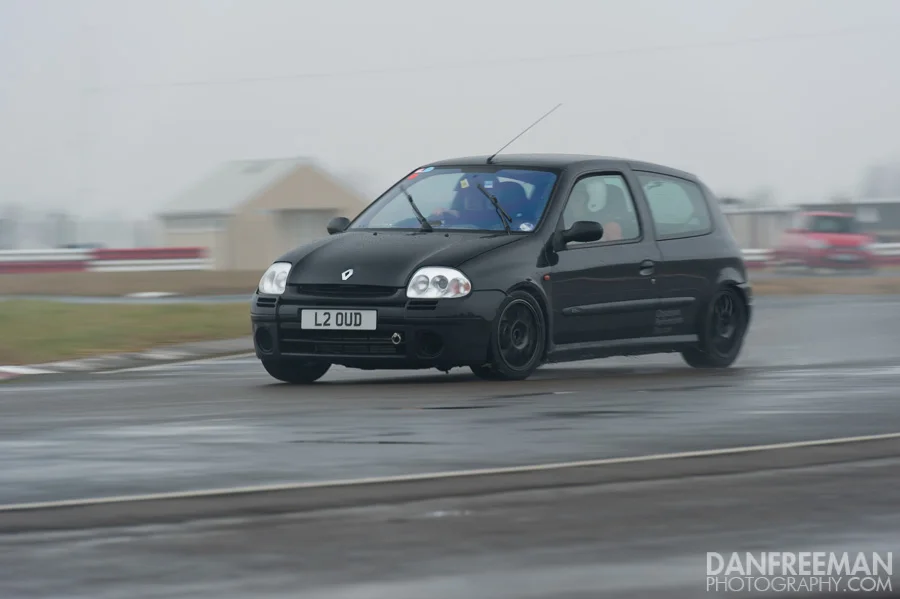

Some pics from the day:
Pics from the legendary Mr Freeman :)
PROPERLY loving this car since the rebuild, it just seems to do everything I could hope for really, show it a large dry track its epically quick, put it on a tight wet track and its perfectly controlled and drivable despite the power, and on the road its comfy , not too noisey and effortlessly quick.

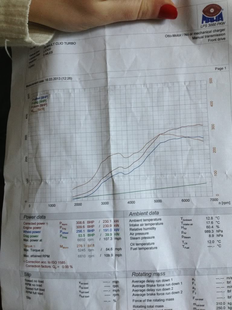

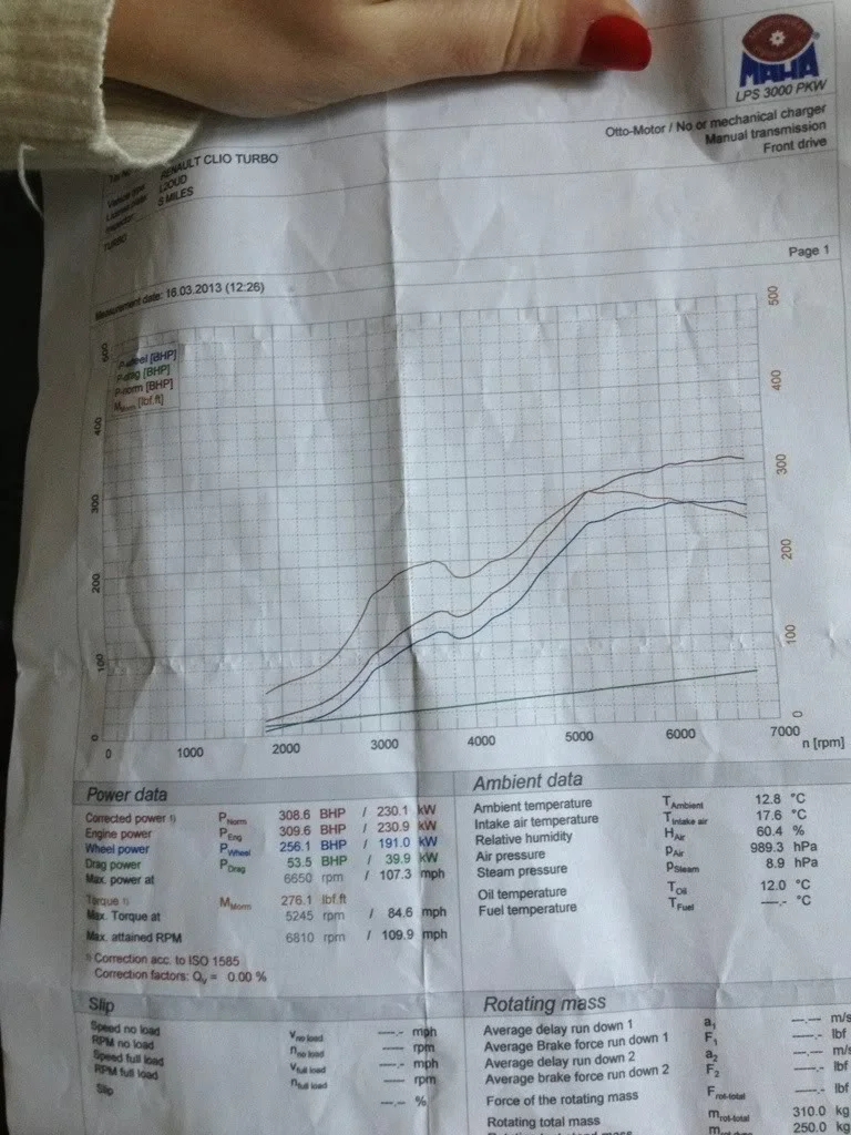

Went to the southwest rolling road meet today at Tipton garage.
I nudged the boost up just a tiny bit as I knew people were hoping to see it crack 300.
torque is low because the operator had to back off a touch when it wheelspan and then feed the power back in, tyres just couldn't cope with over 300lbft on the metal rollers. Probably would have done 330-350 lbft I guess if it had traction as it would have been 2 bar then not one at 4-5k

Not sure if i asked before but have you had the car weighed Chip? Also, is 50bhp normal for transmission loss (if i'm reading that right?)
What is normal, 15/20%?

In the summer I won't be able to quite make the same power, nice cold day today so good for intake temps. So although I will leave the settings the same it will still dip back down a touch. Although tbh 280/300/308 etc. really makes no difference on trackdays.
Dyno dynamics assumes 15 percent for fwd but maha reads it differently as includes an element of loss for the rollers themselves as well as the cars transmission.
never weighed it, slightly more than a standard ph1 I guess.
