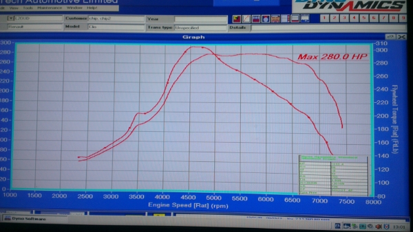

Ignoring the comical speeding, even on the previous setup I still can't believe how well it pulled, while still behaving like a normal car when driving normally - fantastic little car
Yeah Dan's first comment when he drove it was he couldnt believe how easy it was to drive and how timid the engine is at part throttle, still drives like factory standard in that respect, only slight thing spoiling that is the paddle clutch but sadly with the torque I have that is unavoidable, if it wasnt for that it would be fine to send your mum shopping in still.

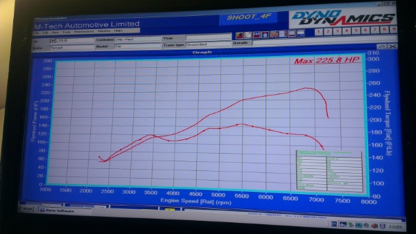

So I would say its about 25% worse on fuel for everything other than hard driving, and about 50% worse for that! (as you would expect for double standard torque nearly and over 50% more power than standard)
