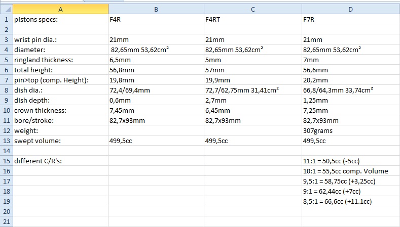

It has dish depth and middled diameter so won't be much work for you to calculate the volume right :p
F4r's dish is negligable, the valvepockets probably are more cc's than the dish.

Thanks for the numbers mate, 9:1 f4rt pistons might not be too bad then if I run a 172 gasket instead of the megane one which is thicker.
iirc that will claw back about 4cc or so. Bit of a block skim and a head cleanup and I should be high 8s, I can live with that.
  R5 gtt, R27 F1 team
Well if the head takes a stock 11:1 cr to 9:1 fitting 9:1 pistons will really get it down too much!
I think f7r pistons would be a better option...
Head alone doesn't. Mine is on a thicker gasket too.
will have to check the numbers but iirc mine is about 12cc bigger, with just over half that in the head and the rest in the gasket.

Do you have the standard head volume for the williams head?
Only I have found some 11.2:1 compression pistons listed for the williams, which look like they might be promising for turbo pistons for the 197 head, as going on your spreadsheet there, the williams are a little bigger dish than the F4R in the first place, so a higher comp version of the williams ones potentially could be a good option for being close to the standard F4R ones.
  182/RS2/ Turbo/Mk1
0.4mm difference on that sheet, yes that would indeed more than cancel out the 0.6mm deeper bowl.
So that rules those ones out too.
Looking like being a real PITA to find a readily available (hence sensibly priced unlike a custom set) piston to work with the 197 head :(

based on some assumptions, which I need to measure when the head is off. I think f4rt forged standard cr pistons with a 172 gasket (thinner) and 197 head (bigger) would give me about 8.14:1
bit low but not end of the world I suppose. Head doesn't look like it would let me chop the 2mm off that I would like to. Lol.

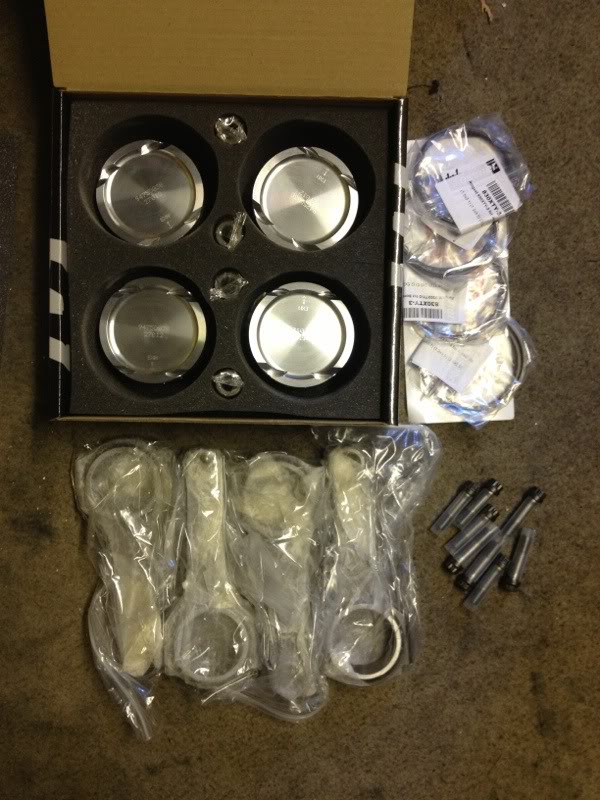

These turned up today, Wossener Megane forged pistons and some steel conrods.
I believe that by running the clio headgasket rather than the megane one like I am on currently (clio one is thinner), and by skimming the 197 head, I can get the CR to somewhere back where I would like it to be using these pistons (dont want it under 8.5:1, somewhere around 9.0 would be good now that im using the same manifold again, was thinking of going as high as 9.5:1 if I went for a bigger turbo and better manifold but there is just no point on the standard gearbox, so im just looking for the same power that I had before but on a nice fresh engine)
  182/RS2/ Turbo/Mk1

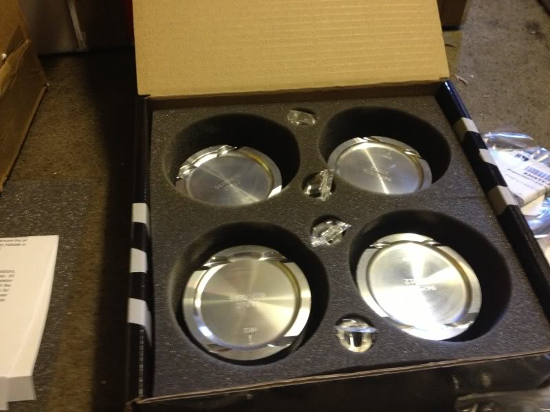

PS
You can see how they arent massively bigger dish than a standard piston compared to this picture:
So I am pretty confident that by losing a few cc out of the head gasket and a couple of cc with a head skim, I will end up not too far away where it is now which im happy with how it drives.
