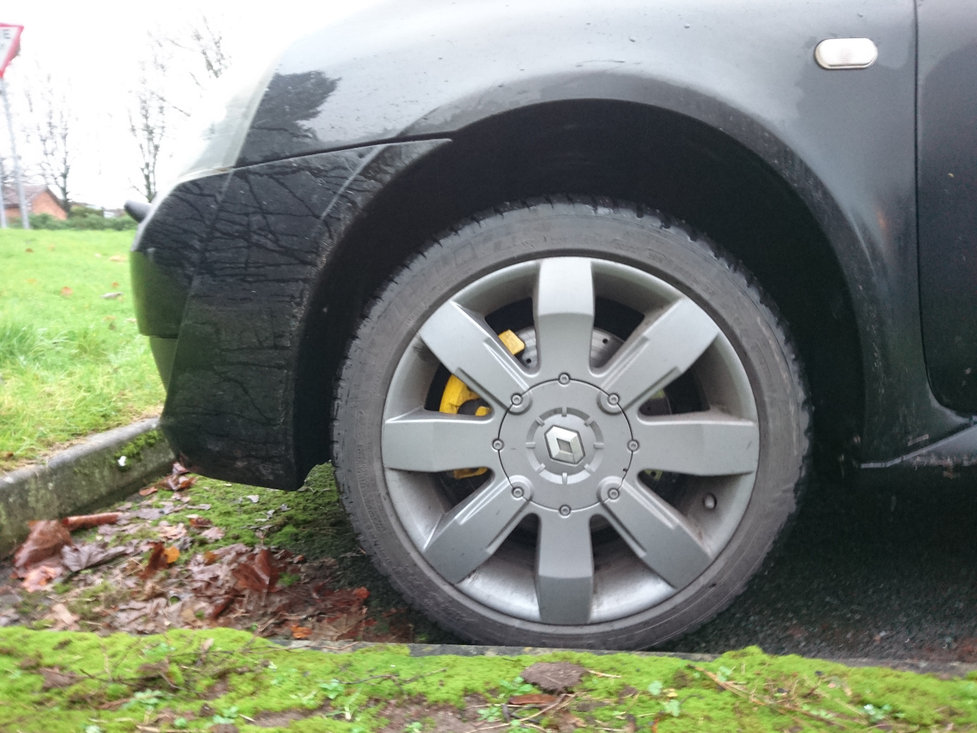

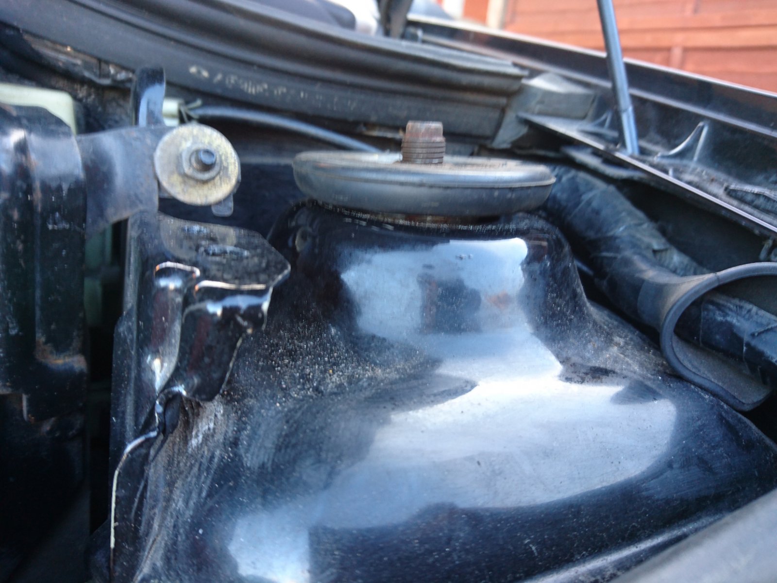

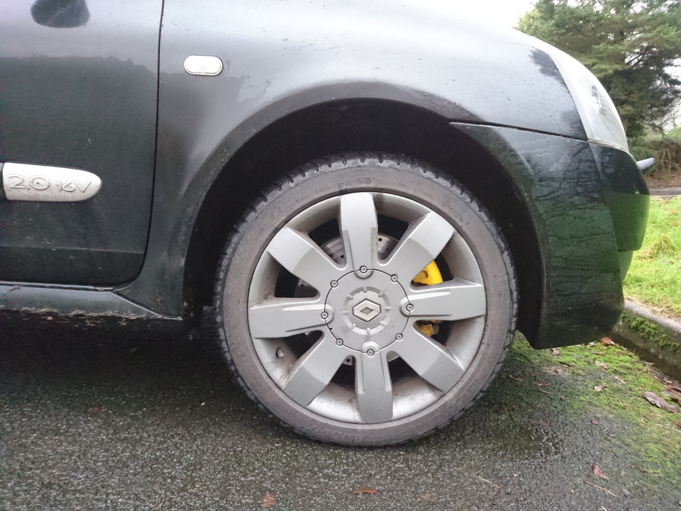

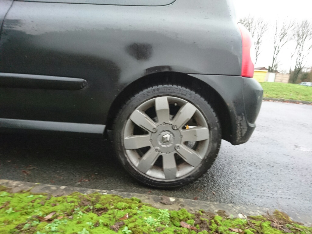

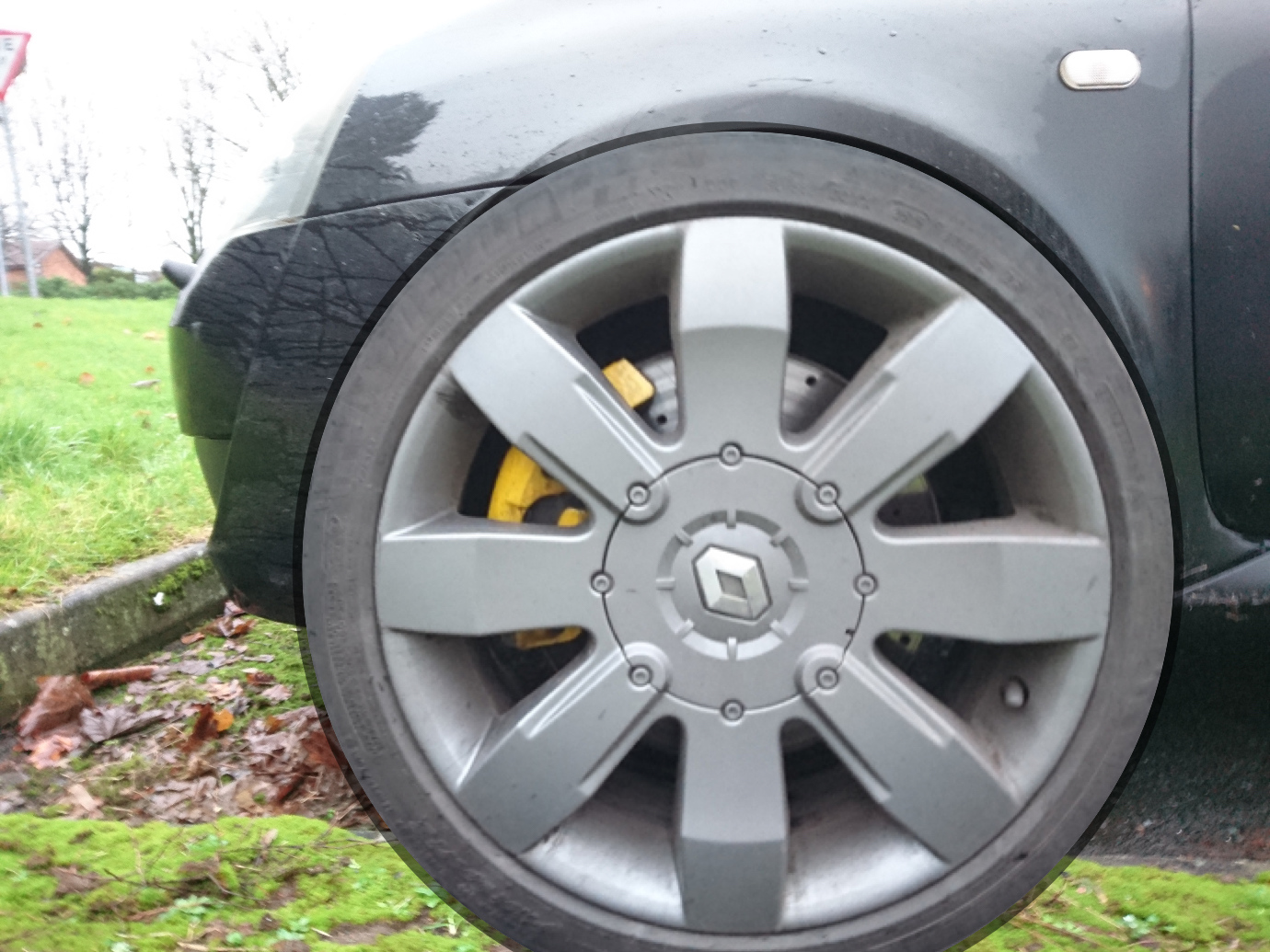

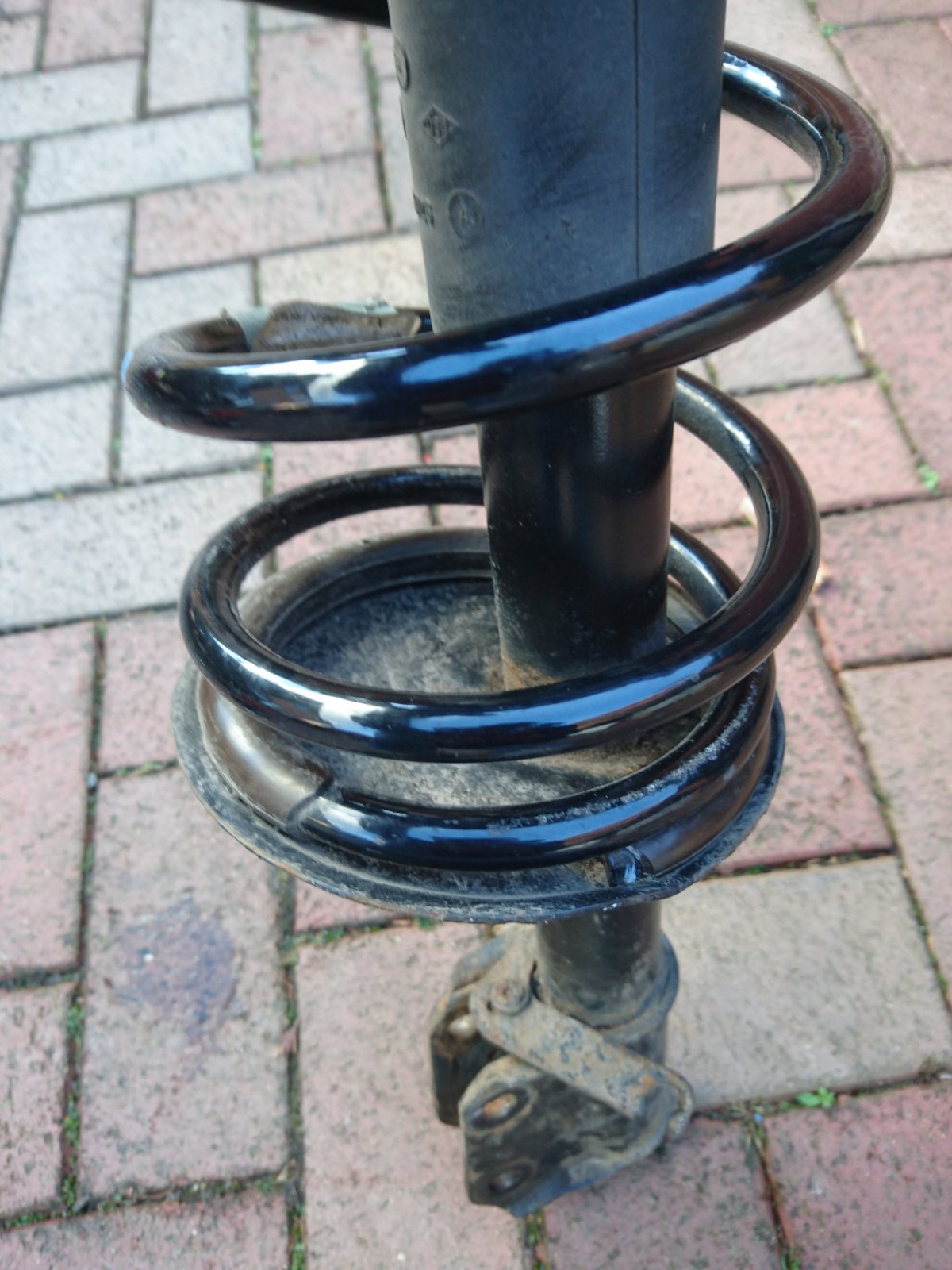

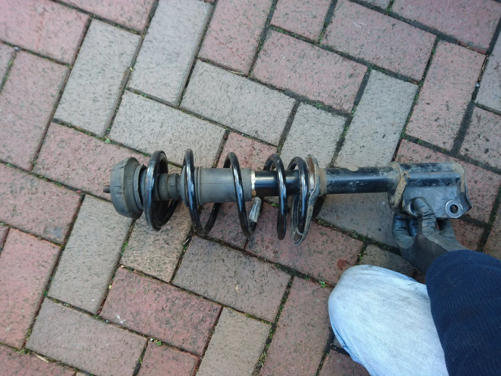

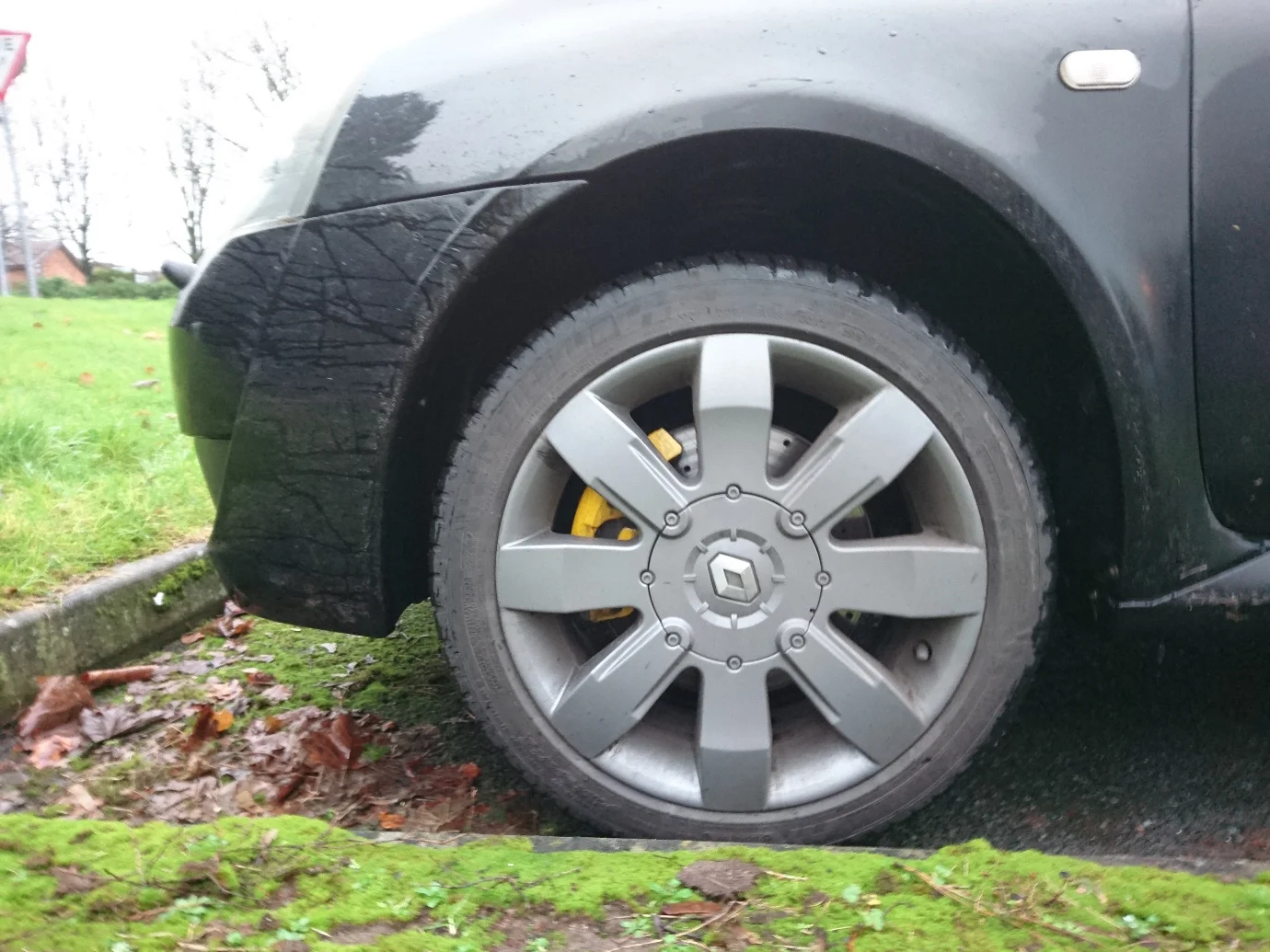

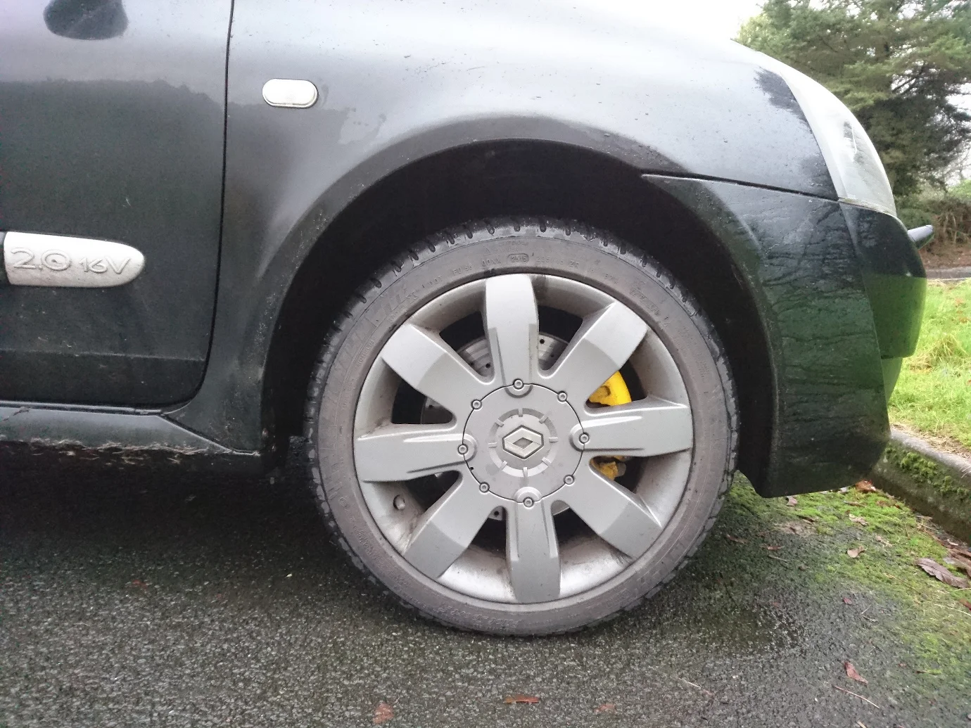

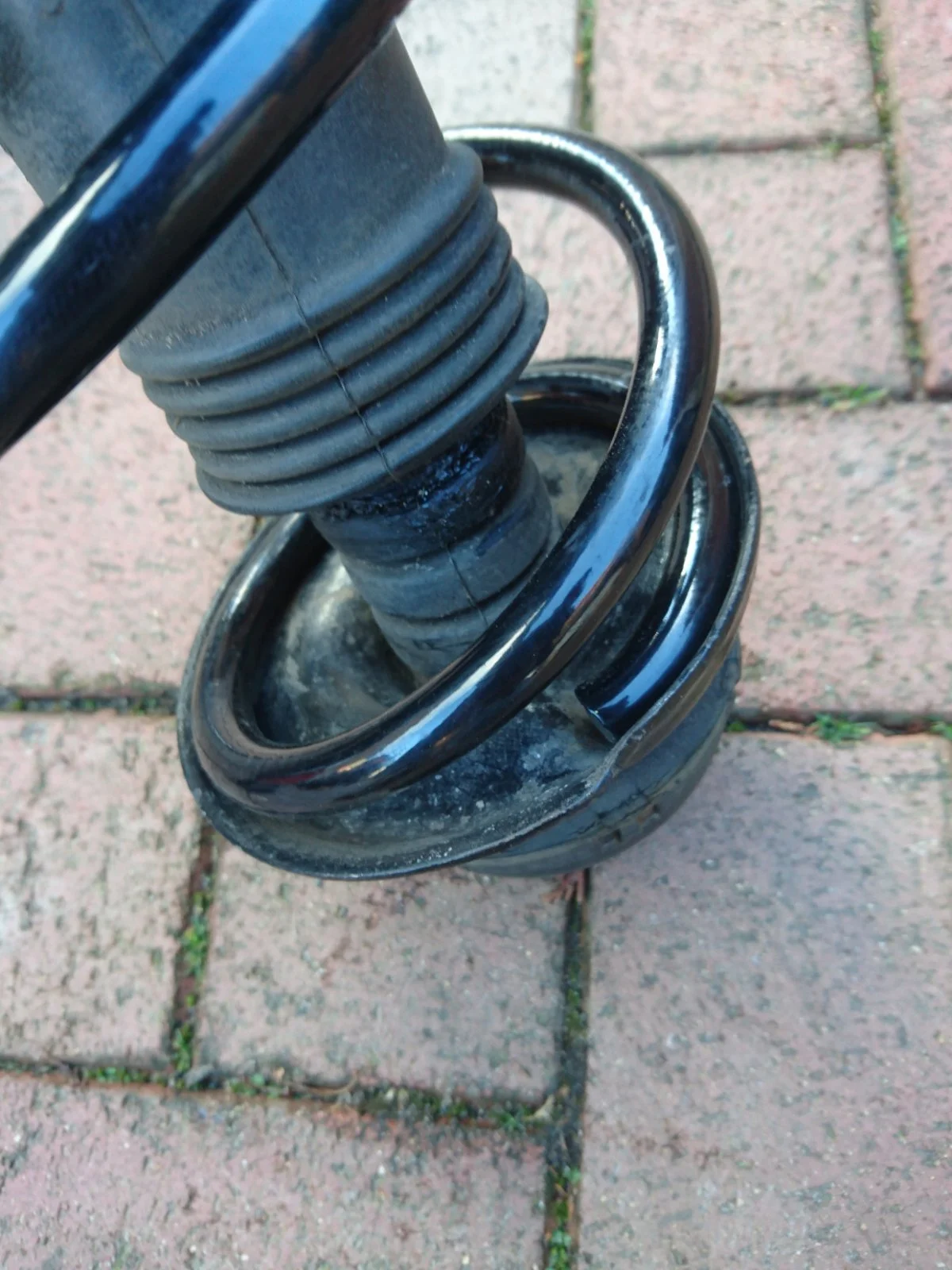

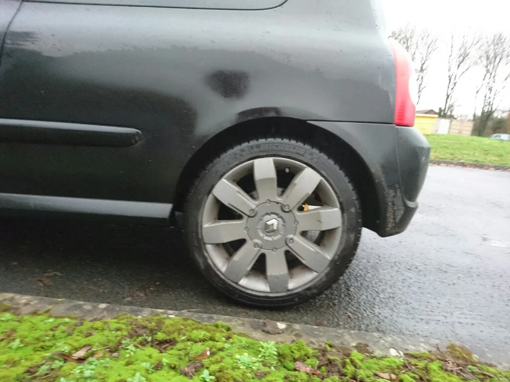

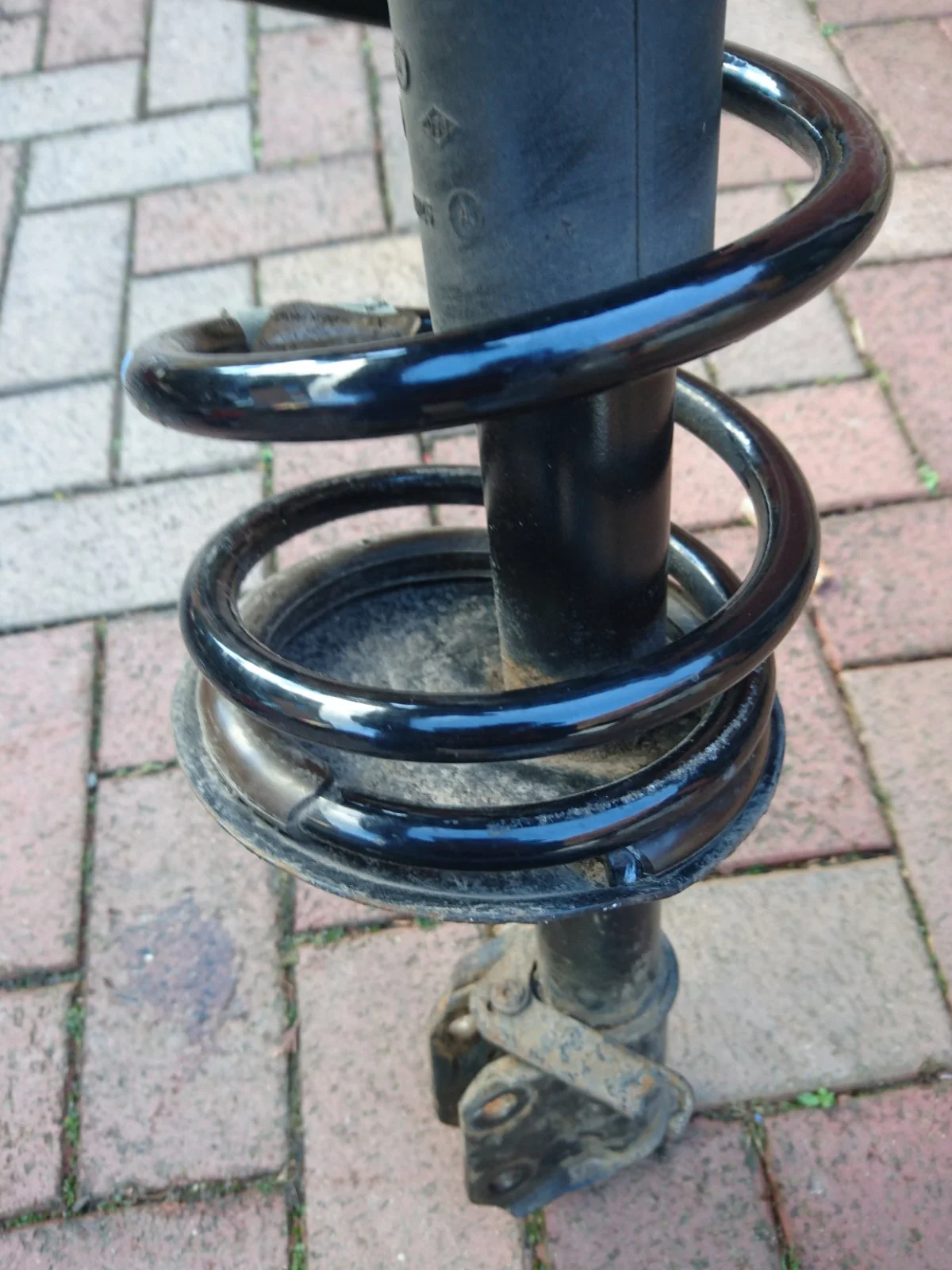

The issue I've got is I've fitted new cup coil springs a couple of weeks ago to both fronts as the previous ones had both snapped in the exact same place and within about a week of each other! on my 182 cup (yup definitely a cup has 60mm shock) and it now appears to be sitting a lot higher than previous and just looks a bit odd! am I correct in thinking it looks wrong?
I have driven it for a few hundred miles since fitting so I would have thought they would have settled by now.

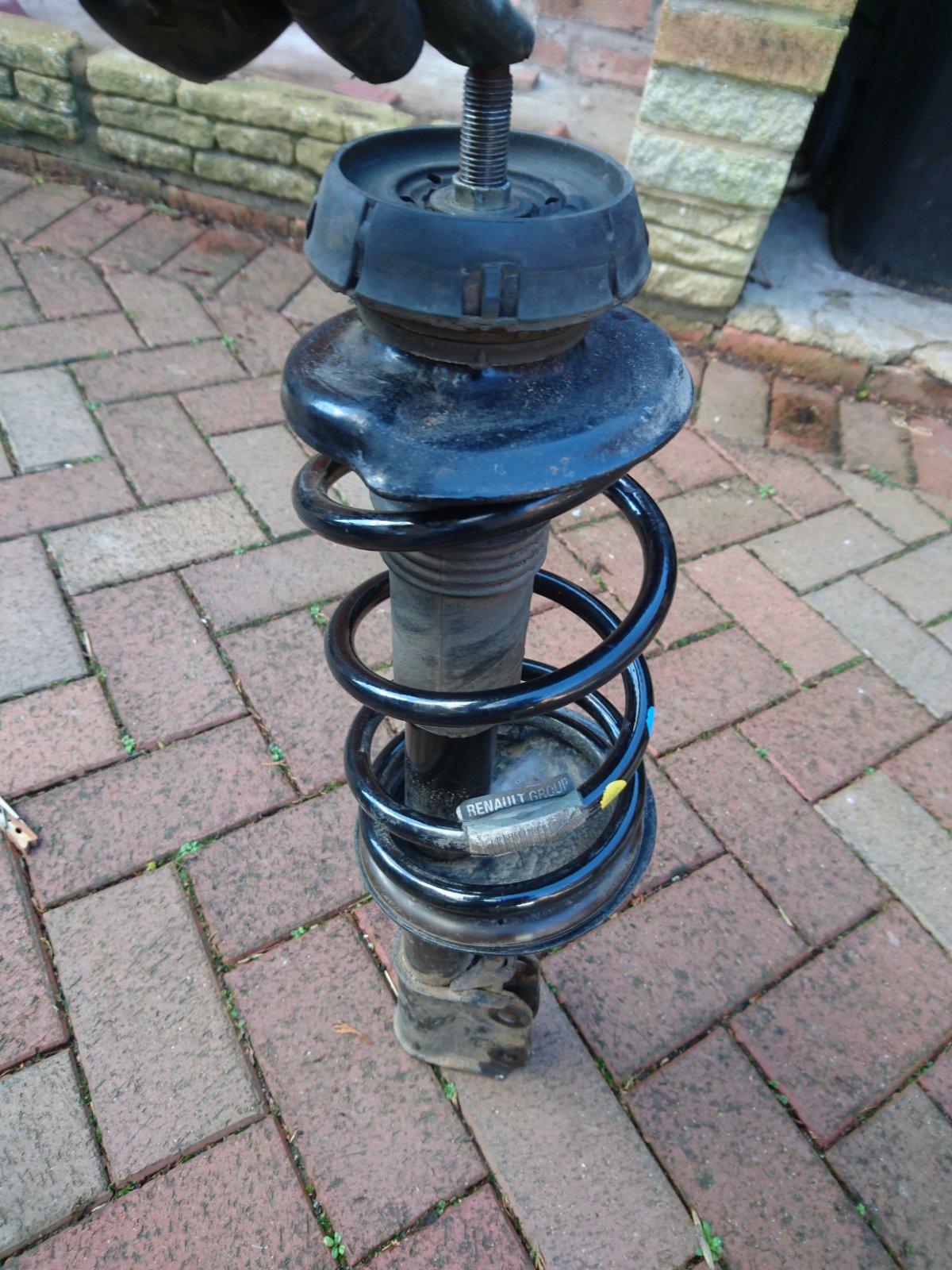

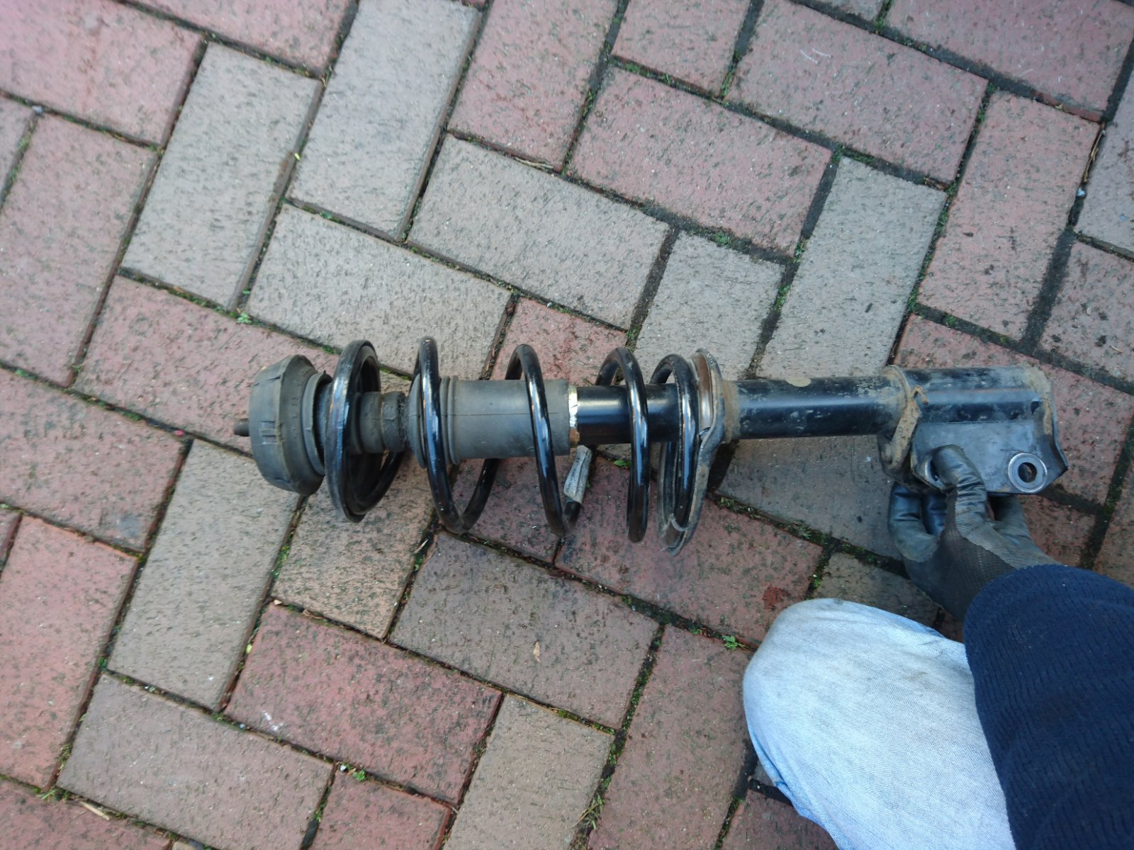

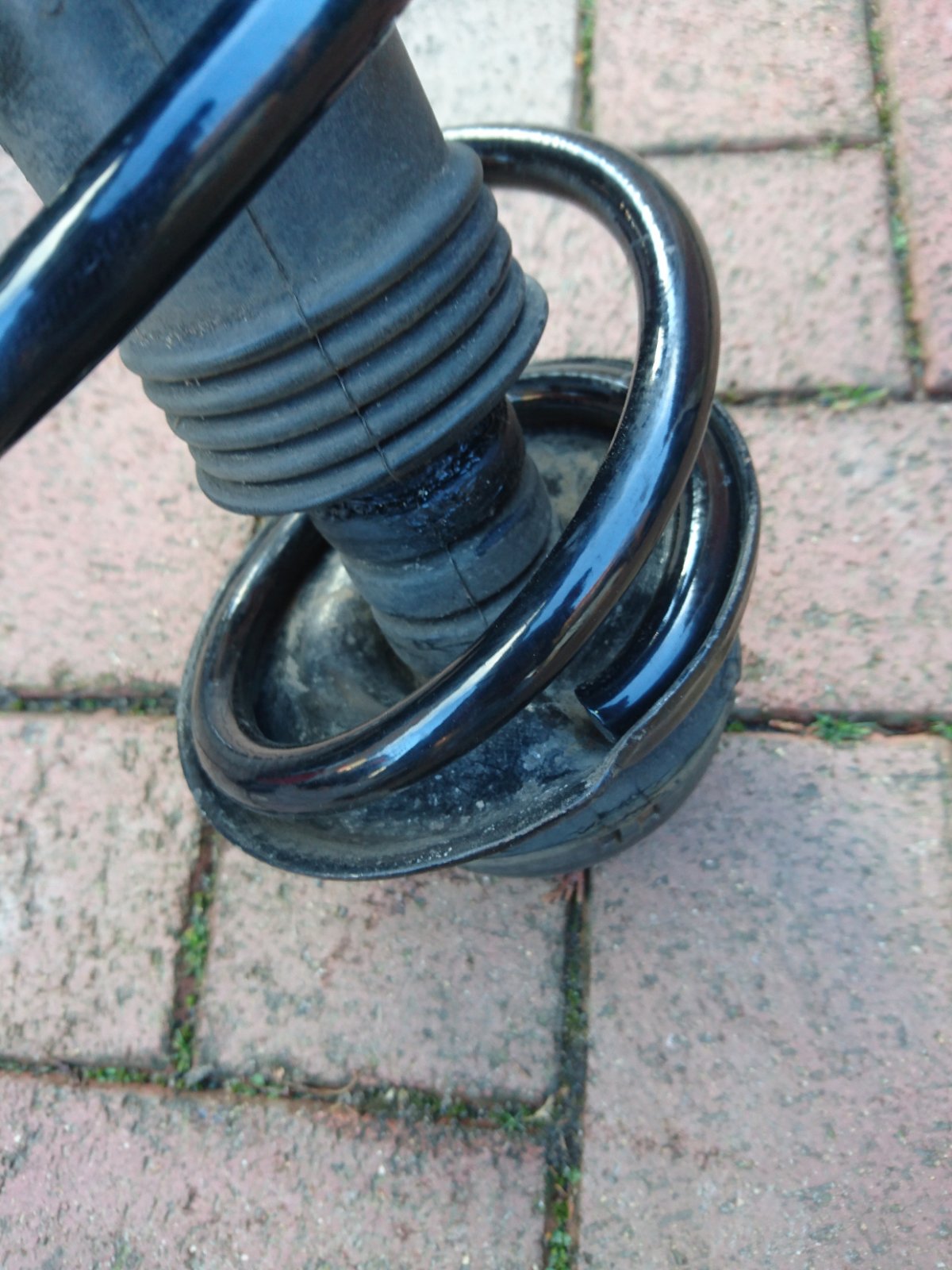

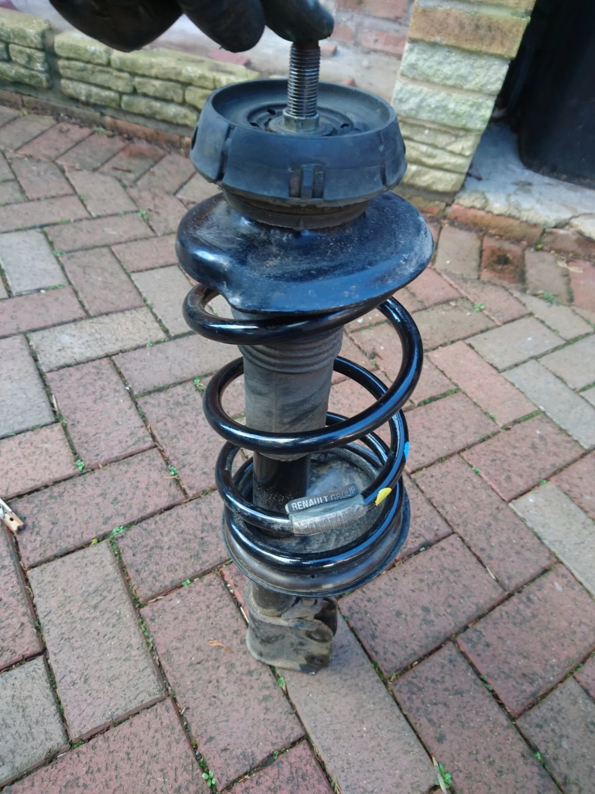

I'm pretty certain I did everything right and put back together as it came apart, took the shocks out compressed the old springs and took everything off in order and then compressed the new ones lined the ends of the suspension up with the correct notches and put everything back on in the same order, I've attached some pictures of the springs to take a look.

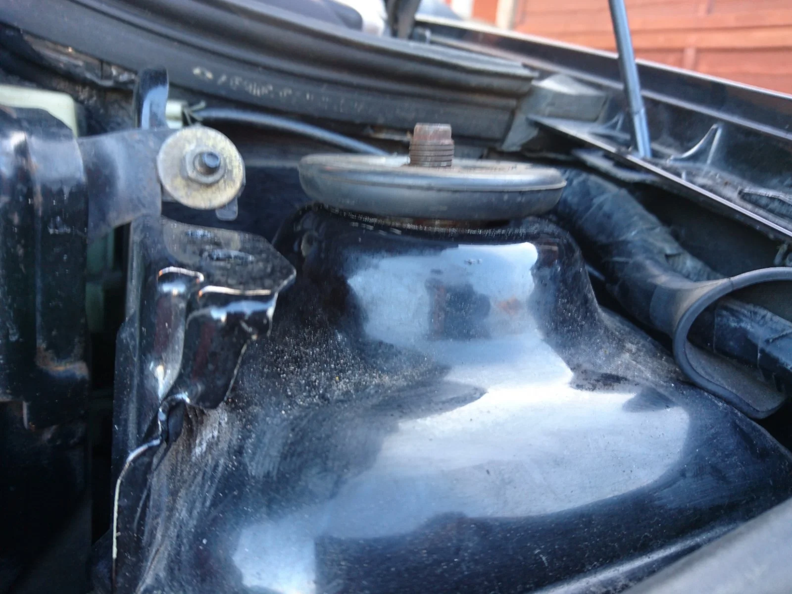

The only thing I have noticed is the top rubber is a little loose (the one on the top of the shock) I know the top inside the engine bay is meant to be raised...normal clio :)
Part numbers are: 82 00 342 860 with blue and yellow dots (same as I took off) ordered them from Renault Wolverhampton
Have I fitted something wrong for them to be sitting high now or maybe wrong suspension sent?

Er very wrong mate

Anyway, even though the springs look to be the correct ones something is quite obviously wrong somewhere! Have you had them back off to double check everything?

@Daz... Yeah I took them back off today to double check and it all looked ok to me so took some photos on here

As the others have said - definitely doesn't look right! Other than them being the wrong springs I'm not sure what you could have done to make it sit that much higher than it should be. Don't forget to get your tracking adjusted after replacing the springs as well.

When I changed the springs on my old 172 I barely had to use a spring compressor. These springs do not look right. The coil spacing looks too big. Can't help more than that other than to say get some eibach or cook sport (I had eibach and loved them).

@c4pob yeah I really had to compress these to get on! Are eibach pretty good then, lower?

Will be the wrong springs.
I was sold some legacy shocks and springs for an Impreza I had, it sat like yours.

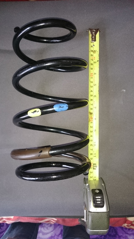

In your top pic , it doesn't look too dissimilar to the pic I've posted . Your other pics aren't quite as convincing . This is a genuine cup spring from a 182 . Just for your reference . It's exactly 30cm long . Not the best pic I know , but just so you get an idea.
Try pulling them of and fitting the other way as something isn't right there, and if that doesn't work send them back and just get a set of 40mm AMAX (re-branded APEX) from ECP for £50, I have them and they're great for the money.

Thanks for the help guys looks like I will be ringing them up tomorrow as does seem very odd. Thanks for the pic @MRBILLYUK unfortunately I didn't get chance to take them off again today to measure the spring or the spacing. but there is something clearly wrong somewhere which is what I thought, may well be getting some eibachs instead then :)
@JB21 what do you mean turn them round, upside down(surely that wouldn't work?) or opposite side?
