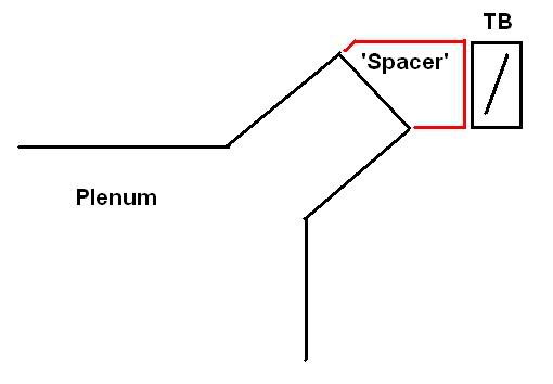

Looks brilliant. Was wondering though, could you not have some sort of spacer/adaptor made to make the TB sit horizontaly in the engine bay to make fitting the filter a little easier and neater?
Something like this:
Could have a flange which bolts to the plenum and one for the TB and a bit of tube welded inbetween to join the two?

is there much point adjusting the angle of it? gains would be minimal at best.
whats the race car plenum like duck?
instead of coming out the back at a 45 degree angle as it does, it comes out the side at 90 degrees which allows them to run a massive ITG filter and airbox
Yeah, we did toy with the idea mate and cutting/ re welding the manifold but didnt think it would be worth it.

Ah right, where did they get the plenum made? renault or just a bodge job?
On the BPM car in order to package the airbox etc. in we moved the throttle body flange/plenum inlet by removing and rewelding the flange and neck and plating the required areas around/behind it.
On Kevs car there was little point in doing this as it is a road car and retained stock ECU/Gearbox etc. which would have negated how much positive effect this would have. As such Kevs car runs with the 'standard' Oreca X85 cup car inlet manifold.
