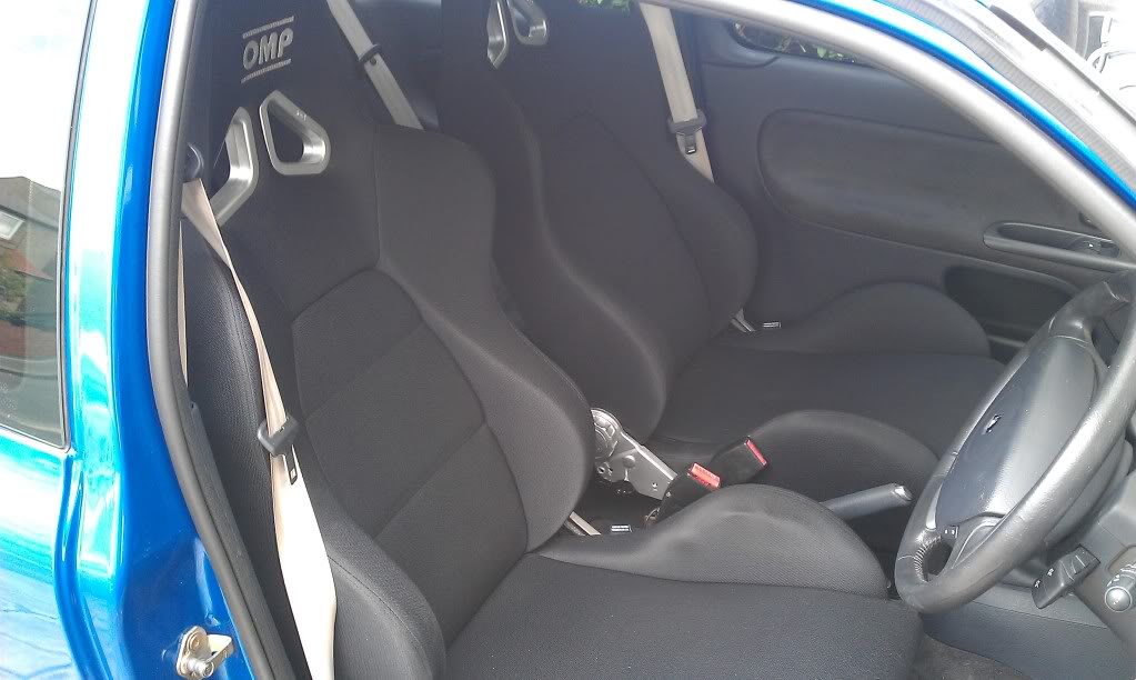

ended up with these
They look pretty good... quite cheap looking fabric but I guess they do the job well?
Do they sit lower than standard? Well done on not going for Trophy recaros... they're really not very good at supporting you.
there made by omp, bought them off a lad on here. they already had clio subframes on and seats belt pretensioners so it was just a case of bolting them in really, the lad sorted all the wiring out aswell so no airbag lights etc, really happy with them
Nah think that's just the lighting in the pic, the material is quite nice and tough looking, they sit a tiny bit lower but the real bonus for me as I'm quite tall is they go further back! support you well without being too uncomfortable. I slightly firmer,sportier ride
Ohh they look spot on! If they were mine id spray the silver harness holes the same colour as the car and then colour code the dash in the same blue aswell ;)
