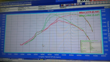

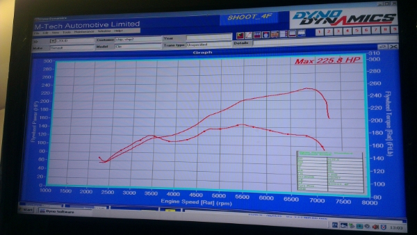

310lbft and 280bhp, but more importantly, I have the boost mapped against throttle angle as the user torque request element of the algorythm so it means that im only running that torque when I want it, it doesnt run away with you like a lot of turbo cars do.
This is full throttle curve and 3/4 throttle curve overlaid:
but if you just give it half throttle it is like an ITB car in terms of making moderate torque but holding onto it all the way up:
P.S - I love those graphs! Very well done with the mapping :)
