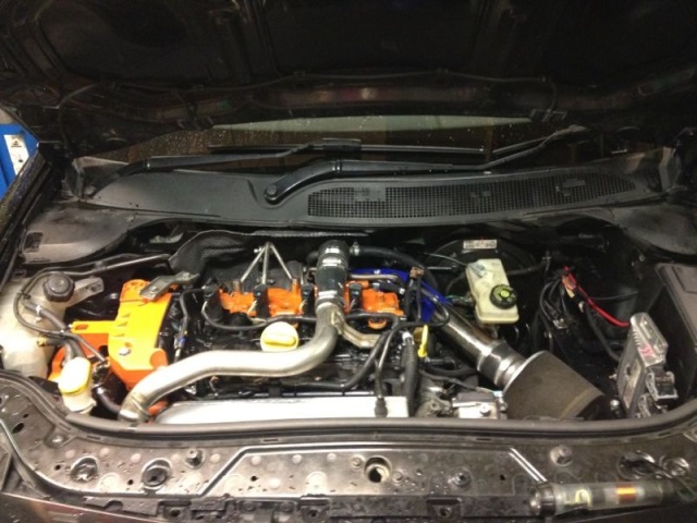

The car then looked like this.

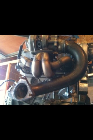

  • Cooksport Exhaust manifold
  • Garrett GT2871R Turbo

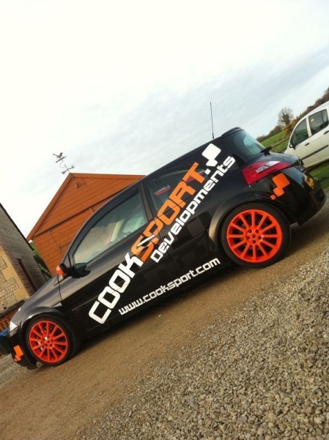

Here are a few more pictures including the Cooksport livery which was fitted for a while.
(sorry about the poor iphone picture)
This is how the car stayed for a good 6 months; it was running approx. 380bhp with similar torque at 1.3 bar. Full boost was by 3500rpm and pulled the whole way to 7800rpm.

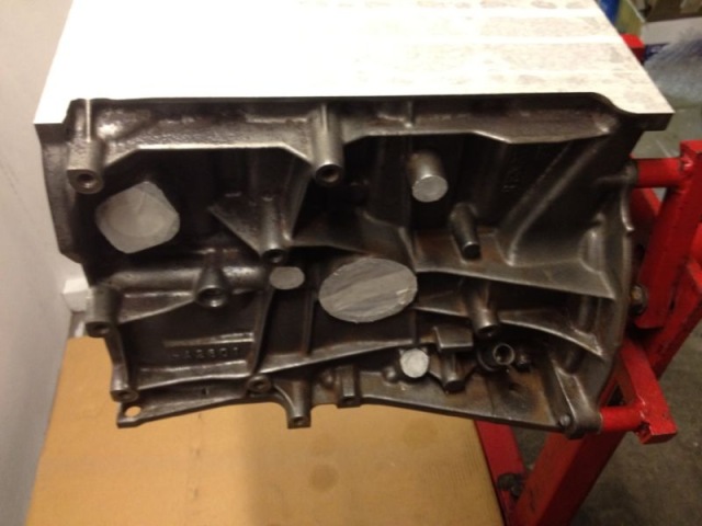

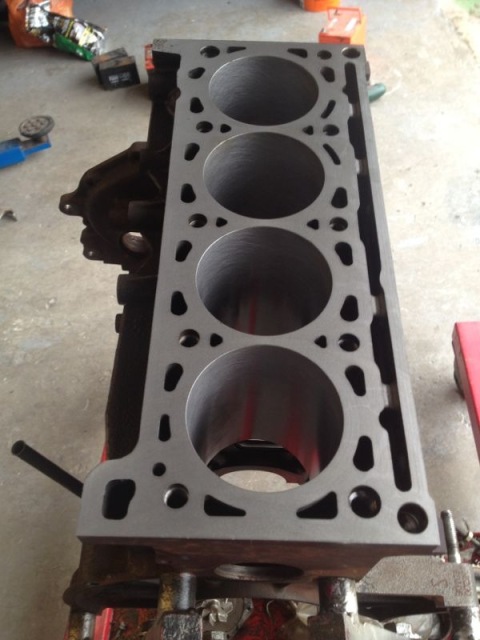

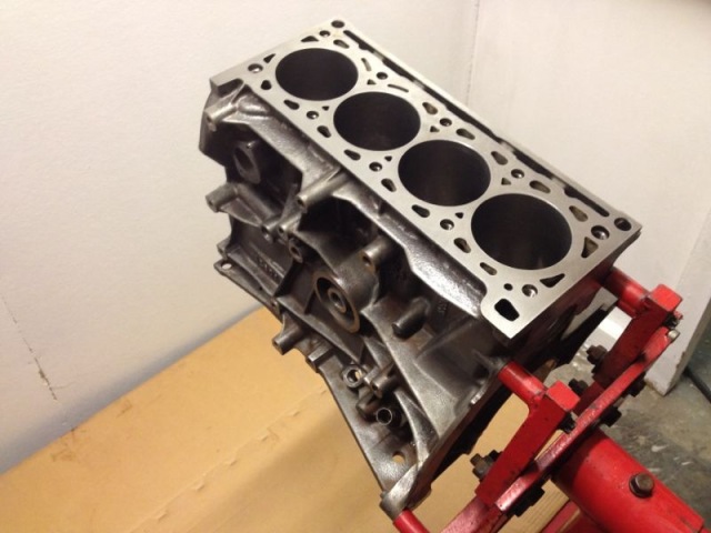

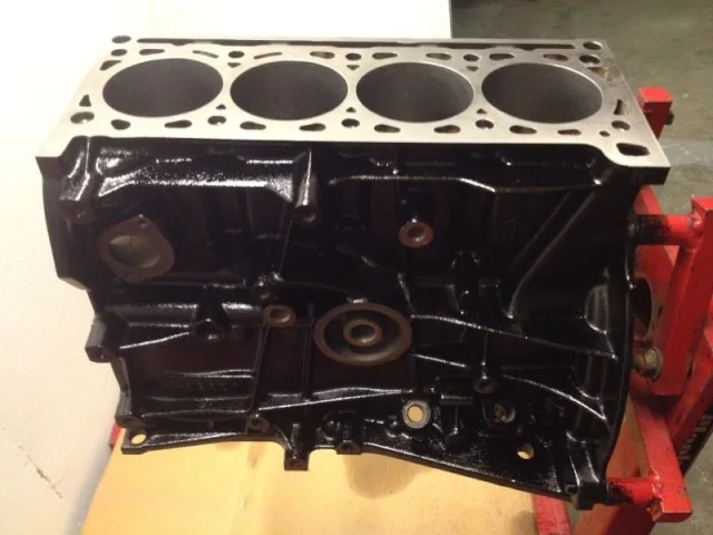

Here is the block, freshly dipped, skimmed bored and honed ready for painting.
Masked up all ready for painting. We are going to be using the standard Cooksport colours of orange and black.
Another angle of the bores and block face.

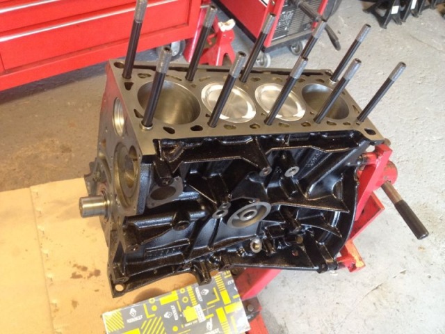

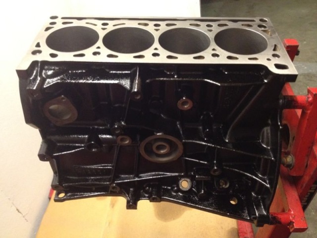

Block all painted and ready for build.

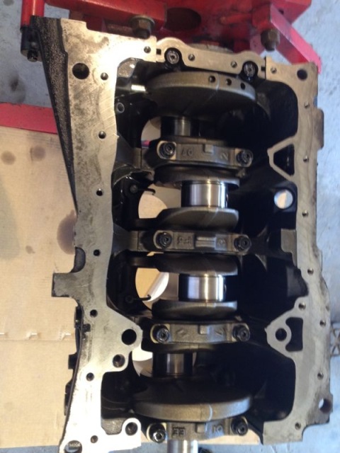

Crank in, with new bearings, thrust washers and ARP stud kit. Bearings plasti-gauged and end float checked.

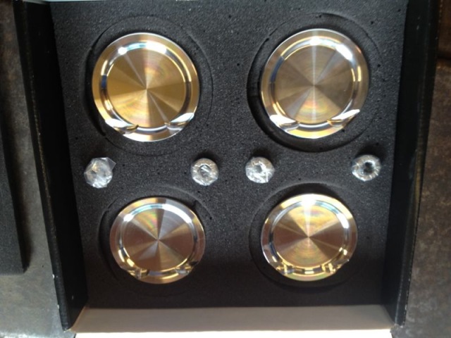

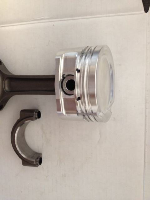

Custom CP pistons :)
Piston and Manley rod connected ready for rings.
Ring gaps done, ACL big ends all plasti-gauged. Bottom end ready for cylinder head.

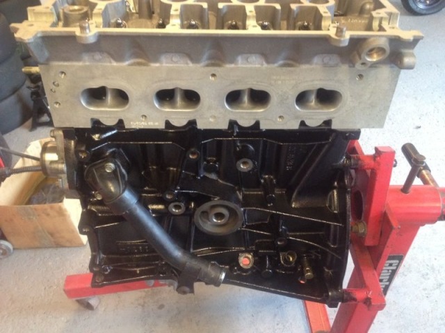

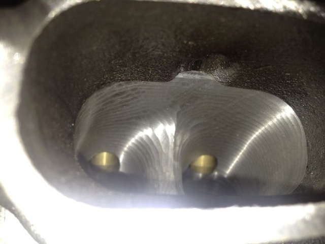

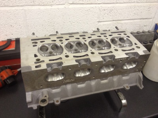

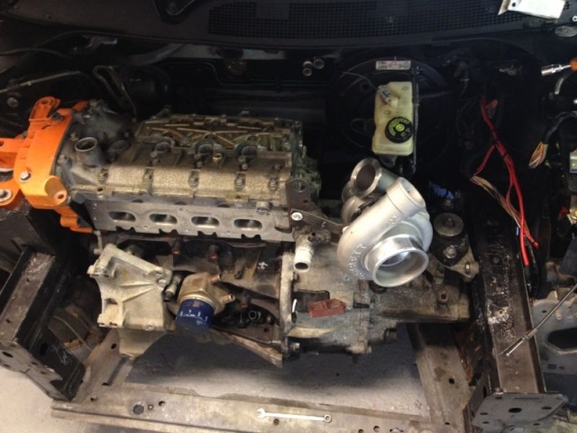

This is a picture of a standard 197 inlet manifold flange against the head. As you can see the injector path is nicely feeding into the side of the cylinder head. When using the standard 197 injectors, this is not an issue as they have an extended nossel past this lip. As we are going to be changing the injectors for high flow replacements without the extended nossel, the head needs modifying.
Cylinder head, acid dipped, skimmed, 3 angle valve seats. This picture shows our modification to the inlet port for the injectors. Valves need lapping and head assembling before fitting.

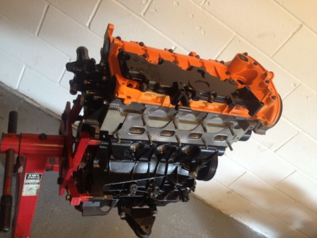

Cylinder head on the block ready for cams etc.

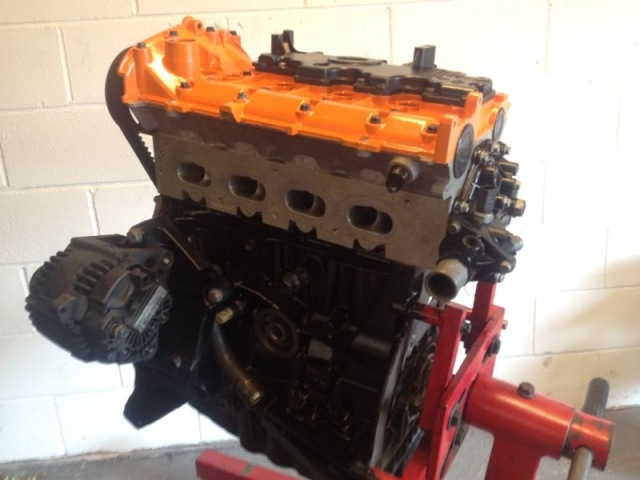

Top end and bare engine all completed. Engine timed up ready to go.
Engine all ready for clutch and gearbox before fitting to the car.
