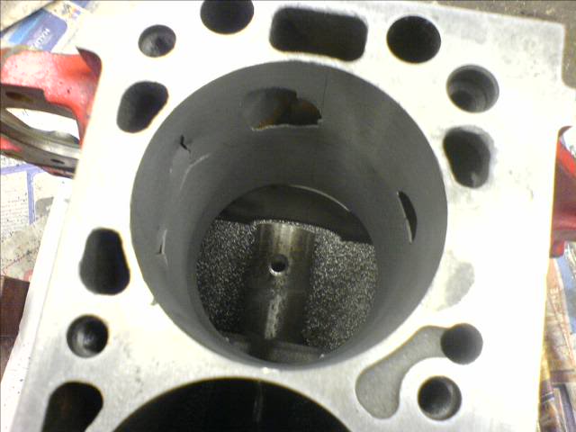

Have you measured the wall thickness or are you just going in blind and hoping for the best?
If I am dealing with a new engine Im not familiar with and looking for big power, what I do is get a spare block and just keep boring it out bigger and bigger till I break through, so that I can see if there are any obvious weak points.
Like so:
As sometimes (a series mini for example) you can end up with a better wall thickness if you offset the bores very slightly as the standard bore location isnt always the optimum one with the casting.

This has been accounted for. Dont worry Chip, we know what we are doing.
Thank you for your concern though :)
