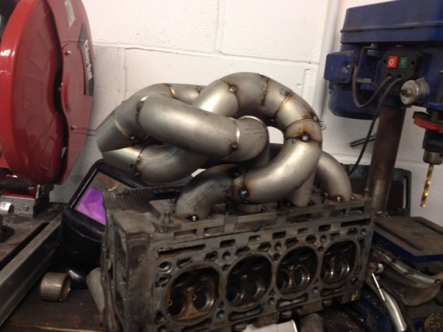

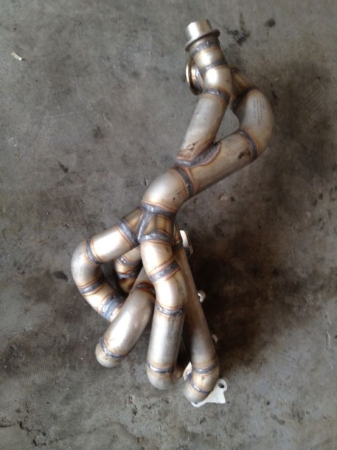

Exhaust manifold manufacturing, first design:

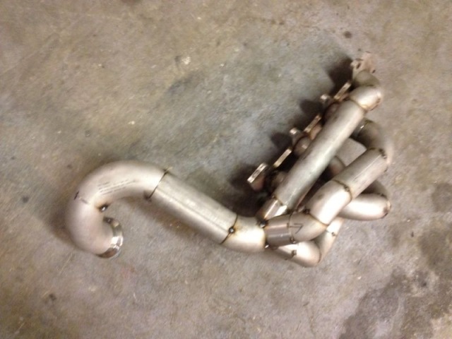

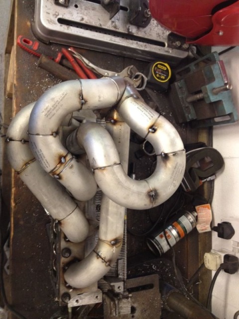

Not happy with the runner lengths, so number 2:
Better, but still not happy (plus number 1 runner fouling on the starter motor)

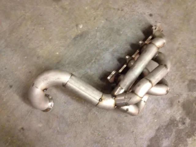

So here is the final layout (before the collector).

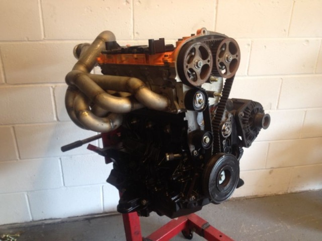

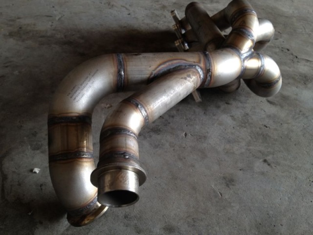

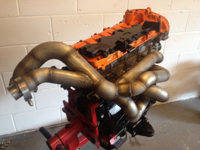

Here is the final manifold, fully back purged.

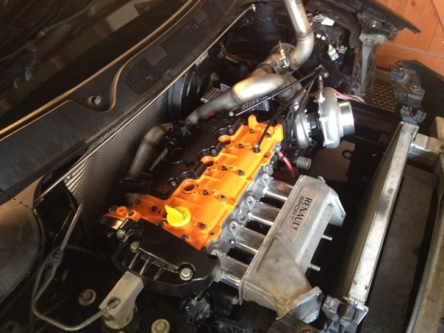

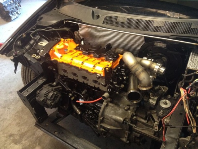

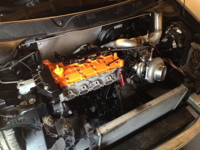

Engine now fitted.
Turbo and Wastegate fitted.

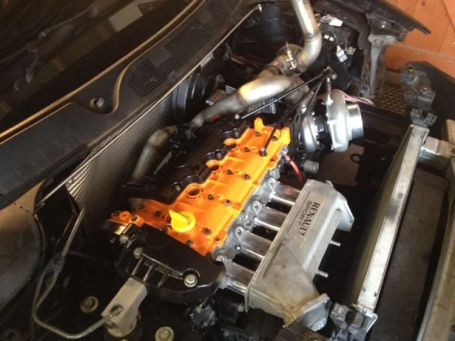

And here is a picture with our mock up inlet manifold :)
It is using the standard 197 inlet head flange and the top of the 197 plenum.
Next is all the plumbing, fuel pumps, coolant system, oil system, exhaust, inlet manifold (completing), fuel rail, boost controller and gauges etc.)
The engine should be running by the end of this week, if all goes well ;).

As you know full well I love this exhaust manifold. ALOT, its a complete work of art. In the flesh it looks even better. Good work
