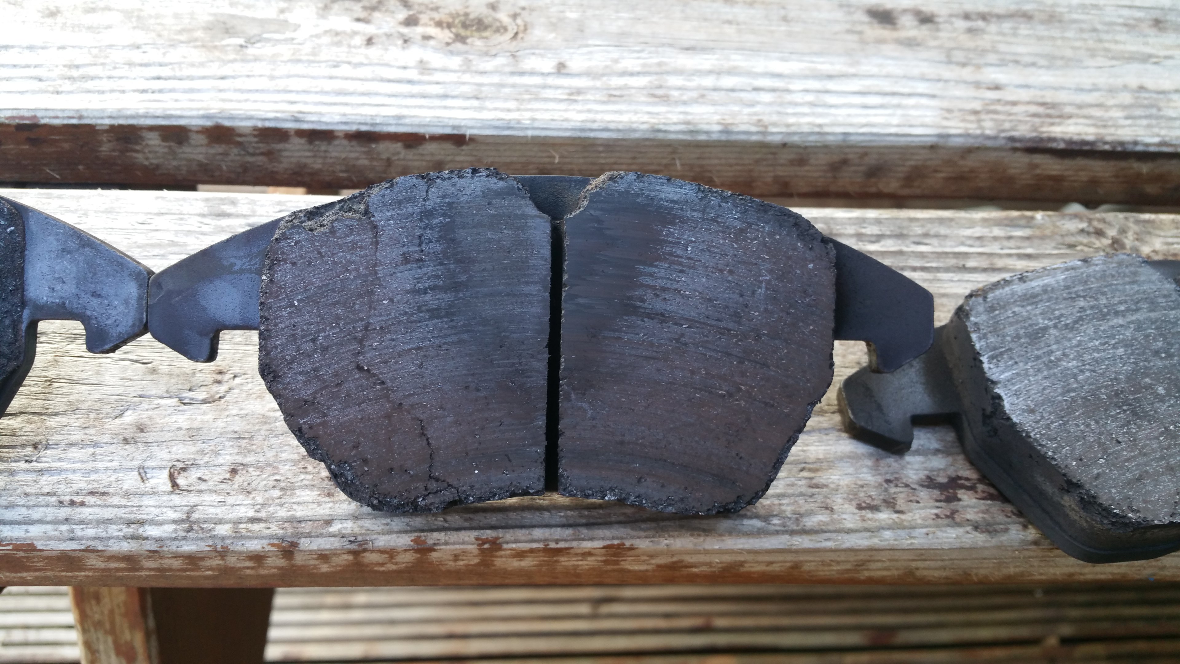

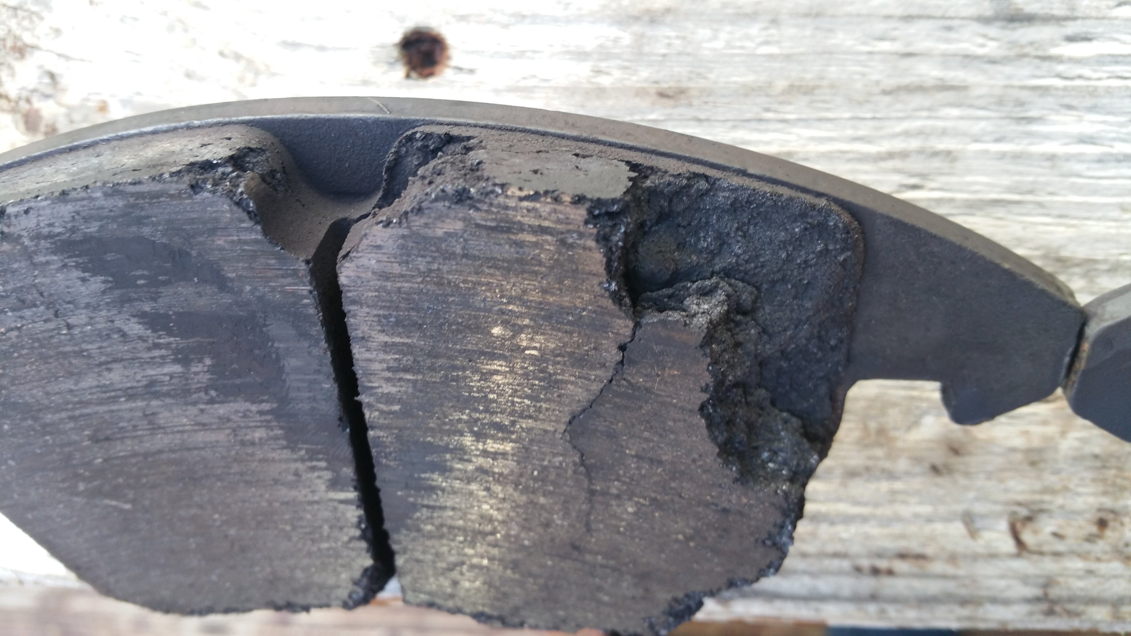

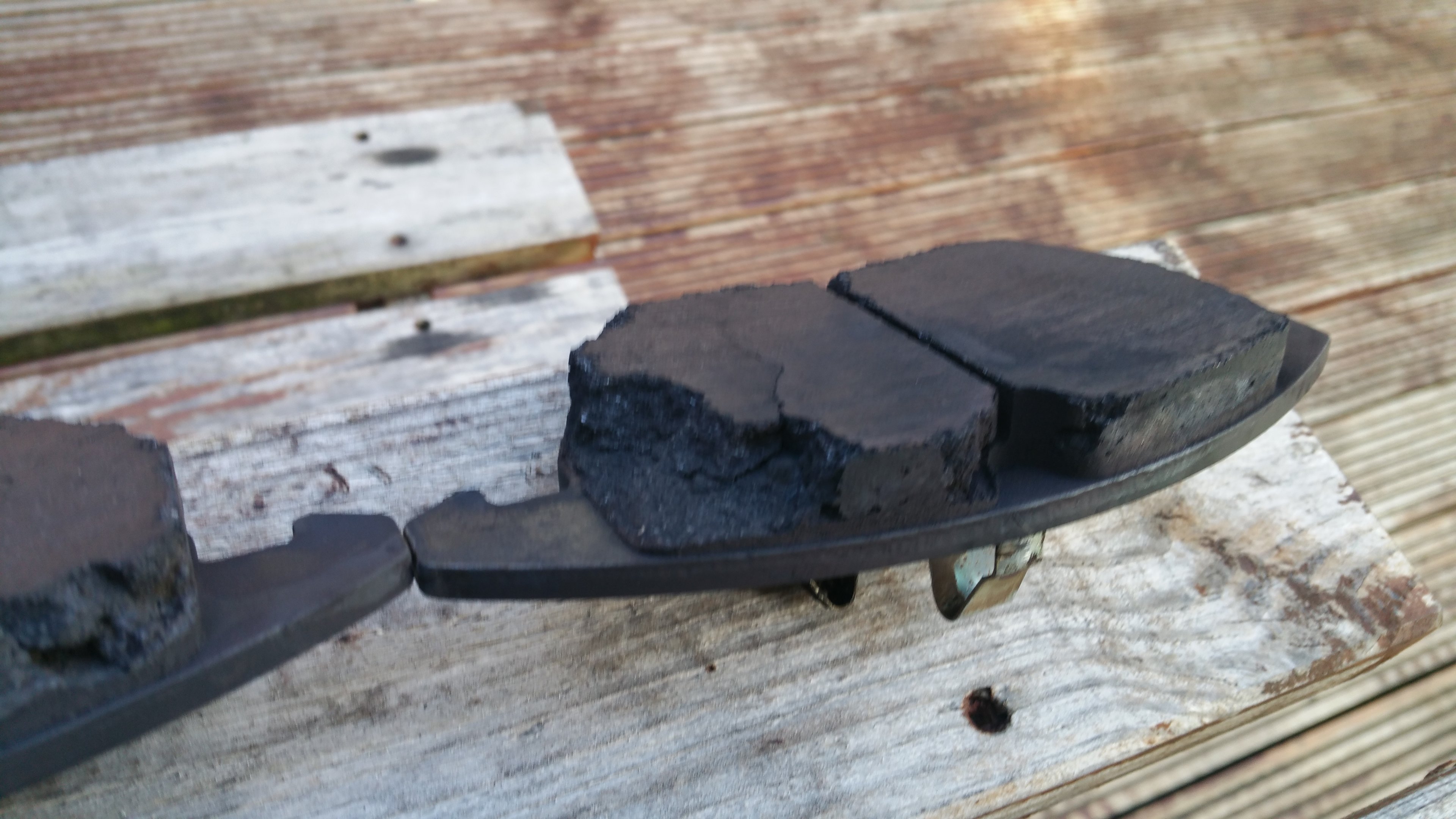

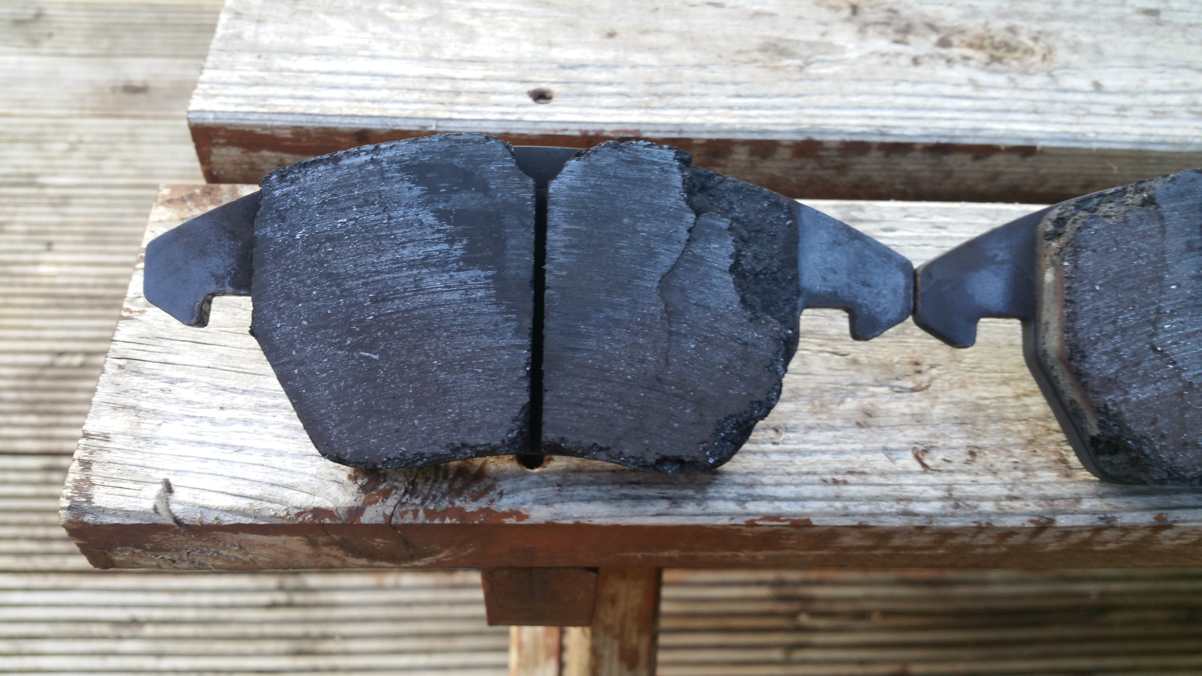

Crumbing Ferodo DS1.11 pads

Ferodo reckon the pad crumbling is normal on the DS1:11 and does not affect braking, so unless severe just send it
