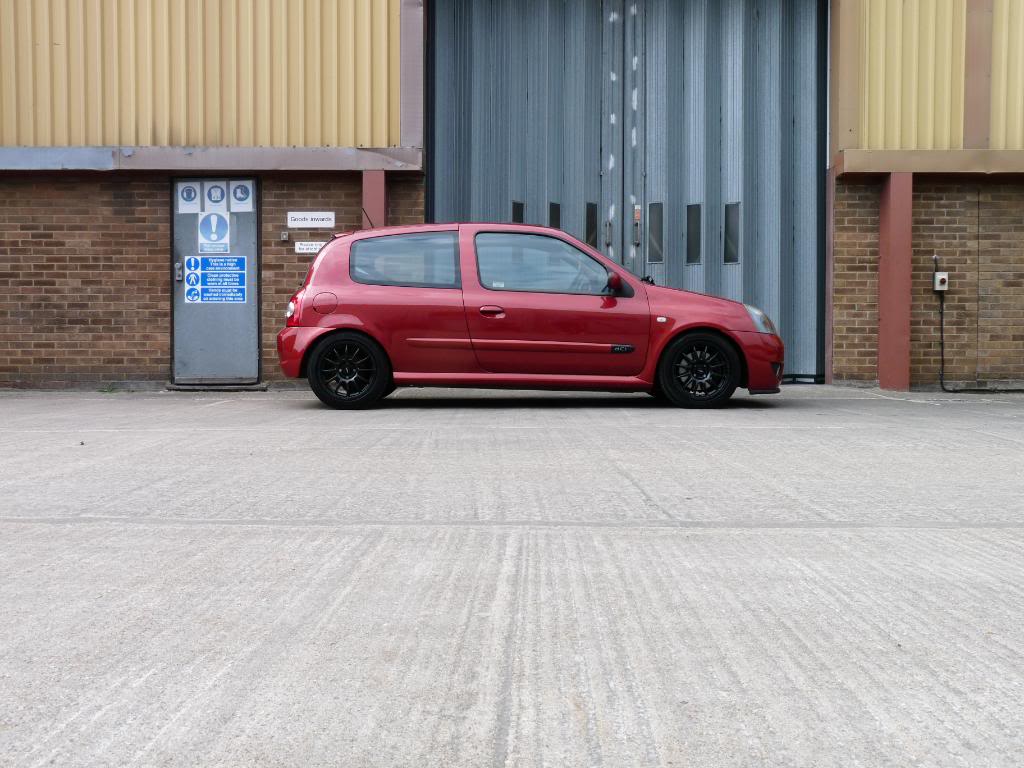

So my next question is, what do I replace the Oz F1s with, either another set of Willys wheels (might be boring as I already have one set), TD 1.2's as per;

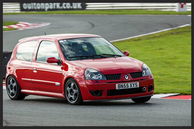

Or TD Pro Race 3's (hope @aucky doesn't mind me stealing a photo of his)
Votes please!
What offset are the willy wheels?
They are originals, I'm afraid I don't know offset 😌 I'm sure someone will be along soon!

Willys are et35 iirc.

Pro race 3 have more calliper clearance than 1.2s. At least it seems so from looking at Auckys wheels on the oulton track day.
