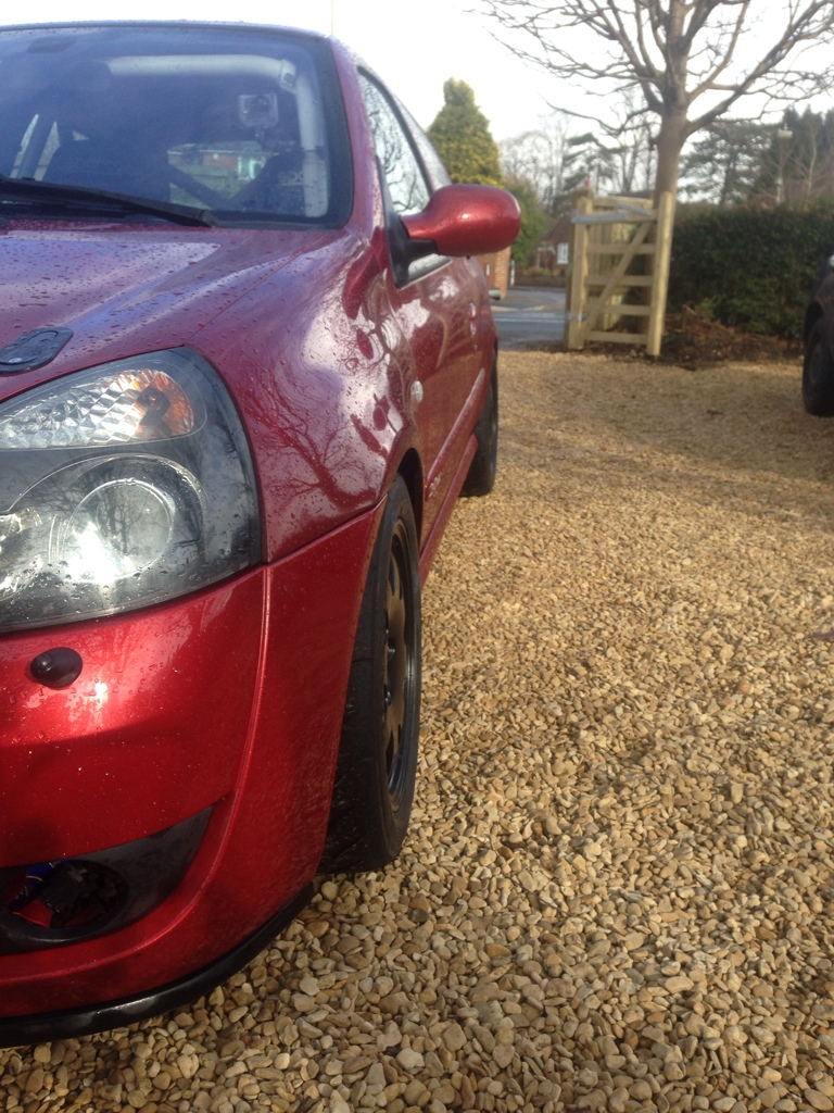

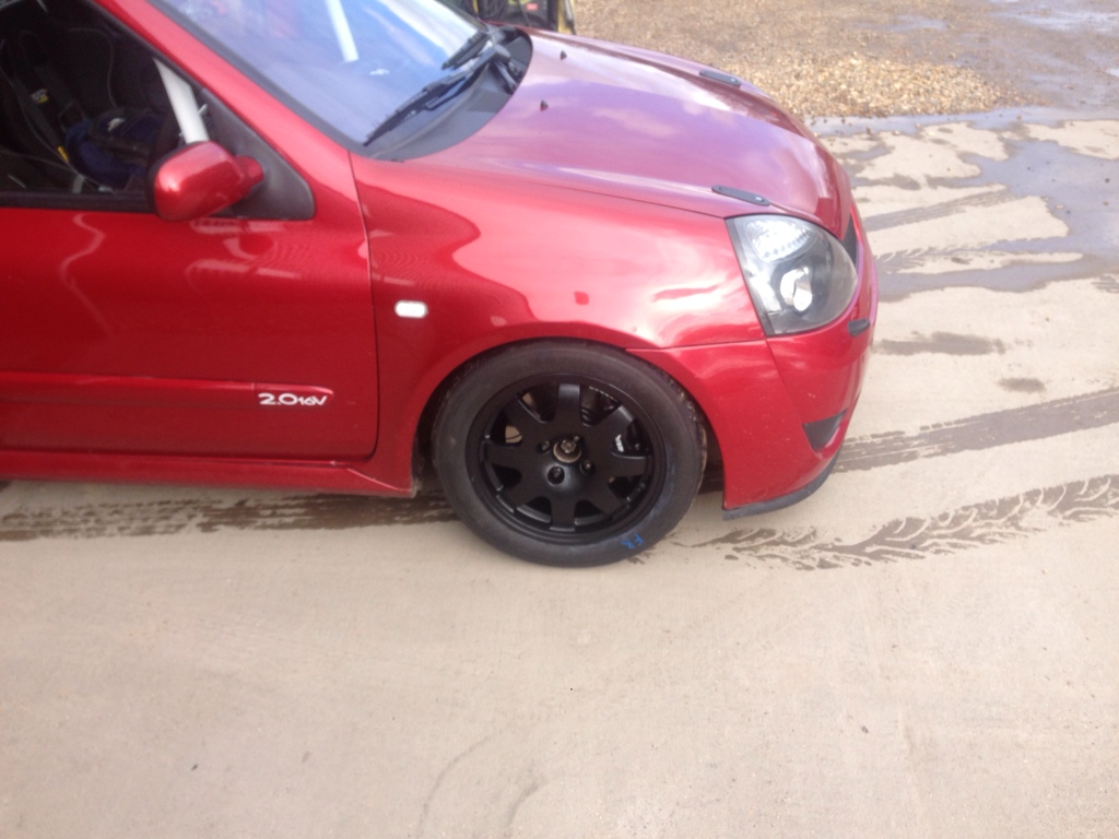

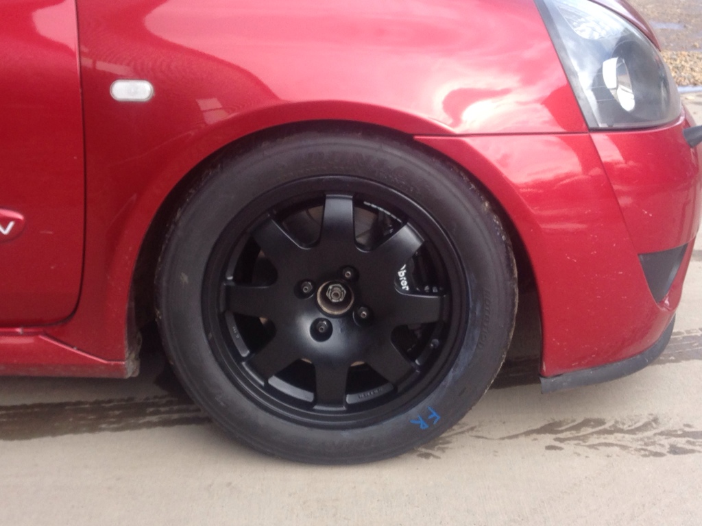

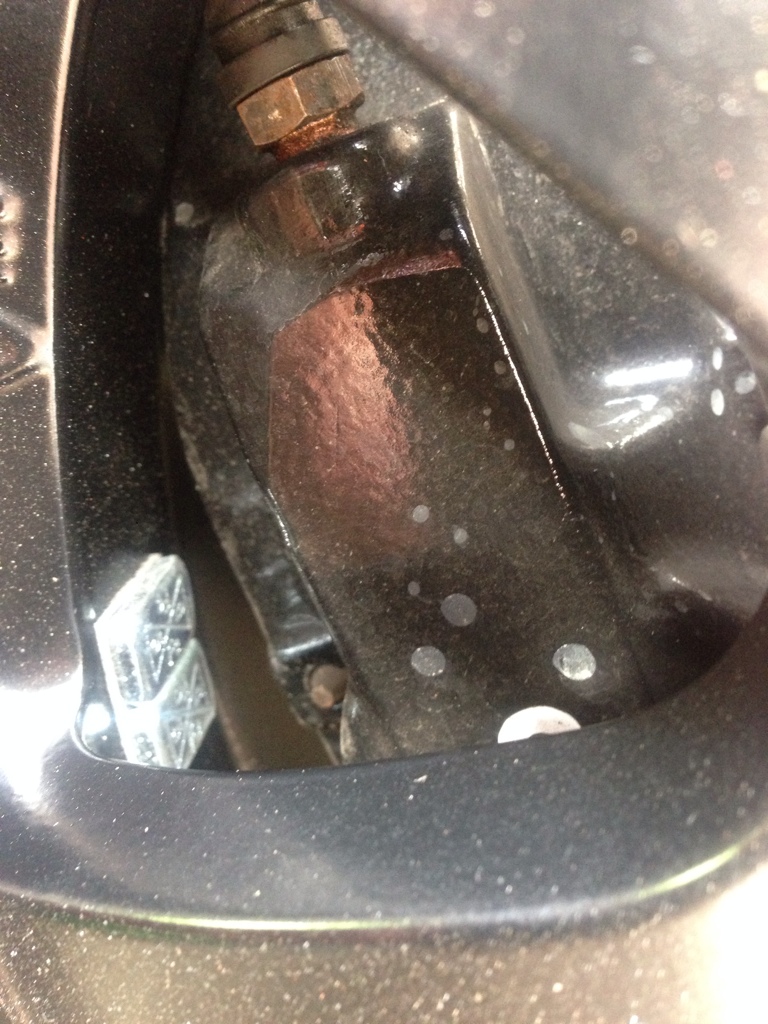

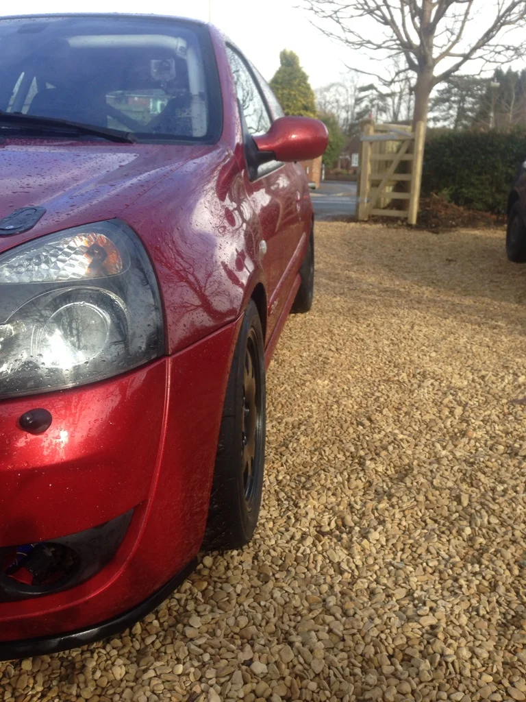

Final bit of work done ready for Bedford. Got my powdercoated Willys wheels back with the Direzzas fitted, then faffed about with the spacers / caliper & wheel weight clearance / arch clearance at the front.
Had to chop some of the inner arch out at the front! Lol!
Got there though;
Cub.

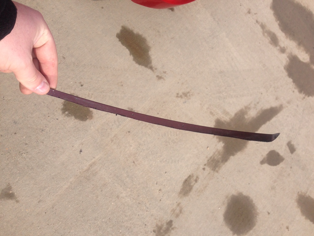

The bit chopped out of the arches both sides...
Sadly the brake ducts won't fit around the boost pipe on the right hand side. So they'll need some modification fit. I'll run Bedford without them, see what the cooling is like. Then fit them modified if needed, or sell them on if not needed.

Wheels look good, you don't have much clearance on them calipers.

The clearance is minimal. Completely minimal. Going to be interesting see how they fair at Bedford!

Given you have recently bought the brake upgrade and are in the loop as such, I'm guessing nobody has managed to fit the Brembo's under a 15" wheel with no spacers on 280mm (or bigger) discs?

Cheers Morgan. And yep, without spacers, I can't find a single 15" wheel that will go over the Brembos.
Mine has cup wishbones, and when I fit the roll centre kit from @NorthloopCup I'll get even more width, so will need to do as much as I can to keep the wheels from scrubbing. I may need to go to 195's annoyingly. Or get stiffer springs now the car will only really see a track. Will see.

Stiffer springs mate. You can buy my ast's when I split the cup. Lol! You'll need 450lb up front minimum.

Yeah when I first fitted this kit around 2 years ago I tried several wheels and realised I was never going to get a 15" wheel to fit and have a half decent offset so I scrapped the idea and started to run them on my track car which had 16" wheels, your options increase greatly then.
I was told at the time that this and that 15" wheel would fit when actually it turns out, just like I proved at the time yet had people butting heads with me that it's just not easy.... Just a bit of a rant from me really. I hope you do find something to suit as i'll copy quickly but to me the only option is to go custom bells and rotors sadly.

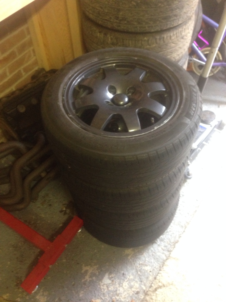

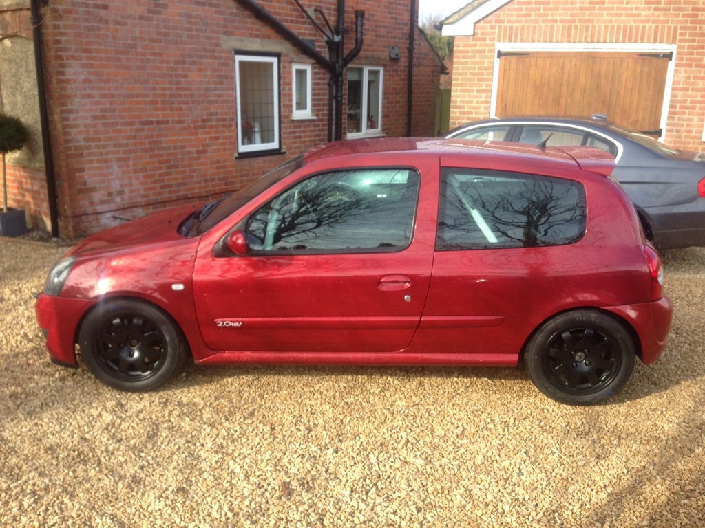

Bought another set of the willy wheels;
They currently have ditch finders on, so they are going to be replaced with some Yoko AD08Rs.
Question is, what colour? Black like the others, or gold or grey or silver?
Votes please, and photoshops if anyone is kind enough. Can use the photos of the black ones above. @SharkyUK :smile:
