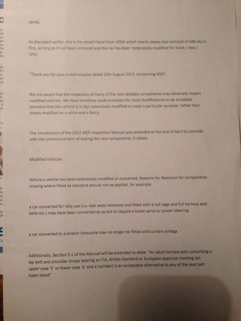

Flameshed passed it's MOT today. :smile:
An advisory to tell me it has no ABS (thanks for that, I didn't know. Honest) and them struggling with the brake imbalance with the Brembos. Boom.
So, ready when you are @Diesel Davis :smile:
Tell them to go f**k themselves regards the brake imbalance mate. There's no such thing in this case as the imbalance will be caused by the diff!!!! They need to do a tapley test on the road to make sure the brakes pull the car up straight.
If you could copy it that would be great. Mines just gone through the MOT under the competition car dispensation (cage, buckets, no airbags etc.) anyway.
Cheers!

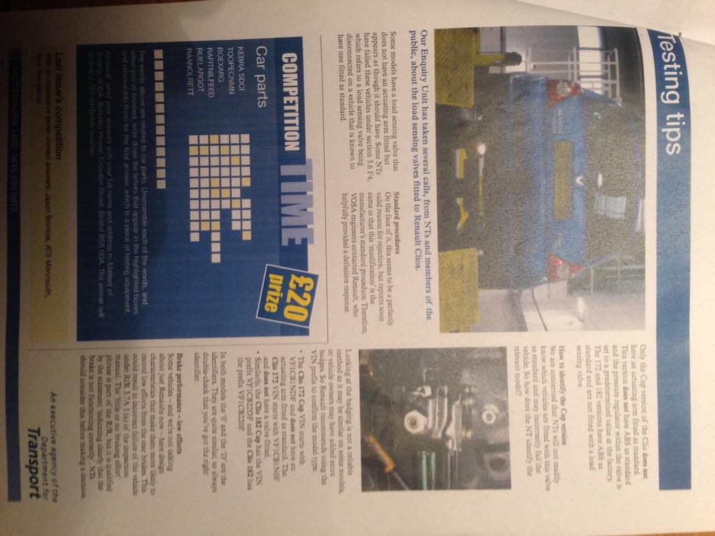

Not sure how clear it is, but here you go. I removed the ABS (referenced in the email) and swapped to a cup system. At first the MOT station didn't like the braking, but that is a known cup problem, so I also printed the VOSA test note Issue 31, which highlights the cup brake issue. Armed with these mine has passed it's MOT twice with no problems at "strict" MOT stations.
Hope that helps :)

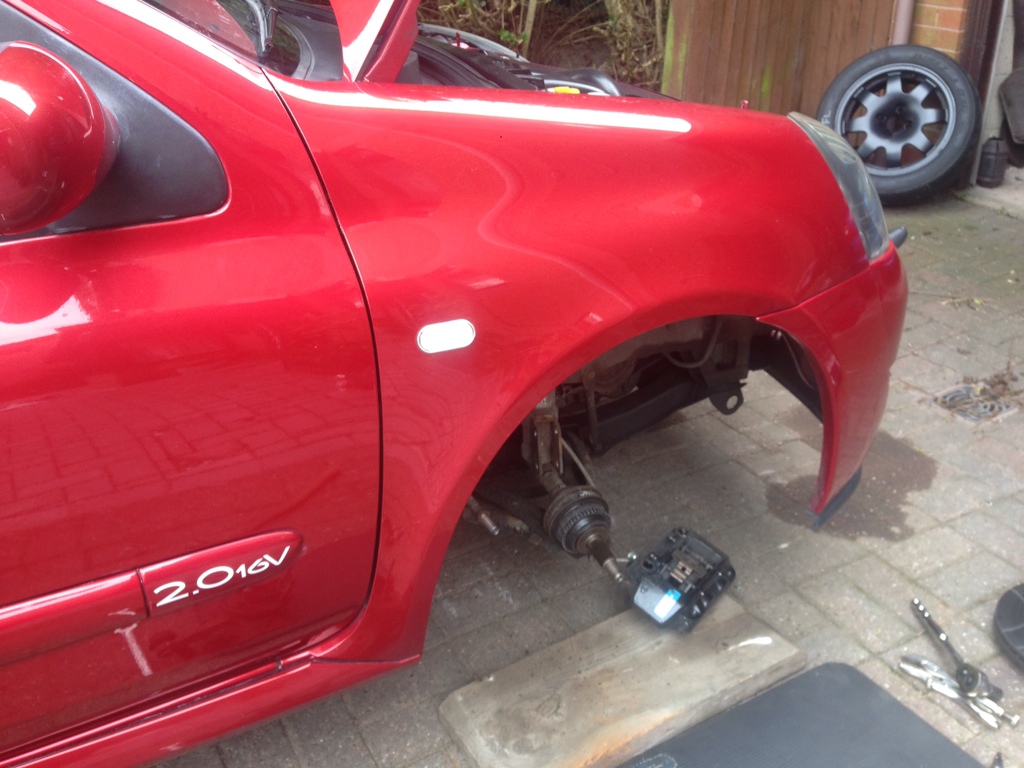

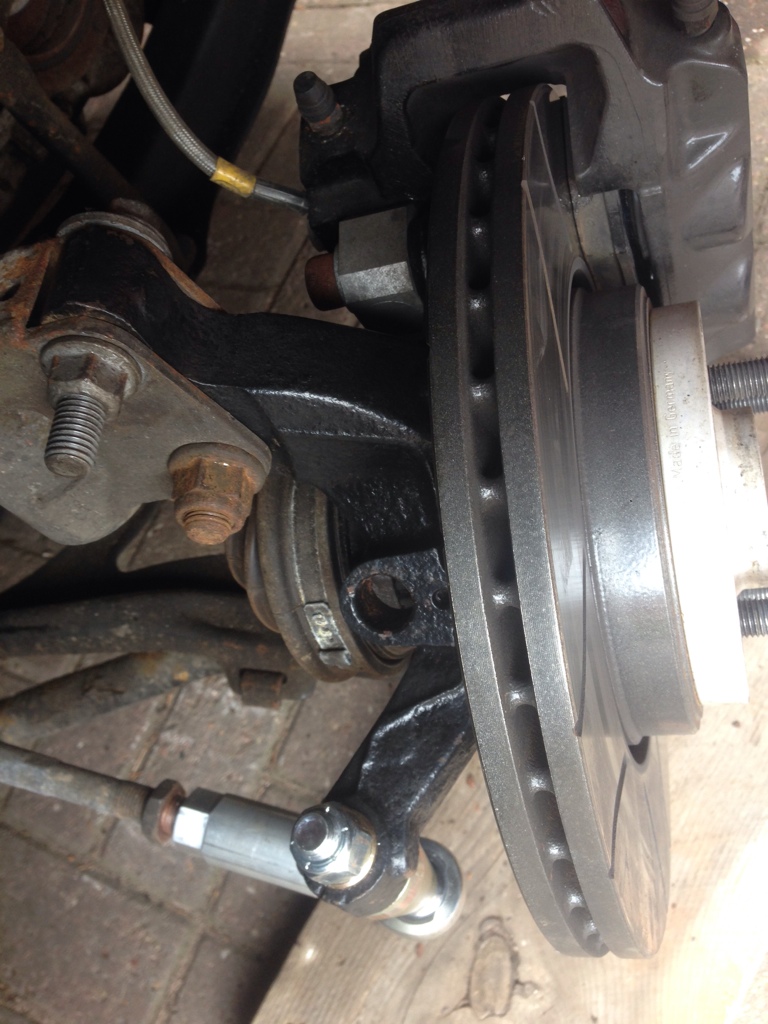

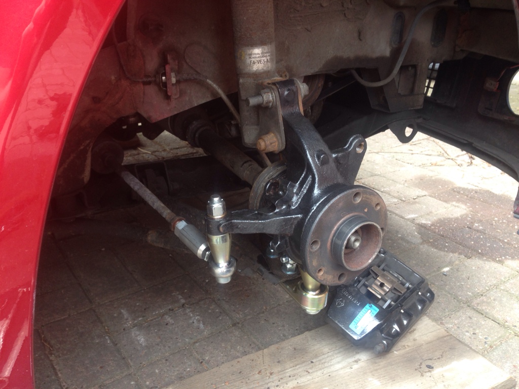

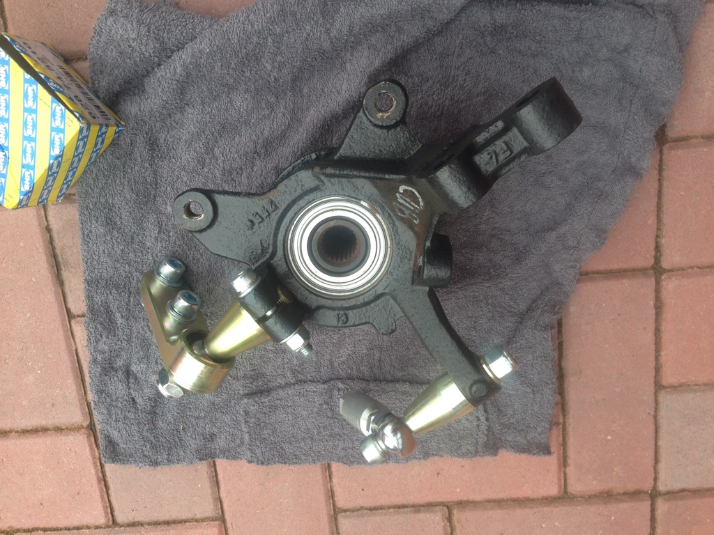

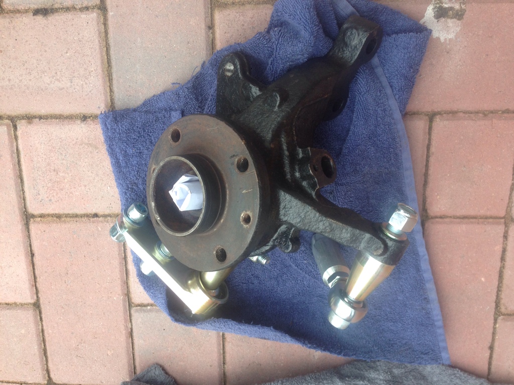

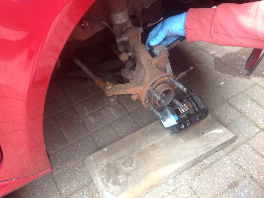

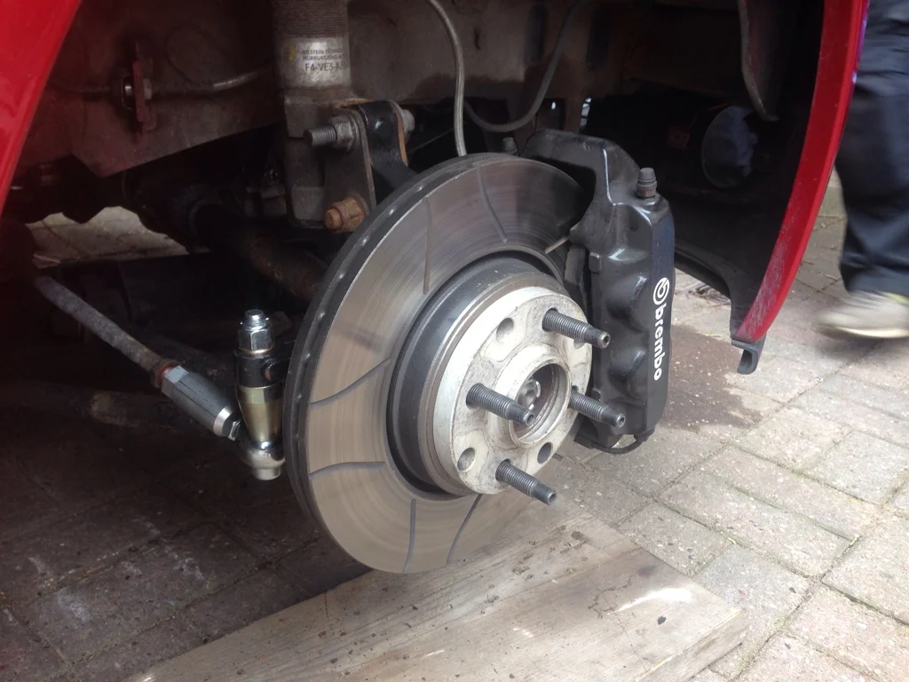

Off to @NorthloopCup at TMR HQ for the roll centre kit. Brilliant bit of kit, and the man himself is a little, dwarfish legend. Thanks for your hospitality bud, and all the help. Massively appreciated :smile:
On the way home it was great, handles much better. With the extra 5mm on each side, and the 16mm spacers to clear the Brembos, I need to sort stiffer suspension to reduce rubbing.
Plan is AST II's, with 475 lb ft at the front and 450 lb ft at the back. Stiff!! But, the clio is becoming more and more track focused so I don't mind.
Billies have been epic, and are brilliant for a road / track car. They will be up for sale once the AST's are ordered.
Some photos.

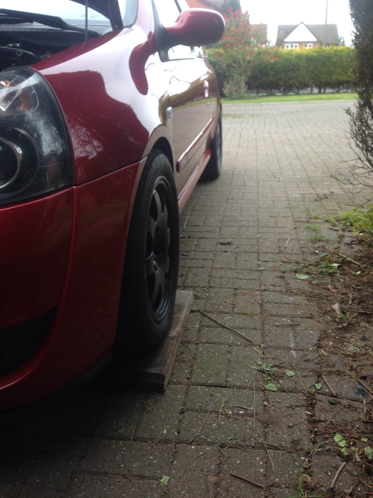

Old;
New

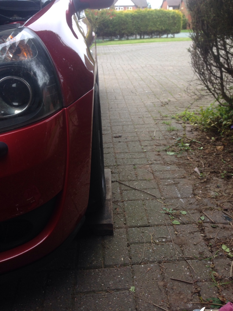

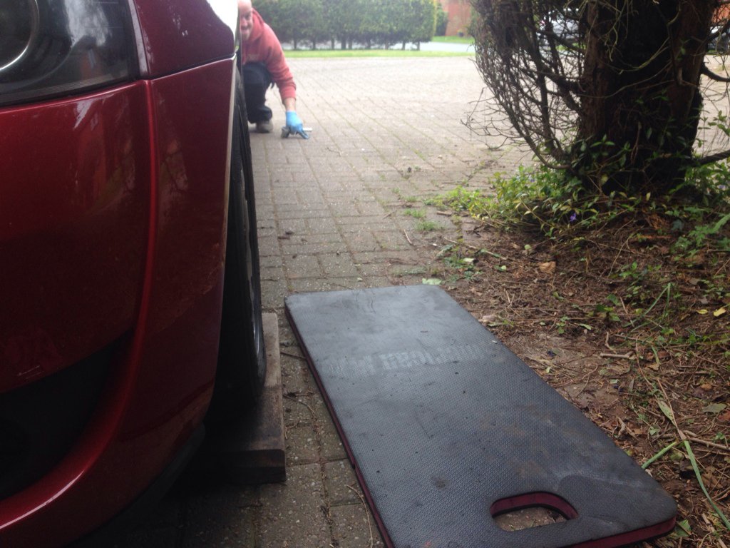

Then faffing about with camber, toe, tracking and alignment. Mark loves this car.

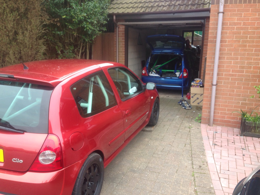

Kermit and the flameshed;

How good are the new hubs?! It's unbelievable what you can do on roundabouts with them fitted. Need to get back to a track now to test them properly.

The RC kit is brilliant. Up there with the diff in terms of effect on handling I suspect, but I need to get it on track to really exploit it but it made it much nicer to drive yesterday. Lots more feedback.
