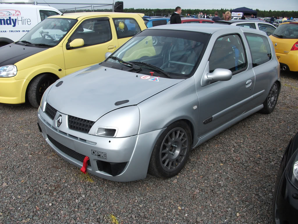

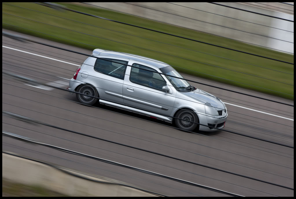

so after not updating for ages i finally got the car ready for FCS and had abit of track time but had a few problems which are all now sorted. just got to do a full spanner check then will be booking up another track day. anyway heres a couple of pics of the final product after pretty much 3 years.

Ah so that was yours Lee, was wondering in most photos. Looks superb :)
  Qashcow
ah i saw you driving in and out lots all day (was with TDF/Burpspeed/Ph-reebone stand), hadnt realised it was yourself.
very very nice looking car, i feel one day i'll own a cup racer of my own!
  Disco 3 &4 1993 mini
Yours looked great Lee - went to France didnt it? I still have the headlight duct from yours, at least some of it is still in the UK :smile:
Yes it did, it went to a racing school i think so i hate to think what state its in now.
