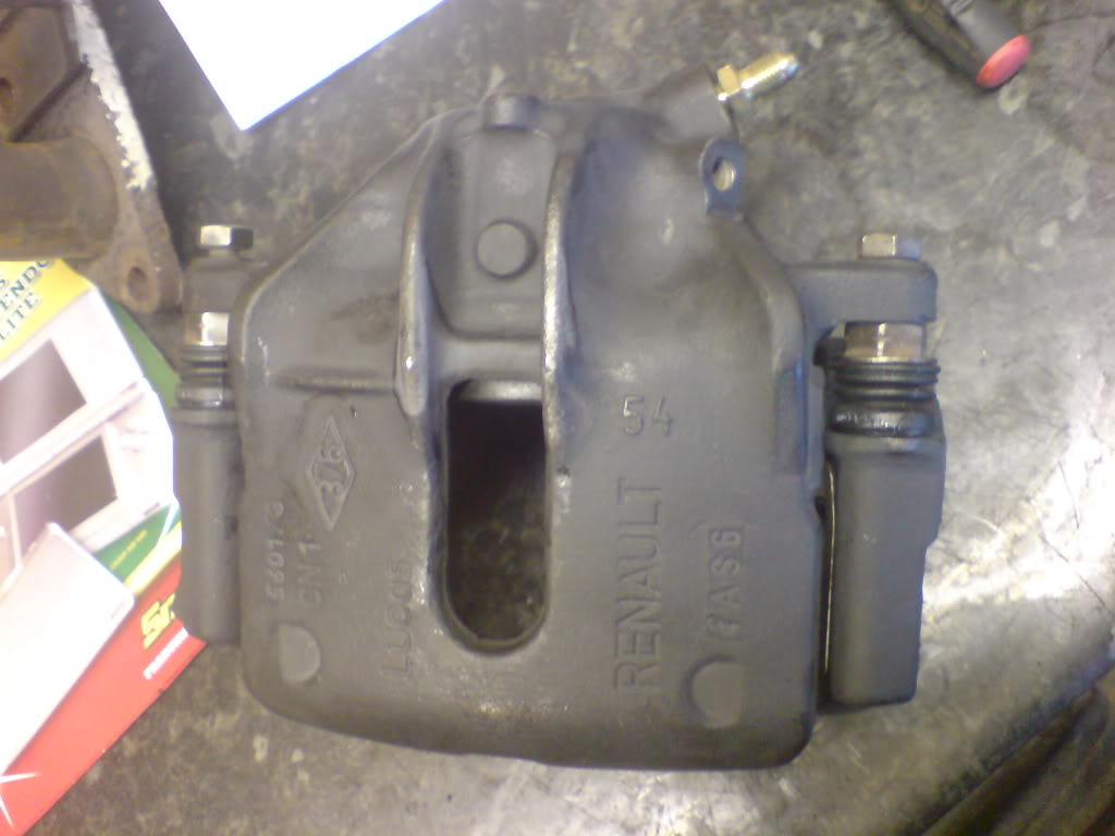

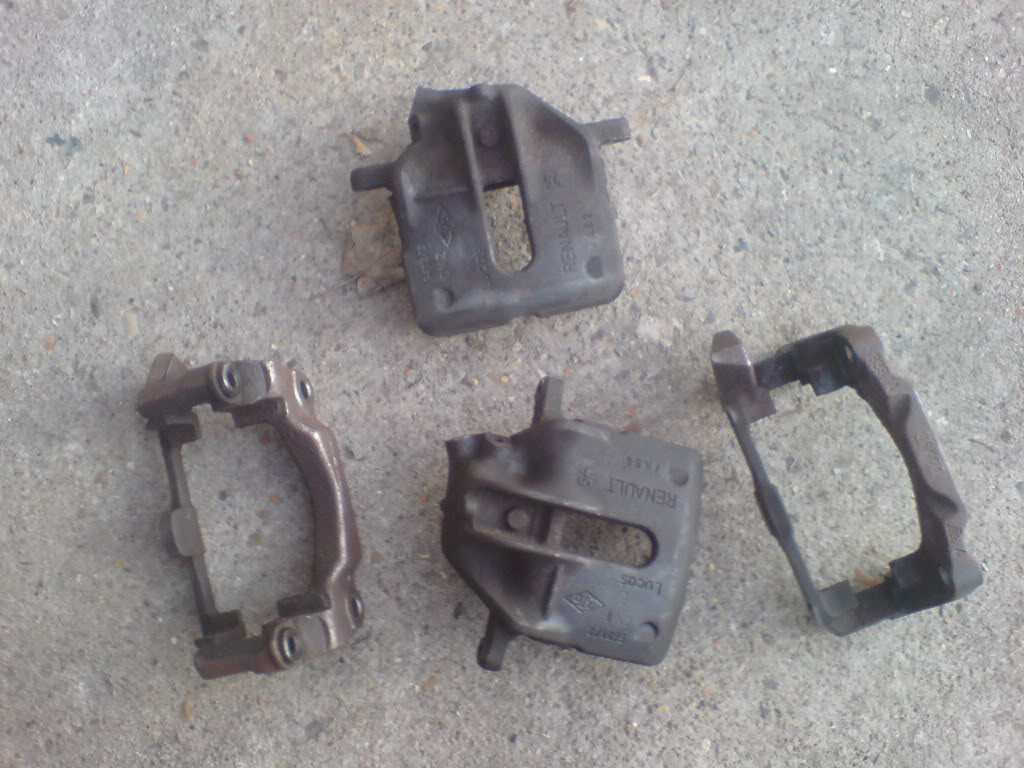

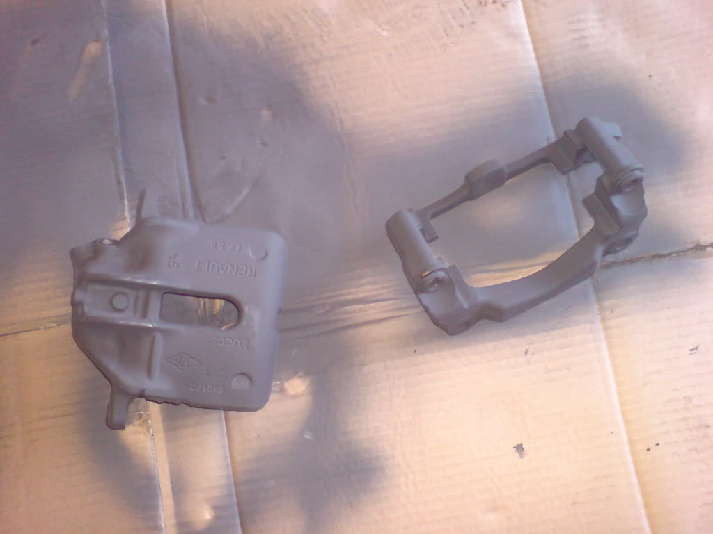

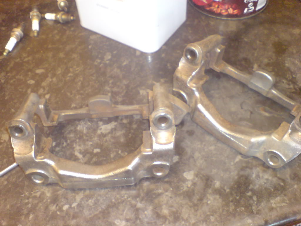

right didnt do too much today but got a little update. id remembered id got a pair of rebuild kits for the front calipers. so i set about taking them apart
and oafter a bit of wire wheeling they looked like this
i had some paint left over so gave them a quick coat

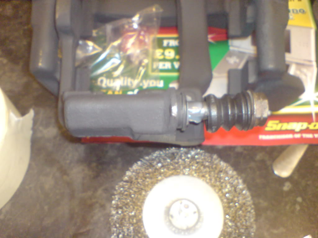

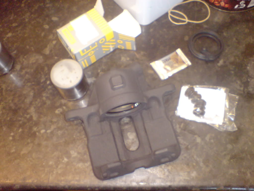

so i set about rebuilding them

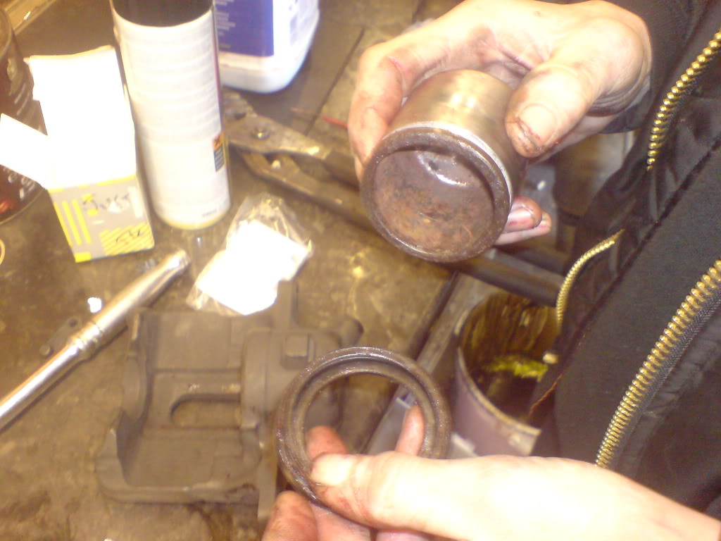

i wire wheeled the sliders put new grease and boots on
cleaned up the pistons and put new grease on and slid them back into the caliper
and the finished article

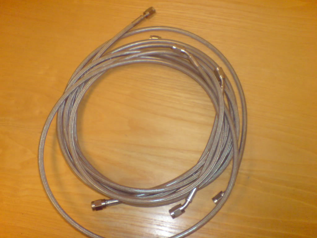

i also got some brake lines made up by Matt and Think Automotive 02085681172
he did an awesome job, really good quality.

they full length flexable brake lines? to run inside the car?
Are these a copy of the bits you took off or have you measured etc?

yea they are full length flexable hoses to run through the car with a bias controller inline. when i got the car there were no brake lines at all so ive measured the required length and had them made up to that length.
I always prefer as much solid line as possible due to improved feel over lots of braided. Braided is much tougher than rubber brake hose but still has some give and over a long enough run its sufficent to feel.
The original Noble M12's were braided throughout the entire brake system and we got very good results in terms of brake feel by changing the vast majority of it for old school copper.

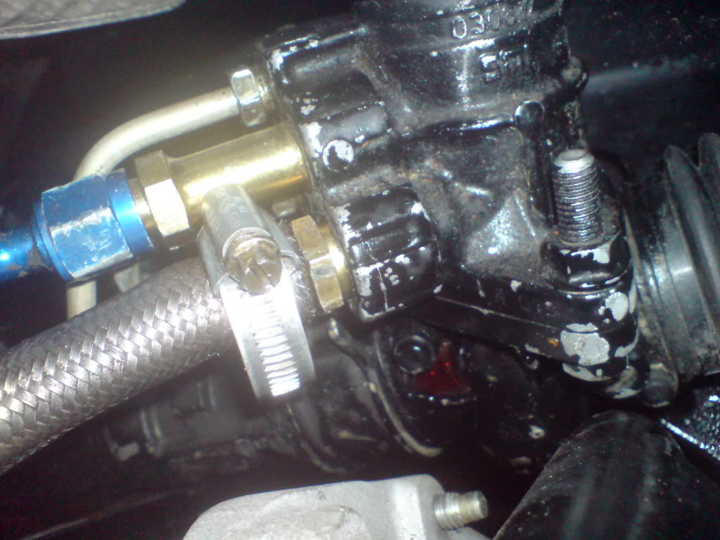

didnt do much today as was working but realised i had a power steering leak.
found out that there is a big crack at the top where the pipes connect so that means a i need a new steering rack hopefully supplied by the team i do some work for.

here a few pics for you in case your interested, the bottom one shows the offeneding crack in the steering rack.

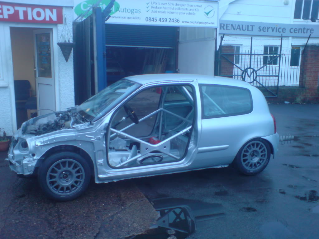

she is low at the back...
that car is licking the tar
thats roughly the ride height it will run at, theyll prob be a few adjustments when i corner weight it

thats the way id want my clio ride height at the back, what size of wheels are they? and what size of drop? thanks
LeeP86
  Disco 3 &4 1993 mini
Re: clio cup race car project!
they are 15inch wheels and i have no idea about the drop mate sorry

bit low at the back lol

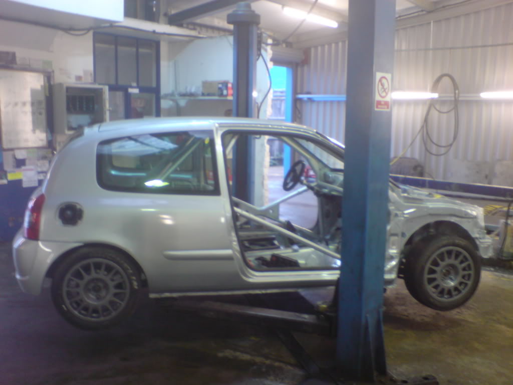

you can see how little the wheel has dropped when the car is in the air.
