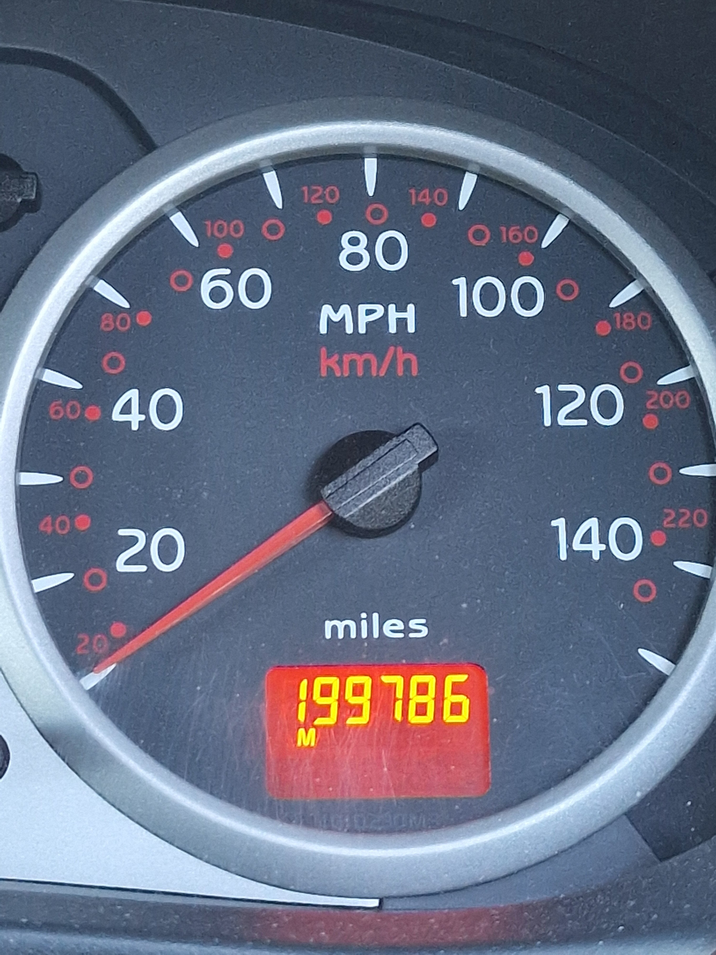

Blue dci running great. Has not missed a beat and around 198,500 miles now as had a few site visits at work.

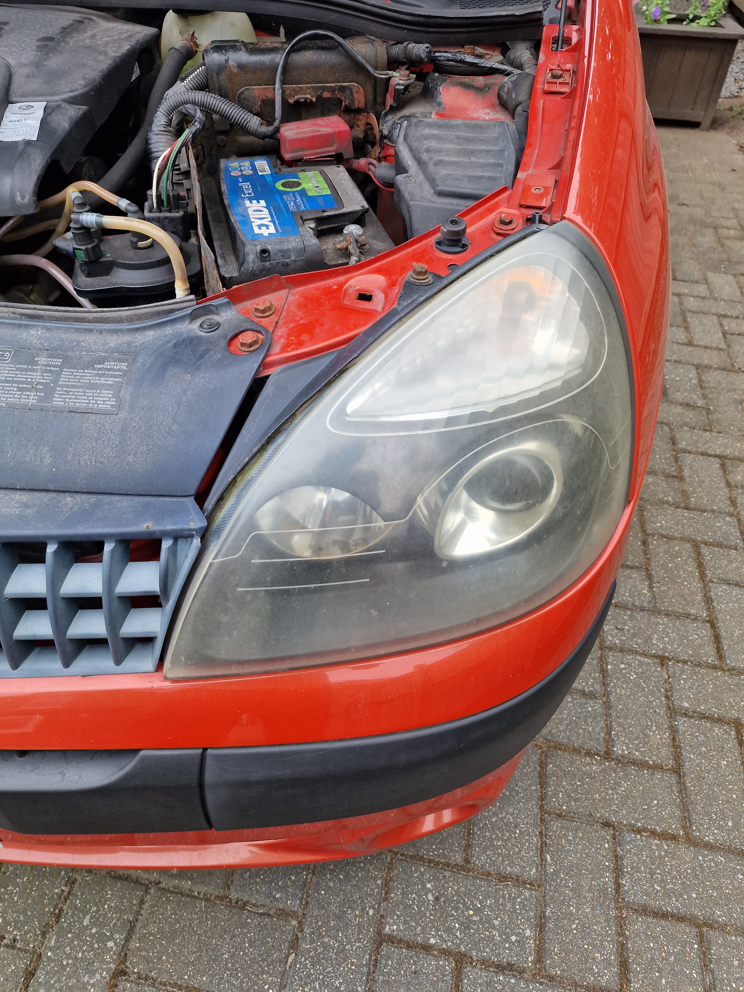

When i repaired the xenons on the blue clio, i stripped the ns light down, and whilst it was apart i cleaned the dome of the xenon projector. It was covered in filth and looked milky like a cateract and simply needed a wipe over revealing a really clear projector, simple job as headlamp front was off. I didnt do the drivers side as i couldnt be bothered splitting the light and in use the light output was s**t in comparison, and quite obvious when driving at night.
Had a spare hour yesterday so whipped headlamp out to see if it was possible to remove the xenon dome without splitting the headlamp. Its not possible to remove it fully as access hole is too small, but i managed to rotate it 180 to be able to clean the front and the back of the projector..check out the filth causing crap light output and pattern and the clear projector where i rubbed the dirt.
Filthy.
Forgot to take a pic of it before refitting but its same as passenger side now and looks really clear/great light output. Highly recommended if your xenons are not great at night.
Cateract gone.

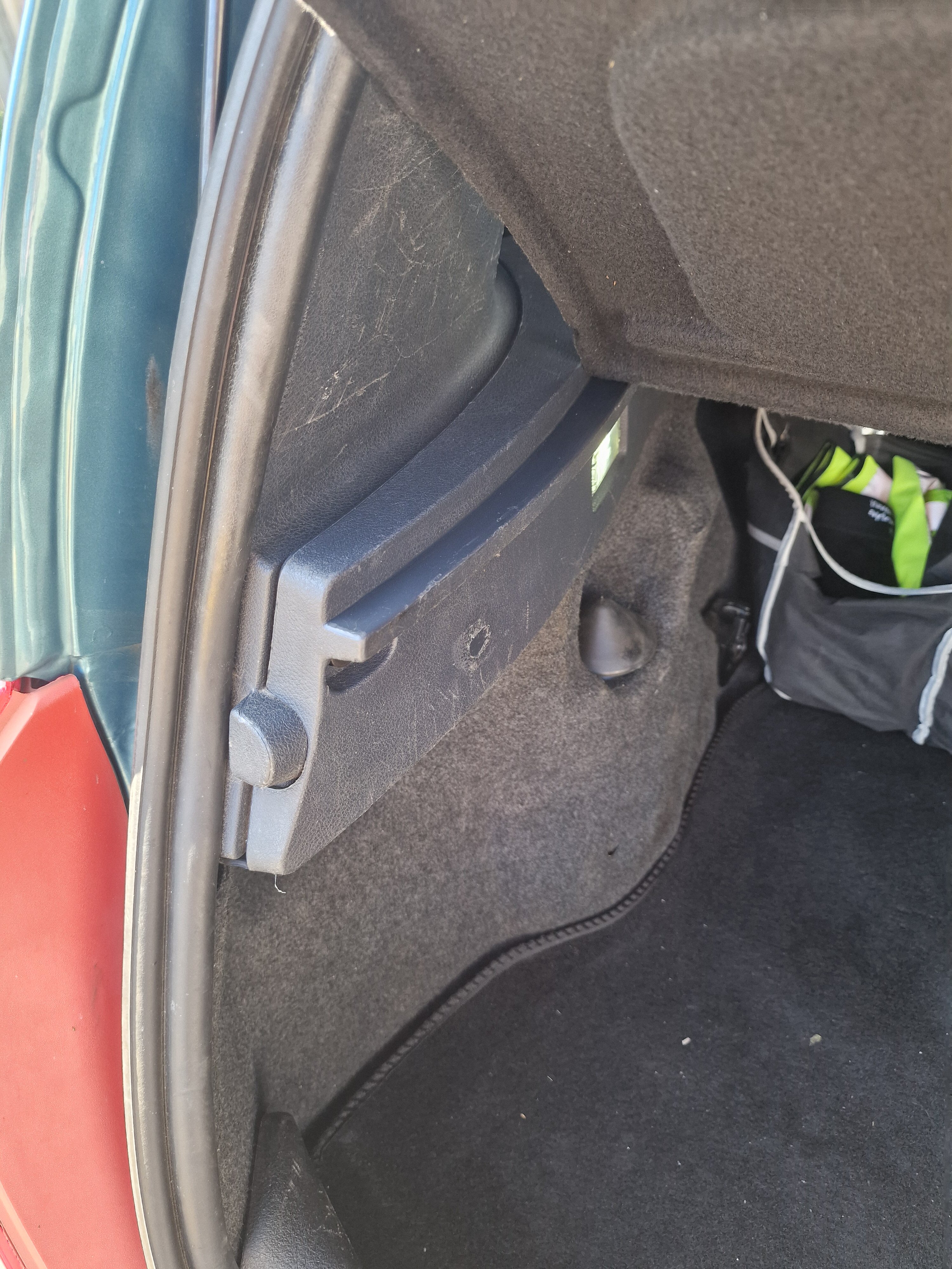

Boot lock solenoid failed to commence on the orange dci. After several replacements in the past its a ten min job to swap.
Trim off.
Offending locking solenoid, one torx screw and out
When it failed last time i bought a chinese spec solenoid off ebay. Fitted that and remembered why i did not use it as the motor makes an awful noise. Looked at original to see if i could repair, and the gears were jammed as a rubber part had deteriorated stopping the mech from moving. Cleaned the rubber and old grease out, bit of silicone grease and working fine again.
Chinese spec top, oem bottom
With repair, working as intended again in 20 mins.

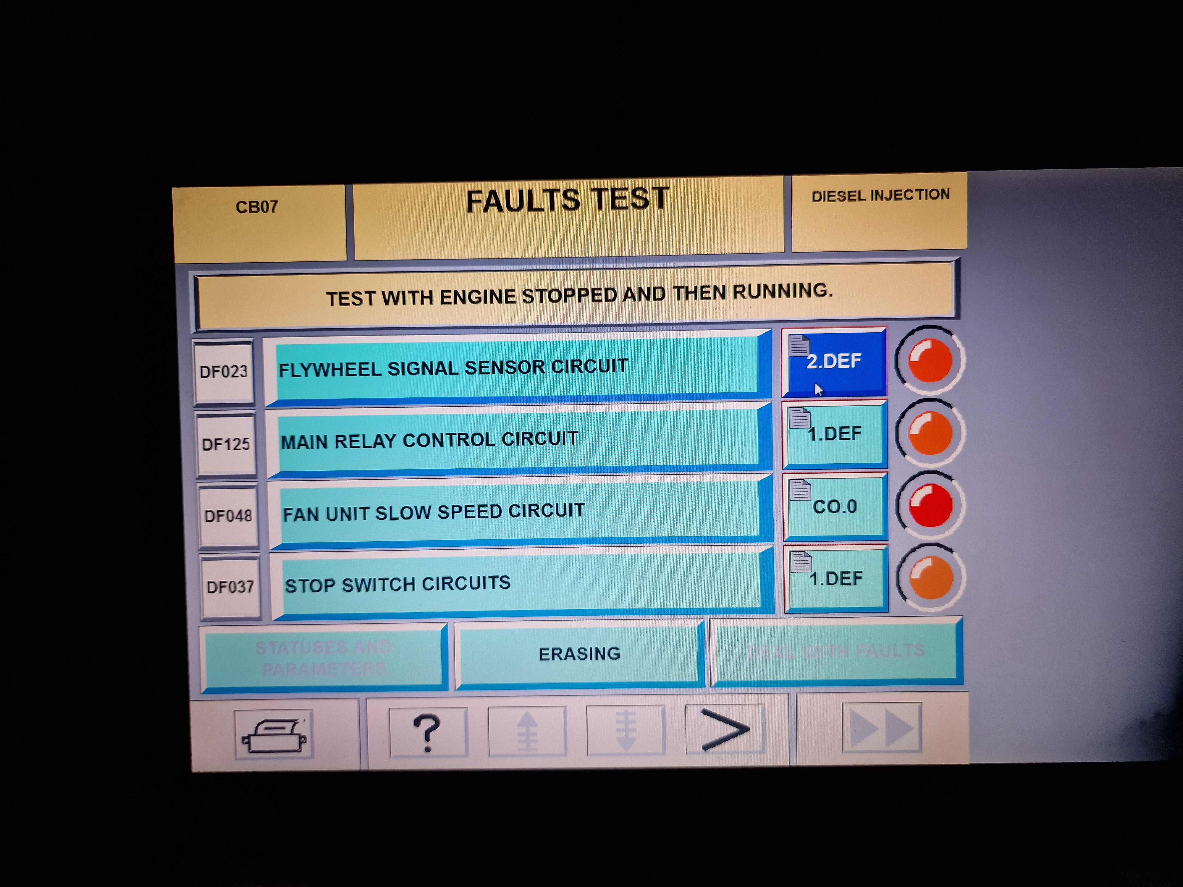

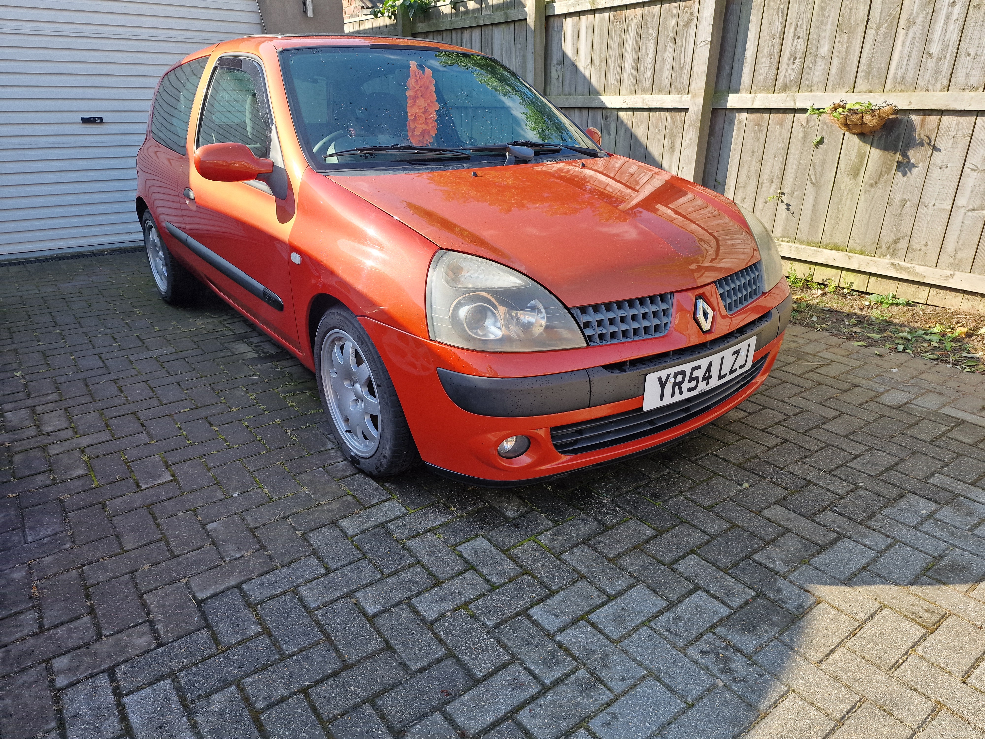

Orange dci update.

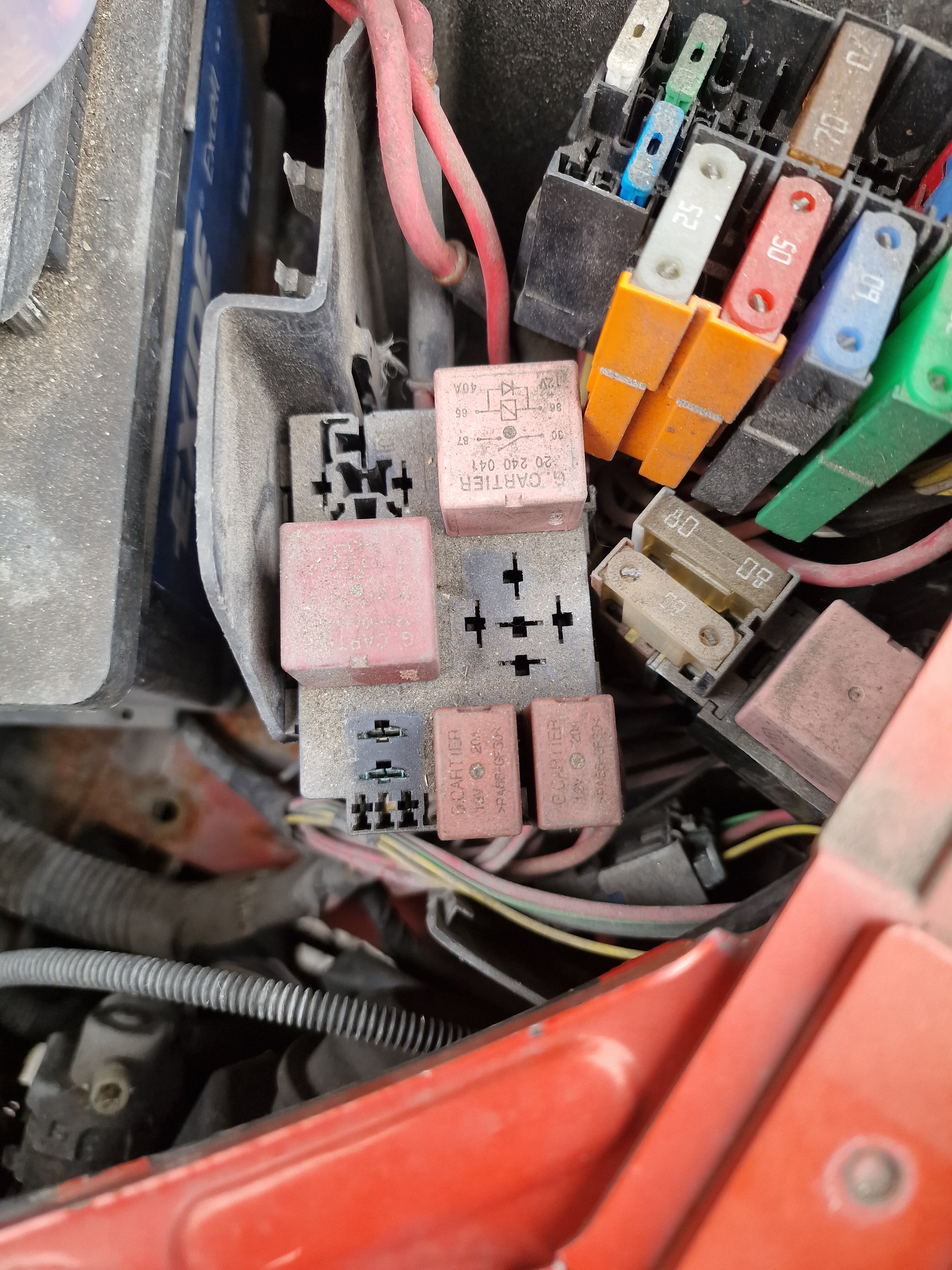

Used orange dci all last week. Had a couple of start up/conk out then start up ok on 2nd attempt chucking eml on briefly. Assumed fuel system issues and scanned with clip to diagnose.
Can clip diagnostics
A few faults stored but no fuel related codes. Digging a bit deeper reveals
DF023 Flywheel signal sensor circuit - 2 def tooth signal missing - crank sensor related
DF125 Main relay - 1 def relay cut too early so relay poss on its way
DF048 Fan - Be relay or wiring at a guess
DF037 Stop switch - 1 def coherence - fcuk knows, it done the immob red flashy a while back.

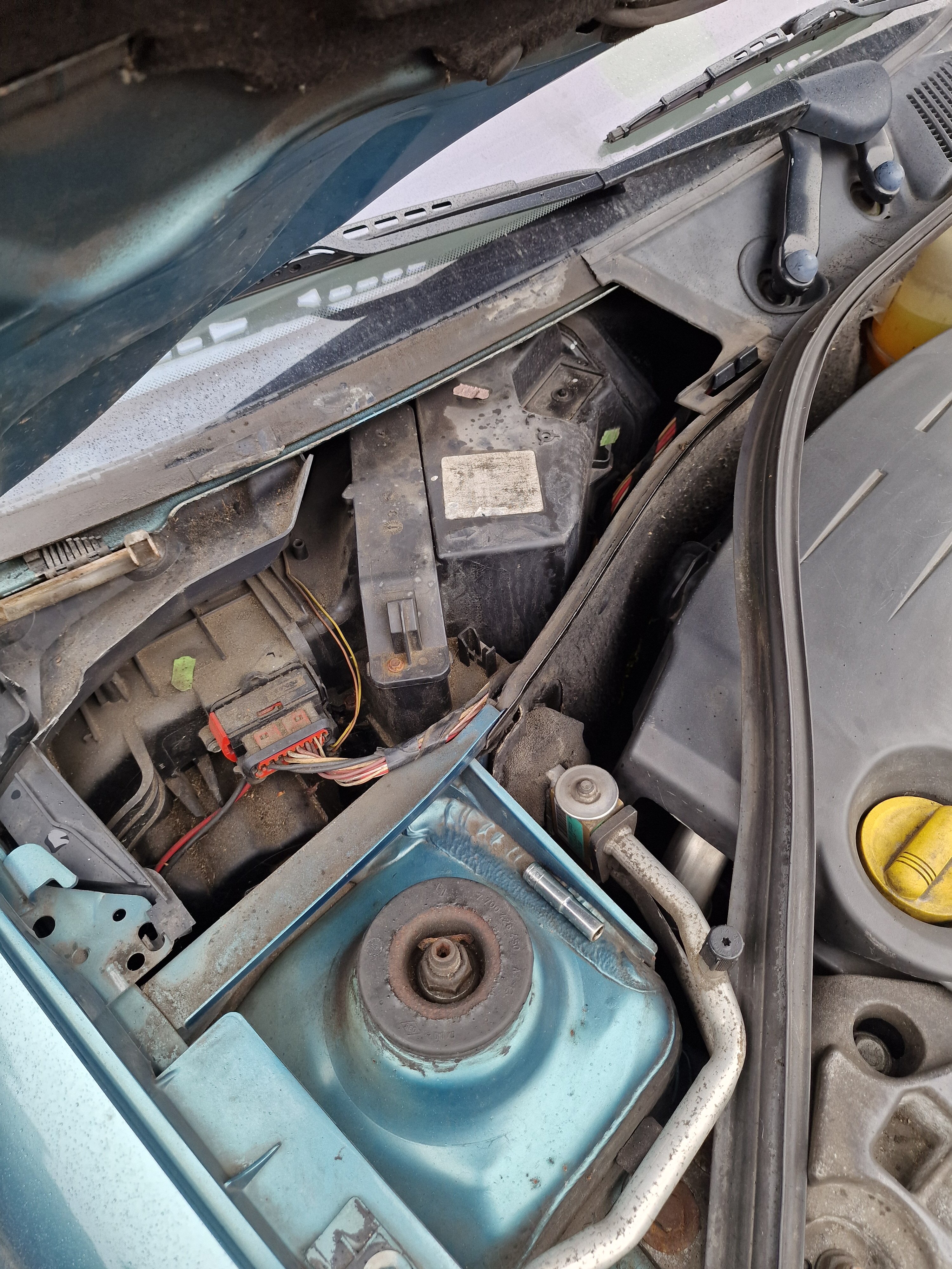

Deleted them and DF048 fan comes straight back, and fan does not trigger on actuator test. Open fusebox to look at relay and bit of corrosion/relay not fully inserted as top of fusebox knocks it when refitting as crap fit.
Corrosion visible.
Clean up the corrosion, fault clears and fan working on actuator test. Refitted fusebox carefully to ensure relay stays seated.
I then pulled the main/locking relay out and checked for corrosion. Was ok, so changed relay for a good used spare.

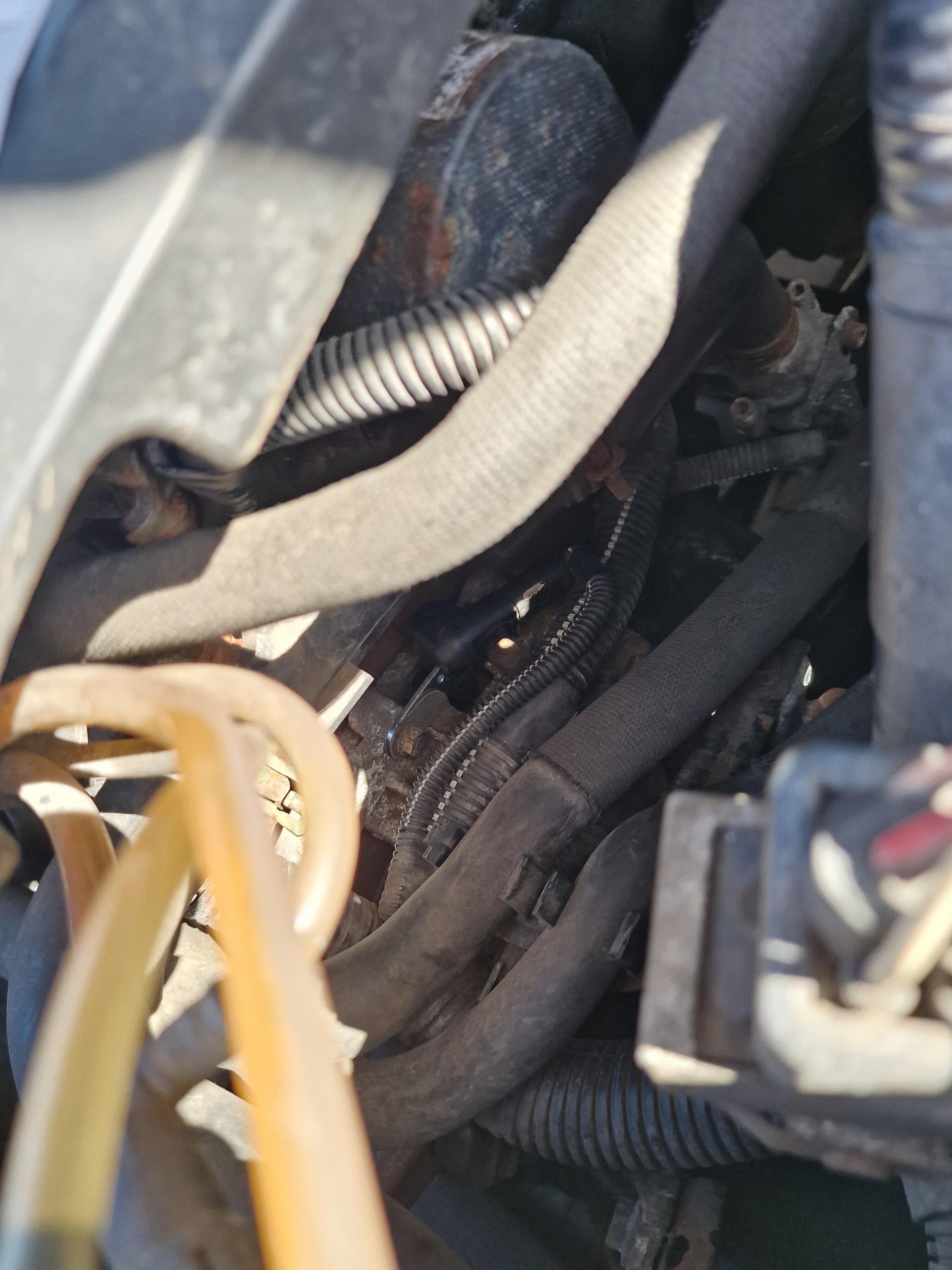

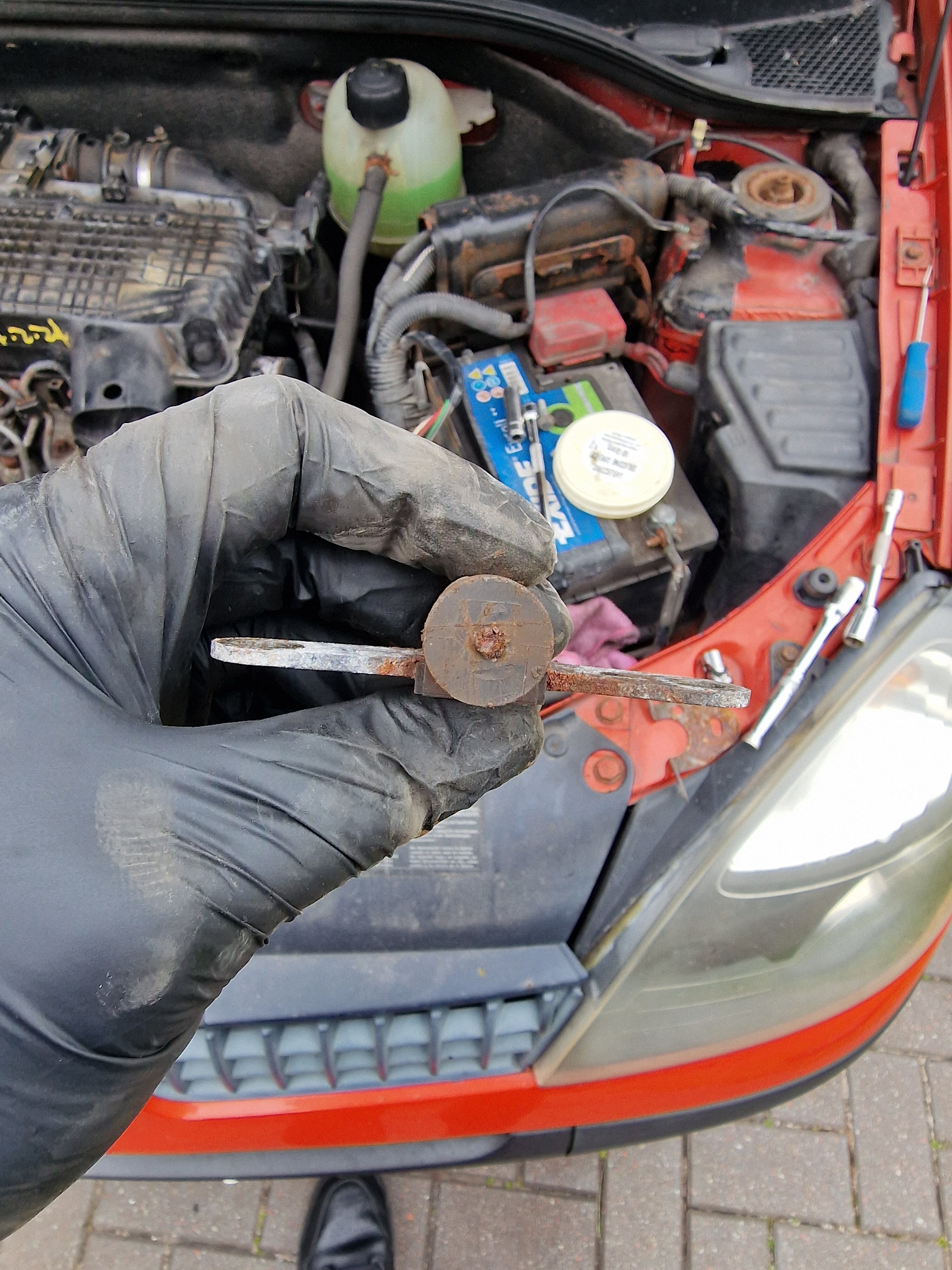

I then removed the crank sensor to have a look to see if end was covered in s**t. Noted the end has rotted to a point - that is clearly the issue. Actually resistance checked ok.
Id say thats about knackered.
I briefly cleaned and refitted this as no spares and it did not fail to start again so prob could have limped on a bit. Ordered a new aftermarket sensor and it arrived and fitted today in ten mins.
Super easy to change with long 1/4drive extension.
Fired up straight away and faster than usual. Logged fuel pressure on clip and flys up to over 230bar so assume still OK. No fault codes returned since so id say its job done.

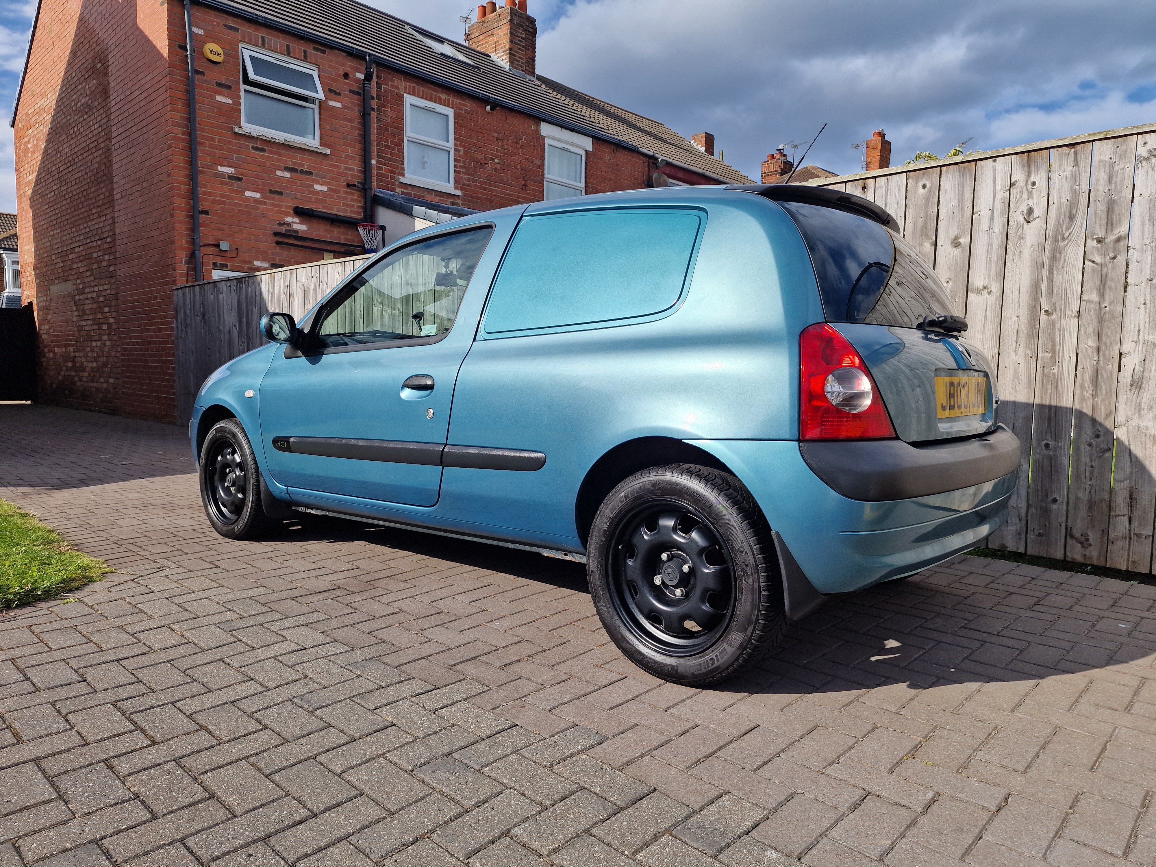

Running absolutely fine. Went to Doorslammers/Santa pod in it last weekend 450ish miles, 69.3mpg. Its getting close to the 200k now.
214 miles to go.
@Martin_172 kindly donated some van spares for it, rear trims, spare window blanks and floor panel. I was missing the upper rear plastic trims and had cut down car trims which didnt fit great but were passable with carpet bridging the gap. With the vans being rare ish id not seen another set for sale.
Had a spare hour today so stuck them on. Looks much better with it all fitted and no gaps.
Van upper plastics in situ.

Used the orange dci today.
First run out after new crank sensor. Its made a massive improvement to starting and idling from cold. All the time ive ran it (around 45k miles) its started quite harsh jumping into life, then idled fairly rough from cold but fine when up to operating temp. This was quite annoying on short journeys with engine bouncing at traffic lights etc, i assumed this was an injector on its way and expected it to fail at some point so left it before it got expensive chasing the issue.
Noted today that it started faster from cold and smoother start without the engine giving a kick when it fires. Cold idle is now smooth and no more bouncing your tits off. Never thought crank sensor would be the cure, the sensor resistance was a mile out when checked and rotten point on it, i guess its not been reading the flywheel as good as it should and coming into somewhere near spec when hot.

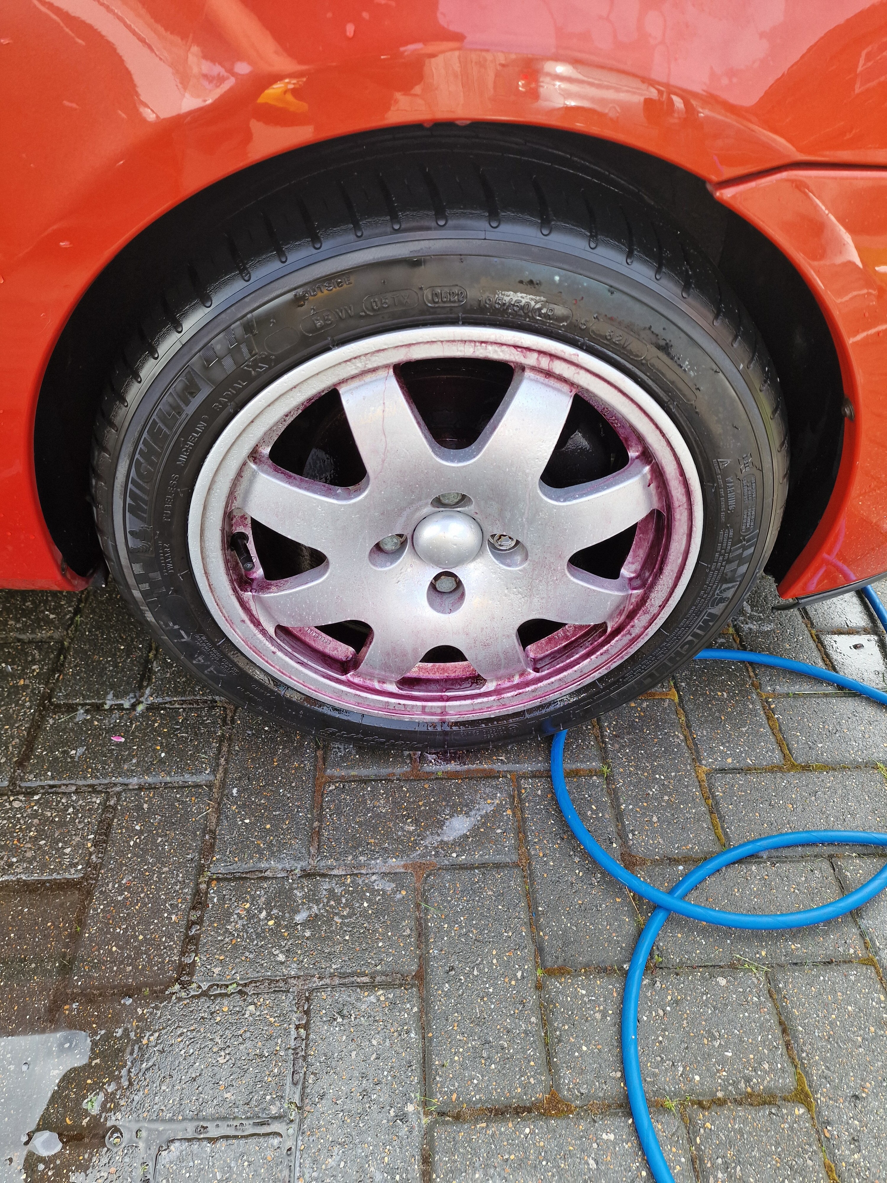

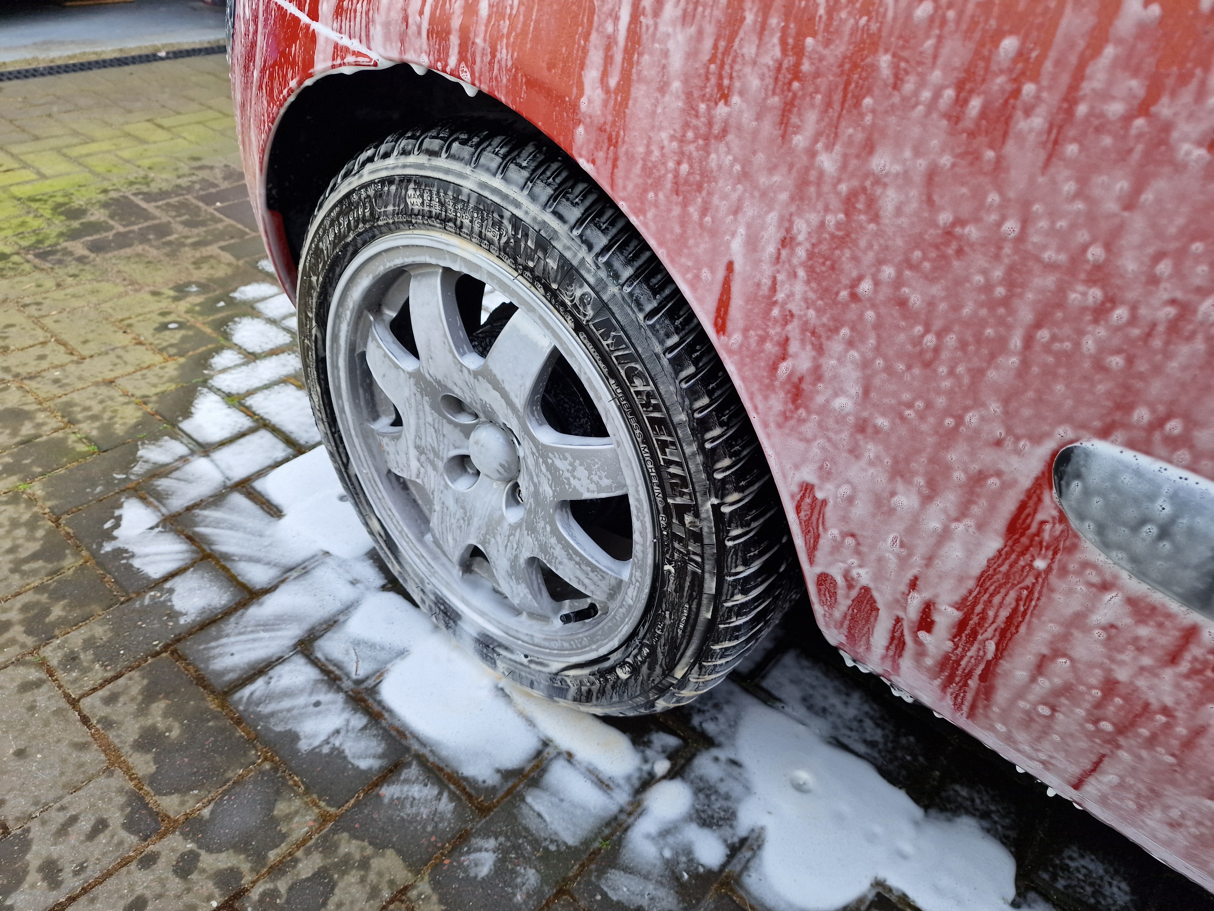

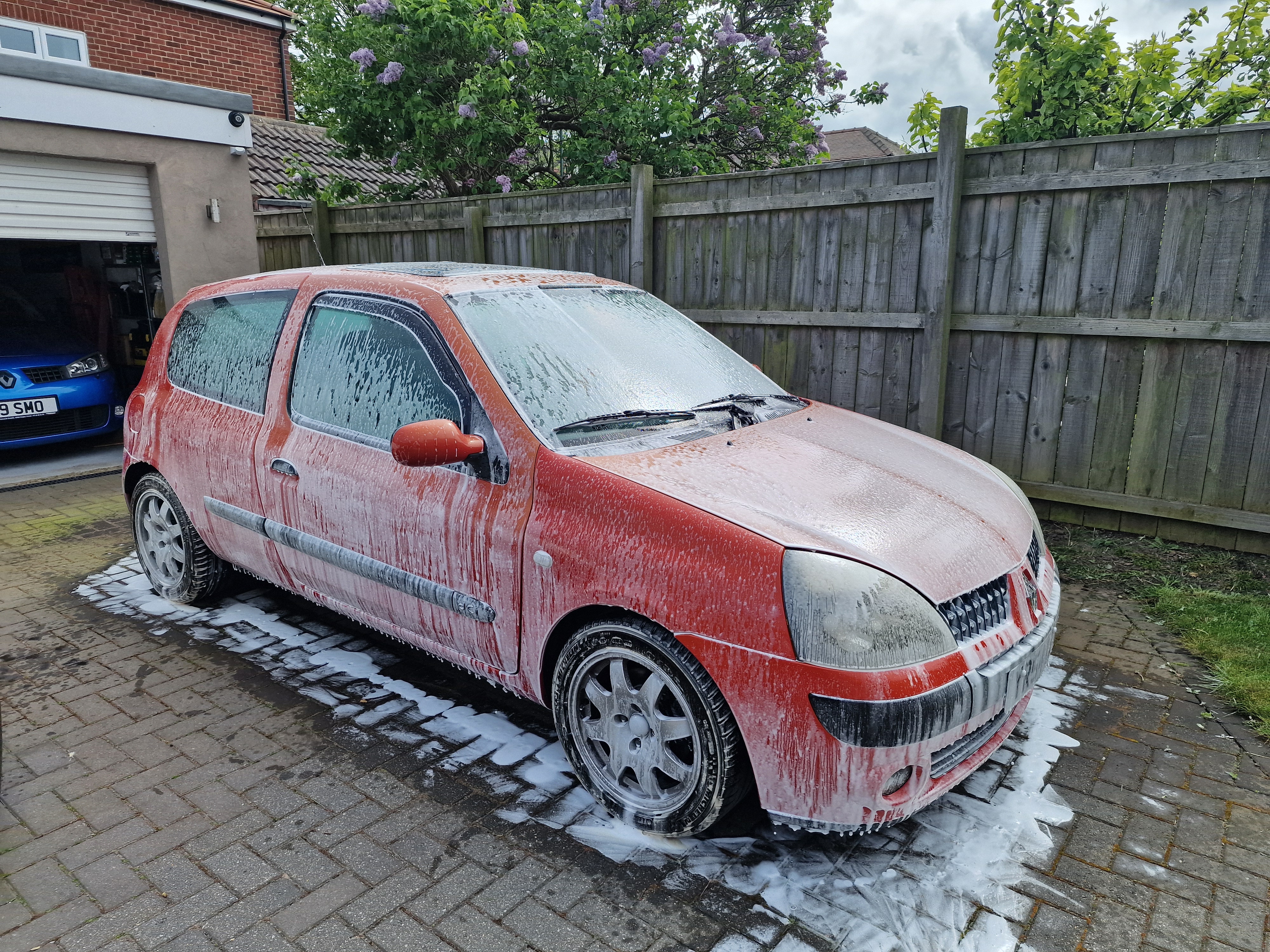

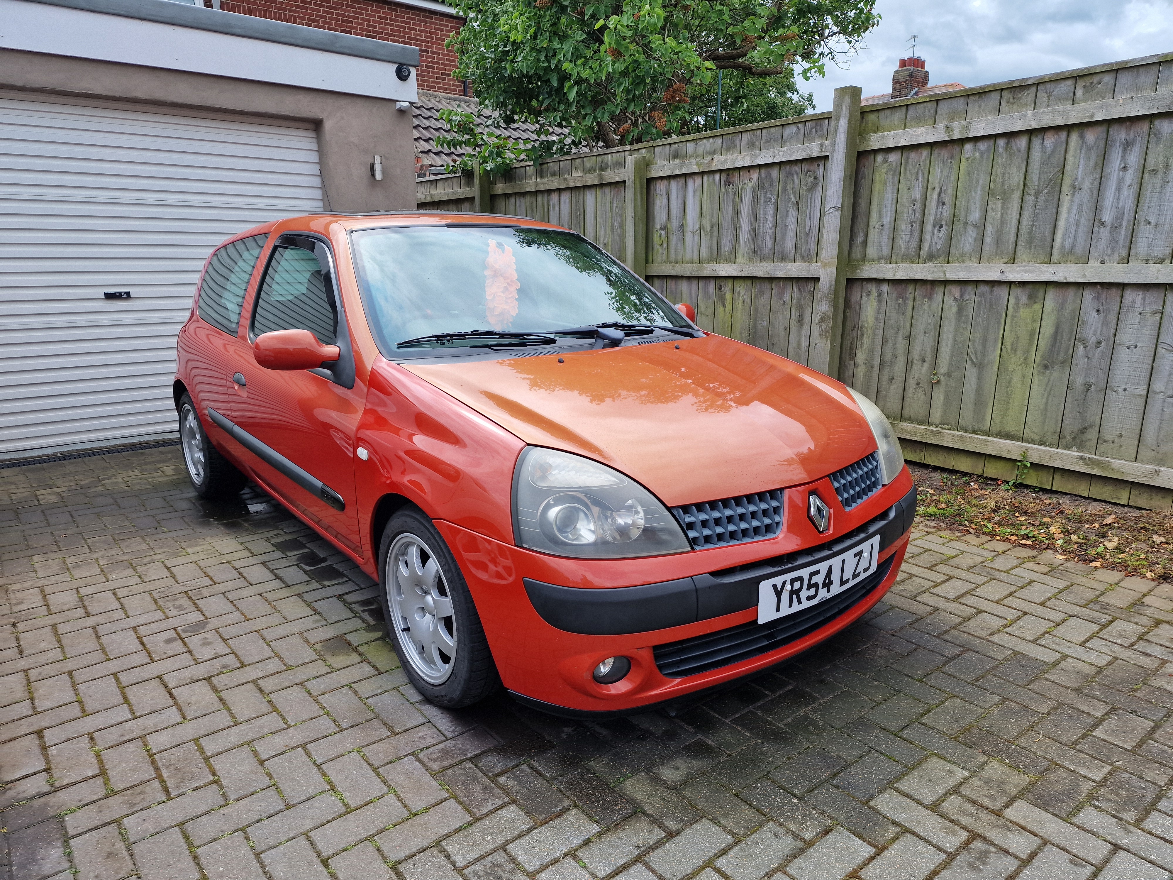

Quick clean up for both dci's on Sunday.
Blue one got a hoover too as doing a load of miles this week, working in Hackney for a few days.
270 miles today as had to make a detour to Peterborough en route. Ive parked it at the hotel and on foot/uber for site visits as the roads are pisstake around here 20mph speed limits and cameras every 200 yards and permit parking everywhere. Cant wait to go back oop north :LOL:

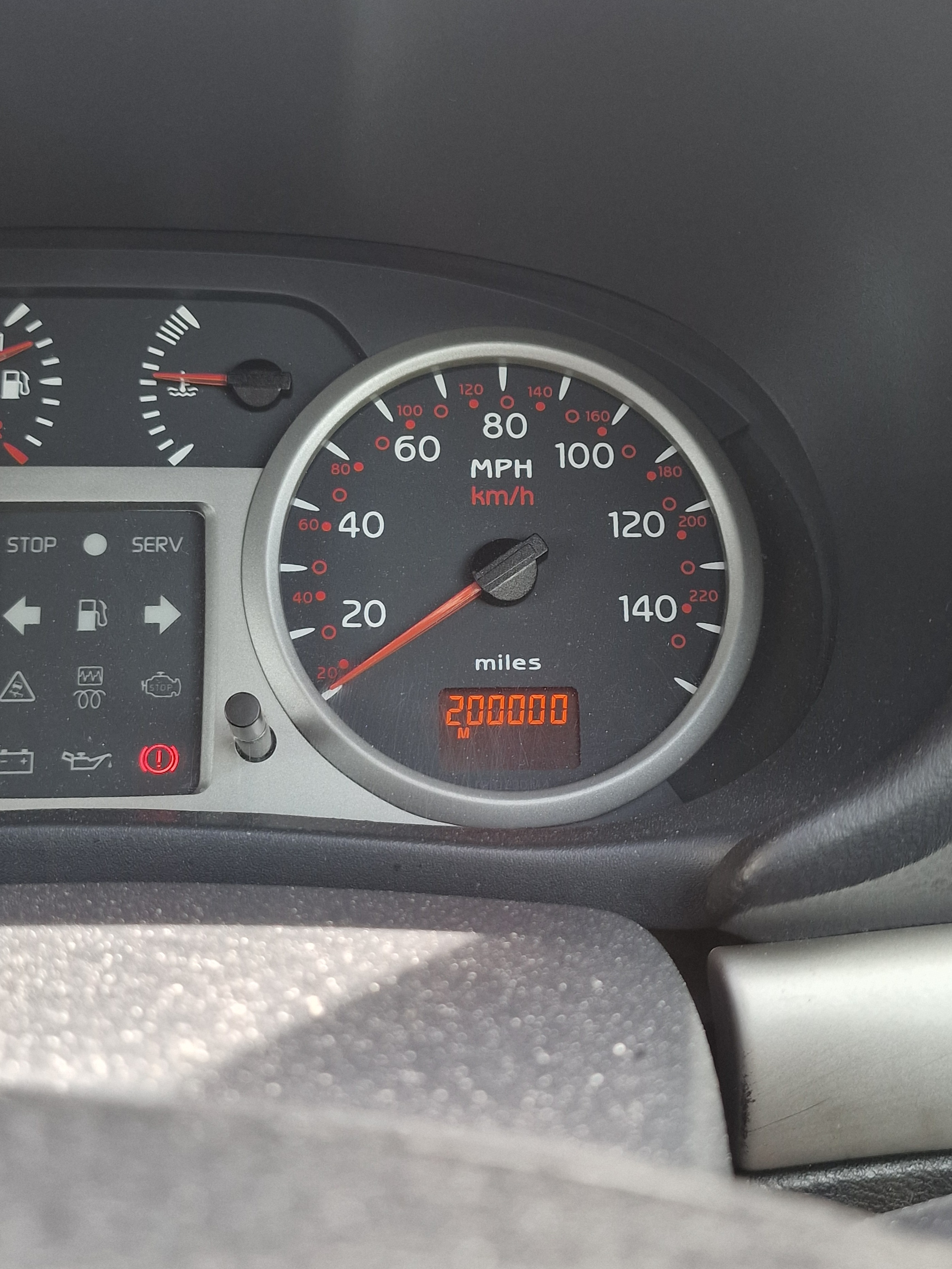

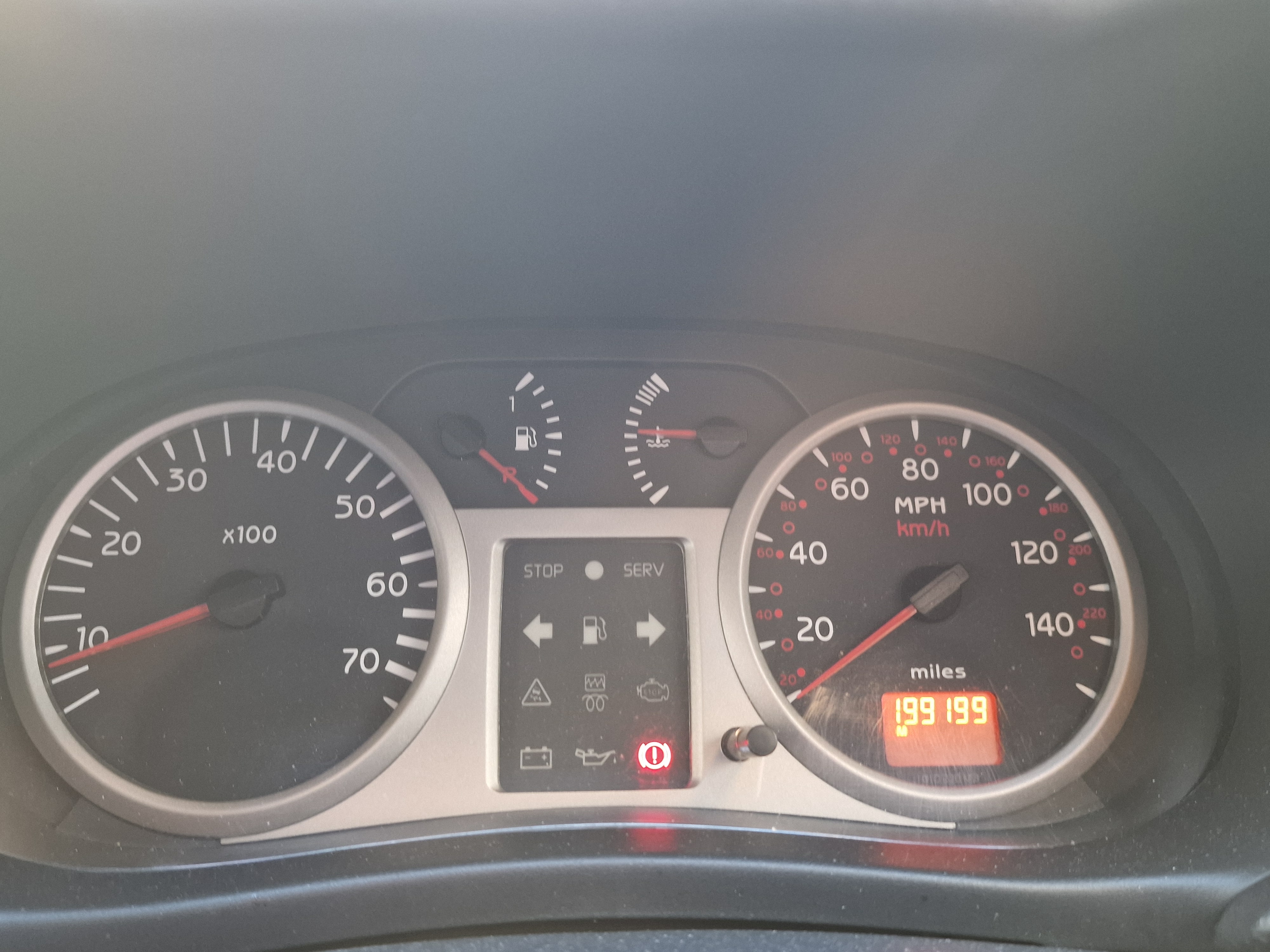

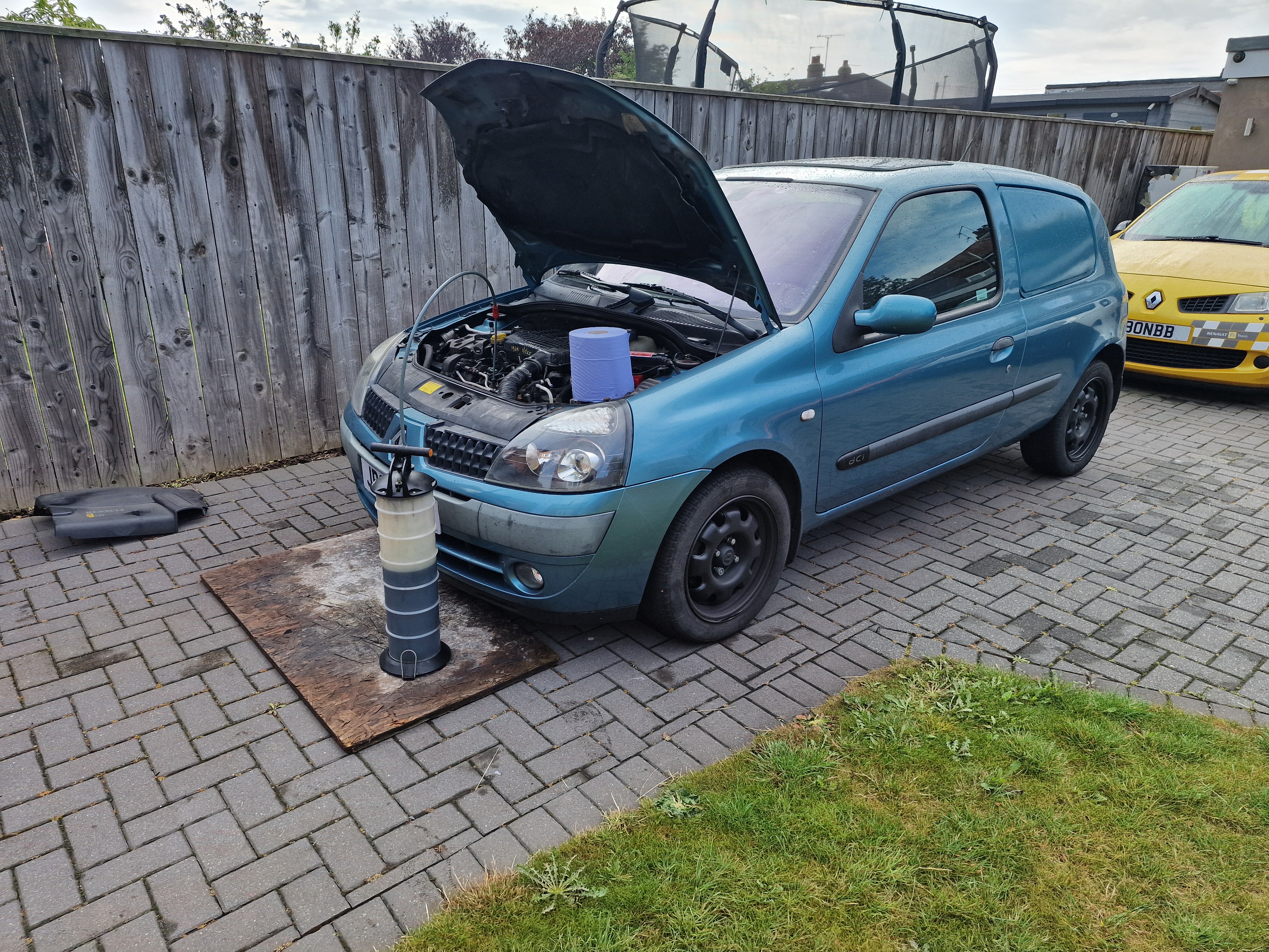

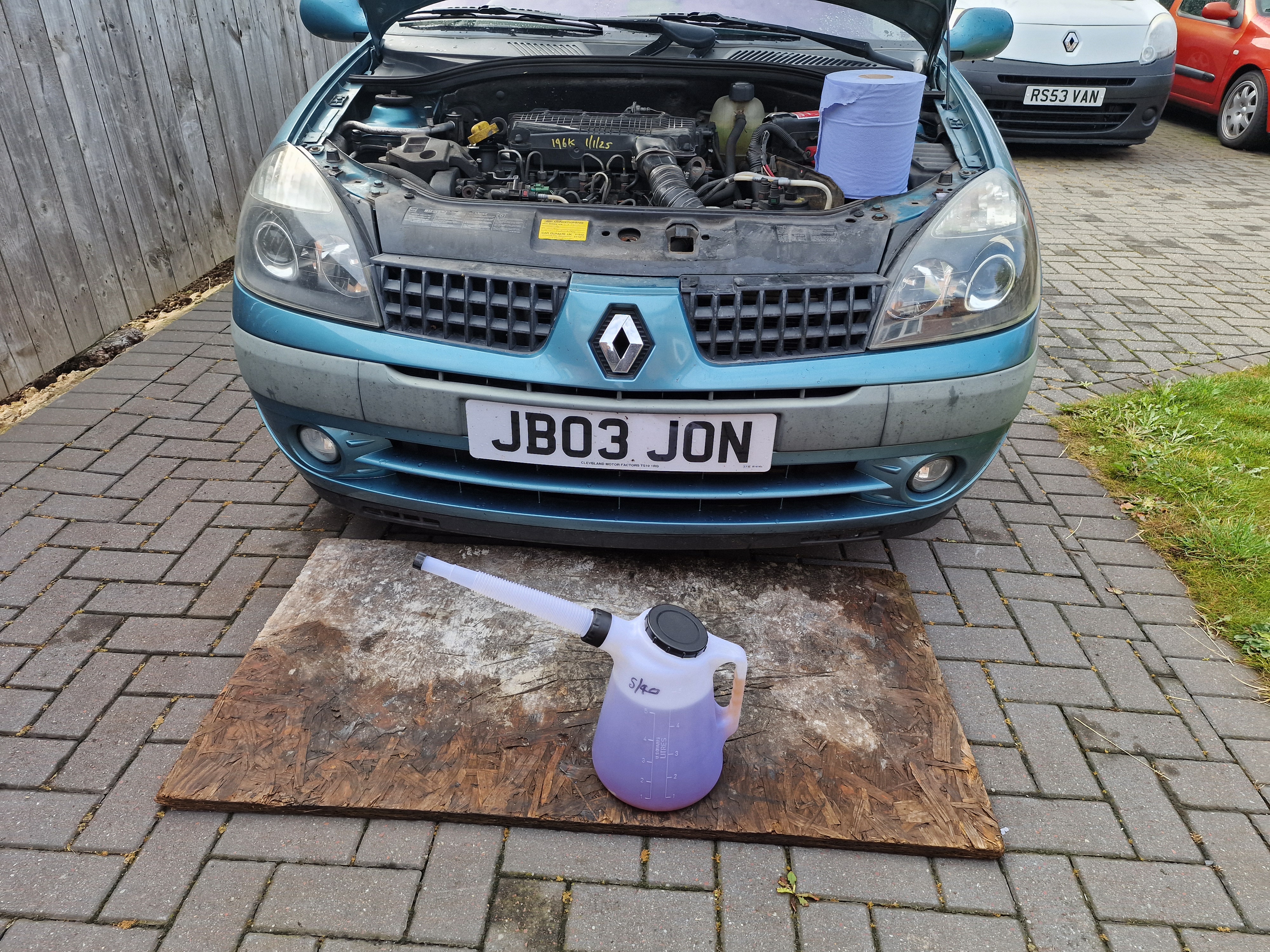

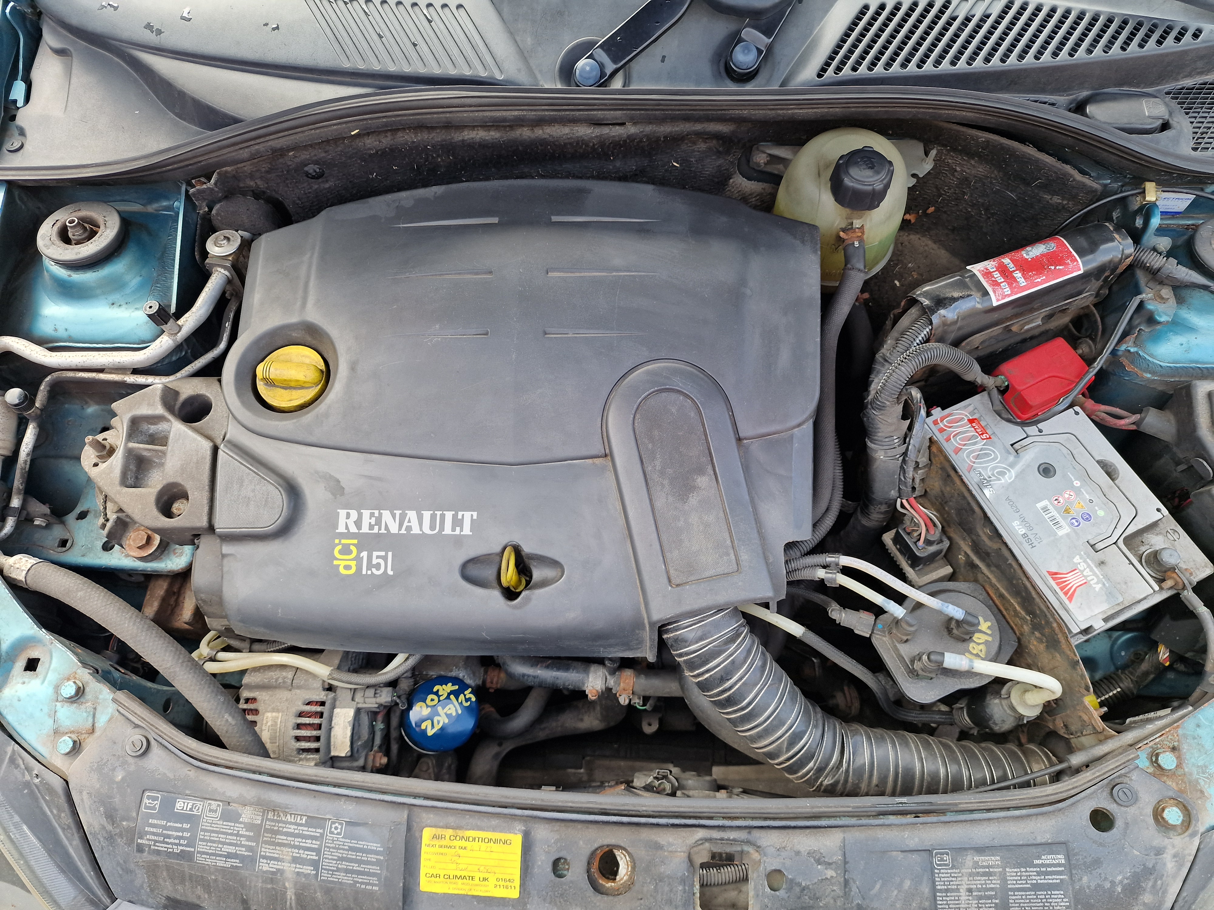

Done loads of miles in the blue dci lately and around 203k now. It was due an oil and filter change so done it last Sunday.
Sealey vac pump to drain.
Valvoline synthpower 5/40and purflux filter.
Done until 210k.
Nice and simple 20min job.

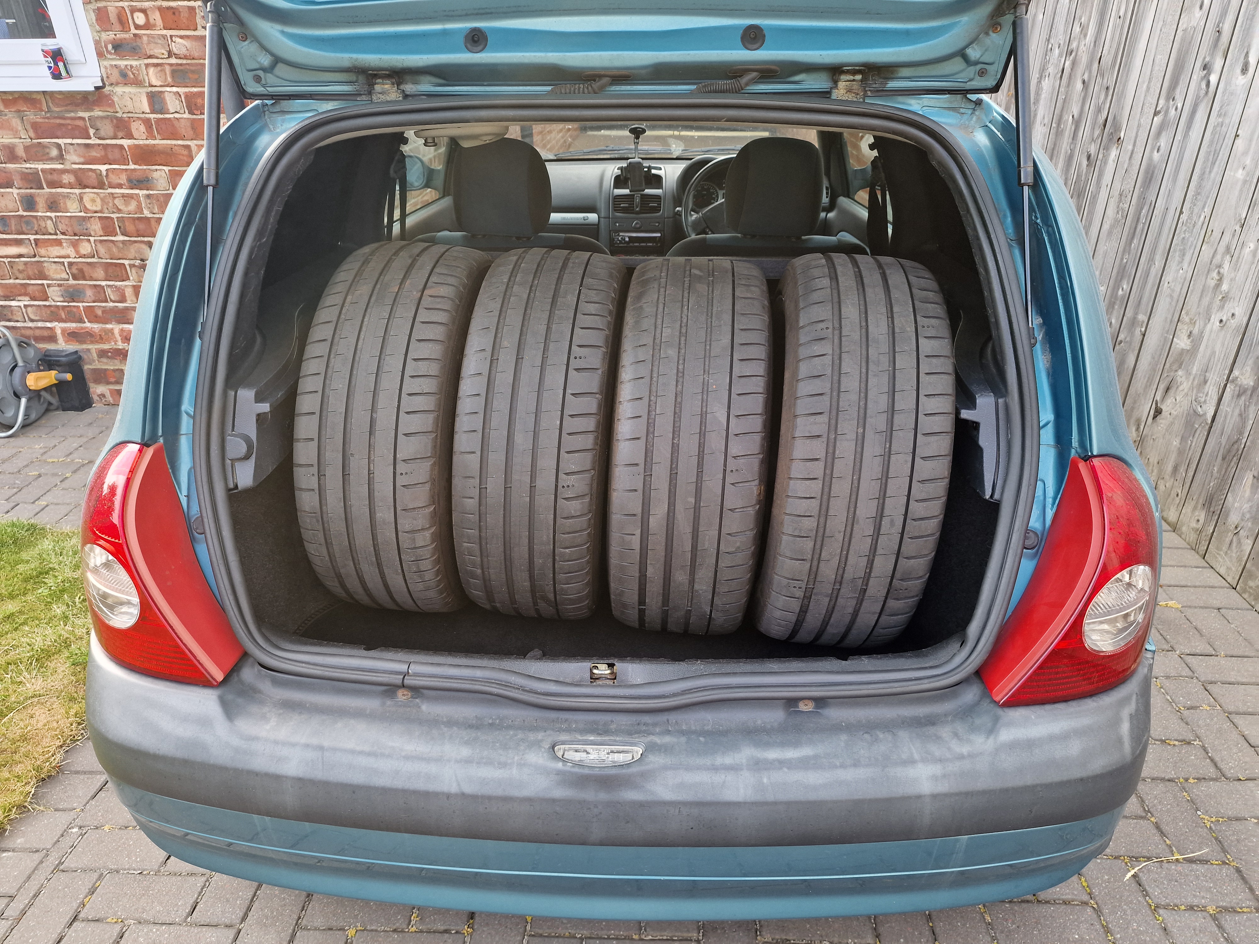

Ive moved a few sets of 18" wheels about in it recently. Fit better in this than the megane!

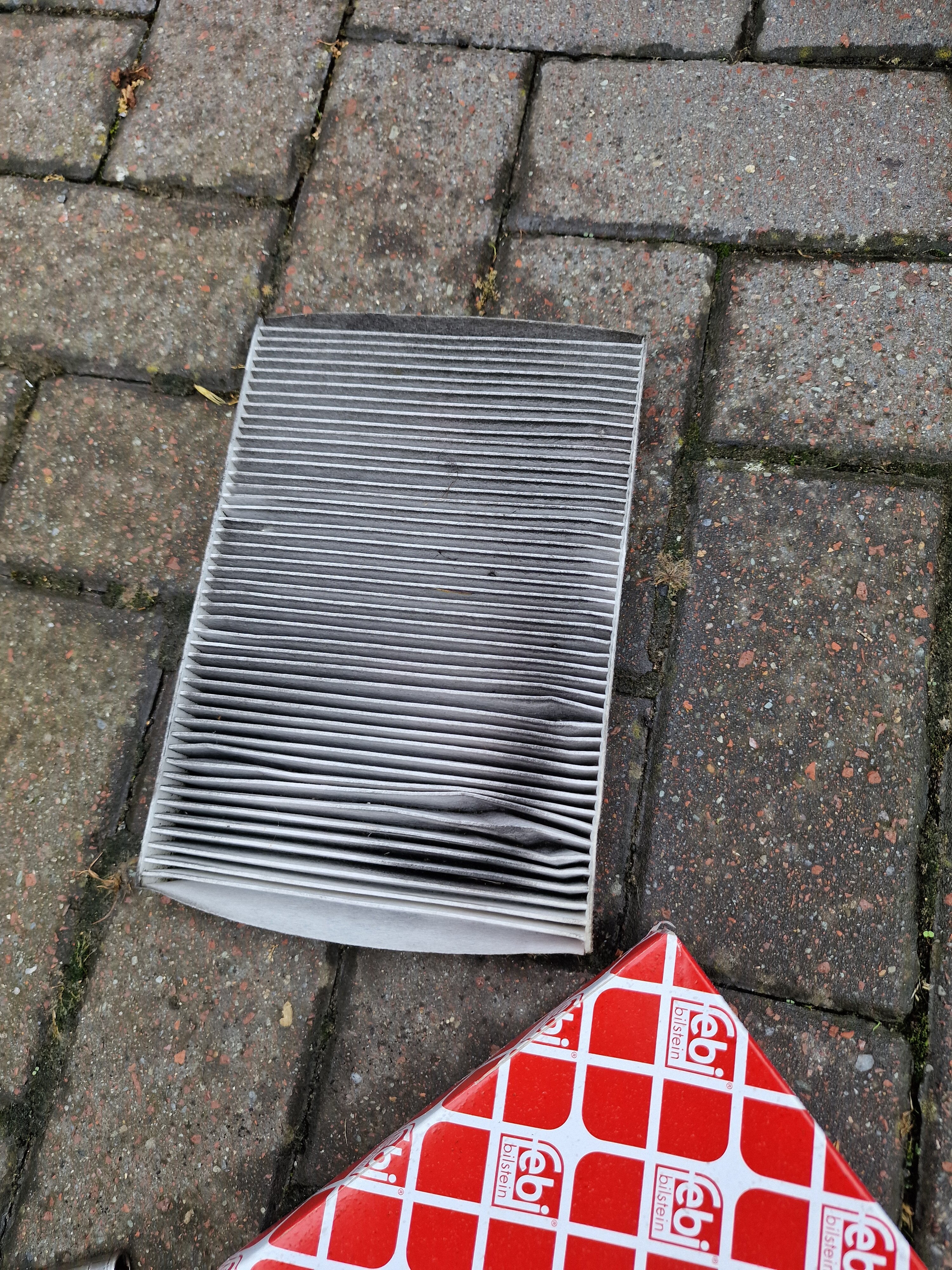

Changed pollen filter in blue dci last week. I always forget to do this and god knows when i changed it last, so was pretty grim as expected.

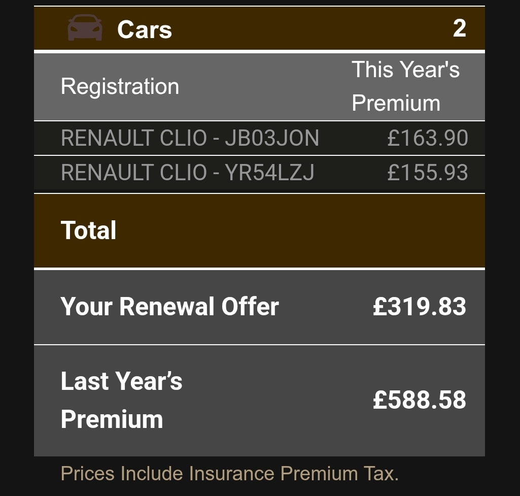

Insurance is up on both dci's. For some reason these have always been a bit dear to insure for what they are and always around mid to high £500 to insure. Ive shopped around and never seem to get it any cheaper so have been with elephant for years.
Renewal came through for me and the mrs on both at £319..ill take that!

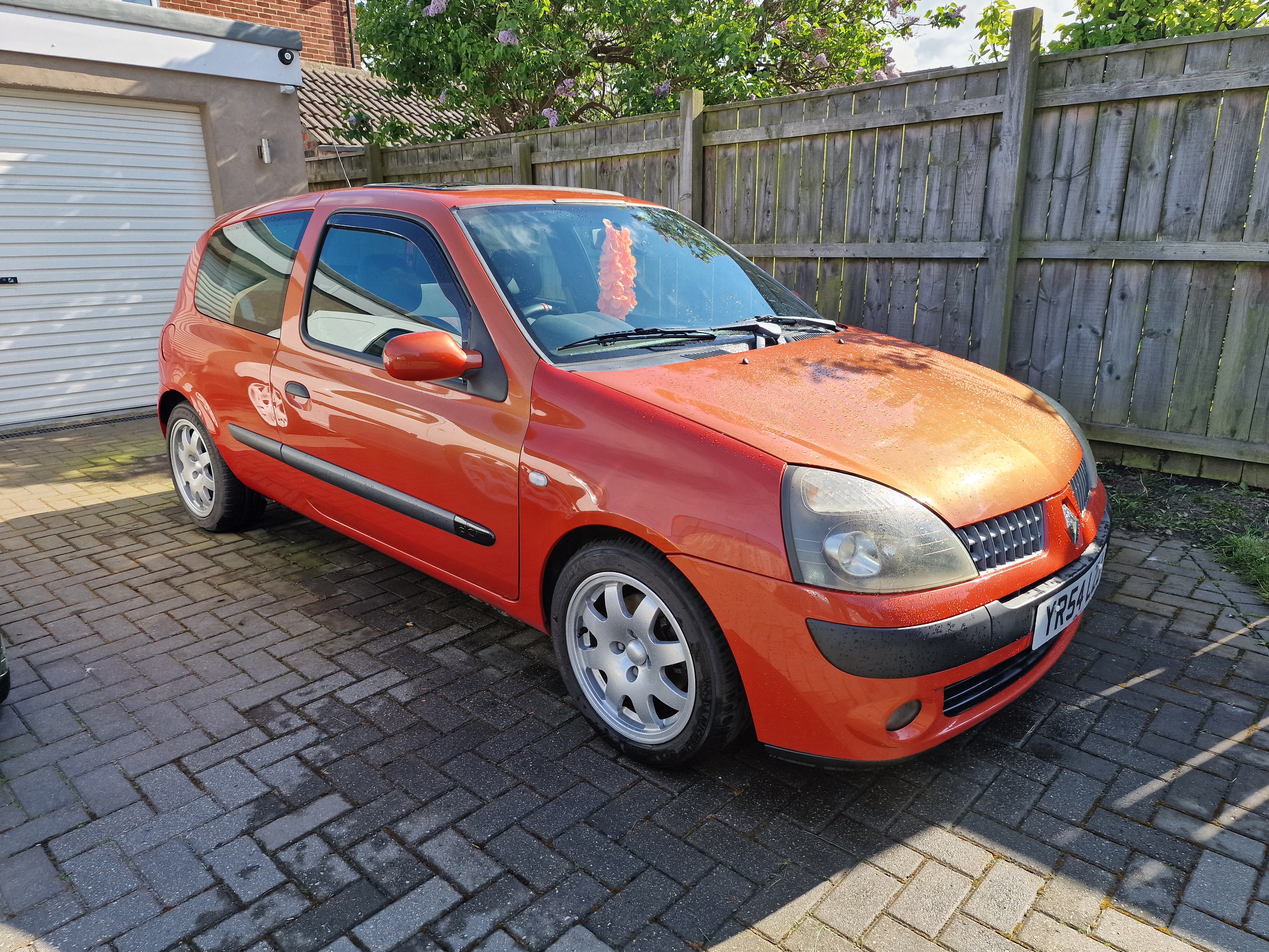

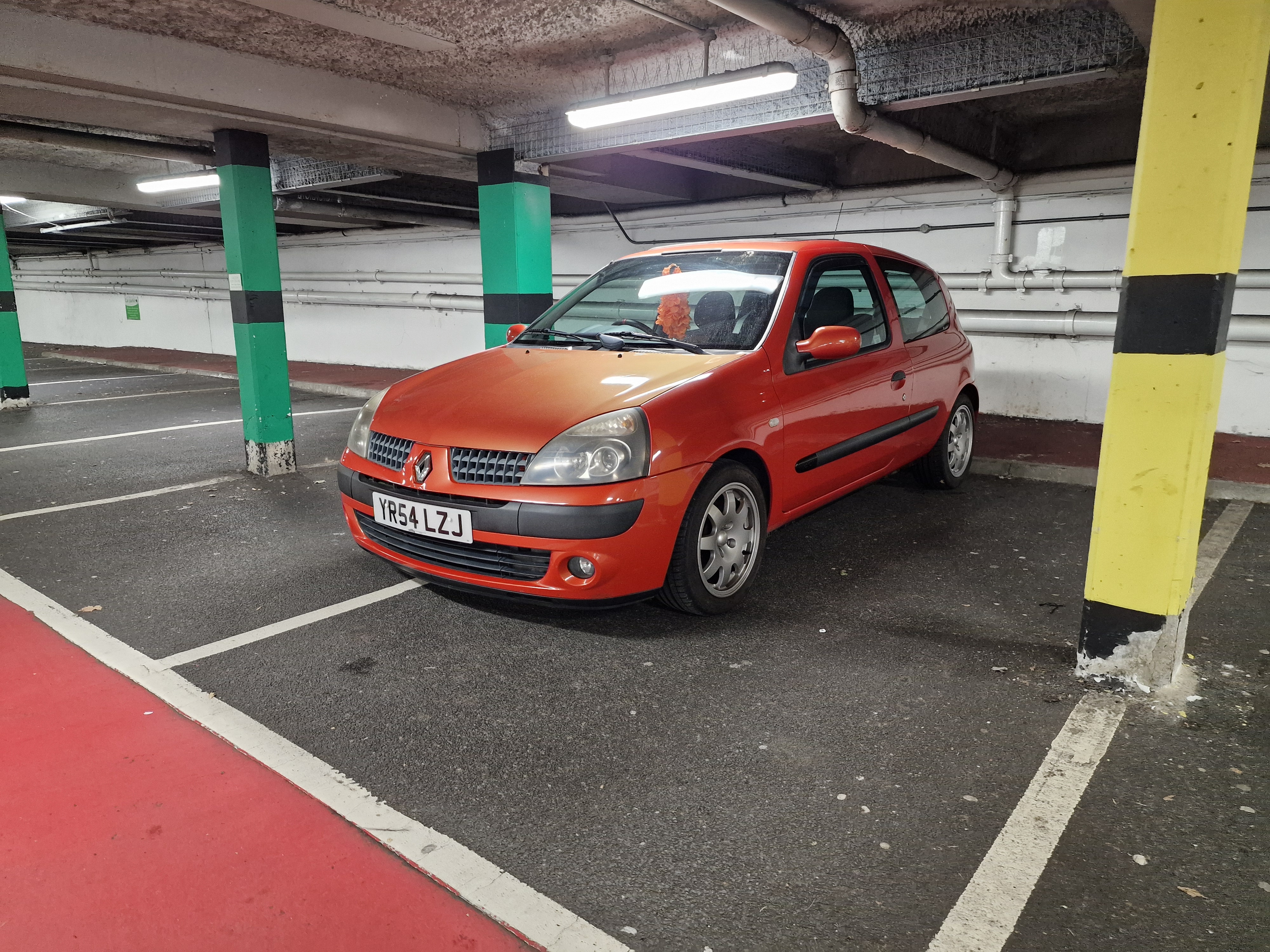

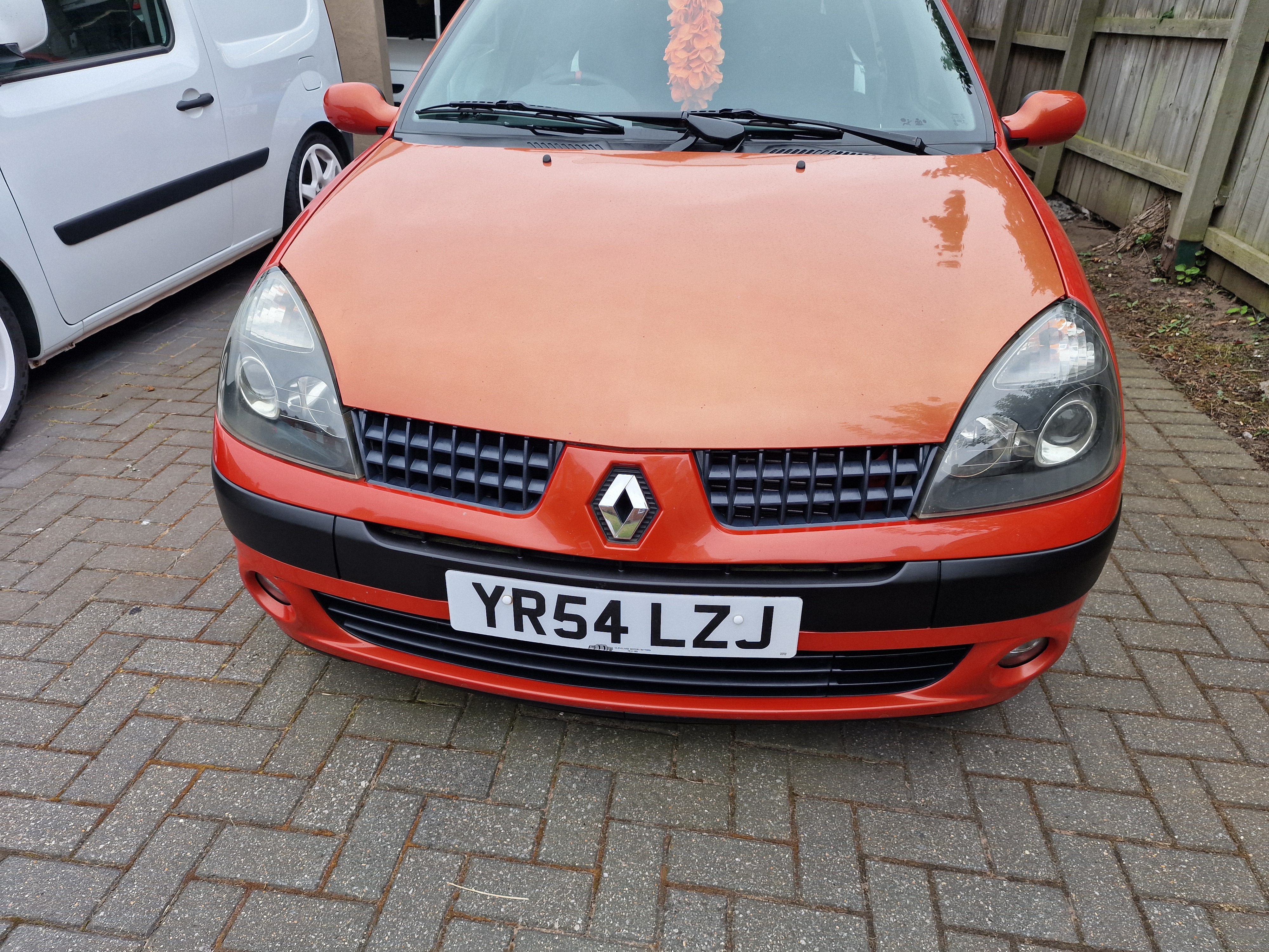

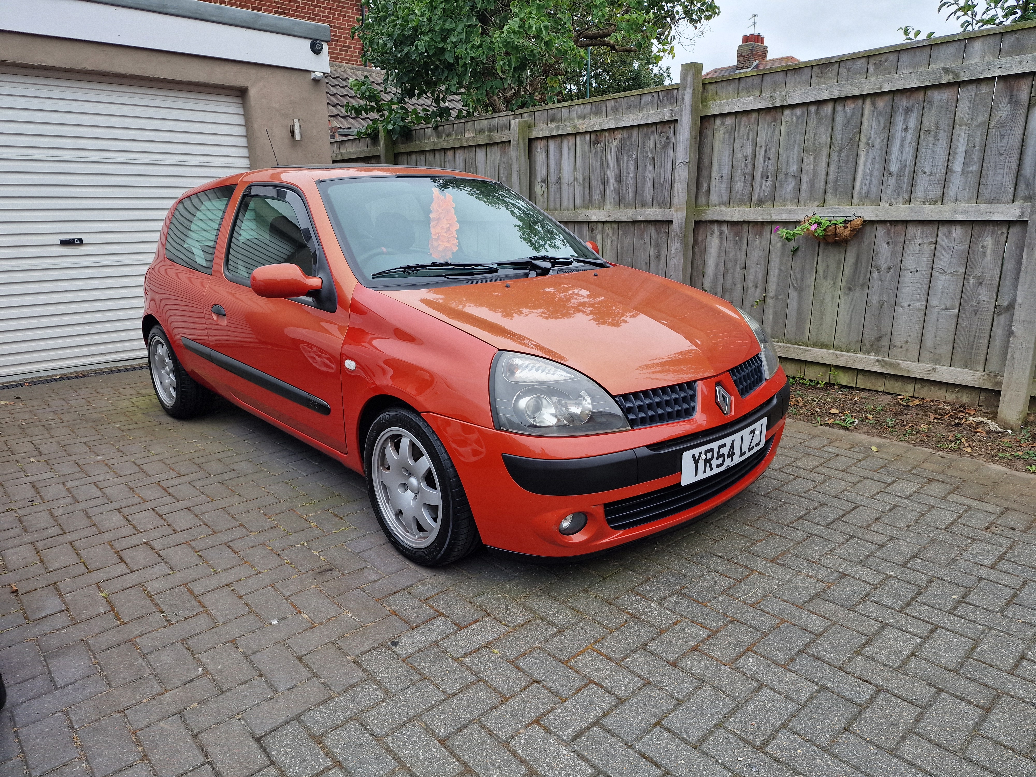

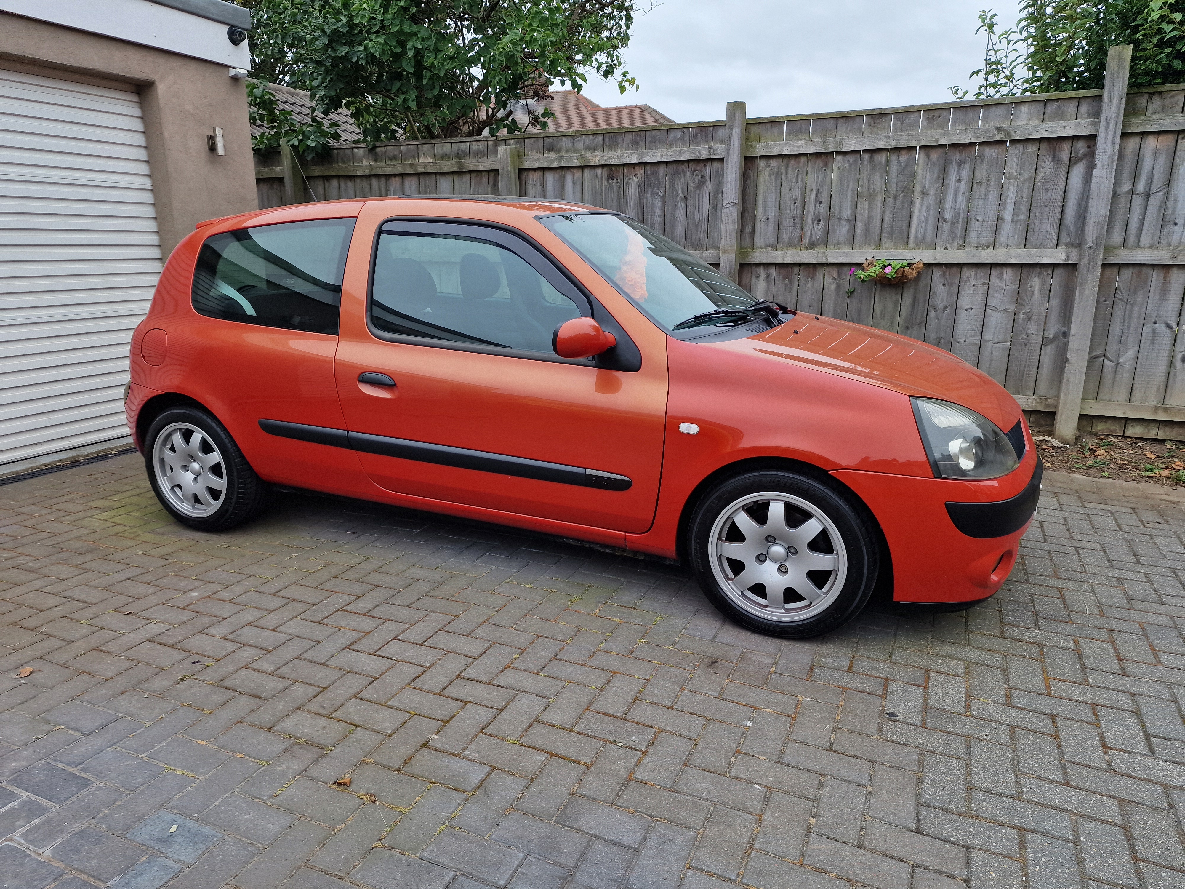

Took the orange dci out yesterday as i had to move it off the drive to get the blue 225 out of the garage.
Not used it for ages as it needed fuel and couldnt be arsed to fill it, but had a bit of spare time yesterday so stuck some in. Bit of agressive braking soon de rusted the discs. Flys along as usual.
Out of all the cars i own this is still a great car to drive. Corners really tight and you can just drive it flat out everywhere.
Headlamps need a once over and a coat of something on the paint before winter. Will get a half day on it at some point.

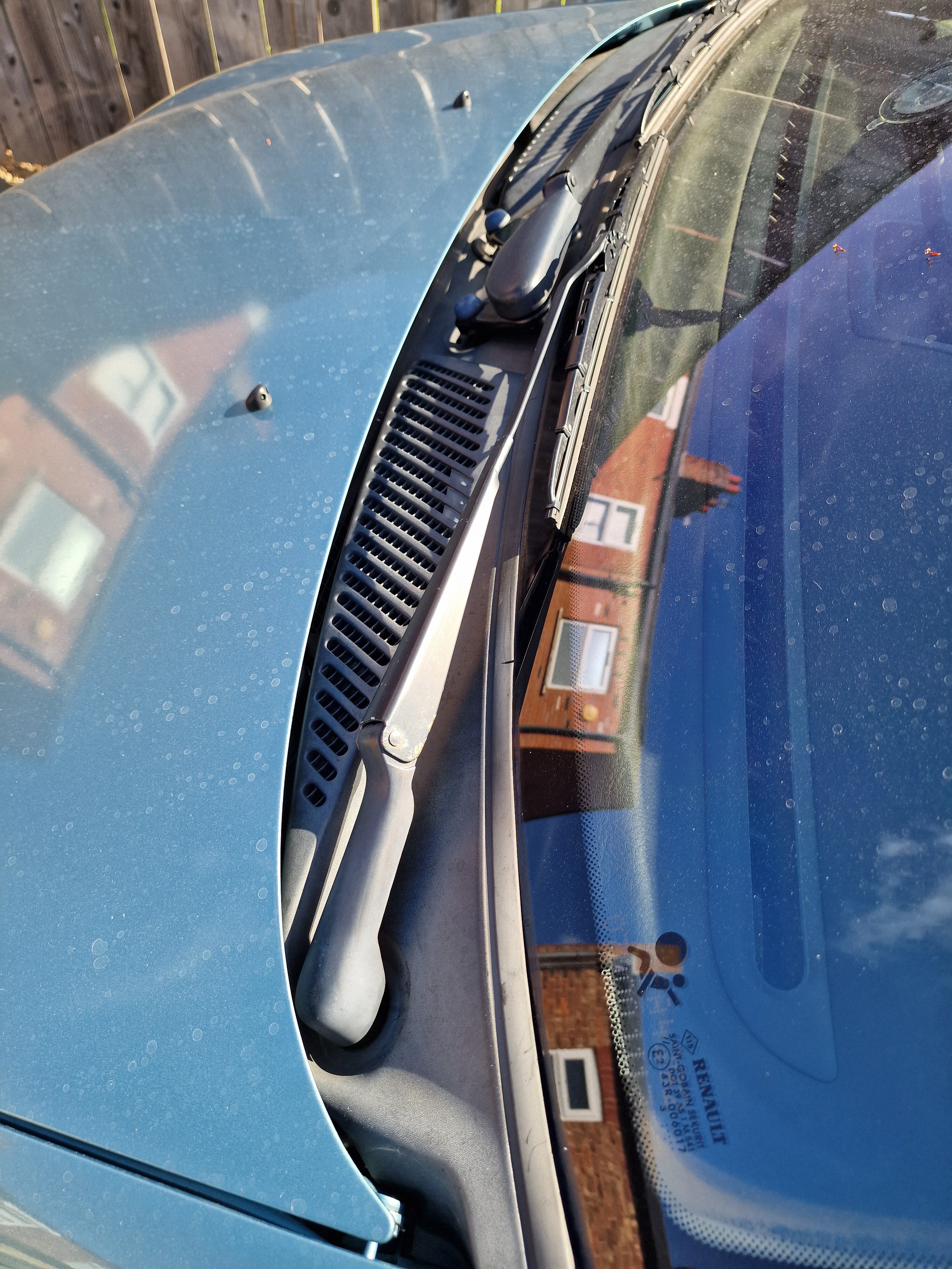

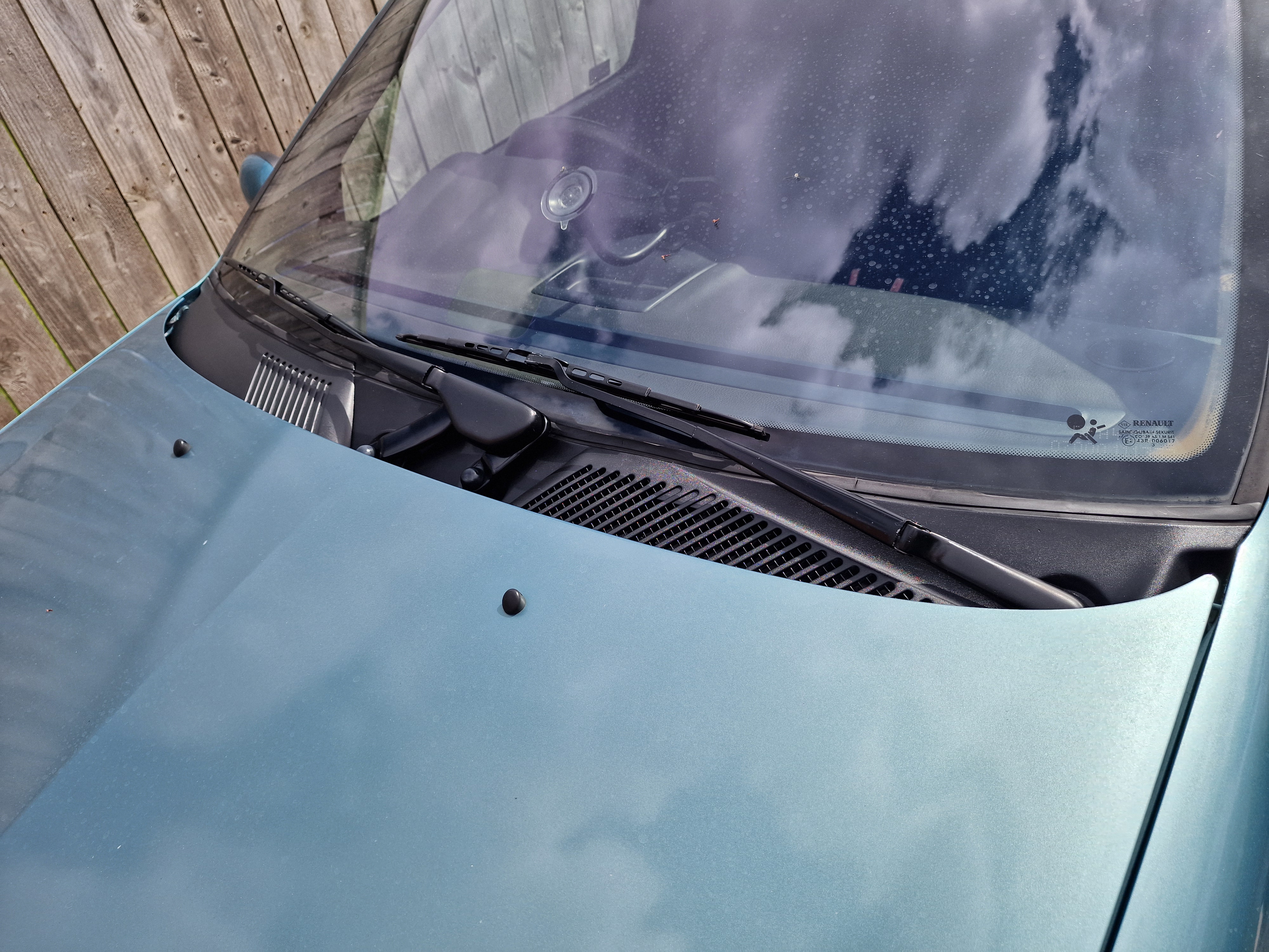

Give the scuttle panel on the blue dci the ceracote ceramic trim wipe treatment. Fiddly to do in situ without removing wipers etc but managed it.
Before, faded to fcuk.
After.
Night and day difference. Should last ages too as the bits i done on the kangoo are still spot on 12months later.

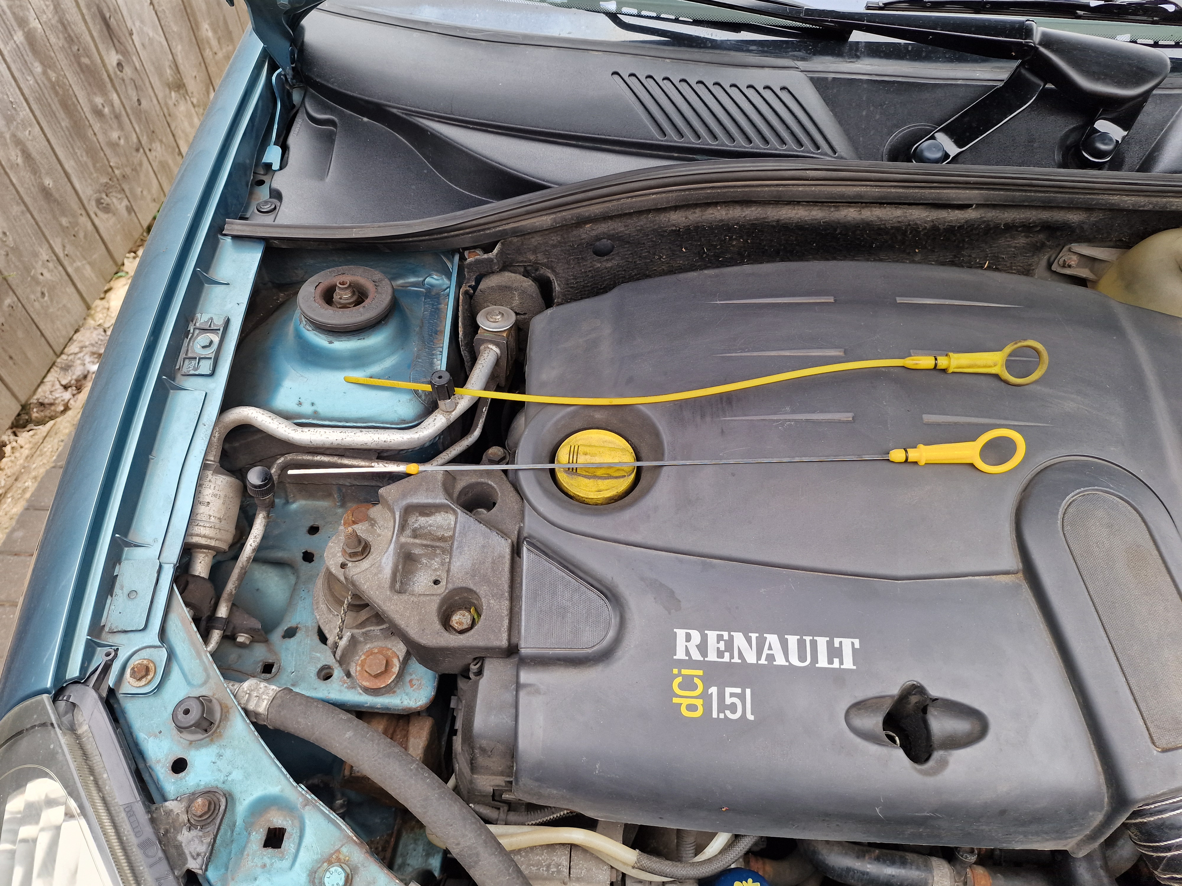

Snapped the original dipstick ages ago on the blue dci when i was doing a leakoff test. After buying several aftermarket shite ones listed with correct part number that were either incorrect length, incorrect fitment, crap quality or all 3, i finally found an oem ren one for sale (or thought id found one!?).
Hit buy it now on ebay, first one fails to arrive and seller says no problem ill send another. It turns up and looks like aftermarket to me, looks like seller had dressed it up in an oem bag but mine turned up without a bag conveniently.
Anyway it seems to be better quailty than the plastic aftermarket one i was using that was loose as fcuk/like a floppy c**k, oil level marks are in the correct position and its metal so it will do.
Dipstick saga, why so many different ones
That will do i guess. Should have just tried to order from dealers orignally.

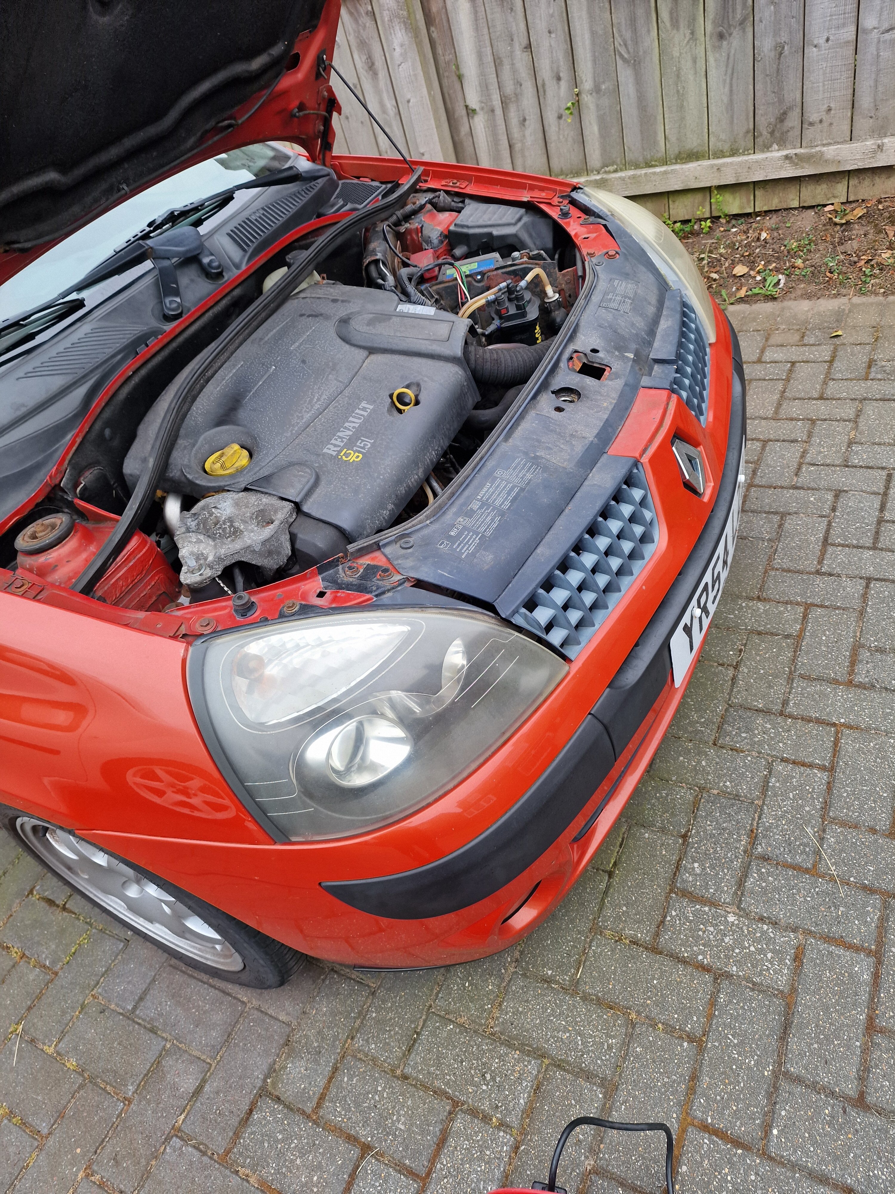

After this i give the orange dci headlamps a polish as they were looking a bit crap.
Usual faded clio2 headlights.
Ive done several headlamp restores on these and i normally wetsand but skipped that stage. This time i just ran a heavy cutting compound with a medium pad and finished with a final polish/finishing pad. Literally ten mins and done. All yellowing gone, headlamps are not perfect but decent improvement
Much better.
I then give the headlamps a go over with a ceracote trim wipe. Also panel wiped all the plastics down and done them too.
Ceracoated trims ftw.
Hours worth of work and its transformed, as faded plastics always make a car look old/s**t.
Ive tried loads of permanent trim restorer ceramics over the years and the ceracote ones win hands down. Honestly wont get a better lasting product as its been tried and tested on my kangoo and no fade, and ideal for using outside as goes off in an hr. Not expensive too, absolutely recommended.

I had the same f**k about with the dipstick for my Megane
Every single one that arrived the cap was either wrong, the stick wasn't long enough or it didn't seal. In the end I bastardised the original lid onto a decent stick and it was fine after that
MLB
Those wipes do look like they work wonders. Where's the best place to get them from?
Can they be used on headlights as well?
Brigsy
  T.Turbo
Painful experience aint it, why renault designed about ten different dipstick types for k9k is beyond me. Had same saga with megane f4rt, all different.

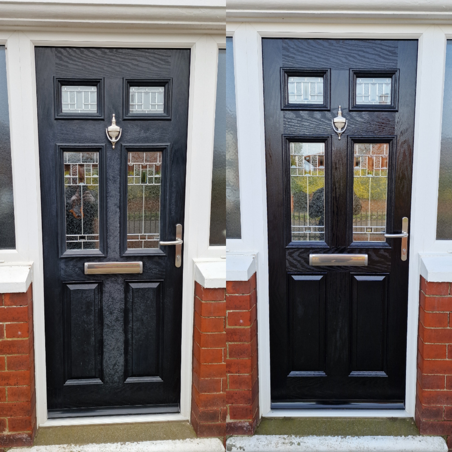

I got last box from Amazon in link below.
They looked like a cheap thing but when tried absolutely amazing. Ive used them on headlamps on both dci's and the r26 and appear to have lasted well. I think they do a headlamp kit too but prob the same thing.
I even done my composite front door with one and it restored it, leaving it gloss finish looking like new.
Before vs After. Still looks the same gloss finish 1 year on with sun on it all year.

The plastic dipstick are a nightmare to read with new oil too.
They are a nightmare to read. Only accurate way is to pull stick out on a cold engine and read the level. If you redip it, its half way up the stick

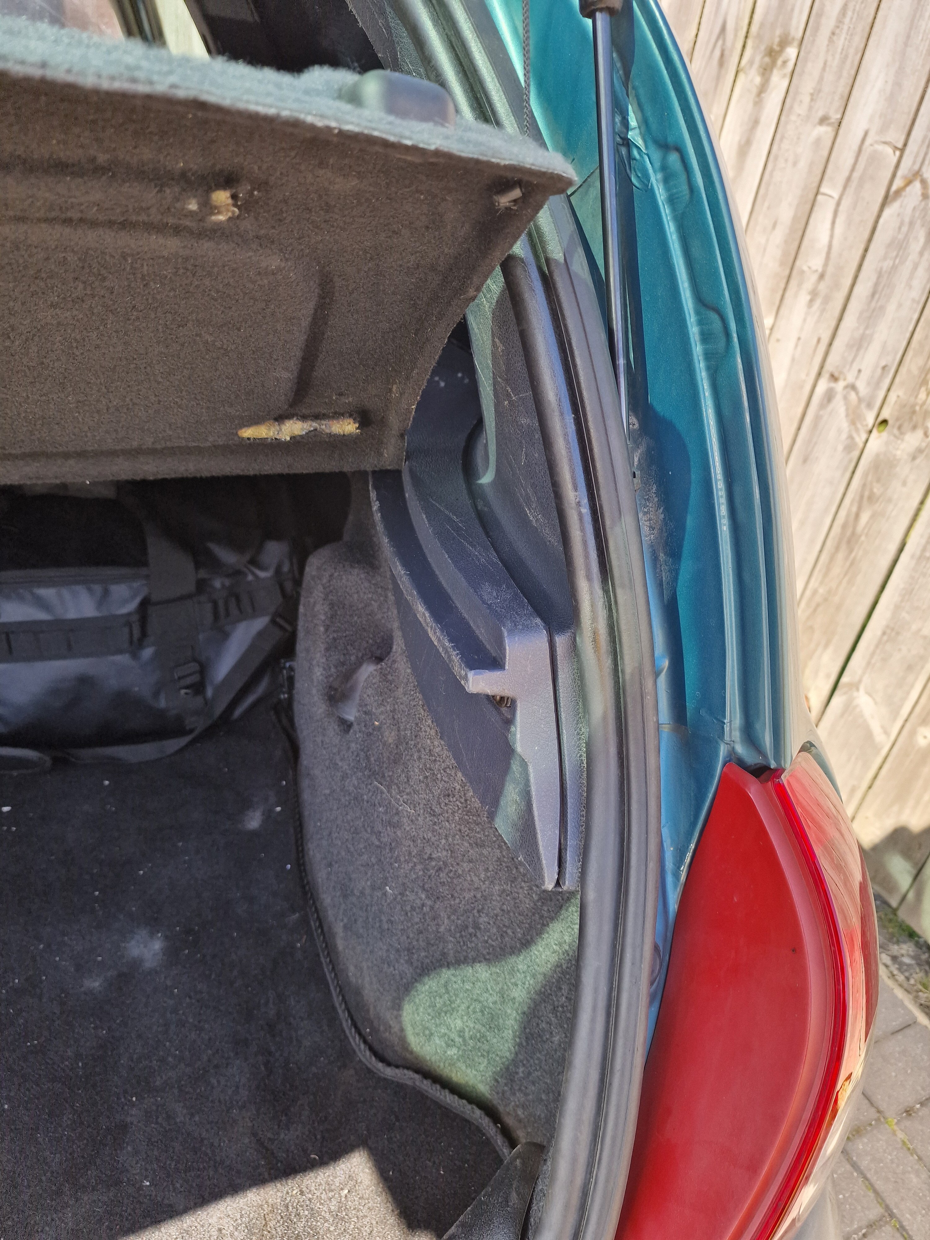

Pre mot checked the blue dci on Sat. Quick jack up and all looks good, floorpan etc in really good nick for a 22 year old clio used in all weathers. Not much to note, front tyres need changing sooner rather than later, whilst in the air i greased the brake pipes and selecror bush, front brakes were squeaky so deglazed/chamfered the pads, half hours work. Should be ok for a clean pass come mot time in a week or so.

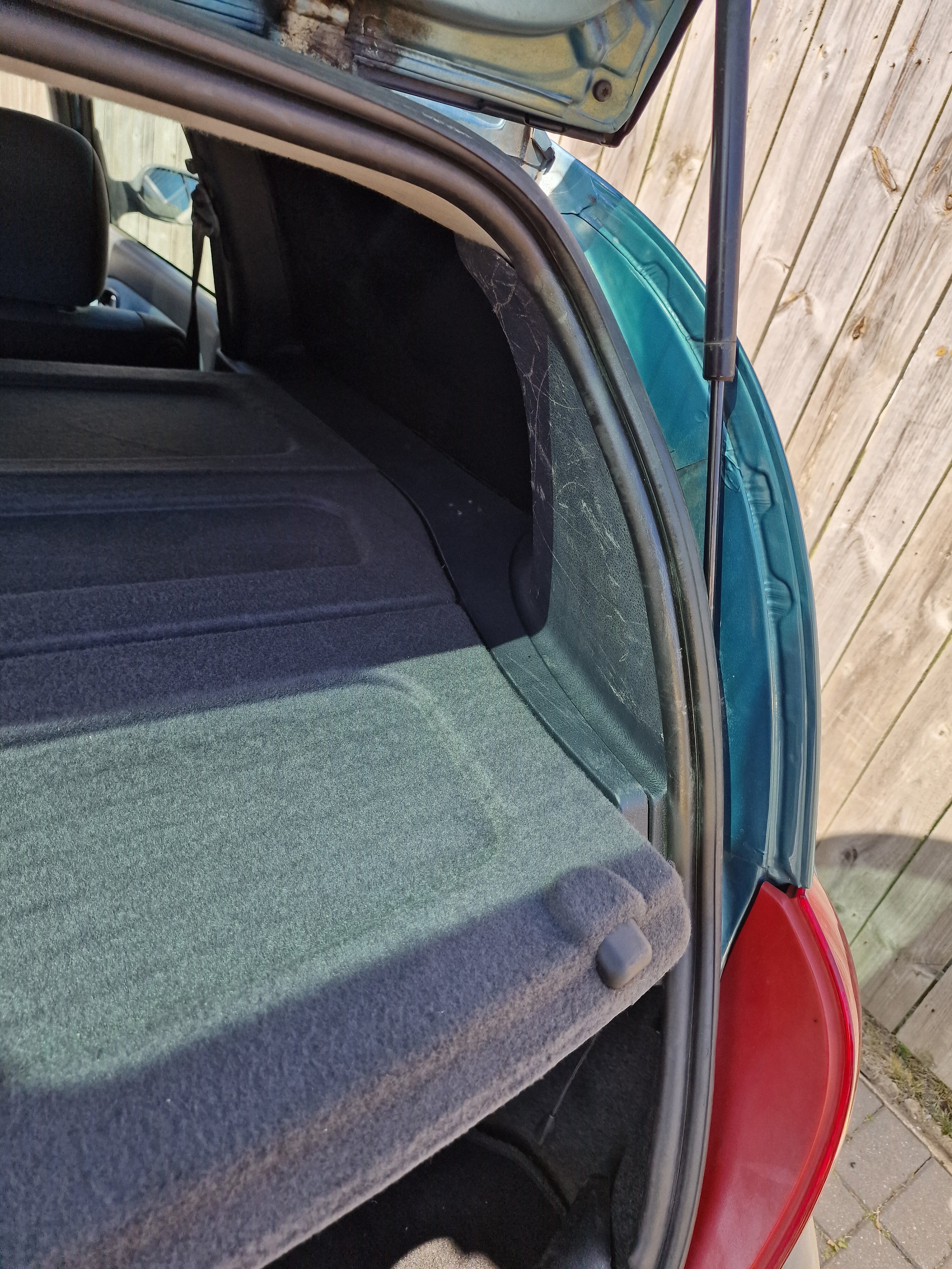

In other news i got an oem renault boot flexi liner. Its listed for clio2 and other models of the era.
Renault oem accessories.
Tried it out today as doing a tip run. With it being a one fits all, it kind of fits where it touches but not bad overall.
2mins work to chuck it in, stops the back getting coated in s**t.
Cost £7 so worth a buy. After tip run there was loads of grass shavings on it, quick dust off and back in the bag and no cleaning needed.
Current mileage of today, 204125.
Thanks for reading!!
