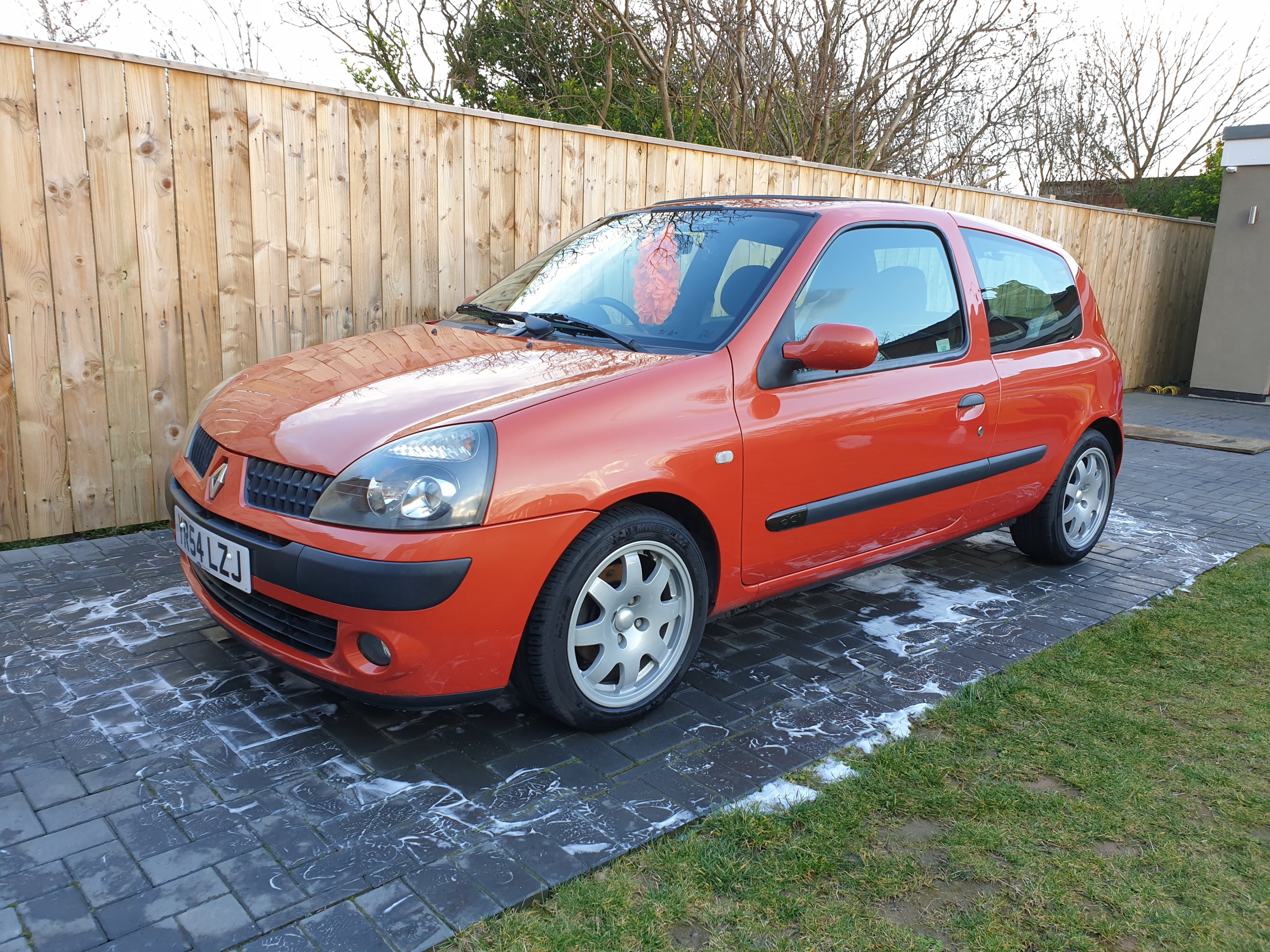

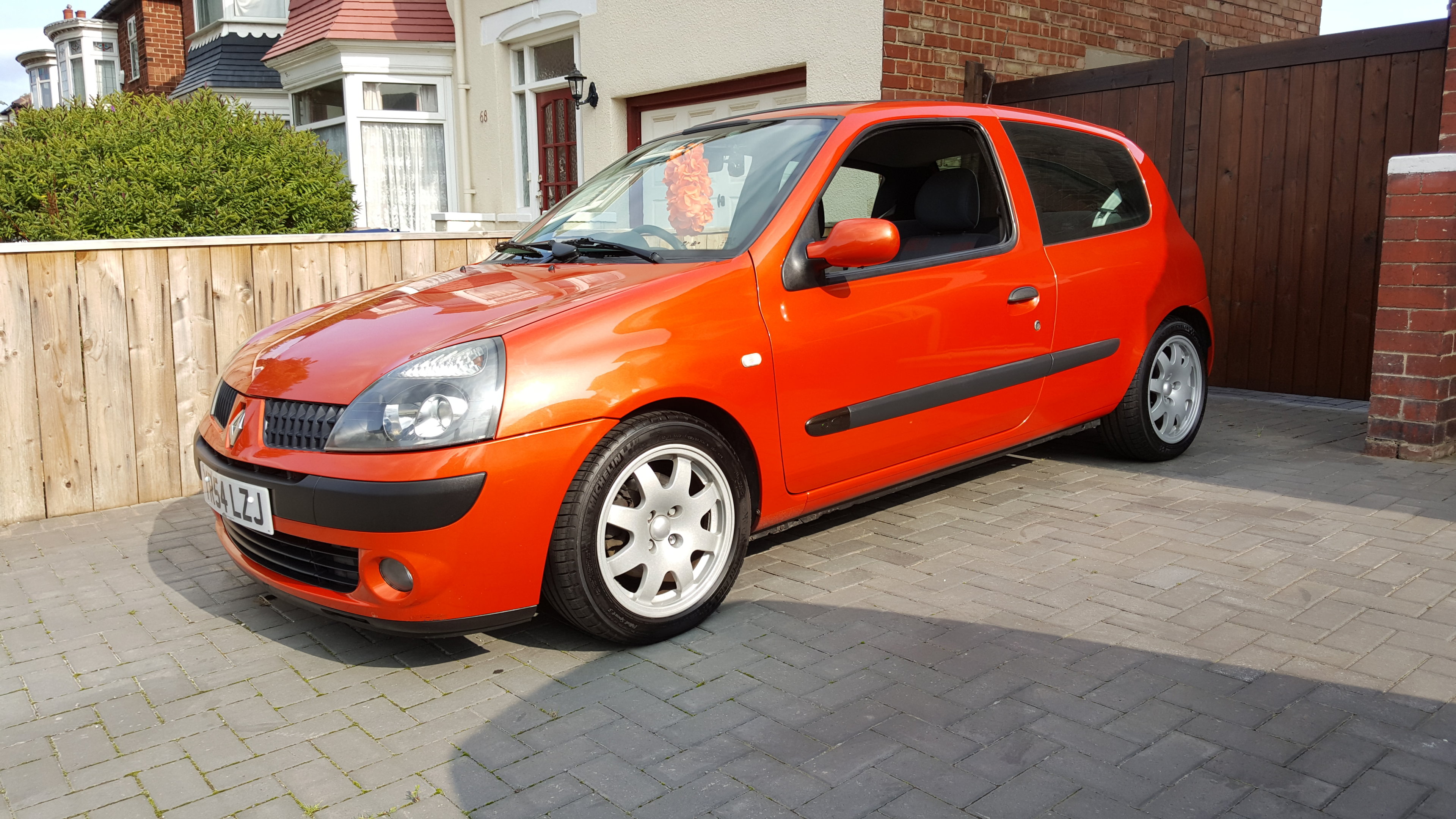

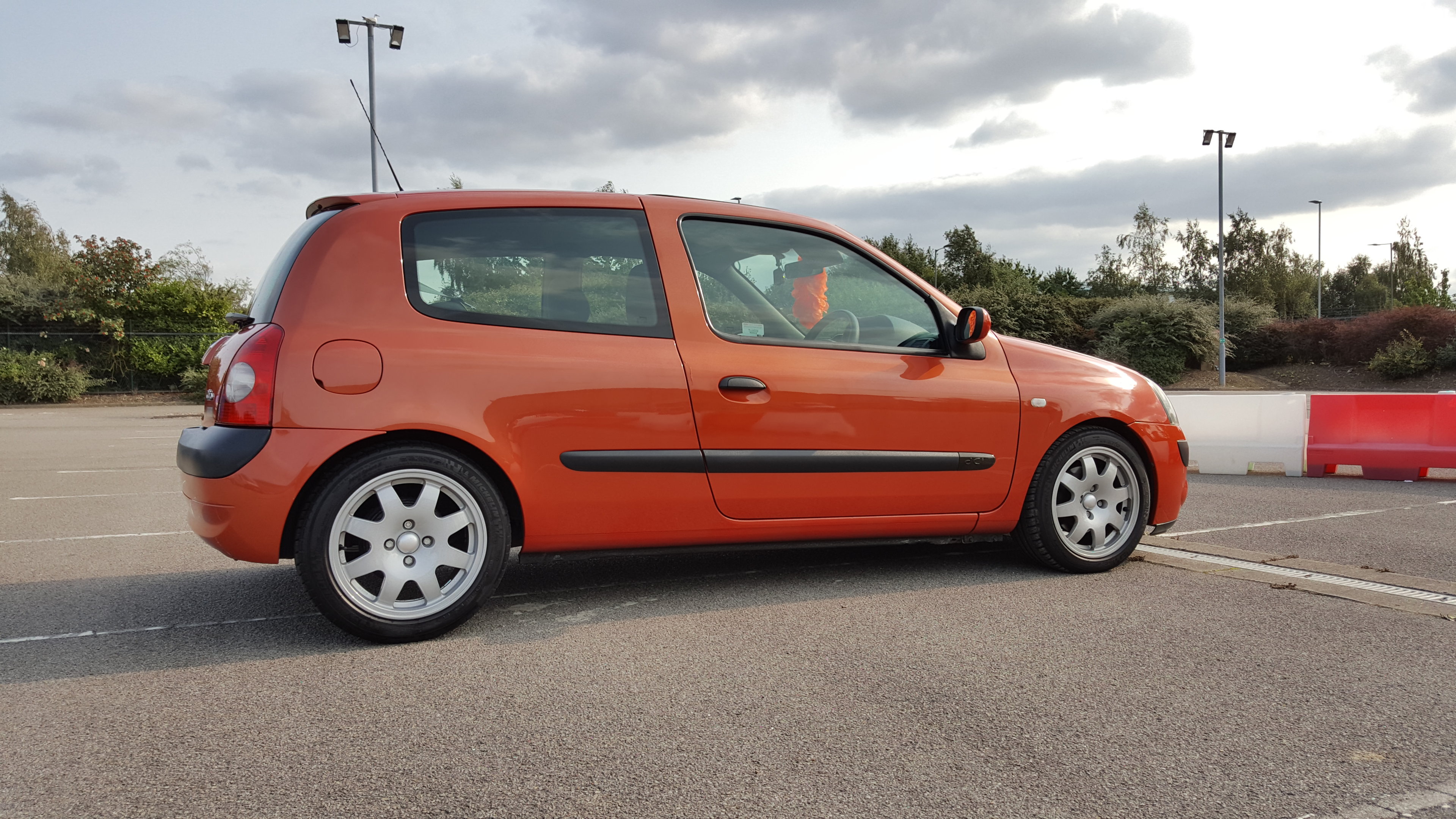

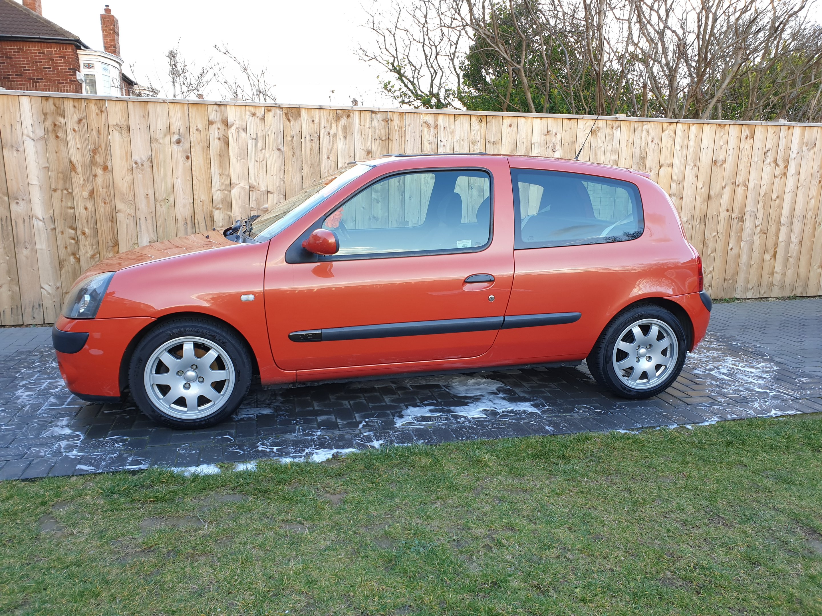

Daily dci was starting to look a little unloved as not been cleaned for at least 8 weeks. Give it a wash, quick decontamination, polish with SRP by hand and a coat of Finish Kare 1000p wax. Trims had a quick coat of AG bumper gel on as thats all i had in stock, need to get some more gtechniq c4 to keep them looking fresh for longer.
Its no minter but cleans up great for 140k on the clock. 60+mpg everywhere and £30 a year tax its basically free motoring !

Never seen one in that colour. Looks very nice!
Cheers mate. They used to be a few the same colour around here but most have dissappeared. I always think of it as the povo spec inferno

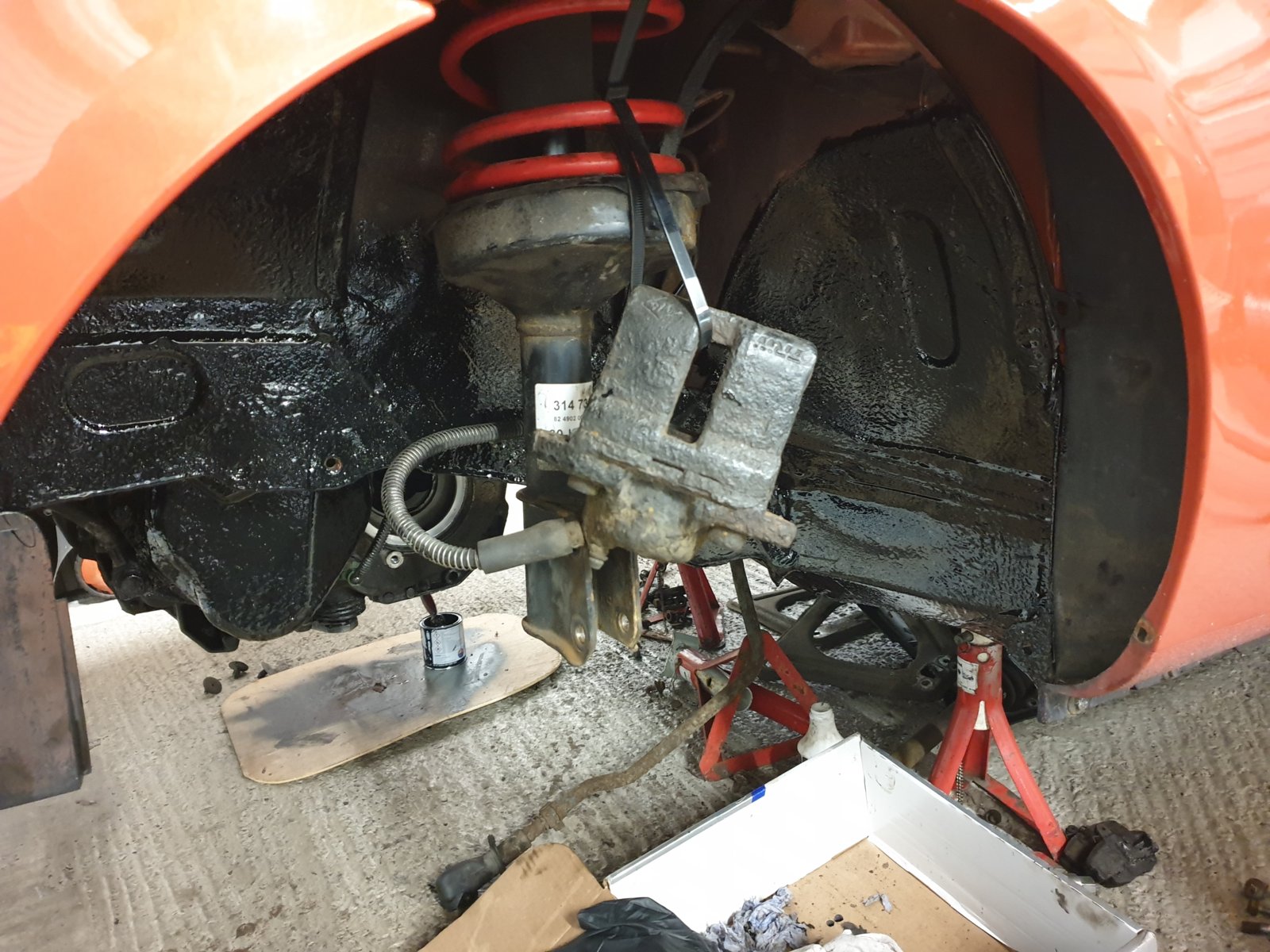

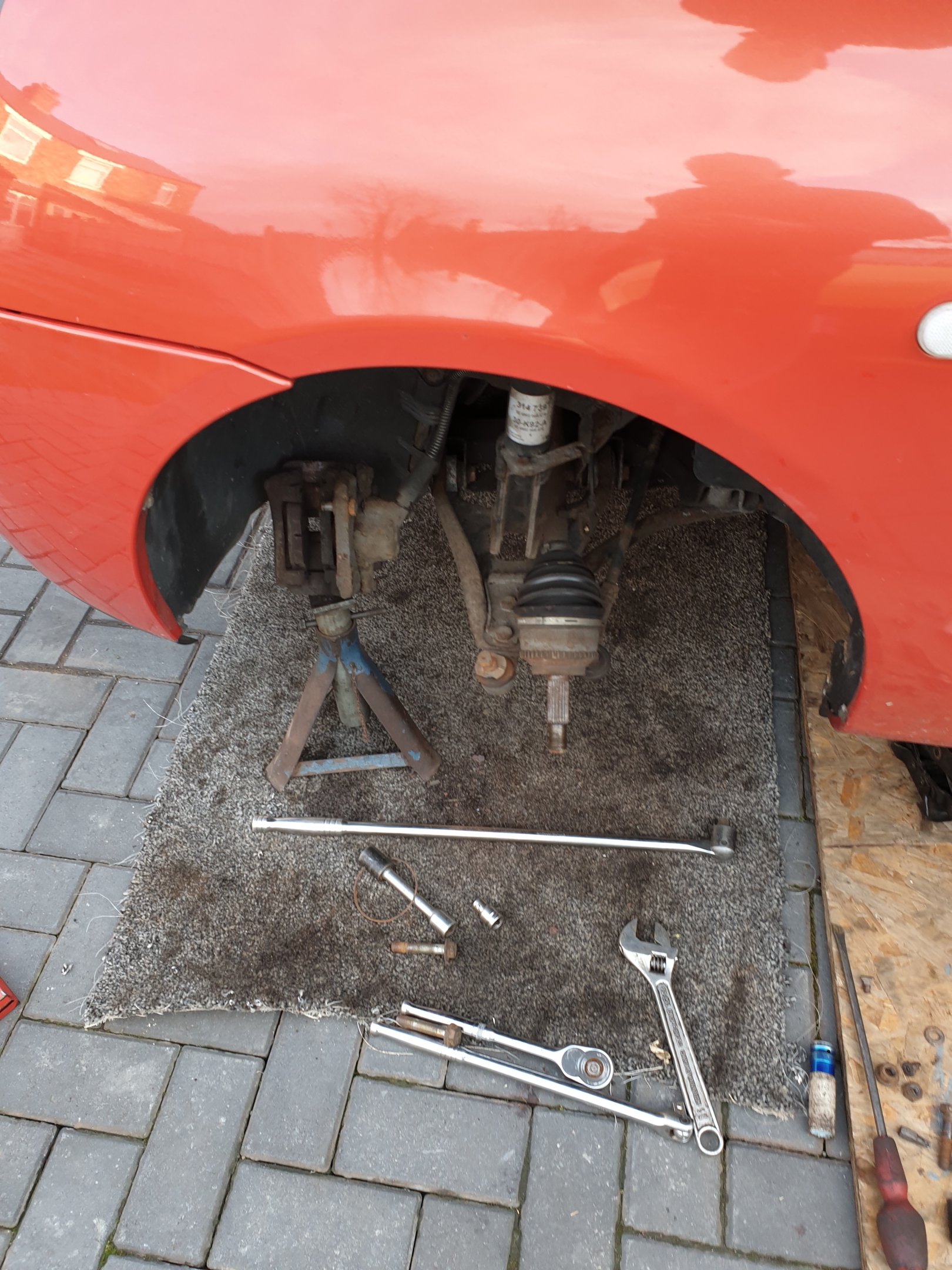

Been a bit neglected recently as loads on. A few weeks back a front wheel bearing started making mega noise so has not really moved for past few weeks. All the other cars are sorn for winter and with only the Kangoo on the road (or off when it breaks ?) and mot runs out soon thought i best put some effort in and get it sorted before im walking everywhere in shite weather?

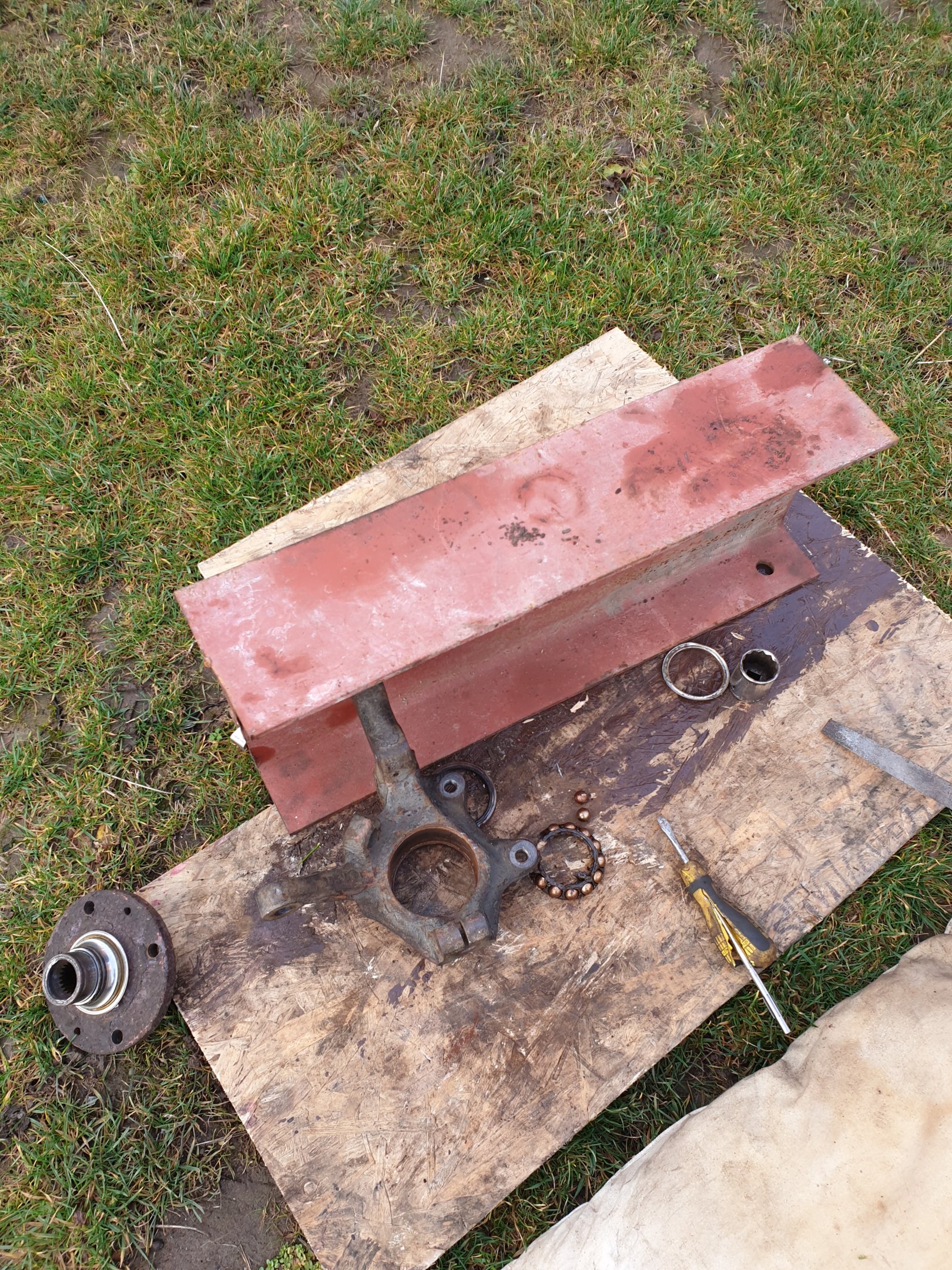

First up both front wheel bearings. Passenger side was shot, no play but no grease. Drivers not far off
Stripped

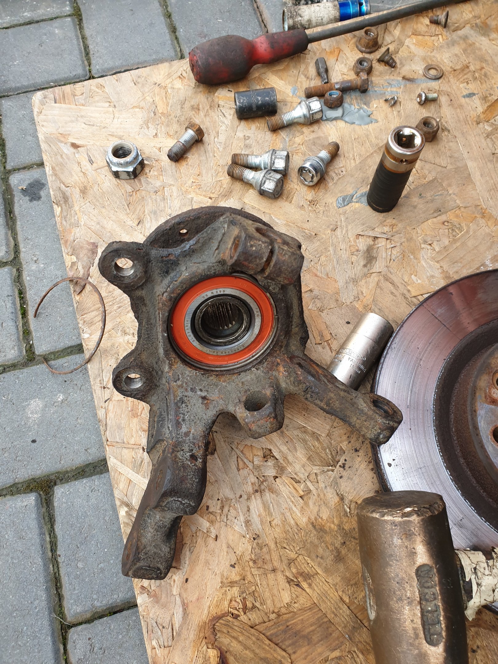

Big hammer to get the bearing casing out. Grinder on the inner race on the hub until almost through then split with a chisel
New bearings pressed in with my 20ton press in the garage. Bought a pair of FAG quality bearings, listed for Dacia Sandero as cross referenced part number which worked out cheap as chips
Refitted and coated everything with Acf50 for a bit of winter protection

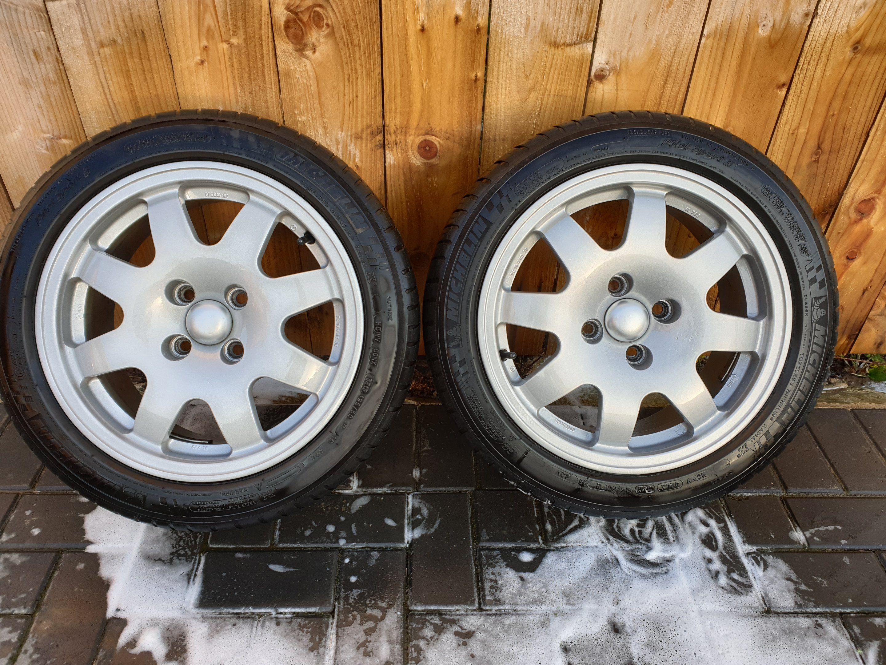

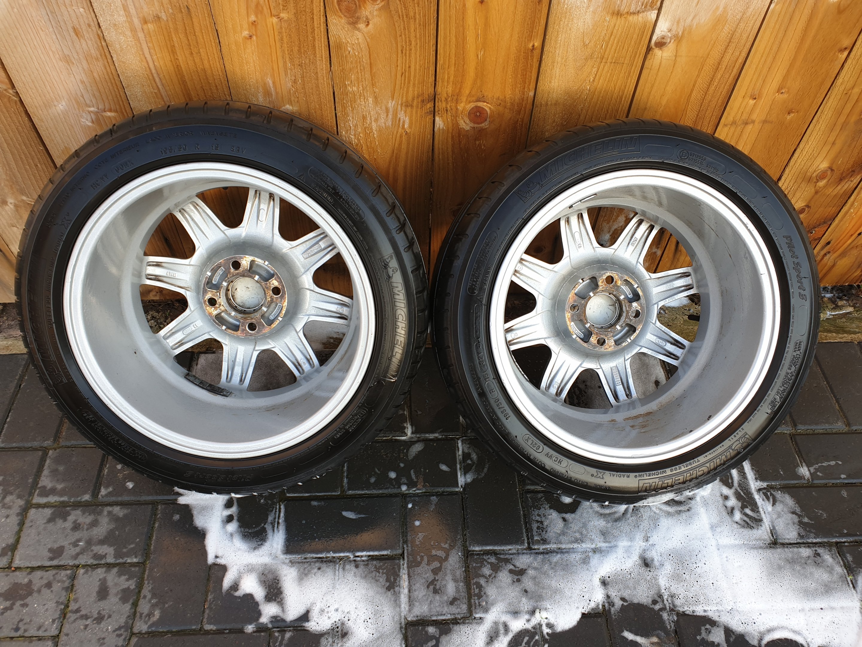

Cleaned wheels with Bilt Hamber Korrosol inside and out as they are rarely off. Prepped and powdercoated them myself a few years back still holding out ok. Quick coat of gtechniq c2 liquid crystal on them as too cold/damp to seal properly

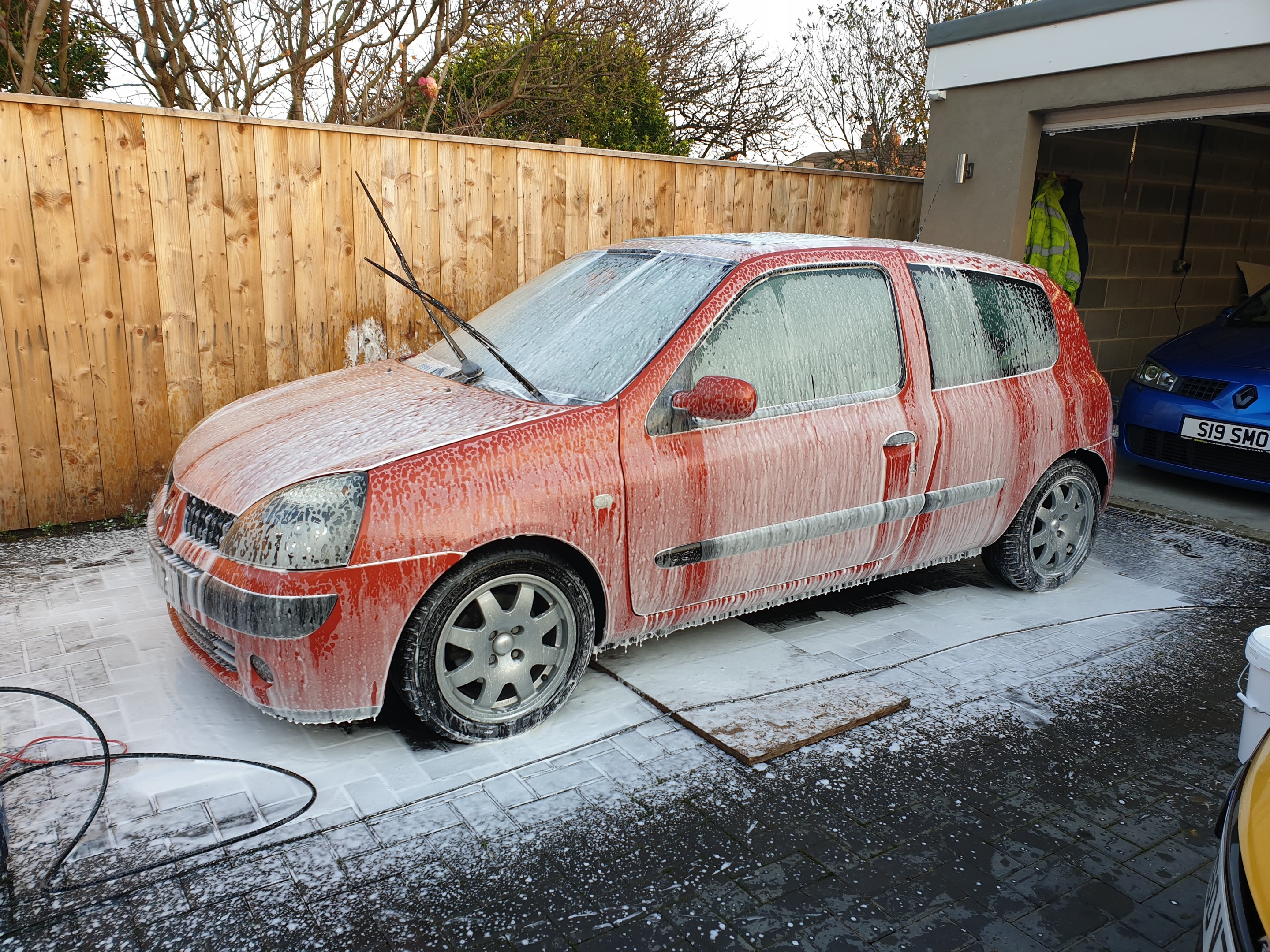

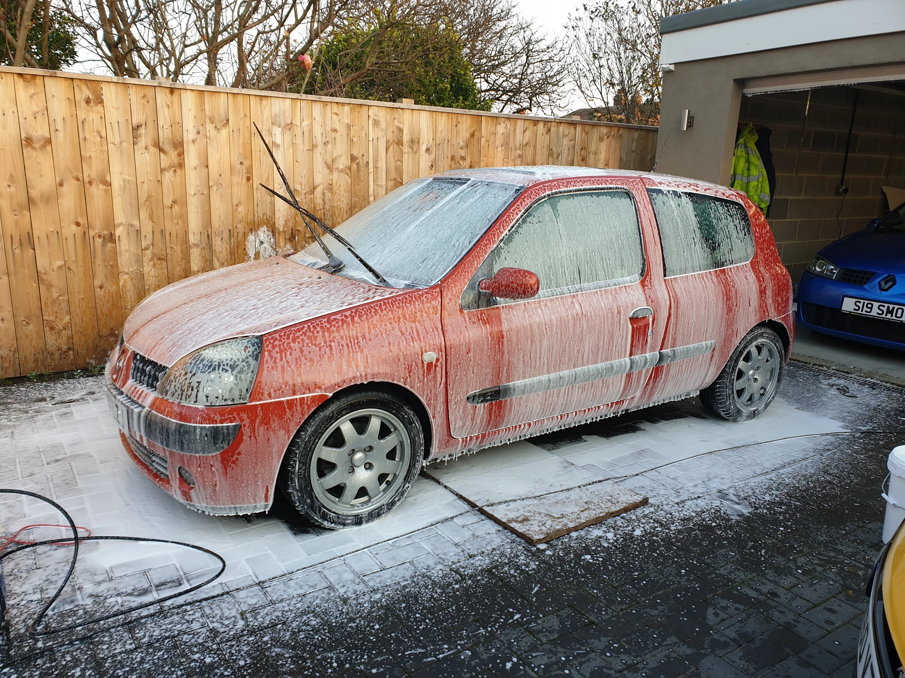

With the wheels looking good the bodywork needed a wash badly. AG avalanche followed by 2 bucket wash. Too damp to dry or add any qd so can wait until next time.

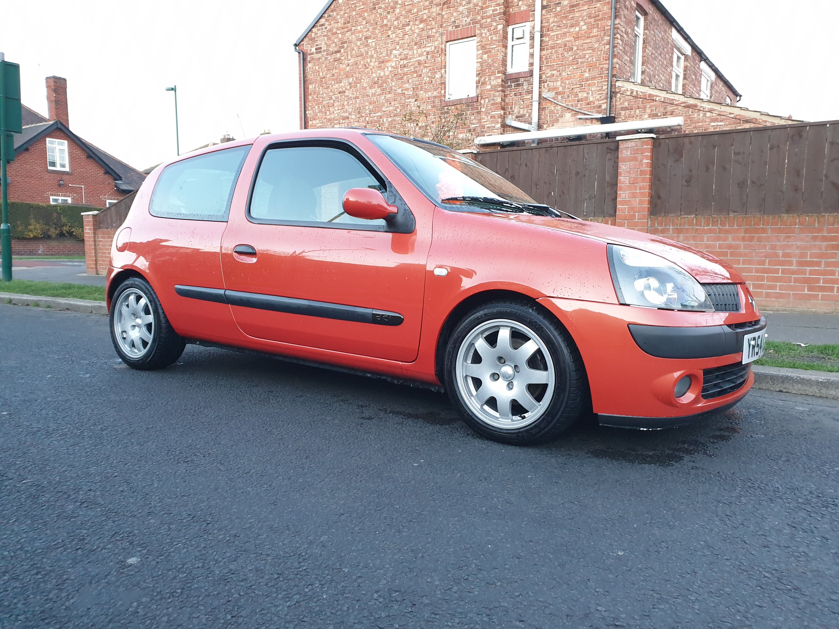

Still comes up epic for £80 gumtree buy. All done and dusted 3.5 hrs work and drives great again. Bargain motoring costs nothing to run or fix !

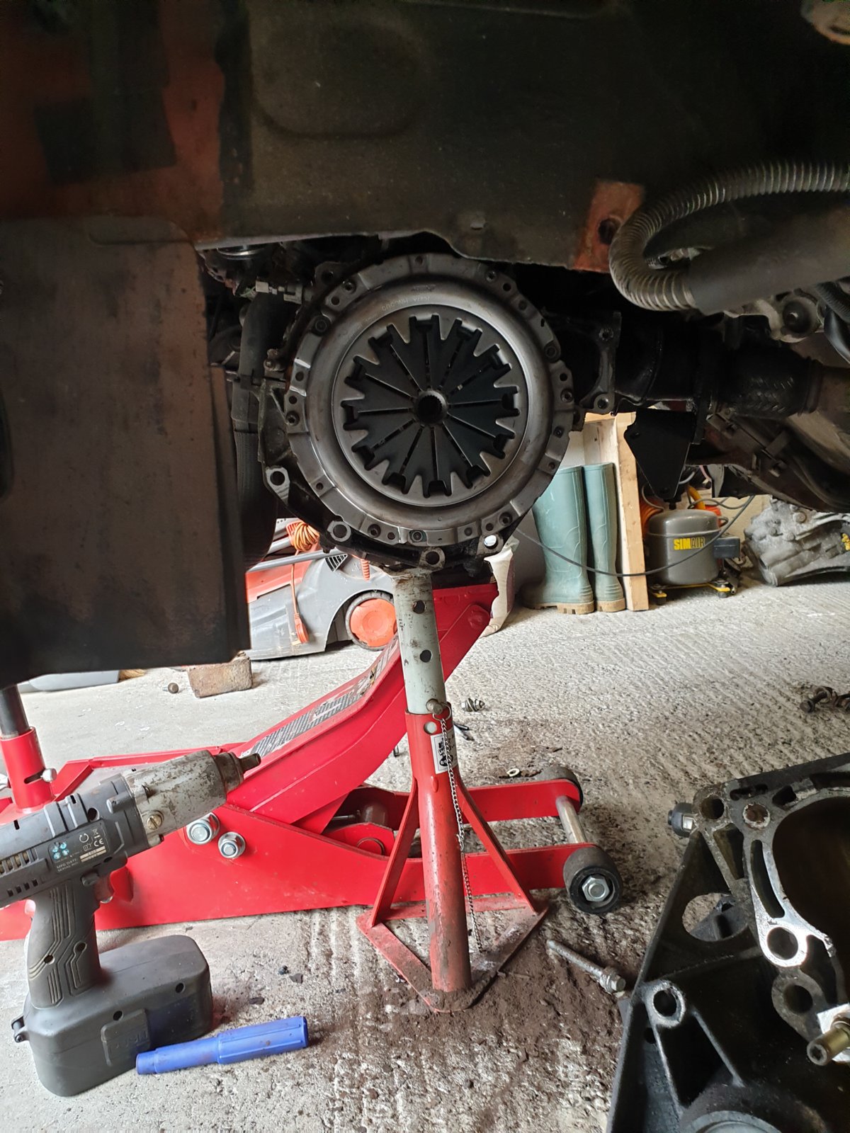

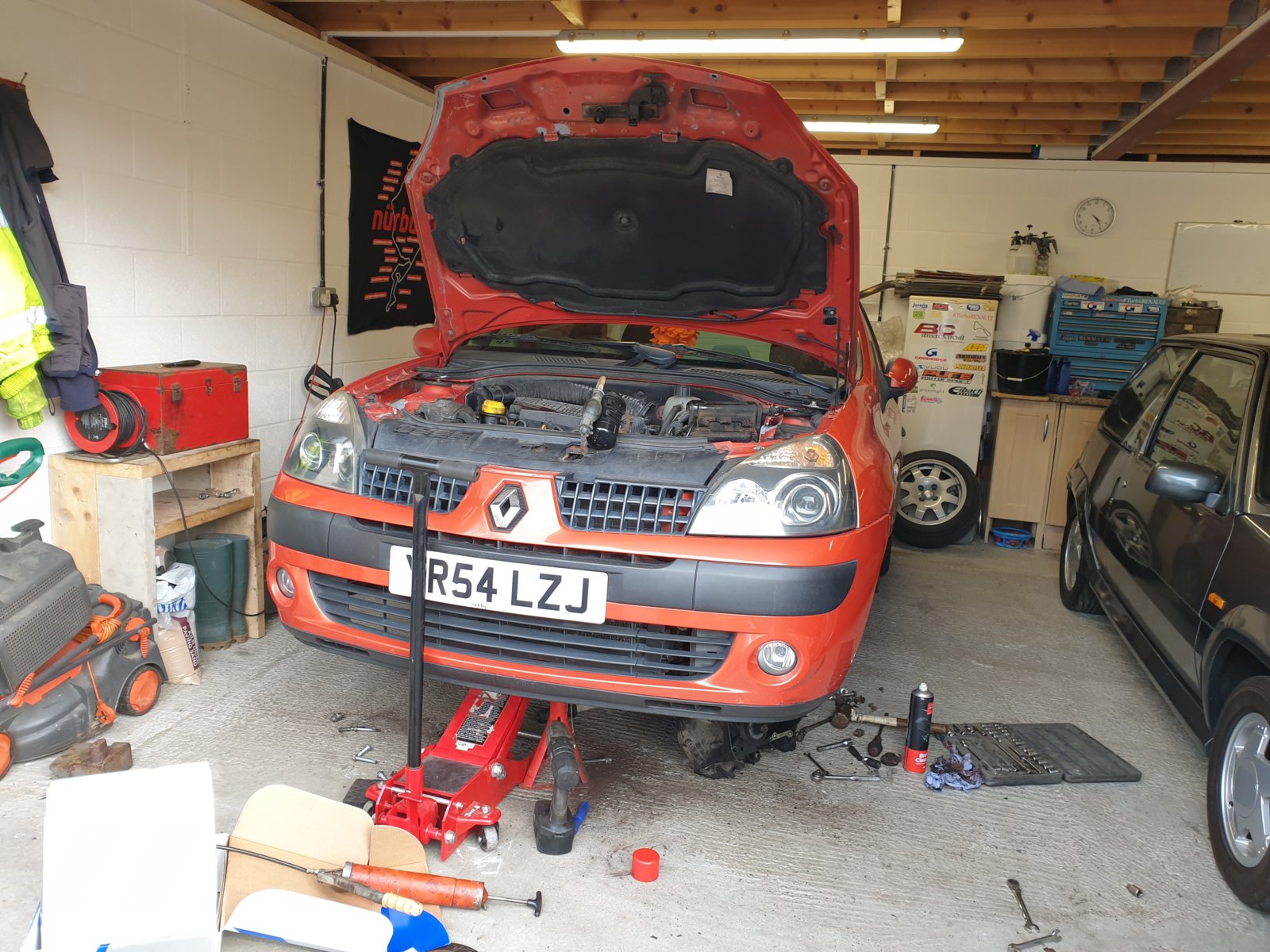

Made a start on the clutch change on Friday as gearchange was starting to become difficult & need to use the car for work in the next few weeks.

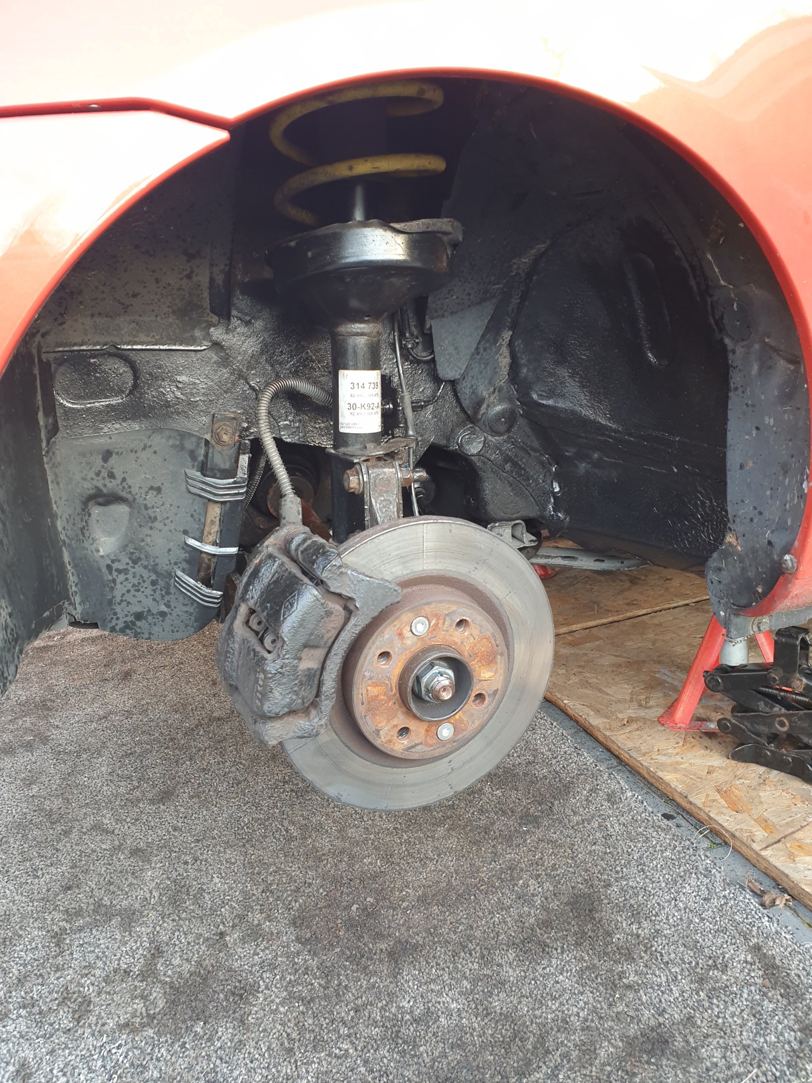

Subframe off and box off, all bolts as rusty as expected
New clutch in, old one almost down to the rivets

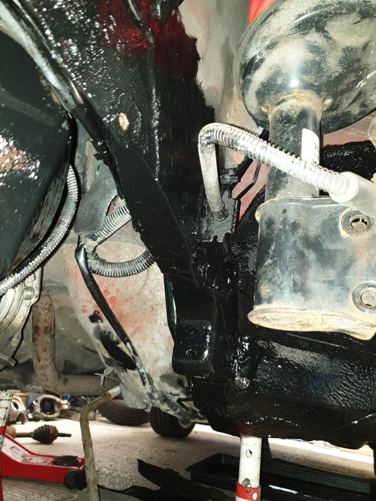

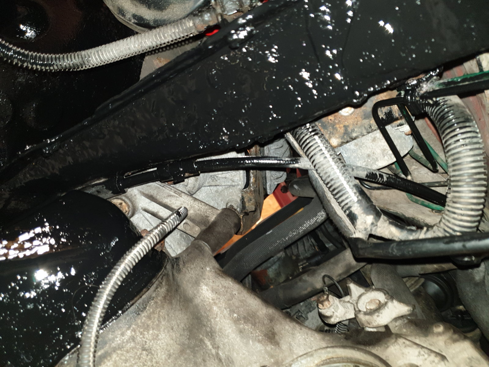

Give the chassis rails a quick de rust and paint, as quite a lot of surface rust. Still expected for a 15 year old car, should last a few more years

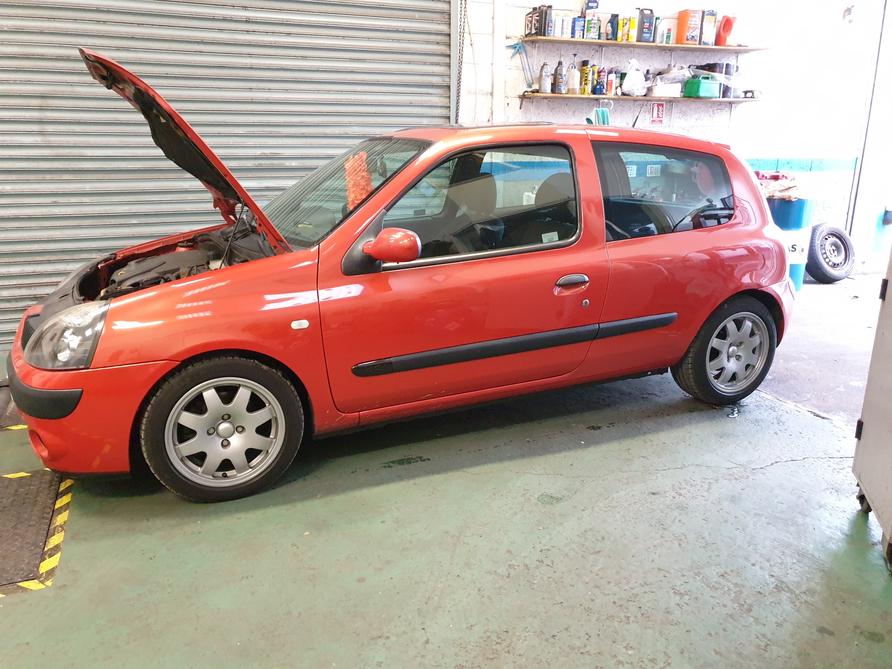

All done and dusted earlier on ths week, new clutch feels awesome, mega light should have done it years ago. Had toe set yesterday too so good to, go for plenty of miles.
