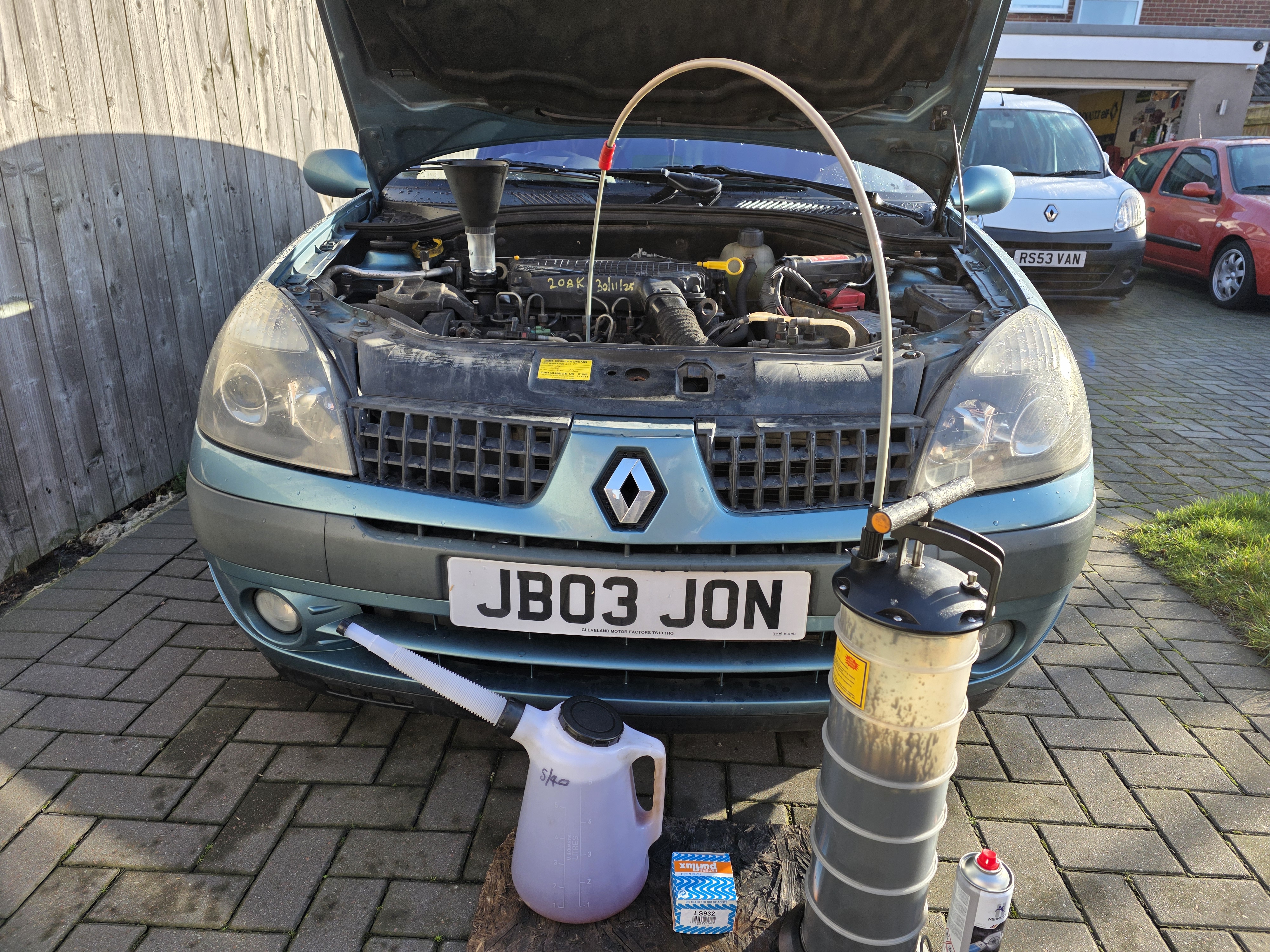

Both dci's washed on Thursday. Rinsed using the di vessel, great finish with no watermarks.

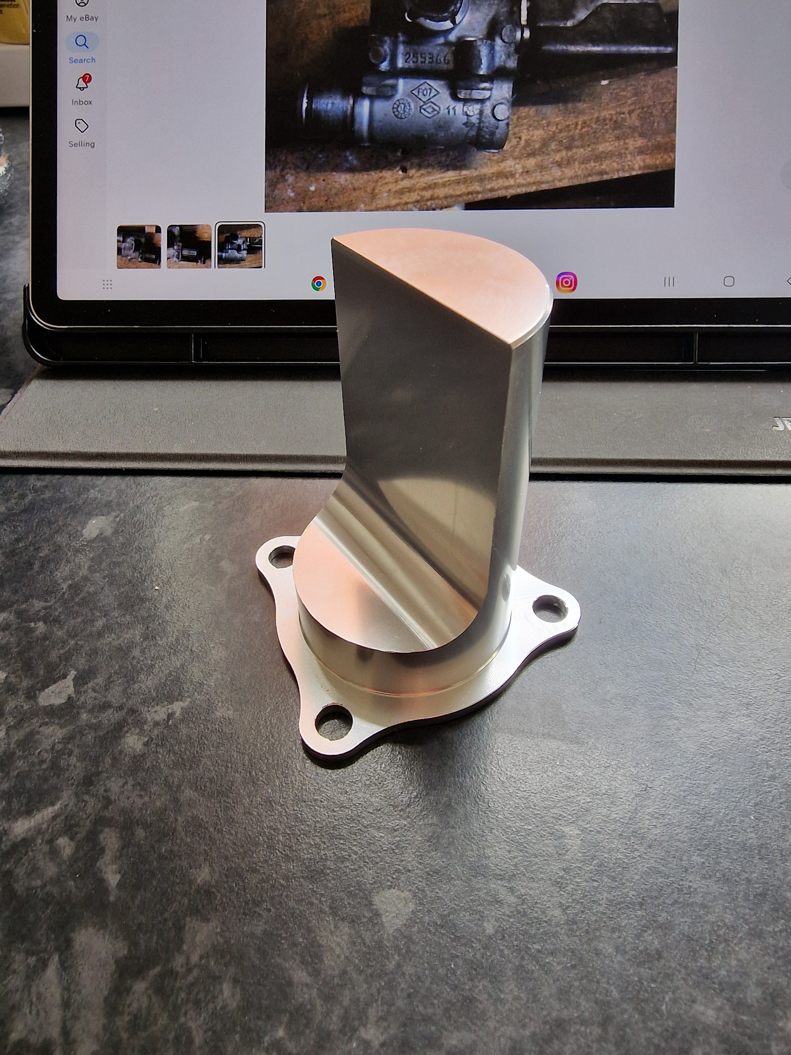

Also picked up a cheapo trafic/vivaro 1.9dci egr delete to try. The egr is more or less identical on the trafic so might go, ill have a look at it one day soon.

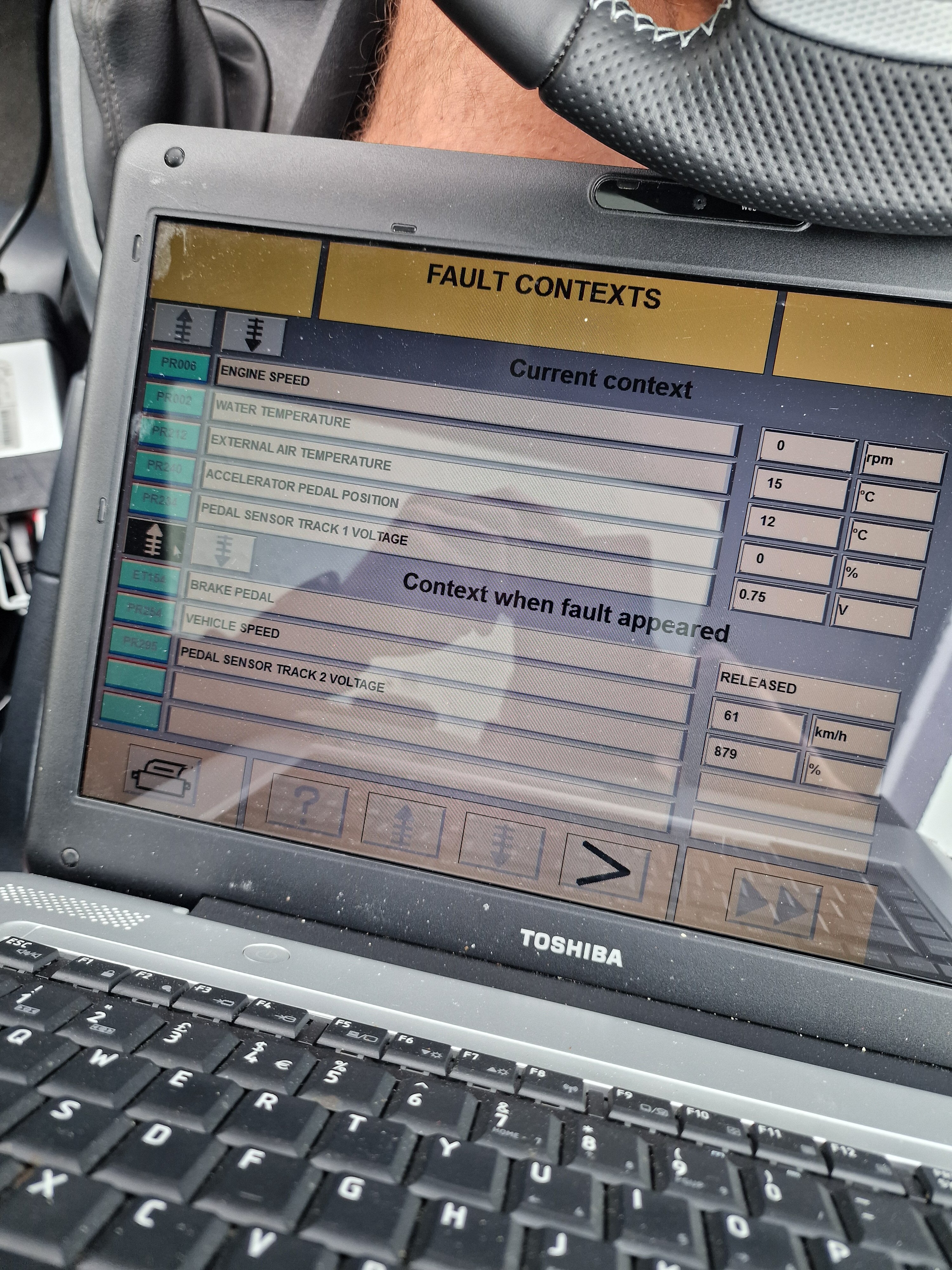

Mrs has been using the orange dci a bit. It chucked eml on briefly last time she used it which as expected was throttle position sensor track 1 Df071.
Apparantly it was reading 879% on track 2 :LOL: ill have a look at wiring etc soon.

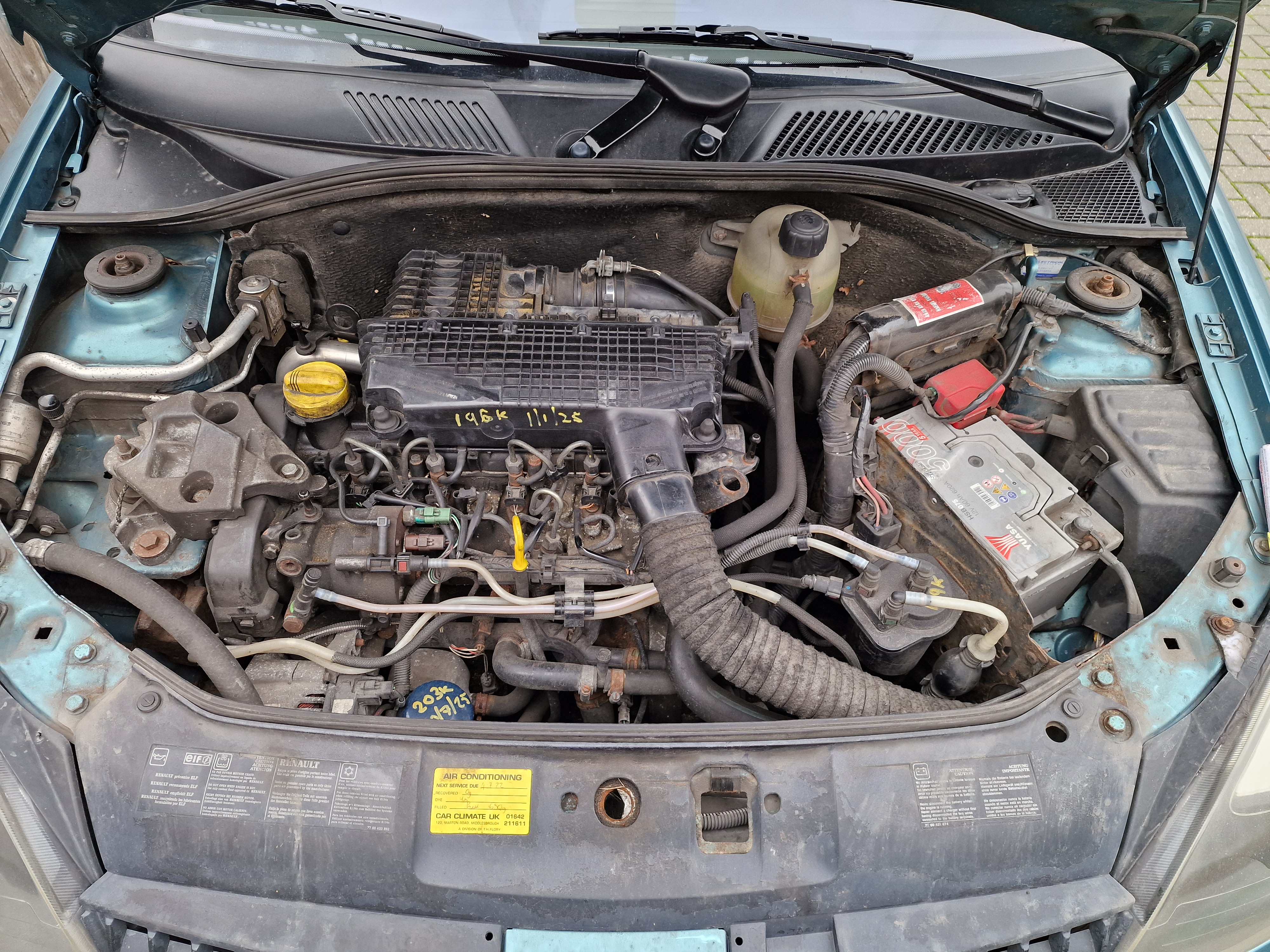

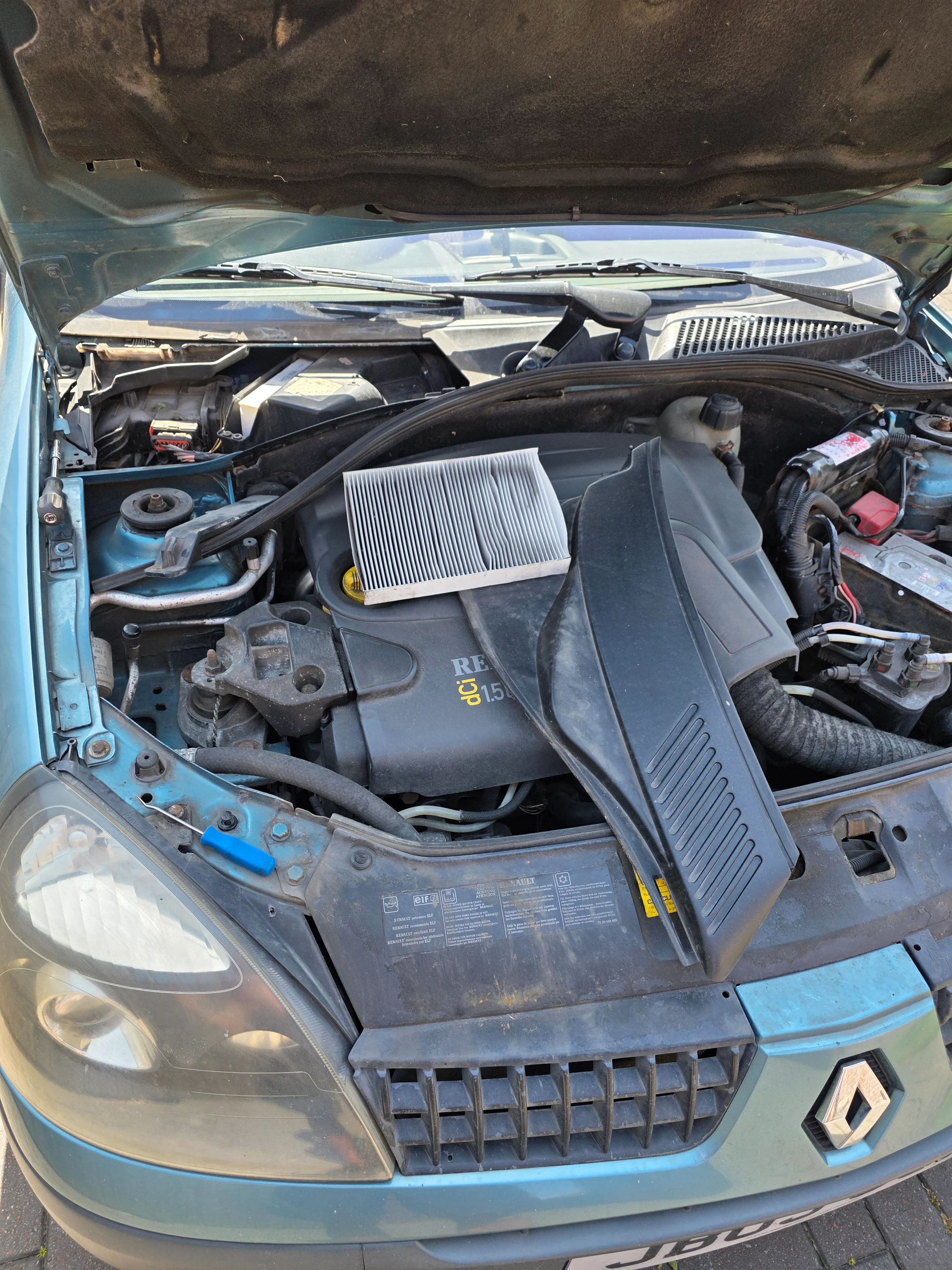

Give the blue dci egr a once over on Sunday as looks a bit more black smokey than usual. Ten min job to remove and examine, looked pretty clean so straight back in. Offered up the egr blank whilst apart, it seemed to be a loose fit and i could imagine it leaking so sacked that off..original egr working is good enough.

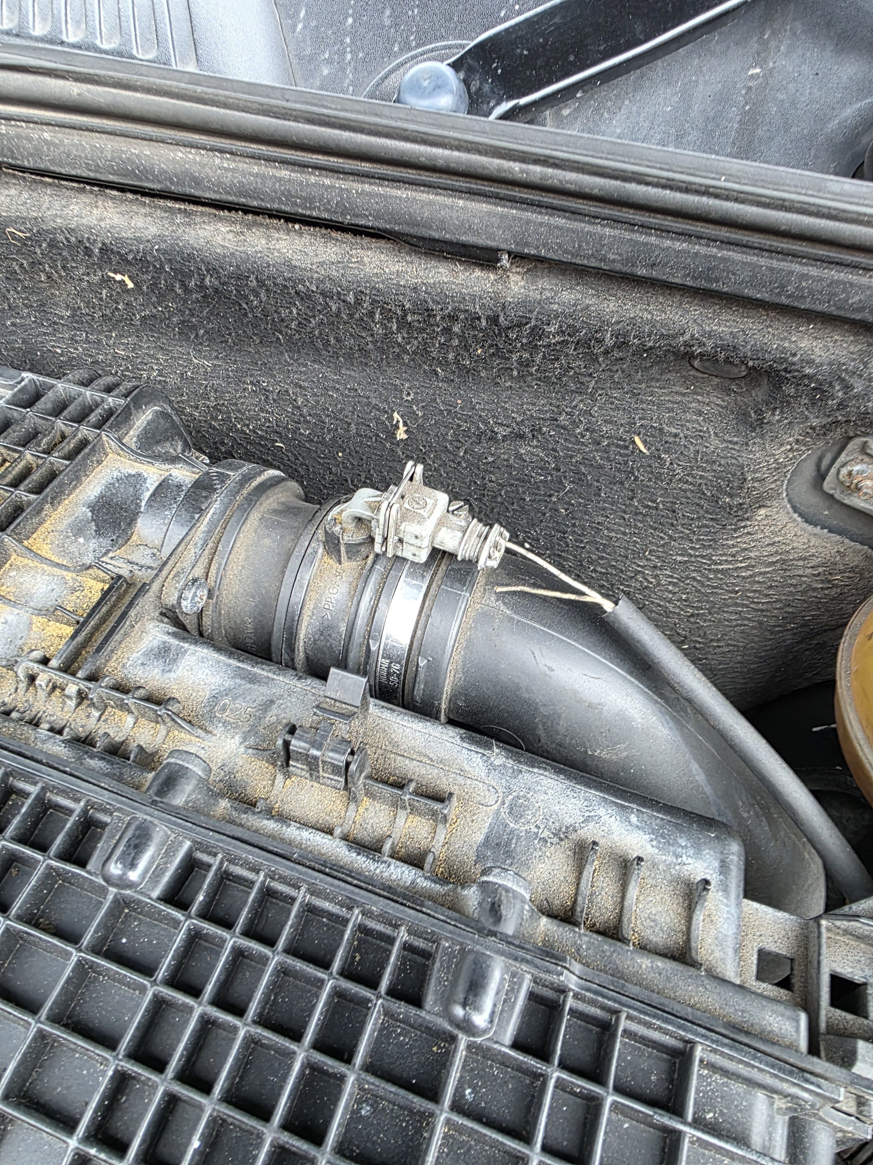

Whilst there i changed the airbox for one that @Martin_172 kindly donated. My airbox was well worn round the induction pipe and was causing noise/resonation on overrun and reversing when engine was loaded. The new airbox was in much better condition so fitted that and the new induction pipe that was also in good nick. This cured all airbox rattles and the engine sounds loads quieter.
Airbix fitted, its no show winner under the engine cover😄
Have also ordered cambelt kit, water pump and aux kit. Cambelt has done 64k so its about due. Xmas job, when i get a spare half day.

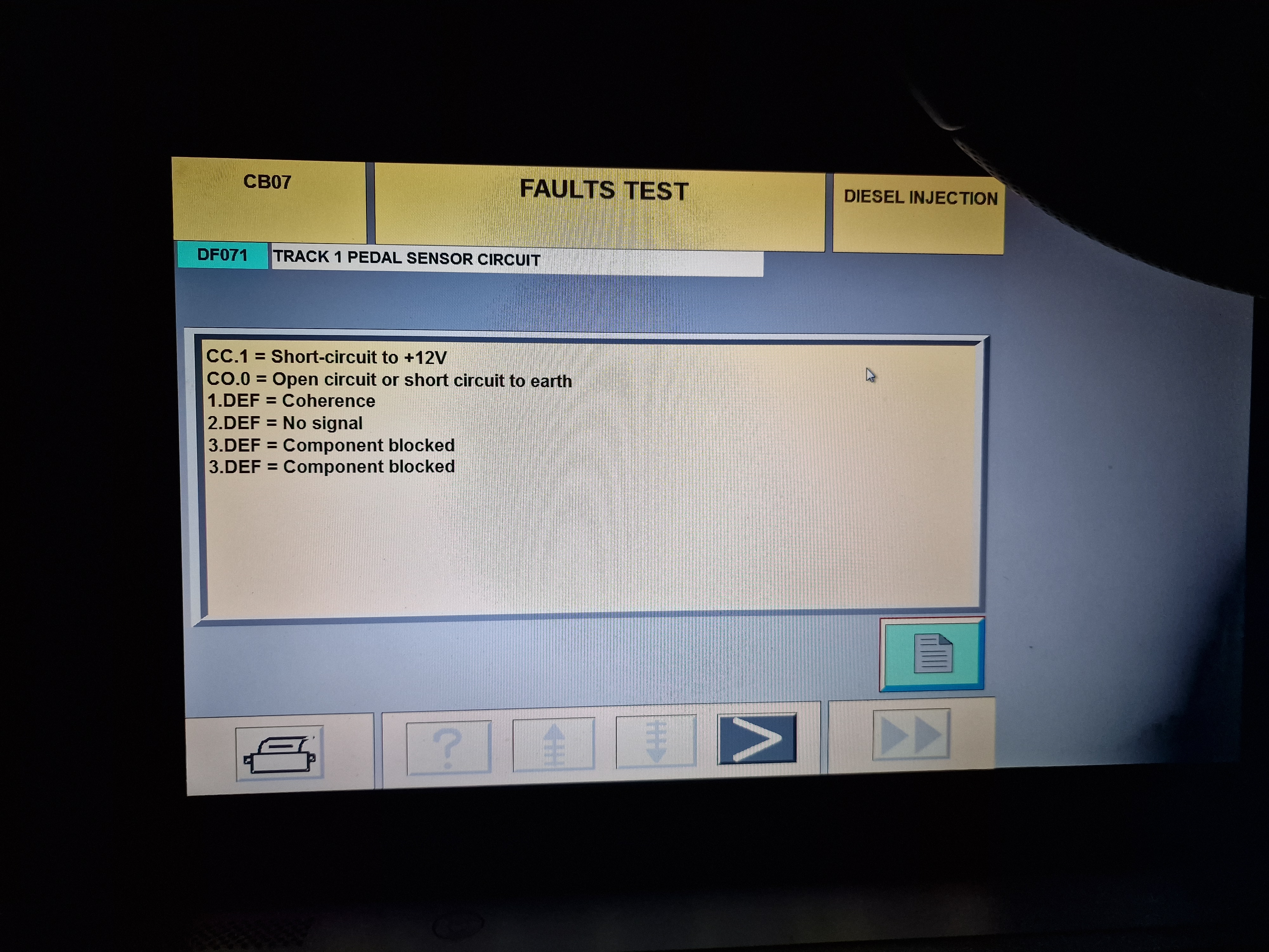

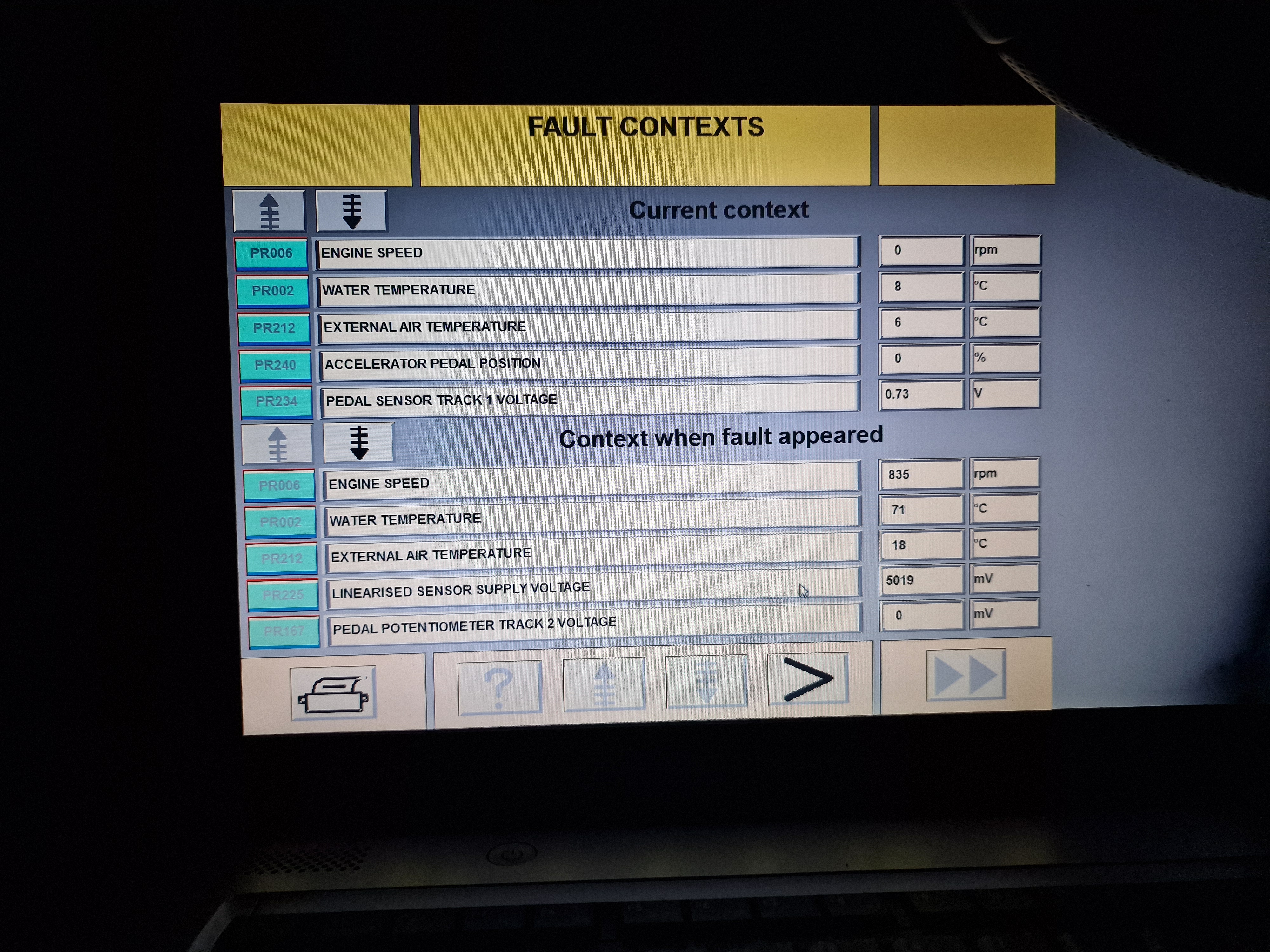

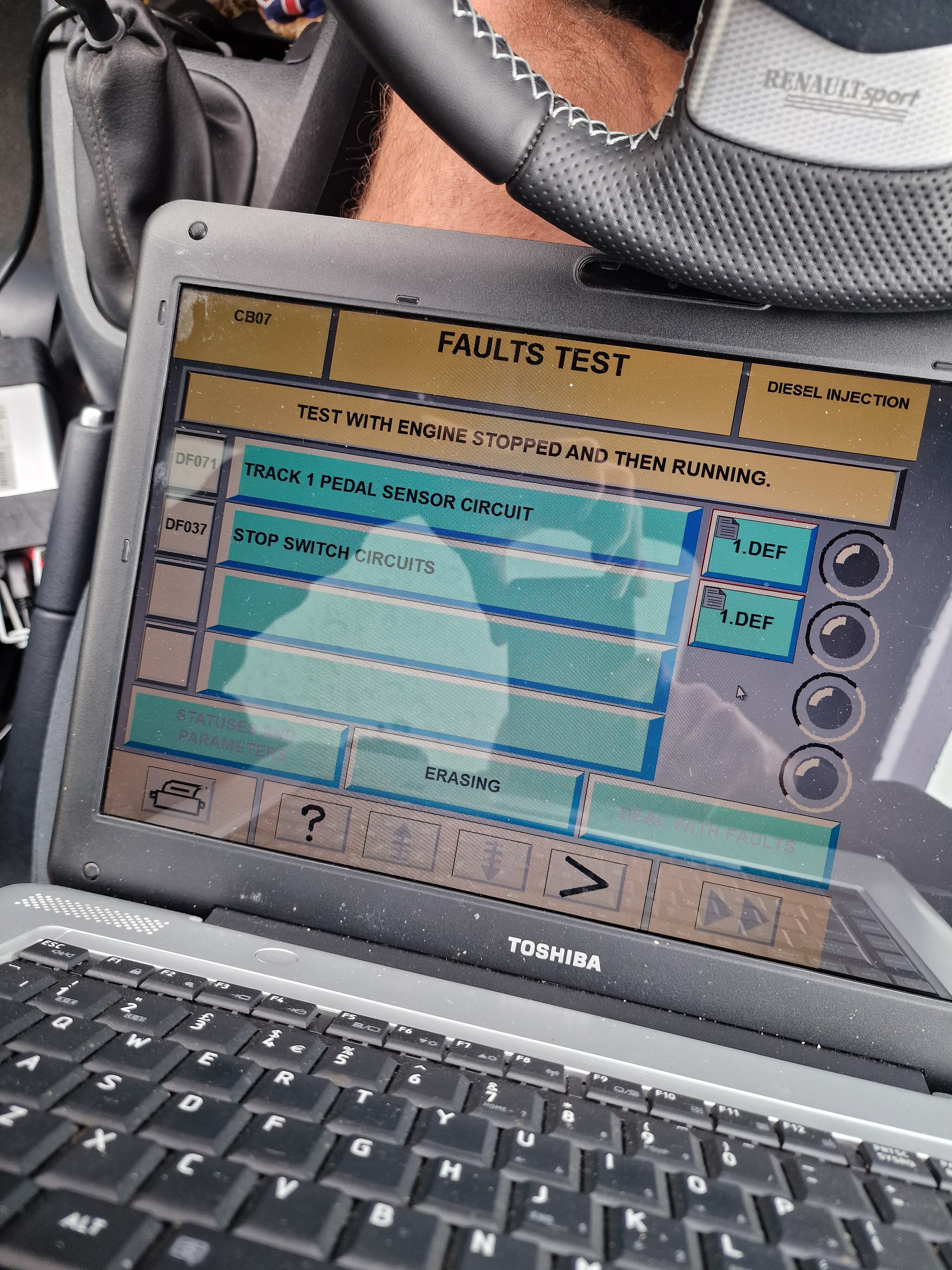

Orange clio is in the mrs bad books. She used it the other day and the pedal/limp fault was present for most of the journey..best get it fixed soon or there will be hell on😄
Ive ordered a replacement pedal, will try that first. If no joy, i have an old 182 interior loom to chop the wiring out of to replace bits, and ill check out the white plug of doom for corrosion.
Thanks for reading!!
Updates
Mrs was out in the blue clio yesterday and i needed to go out. Id normally jump in the r26 but its got no gearknob on it as its at the trimmers. Rest are sorn apart from the orange dci which is in limp. Best fix it eh!?
Usual fault stored when scanned with clip.
I bought a new accelerator pedal to fit so had the parts in stock, so should be an easy fix. Could i f**k get the pedal/bar off to swap over, my small puller has went awol so give up before it all broke.
With the defective pedal on the bench, i stripped the cover off to see if repairable. Its 5x posi screws and the cover comes off. The tracks on each potentiometer appeared to be worn but not beyond serviceable. I levered the contacts slightly to add more tension, and cleaned everything up and refitted the cover.
Cycled the pedal through a few presses with ign on and all good. Done 30mile or so yesterday and no limp, appears to be fixed. Simple repair, will see if it lasts.

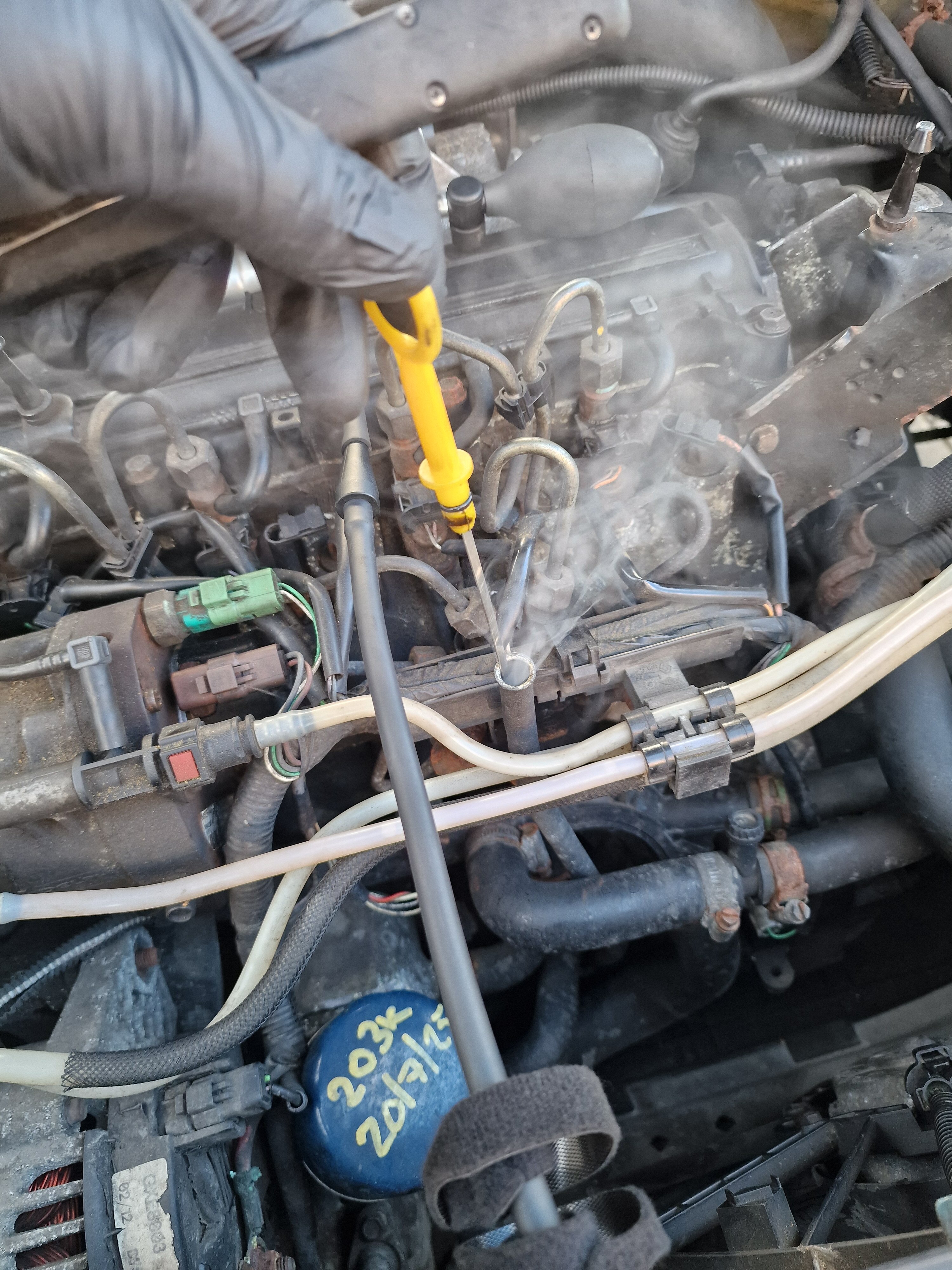

The blue dci seemed a bit slower and black smokey recently, bit intermittent as sometimes fine. Not sure if it was actually slower or felt slow after a week of driving the r26 fast as fcuk everywhere at Spa/Germany, but yeah thought it was worth a quick look at.
Stuck torque on it and noted it was making boost ok but bit lazy getting there. Basically when i changed the turbo a while back, i noted boost pressure was a little lower but never done anything about it as its no rocketship.

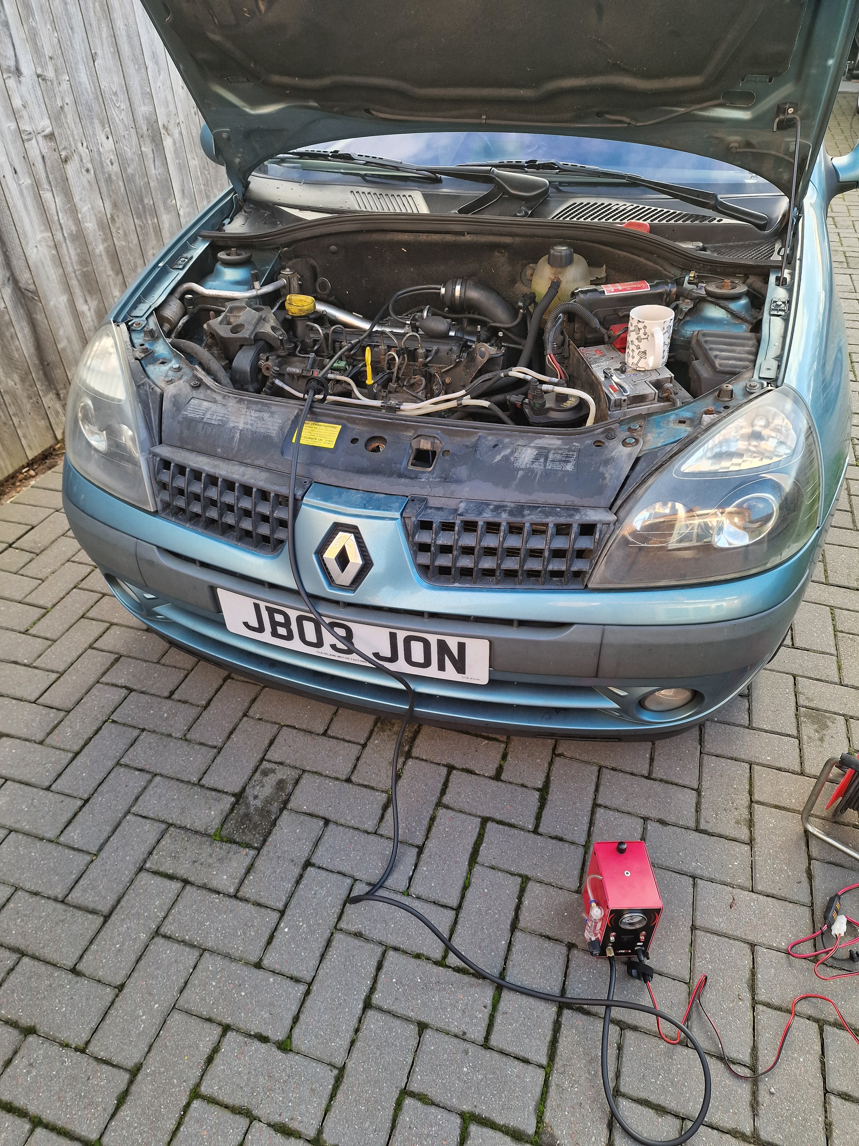

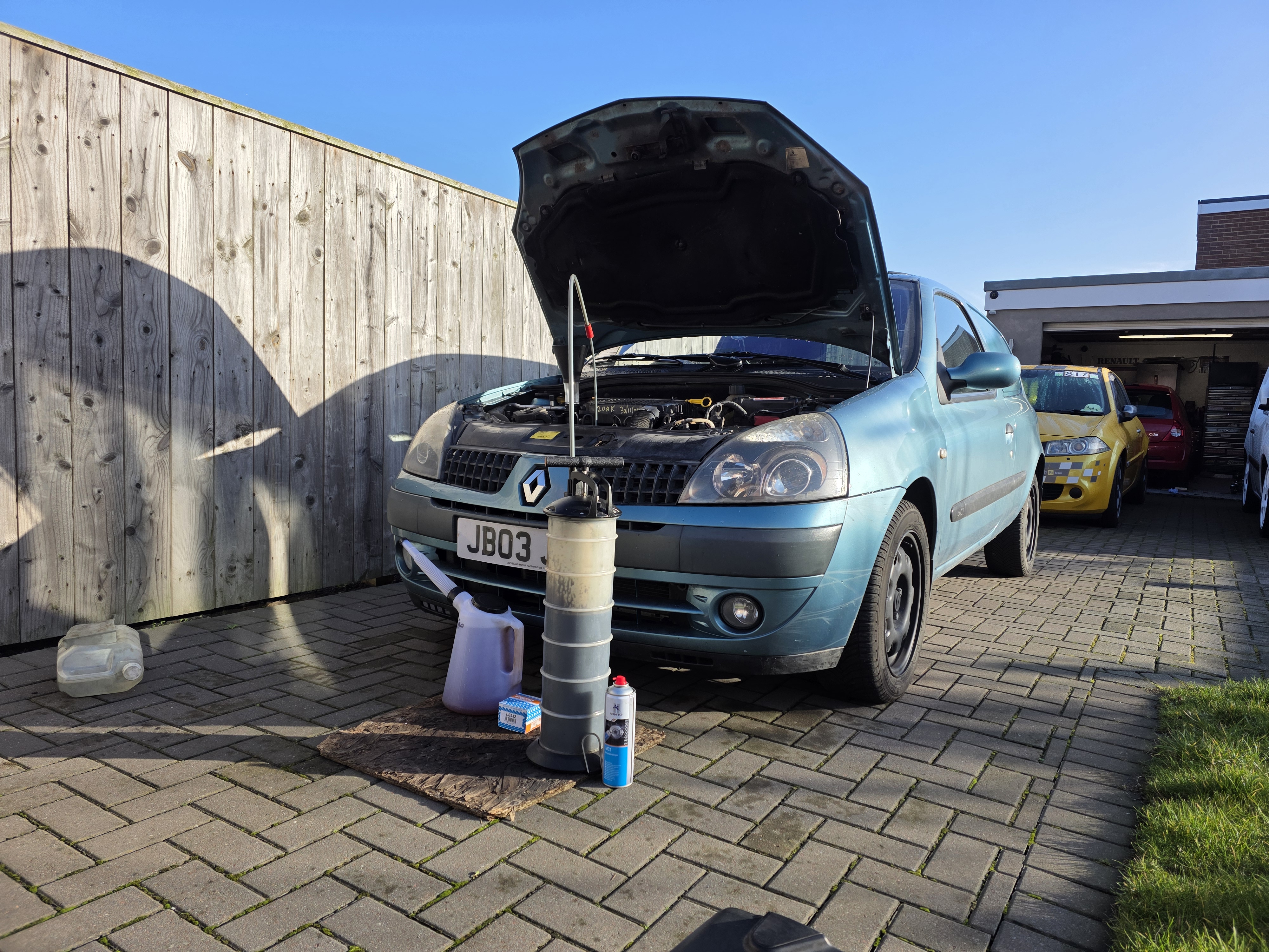

Anyway had a dry morning so got the smoke kit out to leak test, just incase any boost leaks had developed.
The boost circuit on dci65 is super simple with no intercooler. Smoked it up and no leaks at all, air tight with the crankcase smoking up as the rings naturally let a bit by even with good compression.
Smokin.
With the boost circuit declared leak free, i took the egr out and inspected, pretty clean. Took the stainless steel pipe from egr to inlet off to check for soot restrictions and also pretty clean.
Cleaned both and got the mityvac out to check wastegate crack pressure, which was just under 15lbs, cranked the actuator up a bit so just over 15lbs. Also fitted a new airfilter that i got off @plees as the old one was not great/12k old.
Took for test run and boost up a little bit. Feels normal ish, was hard to tell if any better as been driving the megane all day. I will monitor and see how it goes, get the feeling egr might be playing up intermittently or maybe fuel system is a little bit tired. Might be worth logging fuel pressure at some point to see if anything is obvious?

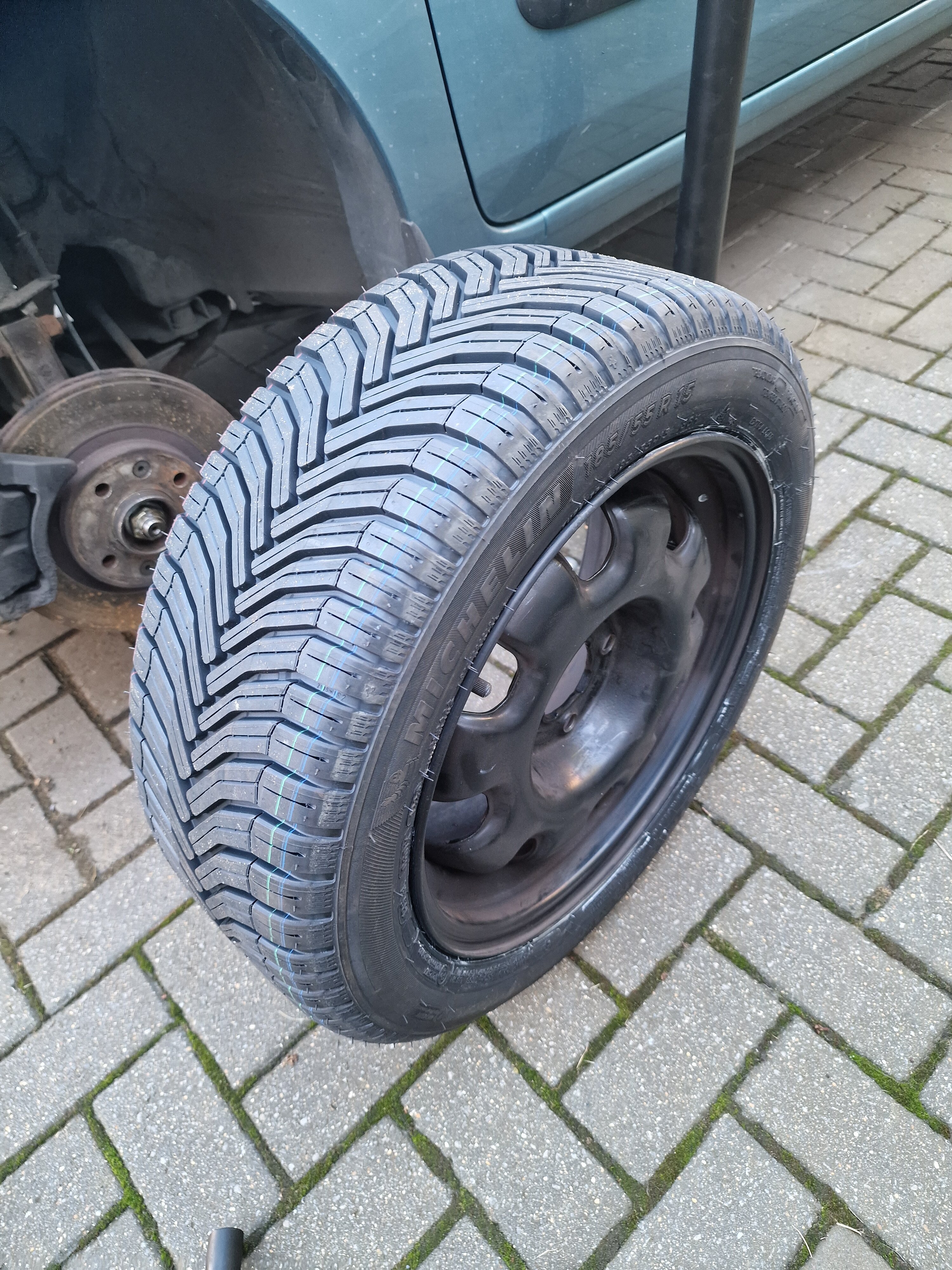

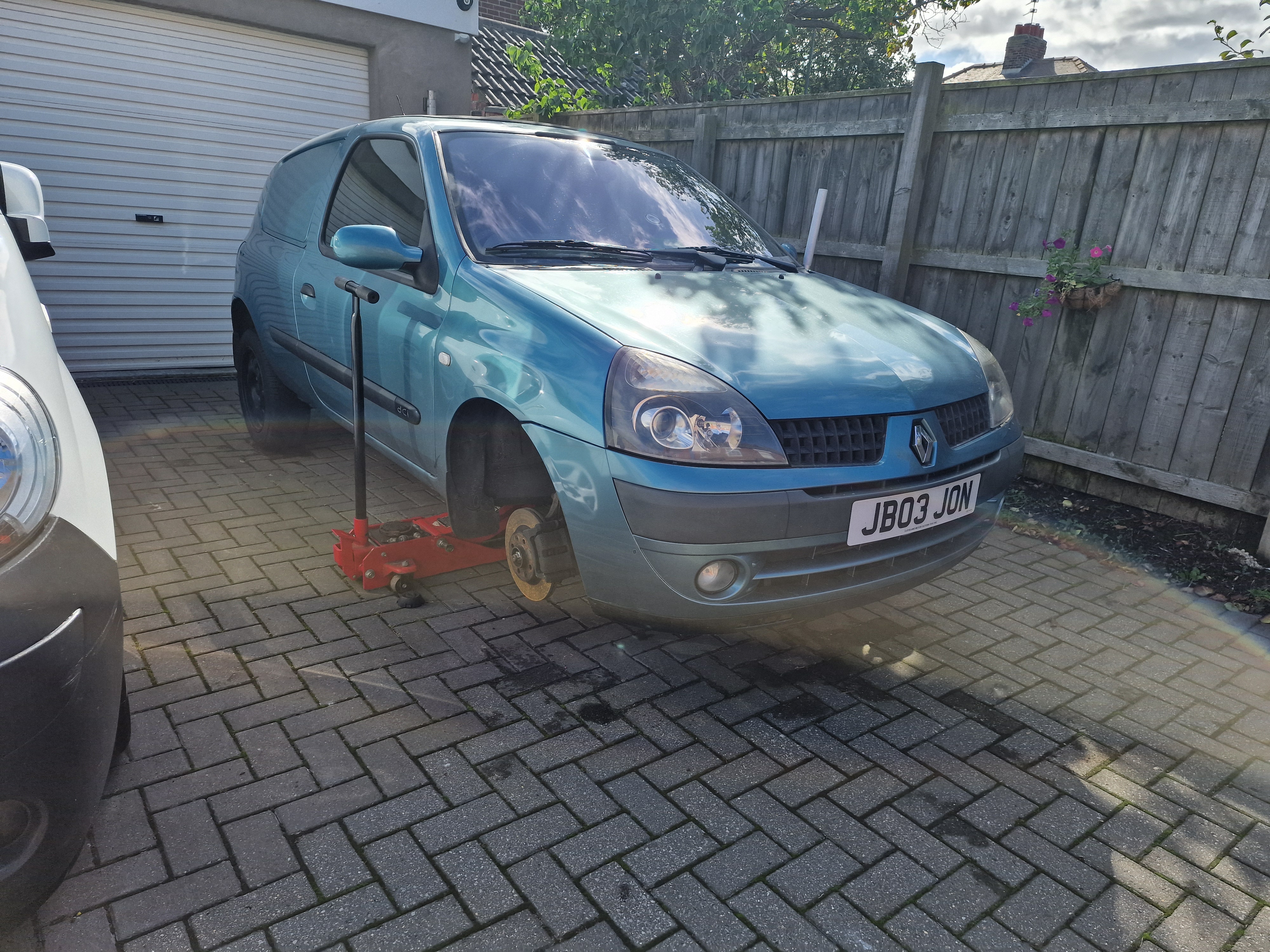

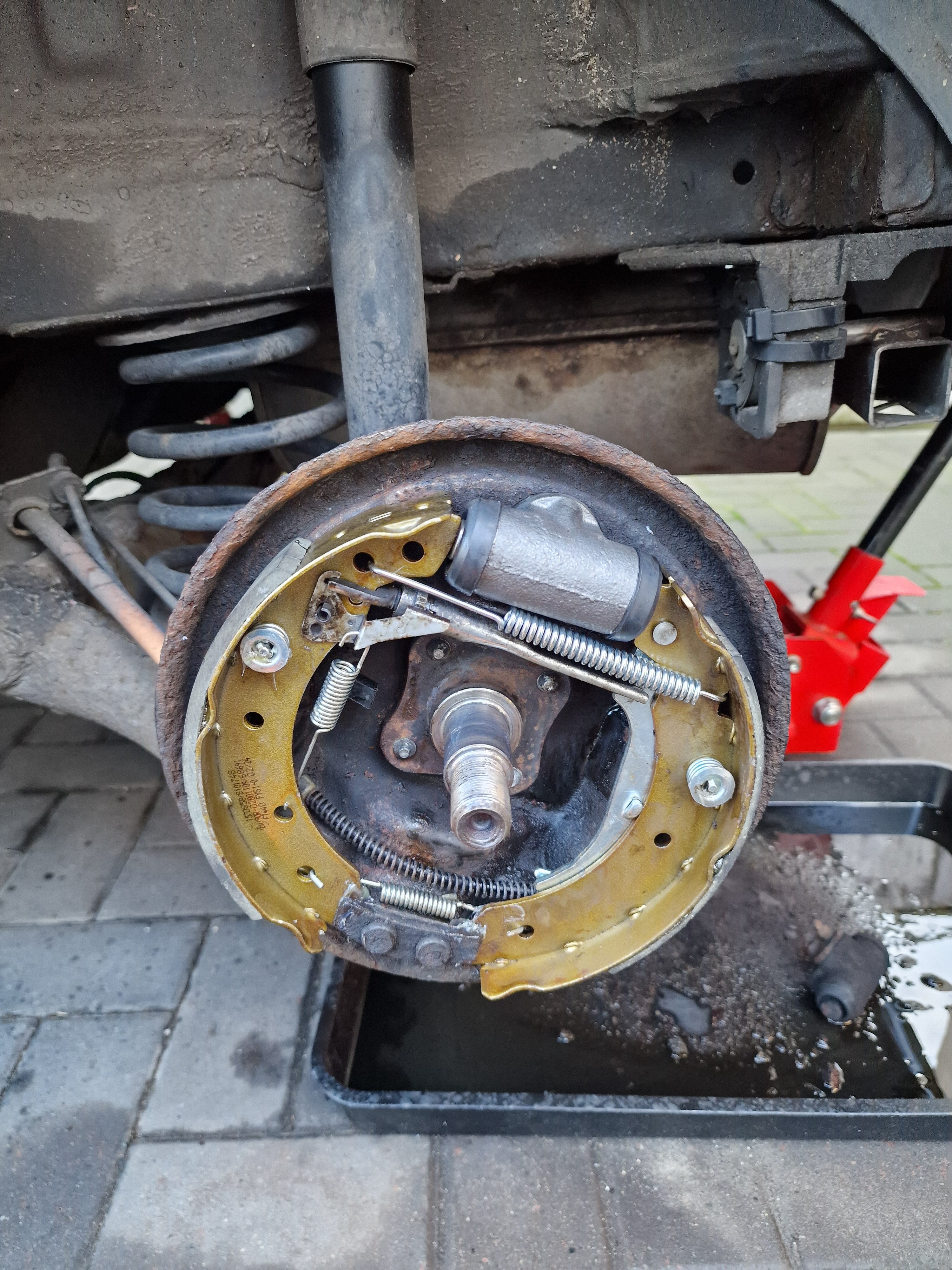

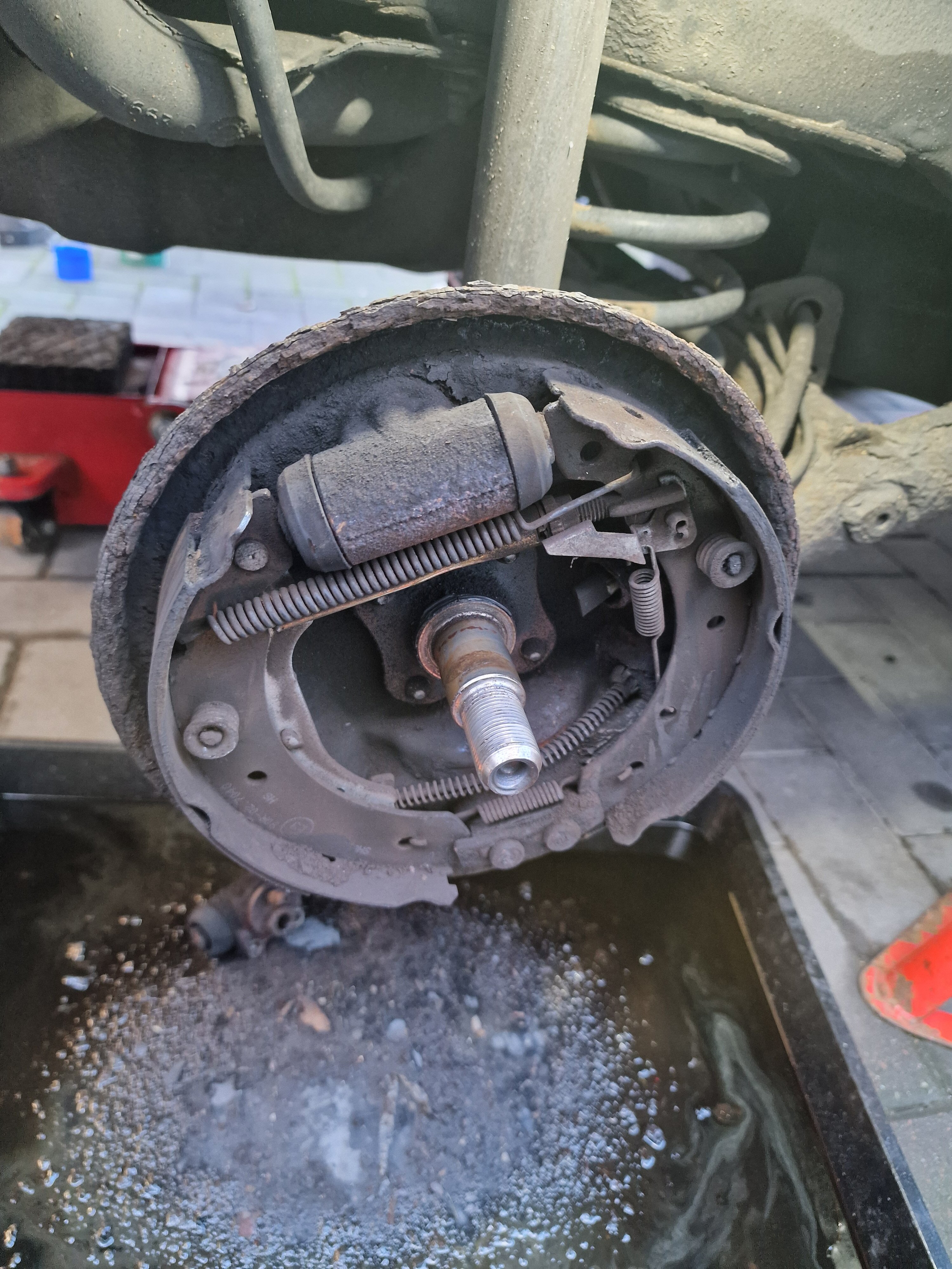

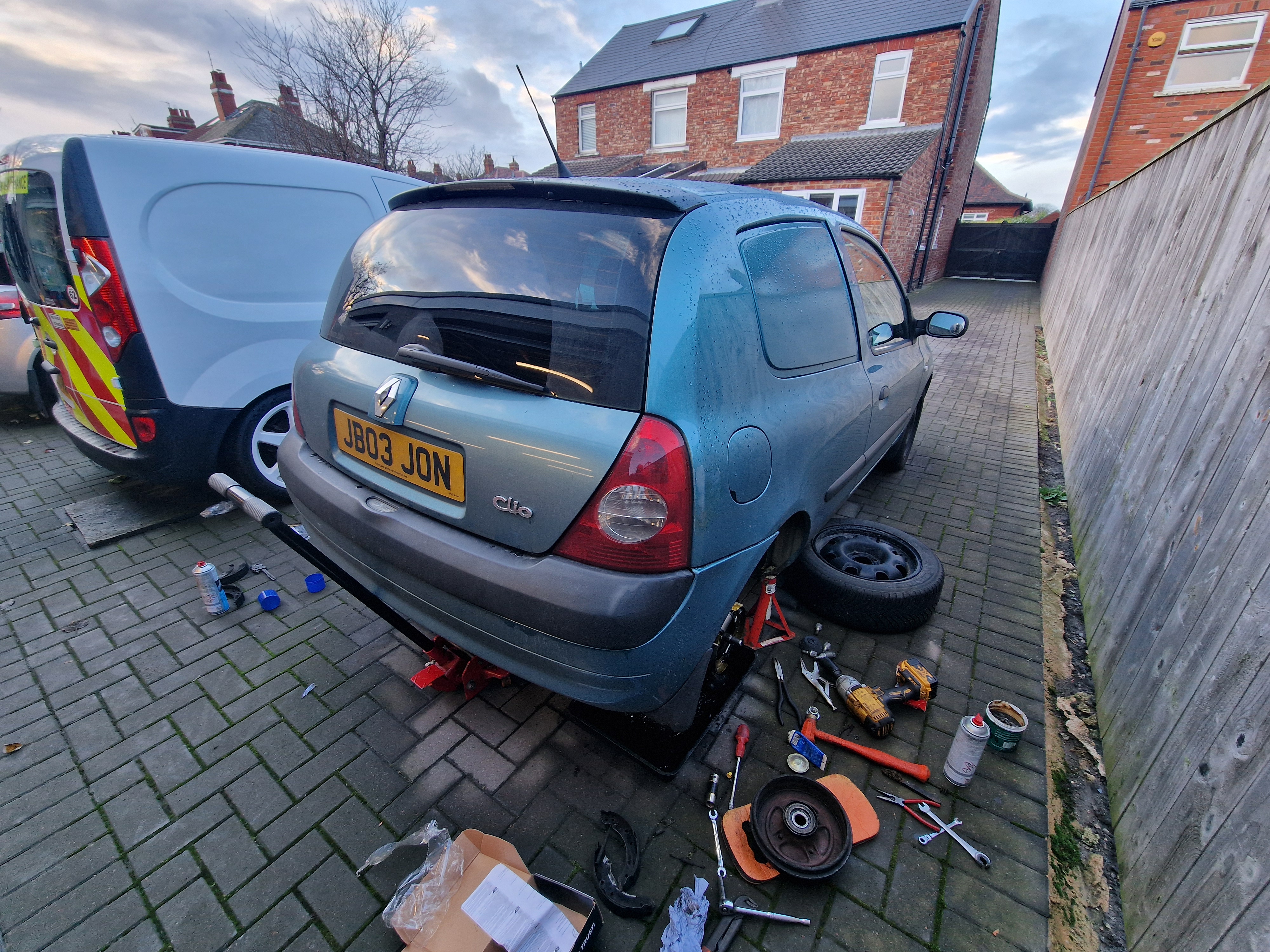

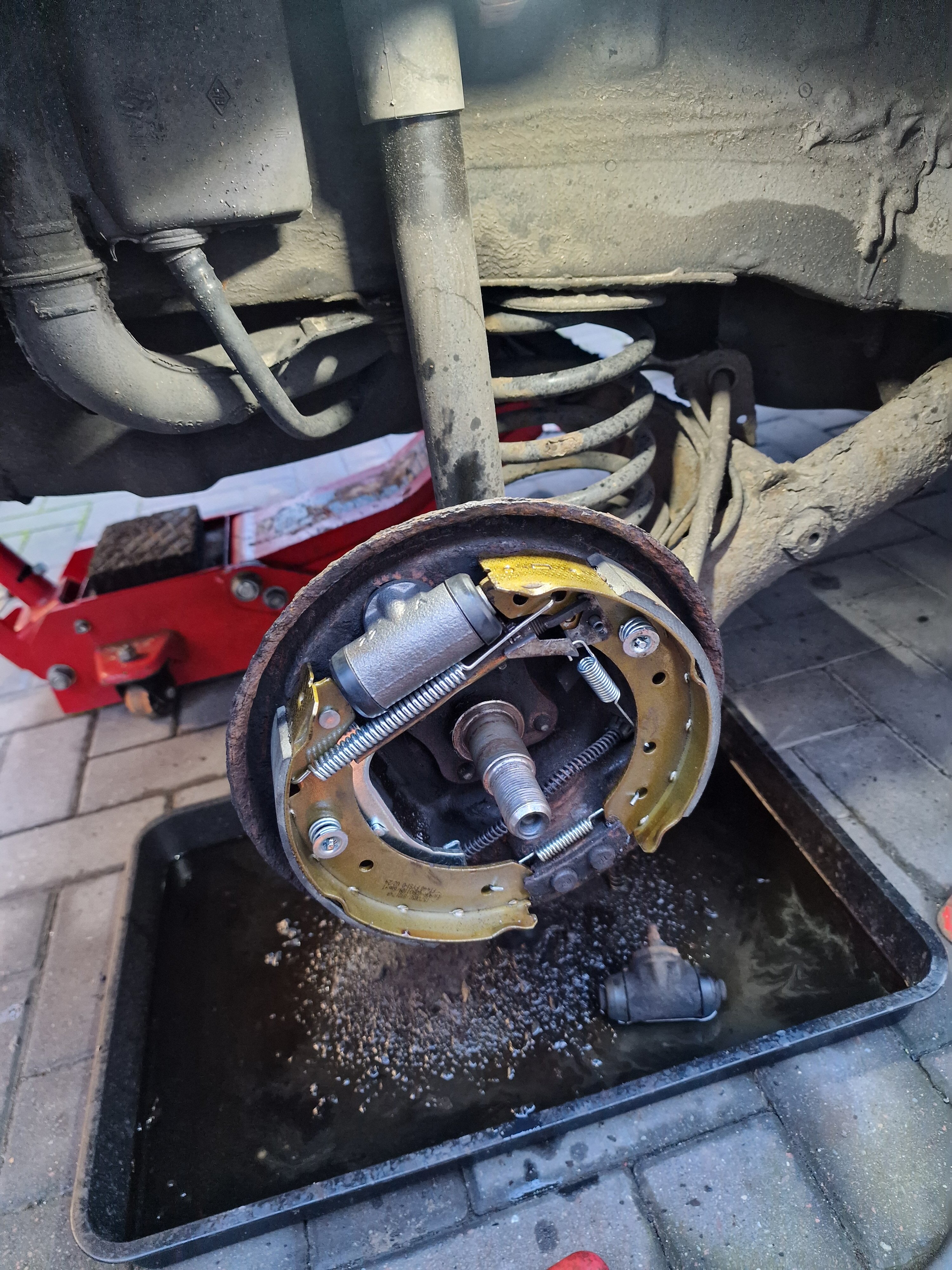

Blue dci passenger rear drum brake started making a right squealing the other day. Brake pedal was still ok ish but not as sharp as it had been and handbrake was a bit w**k.
This is usually due to one of the below issues as i have been there before on several different cars over the last 25 years.
Shoes worn out - were thin ish last time i adjusted.
Shoes need adjusting and drum cleaning.
Rear brake cylinder starting to leak, causing dust to clog up, contaminating the shoes and make loads of noise.
With the brake shoes looking thin last time i adjusted them, i had a set in stock which i stuck in a recent autodoc order, with 2x new cylinders and fitting kit. Also ordered 2x new rear drums. Full monty.
Weather not bad this afternoon, stripped down fast. Gear all over
Passenger side drum examined, shoes indeed low but not on metal. Noise was due to a leaking brake cylinder and adjustment required, noted shoes looked a bit contaminated. On initial inspection brake cylinder looked ok, but pop the dust seal off and it was full of brake fluid. Pulled it off easy, brake pipe undone and new cyl and shoes on.
All new.
Went to fit the new drum and it was tight on the backing plate, rubbing as crap aftermarket. This could have been resolved by removing rust off the backing plate and a small chamfer, but then compared abs rings and 10mm smaller in diameter, so no good.
With this fail i measured the original drum. The drum was just under the max tolerance 203mm recorded vs 204mm max so were ok to reuse once again. They needed a clean up, delipped the drum, give the outer a clean up with grinder on knotted wheel and painted in vht black. This was to try and stop the shoes sticking in wet weather, as i believe the drums let a bit of water in due to porosity in the casting. Hopefully a bit of paint might seal.
Shoes adjusted, drum refitted and onto drivers side. Drivers side was OK and still in adjustment but as per brakes always do in pairs. Stuck a new cylinder in as they usually fail shortly after fitting new shoes to take the piss.
Before
After.
Drum got the same treatment as above. Easy yet s**t job, i hate the springs on the shoes.
With that part done, i pressure bled the brakes all round, i dont think its been done for 50k or so, so looked pretty grim.
Brake pedal nice and solid/sharp, and handbrake back to 4x clicks again. Normal service resumed.

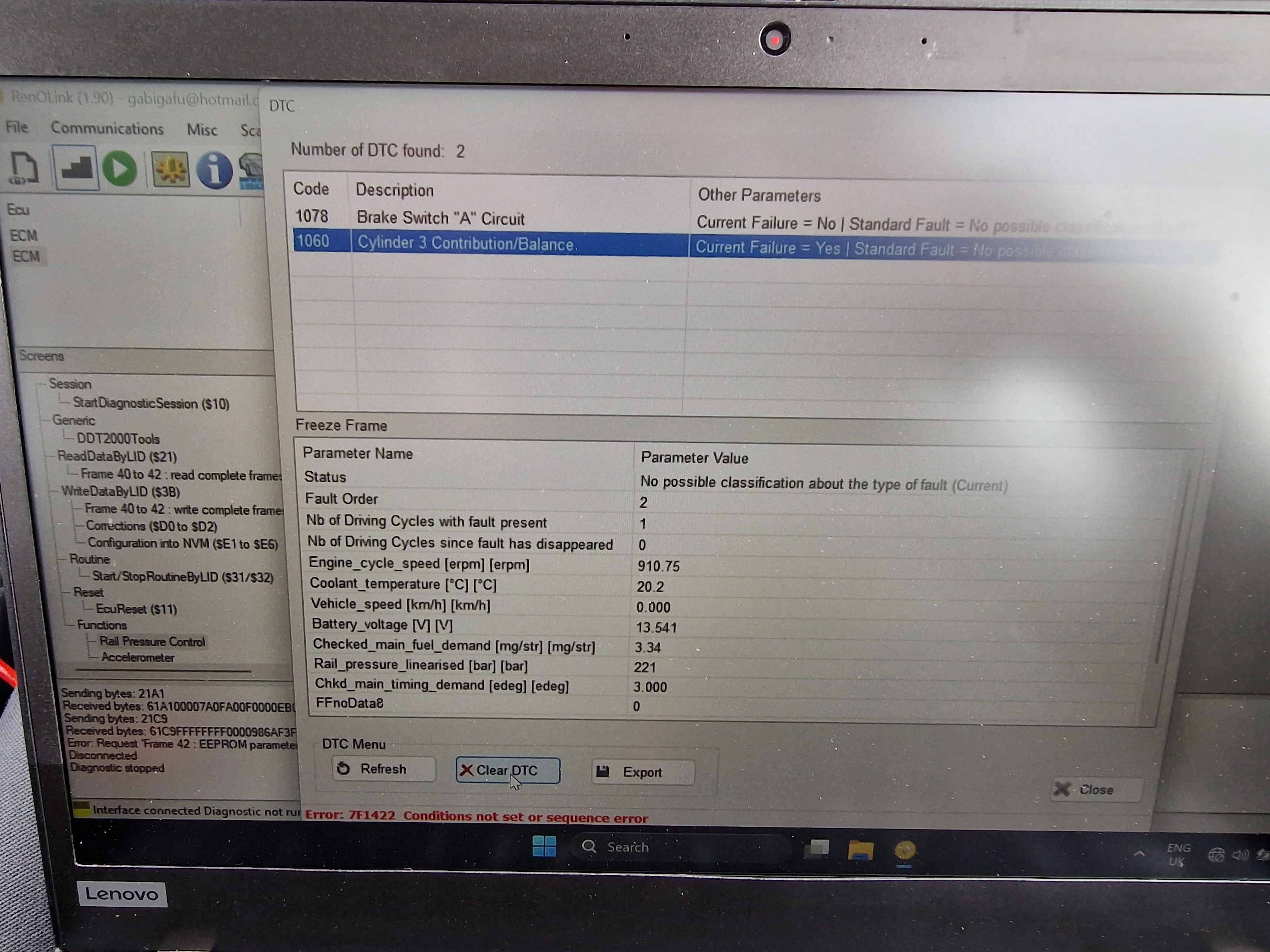

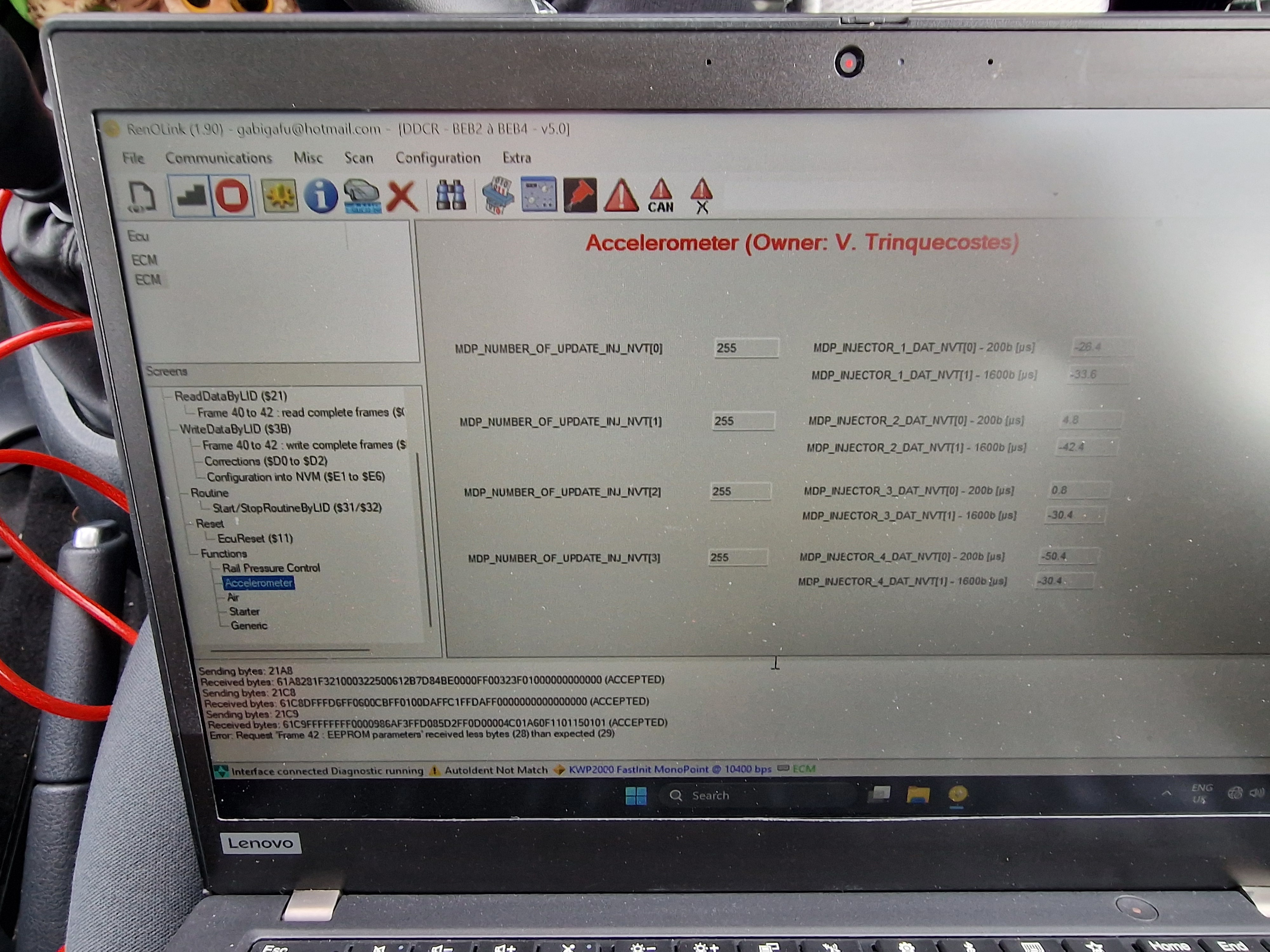

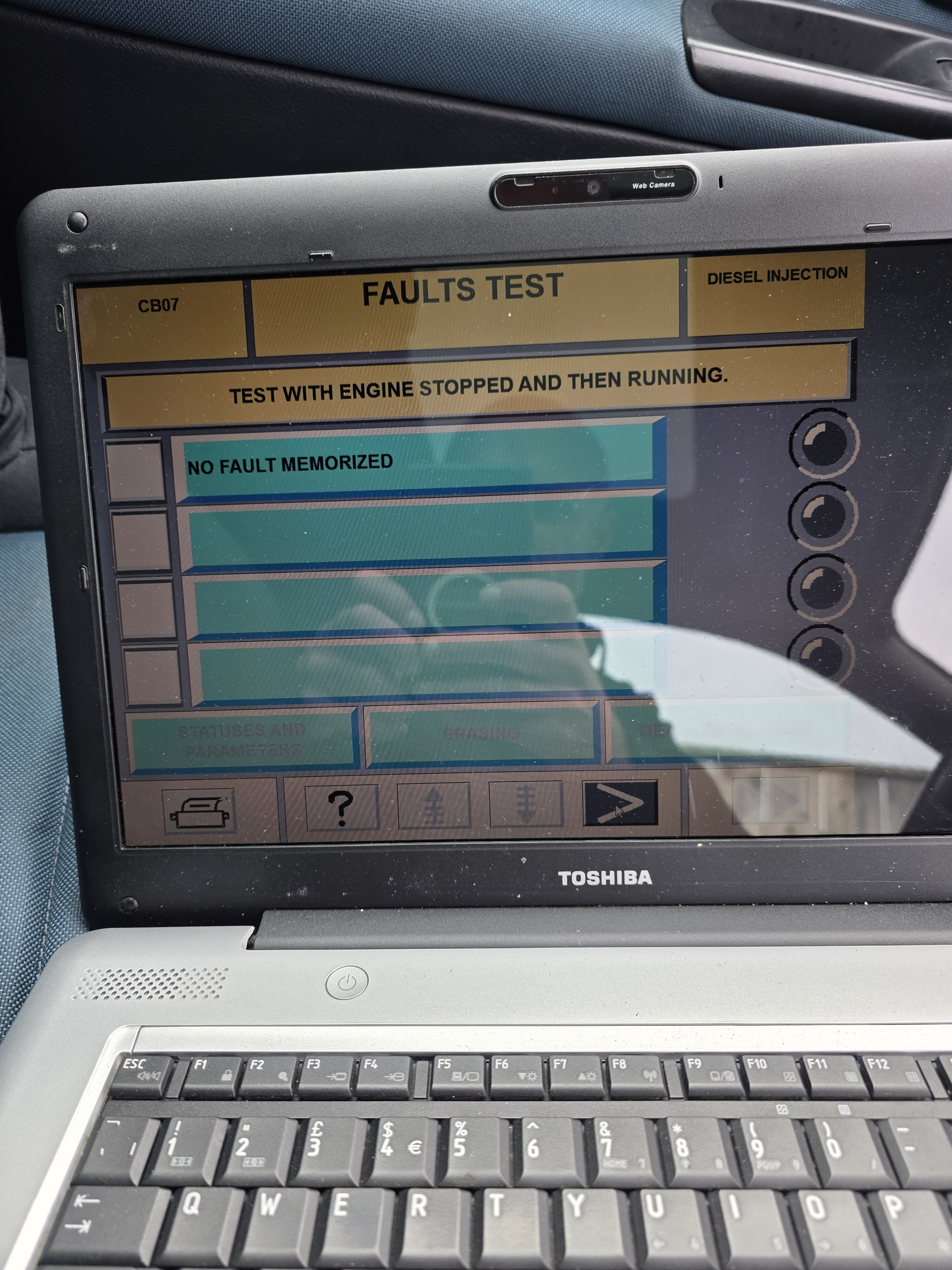

Fired the orange clio up to move it, to get the breaker megane 225 out. Starts up as usual and idling for a couple of mins in usual chuggy fashion from cold, its never ran great from cold but has been like that for 45 thousand miles.
I hear idle pick up suddenly and smooth out, and without even looking i know the fcuker has put the eml light on/went into limp. Look at dash and eml/glow plug light is shining brightly.
Plug in clip and laptop goes flat so stick Renolink on for a look.
No idea if the codes mirror clip but same ddt2000 database. Says injector 3 combustion.
Look in the accelerometer page and injector 3 certainly reading something different to the rest. Taking a wild guess its an injector thats not too happy or injector seal.
Cleared dtc's and runs as normal again. In hindsight i should have left it and read it with clip.
Might be time for a new injector or seal. Ill give it a bit of use next week and see if it repeats it.

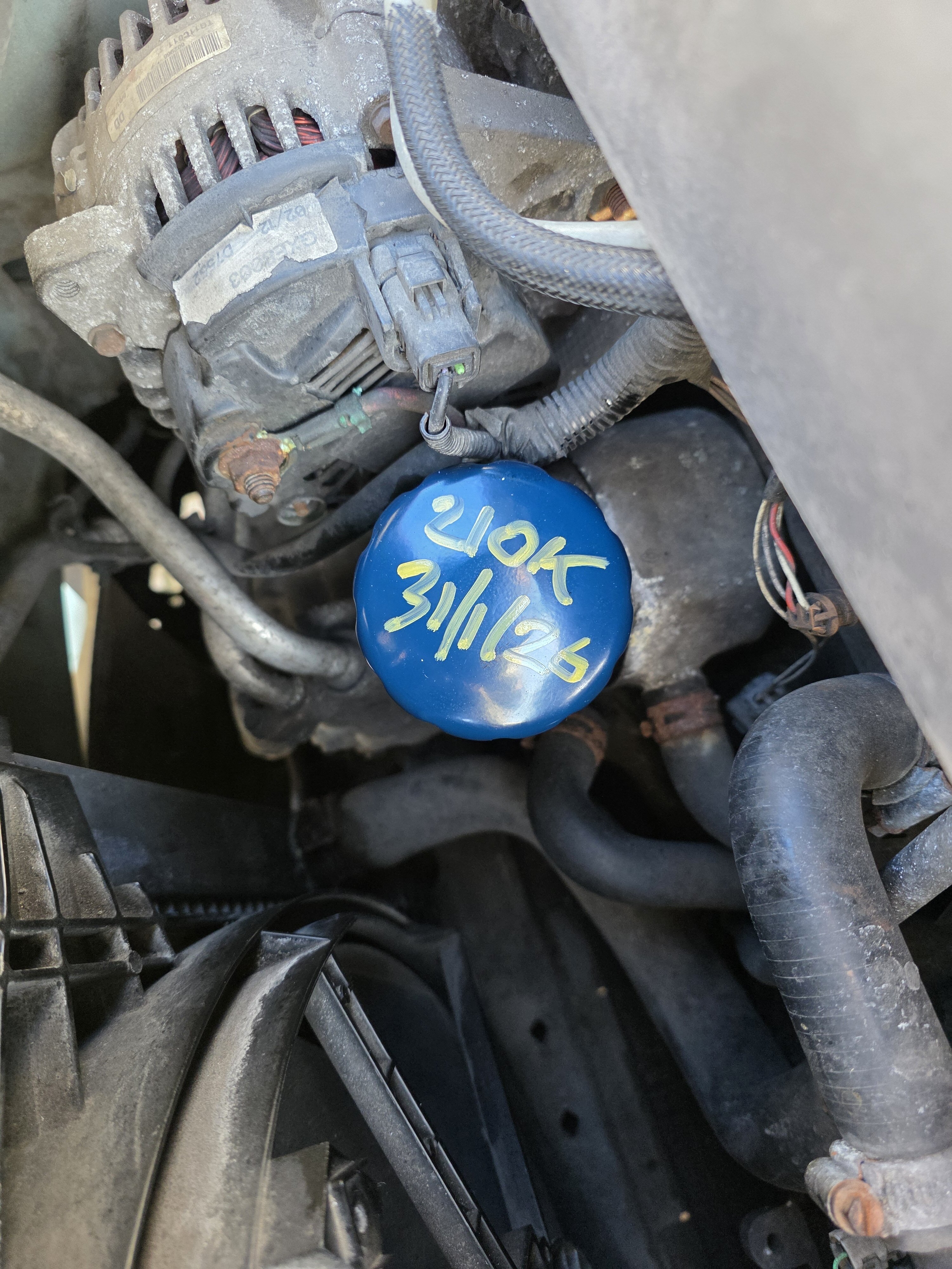

210k service for the blue dci on Sat.
The drum on the o/s was annoyingly squeaking on low speed braking, which is always brake dust related after new shoe run in. Also cleaned and resolved.

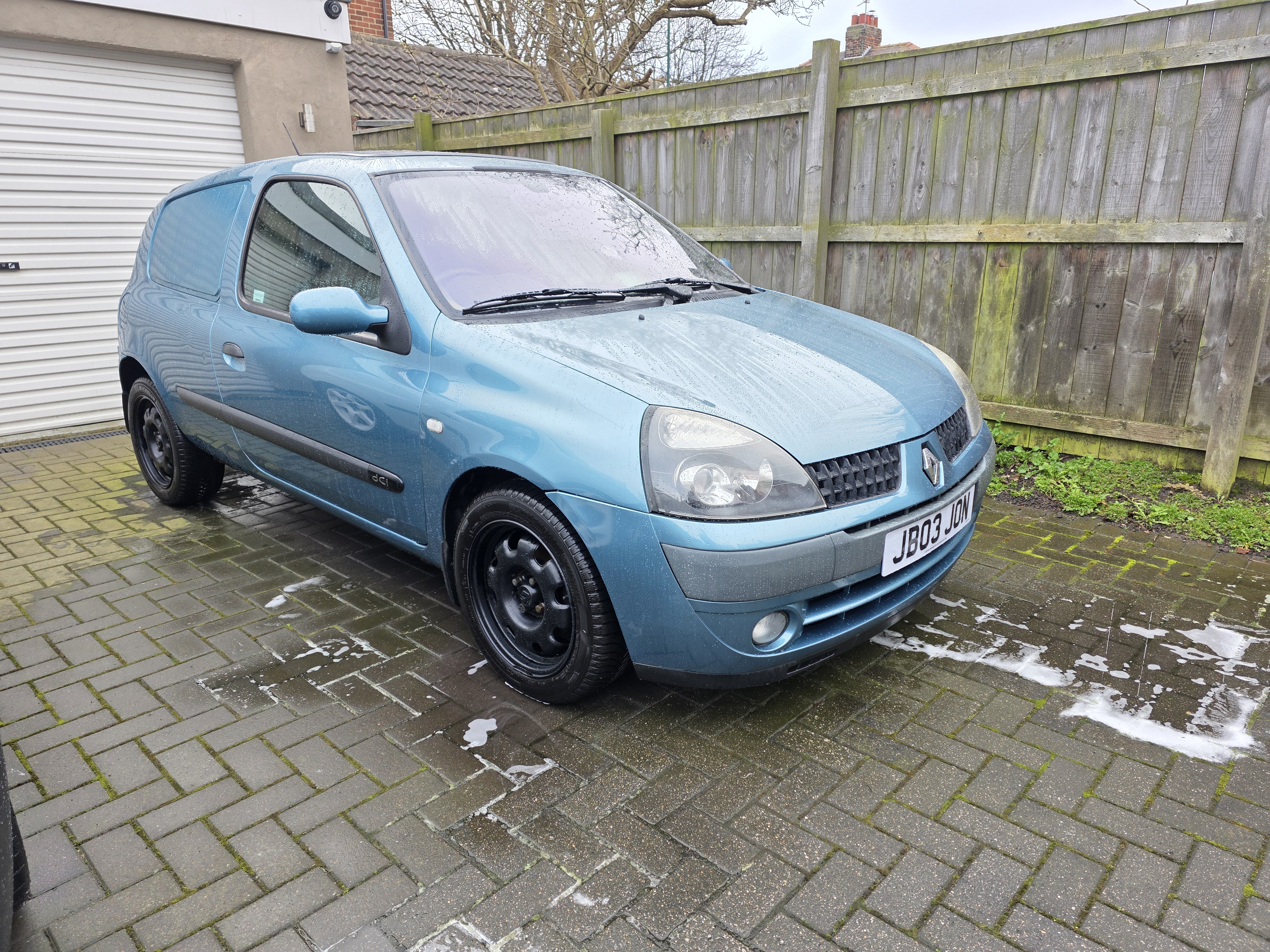

Blue dci washed a couple of weeks ago.
Its back up to its eyes in s**t again after constant rain after.

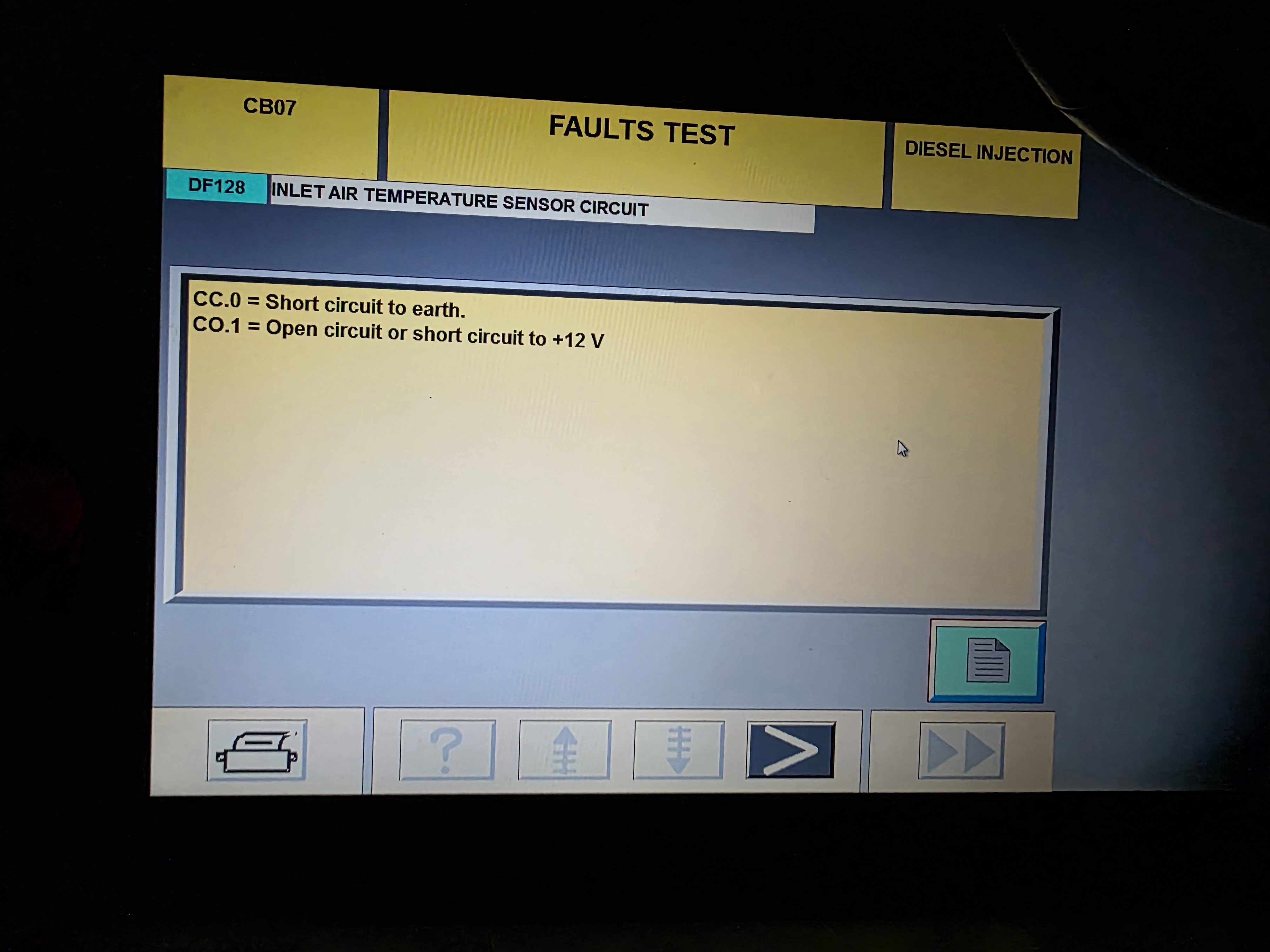

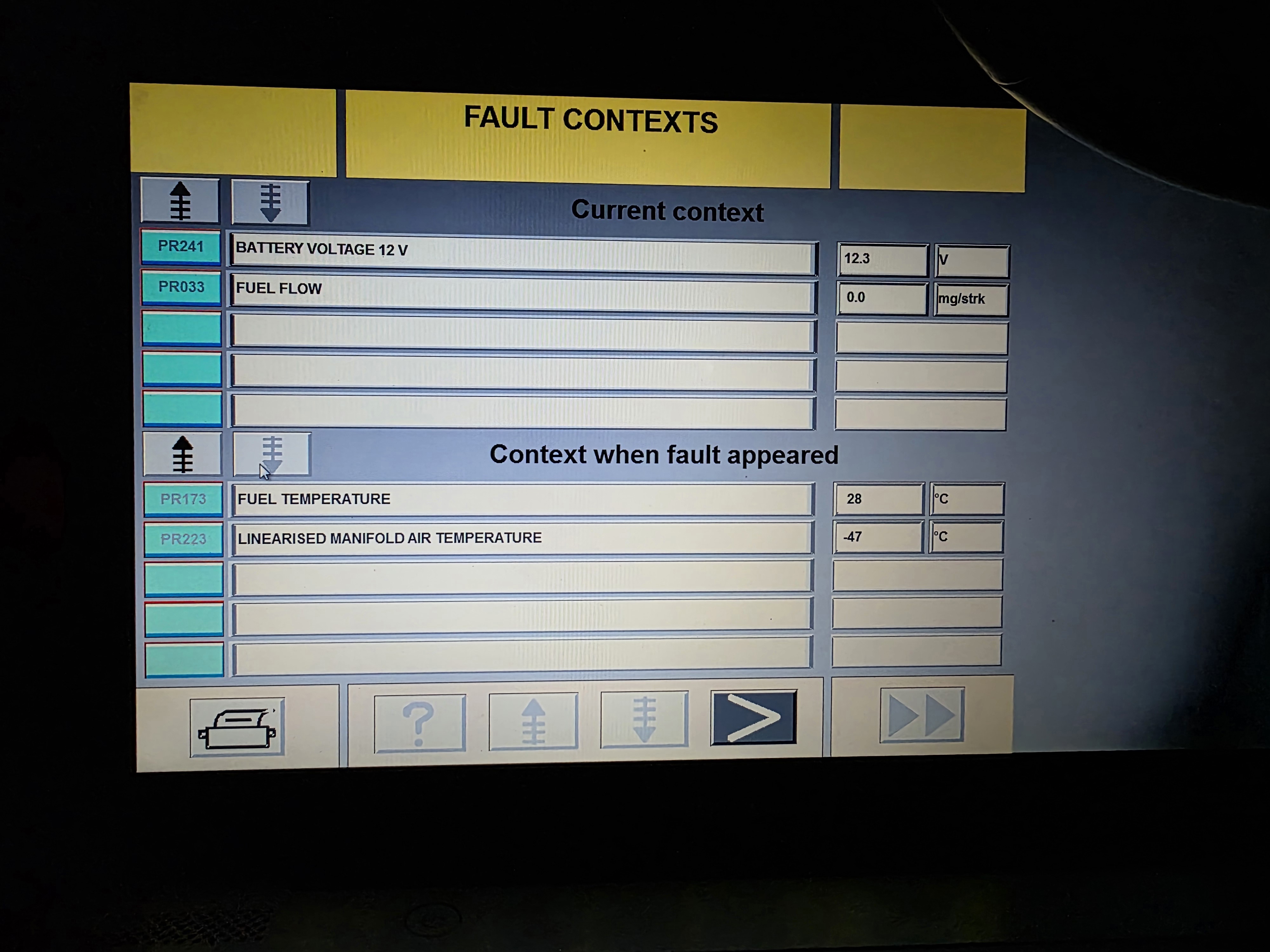

On Monday this week it started up as normal, ran for a minute or so then dropped onto what sounded like 3 cylinders and eml on. I turned it off and restarted and it fired up as normal/no issues and was in a hurry so sent it. 50 miles later no issues so stuck clip on it to diag.
Cyl 1 combustion. Not sure why it had a fit, this mirrors what the orange clio done a while ago and never repeated it. Ive done about 300 mile in it this week and no return so that can wait until it reappears and ill bang an injector in if it needs one.

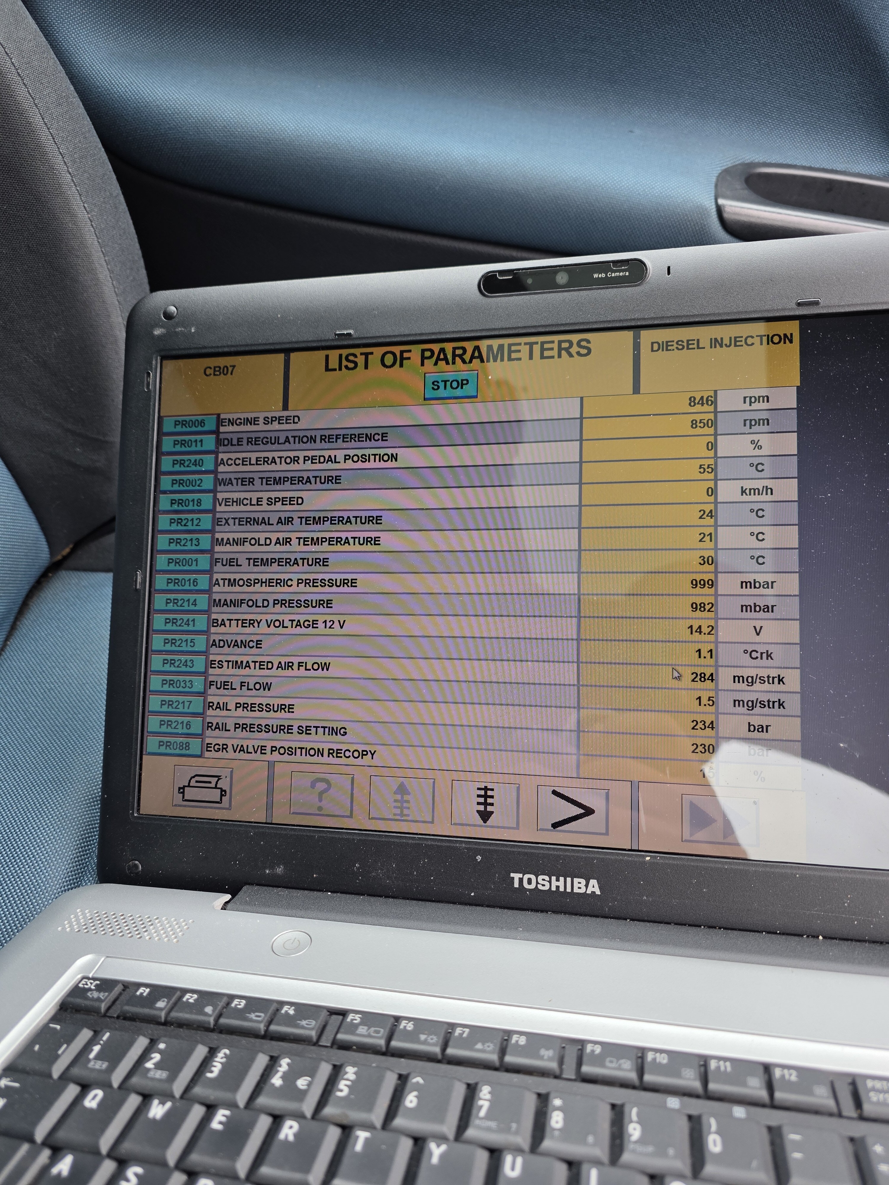

Noted iat fault whilst scanning which is a new one to me. Cleared all and iat straight back up.
Extended data says
Noted external air temp stuck at 25deg on live data so assumed related to pre turbo sensor as main iat sensor was reading ok and overall it was driving ok.
This week has been pretty hectic so no time to look, had a spare hour today so on it.
Engine cover off and looking at wiring to iat sensor, one side looked dodgy yet intact. Flicked it with minimal effort and it snapped off, could see corrosion on the wire so clearly the issue.
Connector depinned, wiring stripped and new connector crimped on/refitted.
Checked live data and sensor readings moving as expected and not stuck on 25deg.
Fault cleared and no return.
Issues resolved in 10 mins, easy fix. Will see if performance is any better. I doubt it will be but we will see.

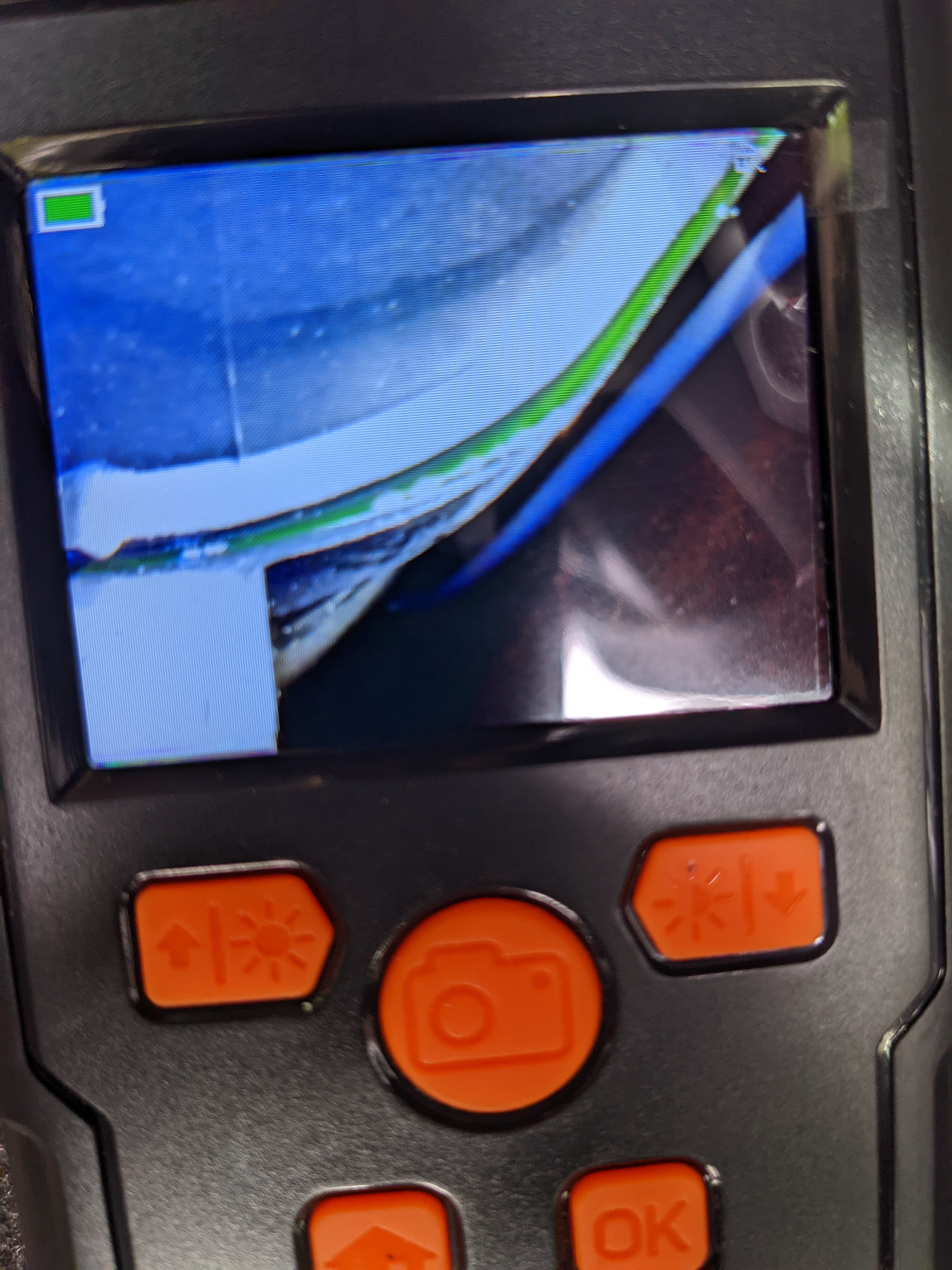

Did you borescope your heater box to check for leaks? Ive seen a little bit of coolant loss recently but barely nothing. However it smells like somebody has sprayed a can of hairspray in the car and worse with heat on so must be very minor leak.
Indeed, absolute ballache of a job. On the newer renaults, its a half hour job with the joint inside.
Yeah mate i did at the time, could see the green glow of Type D 😂

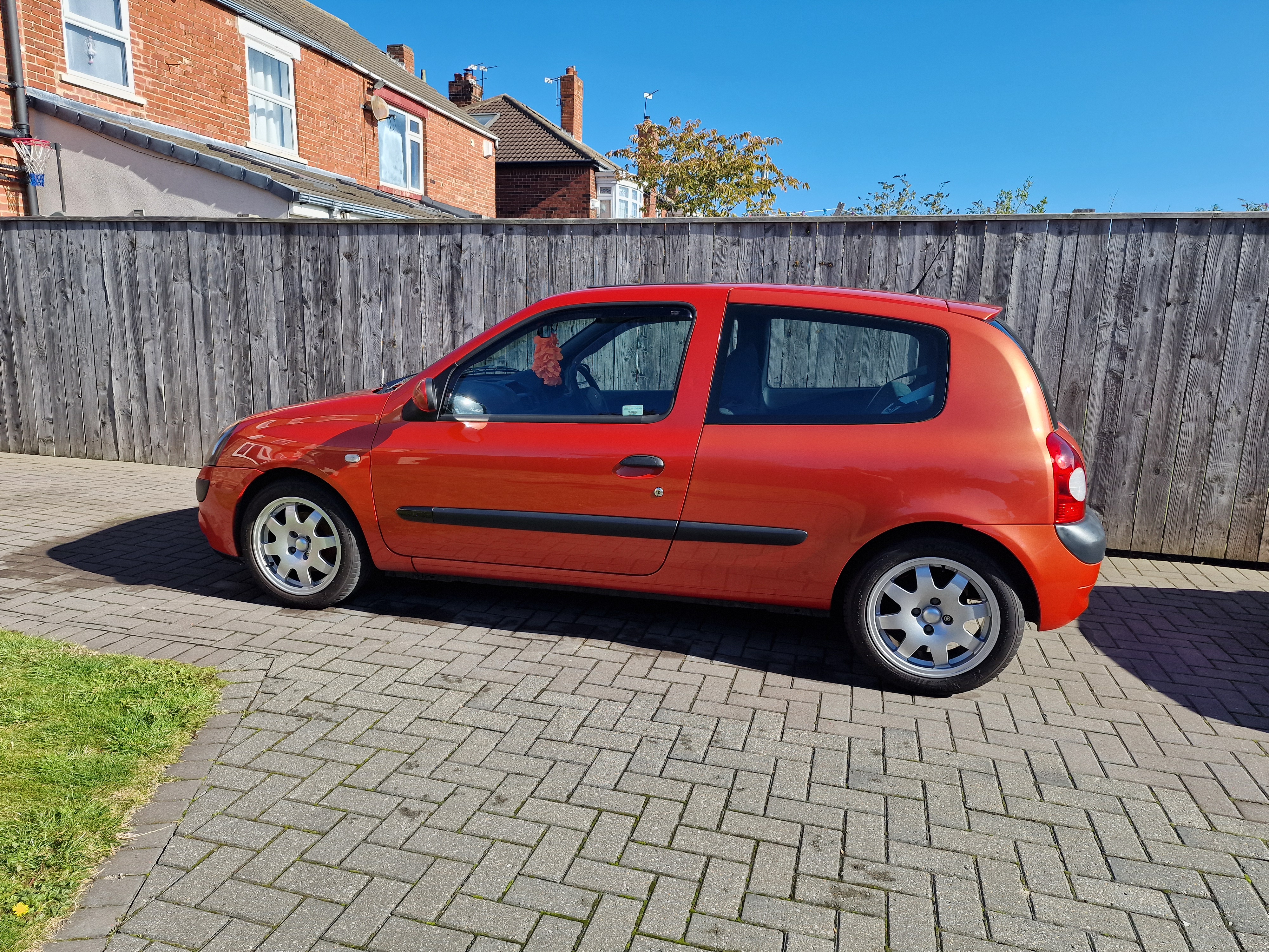

Todays job was to give the clio dci's a clean up. Ive been using the orange dci this week as the blue one is currently parked due to heater matrix starting to leak. Ive got a nissens one to fit this time but cant be fucked this week, full days work to remove/refit dash so can sit a little bit until i get some motivation.
It was up to its eyes in s**t so give it a clean, so its broken but looks alright😄
Orange dci is running well. I brimmed the tank on Monday and its done around 300 miles in the last week, daily running and work commuting.

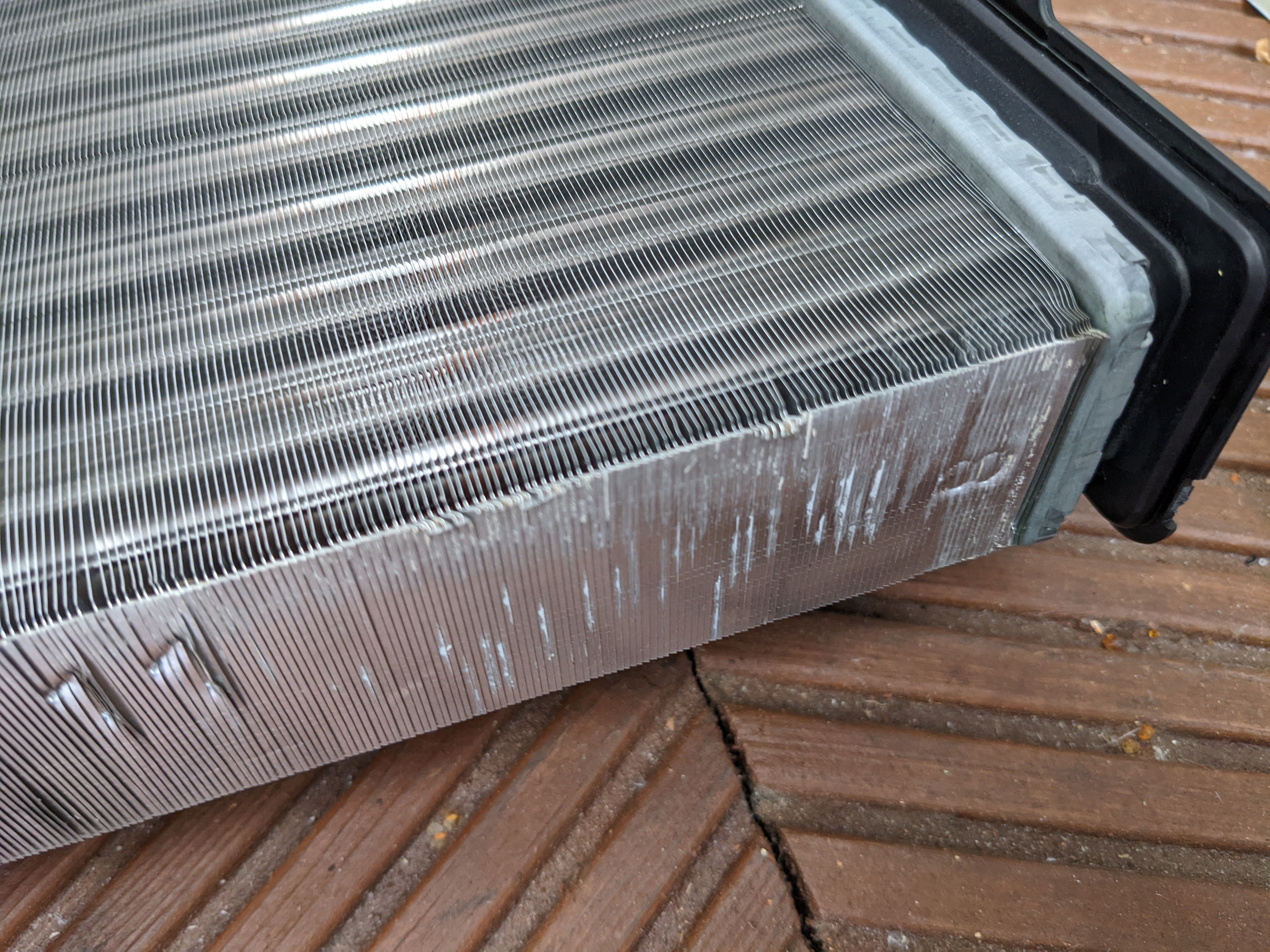

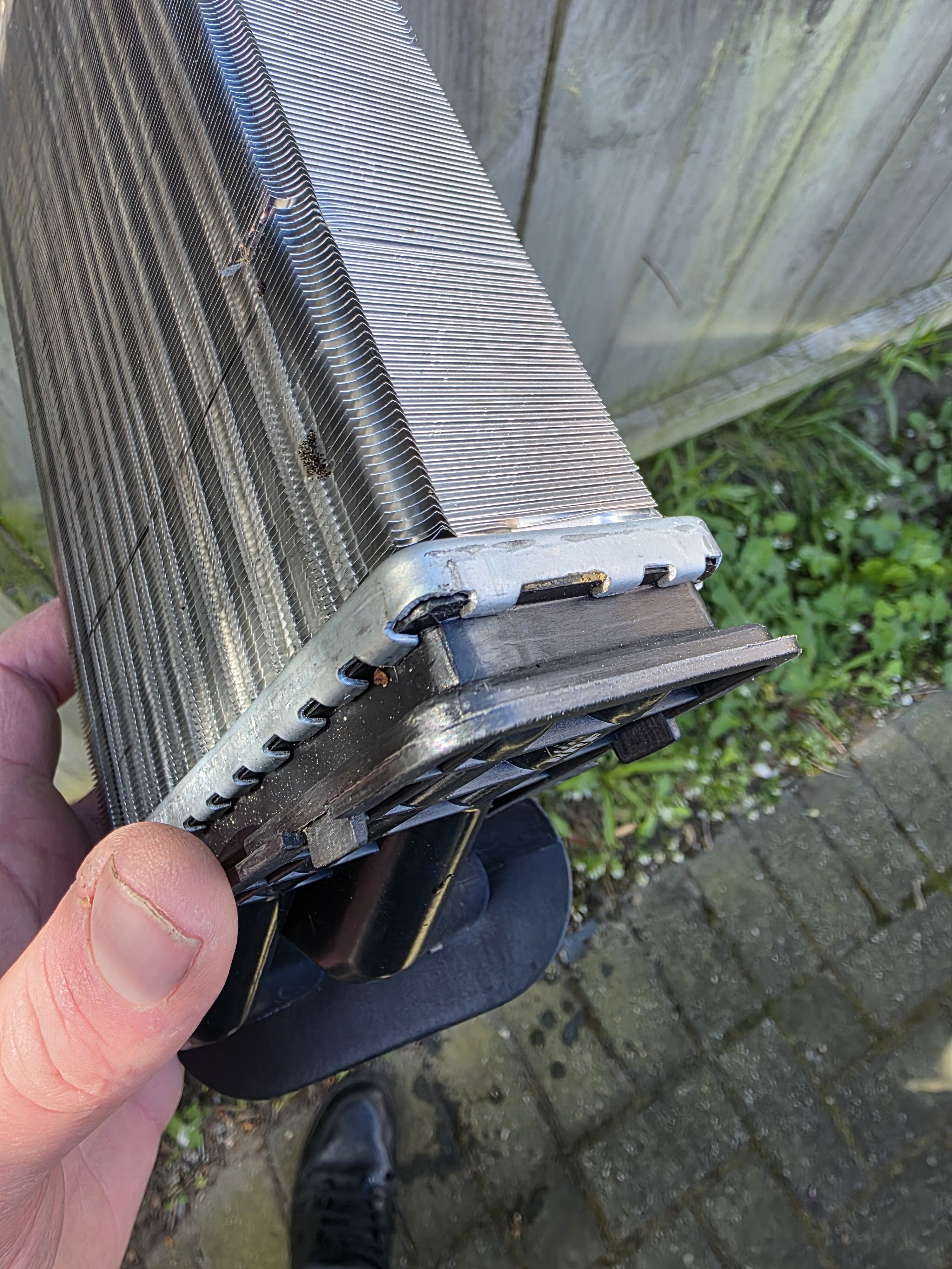

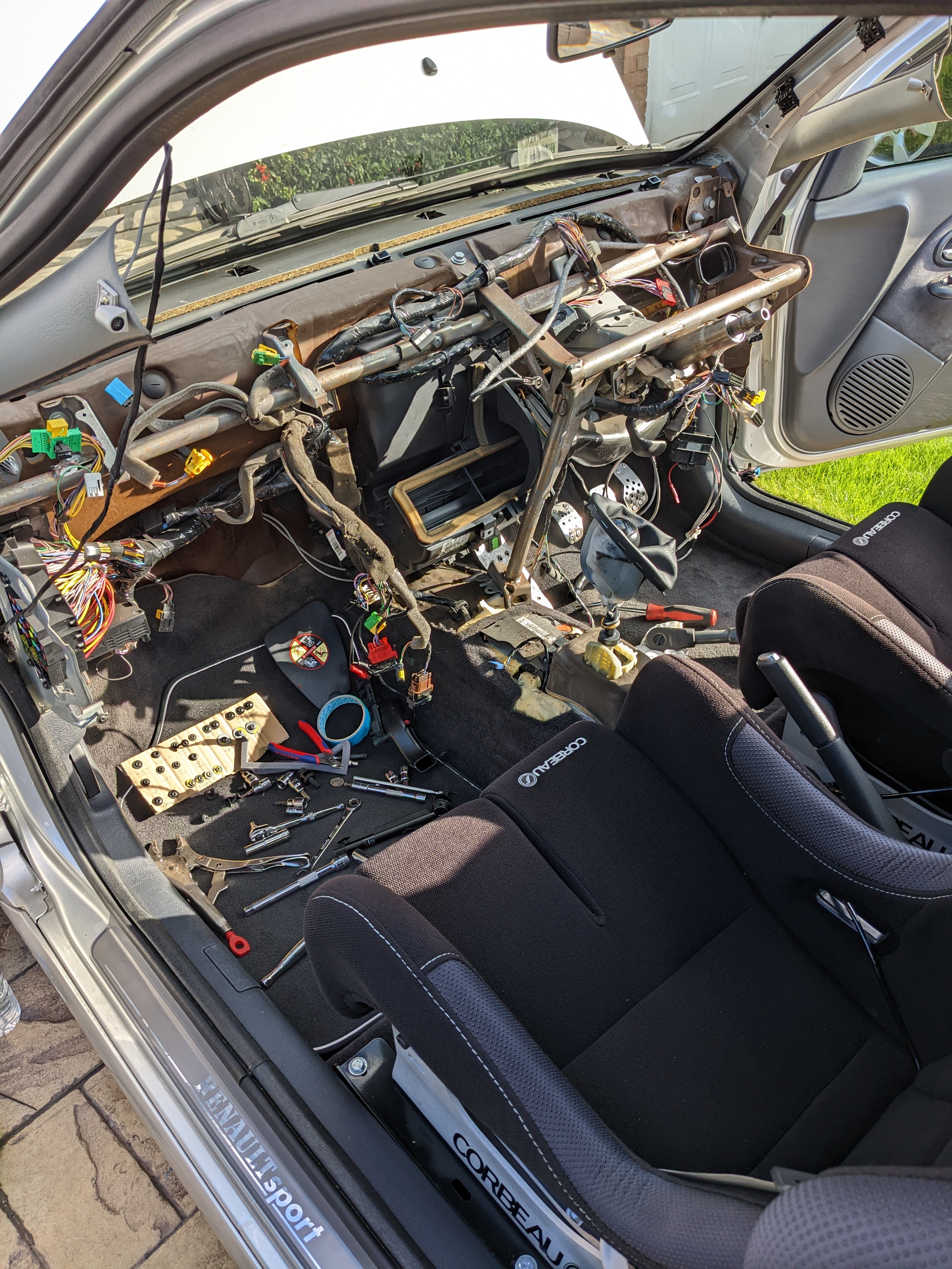

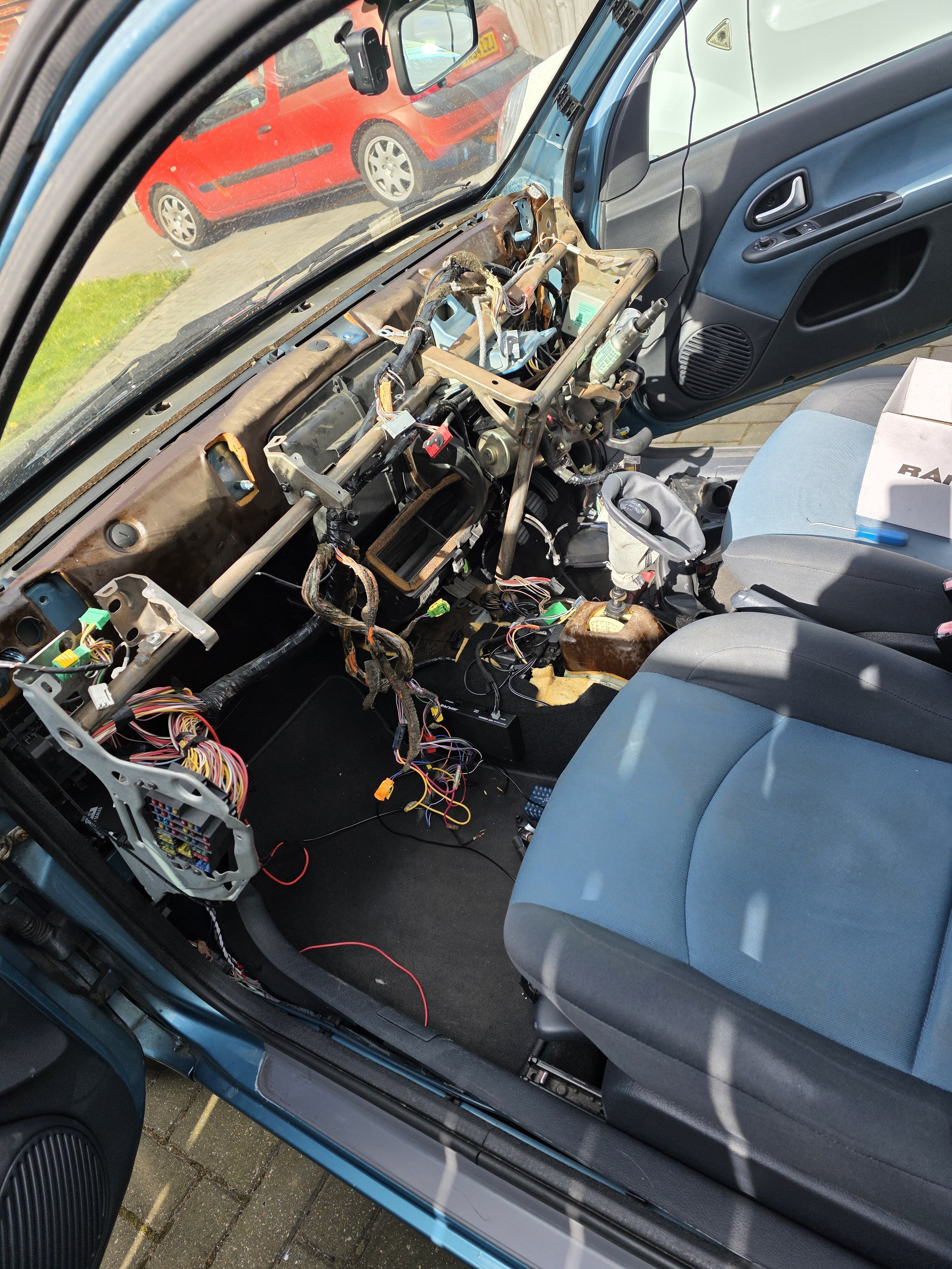

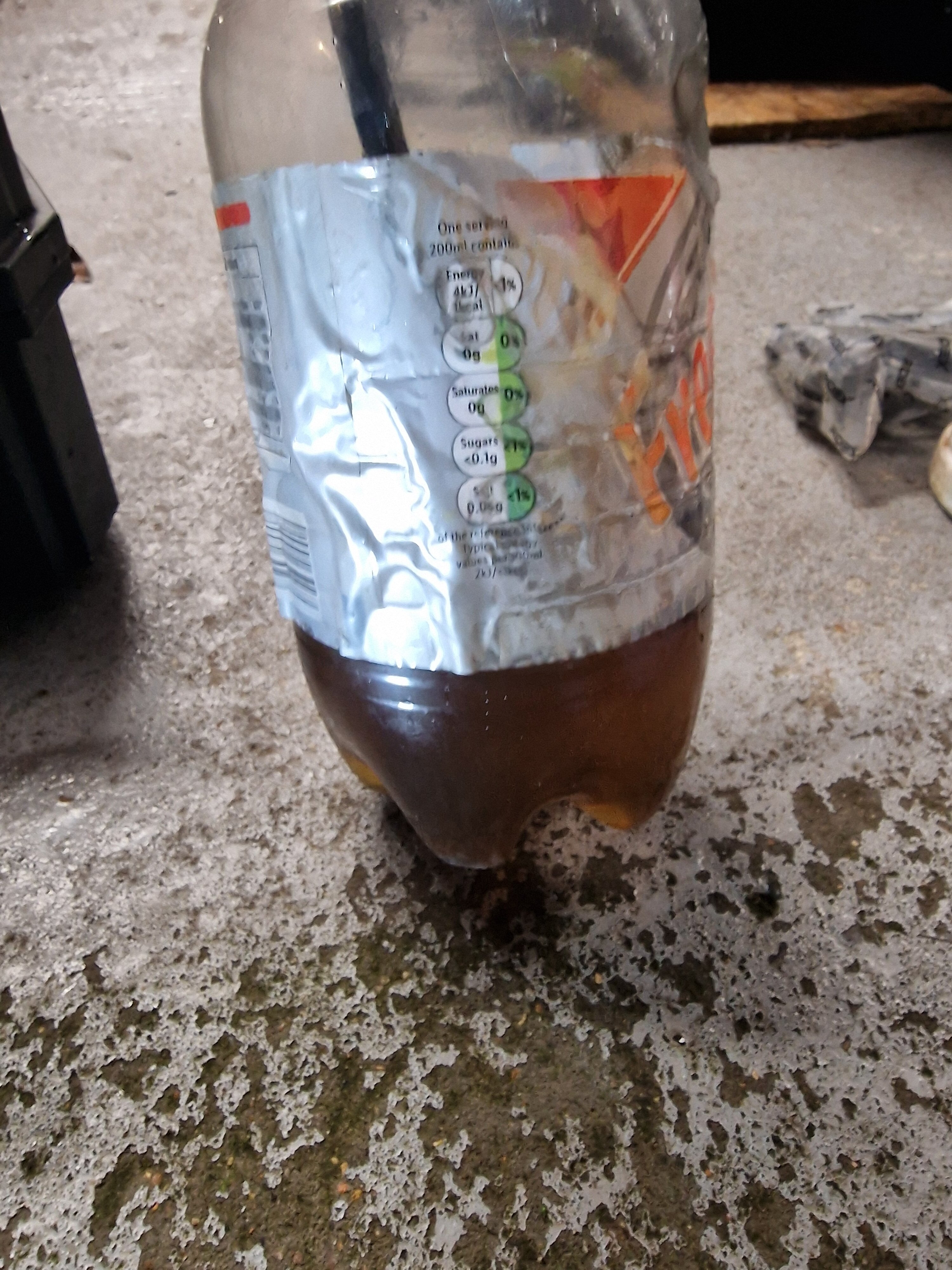

Blue dci has been laid up since beginning of March due to the leaking heater matrix. I was seriously lacking motivation to do this again but it aint going to fix itself :sneaky:
Had a spare hour on Friday so cracked on stripping it.
On sat done a bit more in the pm. Stripped heater box and matrix out, and you could see the coolant leaking out of the end seal.
Looks like nothing but was stinking of coolant inside the car with the inside of the heater box showing traces of coolant running across the bottom from that area.

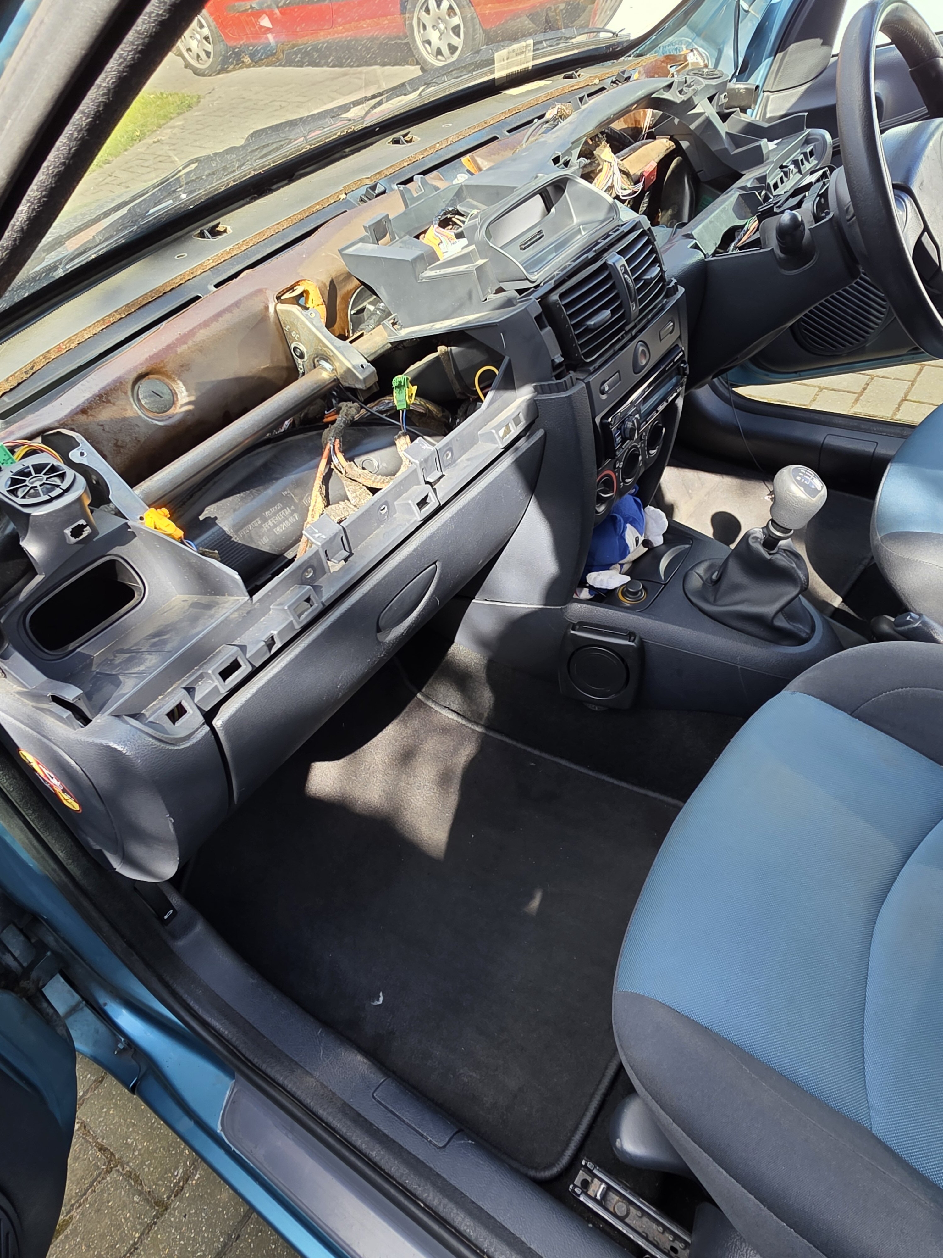

Fitted the new nissens heater core and got the heater box refitted. At this point i was tempted to just stick it back together and move on. As usual i cant leave anything alone and decided to revisit cruise control/speed limiter fitting, to make it feel like ive actually had some benefit from removing the dash.

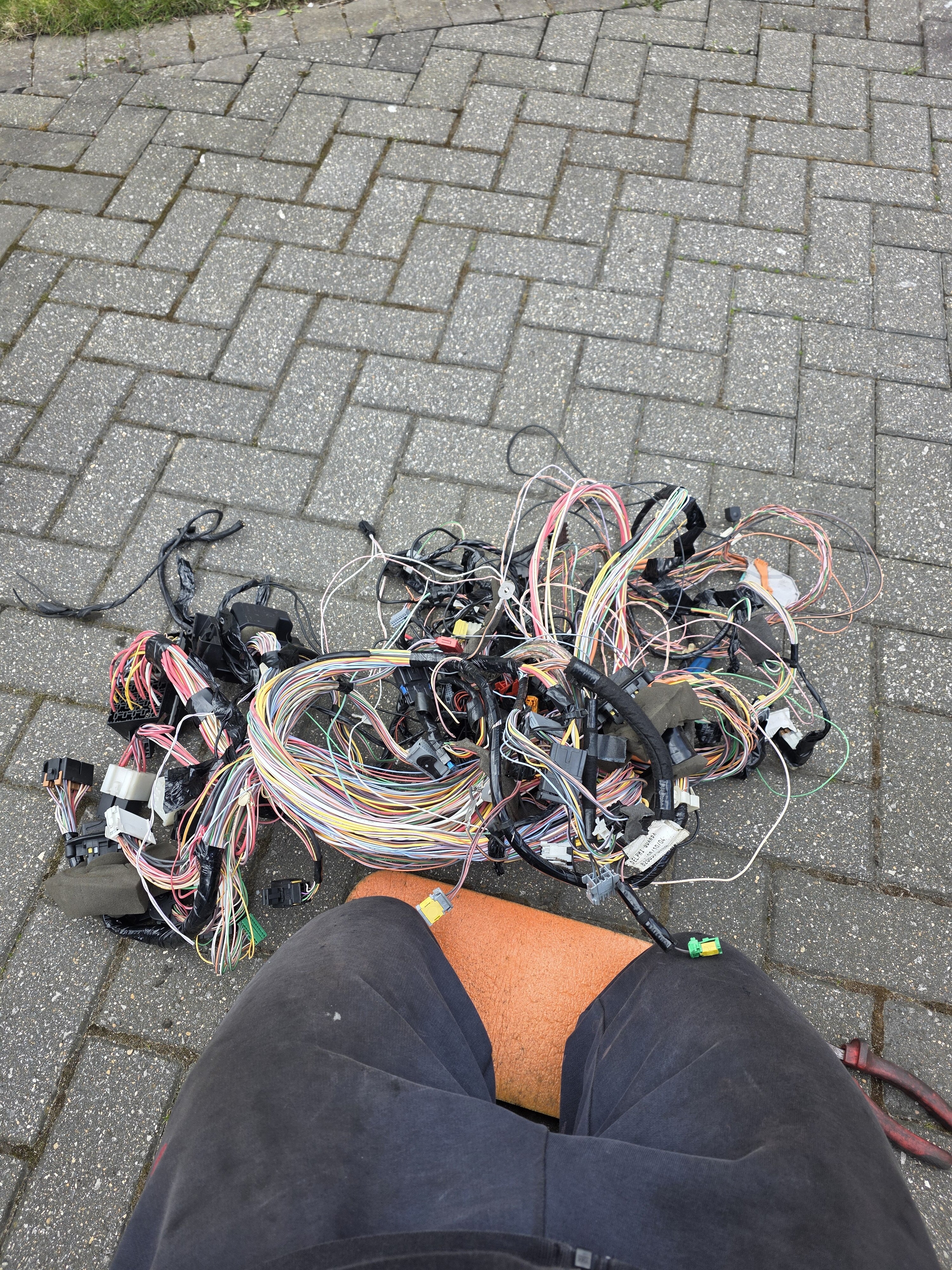

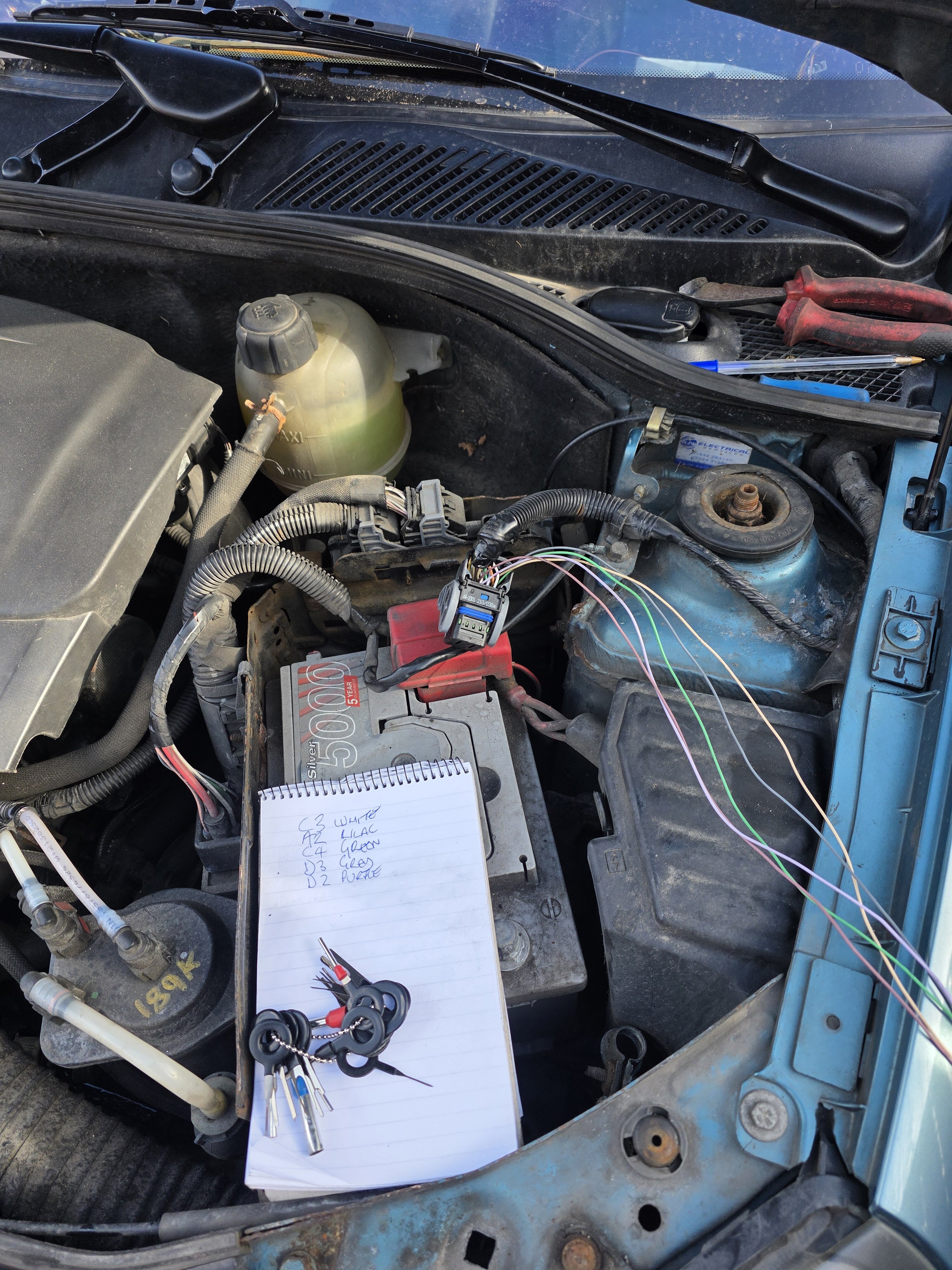

About 5 years ago i fitted the cruise squib and steering wheel but did not go any furthur due to no wiring at all so needed full prep/dash off which was too much work at the time.
Had a quick look at the wiring on visu and the cruise guide on here, it looked pretty simple adding 2x wires to squib plug, 5x wires to the ecu plug, wire in clutch switch etc. Dug the other parts out necessary, cruise switch/panel, clutch switch and a spare 182 interior loom i bought years ago.
Stripped down the 182 loom for the necessary wires.
5 wires to the ecu connector added.
I then ran the cables through the bonnet pull grommit for ease, joining to the relevant wires on the cruise switch and wired in the clutch switch. Taped the wiring to the oem loom so follows the same route.
With that done, i refitted the dash and associated bits and put the battery back on to see if any programming was required. Pressed the cruise switch on and the dash registered set so was already programmed which saved a job.

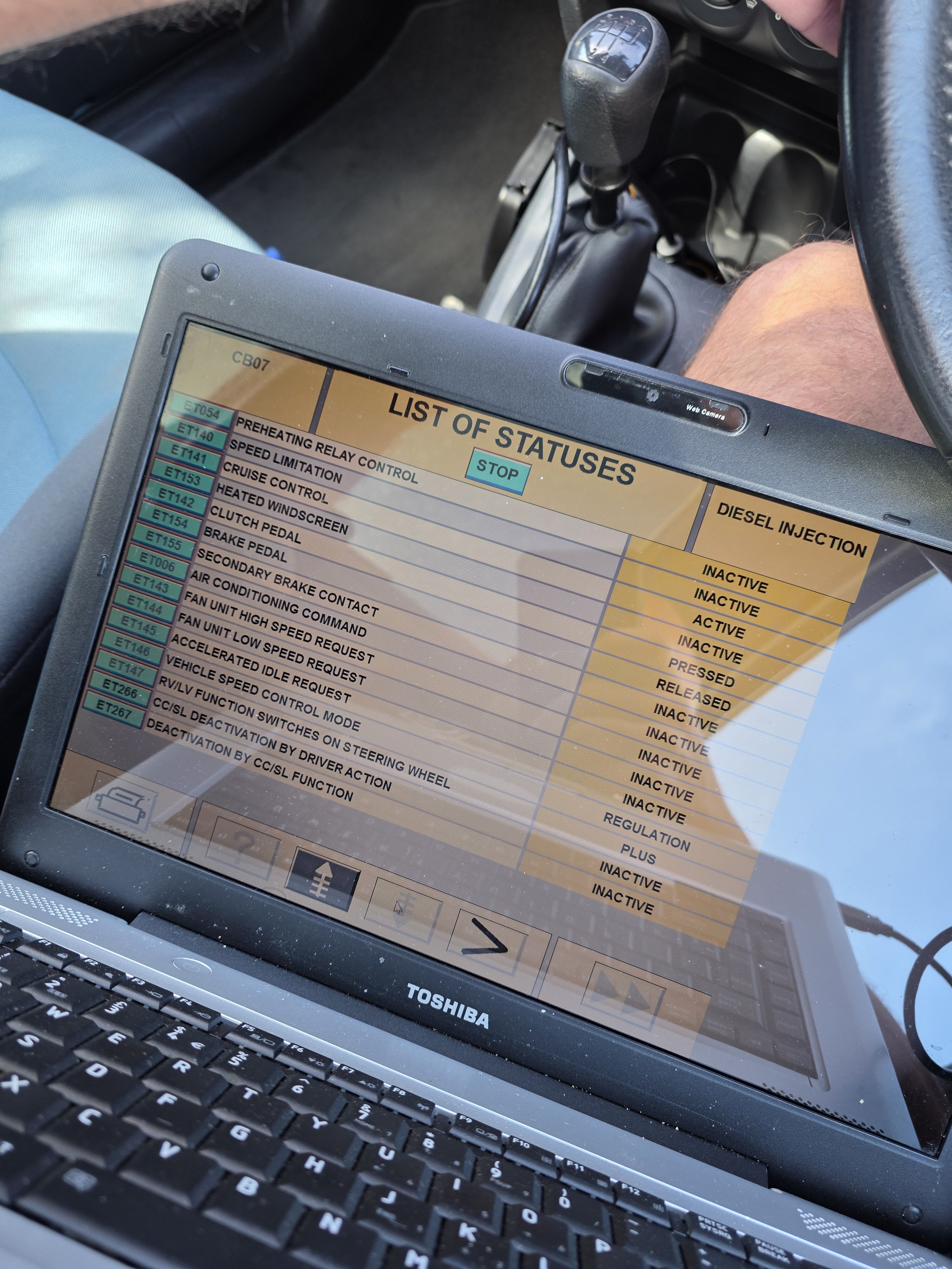

I then stuck clip on to check the clutch switch and steering wheel switches would respond on live data.
Everything was working fine on diagnostic live data, cruise/speed limiter on and off, clutch switch working and steering wheel buttons responding when pressed. Took it for a test run to make sure all good with the new heater matrix and try cruise and speed limiter, both work great. Wish id done it years ago with the amount of motorway miles ive done in this over the years, but be nice to use in the future.
As annoying as it was doing the matrix again, having the cruise working is a nice bonus.
Back in daily use now. Thanks for reading!!!

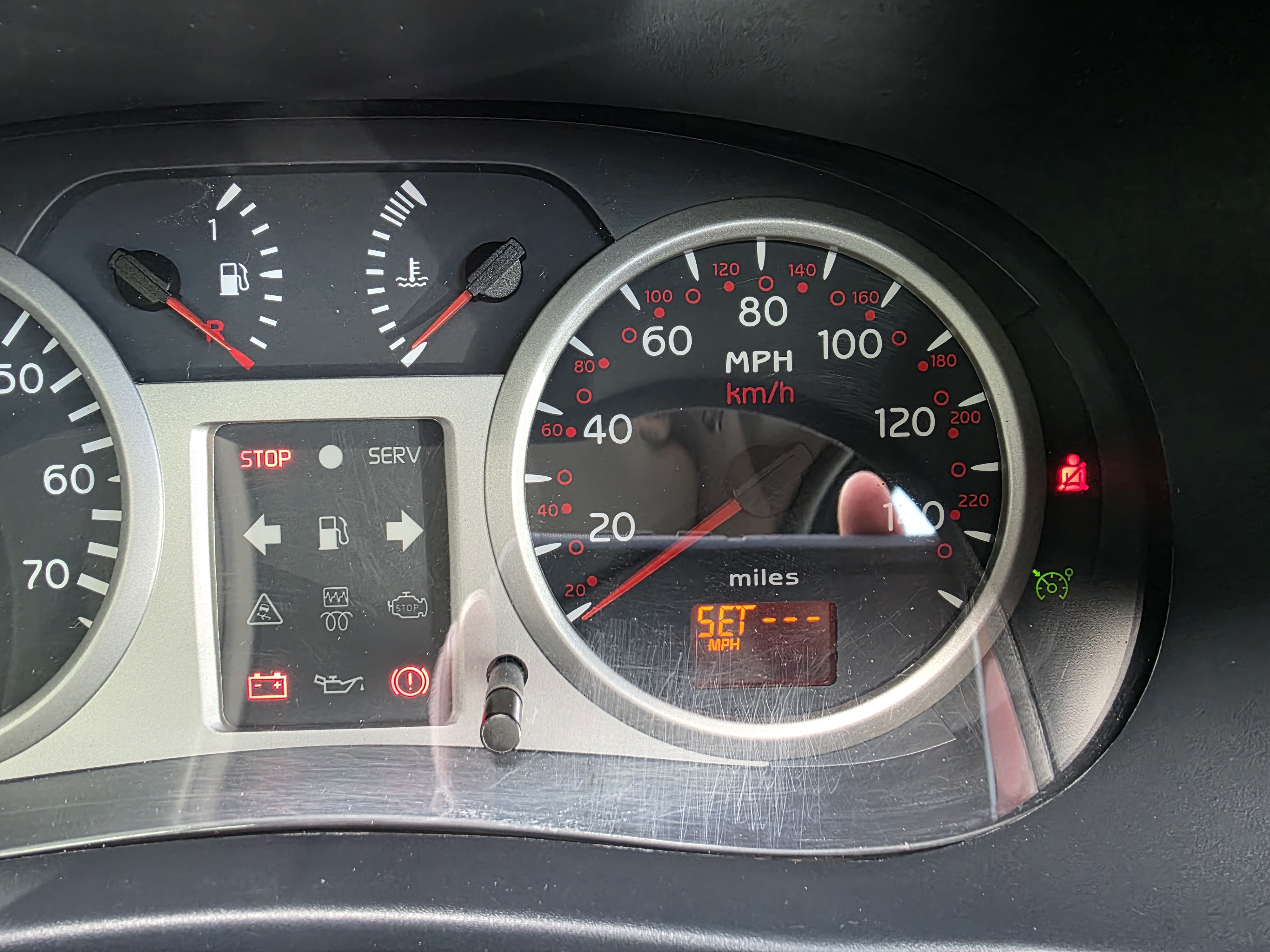

Cruise works awesome. A couple of quirks noted, the speedo needle reads faster than the set speed and sometimes it lands on an odd or even numer and can go up on 1 or 2mph increments depending on what it feels liek? Very french i guess.

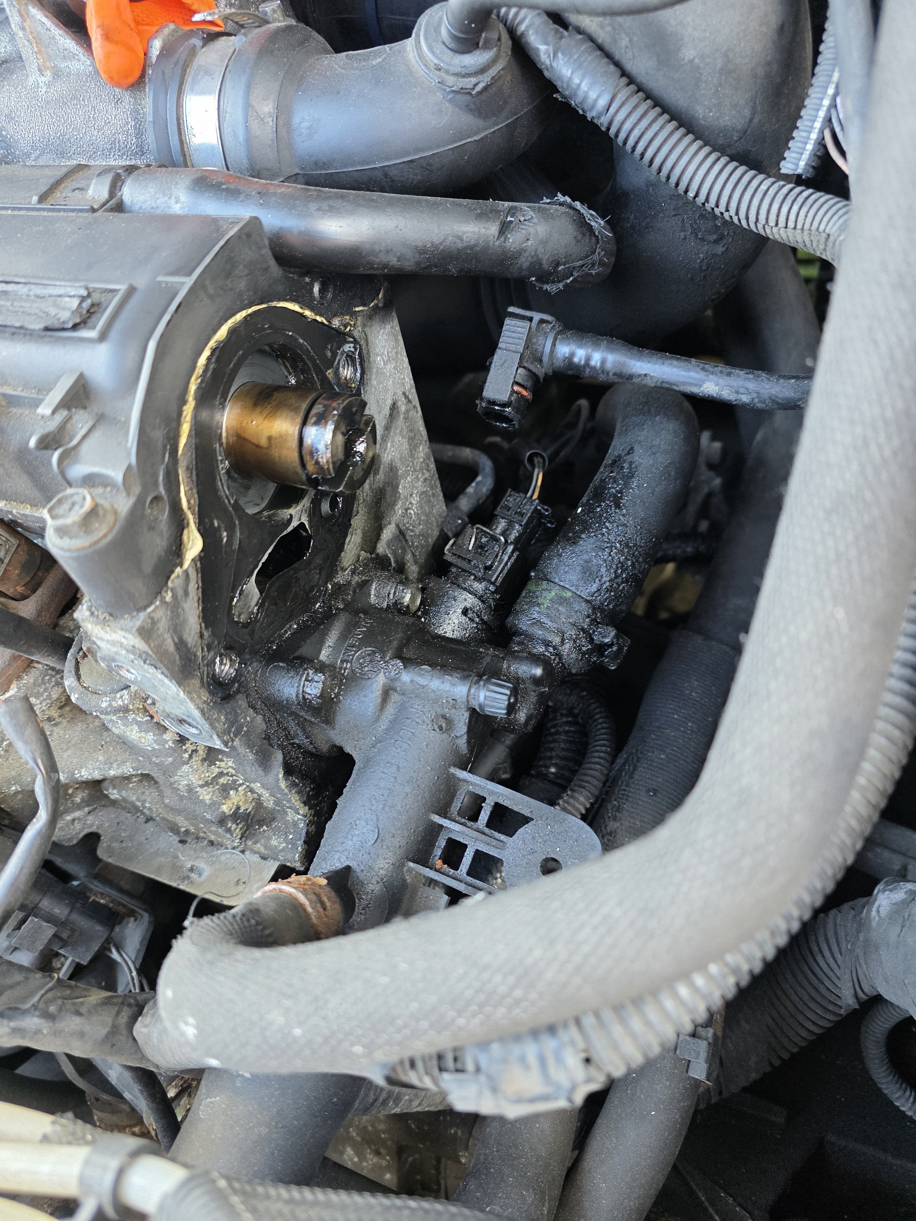

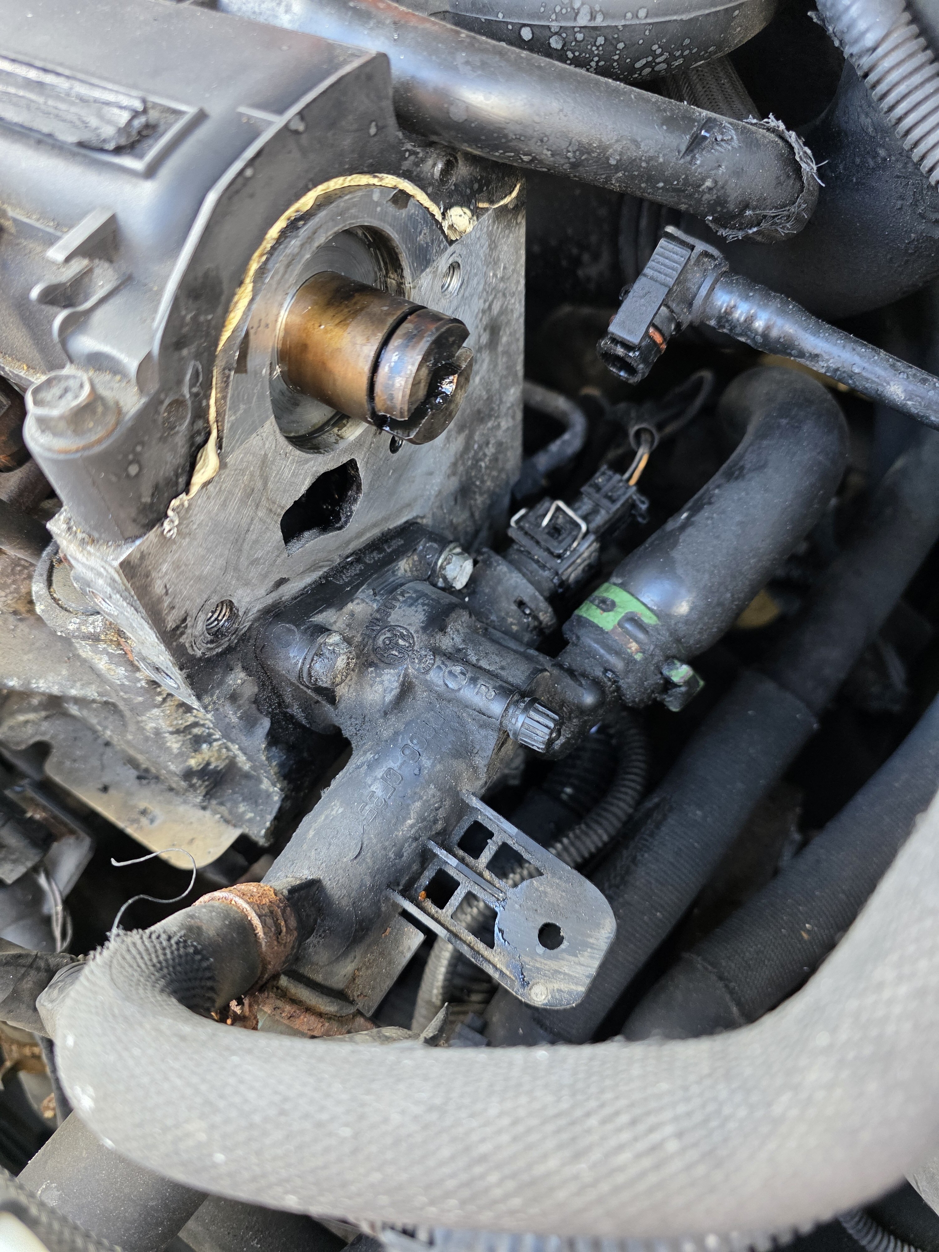

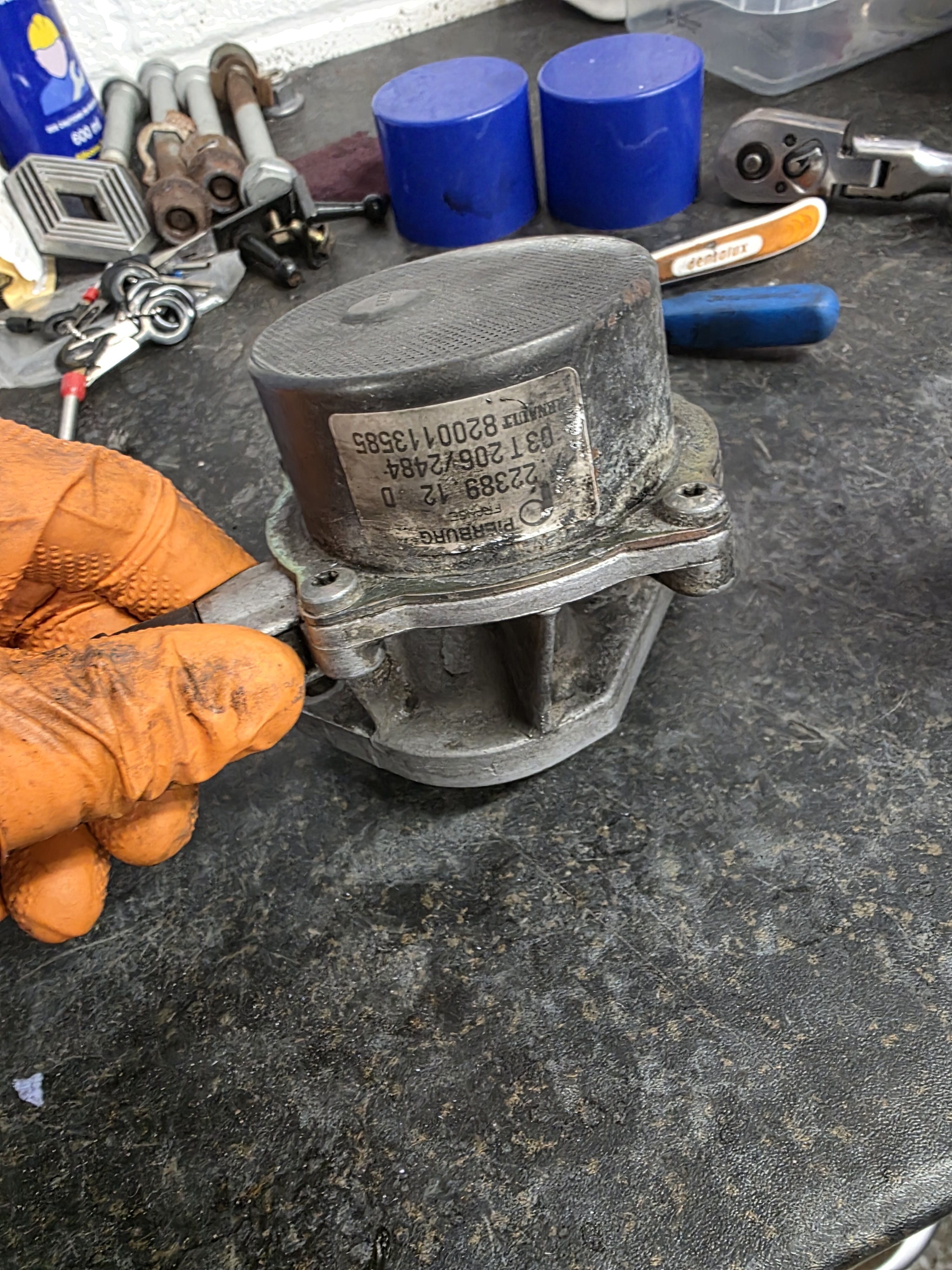

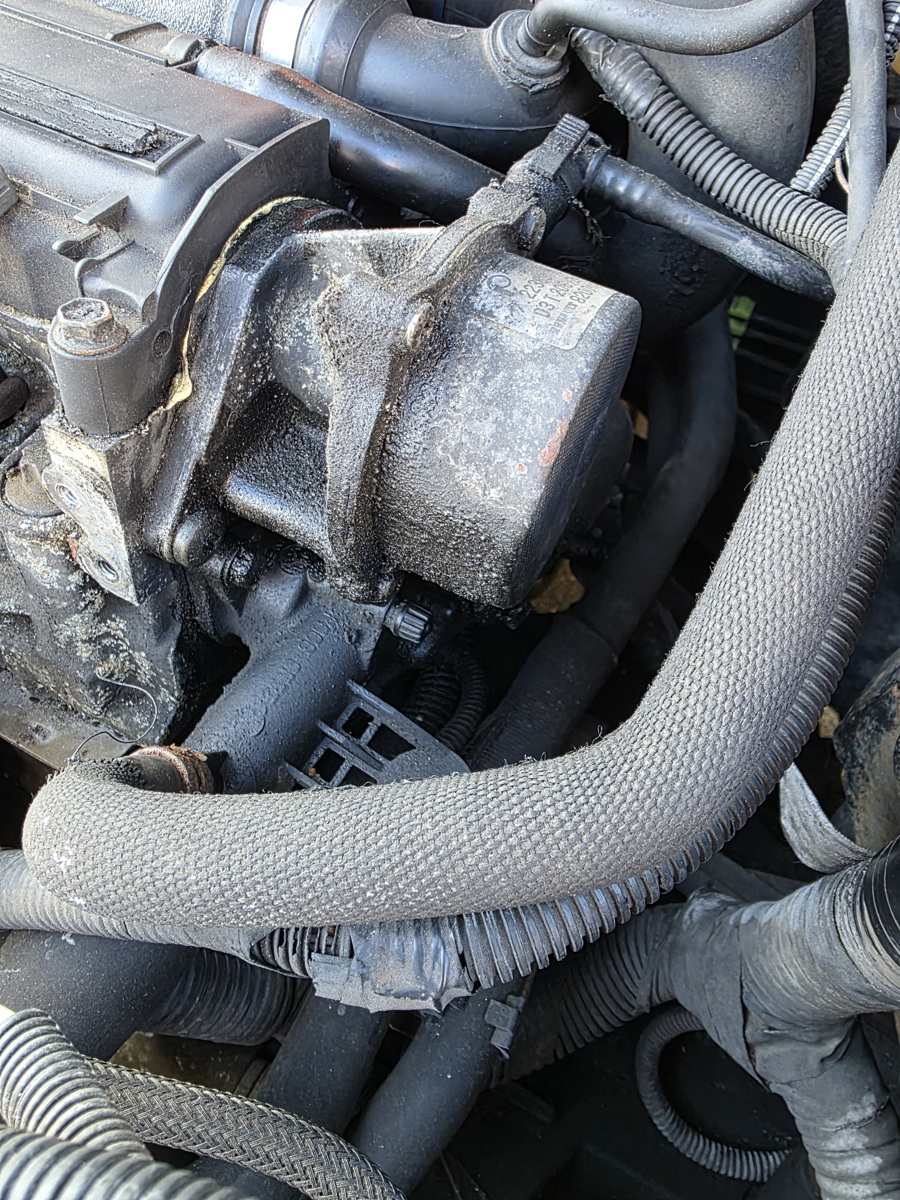

Anyway onto next job. Vac pump gasket / gaskets on the cylinder head has been leaking for some time. The leak is fairly minor but stuff underneath it is coated in thick oil. Ordered a gasket kit for the vac pump and whipped it off on sat to repair.
Offending vac pump
Removed, simple 2 bolts.
Pretty manky. It was twice as bad as this but brake cleanered it a few thousand ago as noticed oil all over the area including on clt sensor and crank sensor, have been monitoring it since. Assumed gasket and seals had both failed. The gasket to cylinder head was reused when i rebuilt the engine as the gasket set had the wrong one in the kit. As i was stuck i give it a light coat of sealant and sent it. Lasted 70 thousand miles so cant moan.
Quick clean up.

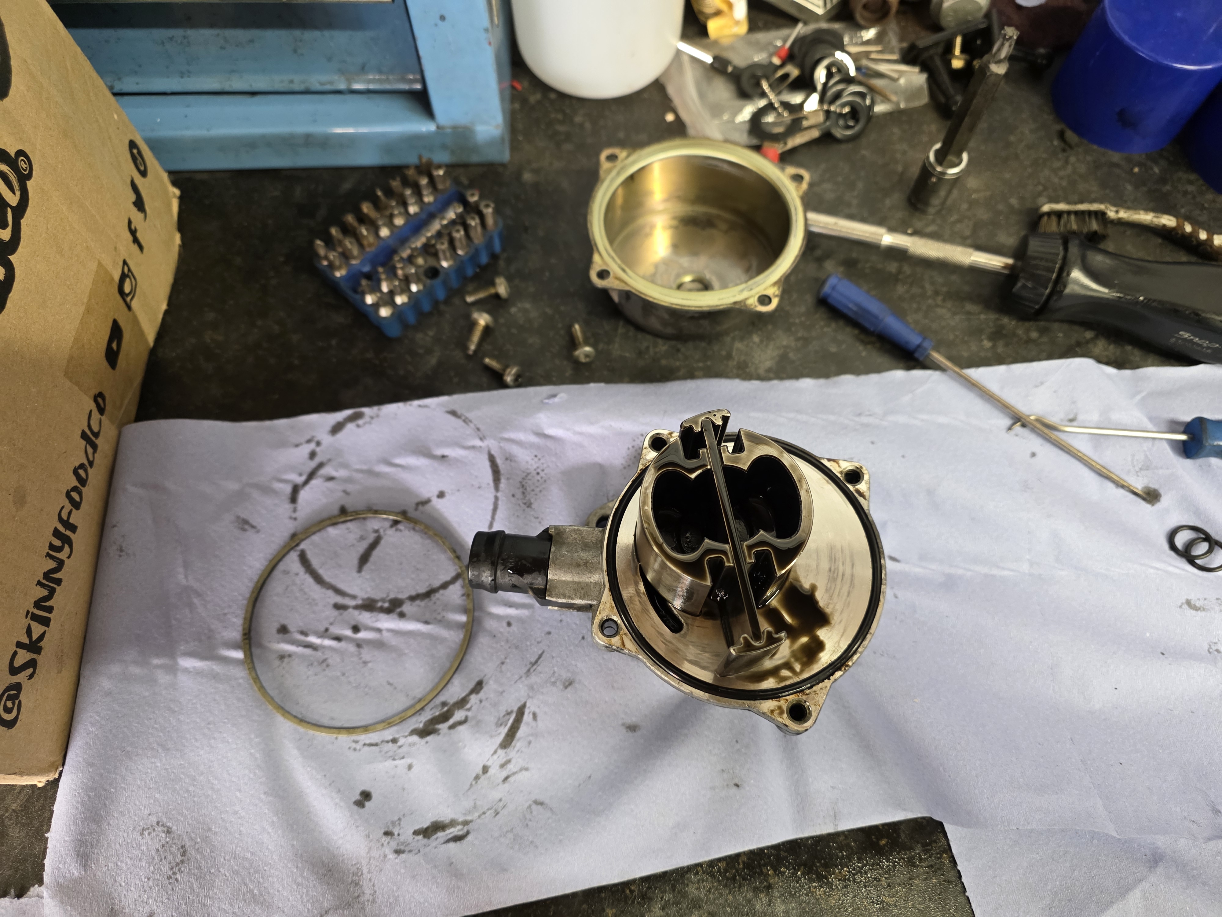

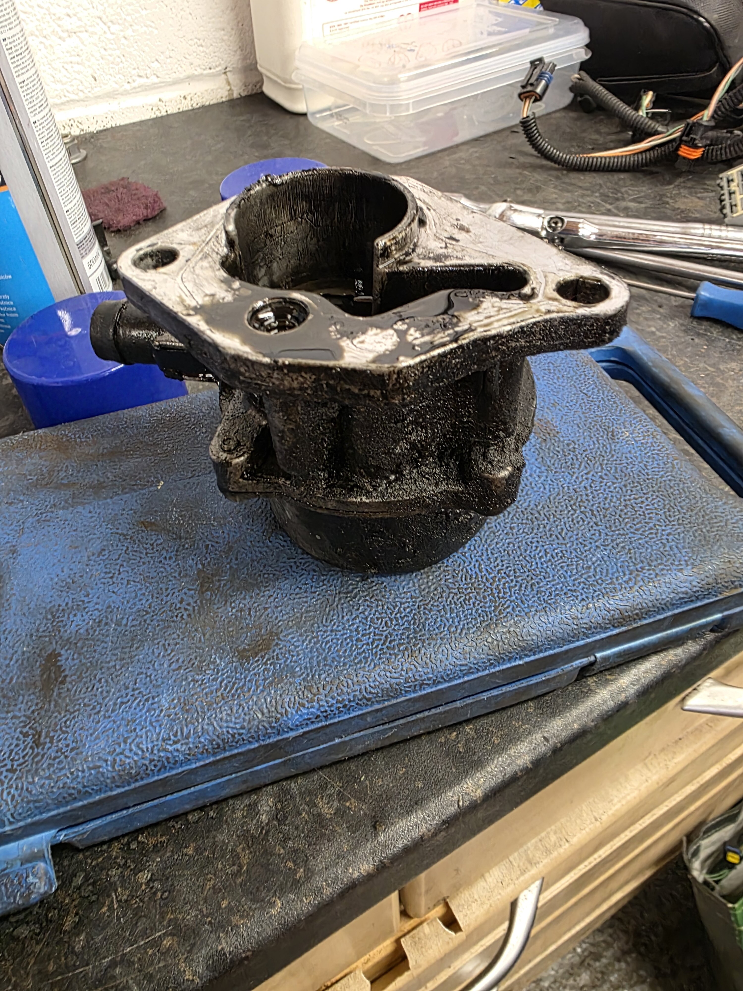

Vac pump on the bench.
Scrubbed with brake cleaner.
Stripped down and new seal fitted. Small filters cleaned. Nice easy job.

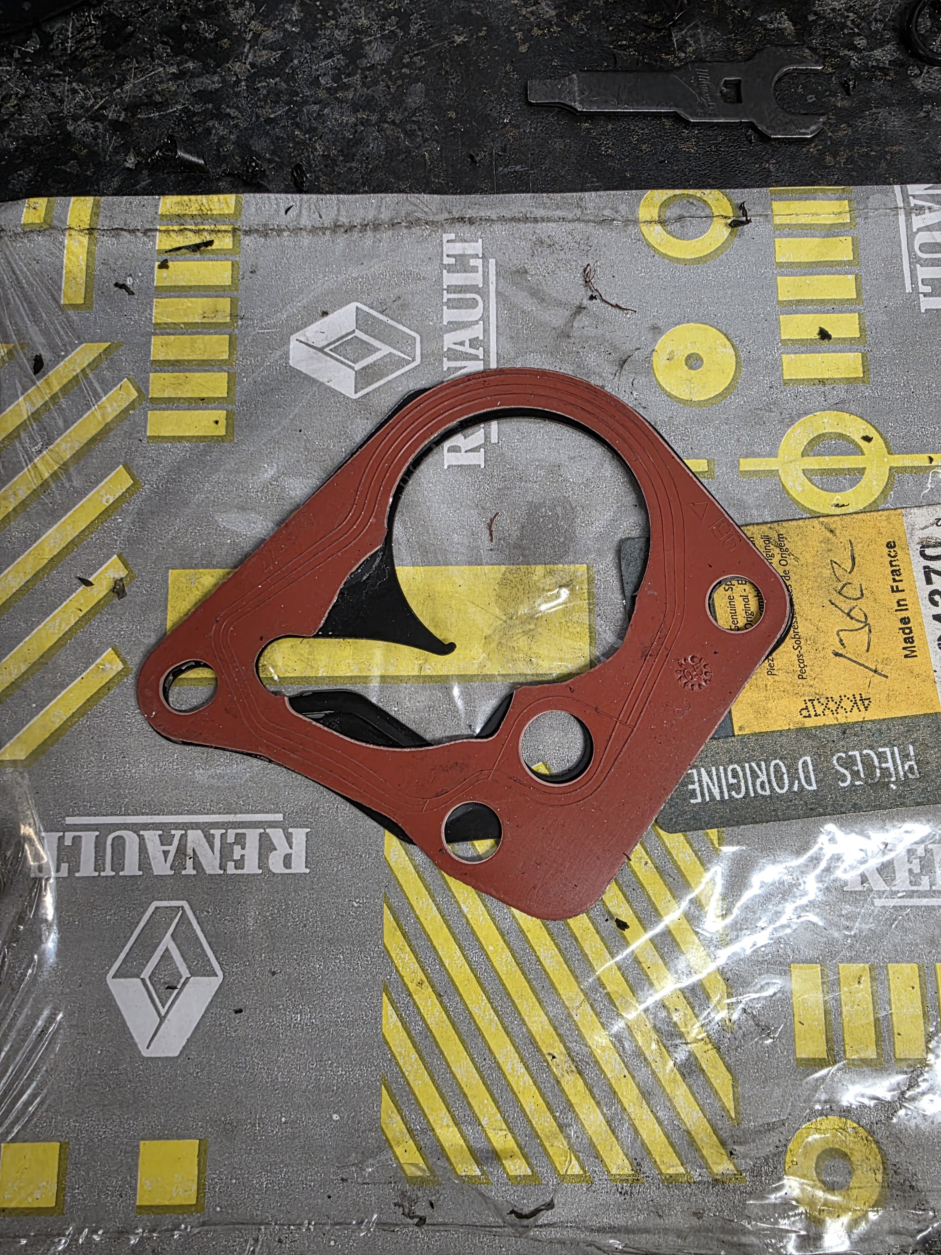

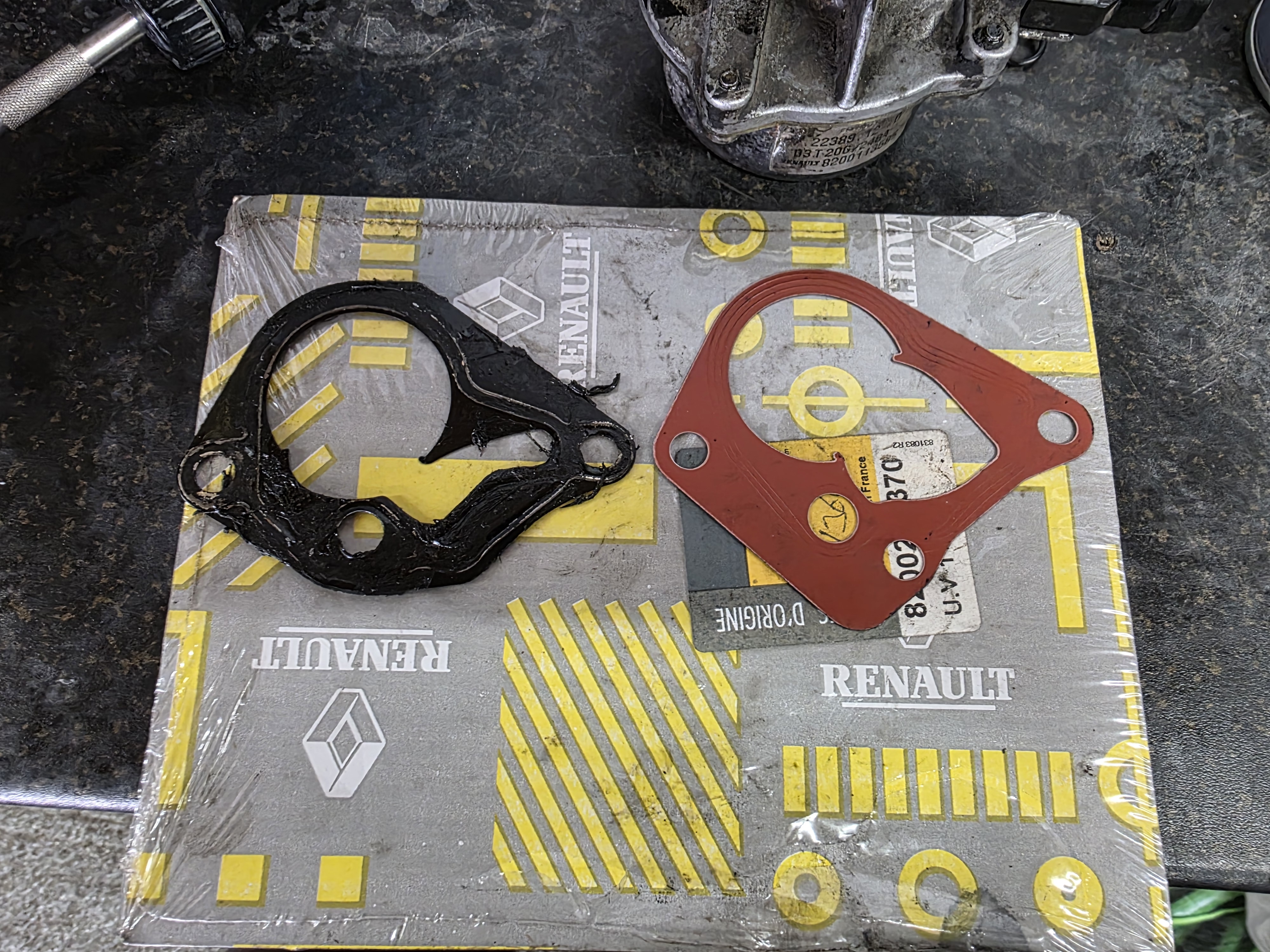

Half hours work. Went to refit with new oem gasket. Wrong fcuking gasket.
Tried ringing round the local motor factors for one and they were all pretty uninterested in helping at all so bit stuck. Reluctant to reuse the old gasket 3rd time, offered up the new gasket against the old and the holes match for oil feed etc, but not the correct shape at what looks to be the return port. Offered against the head and only needed the hole around the port modifying..
Out comes the die grinder and carbide burr to make the fcuker fit. Its not my first rodeo modifying gaskets like this - not sure if ive mentioned my die grinded head gasket when a dowel wouldnt fit!? Worked fine, sometimes you have got to make it work :LOL:
