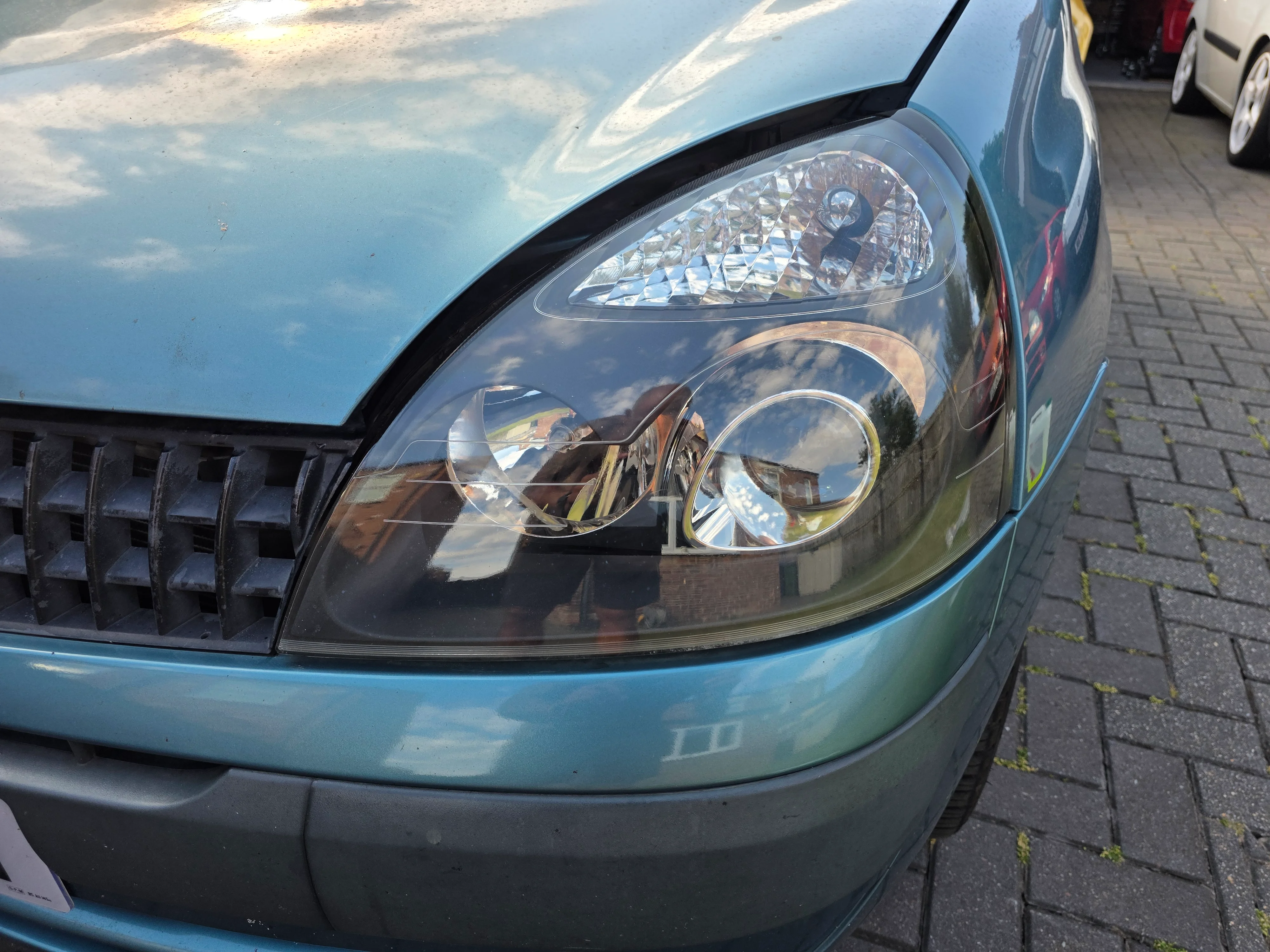

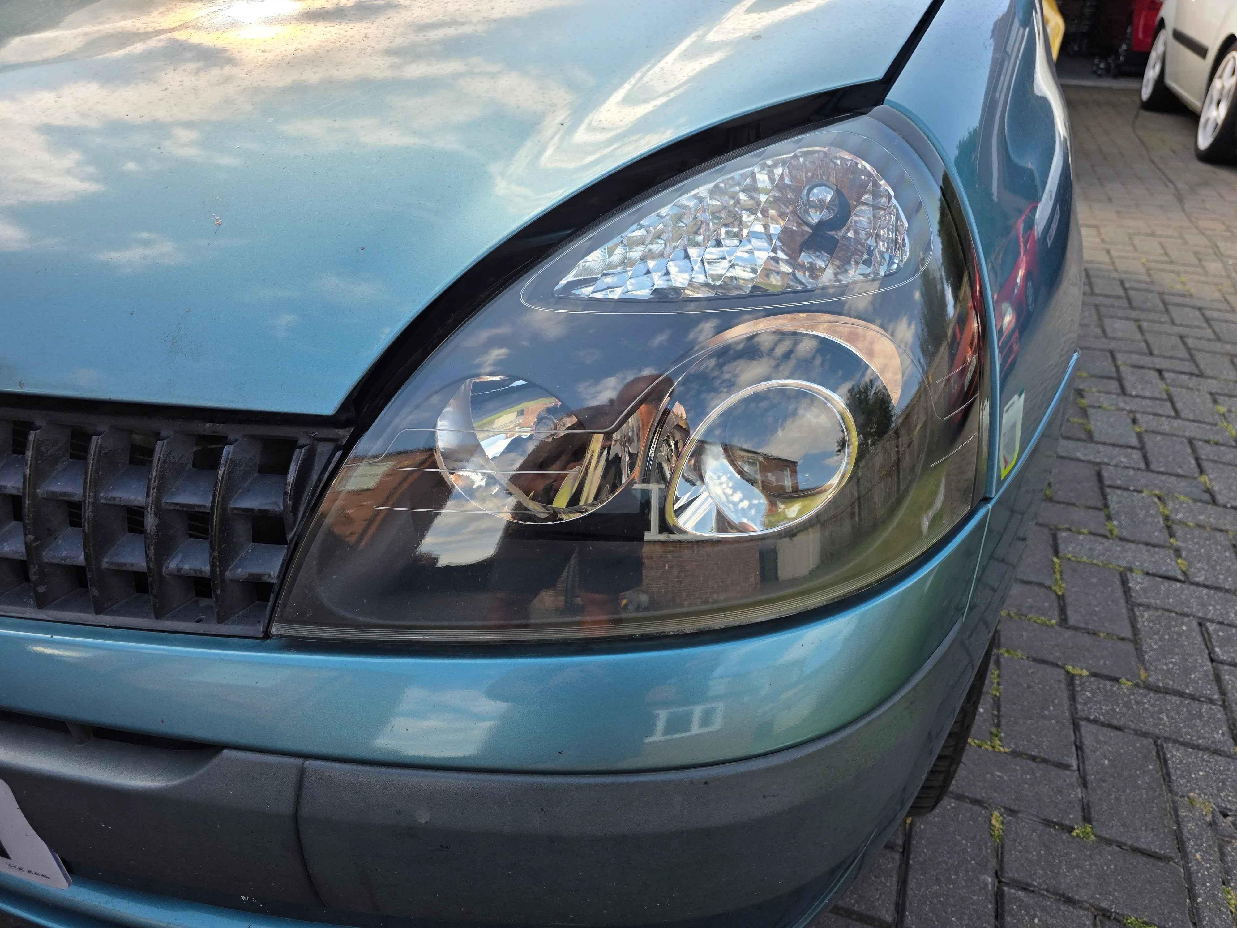

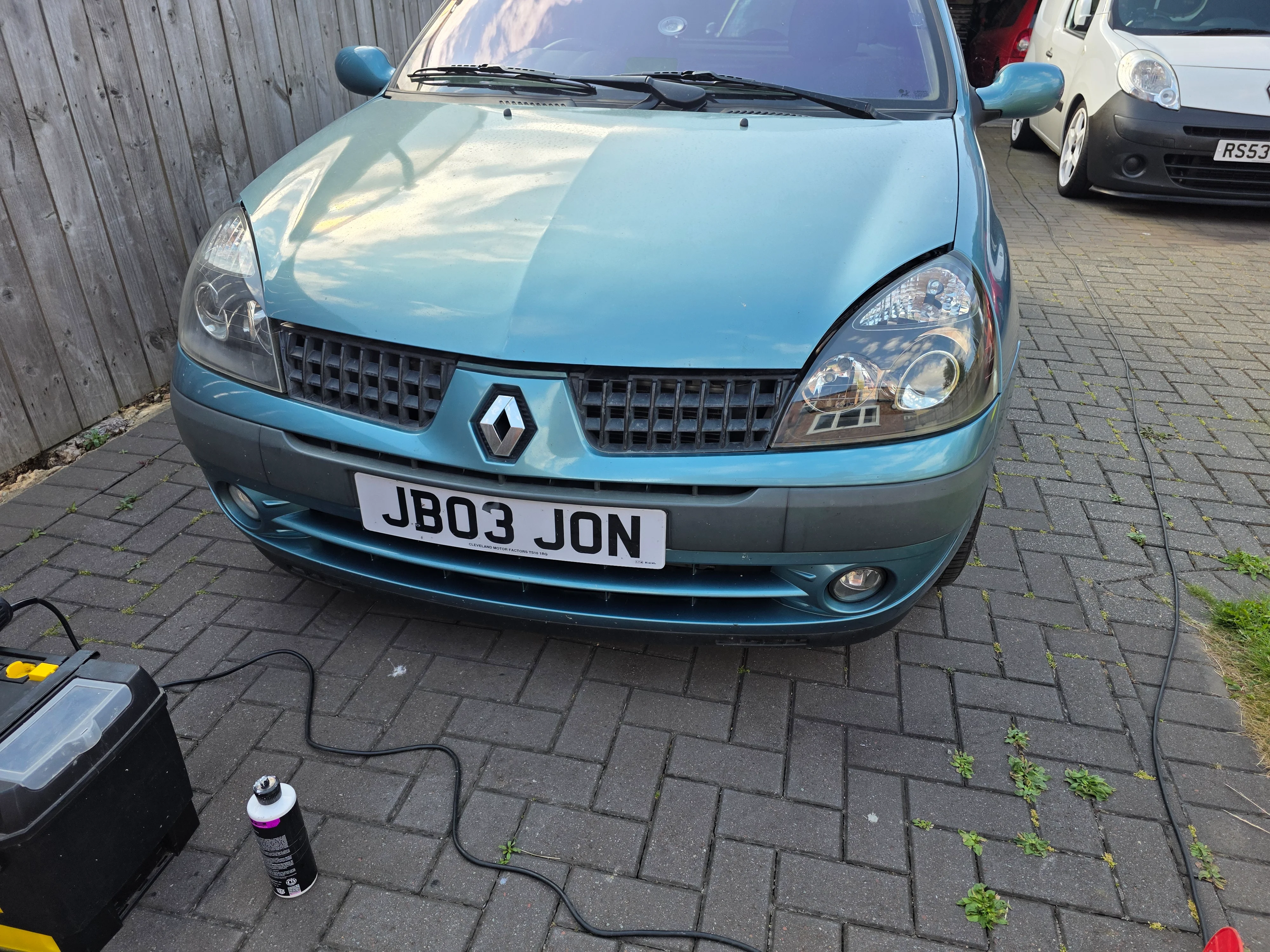

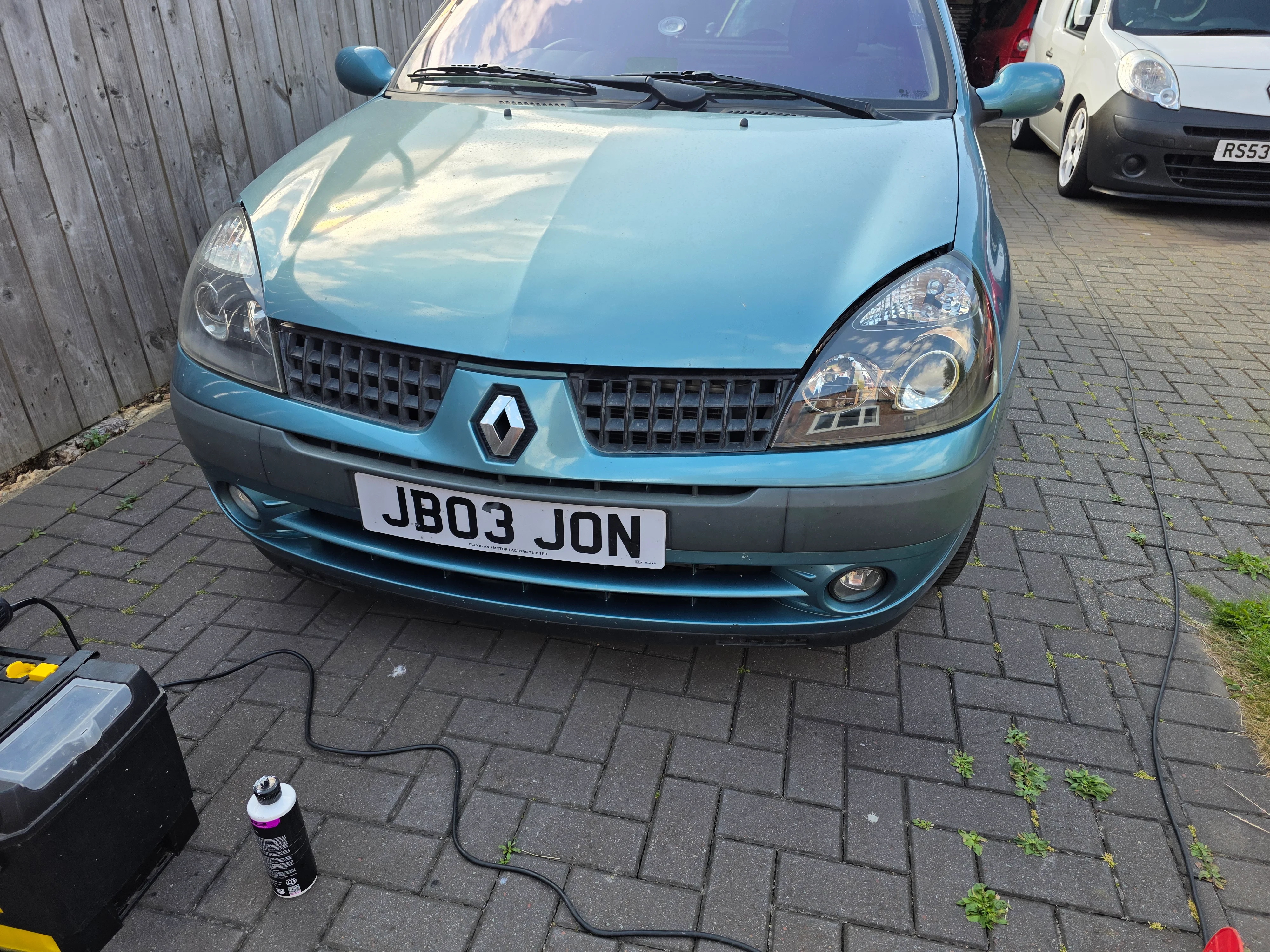

Headlamp polish on the blue dci yesterday.
Coated the headlamoswith Ceracote headlamp restoration kit wipe. This has uv protection apparantly, it applied exactly the same as the trim wipes. Prob same stuff, last trim wipe lasted 18month so we will see.

Headlamp polish on the blue dci yesterday.View attachment 1796652View attachment 1796653
Coated with Ceracote headlamp restoration kit wipe. This has uv protection apparantly, it applied exactly the same as the trim wipes so we will see. Prob same stuff, last trim wipe lasted 18month so we will see.

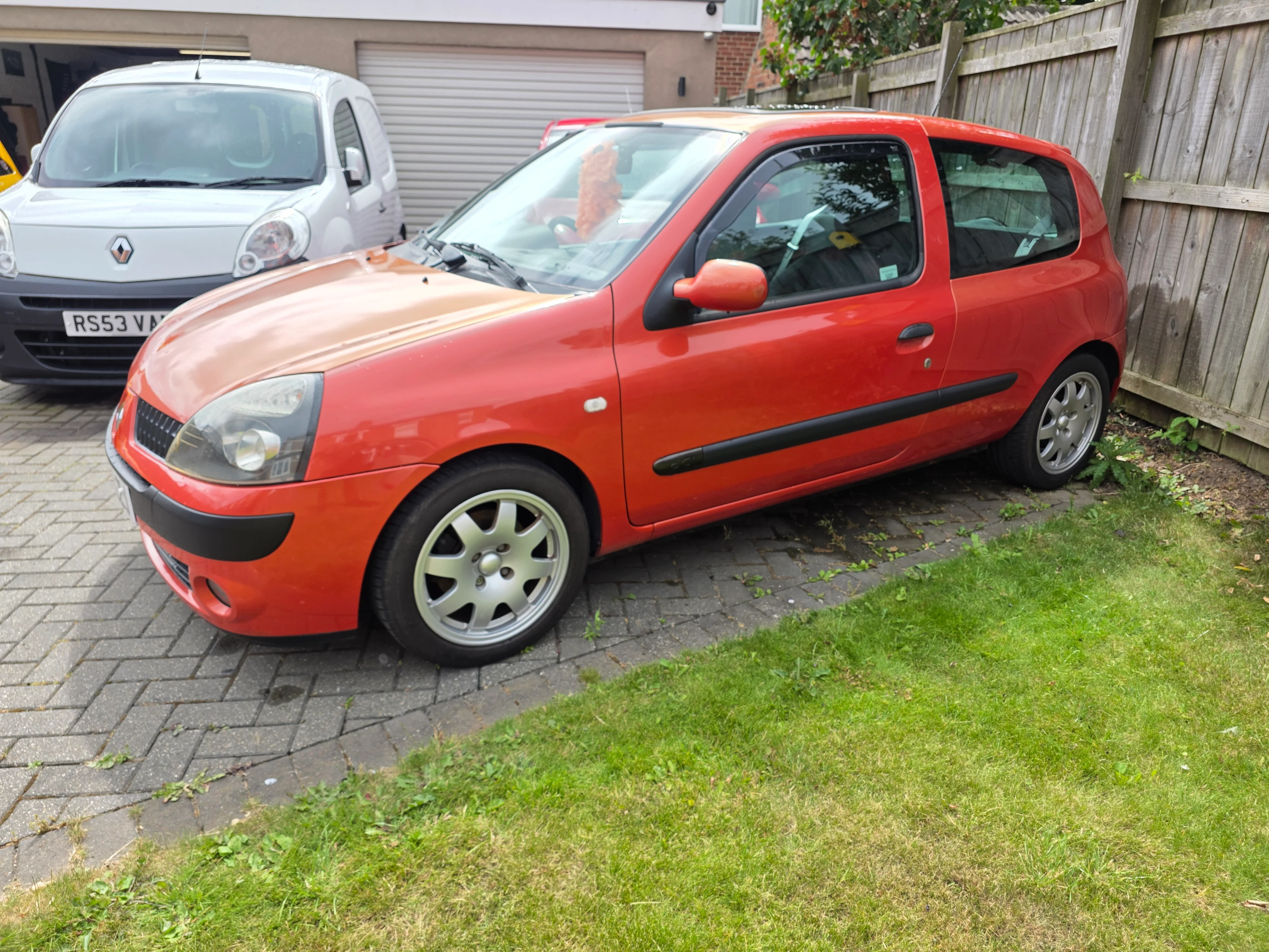

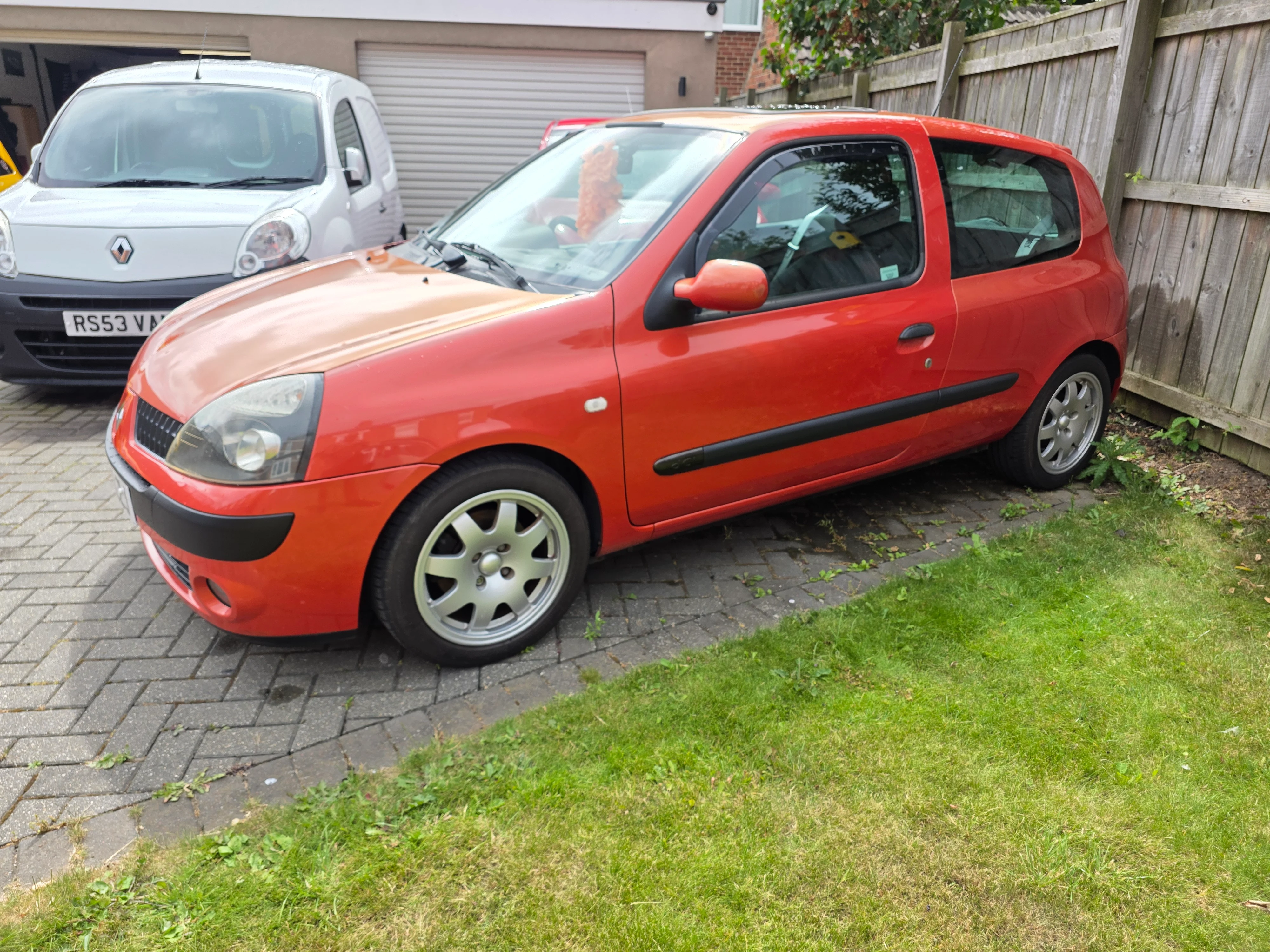

Orange dci washed.

Yeah I used the Ceracote stuff just over a year ago and the headlight is just about starting to go again on the top edge.
I reckon its the same stuff as the trim wipes. Decent though, and easy to apply so pretty good. I didnt use the rest of the kit as just cleaned the lenses with d/a and cutting compound.

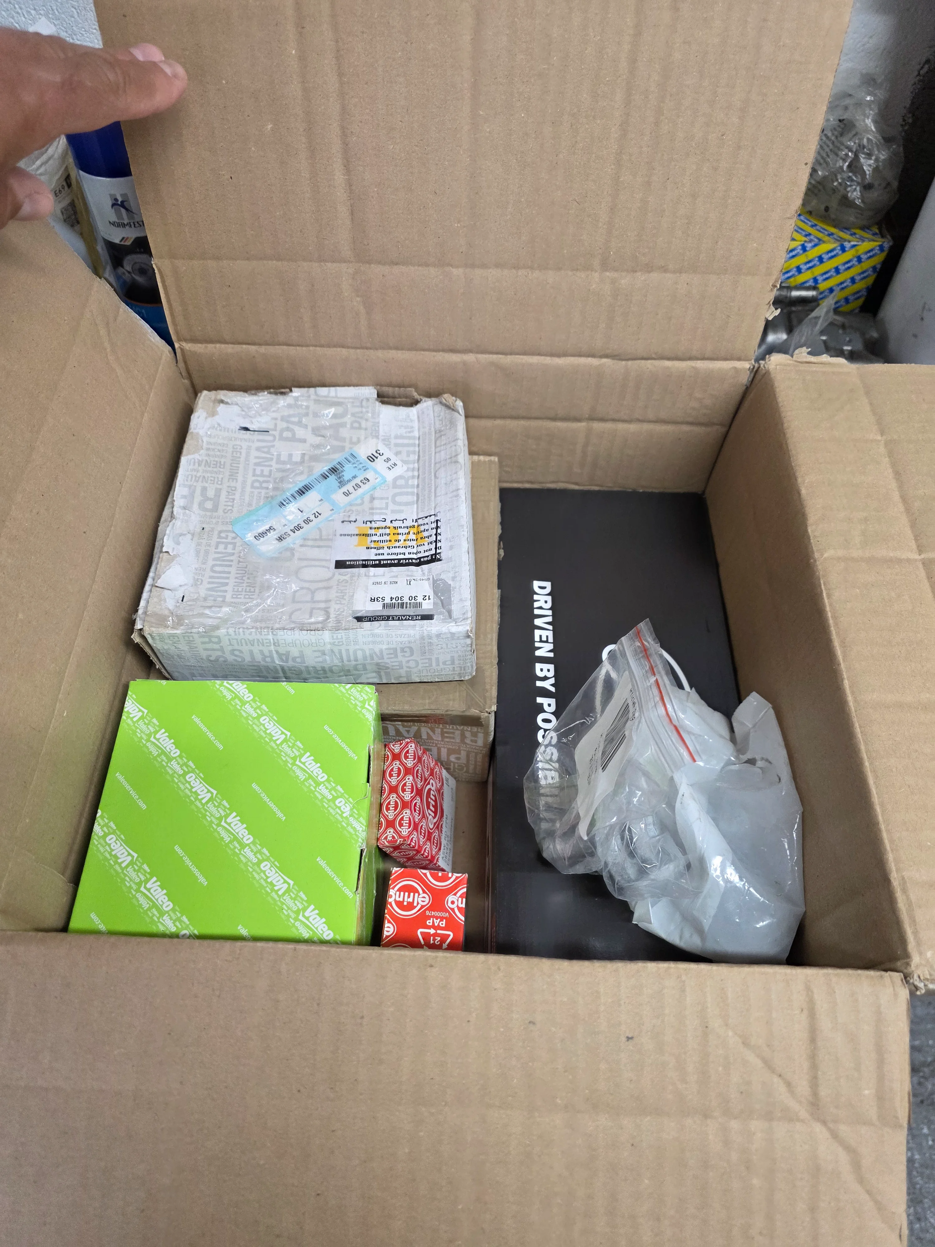

Box of parts which has been sat there for at least 8 months. Planned on doing it in winter but didnt happen.
Gates cambelt kit, gen ren aux kit, valeo water pump, gen ren aux crank pulley etc

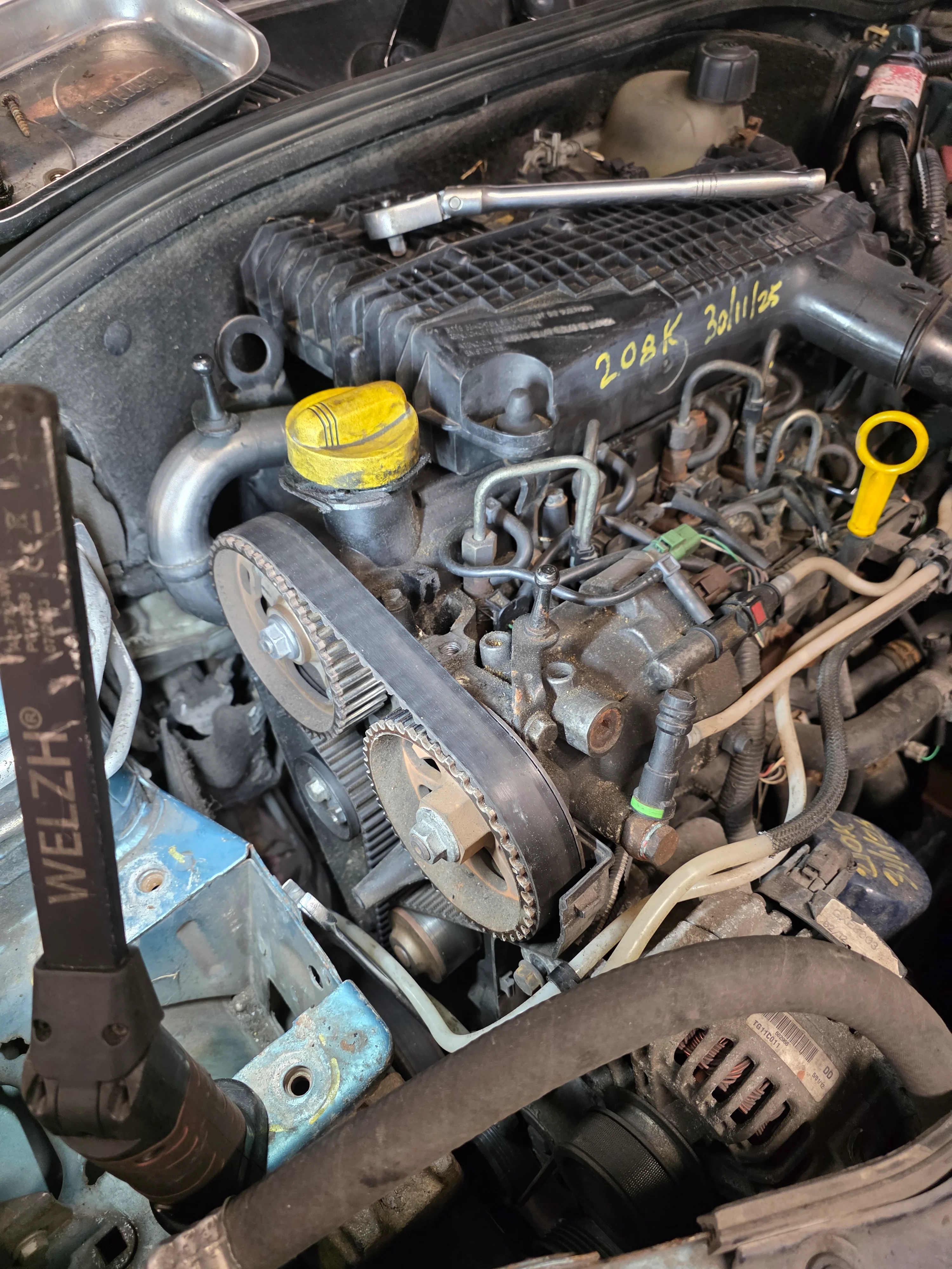

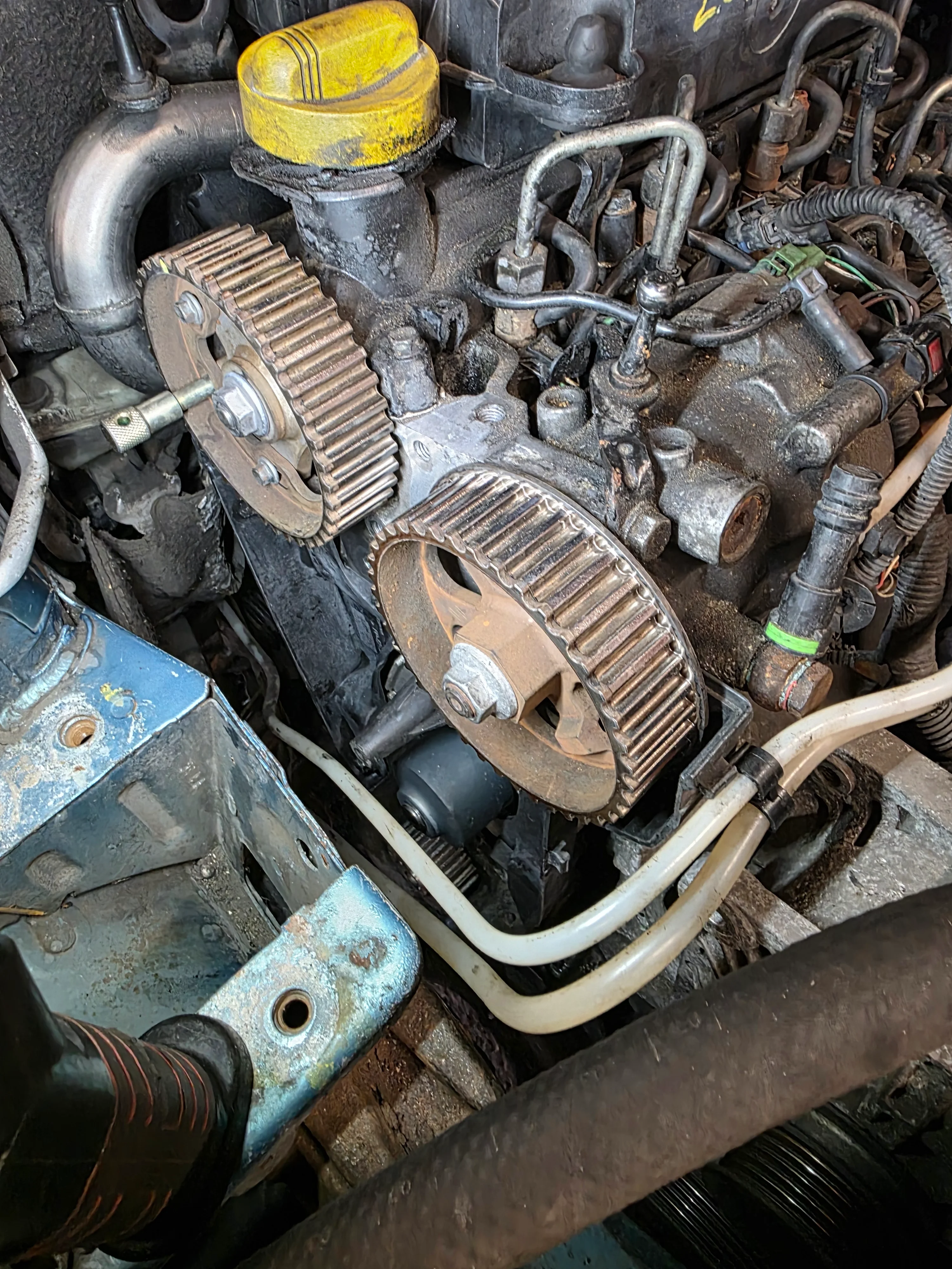

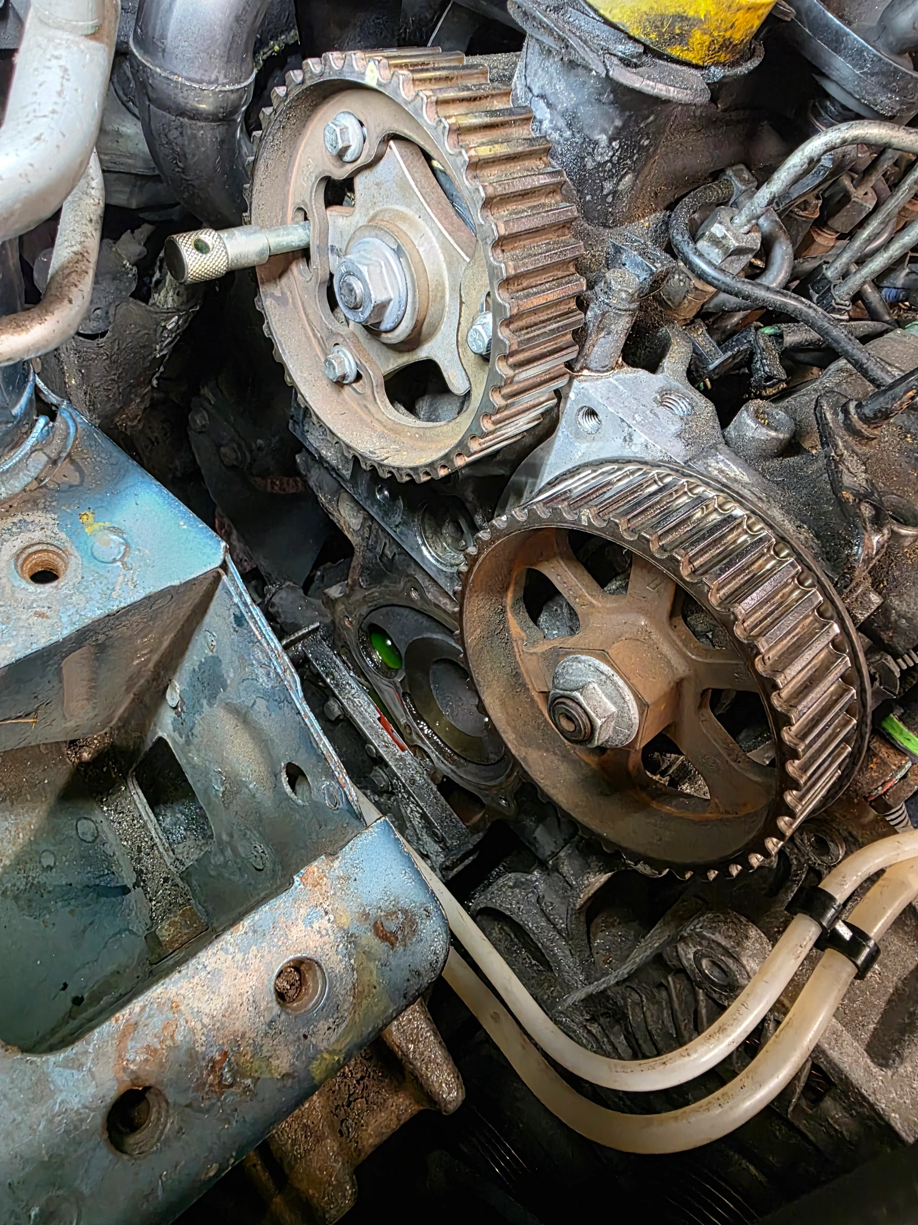

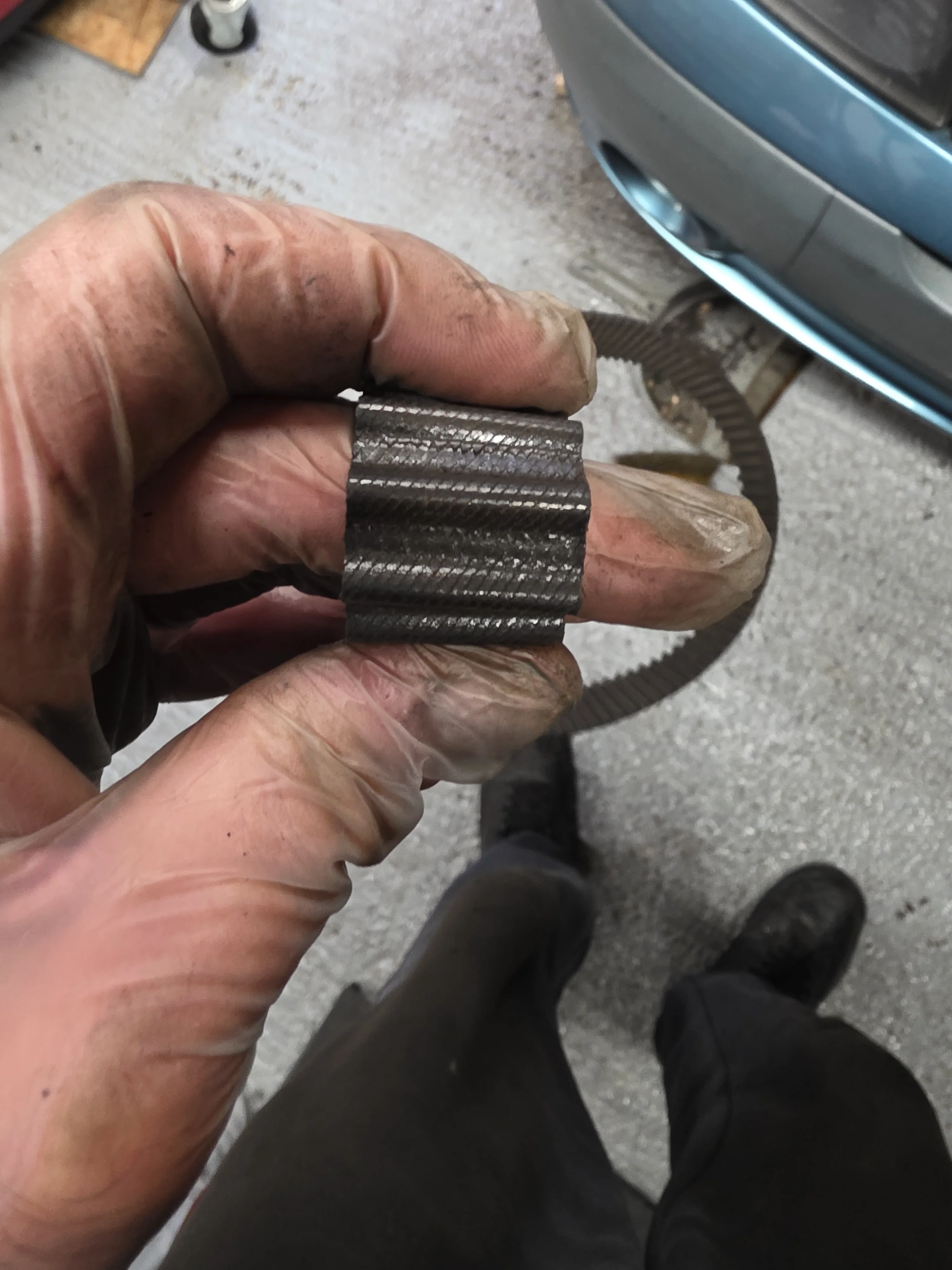

Crank and cam pinned, cambelt removed and inspected, still ok being honest. Id bet the tensioner, waterpump or aux belt into the cambelt would go before it snapped.

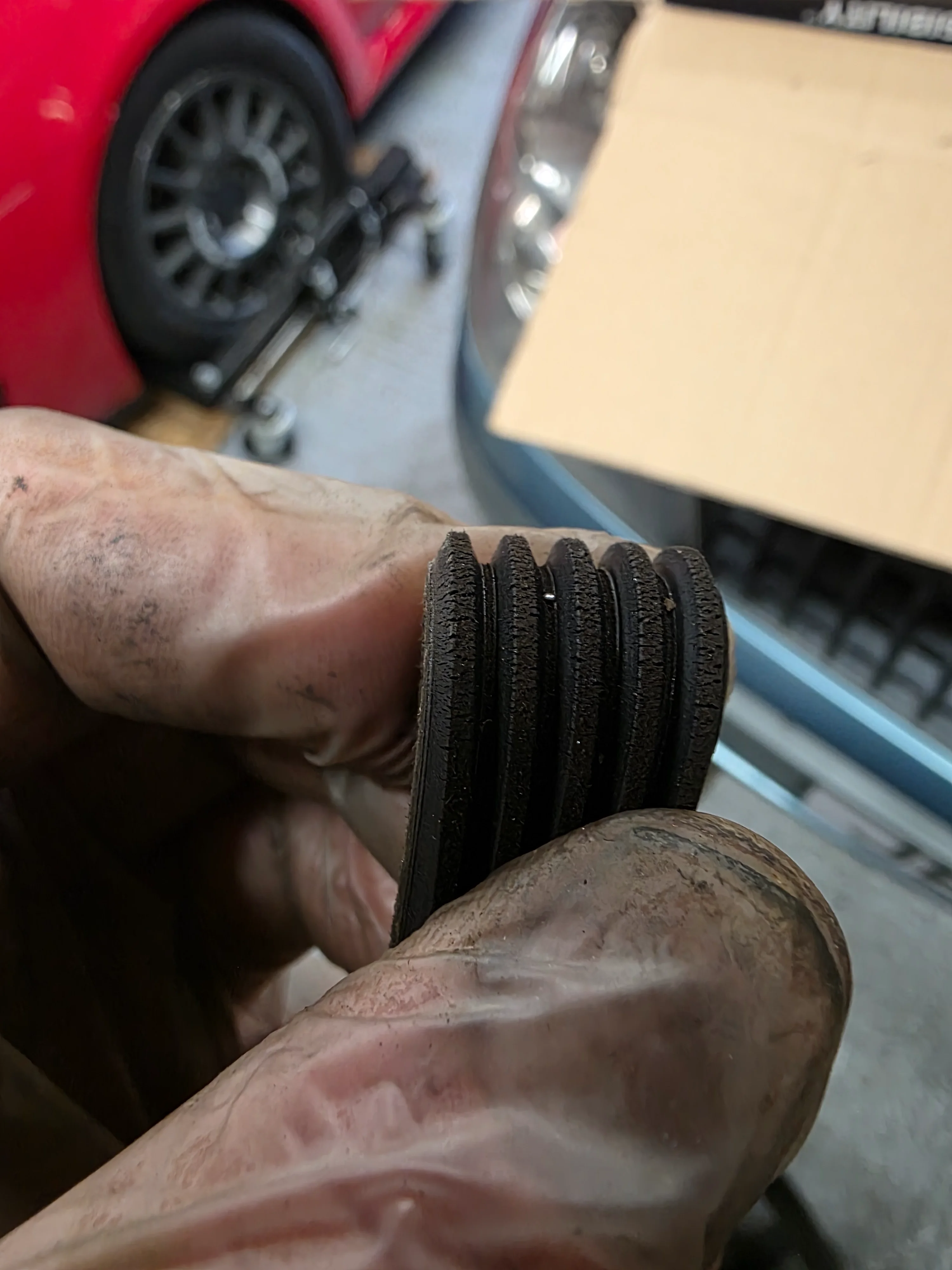

Aux belt starting to crack, not bad as its been on for around 40 thousand as changed at mid point. Tensioner still strong but pulley very worn, this was giving a bit of noise.
Cambelt cover removed and waterpump off, slight traces of coolant leak on waterpump as expected.

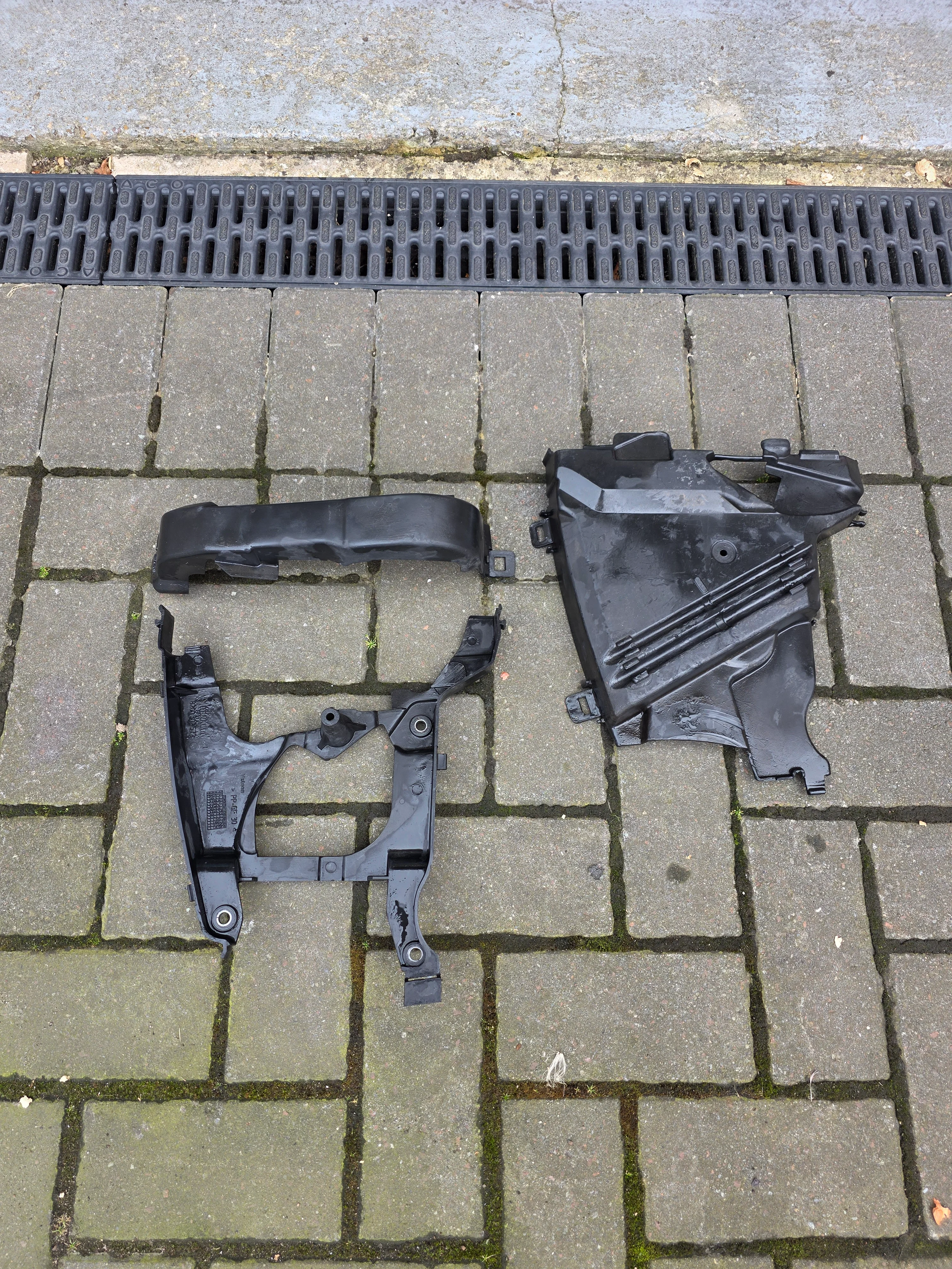

Cambelt covers cleaned/degreased as lots of muck aka dirty diesel.

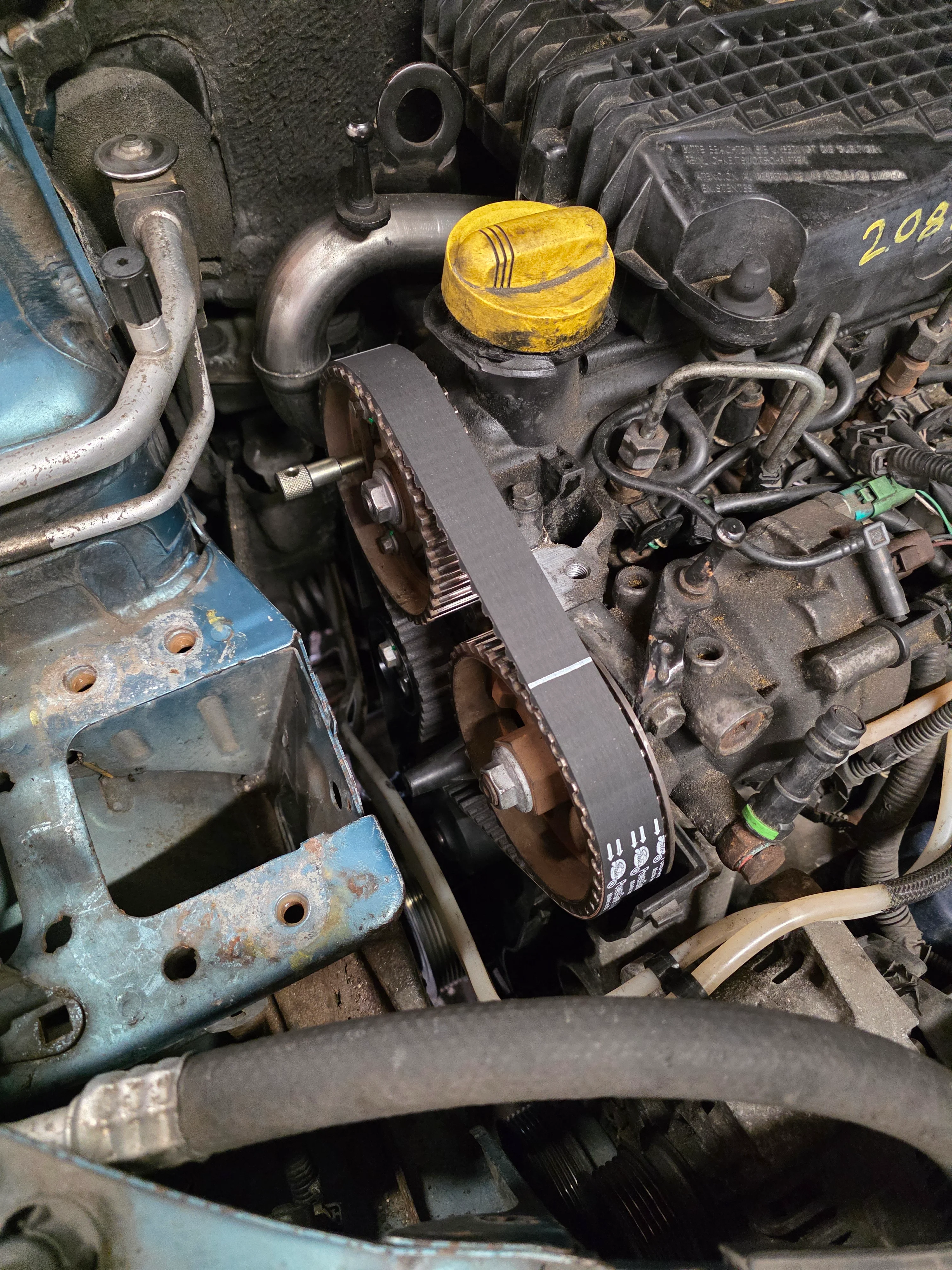

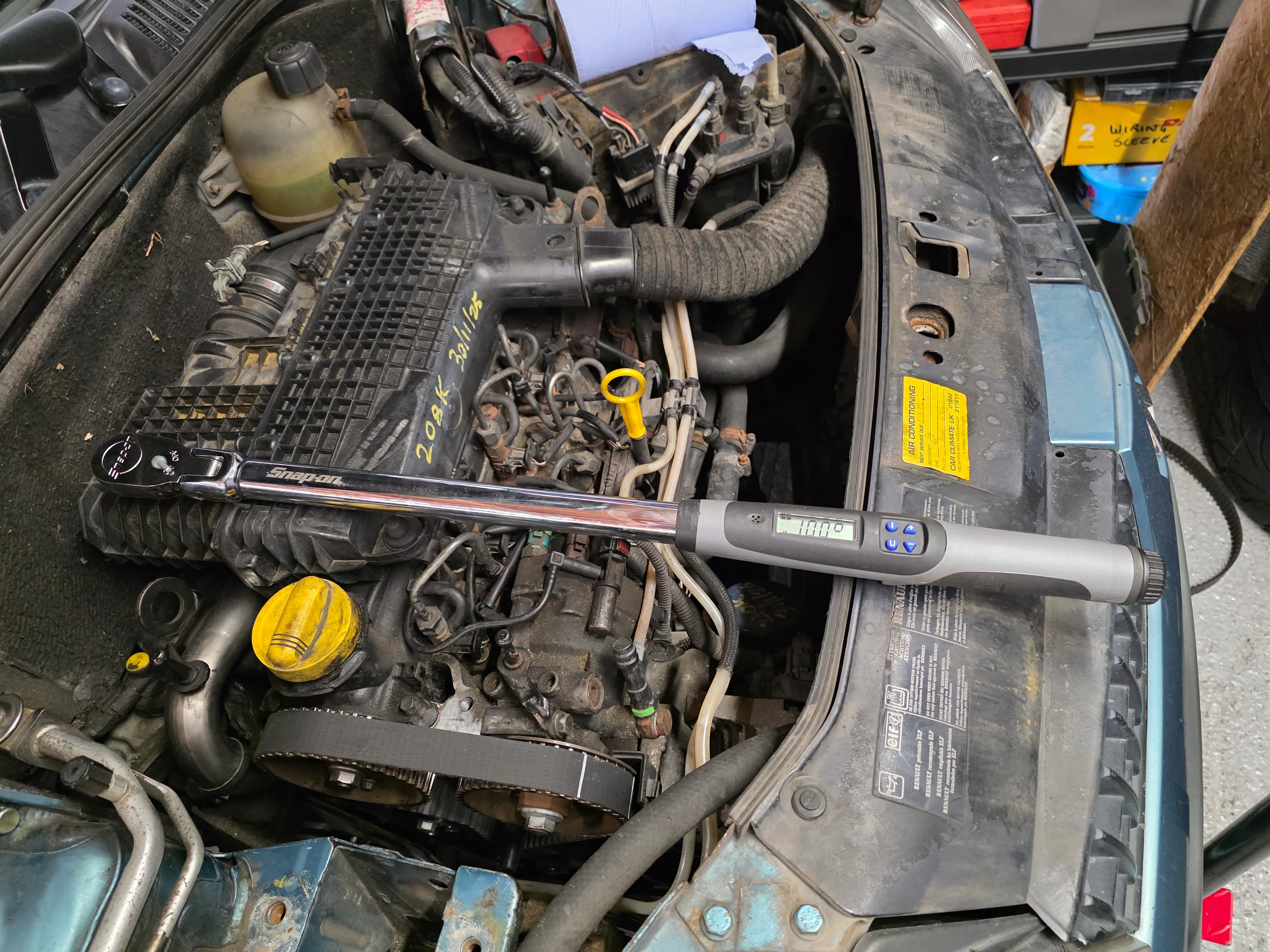

New cambelt belt on, vernier cam pulley loose, diesel pump mark aligned with bolt, tensioner set, torque vernier bolts. Old crank pulley on, rotate belt 2x turns and reset tensioner, check all pins still fit. So easy these 1.5dci's.

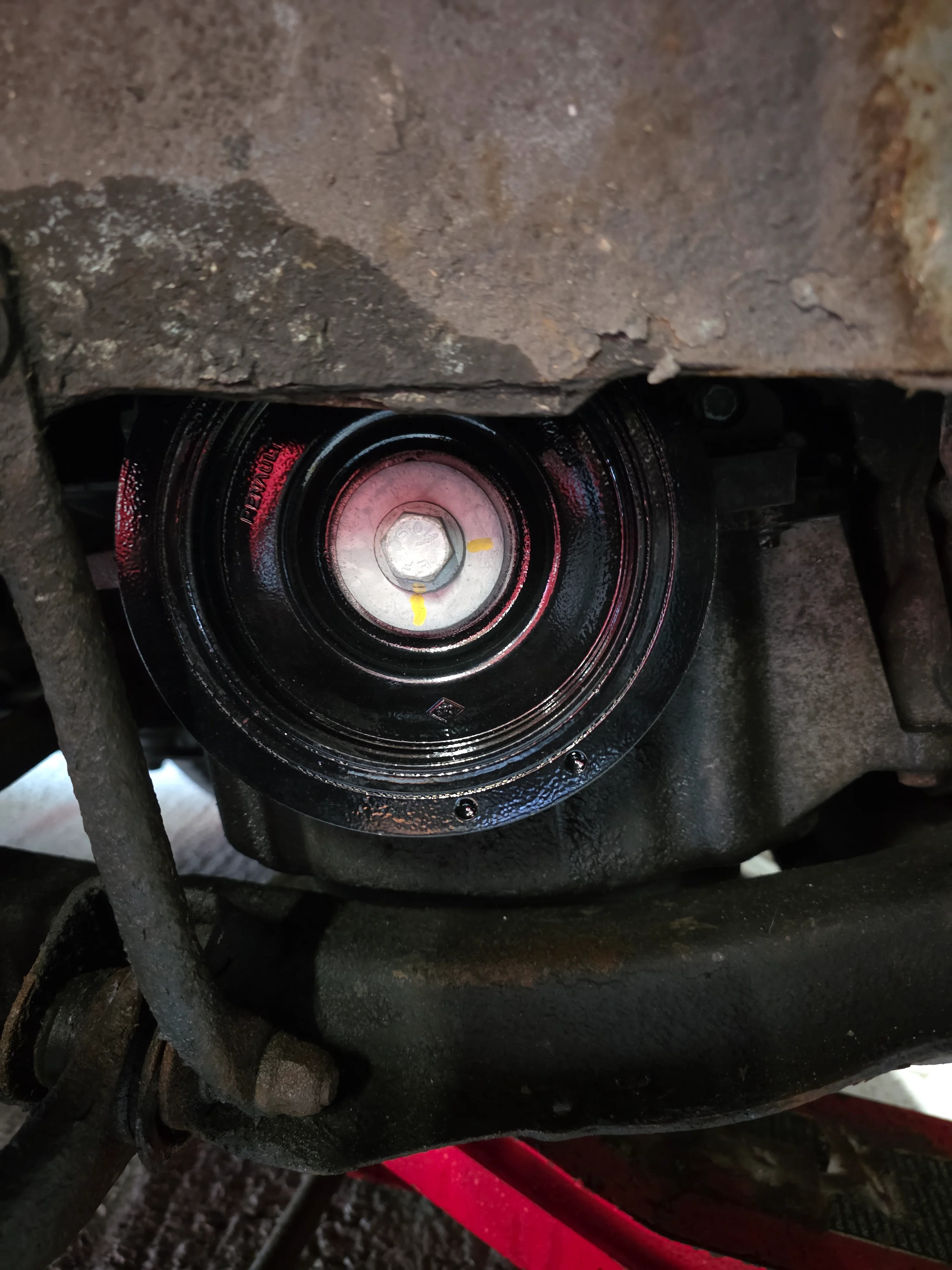

Wand out for the first time in ages to angle torque crank pulley bolt

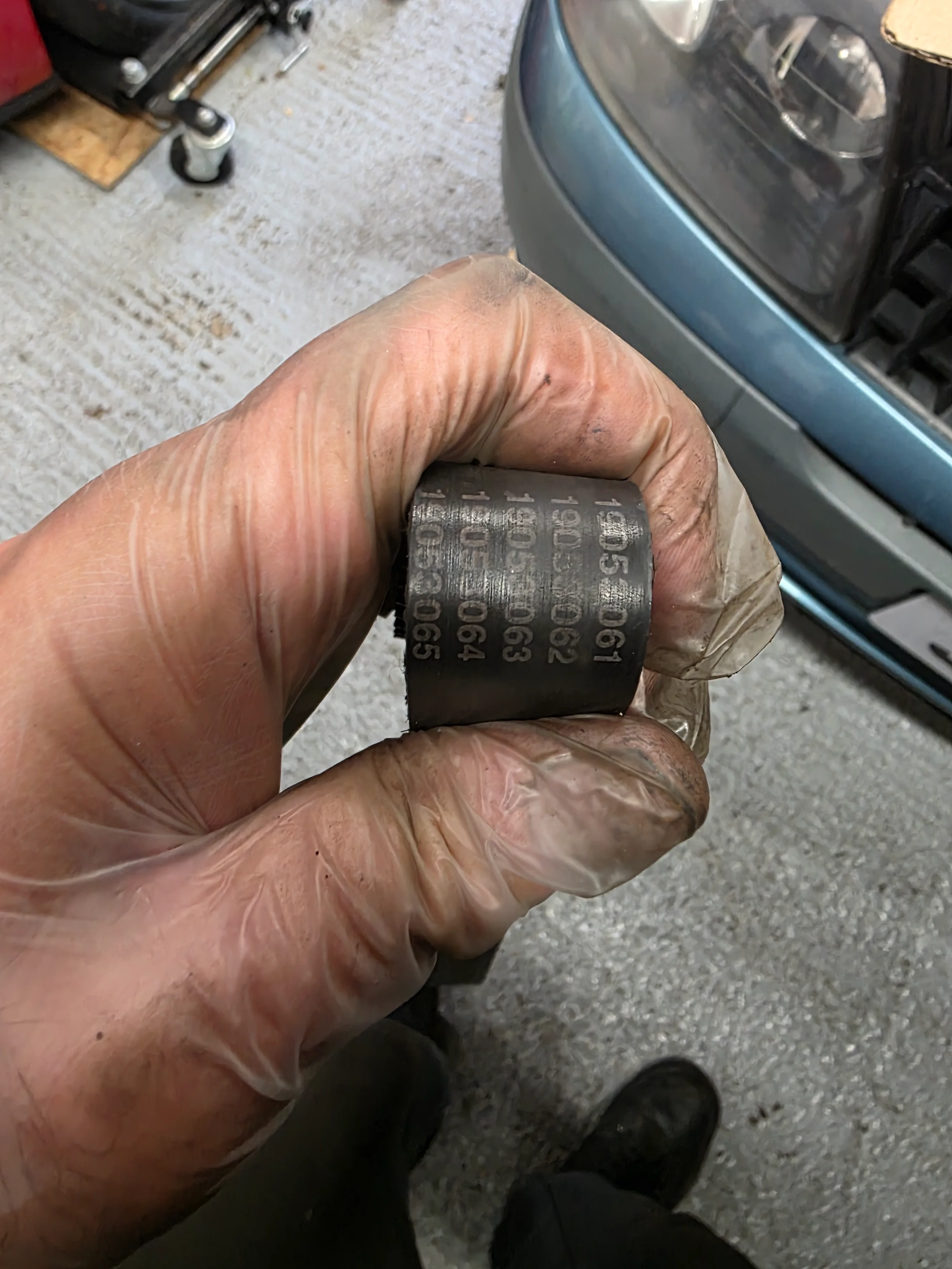

This engine is a bitza, i upgraded the cam pulley to vernier, crank pulley/aux pulley is the old one off the Kangoo compact and is keyed so not floating. Need to be careful with torque settings in this case as m12 and m14 crank bolts. This is m12 bolt as earlier crank, and requires 60nm + 100deg.
New aux pulley fitted, marked just incase

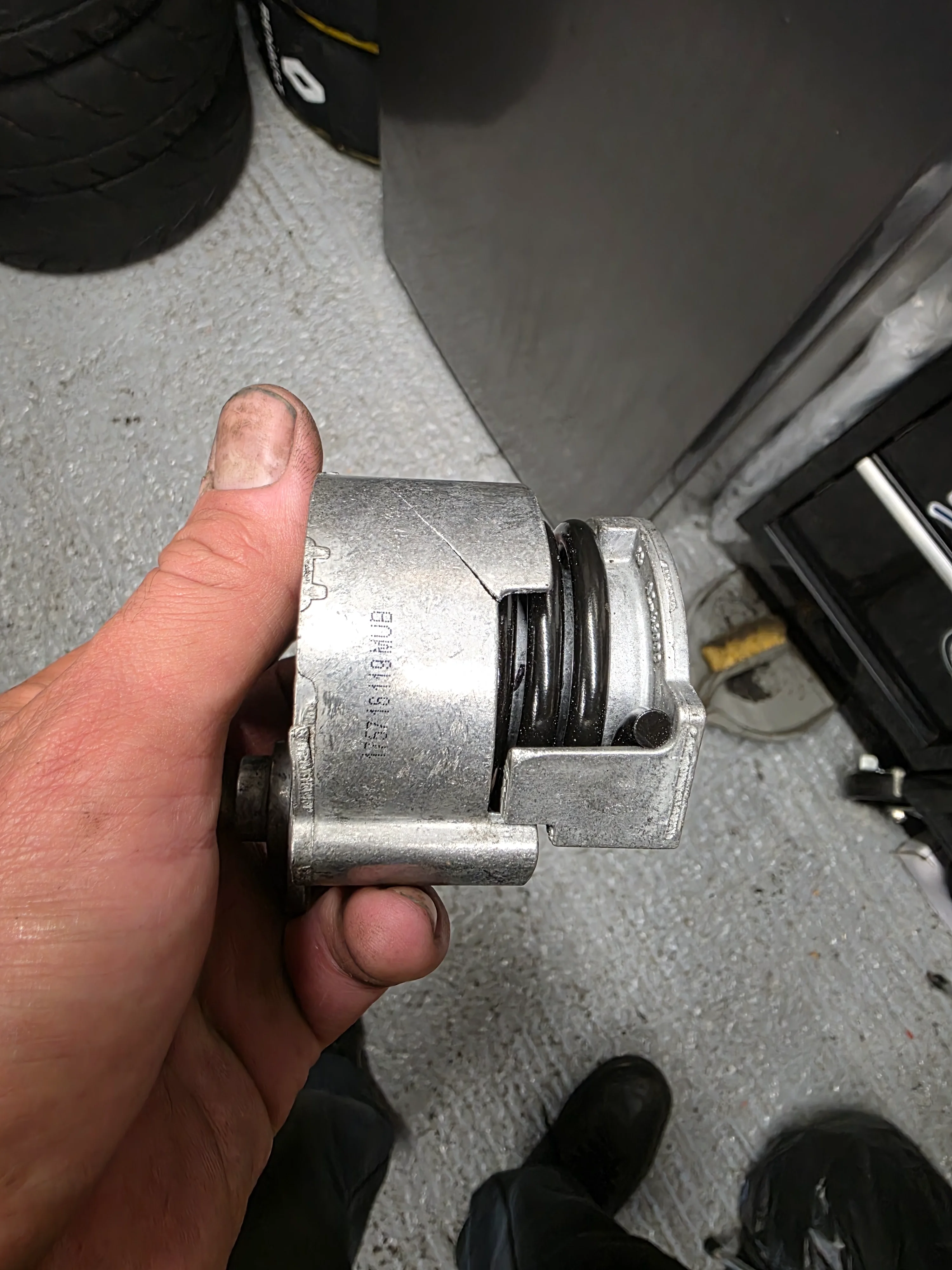

This is where things get a bit interesting. New aux belt tensioner fitted. As this has a later kangoo aux pulley, the belt is tight to get on. Was struggling to get the aux belt on and holding tensioner, next thing bang goes the tensioner and the belt flys on. I was tempted to leave it but removed to inspect as didnt seem right.
Yeah thats fucked..buzzed the idler pulley off and refitted to the old tensioner which seems ok, and made the slot 2mm longer and belt flys on.
Anyway saga over, new kit on order and ill mod new tensioner to avoid same happening.

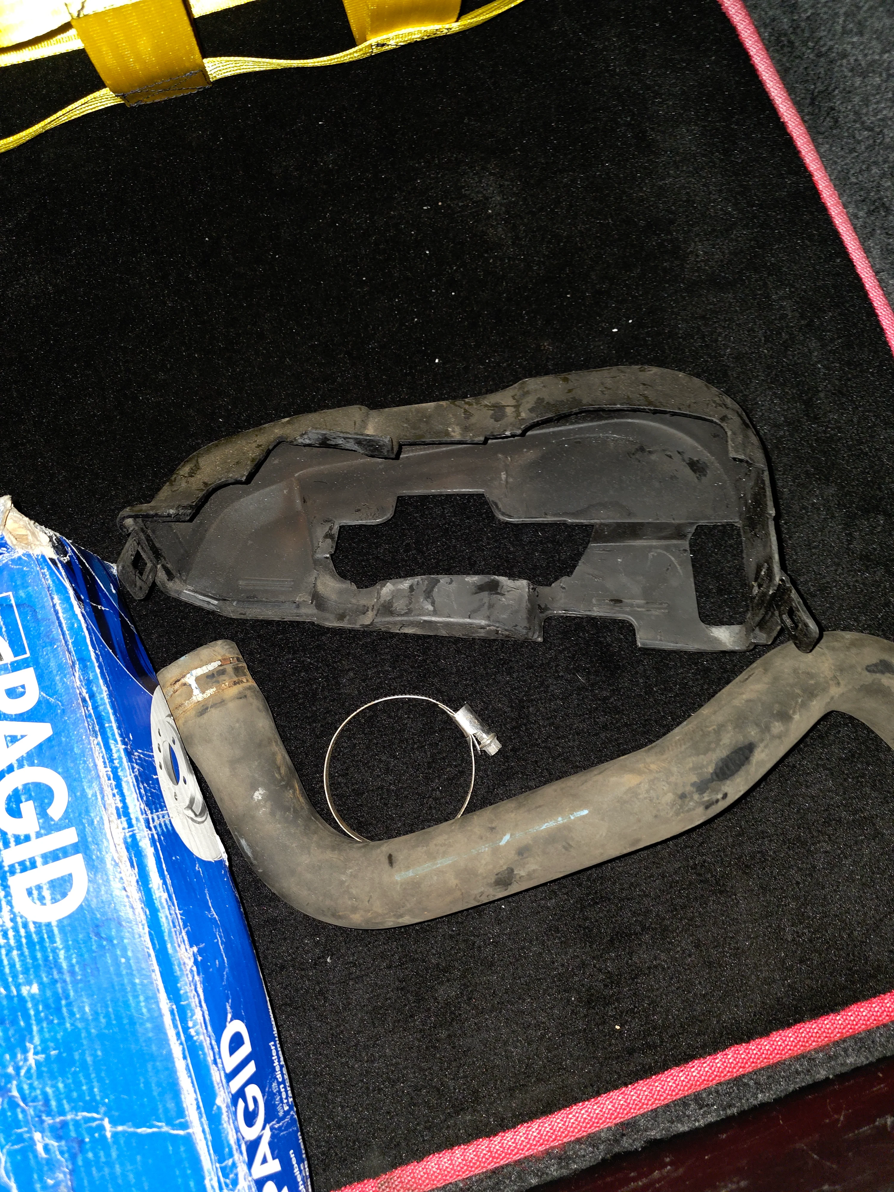

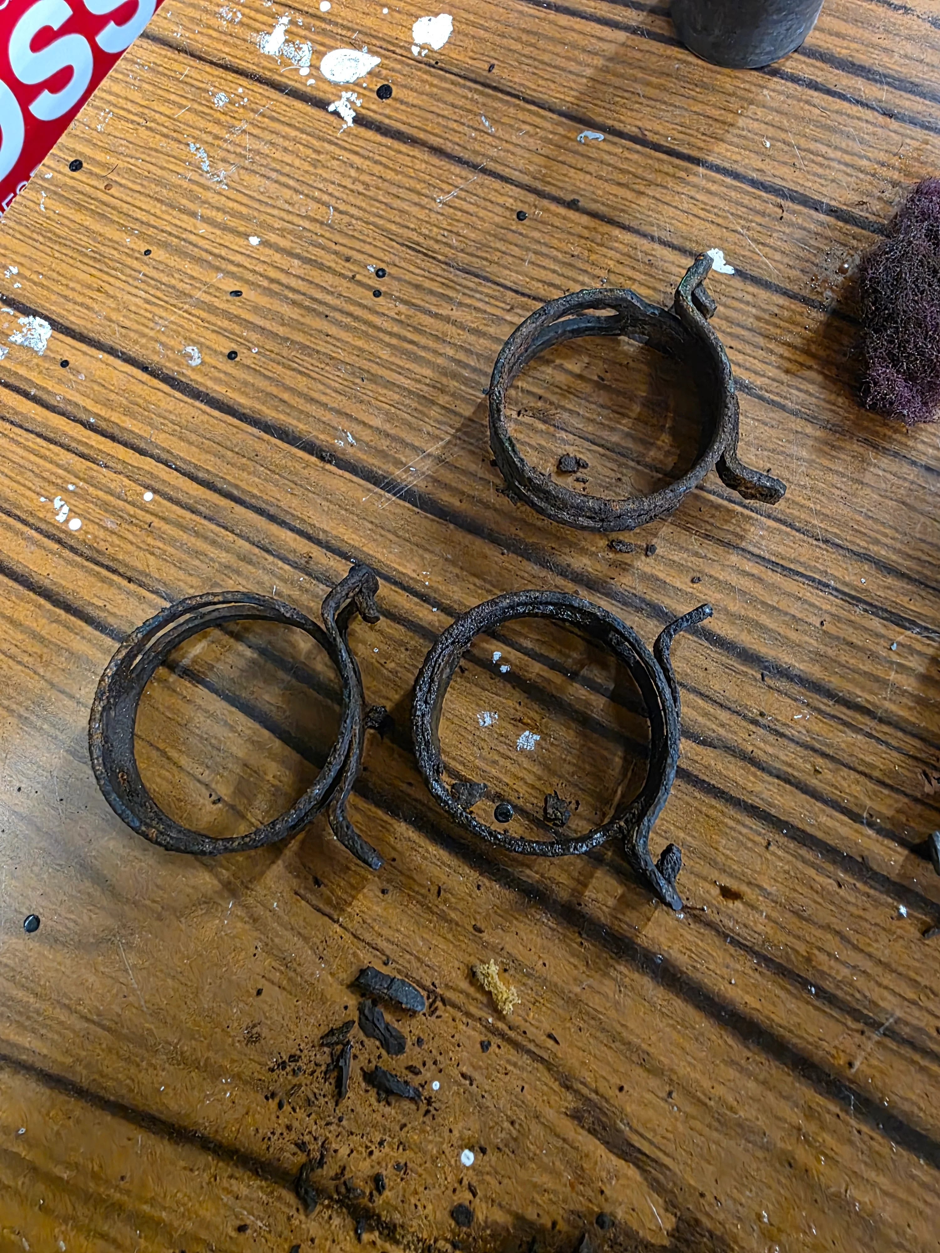

Onto the next job before cooling system is filled. It still has the oem spring loaded constant tension death clamps on the coolant hoses, and all were looking poor with the rad hoses ones looking terrible/rotten. Id seen these rust through and snap on the orange dci, so these needed to be done. They werent as bad as the orange one, but they had lost most of the tension so barely holding tight.

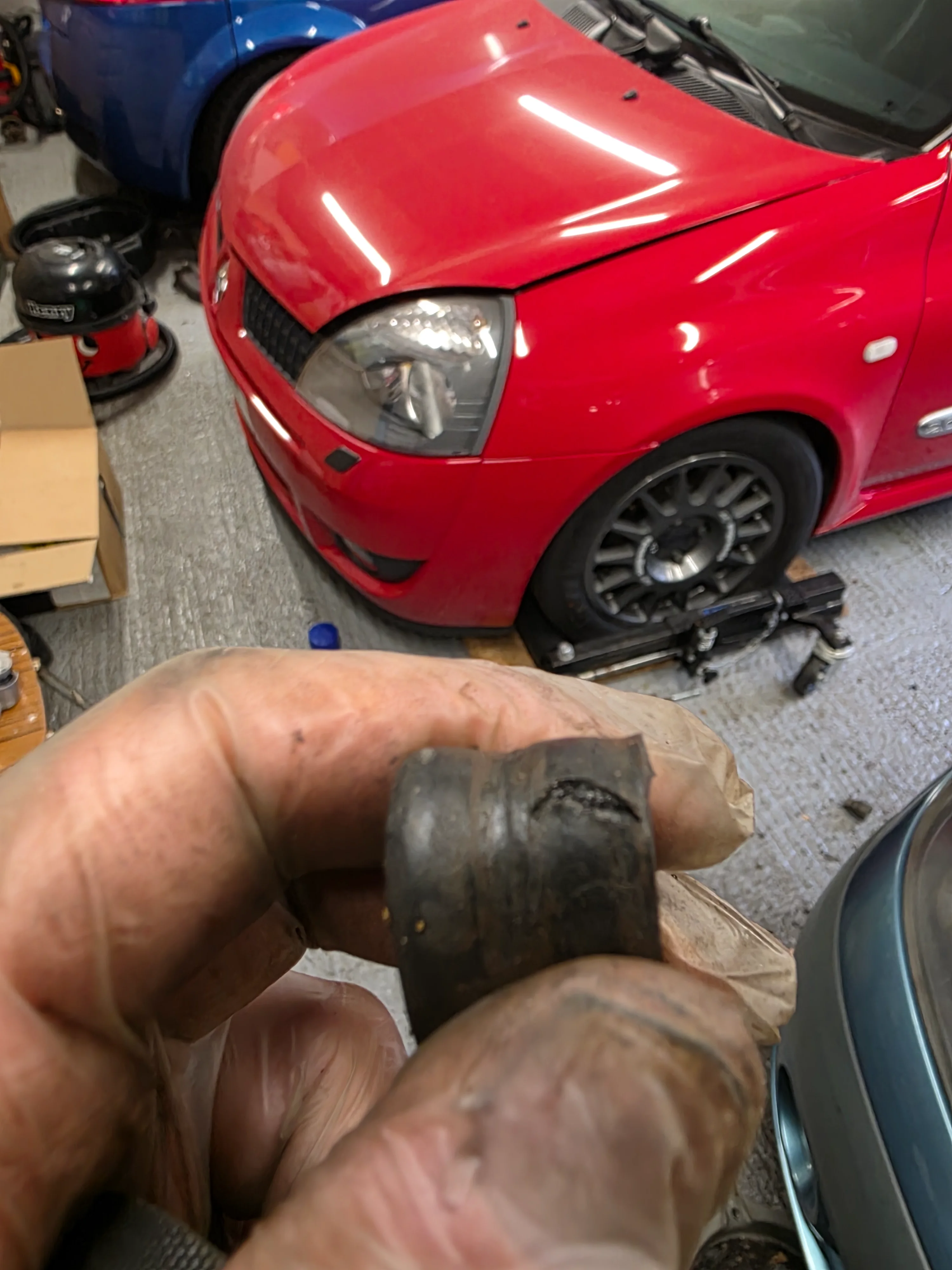

Pretty fcuked, luckily the dci runs cool so didnt give an issue. You could see where they had been weeping a little coolant around each one. Took rad hoses off to inspect as old car/high miler and noted a small split near hose clamp
Not through but no doubt would have made a bad day at some point. I did cut hose down and it still fitted, but remembered i had a set of hoses in the lockup off one i broke years ago.
Hose located and a better top cambelt cover as mine was about knackered.
Hose inspected, all good..fitted, new death clamps fitted from stock which i nicked from u pull it ages ago, fresh febi type d coolant filled and bled

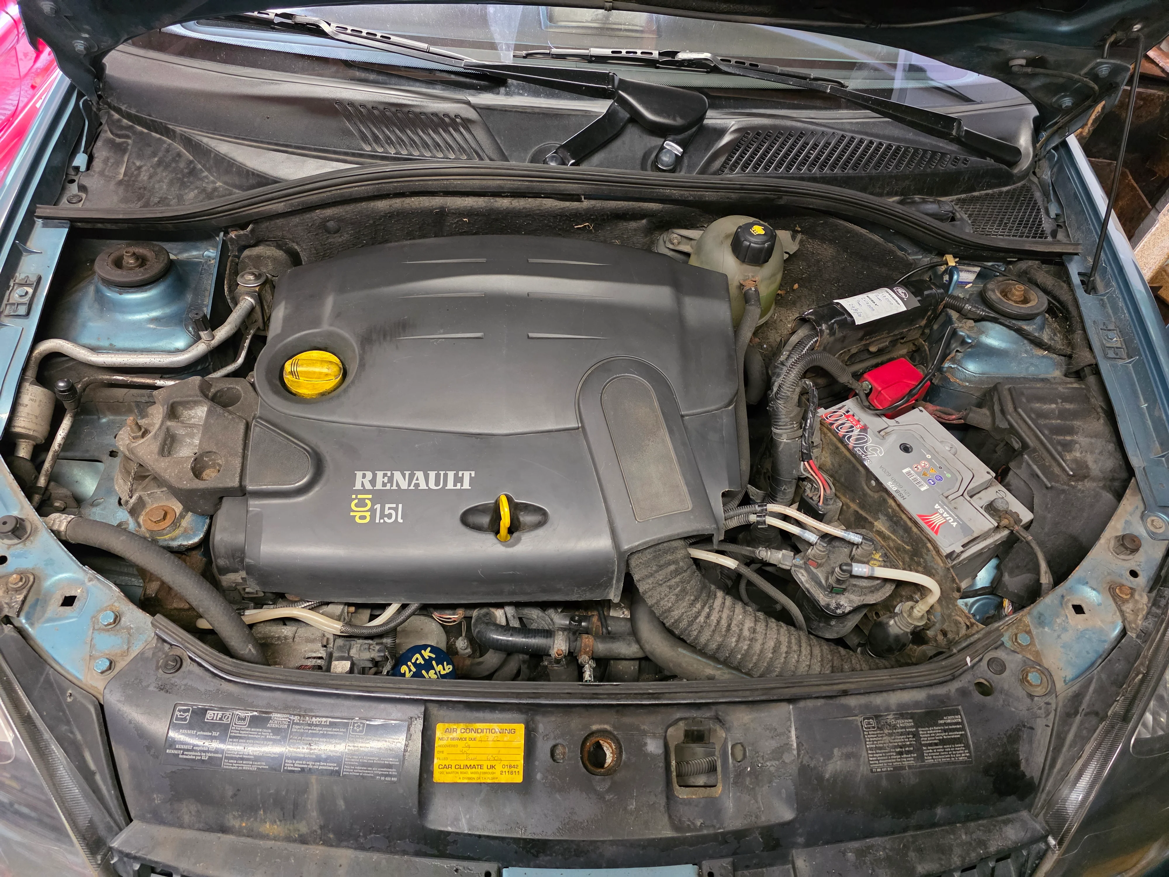

Started totally normal and engine sounds a little quieter. Ran up to temp, dropped oil and renewed for fresh valvoline 5/40 and purflux filter as it was about due.
Took for a test drive, done 10 mile or so all good. Job jobbed, good until 300,000 miles hopefully.

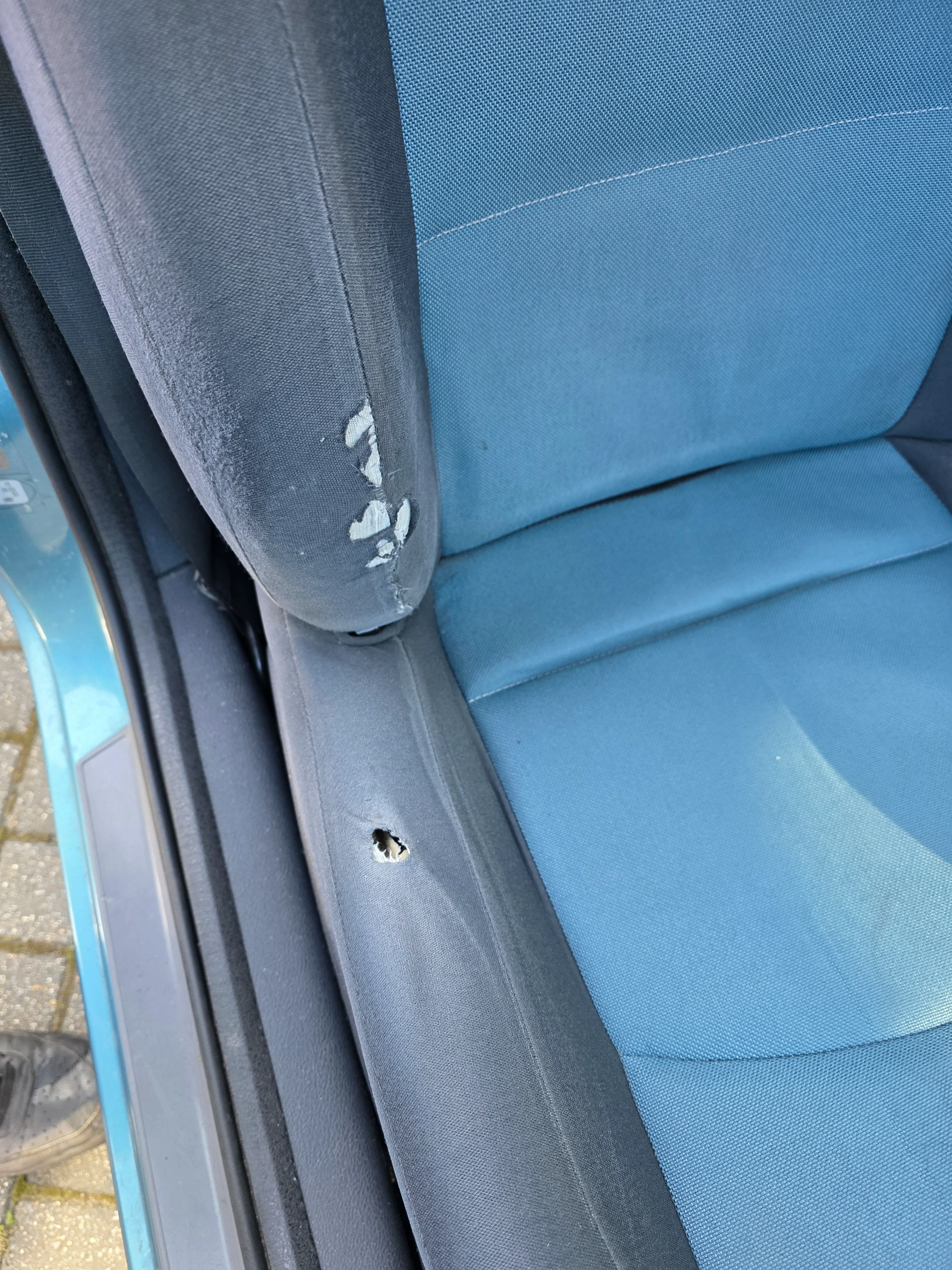

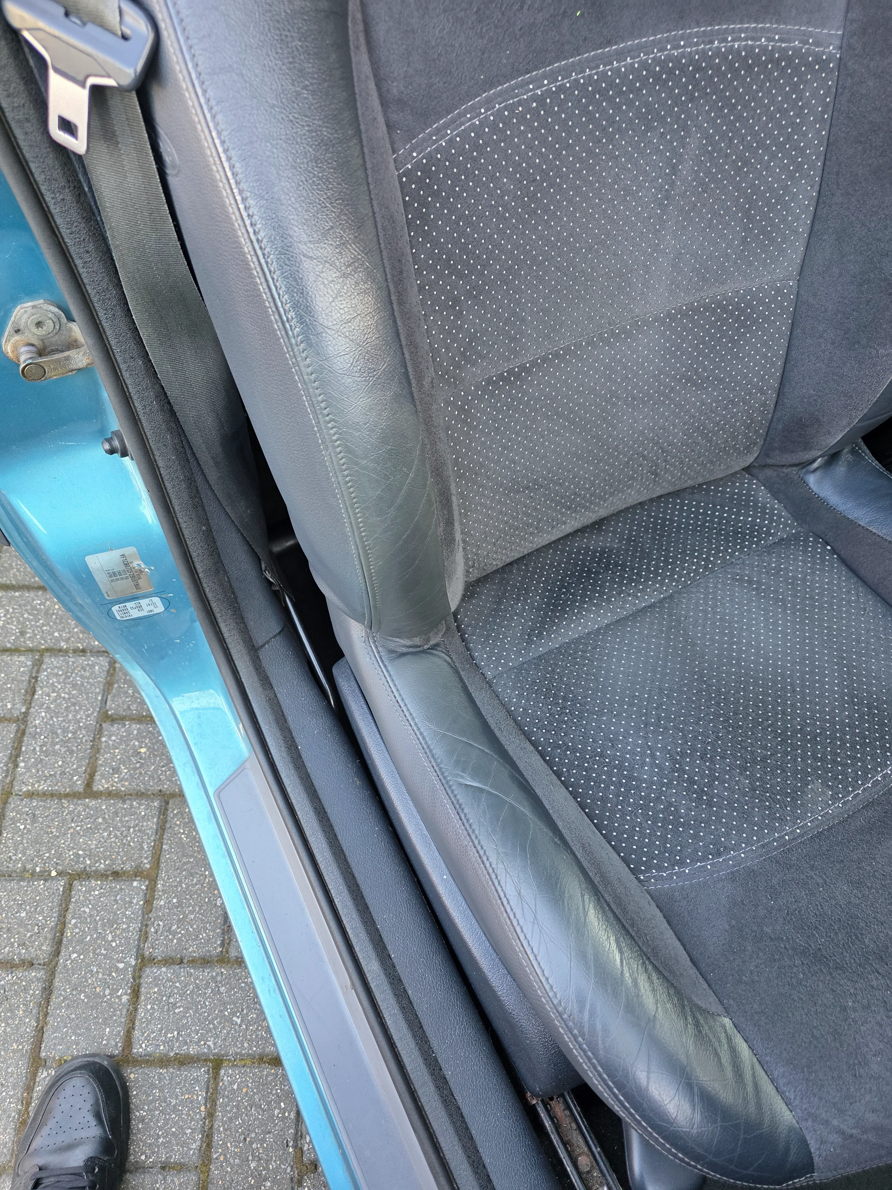

Drivers seat was well worn on the blue dci at 217k. The bolster was sewn up years ago, but was now holed and foam gone in the lower part. Not done bad for mileage.

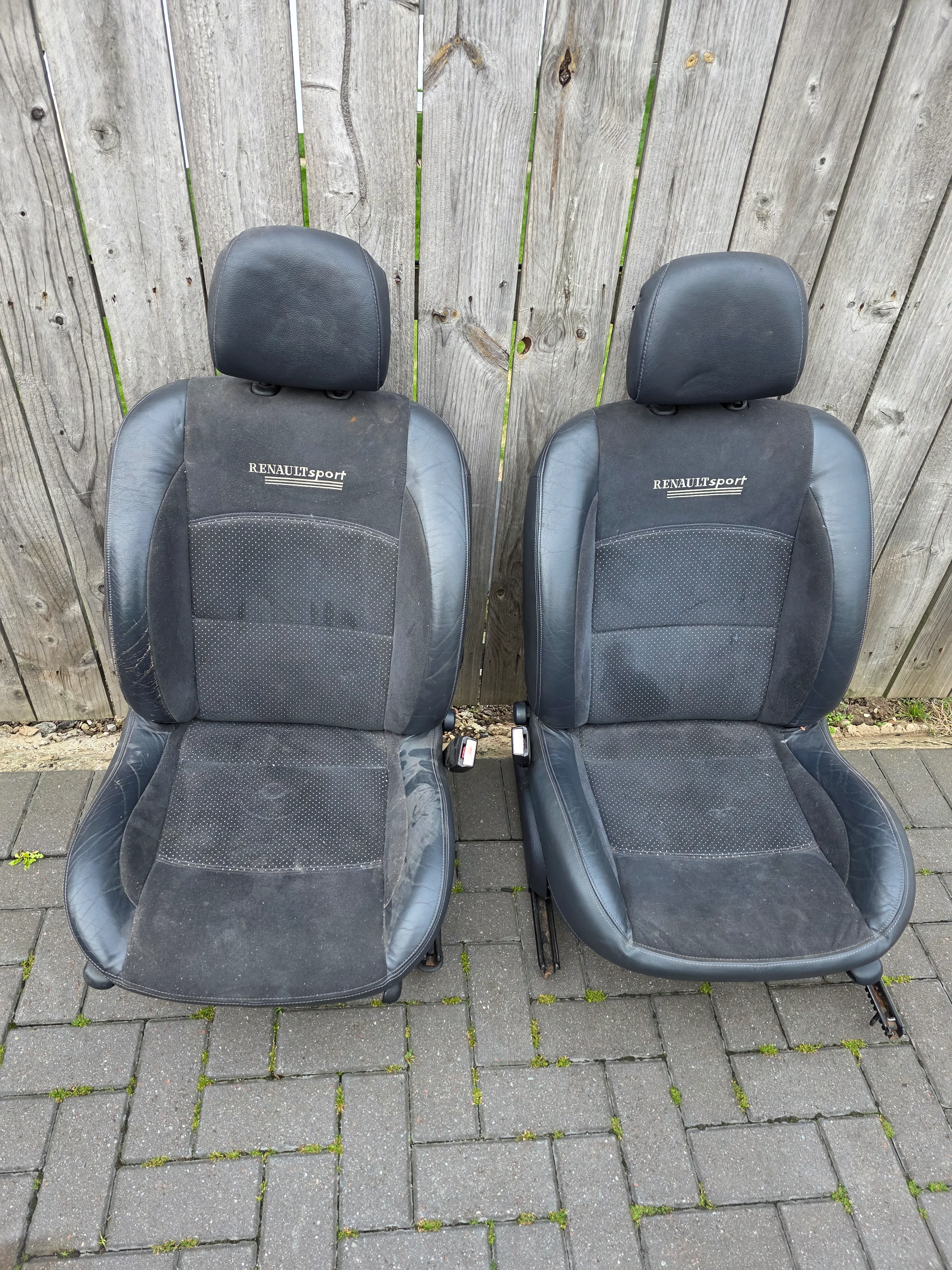

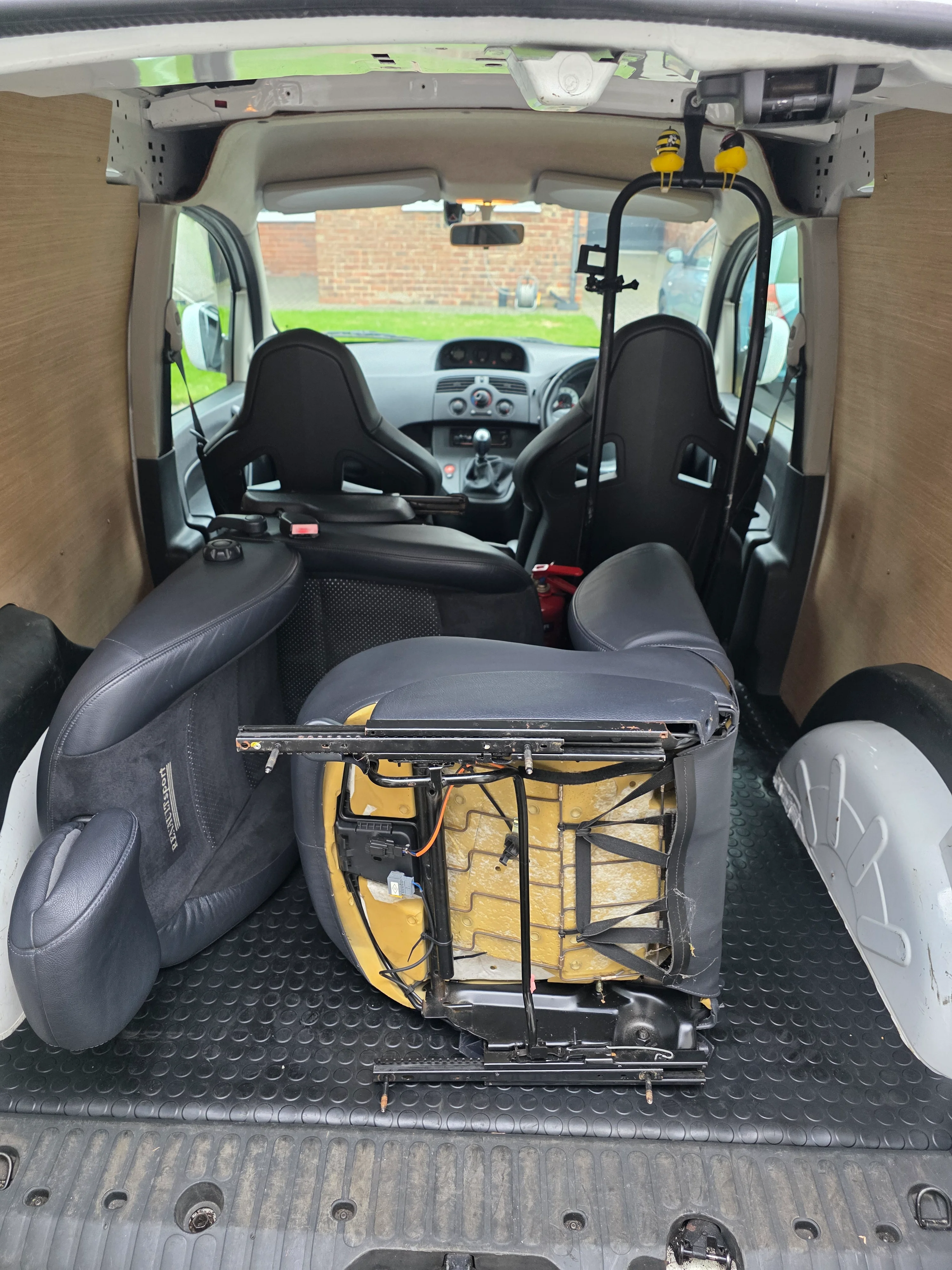

Ive been planning on replacing them for ages but keep missing out on sport or good nick povo seats. A pair of 172 front seats and doorcards came up for free on FB in Doncaster last Friday, managed to get in first.
Collection in the Kangoo, barely fit🤣
My expectations were low as they were free, needed a clean and small repair on passenger one as nylon cord was missing holding the cover tight on the base.
As collected, not the worst

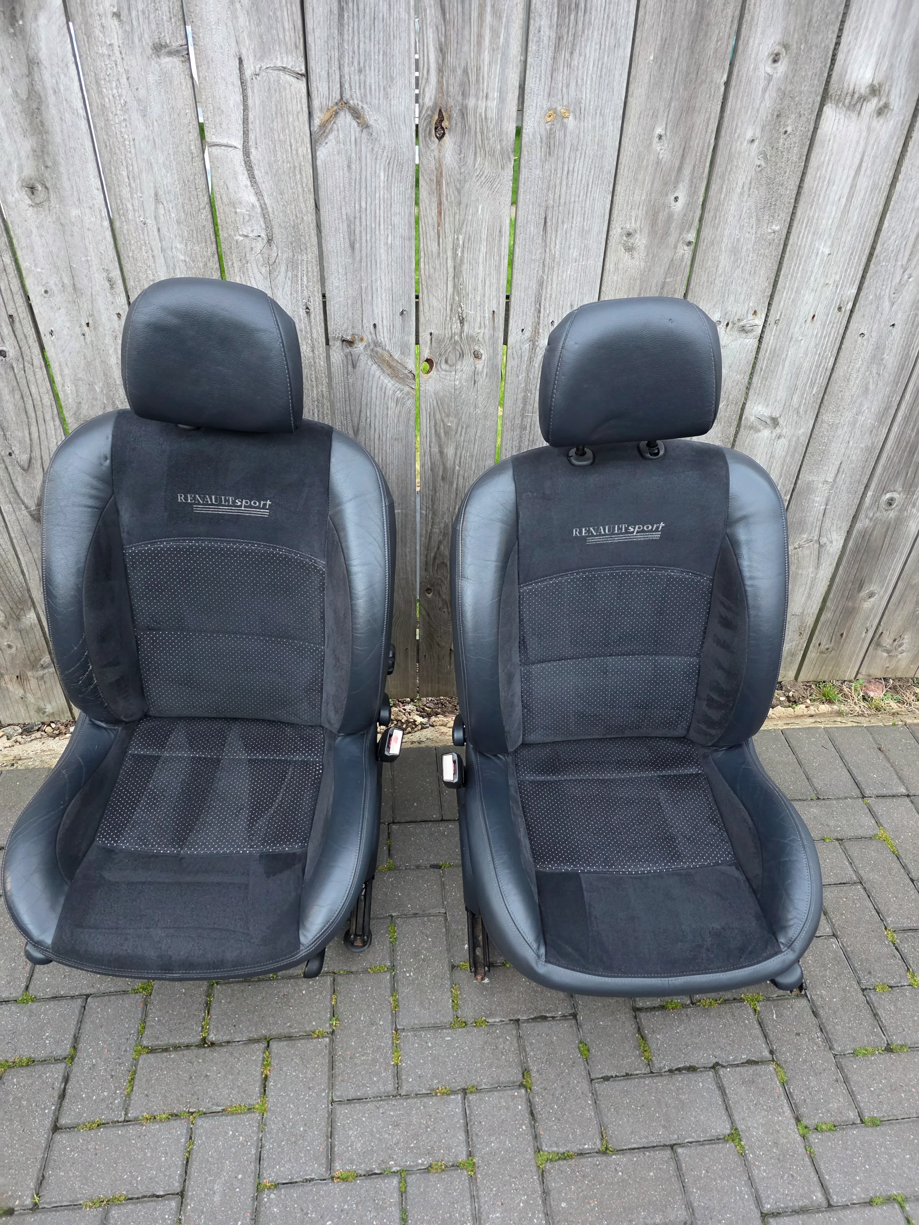

Wet vac, cleaned the bolsters with a gliptone kit, cord robbed off original seat and fitted.
Came up good. Doorcards got same treatment.

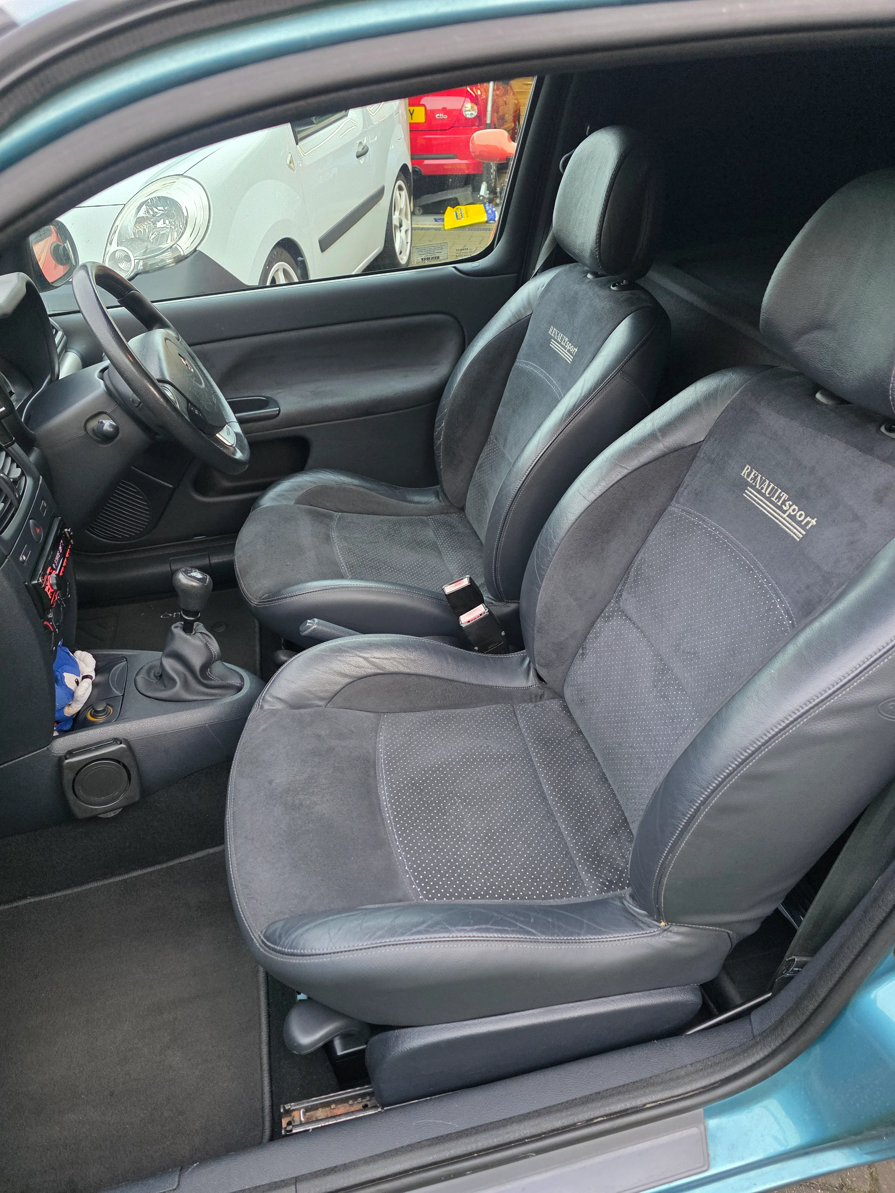

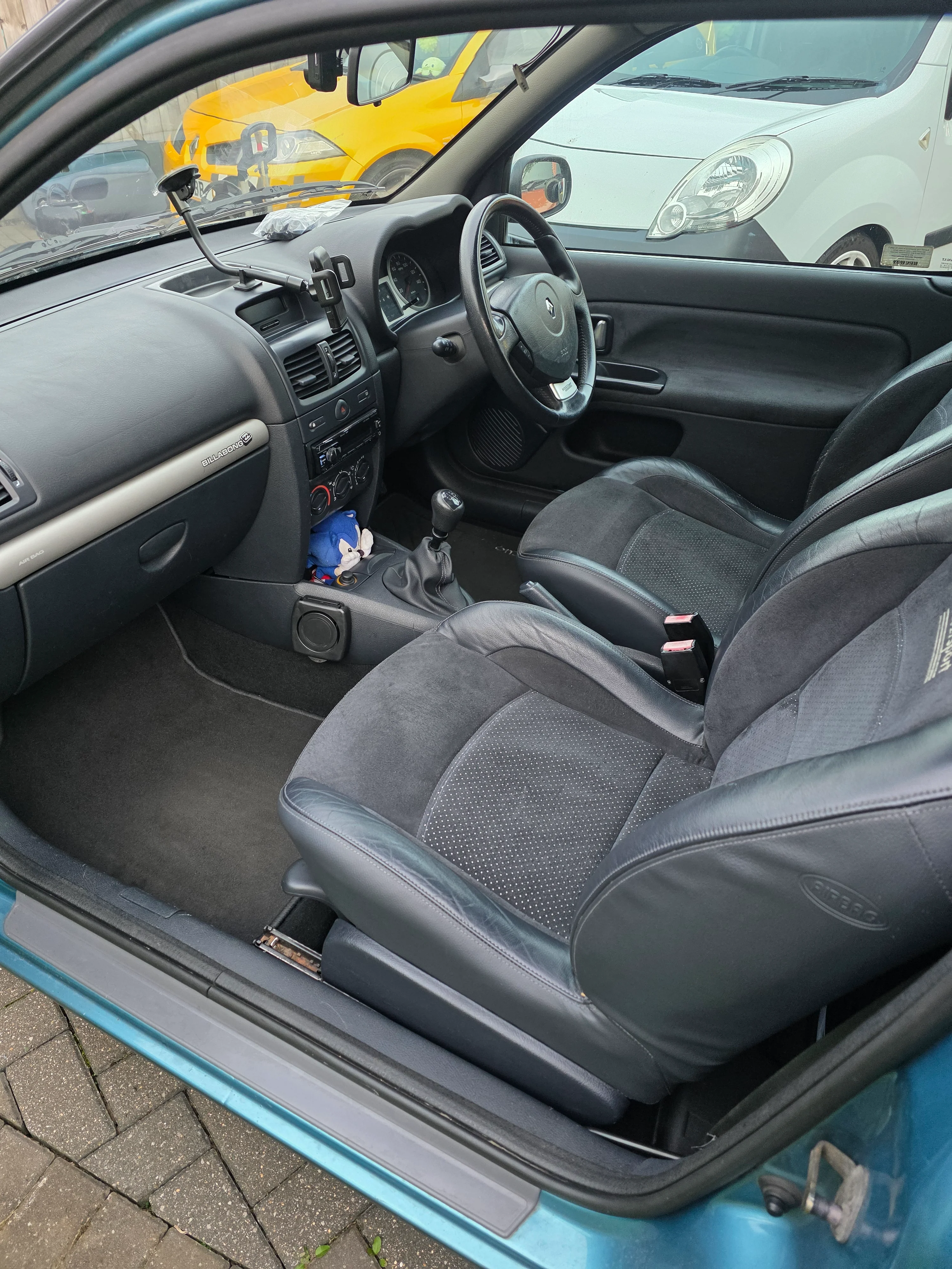

Had a couple of hours spare so stuck them.in yesterday inc doorcards.
Fair improvement/upgrade id say! Perfect amount of patina as the whole car is well used.

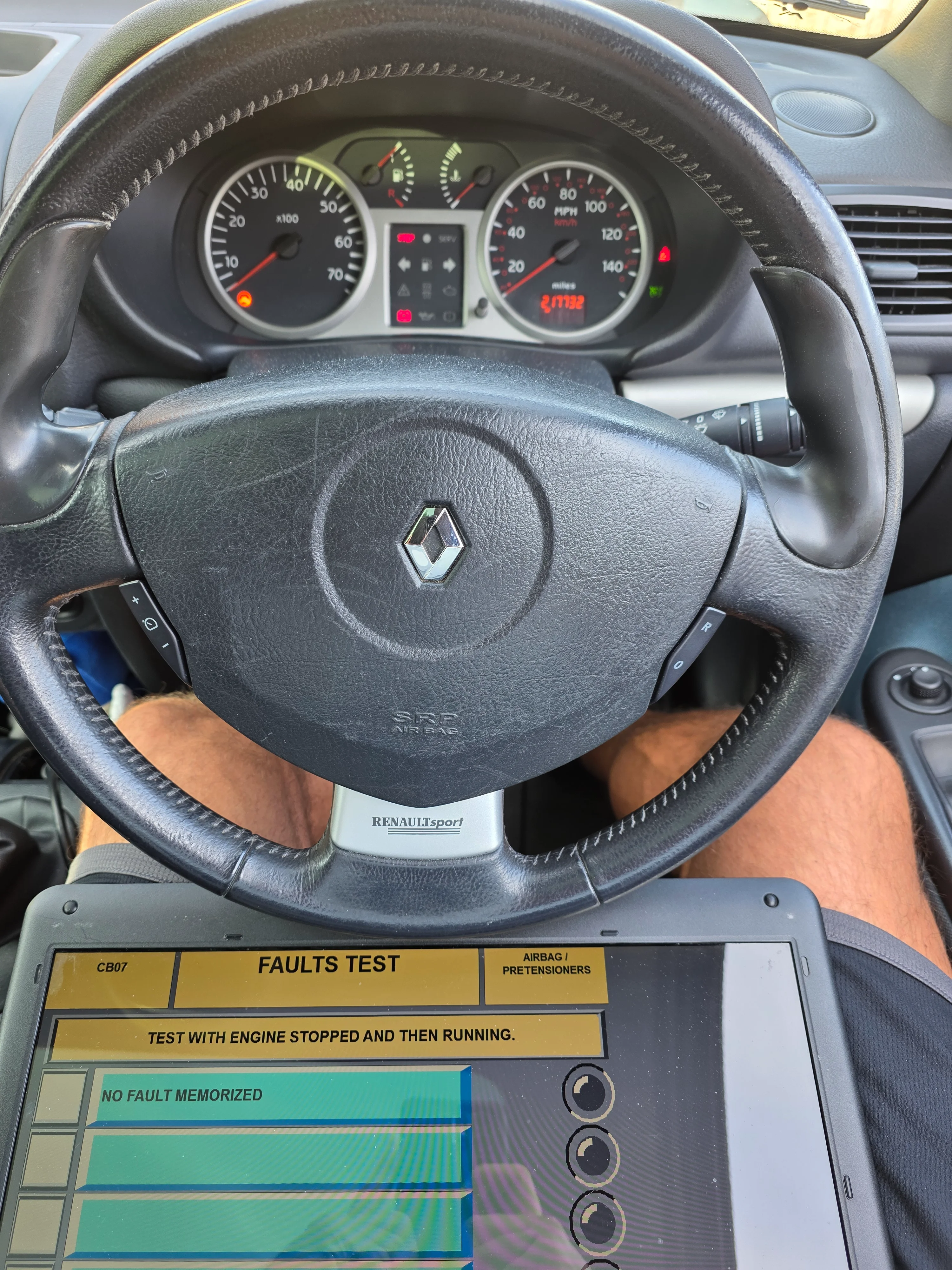

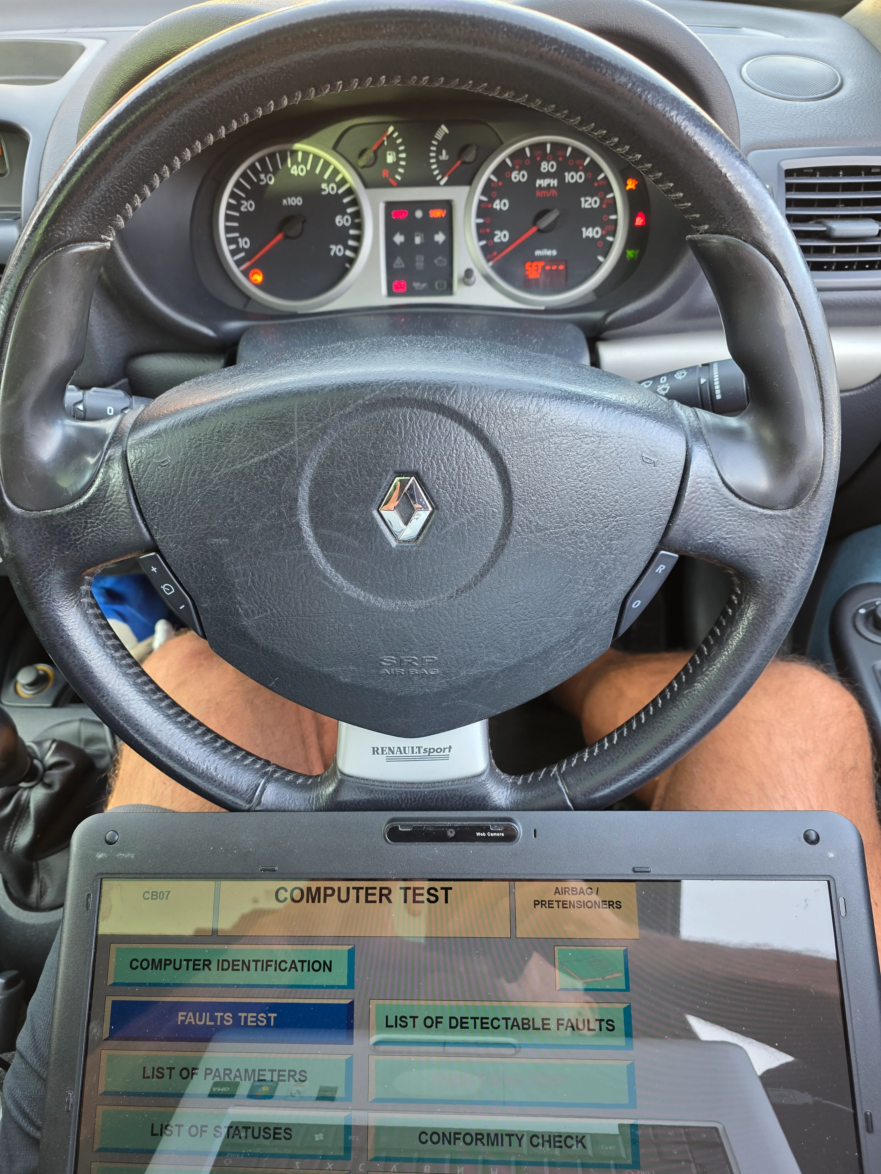

Airbag light was on as expected
Quick scan and passenger seat airbag flagged. This was a simple adjust the pins and refit.
Done a few miles today, no rattles which is good and the doorspeakers sound slightly better as thicker material etc. The 172 seats are much firmer than the standard billabong seats..i actually think the original drivers one was starting to collapse as a bit higher seating position now. I might pull the spacers if needs be to drop it a little.

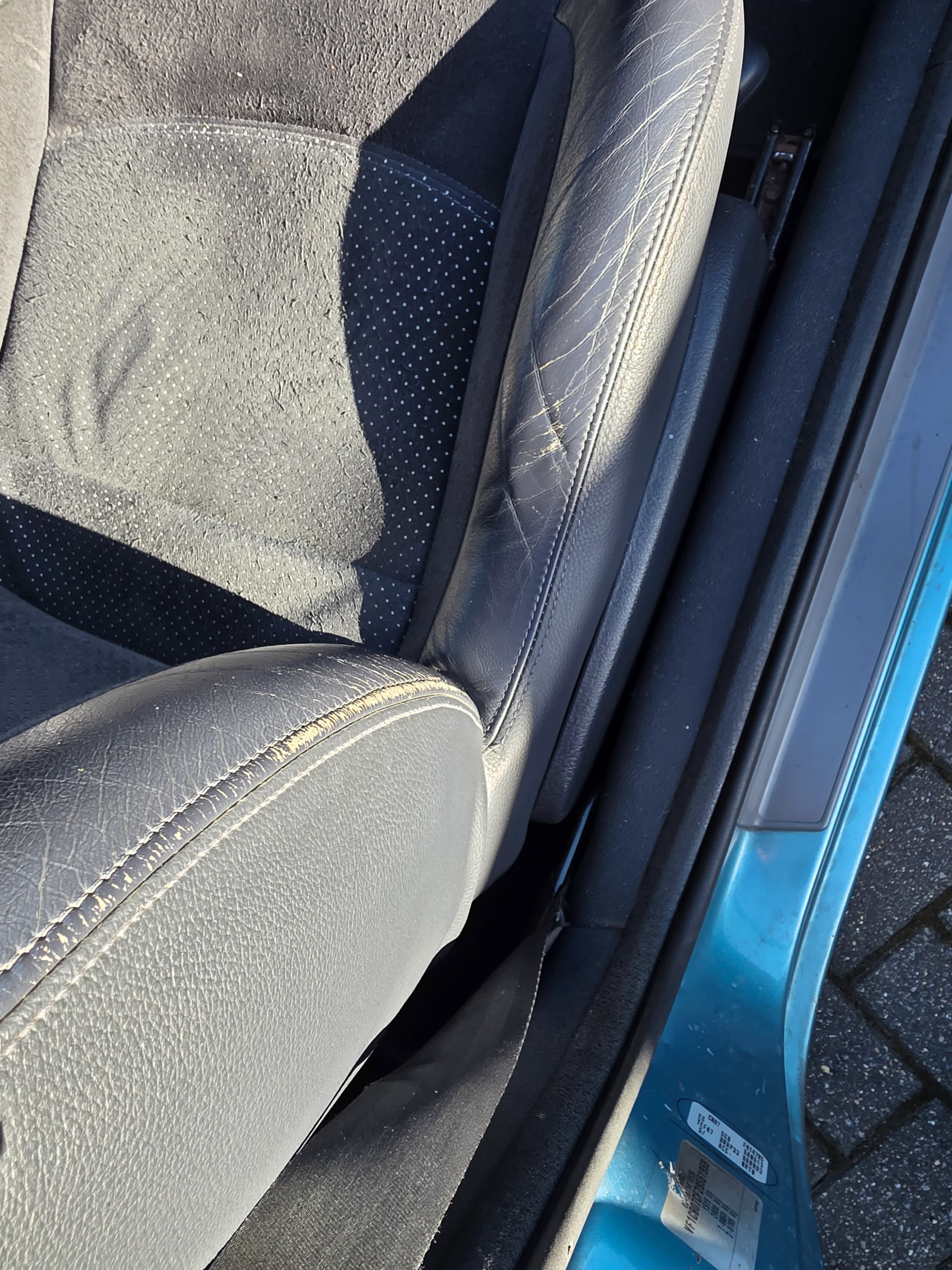

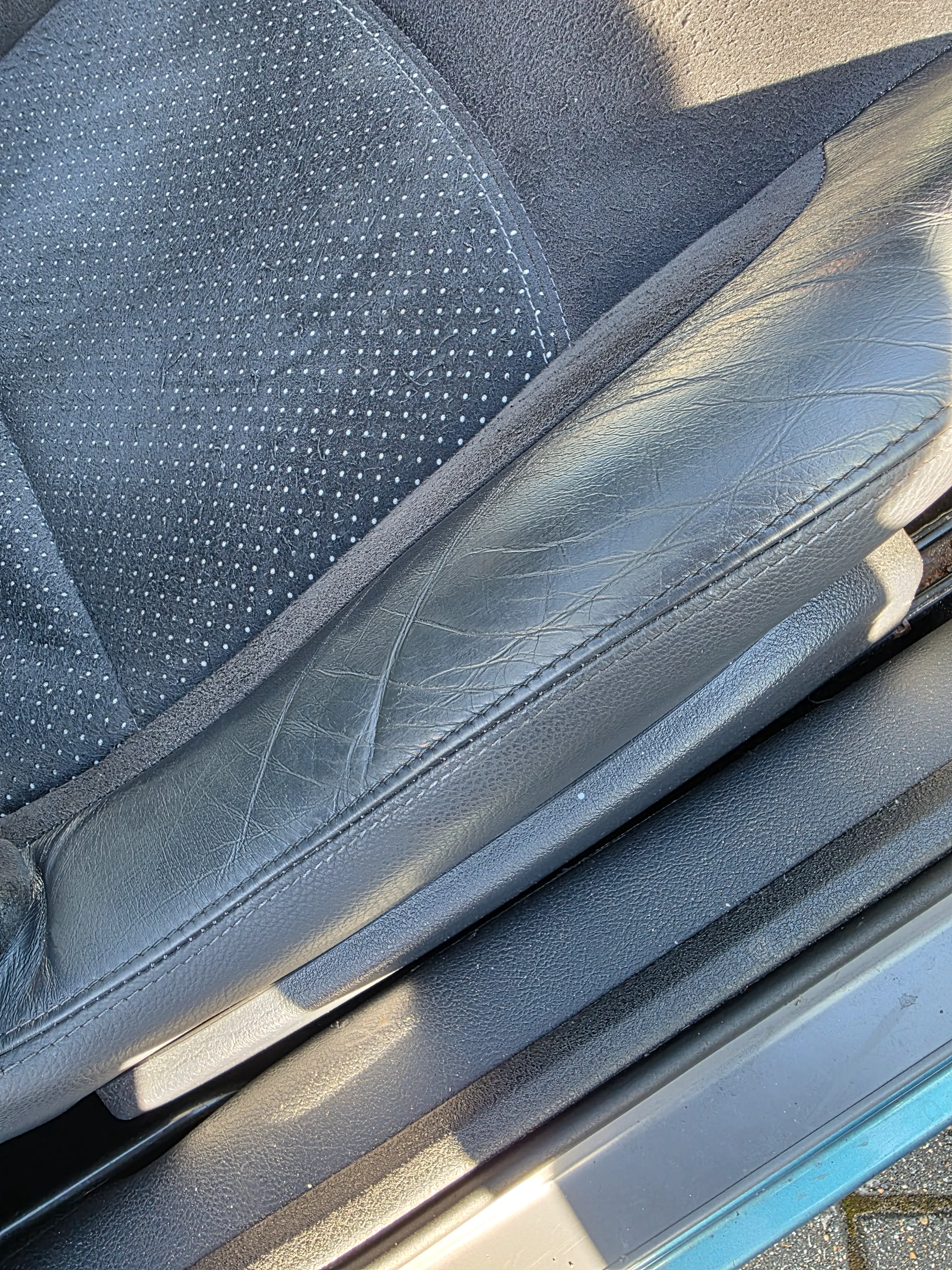

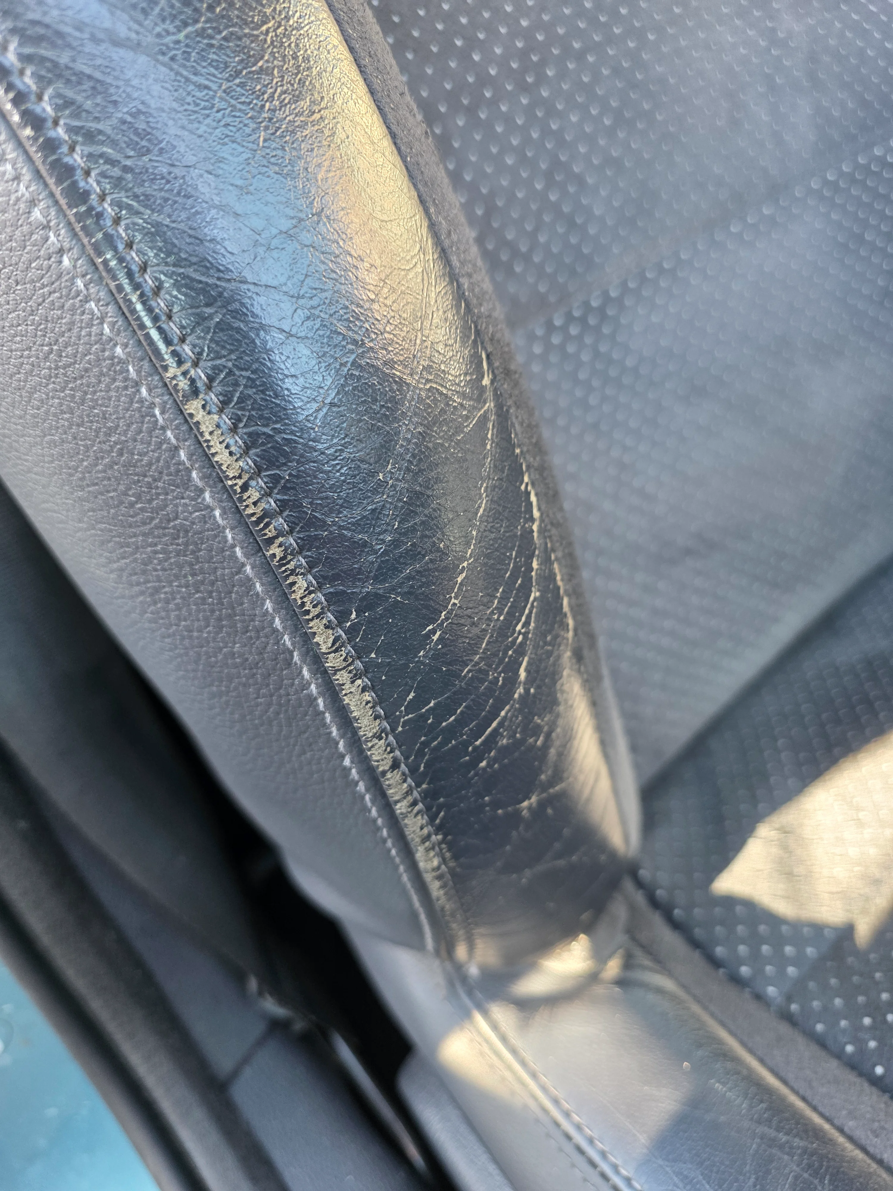

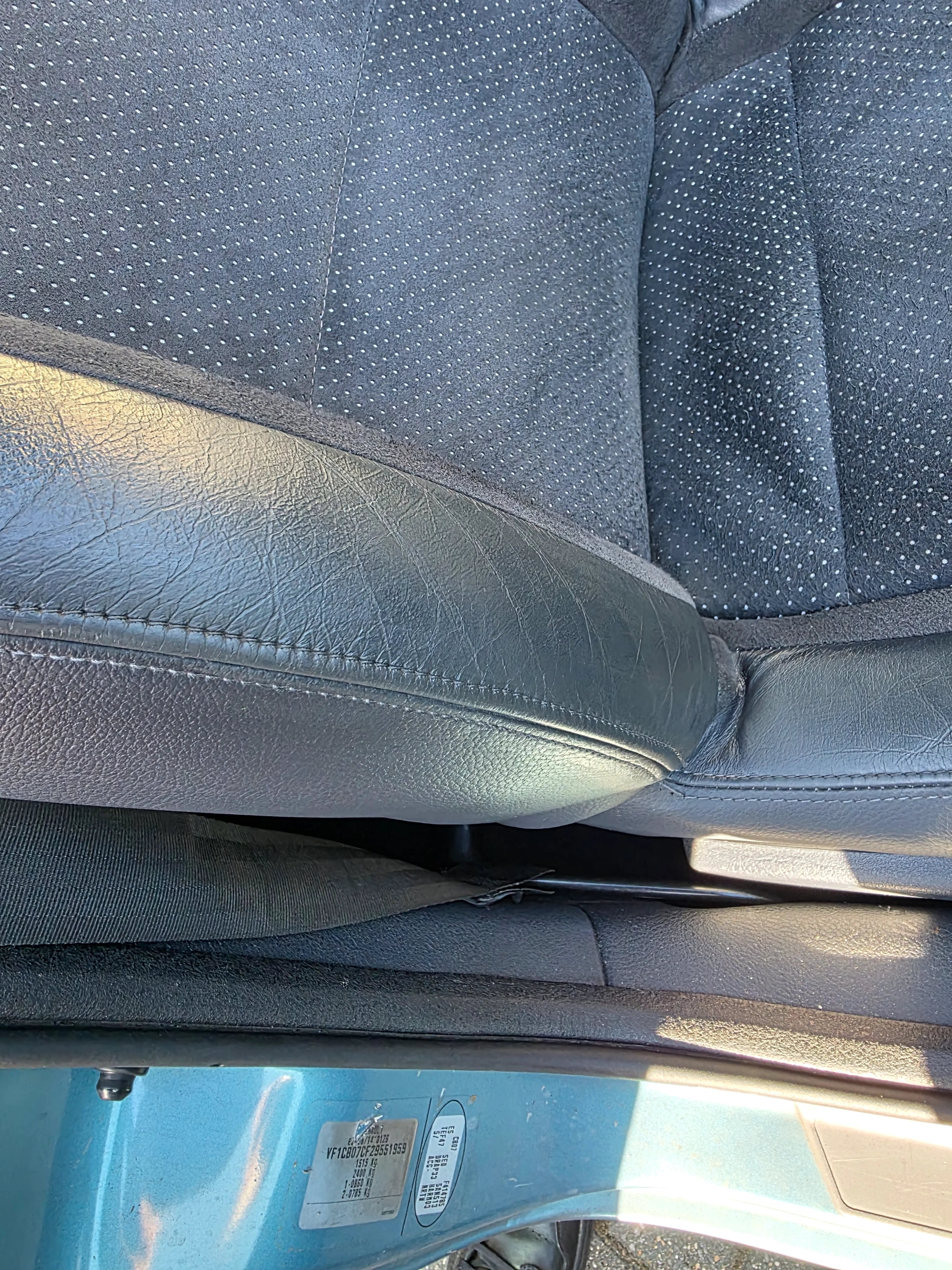

Bought a cheap recolouring kit to tidy the drivers seat bolster up as the leather (pleather?) has a bit of wear and tear after years of arse dragging across it. Picked a generic dark grey leather filler at £3.59 off ebay.
Before
After
100% improvement, match is not bad. Will give it 24hr or so to go off and add more if necessary.

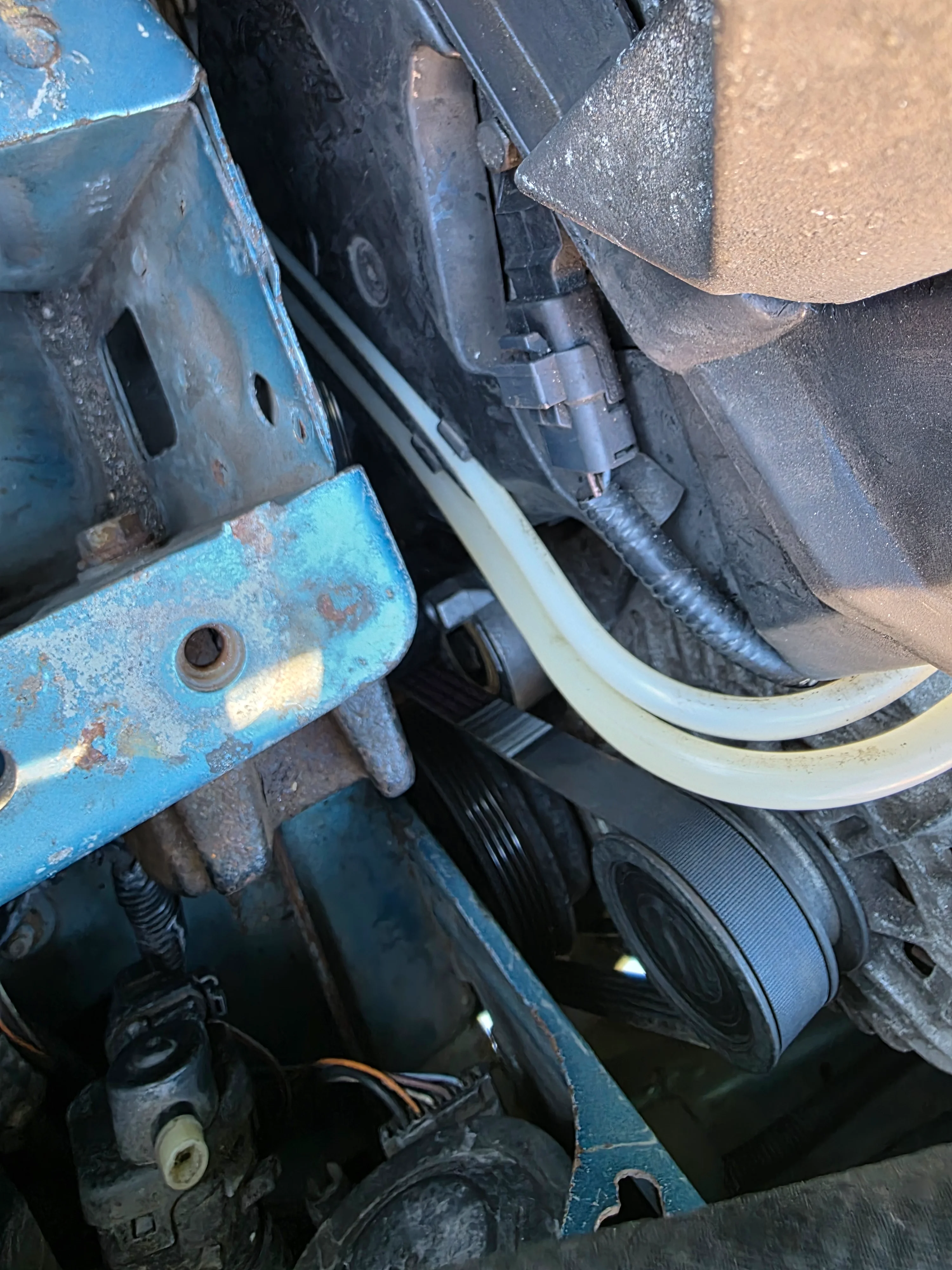

Fitted new aux belt and tensioner, as id had to reuse the old aux tensioner when doing the cambelt a while back as the new one i had in stock broke when fitting.
Its a fiddly b*****d to do as need to jack engine up off the mount to get in. New genuine ren aux kit fitted, slight mod to the tensioner done to give it more swing when fitting, belt flys on instead of being knacker tight. Sounds slightly better when running so assume old tensioner was not as strong as it needed to be.

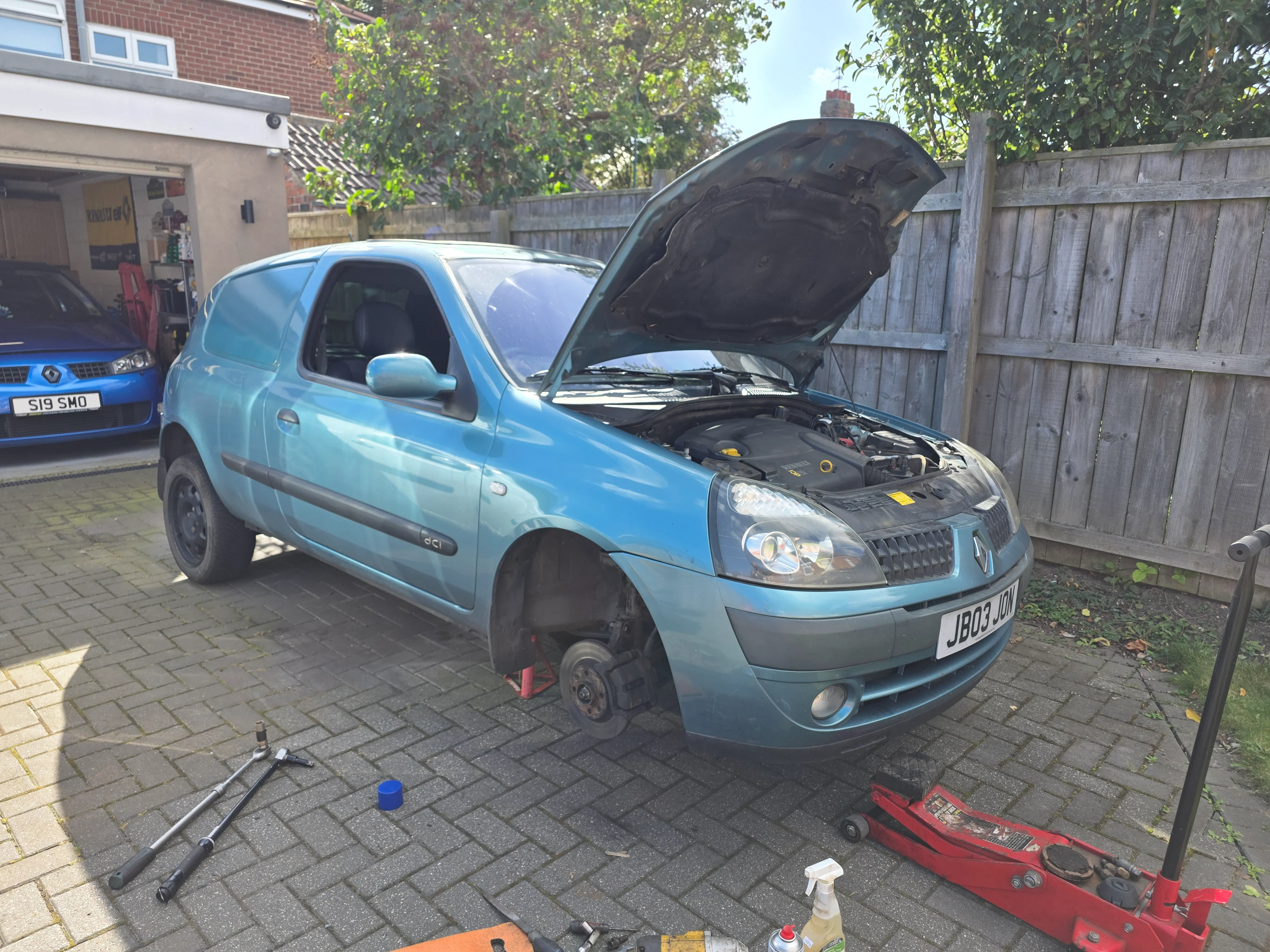

In the quest to stop suspension knocking on the blue dci, replaced front shockers and top mounts when i had a spare hour. On last top mount change i noted the drivers side shock was finished, its done loads of miles so cant moan.
Assume position
Autodoc for the parts, Trw front shocks and full kit for top mounts this time, meyle brand. See how these fair as lemforder were dog turd. Reused old springs as ok.
Fitted
Love the simplicity of clio2, half hour a side to do. The verdict is better again, and handling much better but still the odd light rattle. After extensive checking the only part with slight wear is the drivers inner tie rod and at a certain steering angle it makes a knock, so have committed and ordered 2x inners and outers to do.
