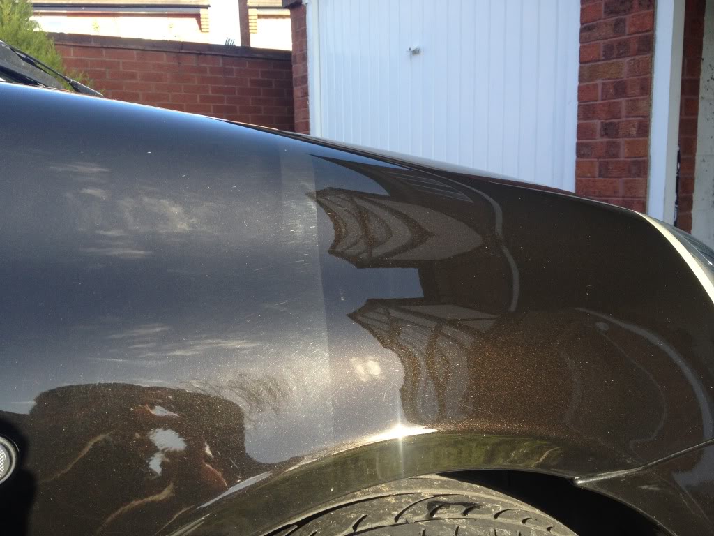

50/50 single pass with 3m blue pad and ultrafina se

UF is my favourite finishing polish. Did you do a serious IPA wipedown? UF have mega oils in hence great for jeweling!
Nice results JB, failing anything coming up after IPA wipedown.

No ipa wipe down tbf no. I'm sure it wouldn't still be much better still though.
It was a car I had infor a cheap wash and vacuum like the Alfa. I just went a bit further to show him what was possible if he gave it to me for a few days

My point was going to be, Clio paint can be rock hard so that kind of correction on BG may lead to the oils filling.
That can be a good thing on quick details though aslong as the customer knows.
  Clio 182, Astra Sri
It's no where near corrected, as I say, just 1 pass with a finishing polish and pad. I'd of probably gone for a megs#101 on a small wool pad next tbh, then refined with ultrafina again.
I did however try black hole afterwards to see if it could help with the left over swirls and it did nothing. So I assume if black hole made no difference then ultrafina did a good job of removing most minor defects.
