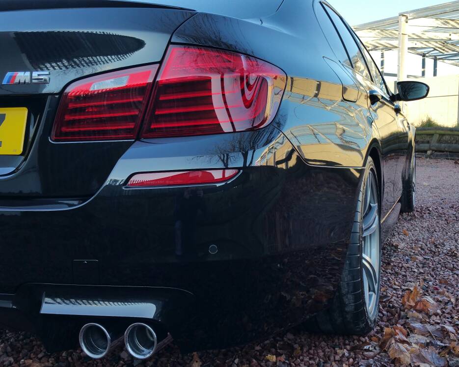

m5 test bed on Sunday for the new essence.

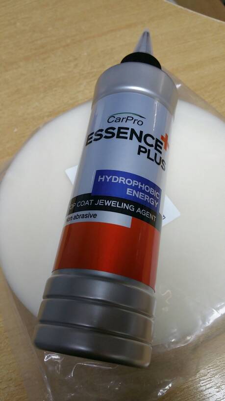

Hellllllllo! You wouldnt use a harsh pad as that's not what the product is for. Needs to melt in to the paint.
So it's almost all fillers.... But it's also the sealant... So you're literally sealing the fillers in. We're talking maybe 6 months plus and because youre not correcting or heating the lsp up like normal essence the speed of application is mental. Stuff has blown me away today.
There will be light correction even on a normal pad. I tried it with a 3m blue pad and rotary. Worked well.
The picture was carpro gloss pad and bigfoot da. I would recommend via Da.

Dave it's simply seconds to apply really. You don't need the heat like essence.
I think you would get away with 3m and blue like I did. Gloss pad doesn't like the rotary that much imo. Or the softest finishing pad. Just like applying a sealant via Da.
I reckon the more you spread it the more filling that will occur but still very quick!

I'm a little confused with Car Pro Essence &Essence Pus. I last used Essence in August, as a finishing polishing & sealant combined and topped with Reload.
Is Essence Plus the same but with extra filler?
It did look good!
  Golf GT & A4 Avant
Essence plus has similar filling abilities. But no abrasives. It can be used as a stand alone sealant like normal essence.
But you cannot use essence plus as a base or primer product like you can normal essence.
Normal essence can be used under nano sealants. Essence plus cannot. Instead it is designed to be applied over the top of a nano sealant once the nano sealant has started to wear off or show signs of swirls. You apply essence plus over the top of the coating instead of stripping off the coating

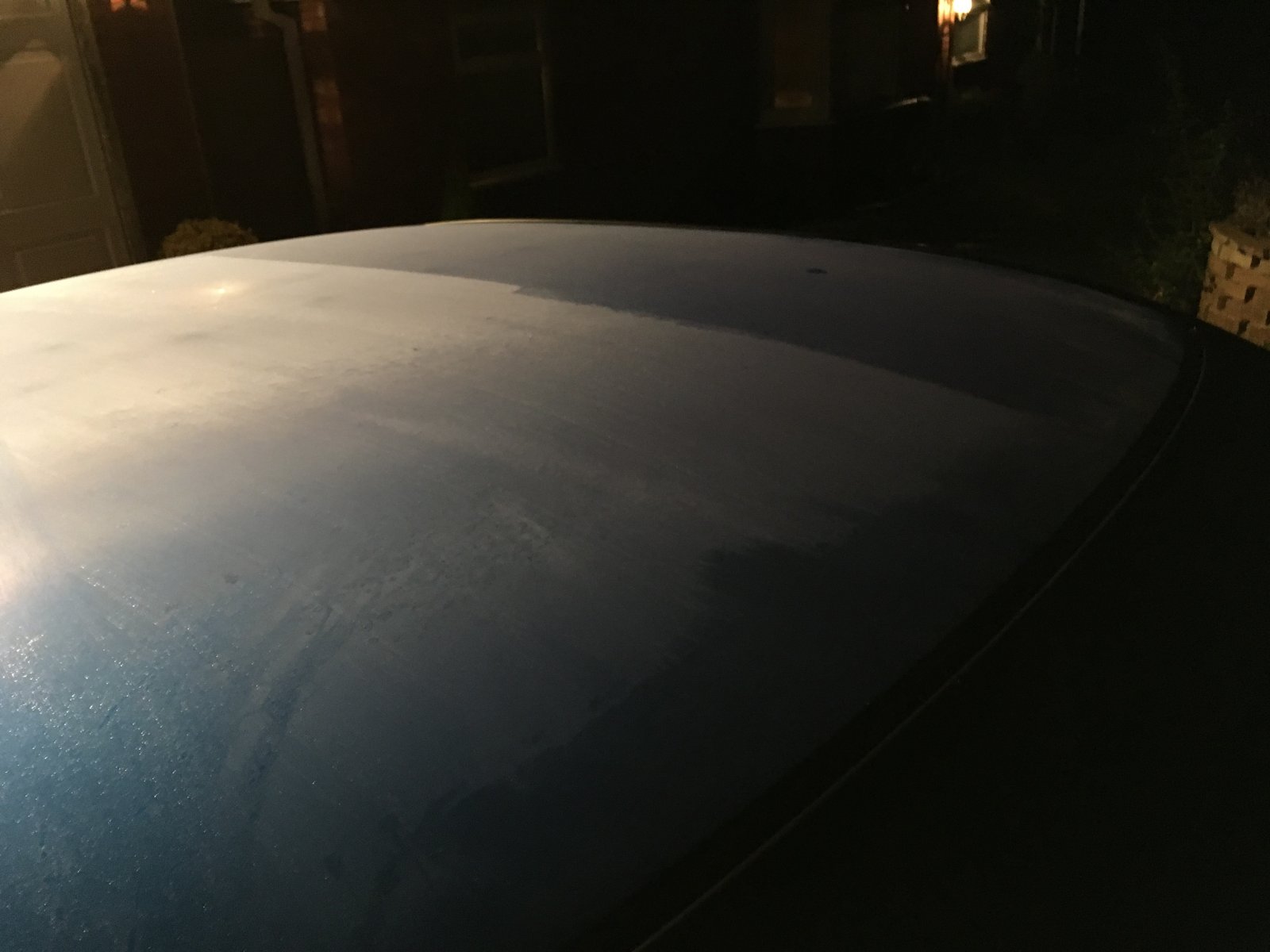

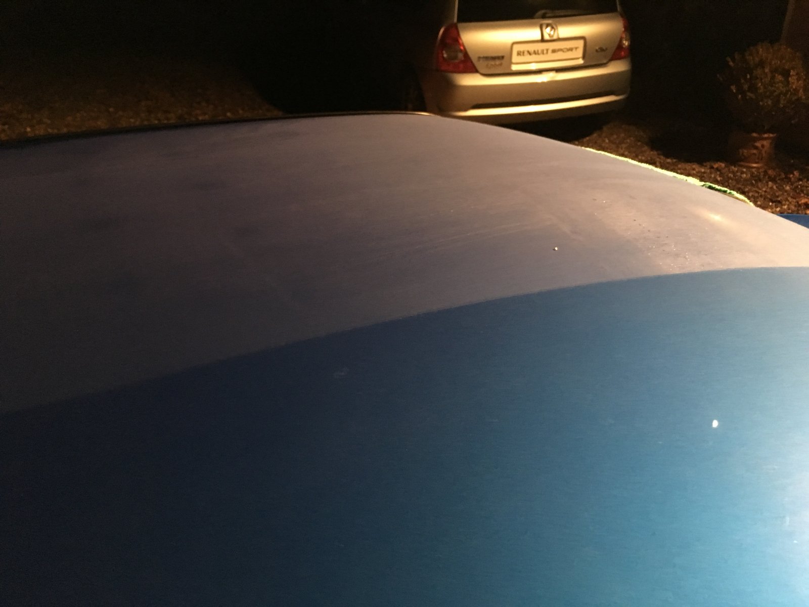

A little advice needed - a few nights ago I gave my car a quick wash, snow foamed, shampoo'd and then I sprayed the (wet) car with Hydro2lite all over and rinsed. When I rinsed the Hydro2lite off it left it looking like it had a layer of condensation effect. It was pretty cold and probably had moisture in the air, it had gone dark already (~5pm) as you can see in the pictures. I'm thinking that it's something to do with the fact I sprayed the whole car with Hydro2lite, then rinsed it off, so it was potentially left for anything upto 2-3 mins and it does say to rinse immediately (stupid of me!). After the Hydro was rinsed I shampoo'd the whole car again as I was worried but it didn't have any effect, was still leaving a dull 'condensation' looking effect.
In picture 5 of the front end, I didn't spray the front bumper at all with Hydro so you can see just below the front grille, the paintwork looks pretty normal with no condensation effect.

The best method is one panel a a time mate and literally spray on and jet off straight away.
And you don't need to cover every inch of the panel. A little dab will do. When you jet it off it spreads it around. Then open hose the panel to get any excess off.
You're most likely going to need to machine polish your car to get rid of that.

Yeah was a bad move to do the whole car in one go. So what has it done to my paint, has it damaged it you reckon? It seems like some sort of film has been left, in which case machine polish seems like the answer like you say. Ahhhhh!

Machine polish to get rid? Ouch
