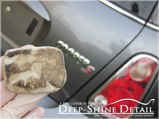

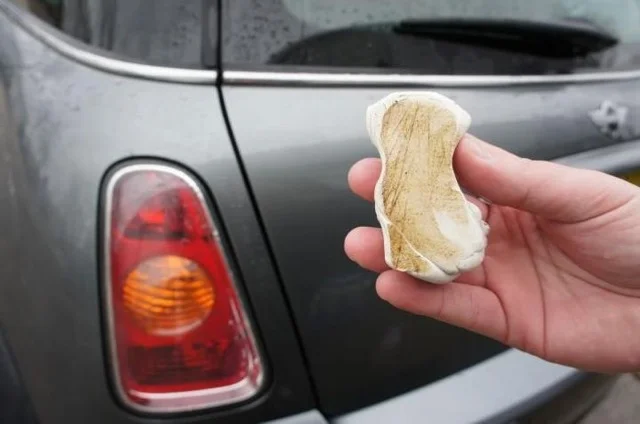

Allo, been searching here and dw but as always, I consult Cs before making a decision...
bought some TARdis and iron x tonight, just a quickie about use;
do I wash, detar, wash, iron x, wash, clay then polish/wax/seal?
and can ironx be used neat on paint or does it need diluting?
cheers
Gally
It doesn't need diluting mate.
So what I suggest is after the initial mincing around washing etc de-tar x2 dependent on condition, pressure wash, de-iron. Wash/snowfoam then clay. Clays can be fussy and fall apart with things like Tardis etc on the surface.
cheers
I usually wash, iron x, rinse, de tar, wipe over with mf pad, rinse, clay, wash polish rinse, dry, seal
Iron x comes ready diluted to use straight away.
Knuckles
ClioSport Admin
Cheers :)
you should see the amount of tar on my car, it's covered lol
brilliant, thank you... I'll remember to get a face mask for iron x :eek:
