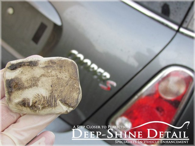

Remember this one...
Looks like its been chucked on the BBQ for a bit.

Or not de-tarring properly.
It's usually followed by... "it's getting polished anyway"... well done on missing the point.

as I'm new to cleaning cars properly, forgive me if this is stupid but
isnt the point of de tarring to give a fairly smooth surface to polish? So you aren't smearing tar across the paint?
Gally
I suppose you could say the whole point of de-tarring is to take the tar off the car safely, but in essence yes although plenty of people tardis their car and know nothing about this "polishing lark".
A clay bar isn't for taking tar off, sadly a lot of people don't realise this because they're maybe new to "detailing" but i've seen seasoned "pros" do it, sometimes it's simply they haven't de-tarred well enough. Hence my earlier post about double hits of tardis depending on condition.

Do you tend to spot hit tar you can see? I've never had a reaction on any tar I couldn't see, so always seen it as a waste spraying all the panels, or am I just missing the point?
Gally
Yeah. What if your car was Black?
You can't concentrate spraying tardis really. You can't really spray each bit of tar. It's not like they are 10p sized blobs they are tiny. 2 seconds sprays a door which is only from the window down.
Again I wouldn't risk there being major tar left on the car when claying. Just really adding to your work.

I thought the day's of not using a tar remover before claying were long gone now that using clay isn't such a new thing. Hopefully that's an old pic as I've lifted very little when claying after using oblitarate.
A tar remover also removes a lot of organic material such as aphid and tree sap droppings. These won't necessarily run like the tar spots do. I mist the panel, once it starts to work a apply it to a MF applicator then wipe down the panel once or twice to help remove anything on the panel
