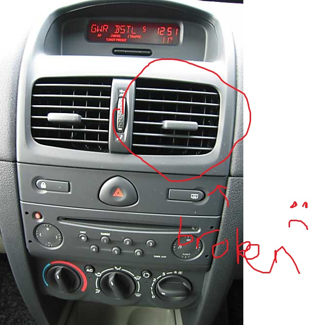

This car has a decent dash from the word go, though I did notice the centre fan didnt move together the other day so me being me i tried to fix it. I now have an open vent/fan :(
as that makes no sense here is diagram i made,
what wrong with the vent? have the slats fucked up?
Re: dmallett's 421'd monaco
i had a broken vent too ! the middle bit with the on/off wheel actually pops out then you can just put it all back into place and pop it back in again !! spent ages trying otherways.

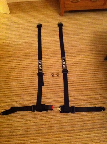

Got a TRS 4 point harness for £20, same as what i had in the ph1 but this ones 4 point rather than 3.

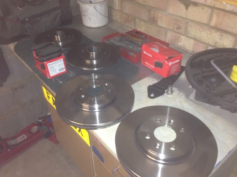

Then last night i picked these up, full brembo brake kit that G172 sells. i know everyone says go genuine rear discs but for the price i couldnt resist getting these. The front pads are already up for sale, see my other threads ;).
I will be fitting mintex m1155 front pads when I manage to get to 519 to pick them up. Also need to find some front braided hoses. Got until the ring trip at the end of may to sort this out :)

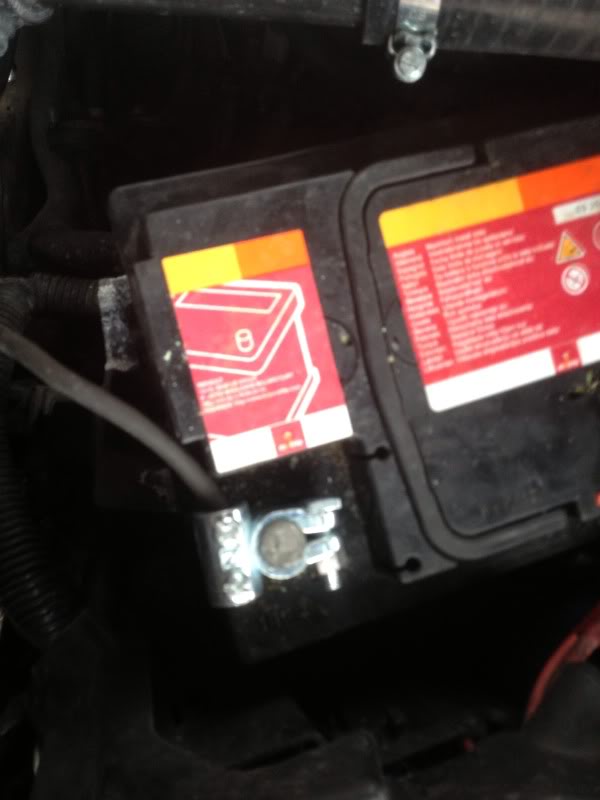

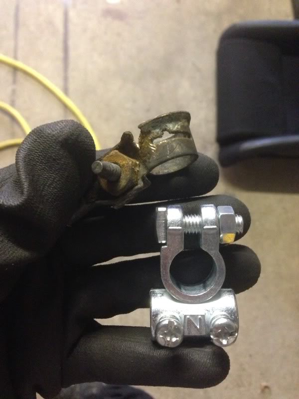

So last night the car wouldnt start, DannyR kindly came round and after pissing about with the volt meter and everything working fine we were stumped. Later on i went to disconnect the battery and realised the sorry state of the connector to the battery terminal.
Quick trip to the local motorfactors once the car was bodged using abit of heat shield and i picked up a new connector, fitted and it now works a treat. The central locking also works from my front door which it didnt used too lol

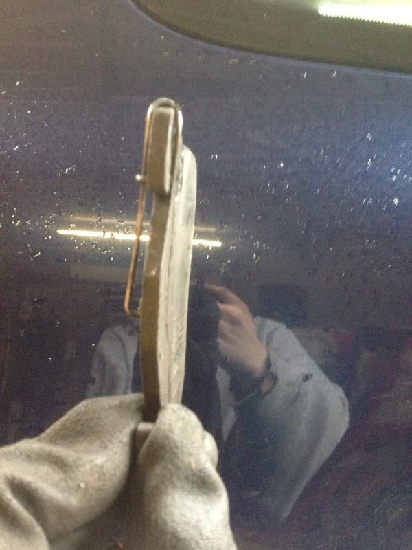

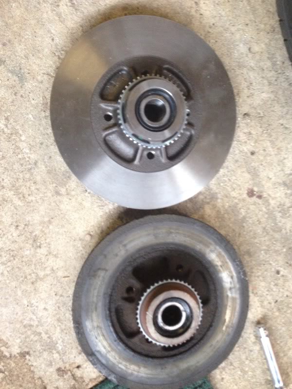

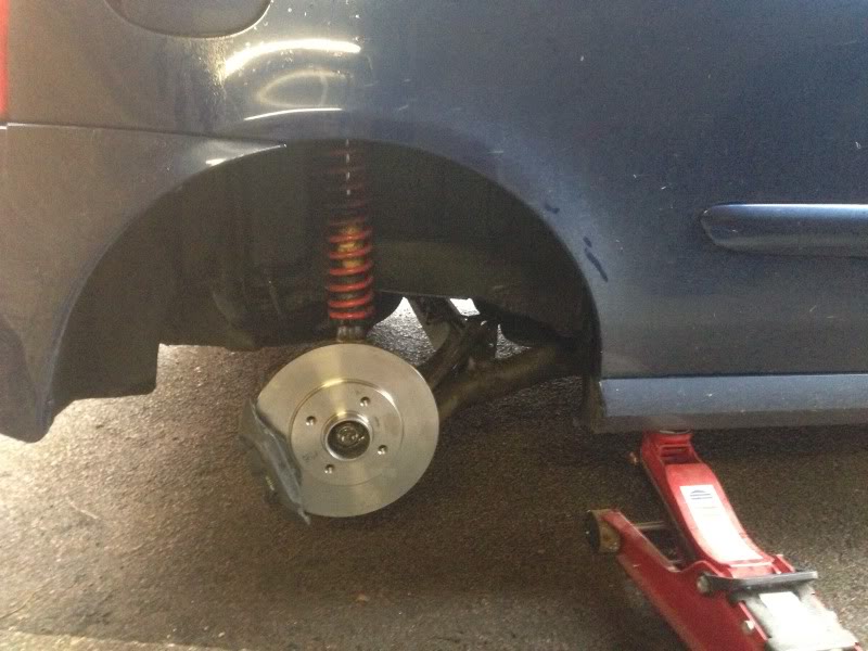

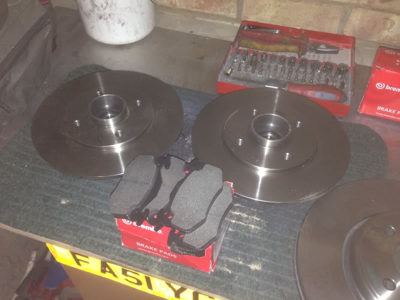

Then whilst i was there i thought i would swap the rear brakes for the ones i picked up last week. Standard replacement brembo discs and pads.
I fitted the abs rings which was easier enough and got on my way.
Old V New,
Old pad, not much life left in these!
All fitted and a nice and shiny!

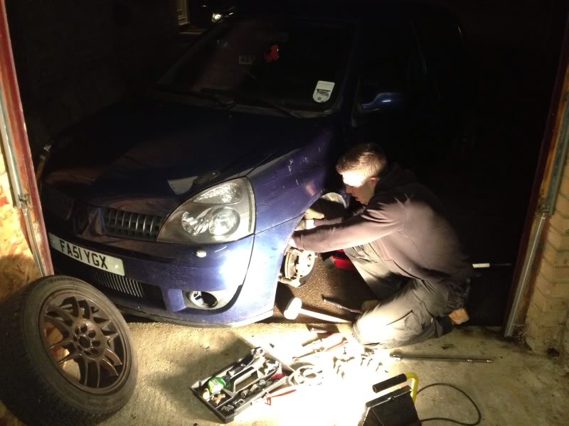

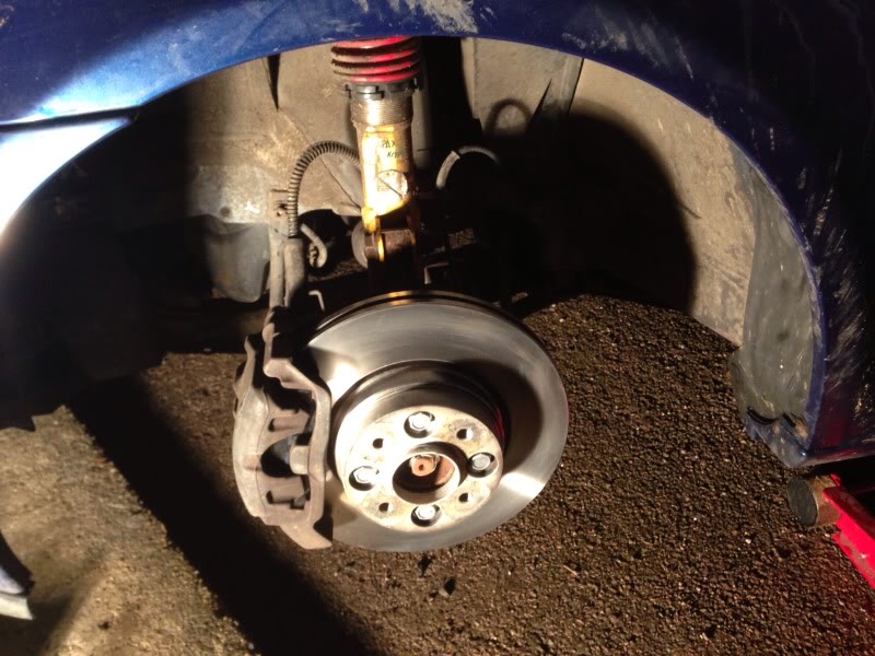

Bit of a random day, swapping rear discs and pads on a mate cars when we noticed the rear caliper was leaking. After ringing everyone/everywhere i couldnt get hold of a replacement. Chancing it i rang Dan @ 519 and he pulled through and had a spare, why is this relevant?

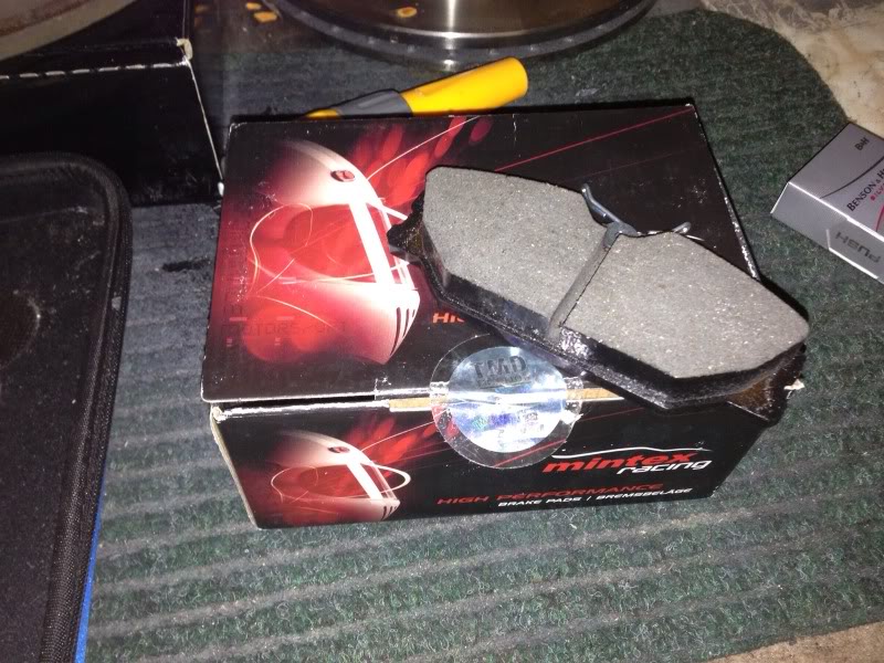

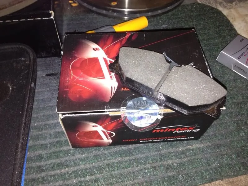

Because it gave me a chance to pick up a set of Mintex M1155 pads :)
Then Rhys Beal offered to lend me a hand to fit them as neither of us had anything better to do on a saturday night ha,
Rhys turned up at 10.30 and got stuck in!
Whilst I used the dremmel to take the edges off the pads. My neighbors must love me!
Finished product, including the new brembo hc discs.
We then took it out bed them in, first thoughts are they feel really good and firm braking. Cant wait to get a few more miles on them and really hammer them in as they are looking really promising!
