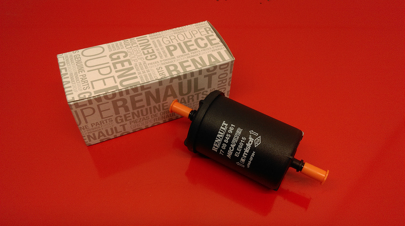

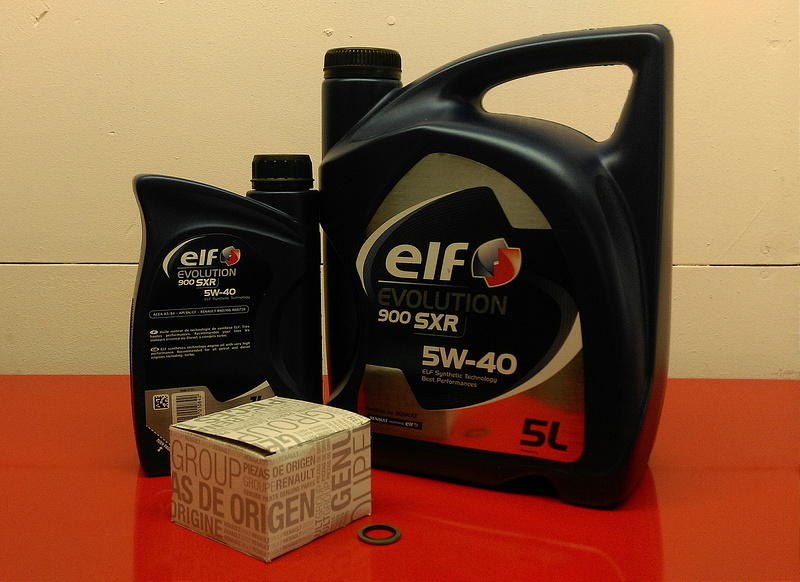

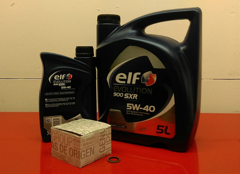

Decided to do a little winter overhaul on the Ph1 before it starts getting too cold. Bought a few things that needed replacing:
New Elf evo oil
Oil filter and washer
Fuel filter
New wiper blades
New headlight bulbs
Screen wash

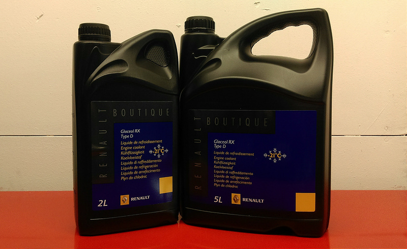

Coolant change to Type D

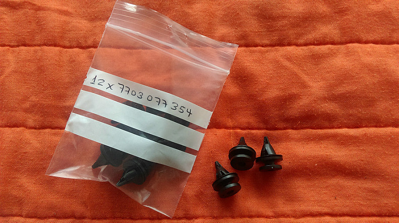

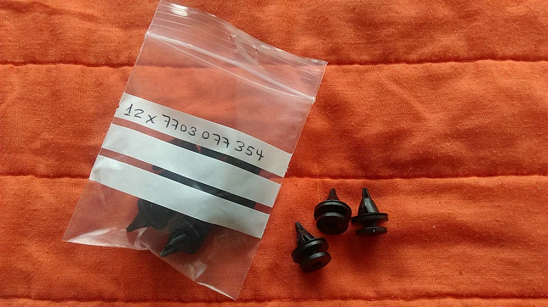

Boot panel clips

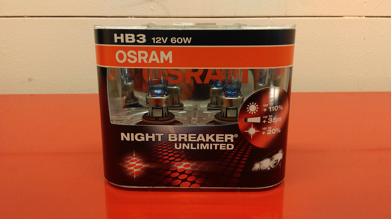

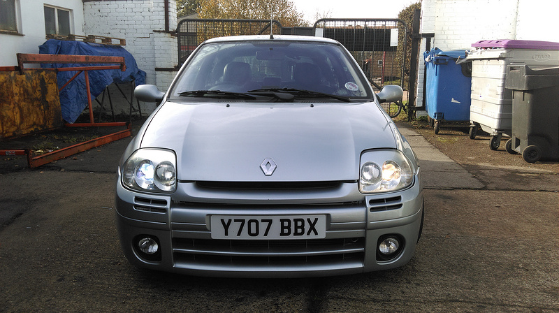

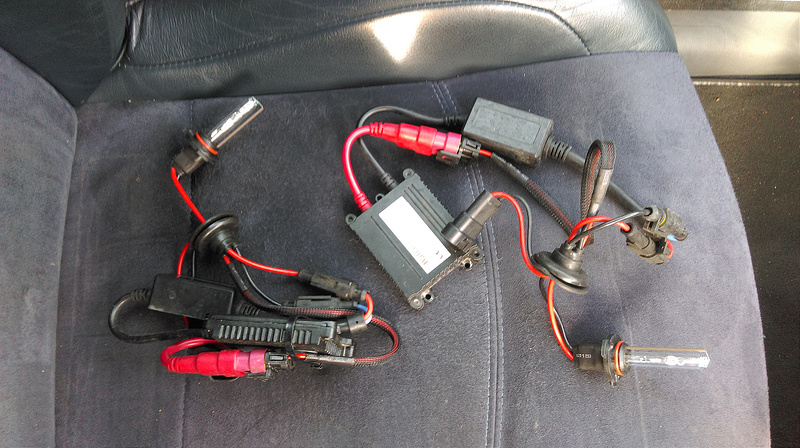

I decided i wanted to remove the 5k HID's as they flicker when first lit up and and i have to change the pins everytime i get new bulbs for them so after a few read ups i got the Osram Nightbreakers Unlimited. The colour is more yellow than the blue 5k's but changing a bulb will be easier and there's less clutter in the bay. Think of all that weight saving!
HID's on the left, Nightbreakers on the right.

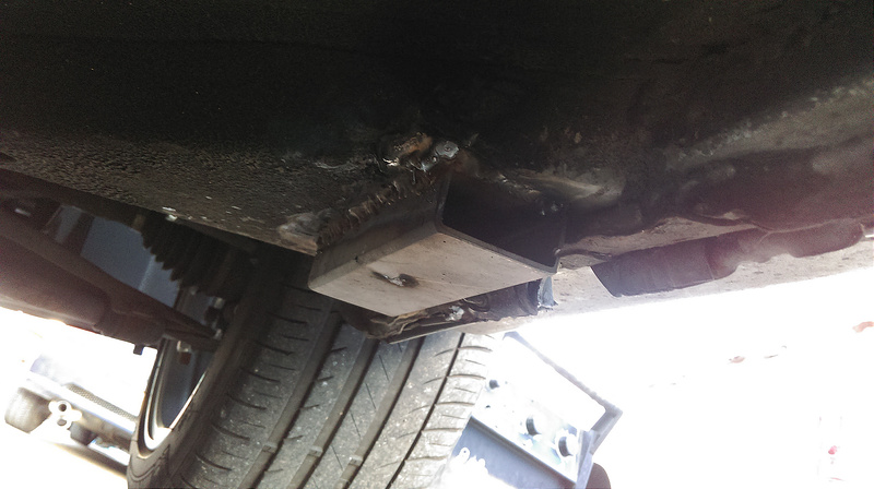

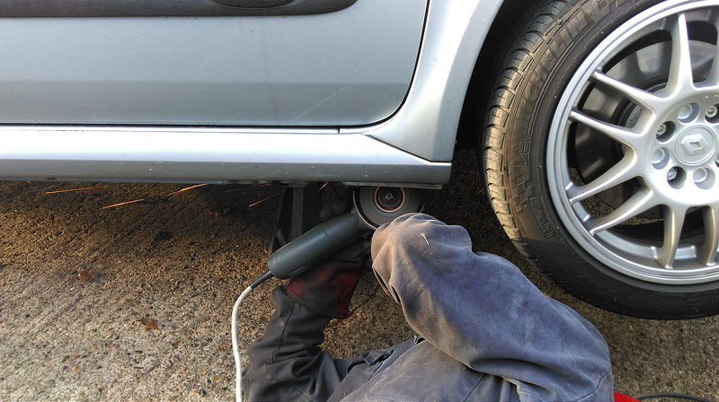

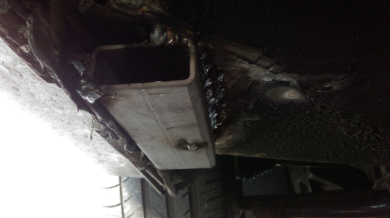

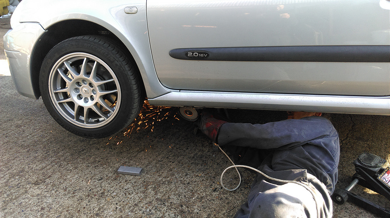

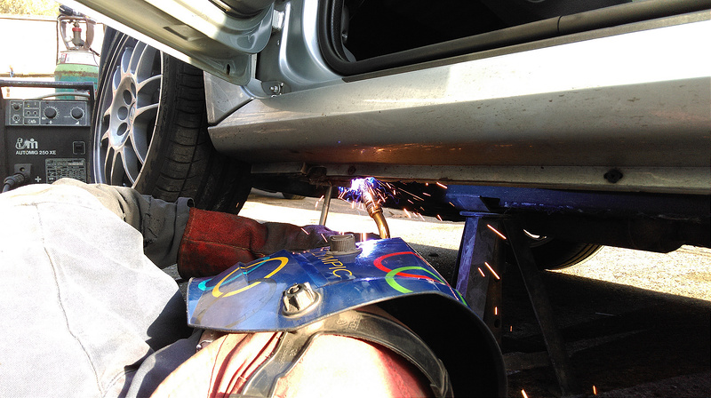

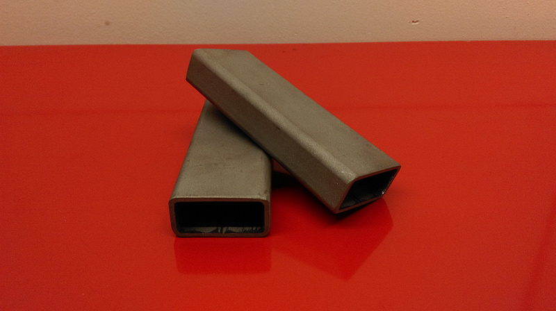

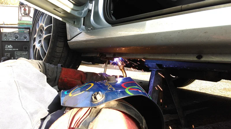

Basically my jacking sill were non existent. It really bugged me the way the was all bent in so i decided to cut up some box section at work and weld them on for strength. I sandblasted them as i wanted to paint them before i undeseal them.

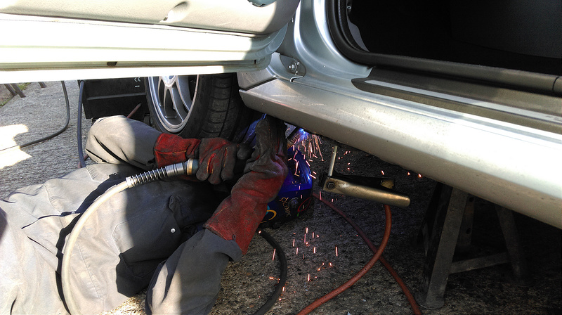

I bent them as straight as i could then a i got a chap at work to weld them on the car.
All welded.
Ive given them a coat of silver Hammerite that i had for now but i'll give them another coat before i underseal the car. Should be stronger now. Thanks Charlie :smile:

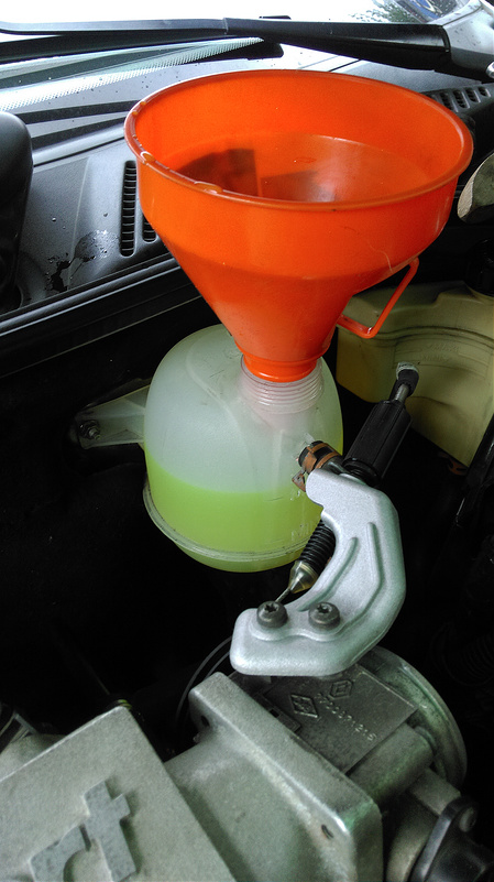

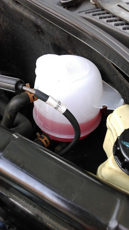

Next up was to change the coolant which @AlexW gave me a hand with.
Old.
New.

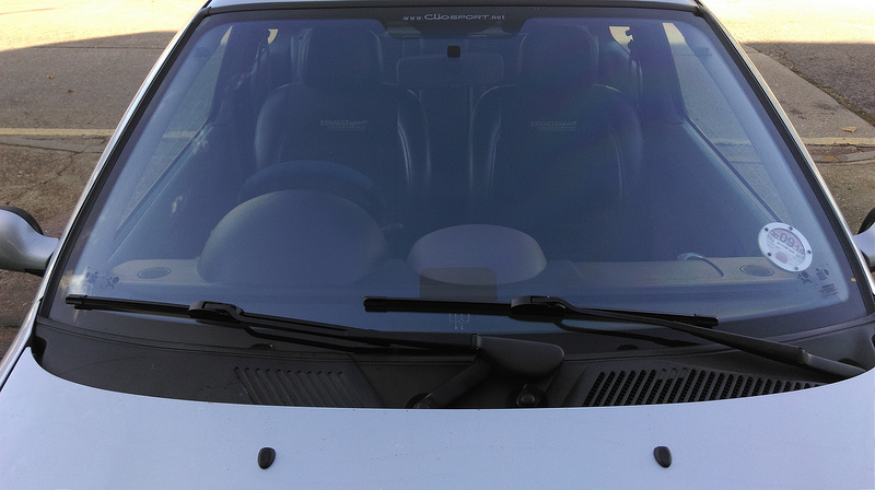

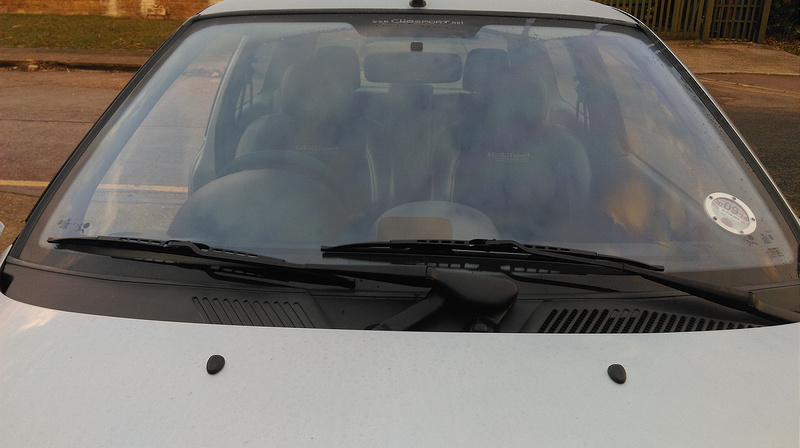

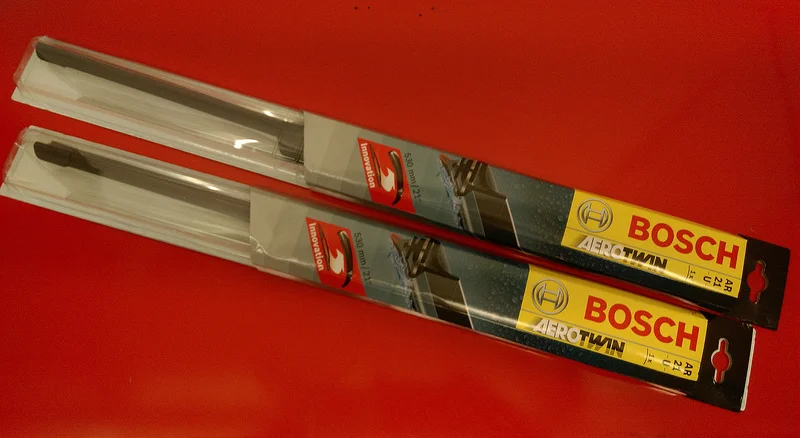

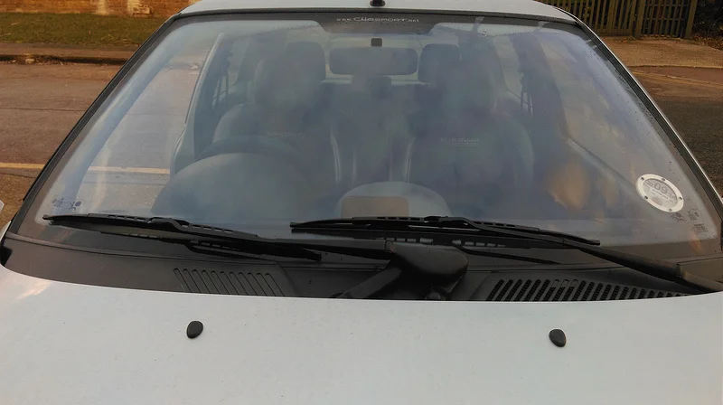

Changed the wiper blades.
Old.
New.

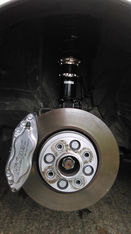

I removed the taxdisc holder too. I was attending the EoE so i gave the car a quick wash. Checked the torque on the spacers bolts which were fine and gave the coilovers and brakes a clean. They both still look like new :smile:

Keep an eye on those jacking points to, as that section there isn't structural and will bend inwards if not careful. Hence why Dan put them to sqeeze the Sill lips.
Alex has a point about the jacking points, tbh I dont like the way I done mine (they didnt sit that straight) Woud be better cutting a section of the folded sill out completely and replace it with a bit of box section where the exsisting was.

Also where'd you get those bulbs from? Might get a set for mine!

Do the manifolds actually make "that" much difference? The box section is more of a sill strengthener, rather than relying on it. It's more to stop the sill bending backwards again. Before we welded it, it did look like someone had jacked it there before as it was slightly dented both sides

I got them from eBay for £18. I just typed in "Osram Nightbreaker Unlimited HB3" and went for the cheapest!

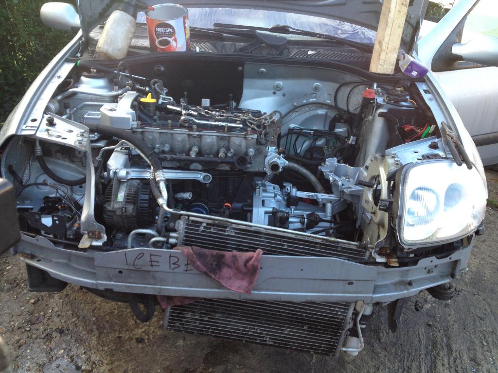

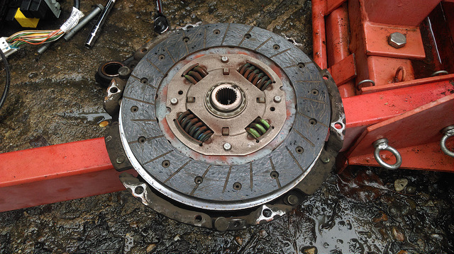

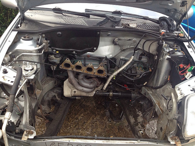

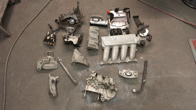

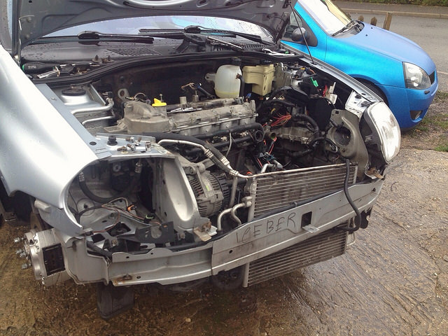

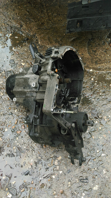

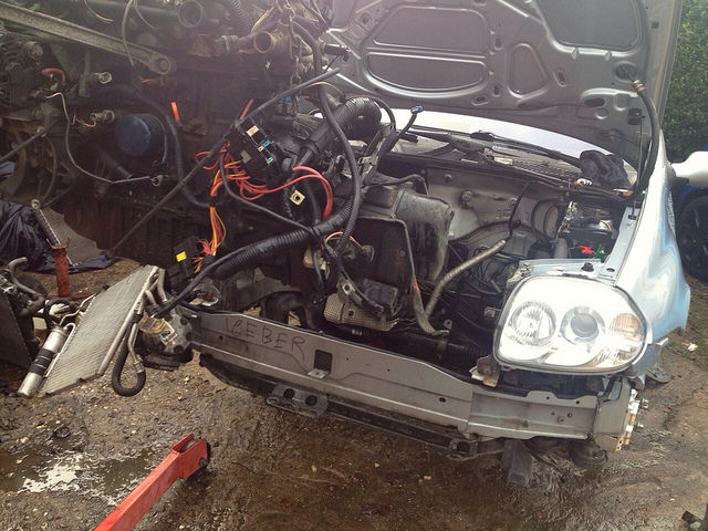

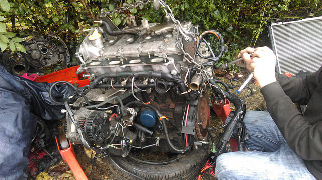

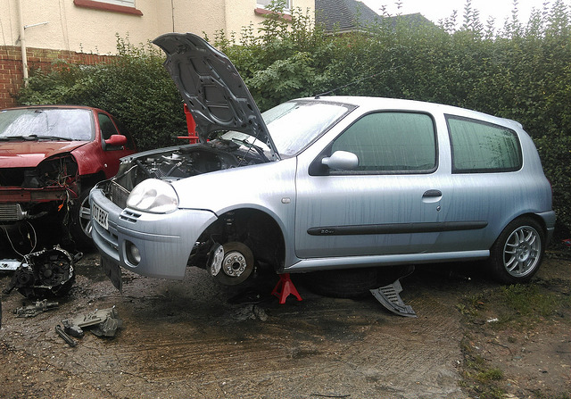

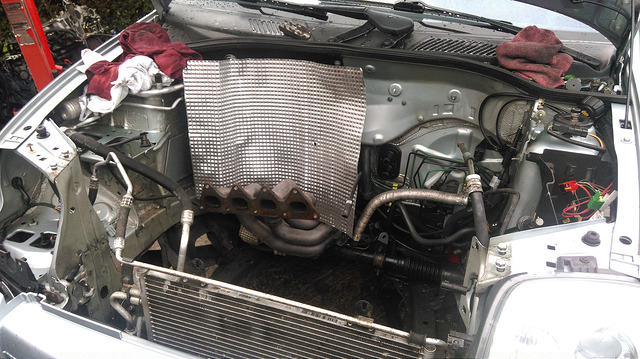

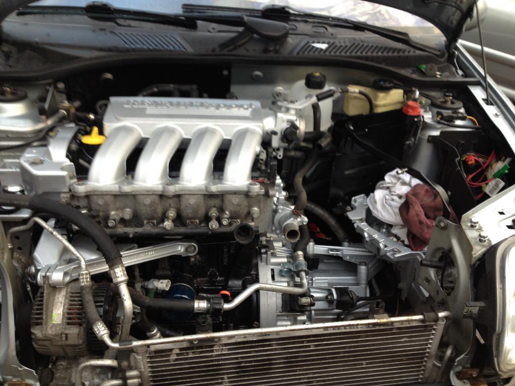

Shot out to see Alex and the Clio this morning. Took a few pics. Alex said that this could have been one of the easiest clio's to have worked on.
Clutch was the original one. Had done 83k so fair play there.

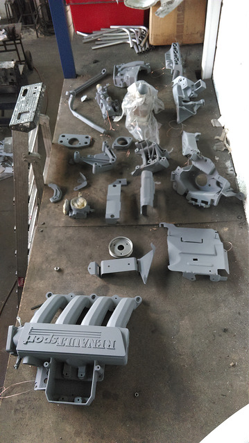

Decided that i'll be using some Nimbus heatshield as the existing bulkhead carpet is all manky but im not spending over £100 on a Renault one. Gave the bay a quick clean too, but Alex will give it another one before the engine goes back in.
And parts to be painted. Going all silver apart from engine mount plate, cam cover, ecu bracket and battery brace bar which will be black :smile:

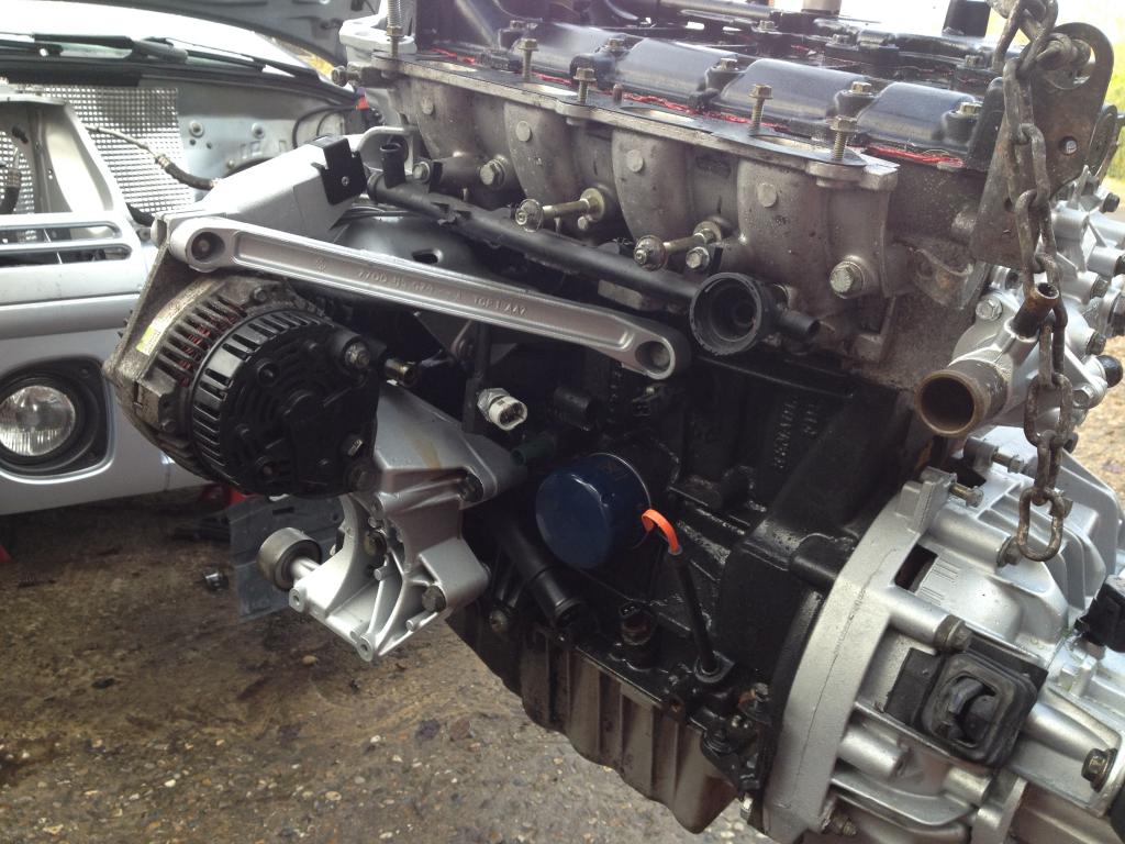

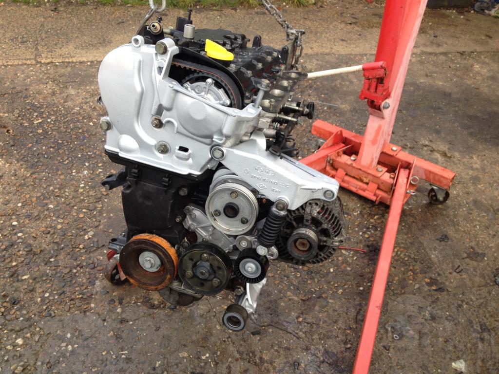

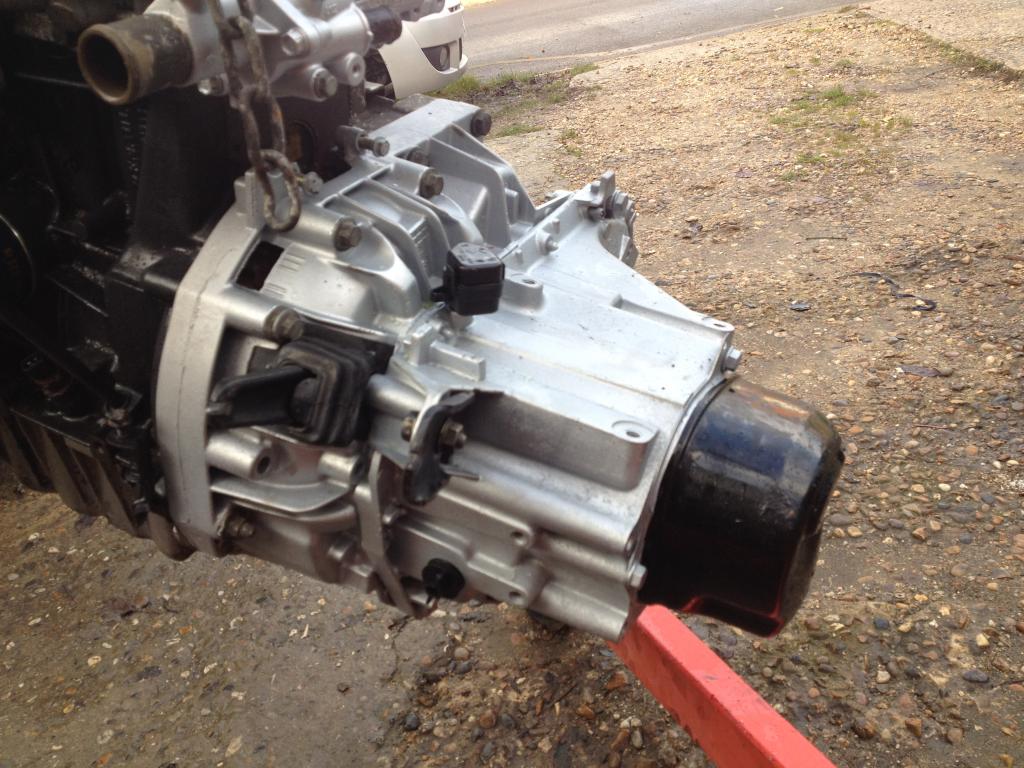

Update (shamelessly taken from @AlexW thread)

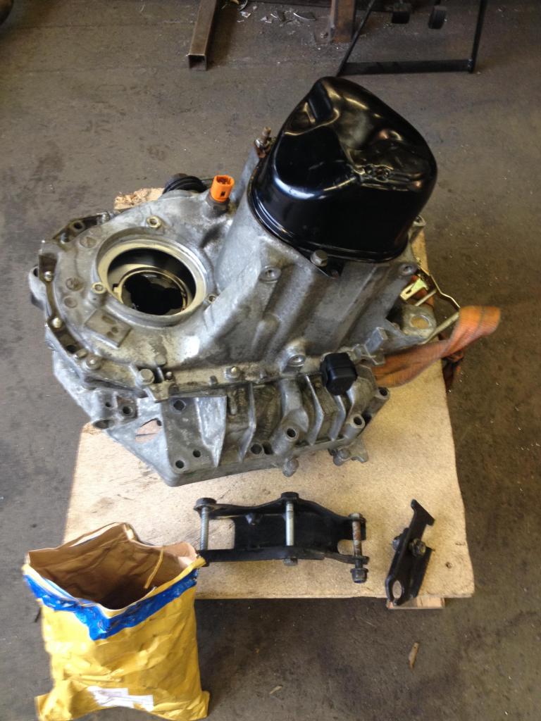

Gearbox has come back from Agency Transmissions. Got it painted in silver then dropped off to Alex's. Had all my bits painted. Got all the silver parts done with 2pac lacquer and I've painted the rocker cover and a few other small bits in satin black and halfords rattle lacquer with plenty of coats.
Filled the box with...
However the box leaks, from the end plate, Cheers Agency lol.
Quick list of what its had...
Powerflex Black Rack Bushes
Nimbus Heatshield
Cam cover re-sealed (Loctite 518)
Cam seals
Dephaser
Cambelt kit
Water pump
Aux belt kit
Inlet gaskets
oil filter
Thermostat
Changed alternator pulley to the later 182 metal type.
Valeo Clutch
Spark plugs
Changed gearstick for a refurbished item
Cat fitting kit
That's what he's done so far, still loads of bits to come.

What's happening with the leaking box? Actually that sounds really dodgy :smile:
