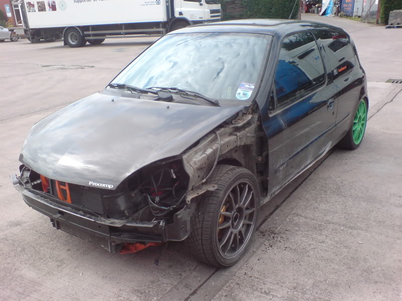

fred im interested in the 4pots - am i right in thinking this is running 1.2 16v running gear like mine is?

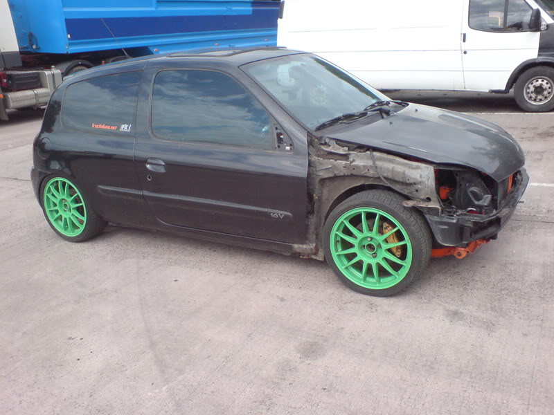

yep 1.2 everything, hubs, wishbones, ARB, the lot, the kit is a hispec billet 4 285mm clio kit with the bracets machined down to take a 280mm disc (half the price!)
forget the ABS, i binned it and fitted a bias valve instead

so hispec actually made the kit to fit the 1.2 hubs?
