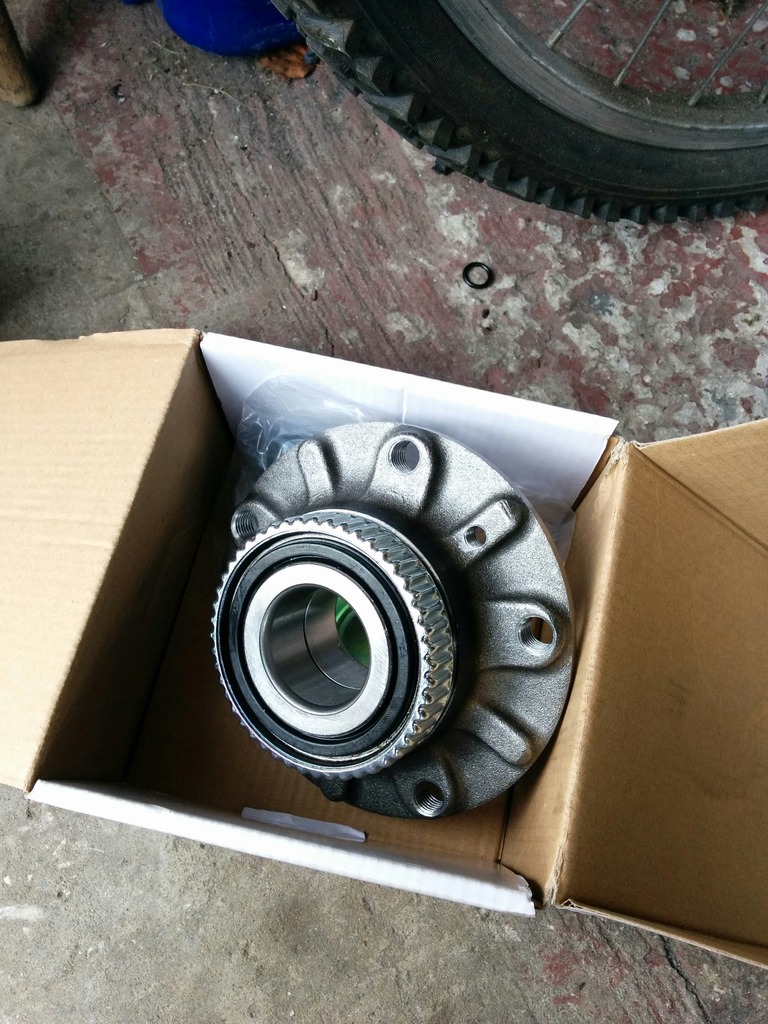

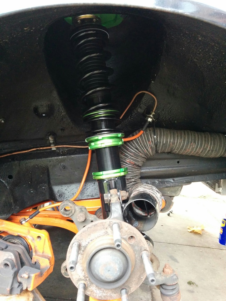

Had a quick check over the car before Donington, and felt a slight bit of play in the front N/S wheel bearing, or so I thought. These have never been replaced before, so I swapped it for a new one...
After fitting, the play was still there. Turns out the play is coming from the shock itself, the piston seems to be worn in its body. This will need replacing/sorting.

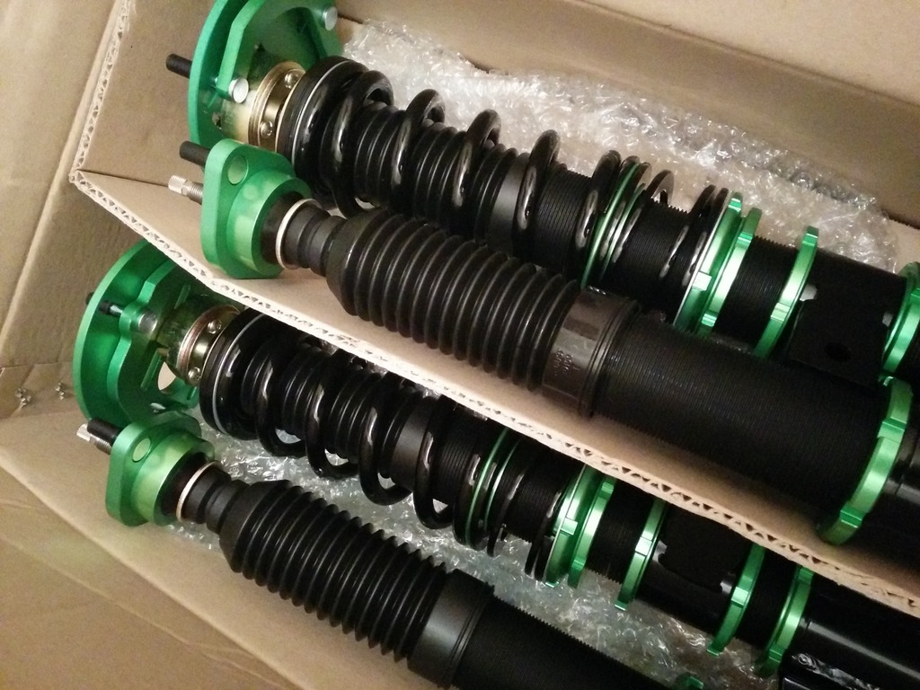

So after exploring options on replacing the front shock, well the pair, it turned out the components would not swap over anyway so I had two options.... keep using the dodgy shock or replace them. After speaking with the original supplier (had them around 2.5 years), I got another set sorted...

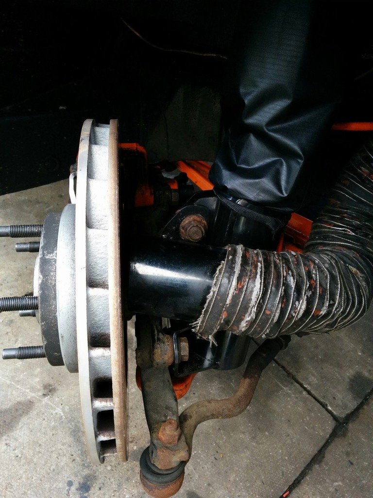

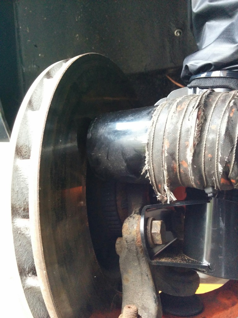

Got them fitted and set up, slightly different to the previous set, but no major issues. The pictures also show the front brake cooling which was changed a while back and just never posted anything about it.... the brackets are mounted from the shock, feeding air from the bumper ducts into the centre of the disc.

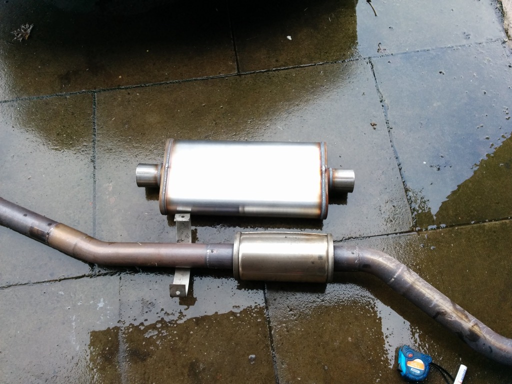

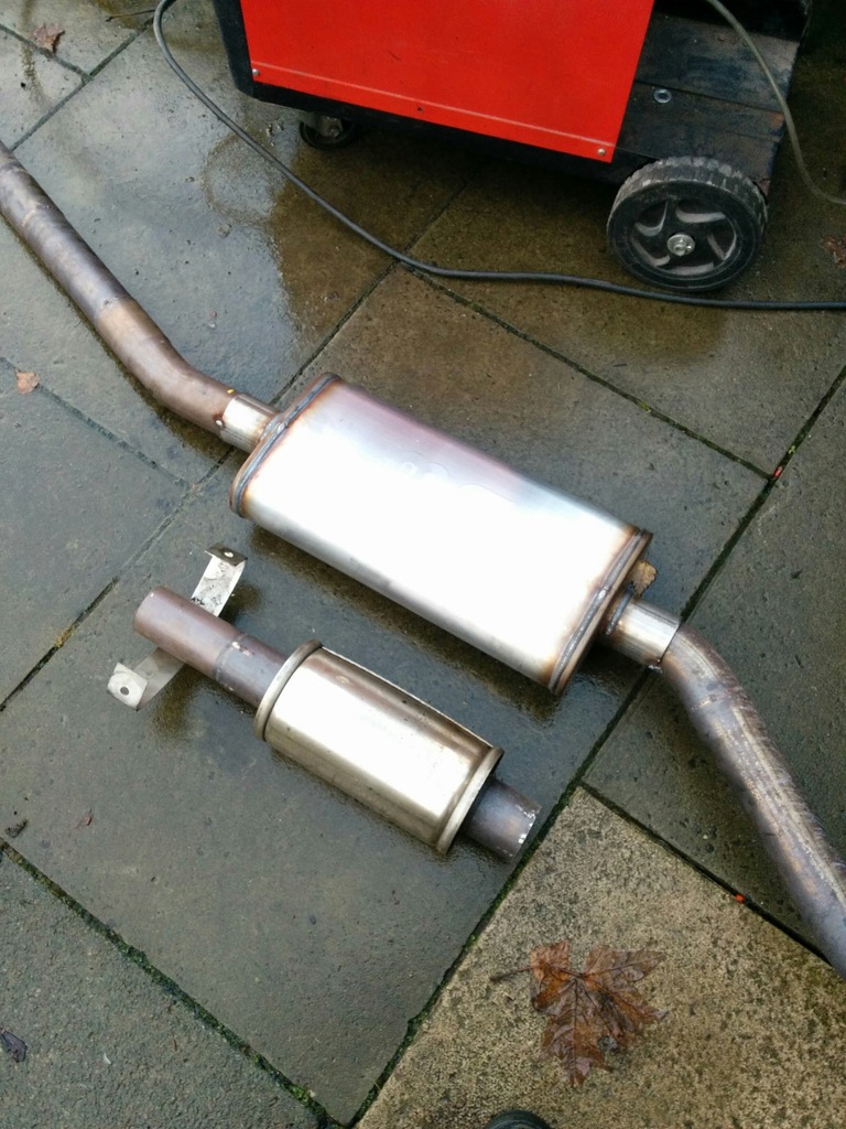

With Oulton park coming up in less than a week, I wanted to be sure there was zero issues with noise. Like I said previously, never had an issue at any circuit until a few weeks ago at Donington... somehow it failed the 98db driveby there yet is fine with a 92db driveby at Oulton.... go figure.

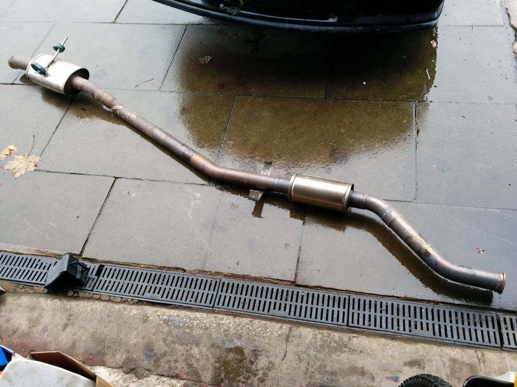

Anyway, the simplest way to be 100% sure was to swap for a larger silencer. It has gone slightly louder since it was first fitted, but I had put that down to possibly losing some of the silencer material from the centre box. The exhaust has been fine for over a year now, since it was made when the engine went in, all still in one piece anyway. I dropped it off the car...

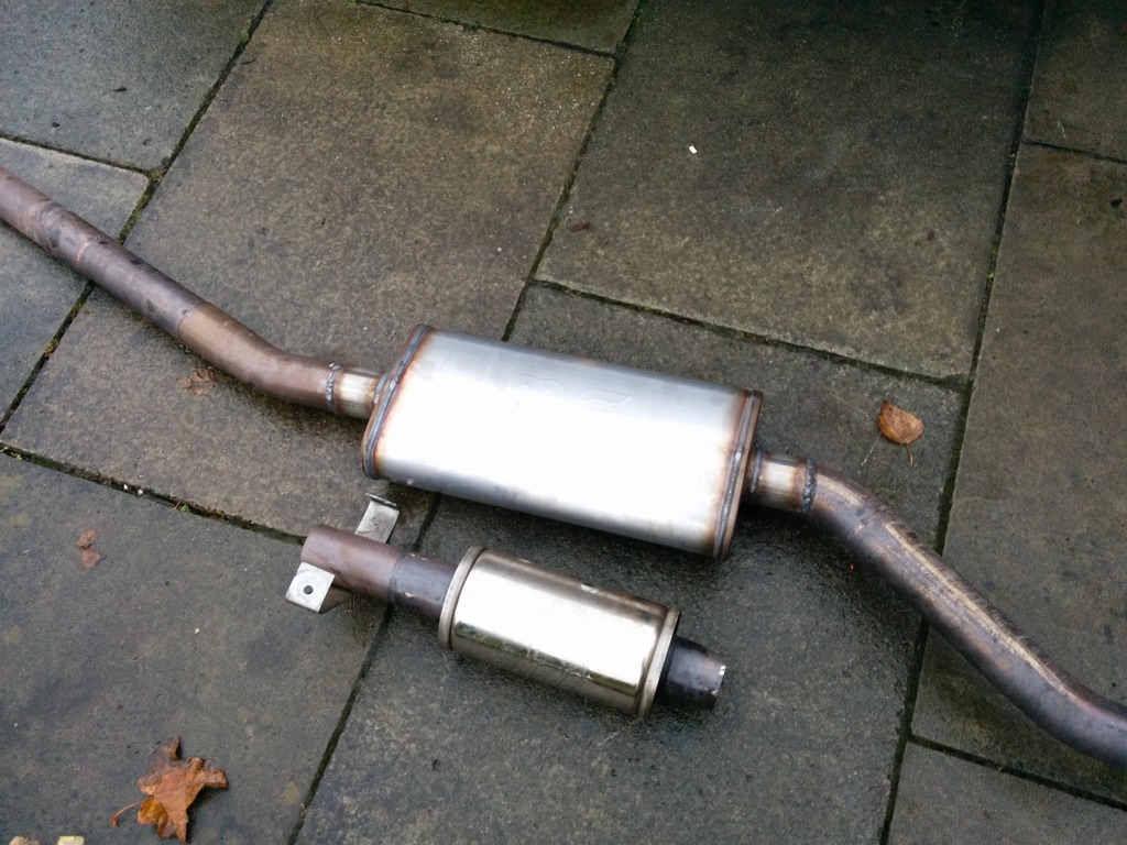

Then picked up the largest silencer I could fit in the centre, as well as within the space of the transmission tunnel; went for Magnaflow this time. The new silencer is shallower height wise - the aim was to mount it higher to aid with clearance, as the previous round silencer occasionally caught on things.
After an hour or so of messing around, cutting the old silencer out, changing the position, height, etc... I had it tacked together. Then it was welded up and fitted back to the car. I would have preferred to get it TIG'd but with time at a minimum I needed it sorting today. Could always be re-done in the future.
First impressions are its noticeably quieter on idle/cruise as you would expect. Hopefully this one will make certain of no future noise issues.
Car is now 82db static, still quite a bit of noise under load though which is fine.

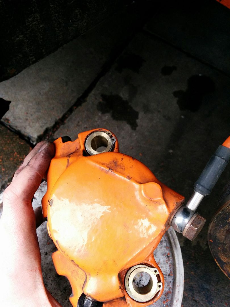

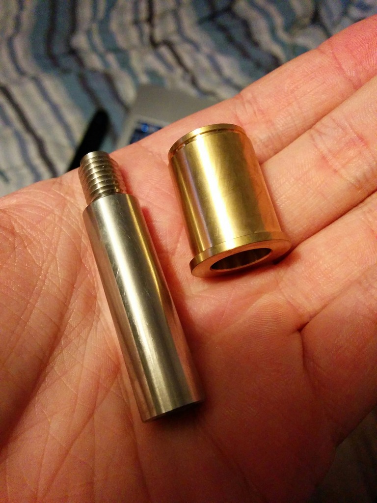

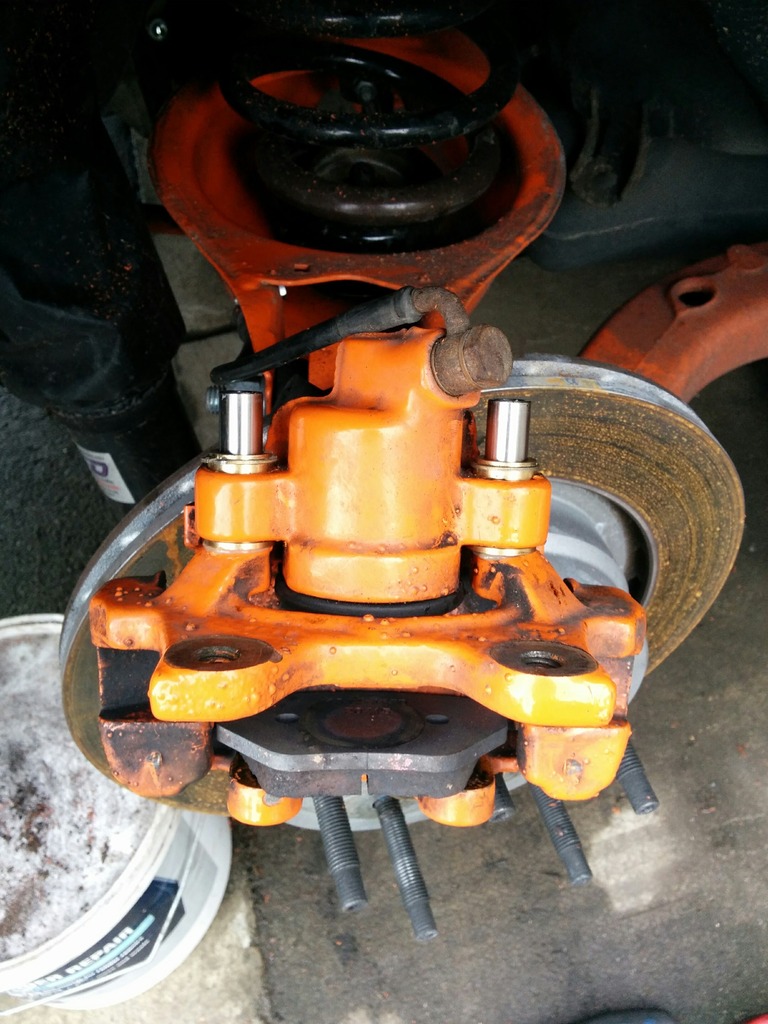

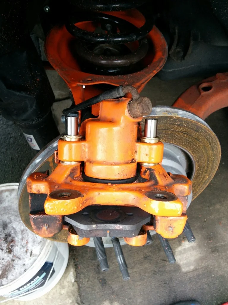

So the week before Snetterton I swapped the slide pin bushes on each caliper - these are just rubber from factory, and tend to make the pedal go softer the hotter they get (as the caliper flexes). New spring clips/retainers combat this somewhat, as they stop it flexing as much - although the only real fix is to go solid with them, removing the rubber part. Some companies in the USA sell 'solid' replacements, so about a month before I ordered some.
They consist of a brass bushing (which is a push fit into the caliper, retained by a circlip), and a matched slide pin. Each caliper was then taken apart and the bushing/pin fitted..
A very small amount of high temp grease was added, and from then on its just a matter of checking them over every so often. The pedal feel has completely changed - its how it should have been in the first place, firm and consistent. The other benefit is now the pads will wear completely square - whereas previously they wore at an angle to each other due to the flex in the caliper.

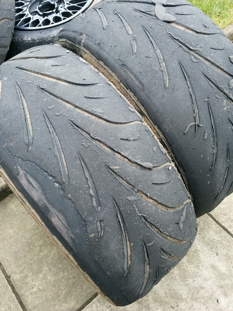

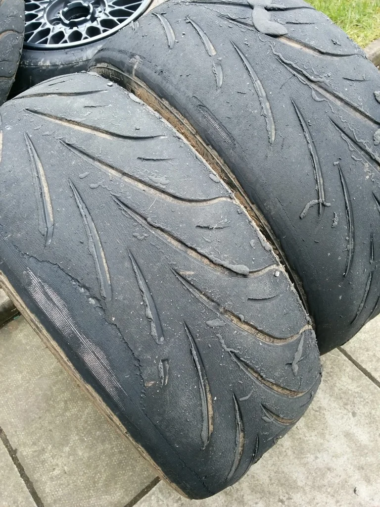

Will also be needing two replacement tyres before the next outing..

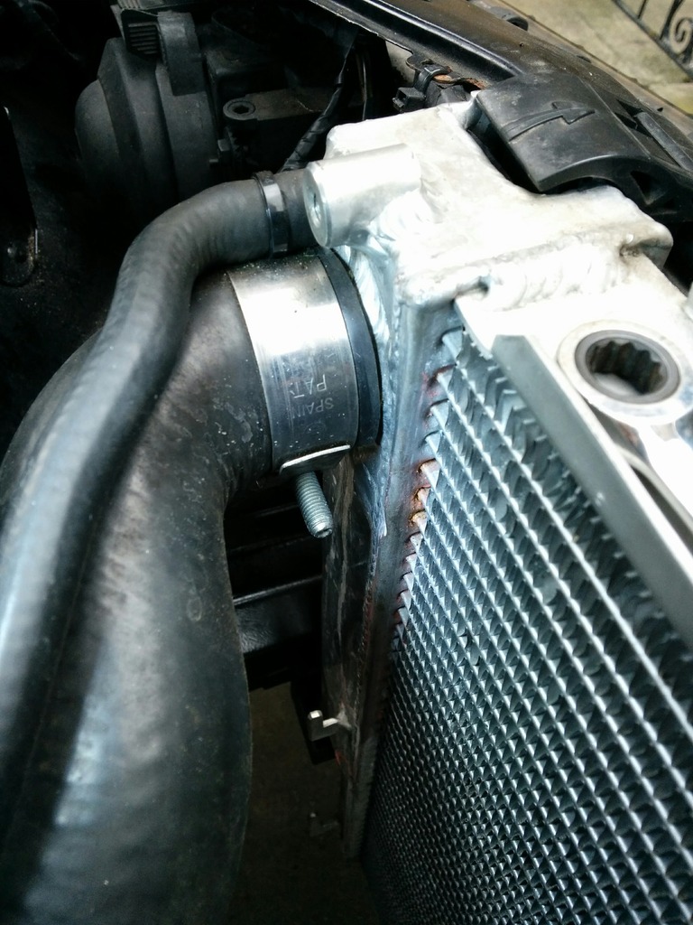

After a quick check over the day after it seems a couple of the radiator cores have started leaking (again), which will also need sorting. Quite poor considering it covers minimal miles, is only just 12 months old and the same happened to the one before it too..

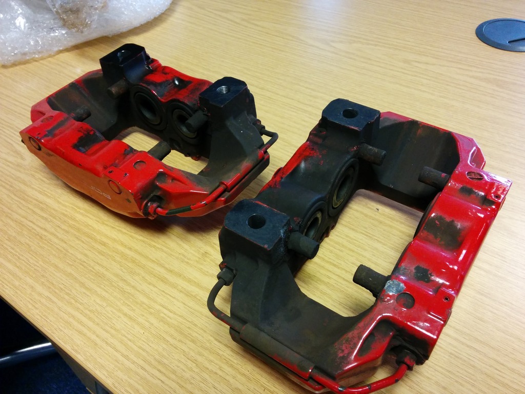

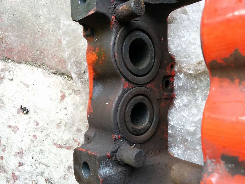

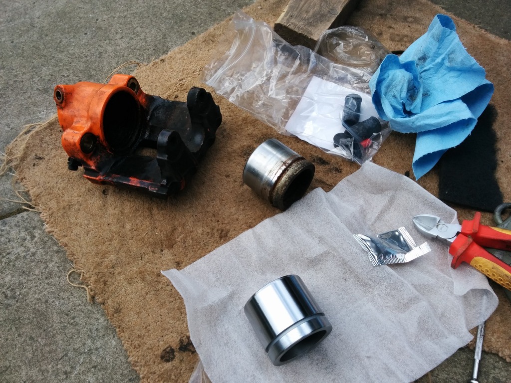

One of the front caliper pistons looked a bit worse for wear, so with the price of them (£12) I decided to replace it, as the other side was replaced in October last year..
The other good news with the brakes is the pads are now wearing perfectly square, rather than at an angle (since fitting the solid brake caliper bushes)..

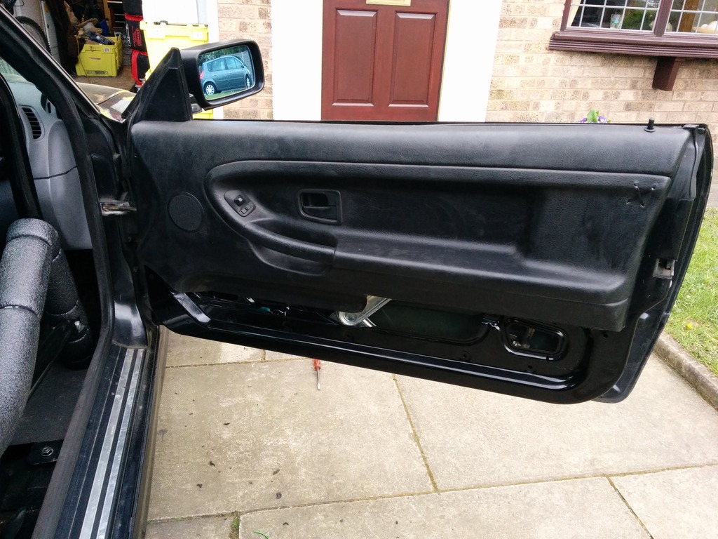

Everything was re-assembled and bled through with fresh fluid, all good to go again. Both electric windows had stopped working a while ago, so it was time to sort those out. I ended up fixing them and stripping 3/4 the weight from each door card..

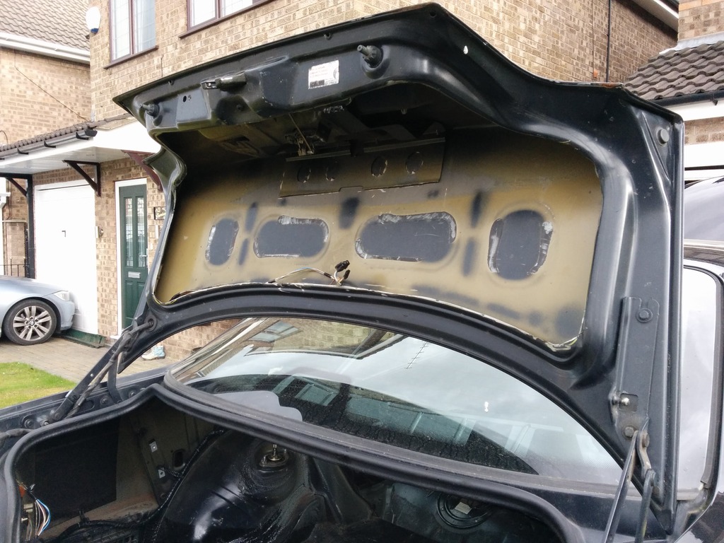

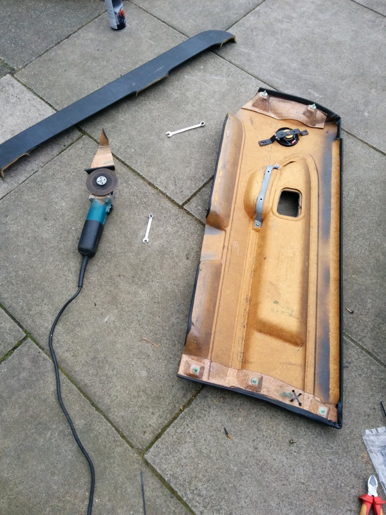

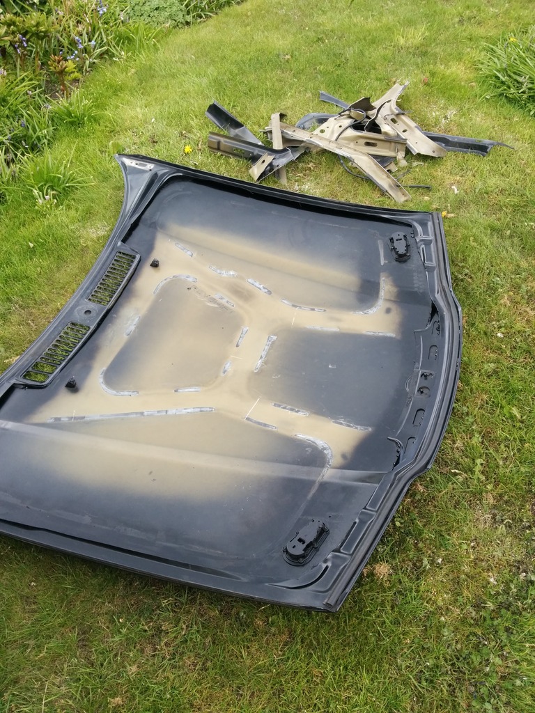

Then decided to cut some weight on the bonnet and boot lid, removing the inner skins, nearly 1/2 the weight on both..
They need some edging round to finish, but that will be done at some point in the week.

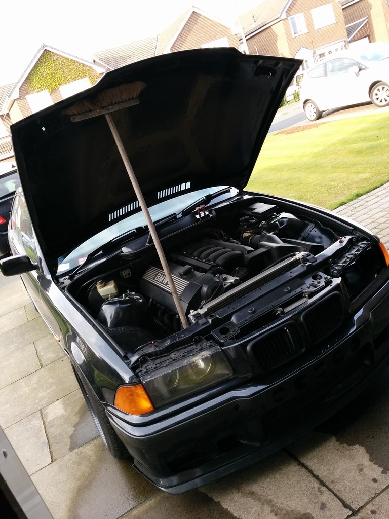

A couple of people had mentioned the car putting out some considerable flames on over-run at times, which its not done for a while, and the only thing that had changed is I now run no headlight so the air box is directly open to the air.
After looking at the data logs once home the inlet temps were up to 10C less than with the headlight in... must have been pulling hot air from the back of the engine bay before hand. Spa last year saw circa 30C inlet temps when it was 2C outside.... Anglesey was nearer 20C when it was 15C outside! In turn the ECU had added some fuel in on trim and caused it to run a bit richer. The trims need dropping back slightly and checking really.

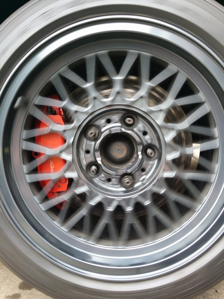

Towards the end of the day I didn't really like the feel of the brakes under high braking force, it sort of felt like brake fade, but wasn't. The power just didn't seem to be there, well, the feel through the pedal more so. The solid caliper bushes which I had fitted previously had made a considerable difference but they still didn't feel as I'd expect.

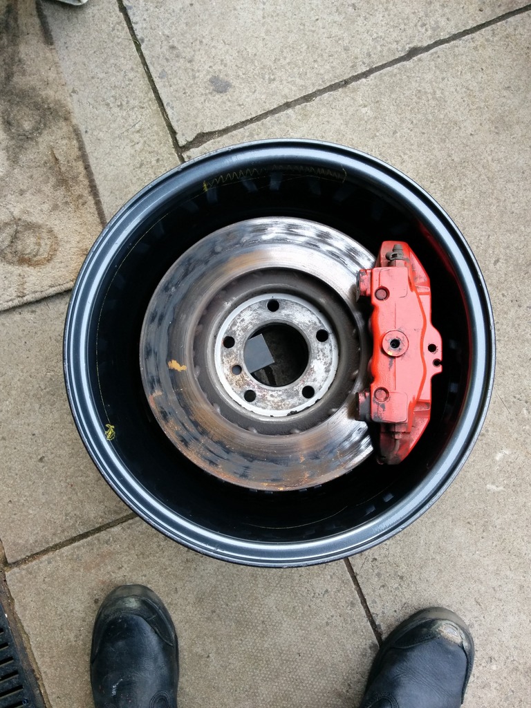

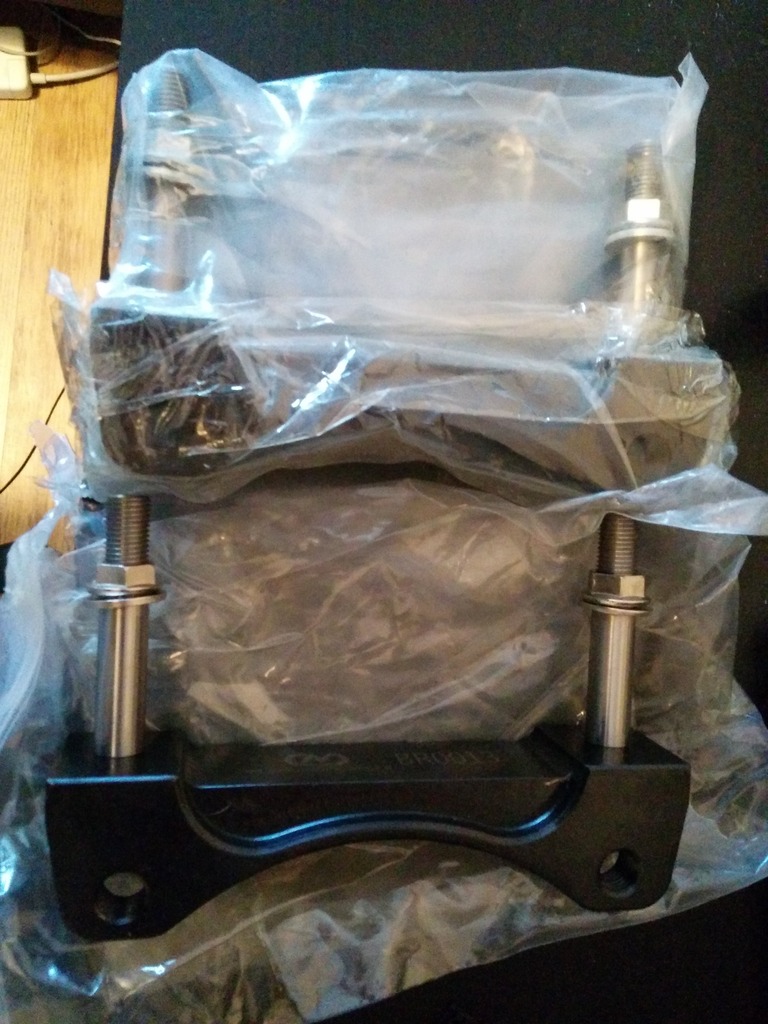

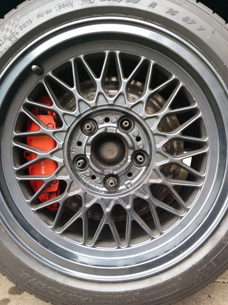

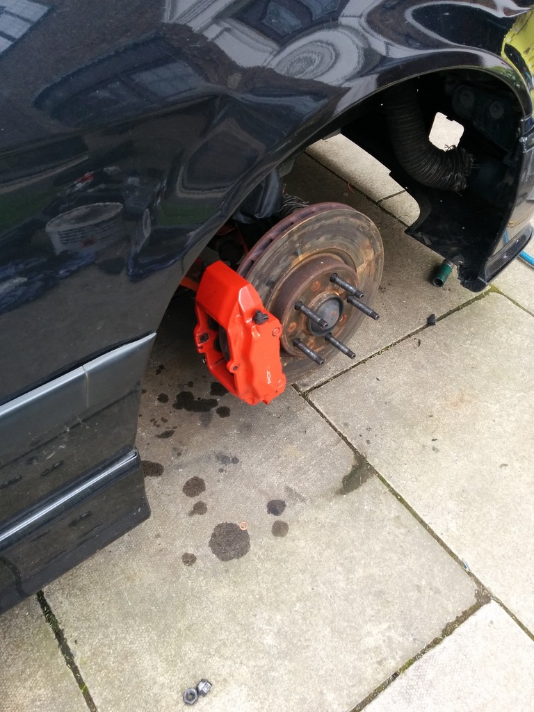

With running 16s there aren't too many options to change caliper, well not that other people have done. Many aftermarket calipers will fit under 17s, but talking big money really. I wanted a solution to keep my E36 M3 discs and fit under my 16s. Porsche 996 front calipers use the same thickness disc as the E36 M3 (28mm), just a slightly larger diameter, so I picked up a set of used calipers and set about getting them to fit.
People have done this before, but claim you need 18s if you want to run without modifications to the caliper, and 17s with some modifications. Another reason why you shouldn't believe what you read on the internet.... with some machine work (12mm from the mounting face) and some adaptors:
They fit well under 16s with the stock disc and 15mm spacers..
I still need to get some pads and retaining pins before bleeding them up then the next track day will be the real test.

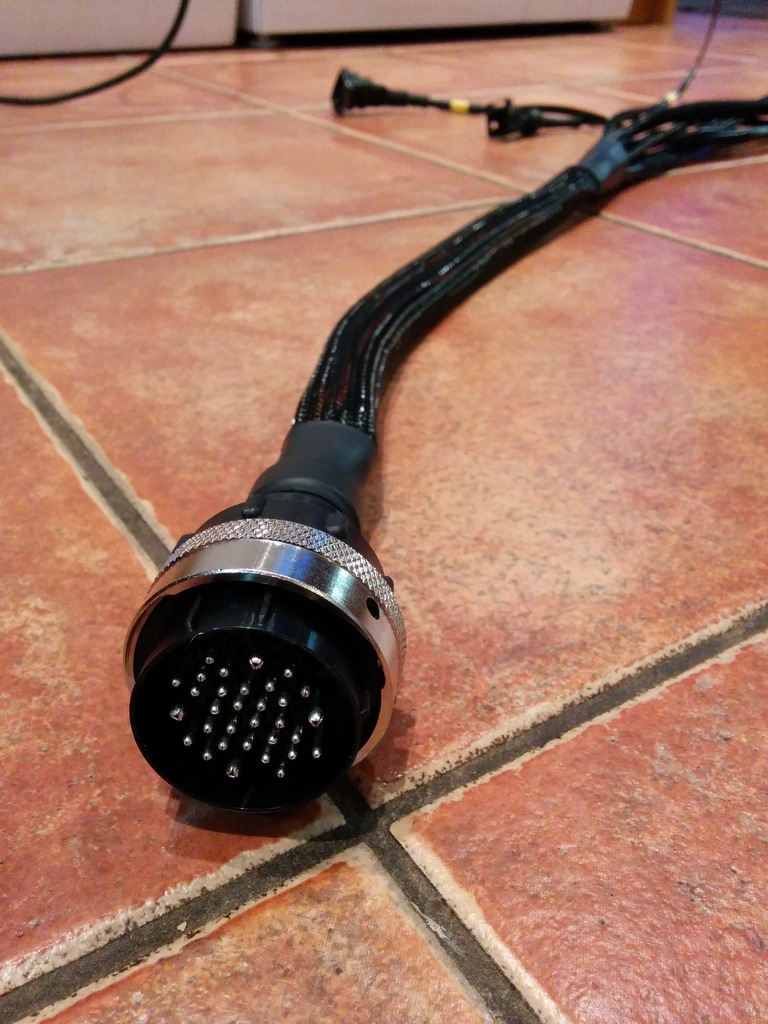

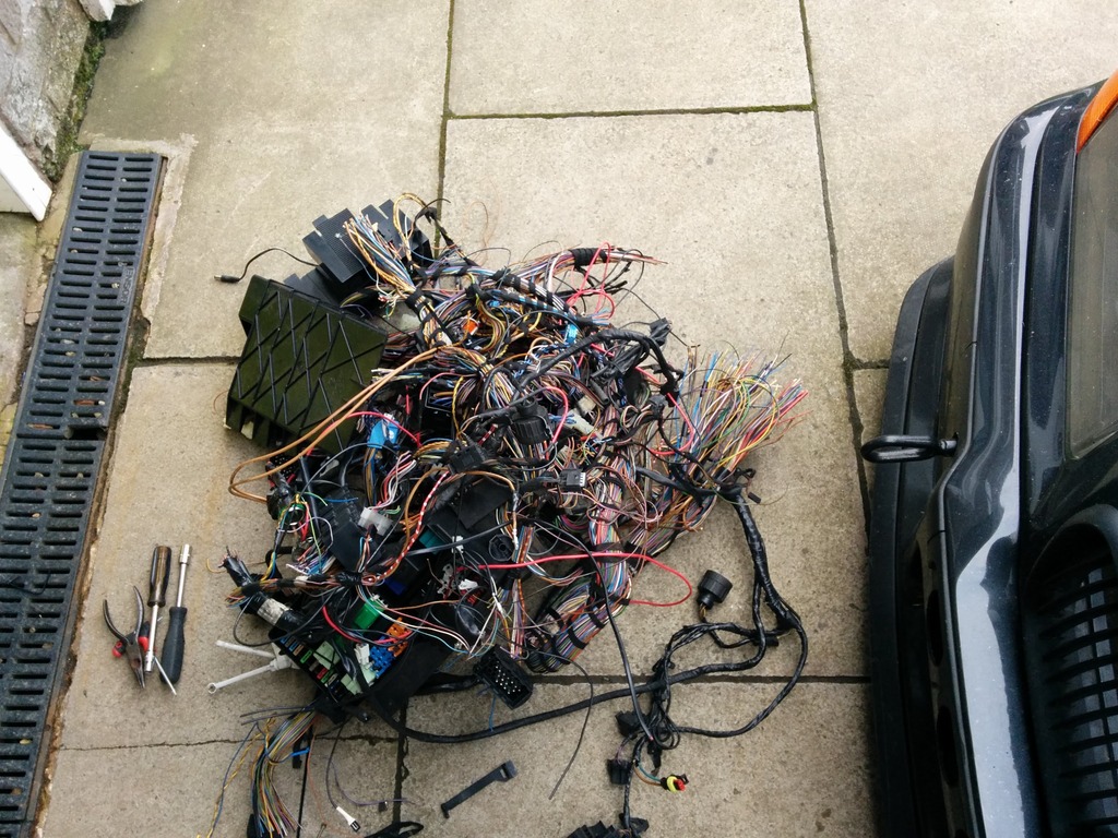

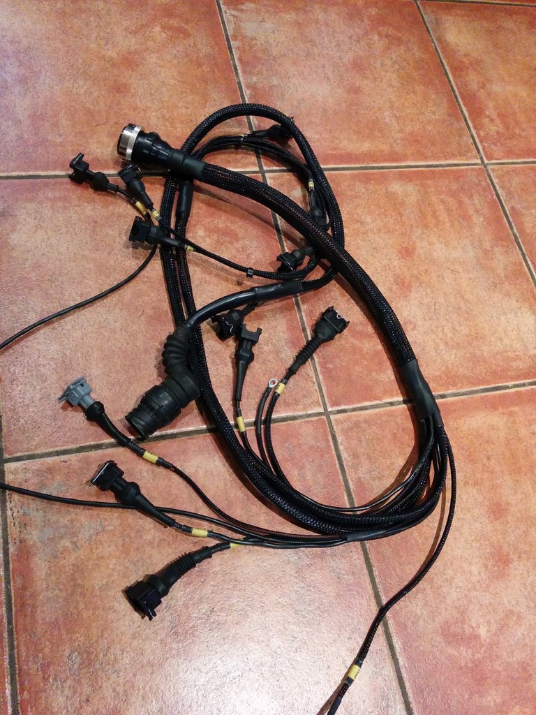

Another major task which is still on-going... a complete re-wire. I started by ripping out ALL the stock wiring, fusebox, everything:
Planned to only run the bare minimum. Keep the standalone, with a new engine loom, and then just wipers, instruments/gauges, lights and bare essentials. Removed all the HVAC unit, controls, electrics and blanked off the bulkhead.
Engine loom was first, all terminated to a bulkhead connector. Shielded cable for all sensors, bit of an overkill but had spare cable to anyway.

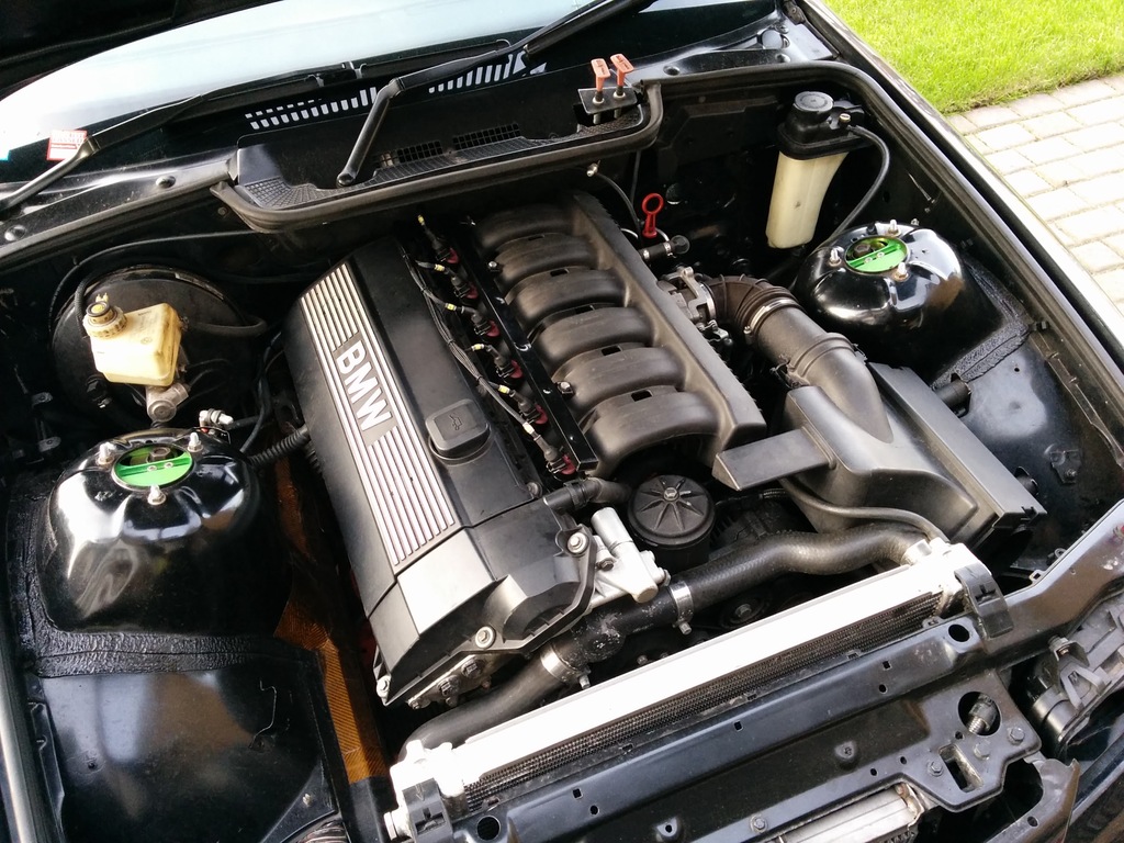

The engine bay was then tidied up, expansion tank moved to the back now the standard fusebox has gone, and loom fitted.
Interior loom is nearing completion, then its about set. Hopefully get the remainder finished over the coming weeks before heading back to Cadwell.

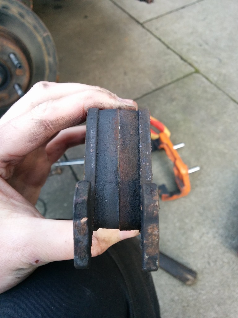

Had a few issues with pad fitment on the drivers side caliper, due to inconsistency with the hub casting/position, but nothing a small bit of machine work could not sort. Pads now fit perfectly, bled the system through with fresh fluid and all operating fine. Cadwell Park tomorrow.... interested to see how they perform.
Do the pads overhang the disc at all?
I have a set of 4 pots i'm tempted to whack on my M3, but would rather not go for CSL discs if i can help it..
When I looked at it last week on the passenger side it was perfect.
