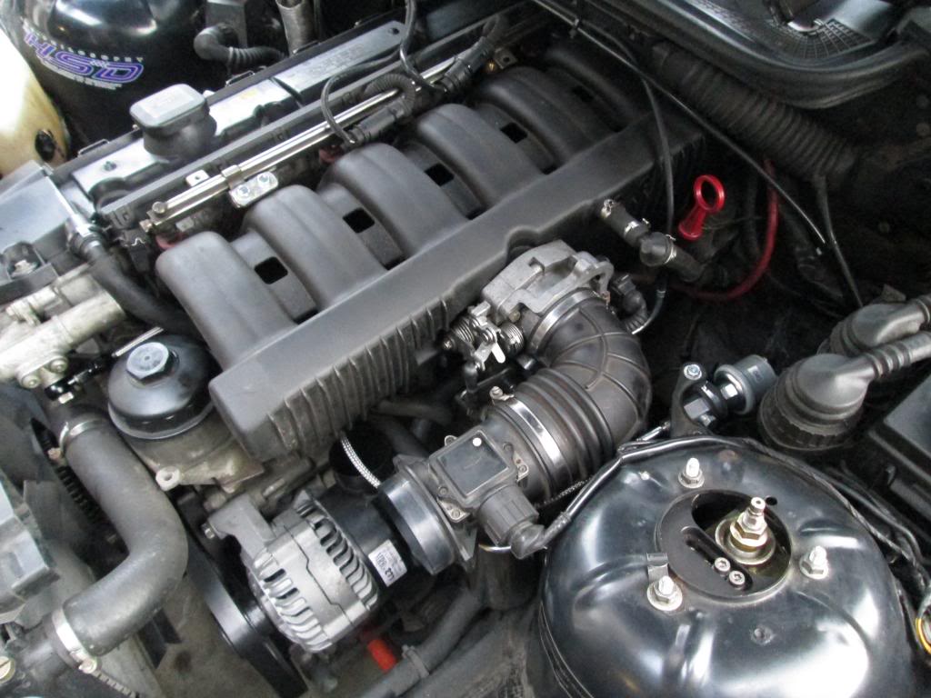

Much cheaper to buy in the first place, engines are ten to a penny and M50 Manifold + Generic remap makes 235hp+. For a clean 3.0 you're easily talking double the price of a clean 328i (going from what we've paid), 3.2 even more. Its ideal all the bits are interchangeable, and the common M3 bits cheap to pick up (brakes, diffs etc) if you know where to look.
Re: E36 v2
Do you not need more than just an M50 inlet and remap to get to 230ish? I was under the impression you needed US M3 cams, exhaust and an enclosed filter to make those sort of figures?
Is there any torque loss with the manifold swap? From what I've read you lose a little bit of low down power and since I use mine for a daily I don't really want that.
Re: E36 v2
You should break 230hp with a map and inlet (AC and viscous fan delete). We'l see in the next week or two, going to RR it to get a baseline to compare it against my other that made 203hp completely stock.
US M3 Cams and M3 exhaust take it further, but then the generic map really does not cover it IMO, you cant get everything into one generic flash map. With a proper map people are hitting 250hp+ with those mods @ higher RPM. Decent filter can help, but many have proven to make the same power on a debaffled stock airbox etc. I doubt I will ever bother looking into the US cams or exhaust manifolds, its comparable to my Mk1 Clio as it is to be honest. The US Spec cams are hard enough to find, and the manifolds hold strong money (as well as needing the complete exhaust to match the bore to the back). Soon adds up!
The lack of torque is not as noticeable as people make out, especially on the road. In the video from Blyton, on the back straight coming out of the chicane it was most predominant... it sort of bogs down then all of a sudden picks up really quickly. The generic map rectifies this, and raises the limiter, as frankly 6500rpm is pants.

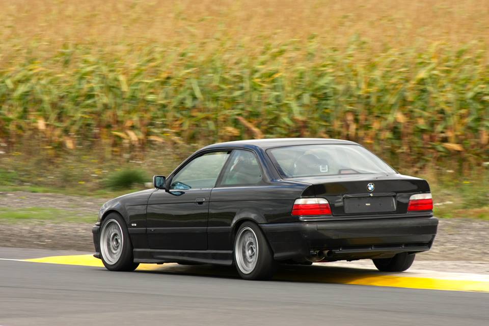

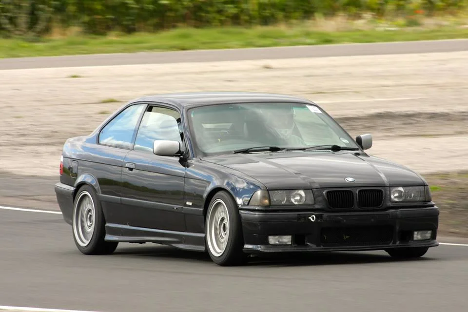

Couple of pictures from Blyton..
Need to sort the wing mirror colour out soon.

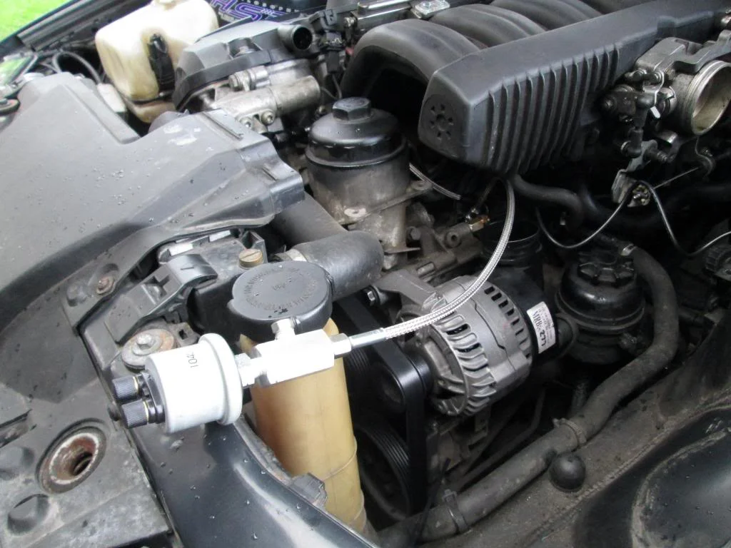

So after Blyton the car seemed to be tapping quite a bit, as if the oil was too thin after getting it really hot. It was on 5w30. The grade varies for these engines depending on climates, age, mileage, the usual. Many people run 5w40 or 10w40 all year round. After some reading, and literally every post suggesting different things, I decided to go with crude like 15w40 - more so because Whiteley has a supply of it!

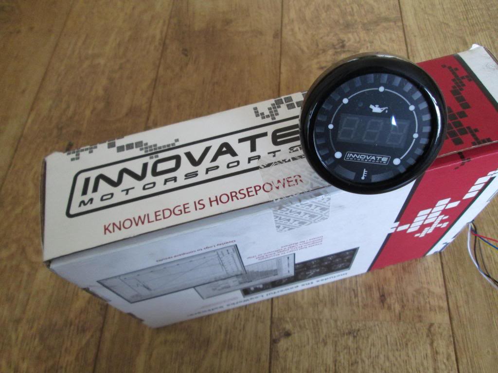

I wanted to be able to see what pressure/temperatures the oil was getting to on track because of this too, well worth knowing, especially on the higher milage engines. Made a purchase:
Brilliant bit of kit, with their software it gives programmable temperature ranges, pressure display and warnings. I wanted it all on one gauge and this is the one that stood out in quality.

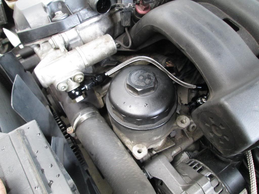

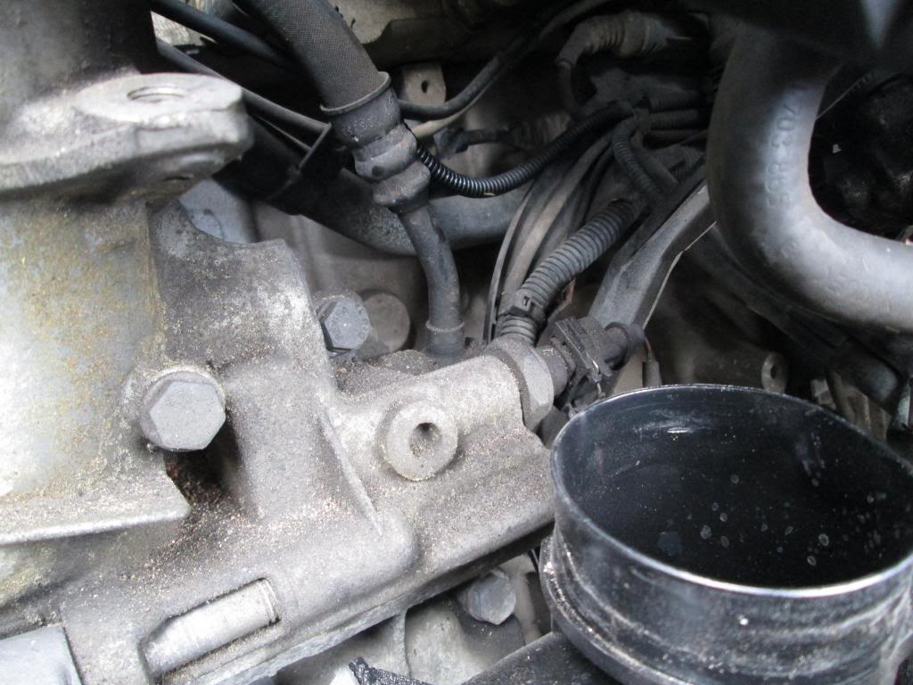

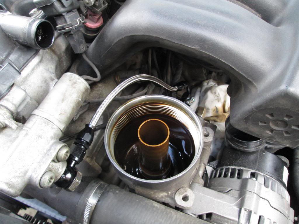

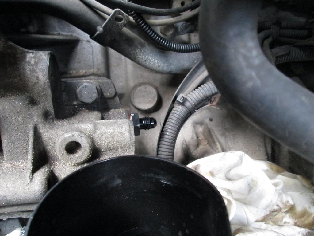

Next was to decide how I was going to go about fitting the two senders to the engine. The M52 has an Oil Pressure Sensor on the back of the oil filter housing, which is M12x1.5. It also has a Vanos feed line, which is M14x1.5 on a banjo bolt. I considered running the temperature sender in the sump plug, but didn't want to be f*cking round with wires every time I wanted to change the oil.
I decided to run the temperature sender from the original M12x1.5 Oil Pressure Switch location, with it always having a good flow of oil past it at full pressure. I got an M12x1.5 > 1/8 NPT fitting and put that in.

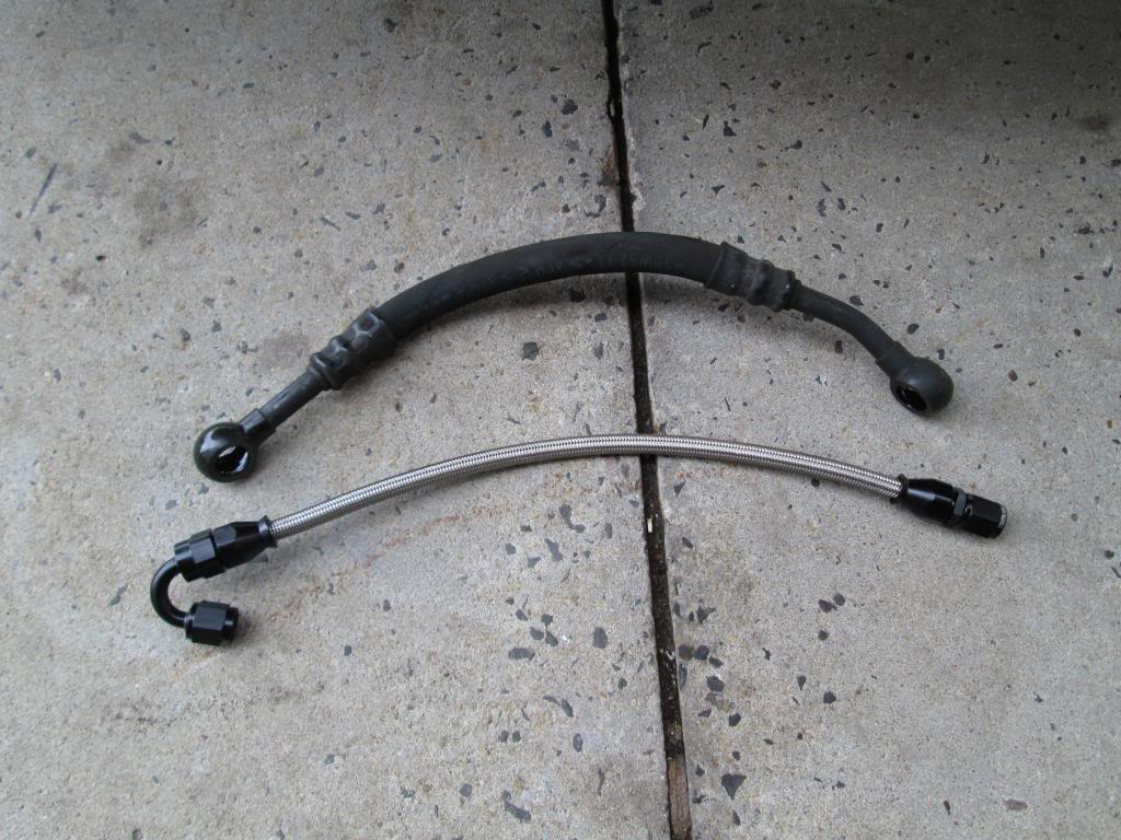

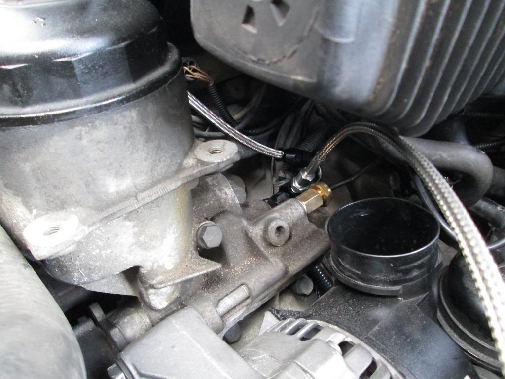

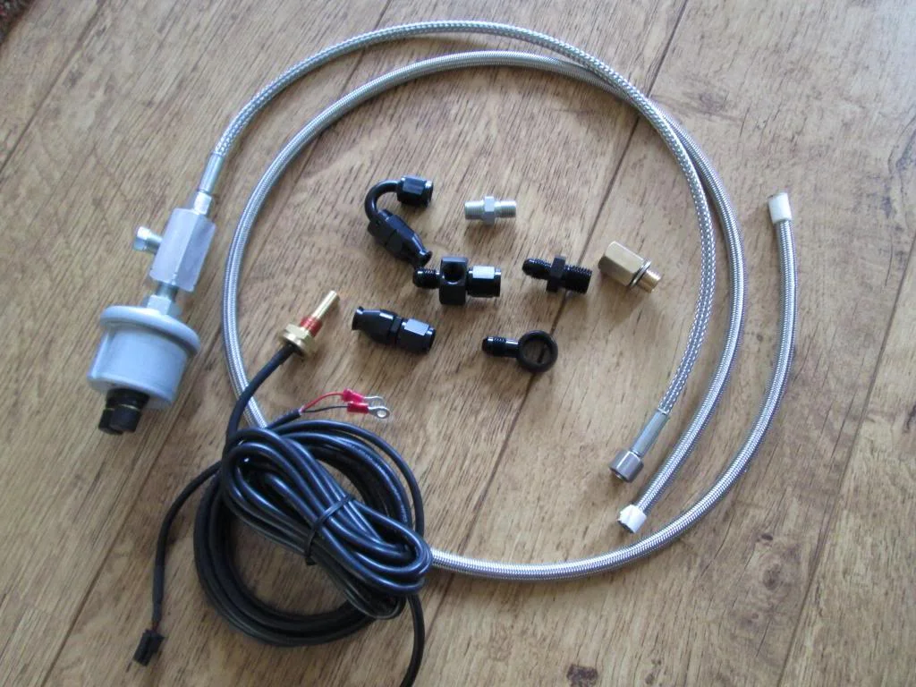

The only other location to use for the gauge pressure sender was the Vanos line port - so I went about making my own Vanos oil line to replace the BMW one. I didn't want to mount the pressure sender directly off the engine due to vibration etc, so the pressure sender needed to be on a remote line too.

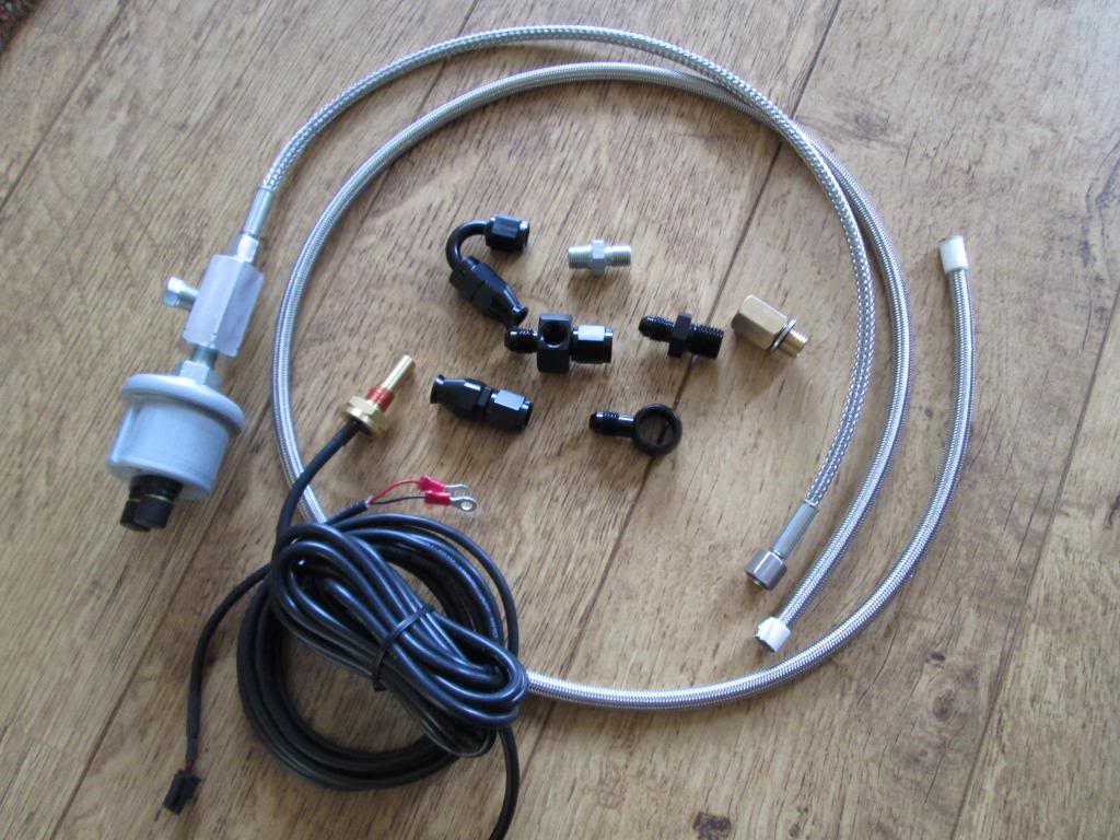

Purchased some AN fittings, stainless braided Teflon hose, and some adaptors.

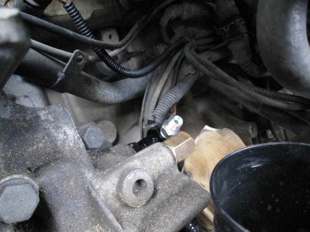

What I ended up using was: M14x1.5 > -AN4 ----> -AN4 Take Off Adaptor (1/8 NPT) ----> -AN4 120Degree Fitting ----> Stainless Hose ----> -AN4 M14 Banjo
Original Pressure Sensor/Vanos Feed
M14x1.5 > -AN4 Adaptor
M12x1.5 > 1/8 NPT Adaptor for Temperature Sender
AN4 Line Assembled
Fitted with new crush washers on the banjo..
Mounted the pressure sender at the back of the engine bay on an unused bracket..
Ran the wires through the grommet that the alarm wiring uses, plenty of room there. Up the back of the dash to the gauge and wired it up. I have a 52mm gauge pod cut up and mounted in the middle of the clocks. Replaced the filter and filled it up with the 15w40. Ran it for a couple of minutes to check for leaks, and had none, all good!
Thankfully the engine is healthy, returning 60psi cold idle. Ran it up to operating temperature and it got 20-23psi warm idle. It makes full pressure (60psi) by 3,000rpm, which is great. Good enough for me!
I will upload some pictures of the gauge in the daylight at some point, along with a couple of other things that have been done. More soon :)

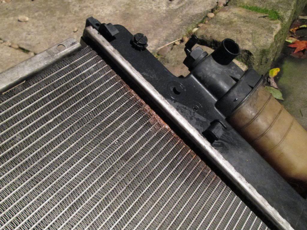

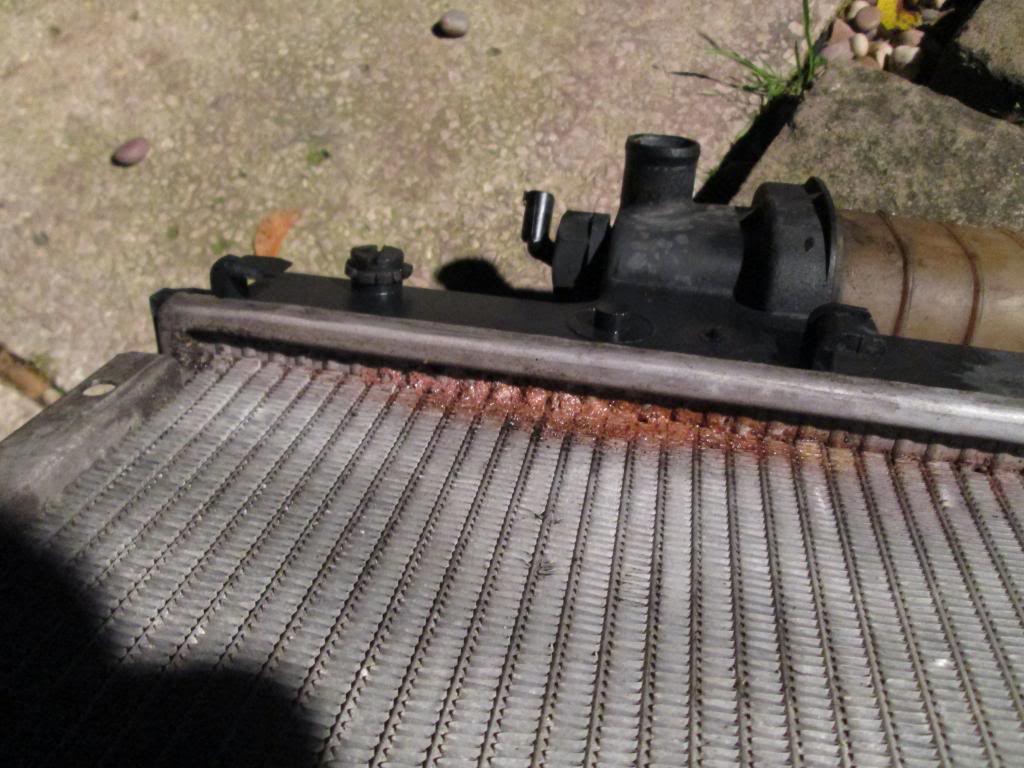

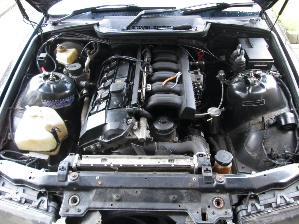

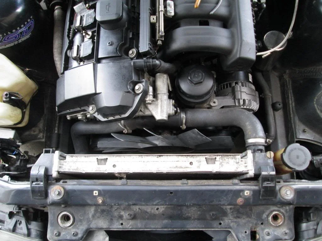

The car had recently had a radiator when I bought it, yet it had already started leaking. Turns out it was a cheap pattern part, over the last couple of weeks the split has been getting worse..
I decided to just buy a proper alloy one to replace it with, rather than f*ck around with second hand efforts or cheap copies. Buy cheap, buy twice, right?

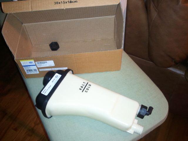

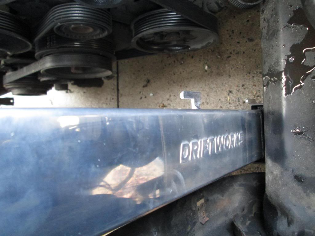

Replacement alloy M3 radiator, which has a much thicker core (42mm), and is wider than the non-M3 radiator. The reason its wider is they do not have a header tank built onto the side of the radiator, there is a separate header tank on the M3s. Bought one of eBay cheap..
Luckily the US E36s all ran this setup, and its easy to adapt a Euro model to run the external header tank by moving one pipe which went to the radiator, onto the tank. Just means you need a mount for the tank, which is easy enough to fabricate. The last piece in the puzzle was an M3 top radiator hose, quite a bit longer than the non-M3 one.

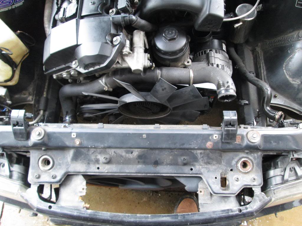

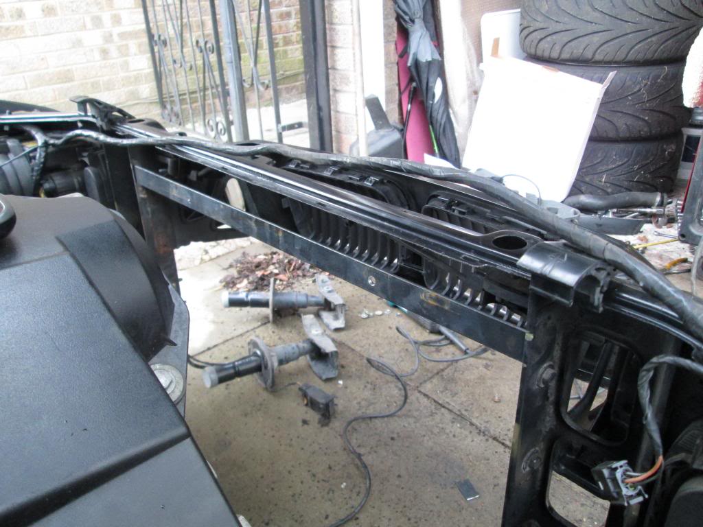

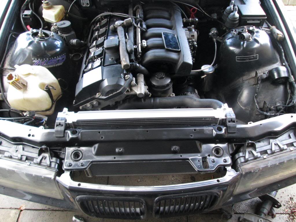

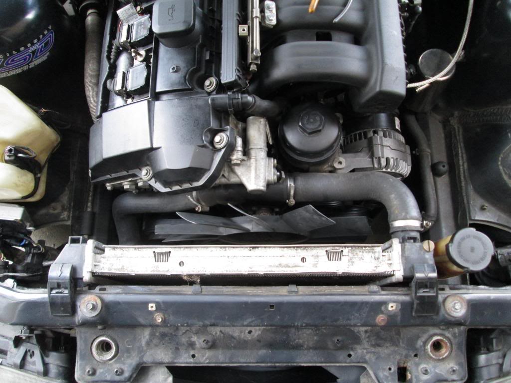

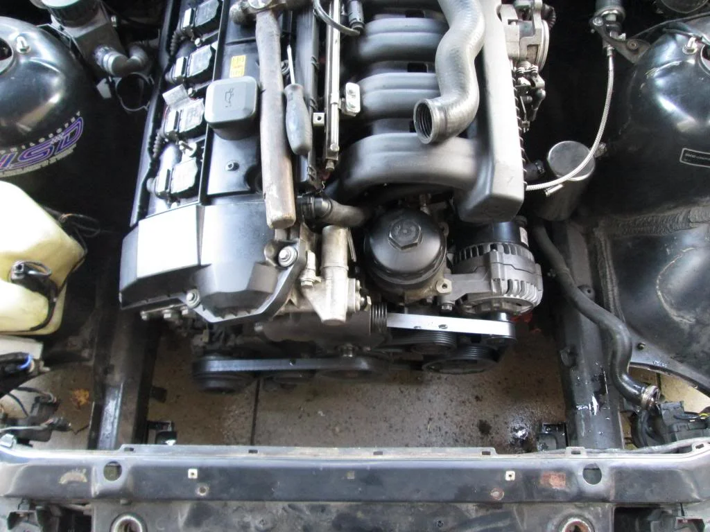

Started with removing the bumper, plastic bits, old radiator, viscous fan, and complete AC condenser setup (never worked anyway)..

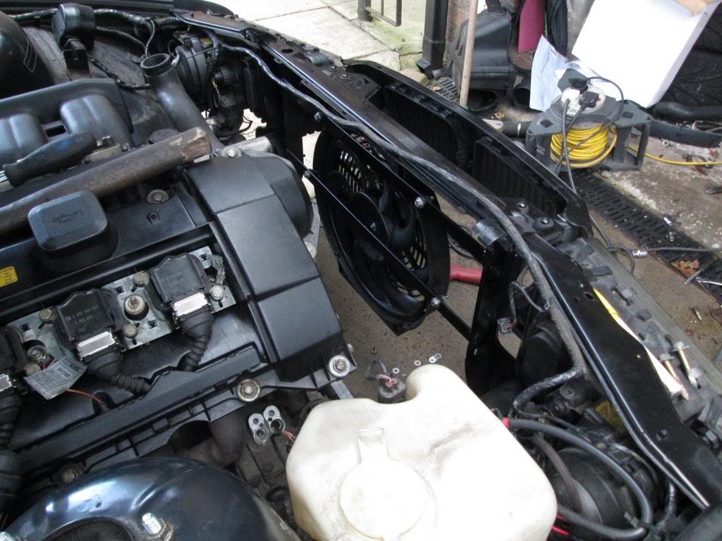

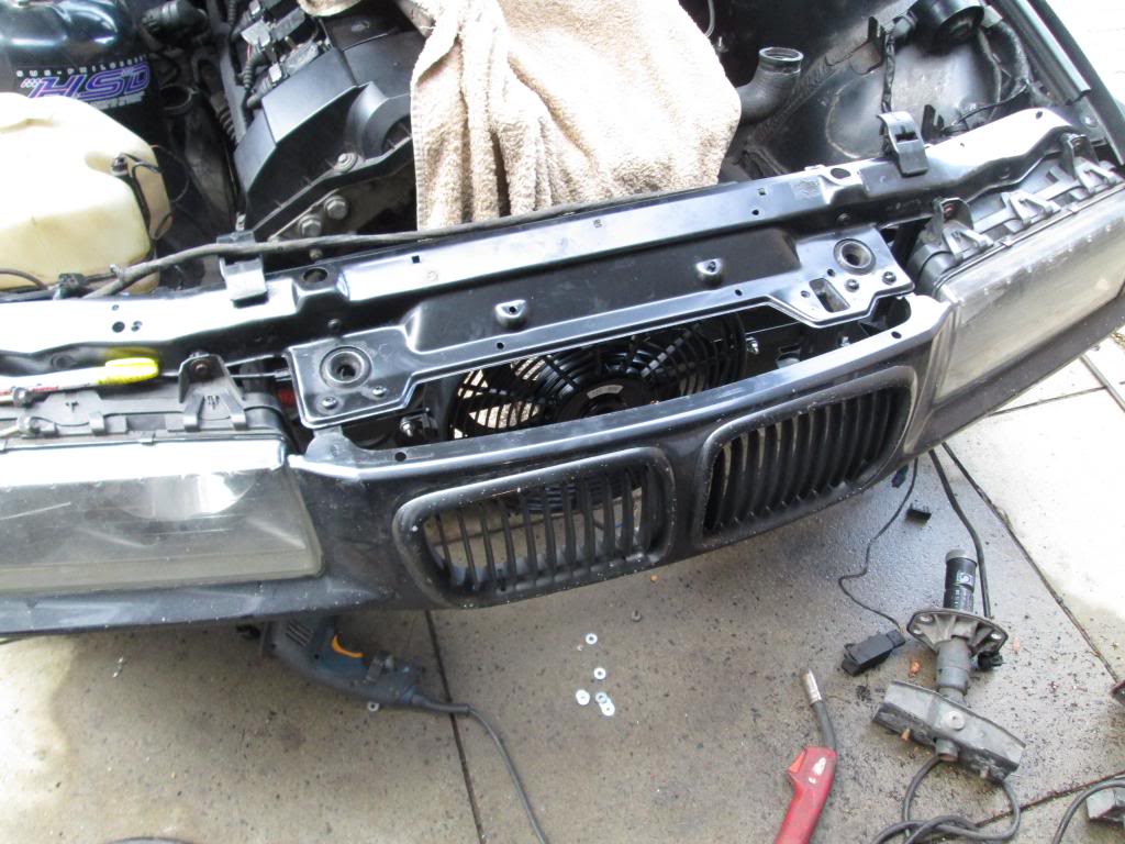

There is usually an electric fan on the front of the air con condenser, which is triggered by a temperature sensor to switch on if needed, but like most E36s mine was siezed solid. They weigh a fair amount too. Removed it at the same time. Tidied up the slam panel somewhat before offering up the new radiator. Fills the entire width of the chassis rails whilst still retaining the standard mounts..

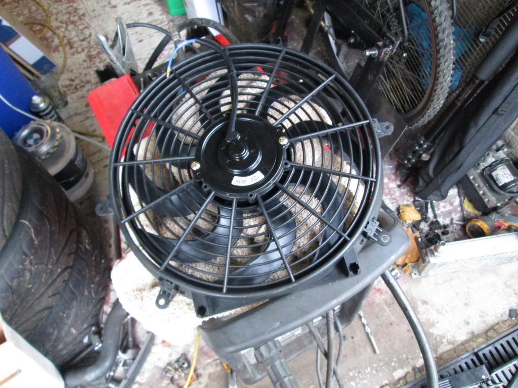

As I didn't want to run the viscous fan anymore, or the siezed electric E36 one, I picked up a cheap slimline 14" electric one like I've used before. Only issue was I didn't want to go poking holes through a brand new alloy radiator, so I quickly made up some mounts.
There is plenty of room in front of the radiator on an E36, so I made use of the parts of the slam panel that are already there. I wanted it as high as possible so its out of the way. Used some 25mm(x)3mm flat bar for the horizontal bars, then painted it all black before mounting the fan.
Popped the header tank at the back of the engine bay, piped it up and refitted the radiator. Ran the engine up to temperature and bled the system, all good. Dark nights now so ran out of time to wire the fan up, will have to do it some other time. More bits to go on in conjunction with this, so will update as and when!
