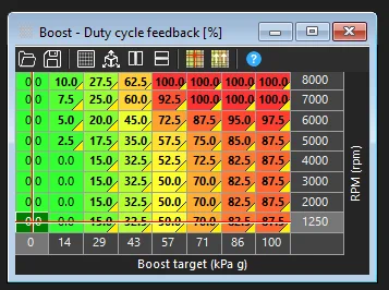

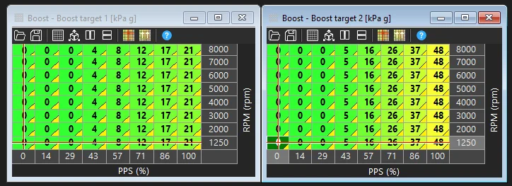

I wonder if the wastegate setup is helping with stability. Most of my setups i've been involved with are internally gated and running 20-30psi. Saying that the actuator will somewhat close the loop if your boost is near to wastegate pressure.
I've not thought about this much but I also wonder if the error is a percentage, so running pretty low boost you're getting a 10% error ish of 0.5psi, so the higher boost setups will see a more worrying error.
Pass - if it works it works. My personal experiences with closed loop boost have been very positive, performance has always been dependent upon the solenoid used more than anything but thats the same as with open loop.
Do you have a separate table for peak boost? I could see your target and actual in the vid and the actual was often >1psi above target without cut.
