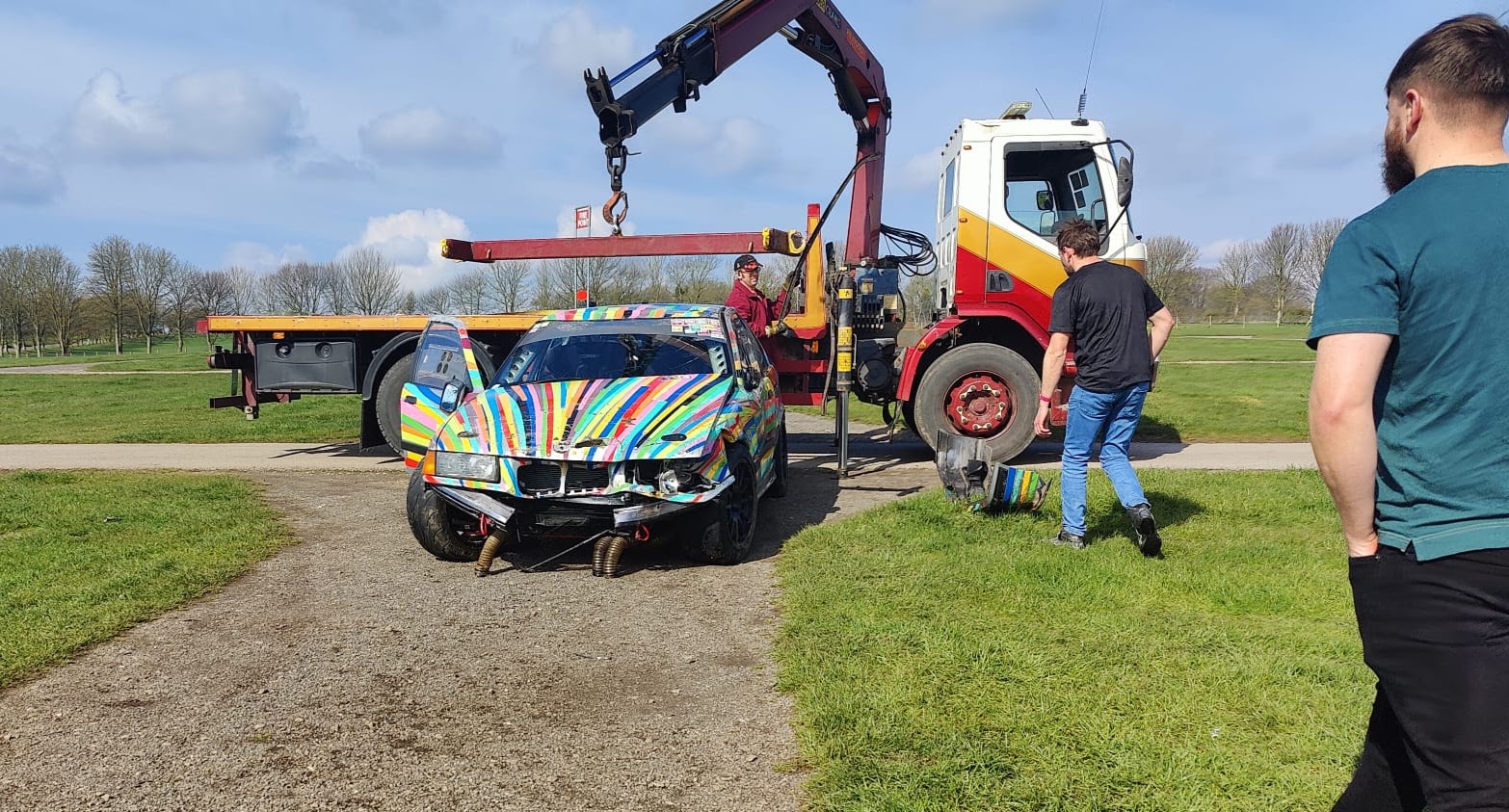

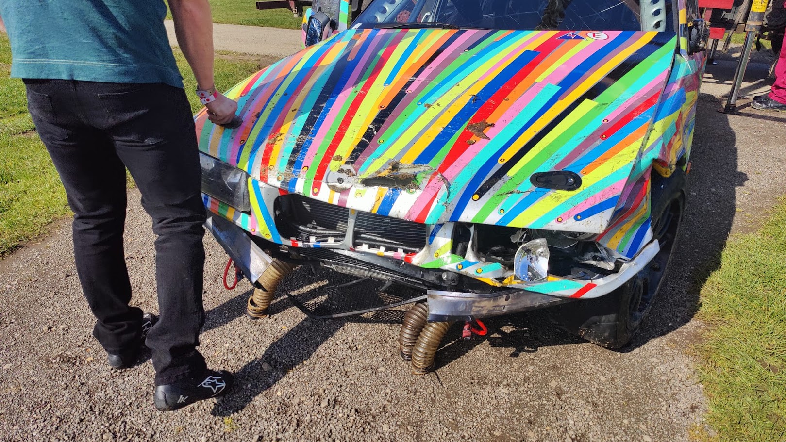

Late morning, I unusually locked the front left wheel at the top of Charlies, which took me on to the grass at 80mph+. There was no stopping the car then, so I knew a big impact was coming with the wall. However, what I wasn't expecting is the car to roll over...
I got out easily, and the engine was stalled before impact with the wall. The cage did its job and saved the structure of the shell, just the roof skin and upper windscreen frame that took the most damage.

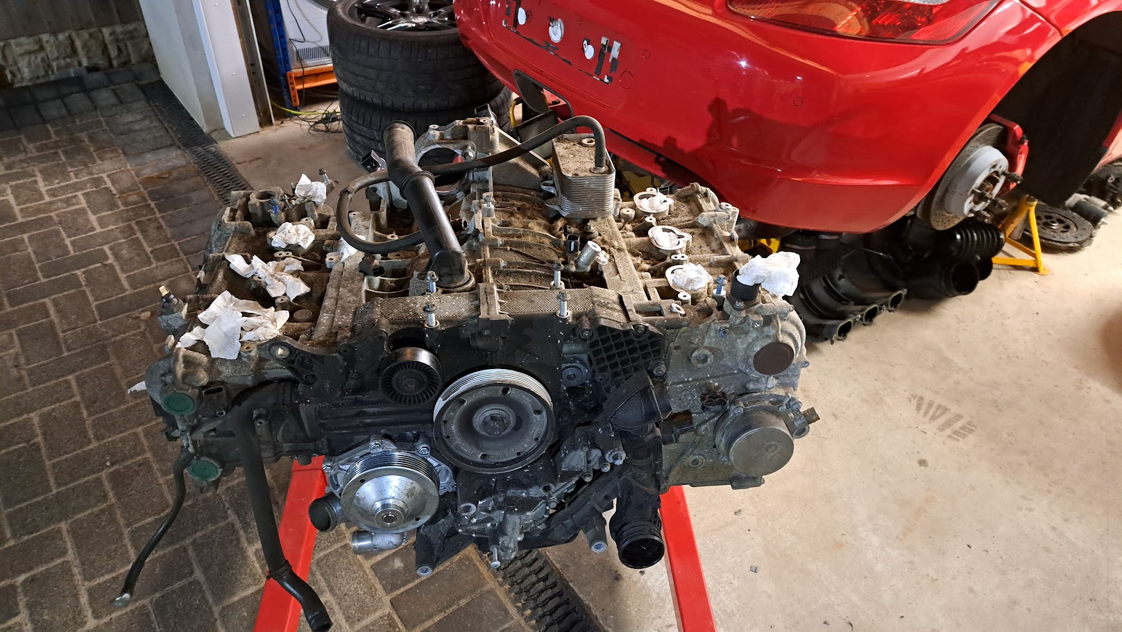

When I got it back, I got it in the garage and stripped the front end down. It then sat for a good few months. With the roof frame still being in its original position, thanks to the cage, it just needs a new windscreen panel and skin. However, I spent a while debating what to do...
Towards the back end of the summer 2023 I had decided it was time to move on from the E36 platform, Ultimately the deciding factor was the value and demand of E36 M3 parts, and the running gear alone from the E36 would easily fund the purchase of what I had in mind to build next.
I stripped the shell of all parts, keeping everything I could move to a new project. I removed the windscreen, and drilled out the spot welds on the roof skin which is ready to come off. I'm replacing the windscreen panel, then see if anyone is interested in the shell. Most of the running gear went quite quickly, however I'm still sat on the engine, ITBs and various other high value parts which in time will fund the next build.

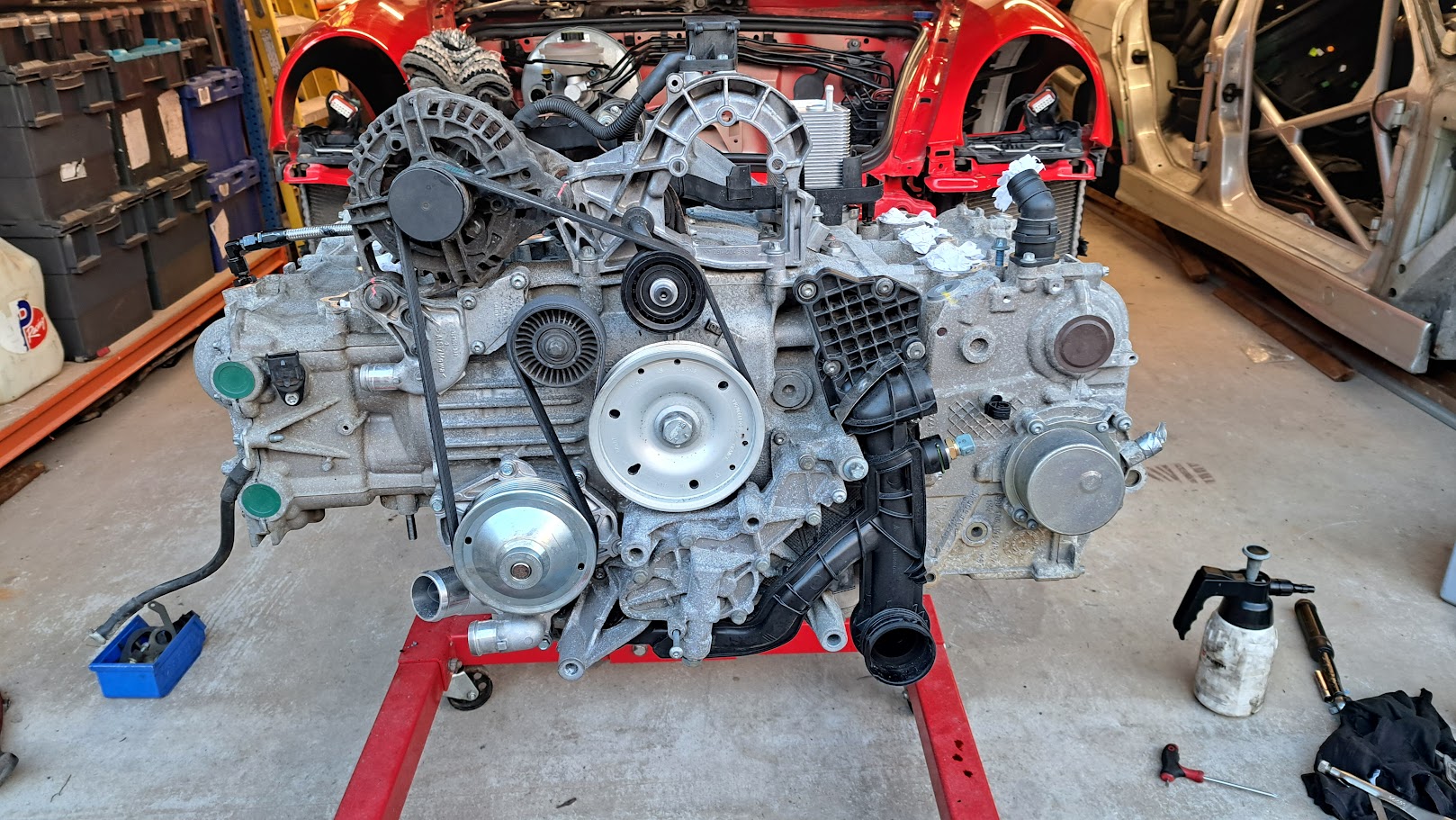

Jobs whilst its out are flywheel, LSD, 997 oil heat exchanger, secondary air pump delete, slight changes to the fuel setup, slight change to throttle body positioning and addition of various sensors. This is why I'm running it on standalone from the off though - no chance you can do that sort of stuff on the standard Bosch management!

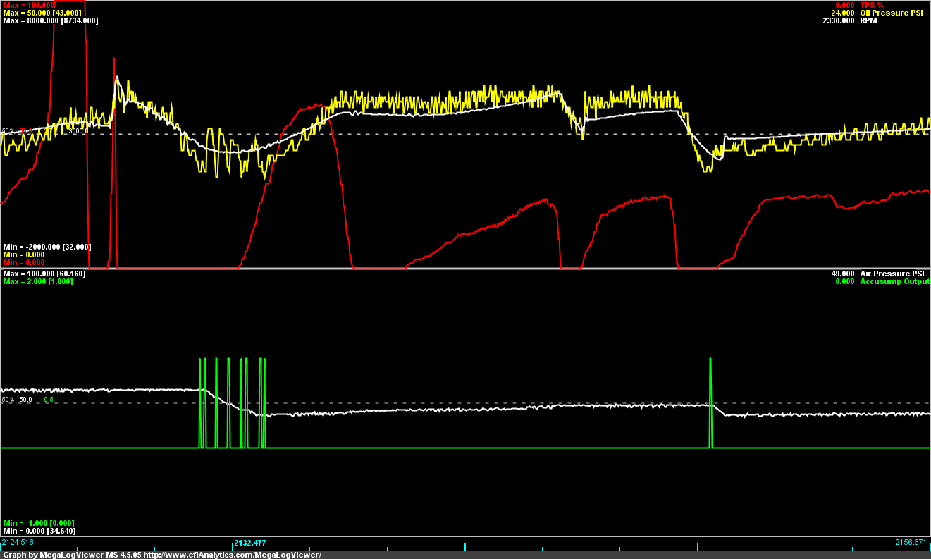

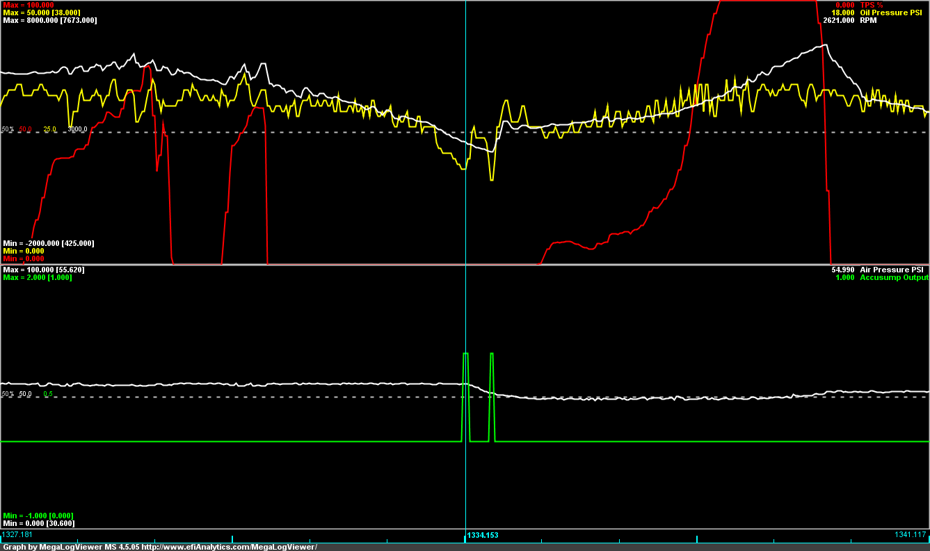

Yeah, it is quick, more so when ECU controlled, however if we're talking about versus a crank spinning at 7k RPM, its incredibly slow 😂
So the normal way to run it is the 12v+ electronic valve on the end of the accusump canister. This is obviously charged on the air side to the equivelant of your peak (usually cold) oil pressure. You have that stored energy then to release down the pipe into the engine when required. You either have a pressure switch on the engine somewhere, linked to said valve, or your ECU controls it based on its oil pressure reading (psi/bar) - which is closed loop.
The former, is a fixed pressure switch, so you'll only ever get activation if the pressure drops below X.
The latter, is however complex you want to make it, as you can throw RPM, TPS and even temperature into the mix, run the calculation on the ECU side and trigger it when your conditions are met. This is what we did on the F4R. There is a sweet spot for the activation point, which is why we chose the latter, as it depends when you are seeing pressure drop, and it can vary by circuit and driving style.
The other variable in either solution is where you have the accusump, and how long the line is to your feed into the engine. This line has no oil, or very little oil in it if you lose oil pressure, so your released "charge" from the accusump rapidly drops pressure the further it has to travel before it even reaches the engine.

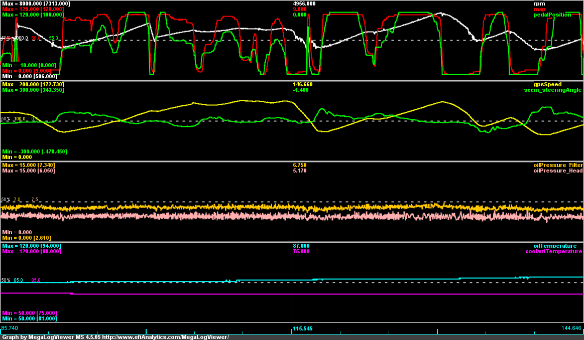

Here are a few logs from the Clio, you can work out where our setpoint was based on pressure, also when the air pressure side of the accusump drops and oil pressure rises. The green trace is when the ECU activated the valve on the accusump. It worked well, but still just a plaster for the F4R which has terrible oil pressure full stop.
The ultimate fix for the below engine was to delete the VVT and blank it off. It has great oil pressure since, with the sacrafice of poor low down drivability (but its a track only car and on CatCam 421).
However still like I mentioned, the M97 pressure sensor take offs are on each head, rather than in the main gallery of the block, or anywhere near the output of the oil pump (which would be more ideal). The quick fix for this is to run a higher setpoint, so it always activates sooner than it needs to, at the expense of using it more often.

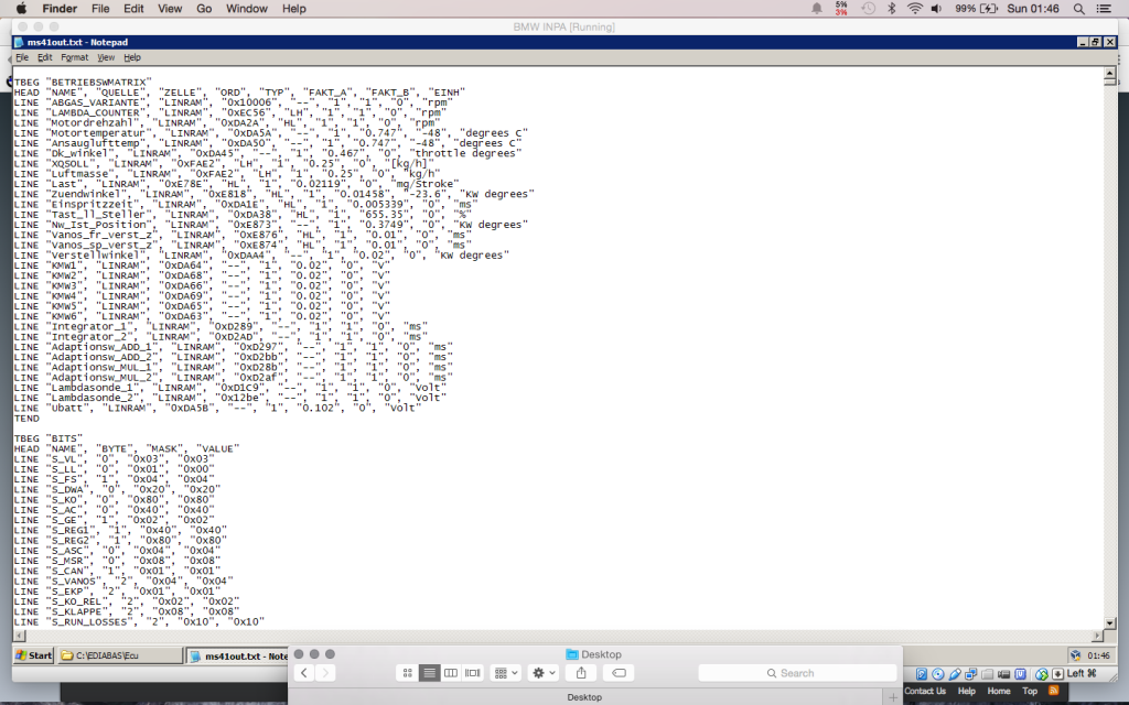

More searching found a Polish developer that had created a small utility to try and reverse engineer parts of the file to get some readable data from them, which sort of worked (he had made it for the E39, not E36). Everything was in German as expected, some parts abbreviated and it was no real help bar one thing - there was a section that gave multiplication factors for each sensor, two columns of them (FAKT_A and FAKT_B). This is how you would get from a whole number to a correct decimal value for a sensor. Although, the problem was there was nothing in this file which described which 'byte' of the ECUs message was for which specific sensor, so there was a lot of trial and error to come...
Hi,
Nice work. do you still have the software to decompile the INPA ECU file to have multiplication factor and other parameters? (name ? link?)
I have some works to do on another and ECU and I have to find them by hand.
Thanks.
Diolum.

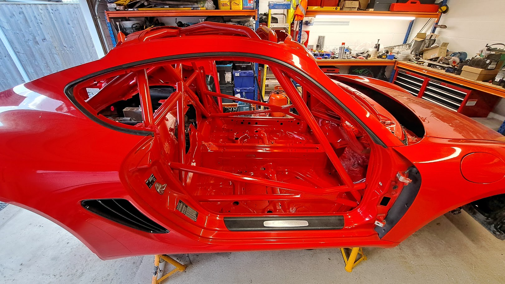

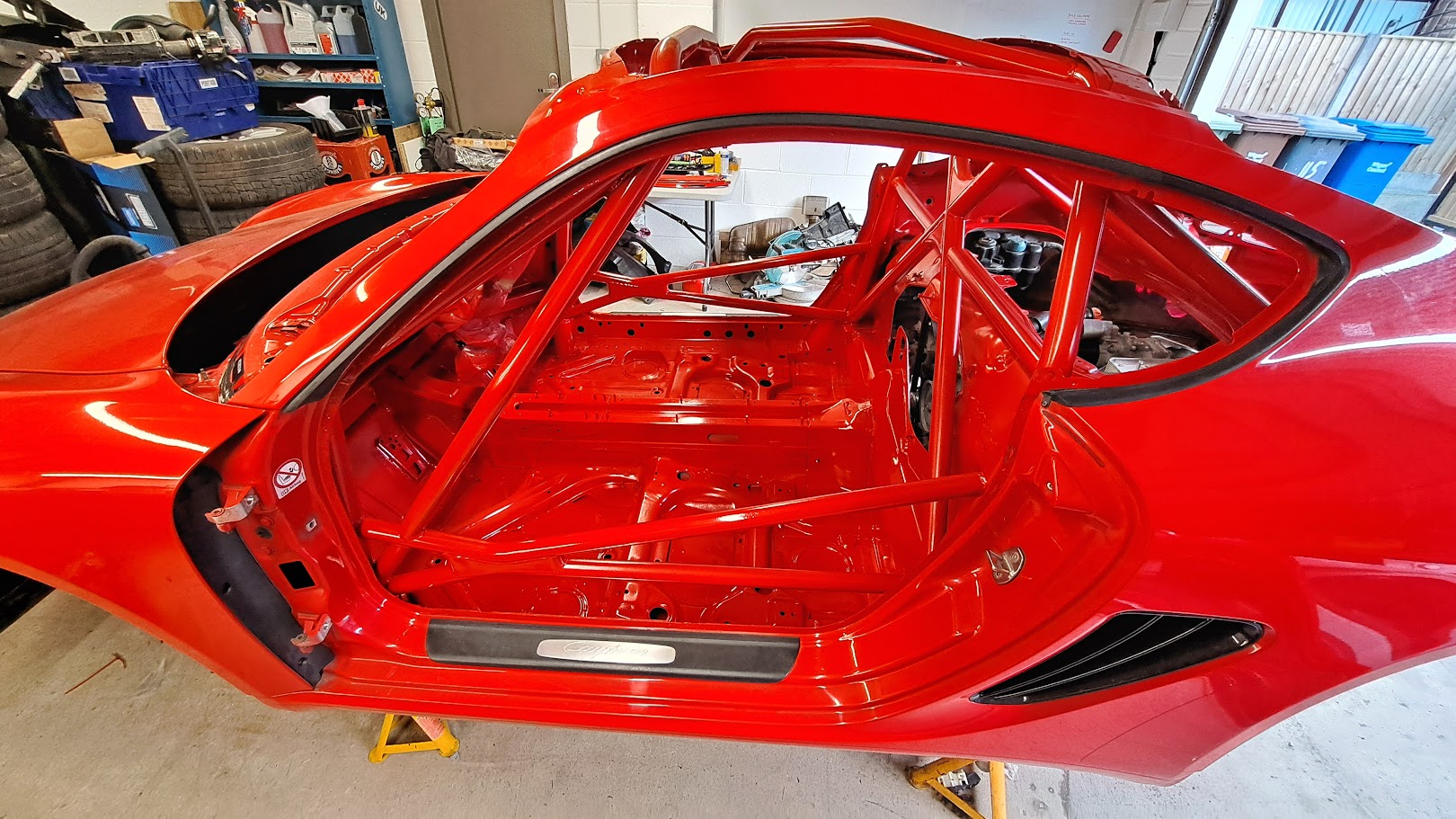

How’s the Cayman coming along @f0xy ?

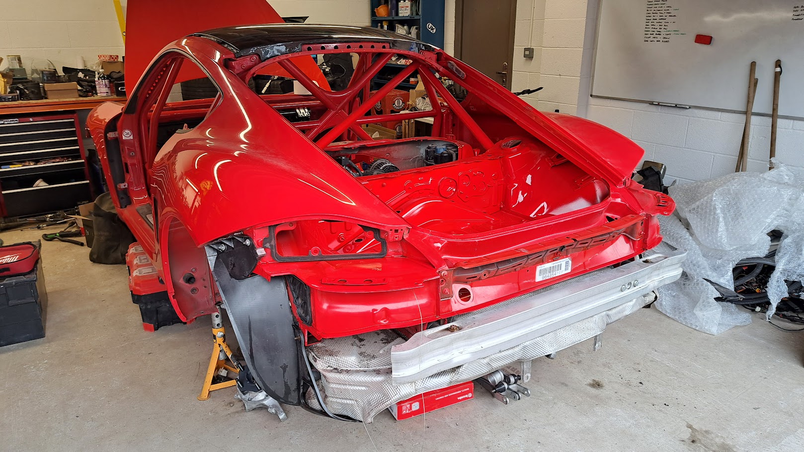

Where to start 😂 So many issues, terrible parts suppliers and various other things along the way. However I'll just throw a few pictures in here, its been to a shell and back together. It's going to be mapped in a couple of weeks then out at the end of the month. I'll put a thread together at some point, maybe not on here but we'll see.

Oof some very nice bits and that cage looks gooood! 🤤
If you don’t want to create a thread on here (I’m sure we all would appreciate one though 👍) , have you got it documented elsewhere?
Yeah there is a lot more than posted for one reason or another. Some stuff transferred from E36 (fuel system, etc). Not documented yet, however I have more photographs than I know what to do with so I'll write it up at some point. Whichever way I'll post it in here. Just been a mad dash to get it done really as I've been delayed so many times!

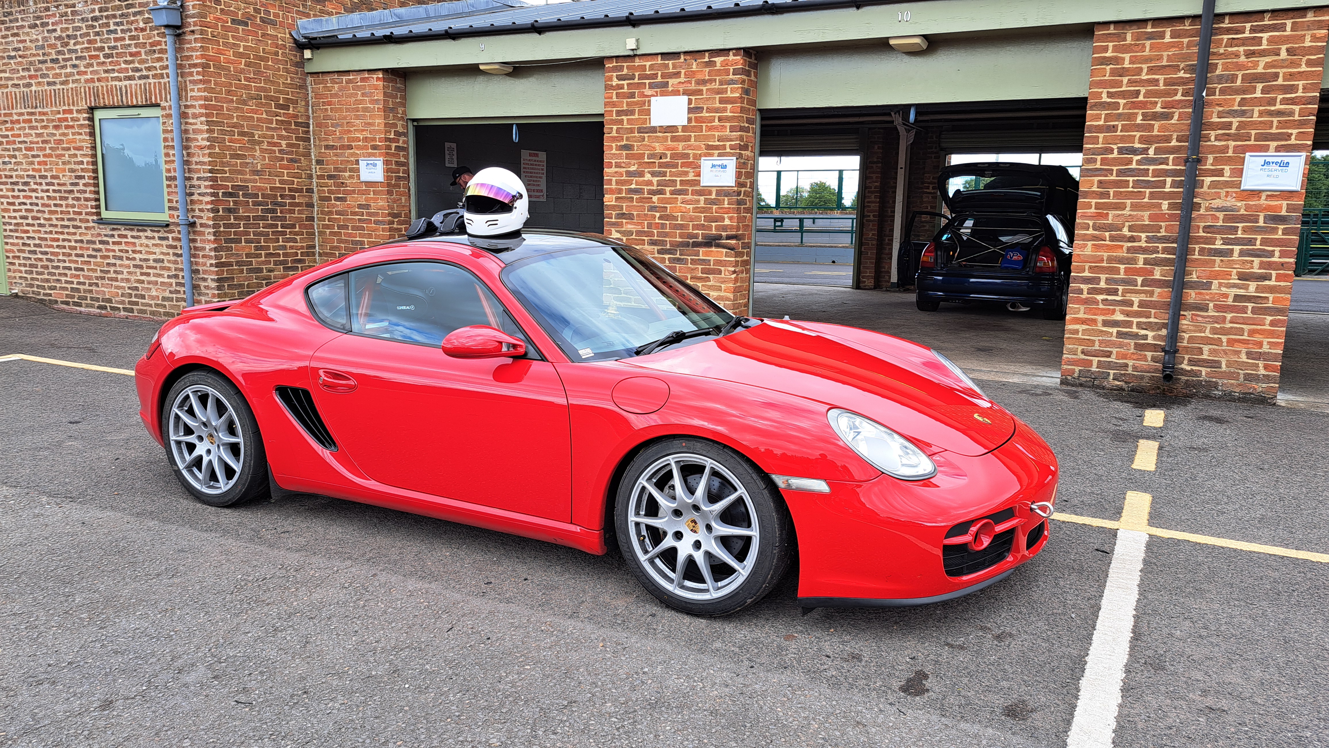

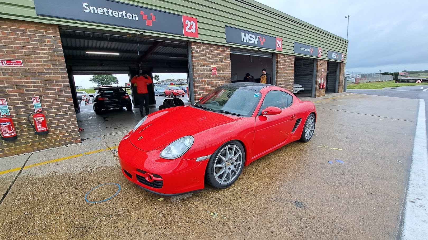

Made it to Snetterton at the end of May after many a late night...
Then spent the last month working out various niggles (mainly the stock ABS), and sorting things I didn't have time to finish before then. Croft in a few weeks, so we'll see how that goes 🏁

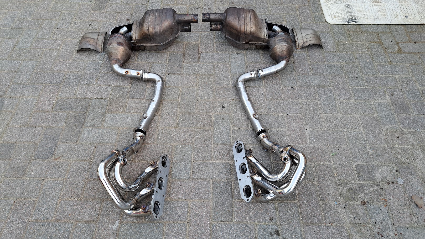

Under £200 delivered for the pair. Generic eBay stainless headers (Gravity/Toyosport/etc) which I then modified with vband, EGT.
Decent thickness on the head flange, and decent thickness wall tube. The lambda port locations are as good as useless, so i have my widebands after the vband.

Yeah, i ditched the OEM headers with cats in for more money than i paid for these. They are from a 986, not 987 - meaning i can use the 986 route to the back, rather than the 987 which goes through the wheel arch, very close to the shock, which I didn't fancy with the Nitrons

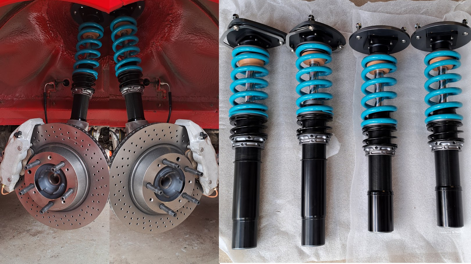

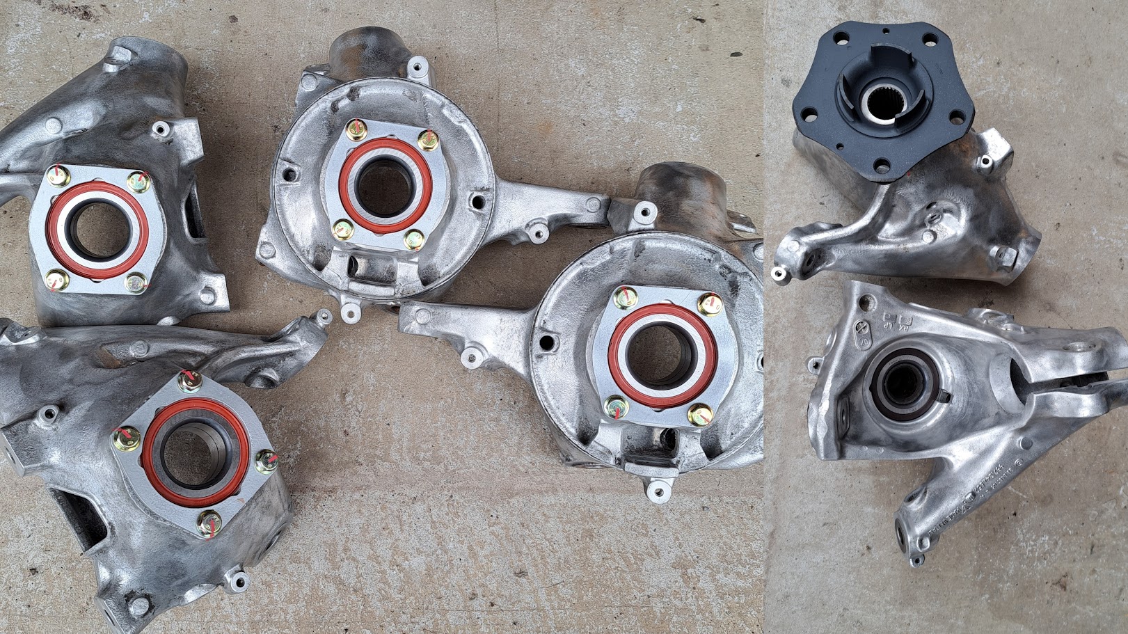

Going quicker on a dry track with AR-1 highlighted a weak point in the rear wishbone/camber bolt retaining plate (either from previous damage, age or the actual design). Managed to work around it and keep going until the end of the day.
As expected there were a handful of other minor issues which have already been resolved. The engine itself, temperatures and oil pressure = all spot on. I'll get round to a thread at some point, when I dont need to spend time making changes 👌

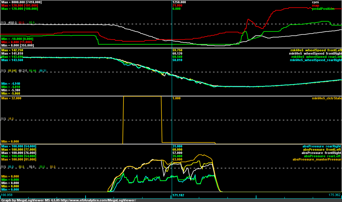

I would bloody love to know what you have done to the engine to make it track ready. I’m currently looking at either selling my 987.1 and buying a 981 or an Evora, but would dearly love to make my 987 a more track oriented car as I bloody love the chassis
Is the E9X an evolution of the MK60? So can be run stand alone?
Yeah, its the MK60E5, used in most E9x 6cyl chassis. M3 units have different software, but non M3 units can be flashed with it no problem. The 4cyl models had MK60E1.
The first benefit of the E5 is it has 5 internal pressure sensors, and can regulate the output to each caliper in real time (EBV / Braking Power Distribution). The original MK60 does not use this functionality, it can cut pressure based on wheel speeds but not regulate as its own function like the newer units do.
All three (MK60, E1, E5) can be run standalone, but the E5 requires magnetic active sensors versus your traditional VR sensors on an MK60. This was easy (ish) for me as the Porsche have magnetic sensors/bearings in the first place, however you have to use E9x sensors as they are specific to the E5 and send a lot more data than just wheel speed (direction of travel, etc). You also need an E9x yaw sensor installed in the correct orientation.
The second benefit of the E5 (especially on M3 software) it has an infinate amount more of coding options than the original MK60. From vehicle weight, center of gravity definition, tyre stiffness, scrub radius, pressure model for front and rear circuits (different calipers) and much more. Some of these things I've set in mine as a baseline.
Lastly, it constantly outputs a stream of CAN data with all the running data, much more than the original MK60, so if you have the ability to log it, you can see it working properly in real time.
Here you can see on initial pedal application the third trace goes to a status of 32, which is EBV (regulating pressure), then switches to a status of 1, which is ABS intervention when the actual wheel slip falls outside the tolerance.

For a basic start with the engine, I have:
- Millers 5w50
- 997 GT3 OIl Cooler
- Center/3rd Radiator
- Low Temperature Thermostat
- Mahle filter (spin on) with non-return valve (the original paper filter/housing does not have this).
- 997 Oil Return Pipes
- 2qt Deep Sump/Baffle (Takes around 10.5L now)
- Oil pressure sensor at the filter, and the head (furthest point).
- Oil temperature sensor at the filter, and in the sump (as per OEM).
- Stock new AOS, however proper pipework not the standard plastic crap.
- Non standard intake distributor (I use a 996/997), different link to the AOS.
At the moment I see no oil pressure issues, generally an average of 6.0-6.5 bar at the filter, 4.5-5.0 bar at the head. Temperatures remain stable around 75C coolant, 90-95C oil.
Other things I did as preventitive measures/things to consider:
- Removed the stock power steering, I use TRW pump up front. Not pumping fluid back and forth to the back.
- Swirl Pot - Under heavy braking at Croft I was getting fuel reserve light flicker on at half a tank. This dosent nessecarily mean I'd have a fuel pressure issue, but I fitted the parts from my E36 so I can forget about it long term.
- Lightweight flywheel (the DMF had done 85k)
- Got rid of the OEM Coilpacks
- Gripper LSD
Thank you very much! Original MK60's from the E46 M3 (the later ones which flash, as apparently early ones dont?!?) are getting very expensive now. I recently bought a VX220 which has 2 channel ABS!! So it operates both front wheels or both back wheels at once. The big issue is hitting 'ice mode' which cuts pressure to the rear brakes substantially. Its horrible to hit ABS on it.
Common upgrade is to a plug and play Lotus 4CH ABS unit however these are also now >£1000. So I have been thinking on an MK60 or some derivative.
Did you pay to have the E5 programmed or did you program it?
I do it all myself - but I am familiar with BMW programming, this is a bit more complex than usual as you don't have any OEM BMW modules (just the DSC unit) so there a few things you have to do in addition. However fault code reading can be done with any tool, even your cheap dongles, which is handy. You just need an OBD port wired to the DSC unit.
To put it in perspective, I've seen non-M3 E5 units go for as little as £60. The M3 units can vary, I paid about £180 which saved me the hassle of flashing the actual software (not difficult, just time consuming). Yaw sensor are the same on all E9x models and under £25. Bosch wheel speed sensors from an E9x can be had for under £25ea, new. I actually use 4x rear E9x sensors, as they're a better fit for my application (the fronts are shorter), but either work at any corner. The kicker is for any of that to work you need to have magnetic rings already, or have the ability to retrofit them and mount an E9x sensor near it. New connector housing from BMW is about £13.
