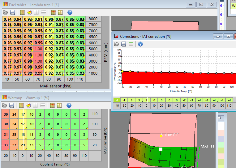

Is 70deg coolant considered hot enough for the OEM ECU not to be richening it up a touch?
I wouldn't ask but I recently learned some OEM Ford stuff has like 3% extra fuel in right up to 80deg.
Maybe in stock form - most low temp thermostats for the 996/997 platform are 75C. I think OEM is 83C. The middle of the (highly inaccurate) gauge is 80C. Stock setup also use MAF sensor, I use MAP.
However it's not relevant in my case. I simply target a specific lambda on each bank in closed loop via WBO. Only fuel correction I use is warmup phase and if IAT goes through the roof

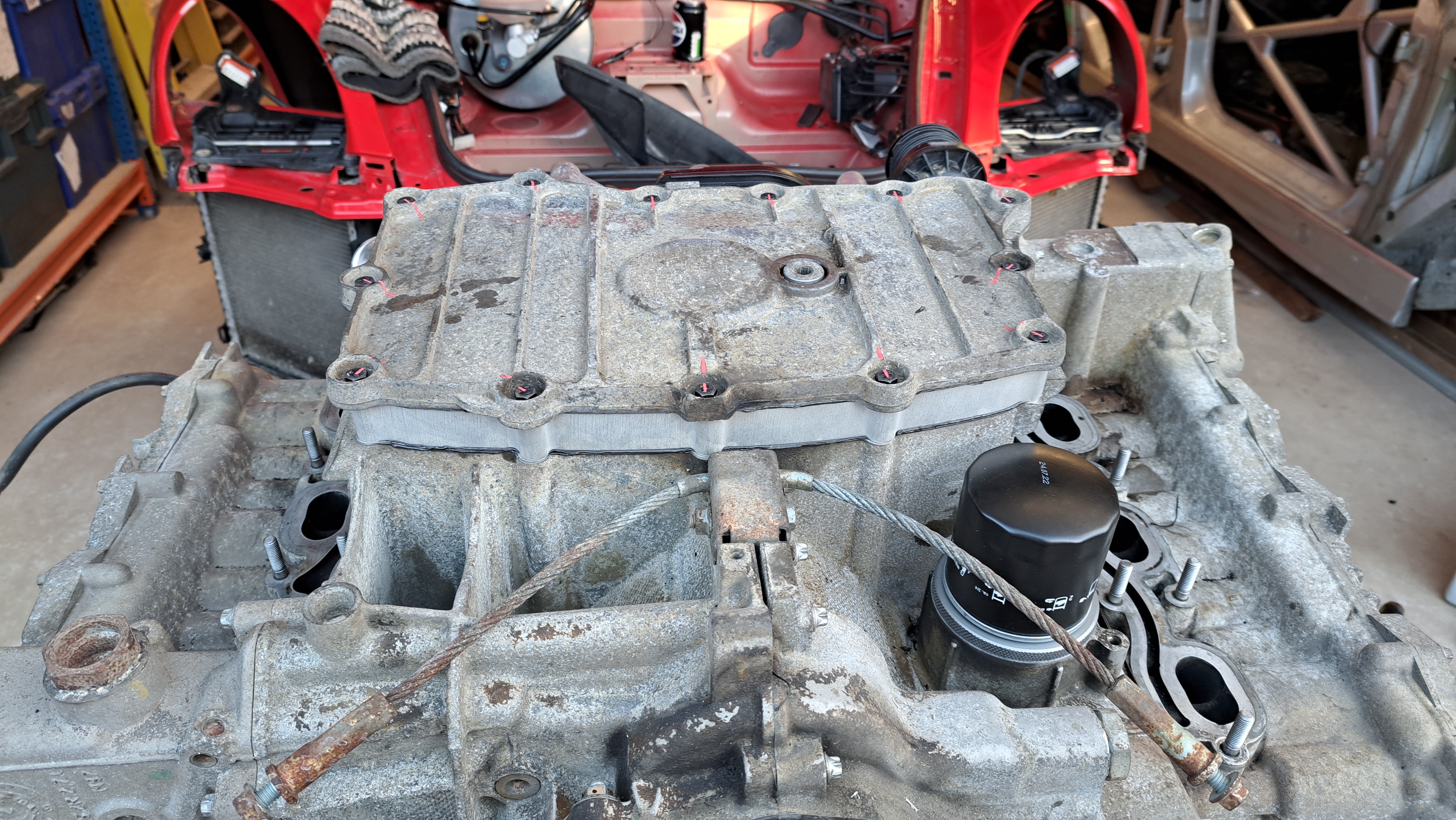

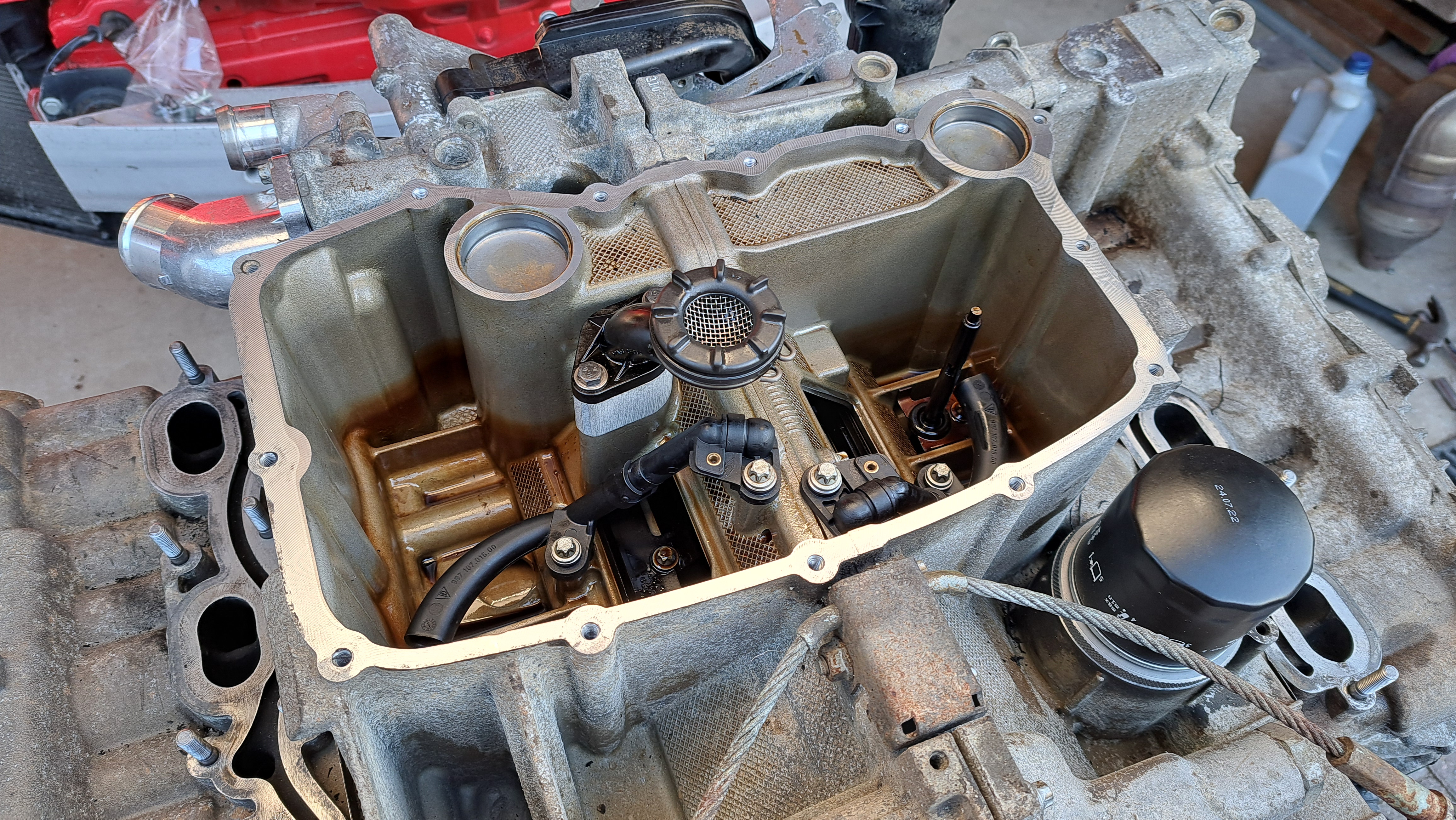

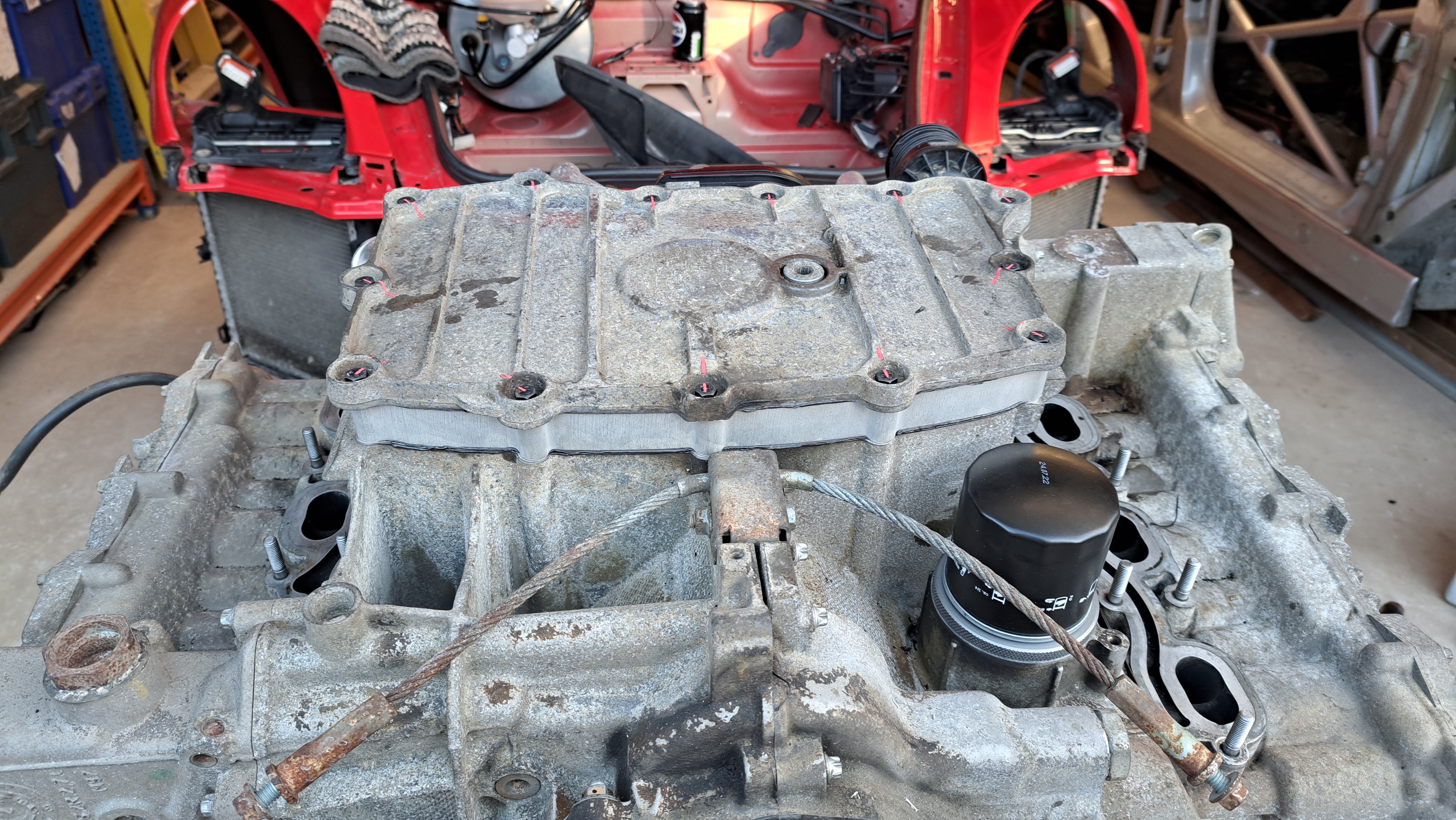

For a basic start with the engine, I have:
- Millers 5w50
- 997 GT3 OIl Cooler
- Center/3rd Radiator
- Low Temperature Thermostat
- Mahle filter (spin on) with non-return valve (the original paper filter/housing does not have this).
- 997 Oil Return Pipes
- 2qt Deep Sump/Baffle (Takes around 10.5L now)
- Oil pressure sensor at the filter, and the head (furthest point).
- Oil temperature sensor at the filter, and in the sump (as per OEM).
- Stock new AOS, however proper pipework not the standard plastic crap.
- Non standard intake distributor (I use a 996/997), different link to the AOS.
At the moment I see no oil pressure issues, generally an average of 6.0-6.5 bar at the filter, 4.5-5.0 bar at the head. Temperatures remain stable around 75C coolant, 90-95C oil.
Other things I did as preventitive measures/things to consider:
- Removed the stock power steering, I use TRW pump up front. Not pumping fluid back and forth to the back.
- Swirl Pot - Under heavy braking at Croft I was getting fuel reserve light flicker on at half a tank. This dosent nessecarily mean I'd have a fuel pressure issue, but I fitted the parts from my E36 so I can forget about it long term.
- Lightweight flywheel (the DMF had done 85k)
- Got rid of the OEM Coilpacks
- Gripper LSD
That’s super interesting, thank you! Can I ask what deeper sump you purchased? There are loads of different options and wildly differing price points? Presuming you’re running proper track rubber as well? It’s reassuring to read this thread so thank you for sharing
I used a ROHLER kit, decent enough quality - it's not a difficult job, fine to do in-situ but it was easier with the engine out and upside down. Note the stock windage/baffle has its own 'trap' doors..

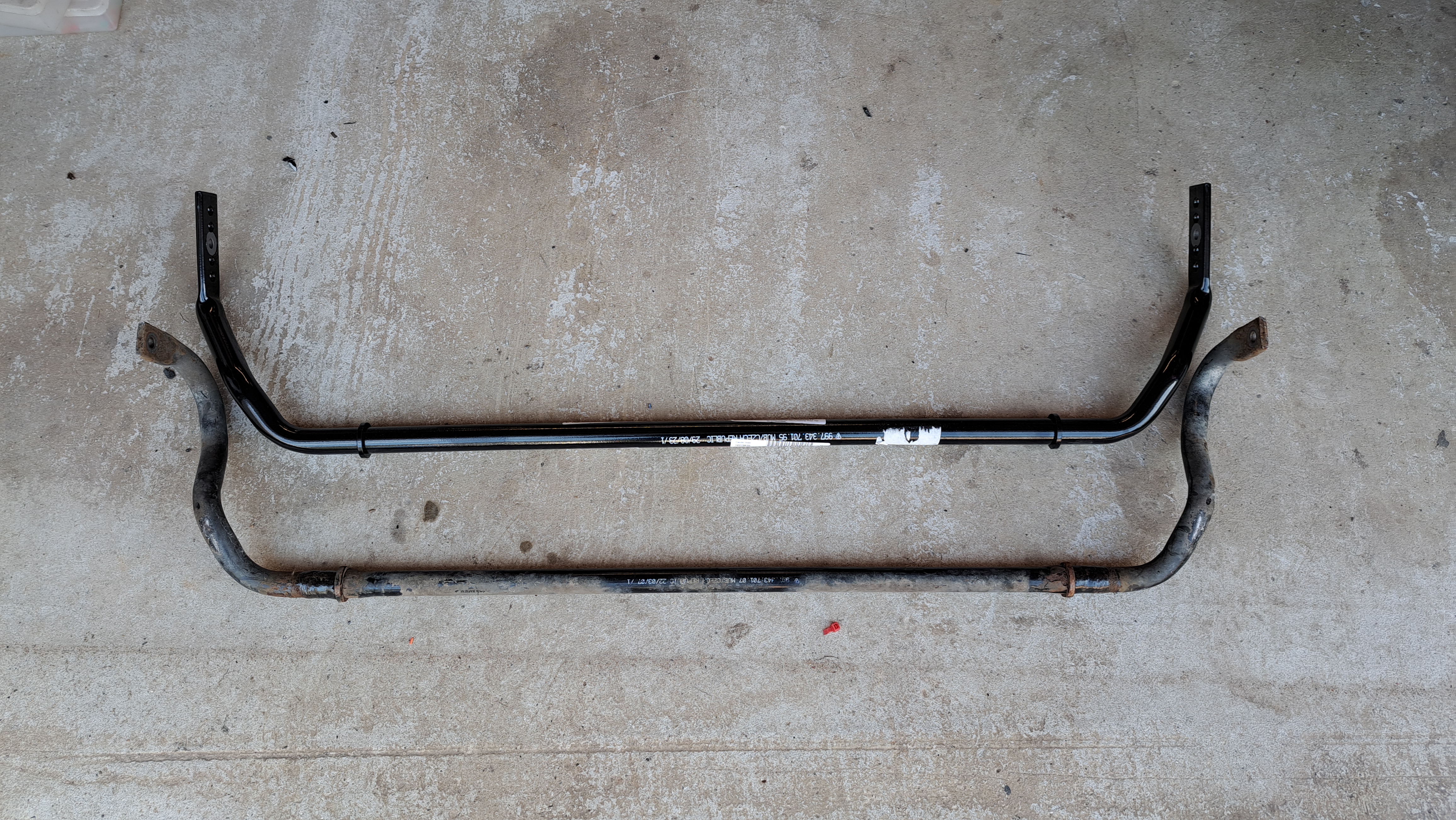

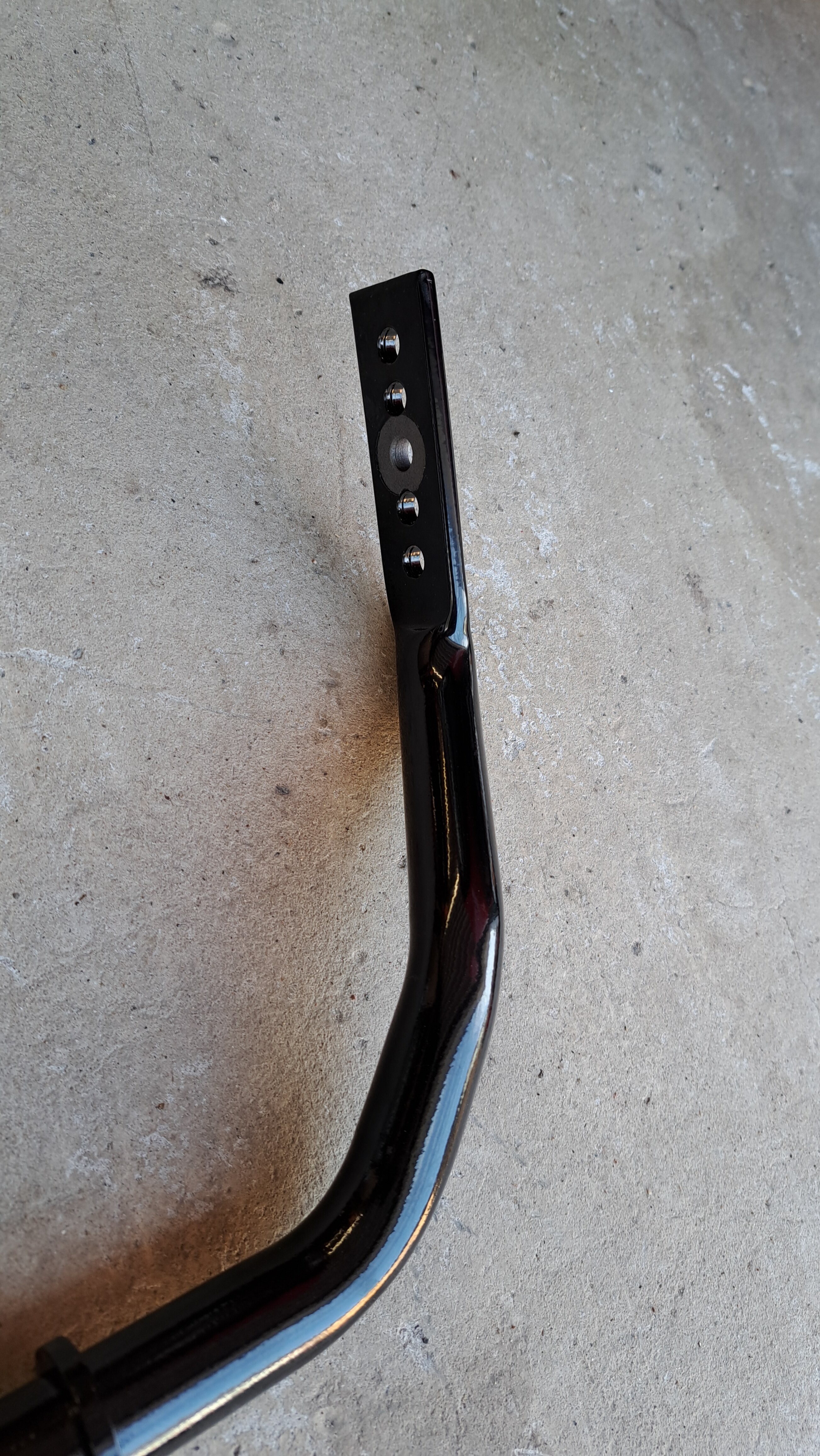

A front ARB swap (if you can find one, I had to buy new from Porsche) will turn into a lot more work, garage or otherwise. I wanted the GT3 RS as its 5 way adjustable from factory - I honestly don't understand why H&R/Eibach sell what they do - non adjustable front, what is that all about?!
I would say deeper sump at a minimum, and a good oil pressure gauge of some sort. Don't rely on the stock oil pressure sensor, if you see that come on... well it's already too late. At least with a gauge of some description, you can see how the pressure is as you build up pace and get an idea of what is going on 👍

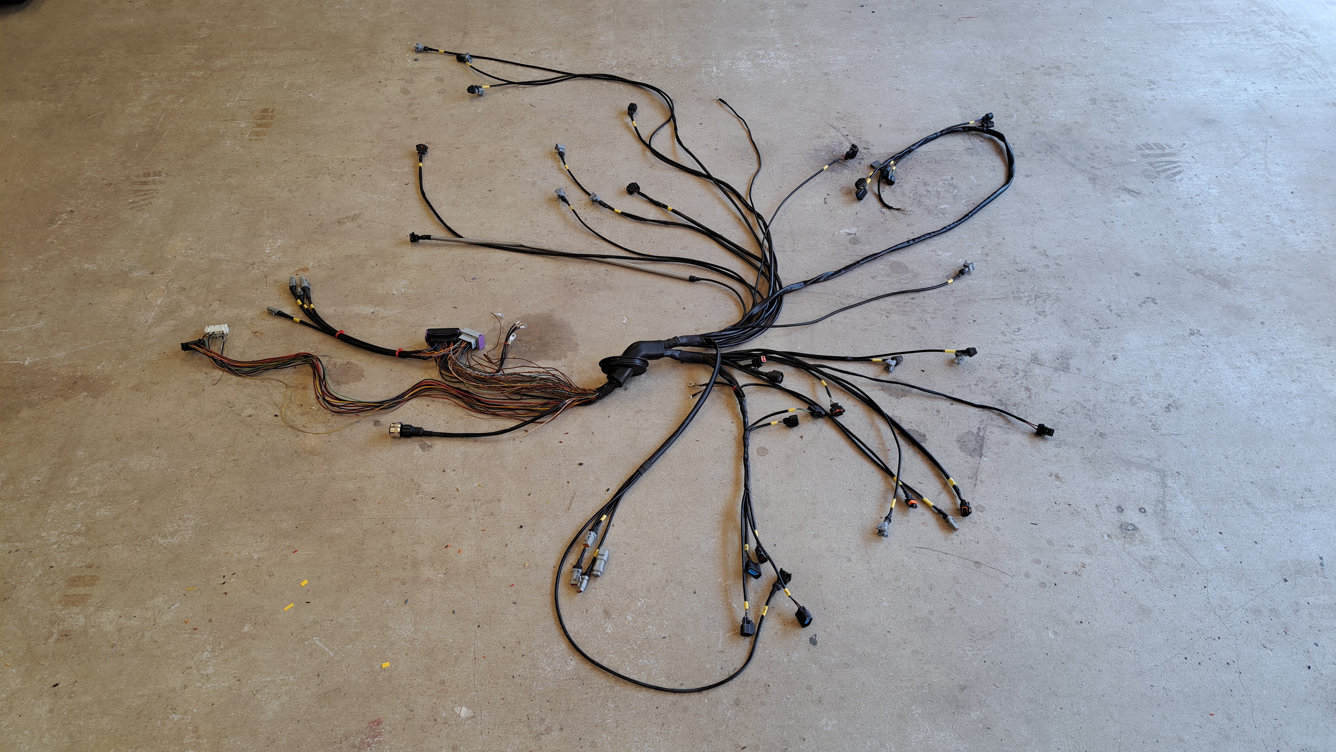

Lots happened over winter, no original wiring left and it's pretty much at its 'lowest' weight now without getting stupid - around 1240kg.

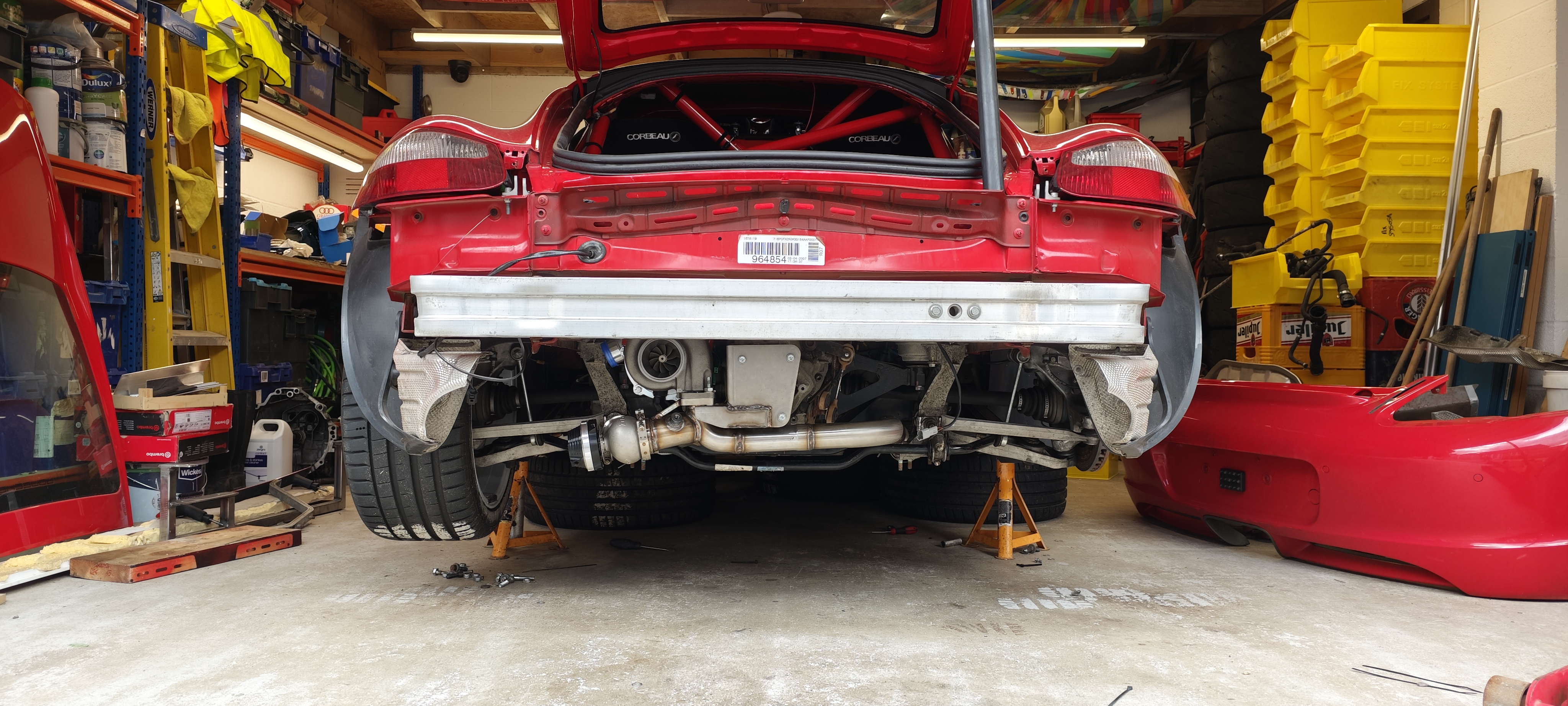

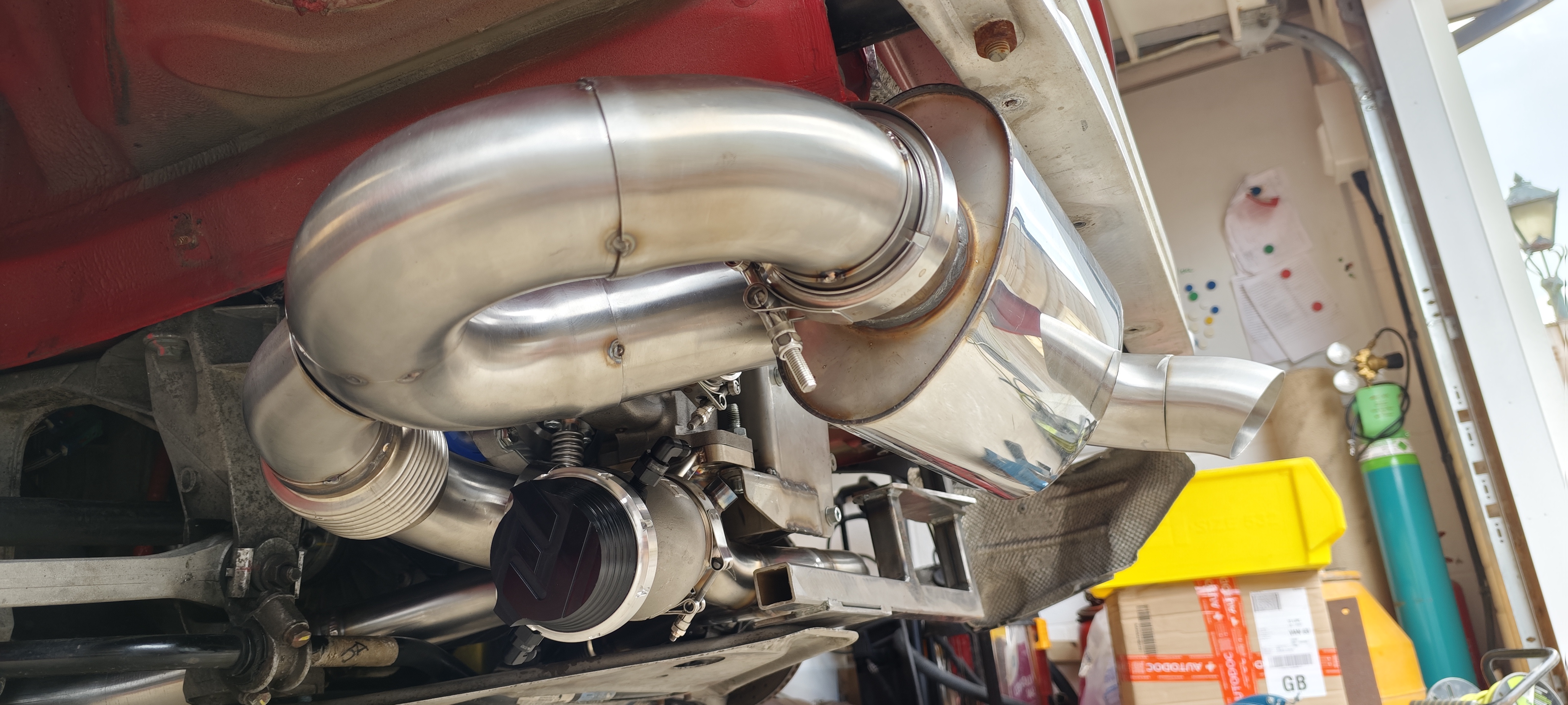

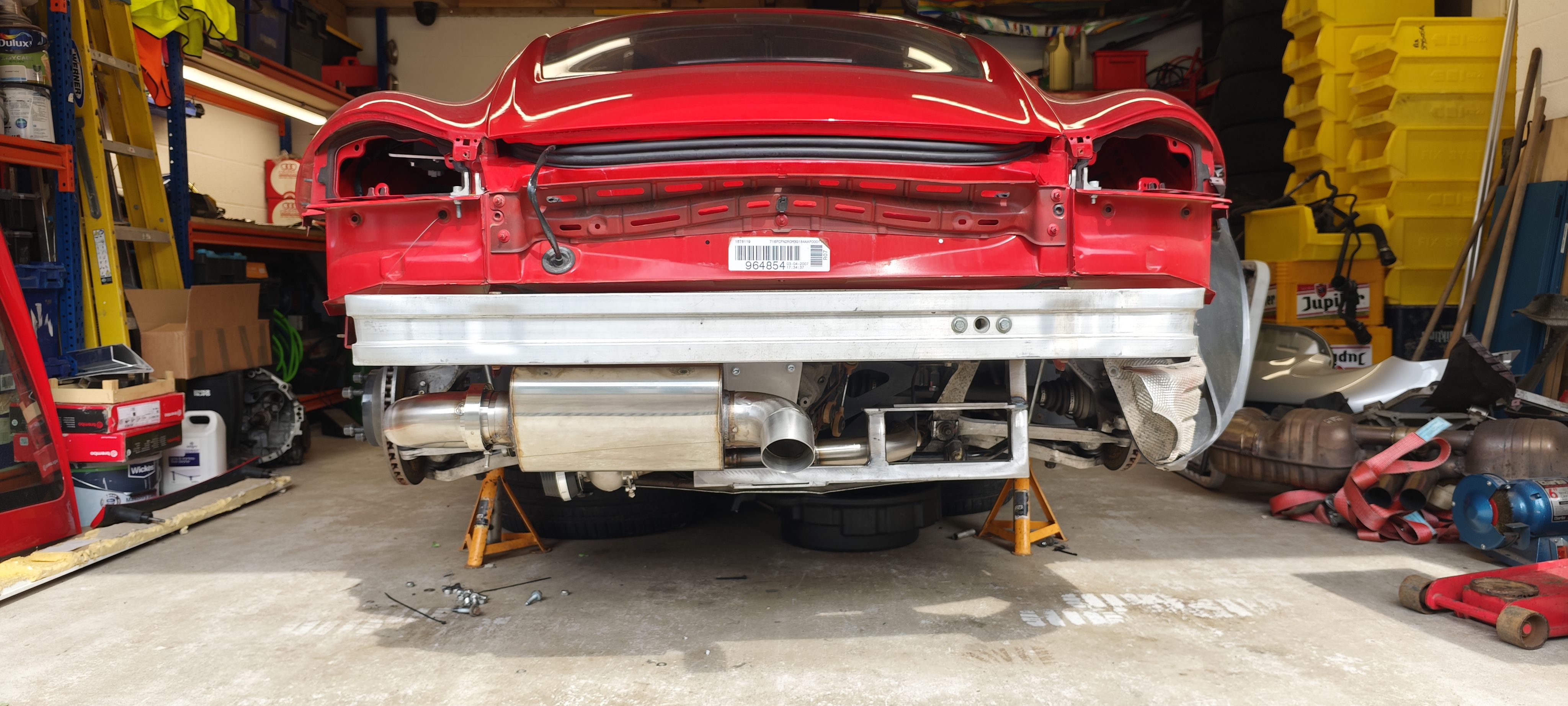

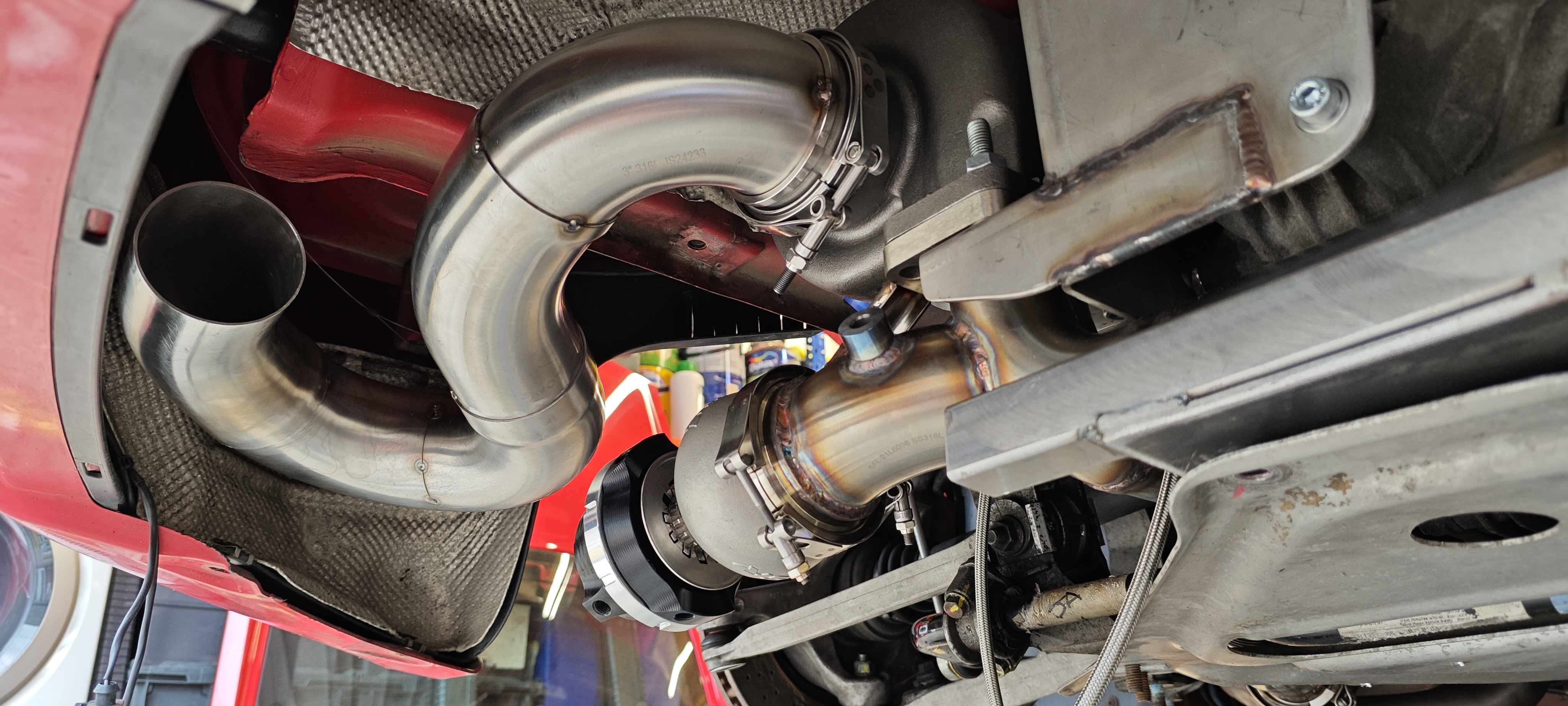

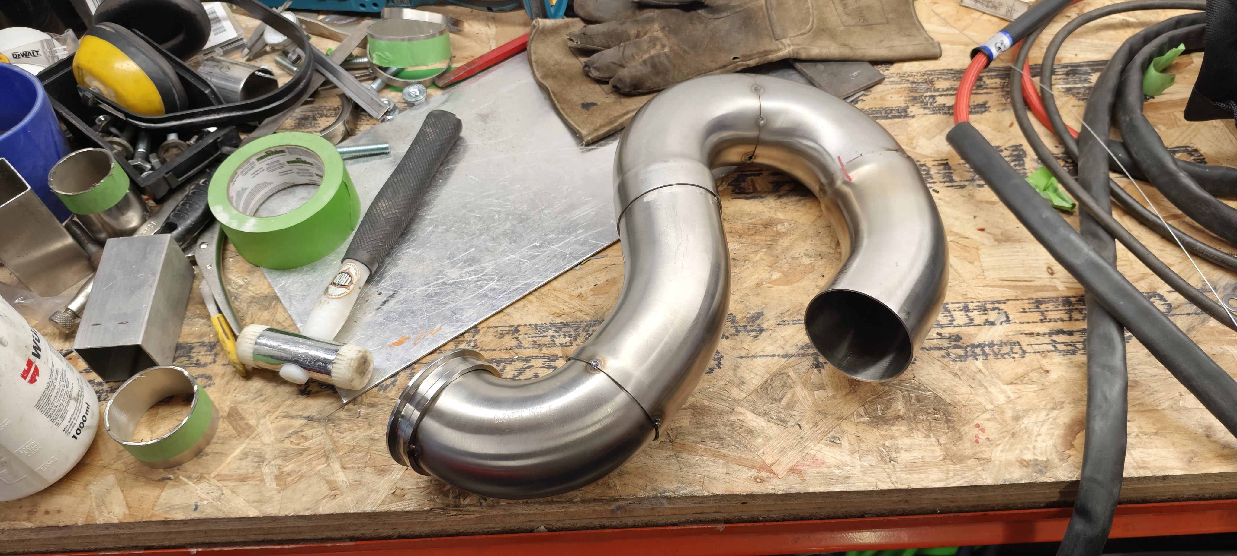

So now I'm on with bumping up the mid range torque and power instead 😈
Strewth! That is going to be lively! What power you expecting with that?
Well the motor is stock, and they're quite high compression standard, so low boost for now, 7-8psi, which is why I'm using a 60mm gate so I have proper control with the ECU. There has been a lot gone into it fabrication wise but I'm attempting to do it properly with how I use it, with proper parts, so it works as itended. All being well should be back on the dyno early July 👌
