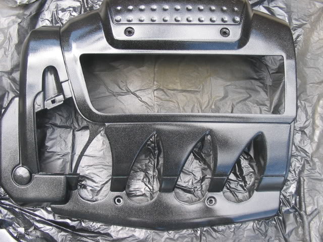

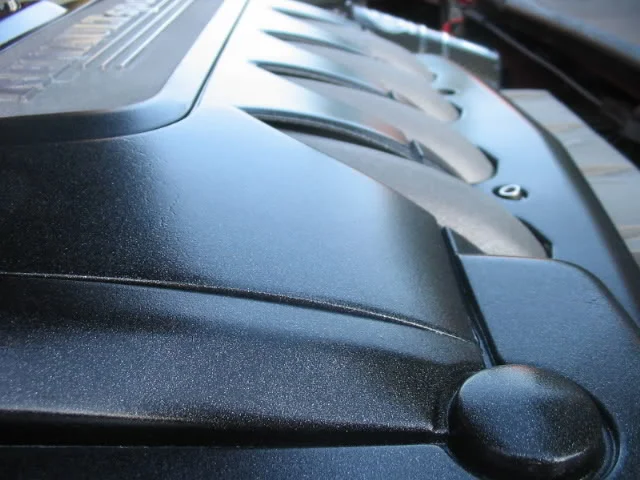

Engine cover - done it properly now!

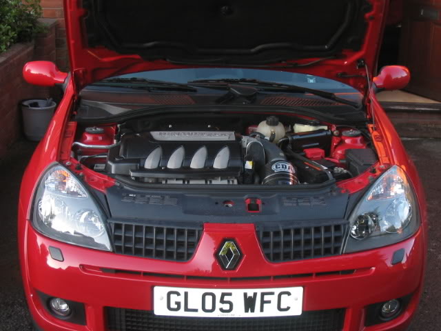

Car  No more clio's for me!

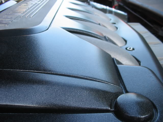

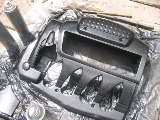

Matt black with a bit of stardust silver in it (stood about 5mtrs away and let the wind do its stuff)...:cool:

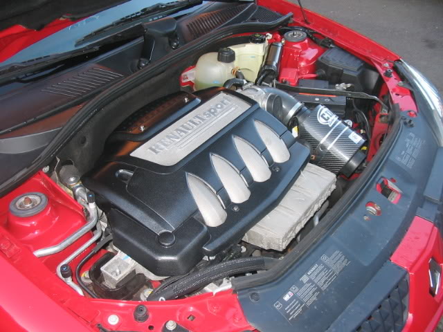

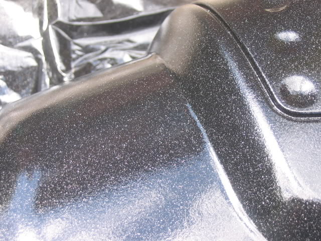

Many coats of lacquer left to do and its finished (its still wet in the pics)
Middo - i need some 16v and 2.0l decals ;)
that looks very nice, tkae it you sanded and primed it prior to those stages though.....
think i may have to play with mine soon....
Yep sanded and primed :D
For the final coat of stardust/matt black i didn't sand as i would have removed all the flecky bits. lol
I could have done the fleck with the lacquer, but didn't want to feck it up, so the finsh isn't as smooth as it could be.
Now its dry though it looks even better, matt finish with a fleck of silver :)
Danny. I can't believe you've colour co-ordinated the battery terminal to the car! Crazzzzzzy!;)
what is it with reno and dabs of blue paint on all the header bottles.
looks the bomb mate
Its so they can see if anything has come undone. If the paint doesn't line up it means somethings lose!
