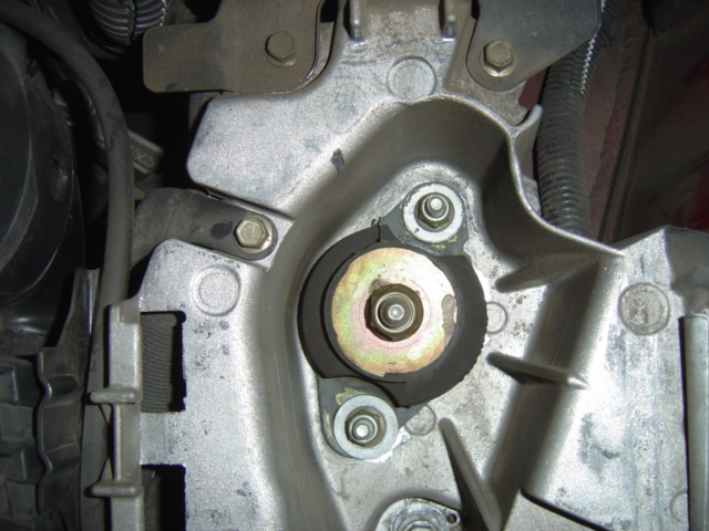

Ok found a picture
Do i just undo the three bolts in view whilst the engine is supported ?

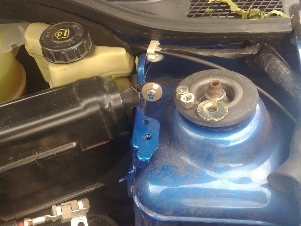

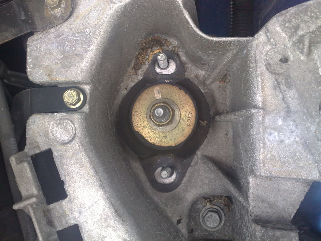

Pic of my mount after removing battery etc, havent took centre nut off but am i right in thinking they shouldnt be oval shaped like the picture shows..?

Engine mount there is the gearbox mount, looks fine to me. The picture is different as yours has another rubberised cover over the metal.
Check that the main nut is tight and try tighten it a bit more to see if it is loose.
Then tighten the other bolts back up and it should be fine.

Don't think you can't see if it's gone until you take it out iirc. I've seen pics where they are split on the bottom side.
