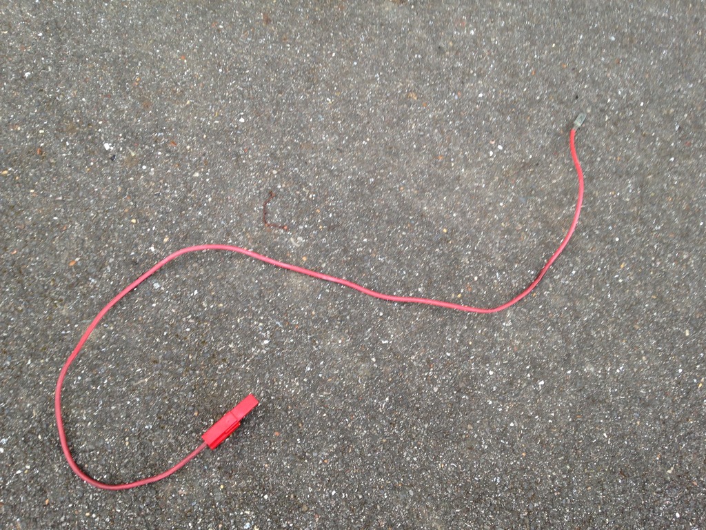

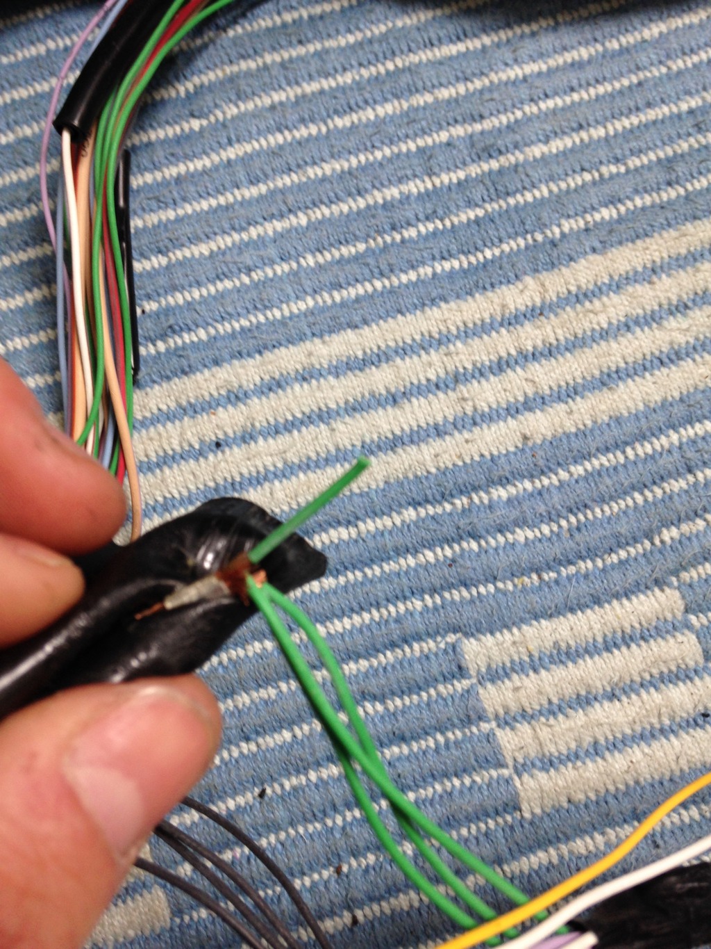

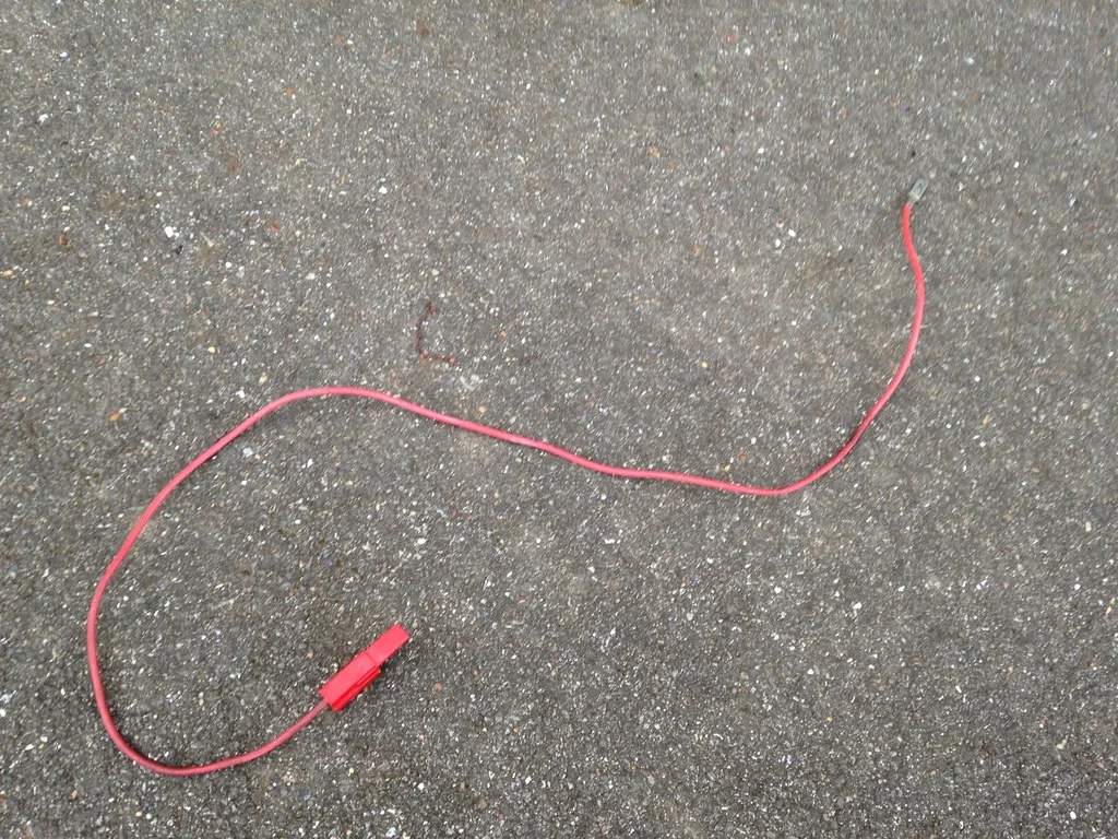

Okay chaps here we are. I've put together an excel sheet with pin out details of the connector into the EPAS ECU. There's a diagram in there too which should be self explanatory.
https://www.dropbox.com/s/7cmvsr40rrv37jp/Power Steering Wiring.xlsx?dl=0
To get the factory wiring it's pin e3 in the r107 which is a central spade connector. The 107 it behind the washer bottle and has a 10mm bolt in the skuttle to separate the internal and external part of it. To take the pin out of the block connector you need to pull the tabs out the side of the connector and press down a small tab on the pin it's self. If you can't source the oem wiring from a scrappies the factory cable size is 7mm^2. The internal part of the loom goes from the r107 accross to the EPAS ECU. It's also a good idea to take the ground wire and remove the plug and wires for the torque sensor and any of the option bits in the notes of the excel.

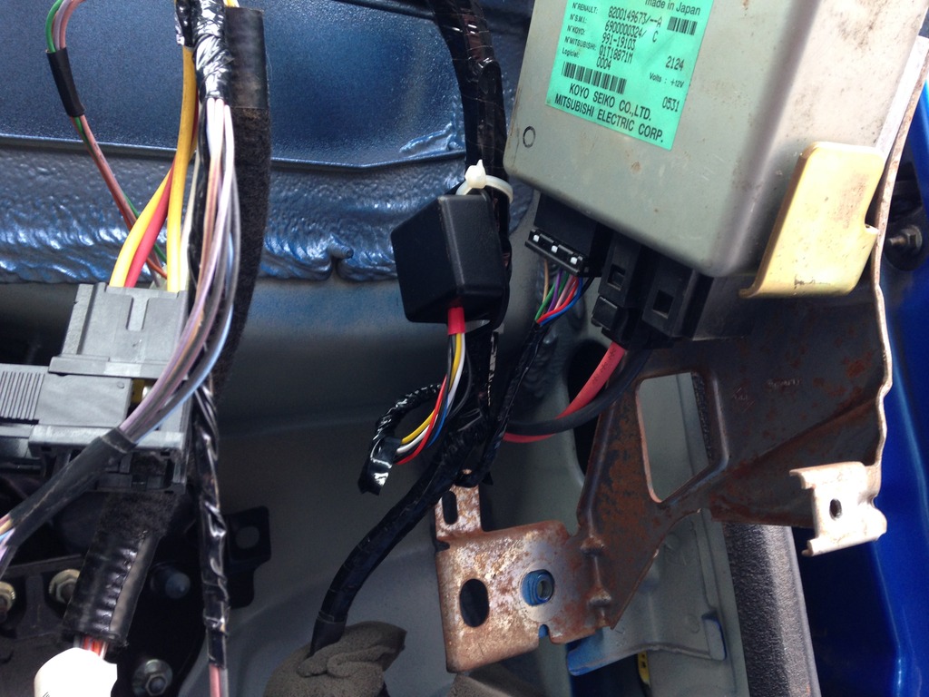

This is the EPAS 502 connector that comes with the epas control box. I've installed the optional EPAS light control wire and diagnostic CAN wire.
This is the bit you connect the CAN into if you're going to. It's on the part of the loom which goes down to the diagnostic part.

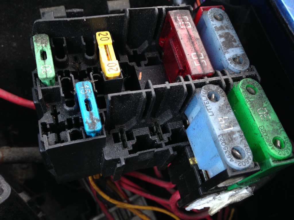

This is the block in the fuse box you attach the OEM wire to. The coloured sections come off so you just clip it on and the other part of the spade is already pre-wired and live.

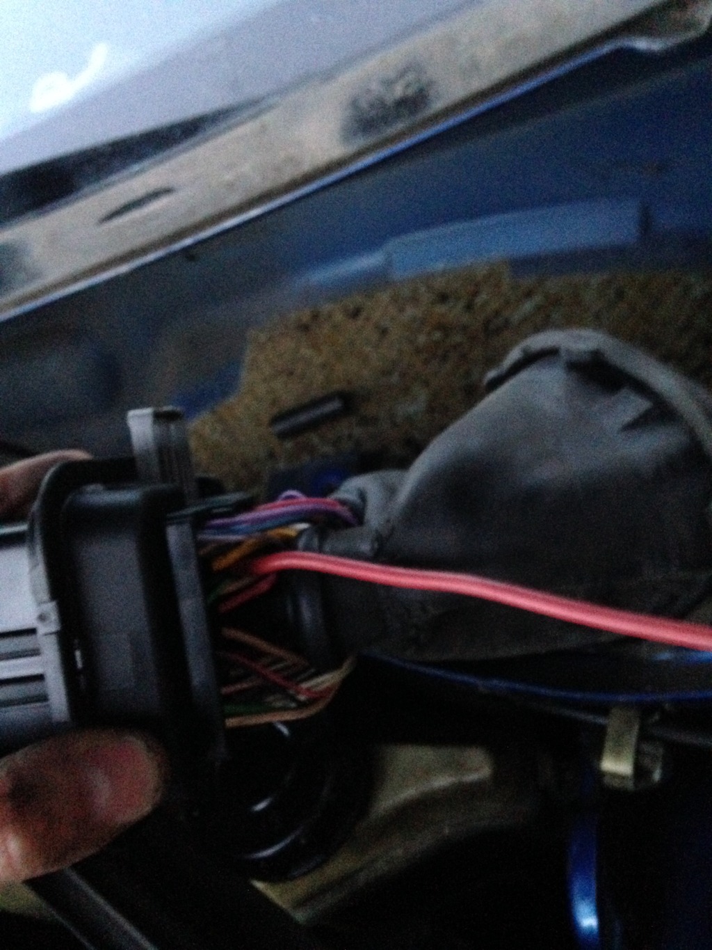

Pic of the external part of the r107. The grey bit is the tab you need to remove to take out and insert pins. It locks them in place in addition to the tab on the spade.
This is how mine all sits

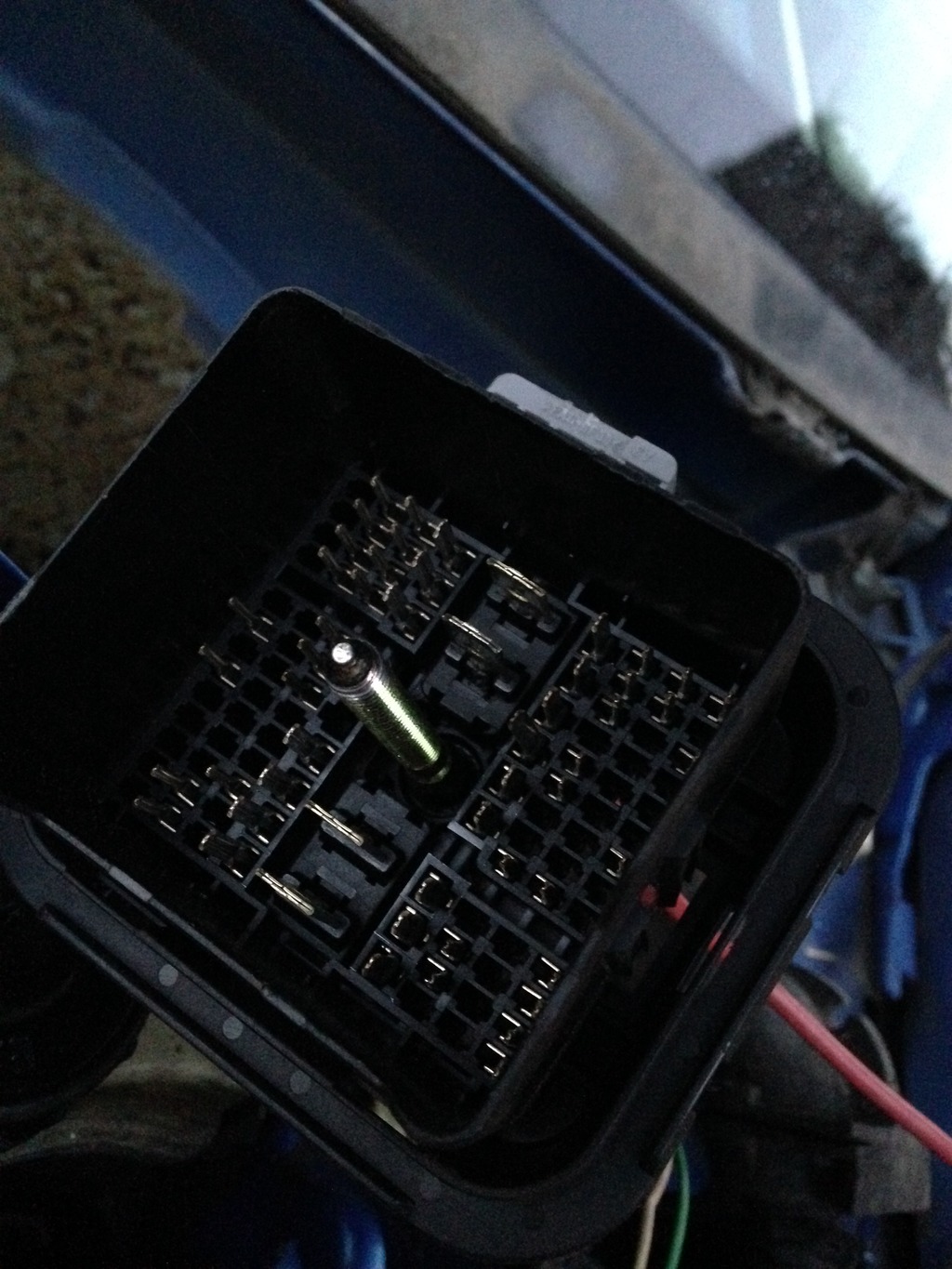

Inserting the wire into e3 of the external section of the r107

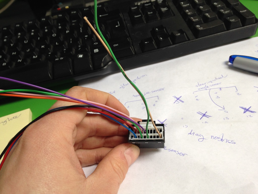

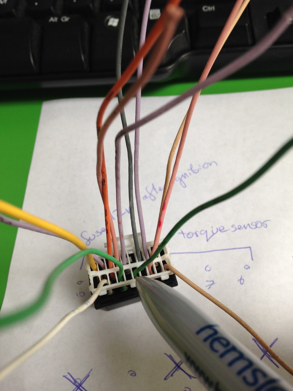

OEM plug for EPAS ECU (I've noted the different colours and what's not used by the ebay control box)
Wire externally from r107 to the fuse box should look like this. This isn't actually the original OEM correct wire so ignore the orange terminal colour.
Any questions just ask.
Graham
Graham
