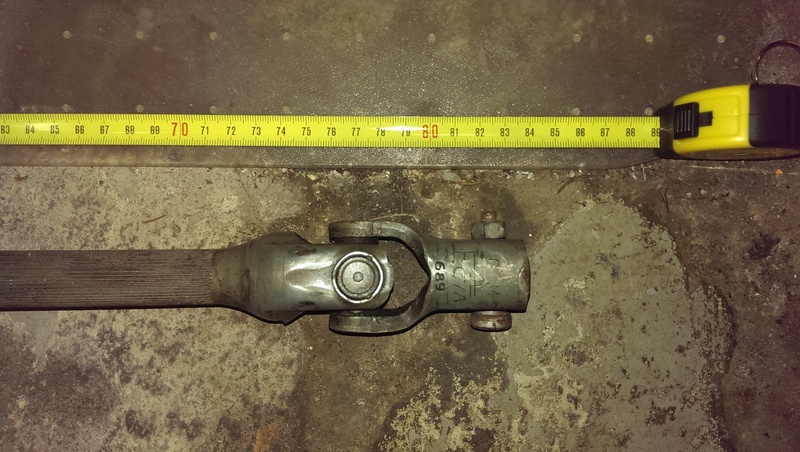

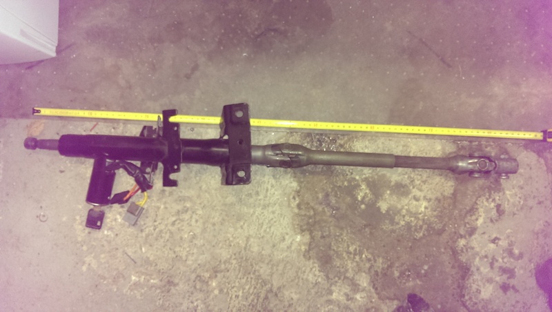

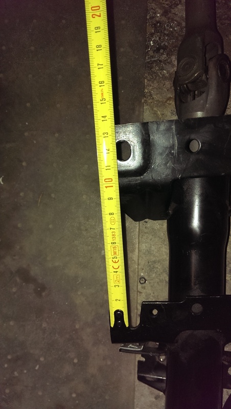

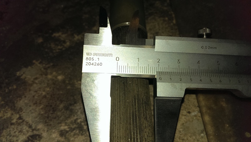

Williams and Clio 2 EPAS columns obvioulsly look very different.
From my point of view the overall length is the important issue.
A Williams/Valver column is approximately 83-84cm end to end.
Length between mounting holes is 11,5-12cm, Column is 48 spline (Ø20mm)
Additionally there is a slight angle between the 4 mounting holes and the column "direction".
Hard to explain but the picture indicates it.
How long is the Clio 2 EPAS column?
Does it have this slight angle as well?
