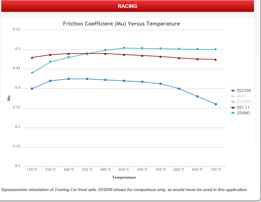

Ferodo DS1.11 v DSUNO?
Anyone ran both? Have ran the DS1's but not the DSUNO's which look beastly on the coefficient charts below. Not sure they'd be as kind on discs and last as long as the DS1's though. Currently got DS2500 but had them fade pretty easily on a recent spirited drive out. Pads would only be used on track with OE pads doing the daily stuff.

Look a little to aggressive for the Clio at neat 0.6 MU. I had the RC8's with similar coefficient and they were terrible. Far to aggressive with little modulation. Saying that the graphs don't always give a true reflection of performance IMO. I was sceptical about the DS1.11 being under 0.5 MU but they are fantastic in the Clio.

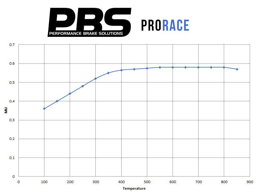

The PBS's are mega for the Clio. Running them front and rear really does balance it out.

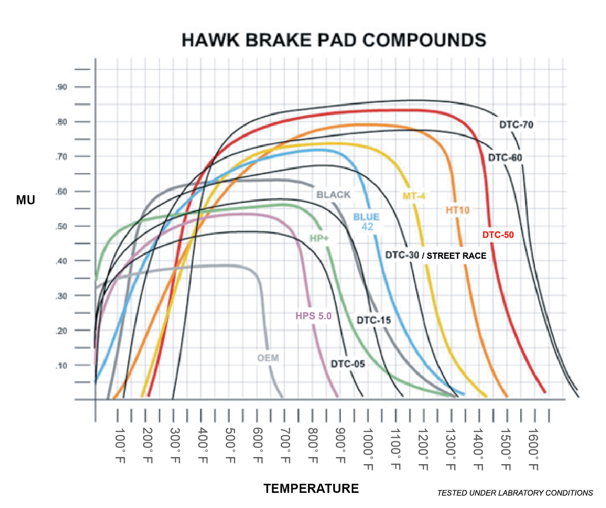

I'm not sure if Hawk do Renault fitment but I like their HP+ a lot on the road - awesome initial bite, even when stone cold. I can't vouch for them when hot, though, as I don't generally drive that fast / brake that hard, but they have a decent range to choose from.
They've taken the graph off their website now :rolleyes: but I saved a copy for future reference:

You can't compare friction graphs between manufacturers, they all use different test sequences, pressures, velocities, etc, to get their figures.
Hell, they're only a rough guide between compounds for the same manufacturer too.
The fact that all the Hawk graphs drop to zero friction coefficient before and after the working temperature should tell you how accurate that PR fluff is.
I'd be amazed if you didn't get on with 1.11 vs 2500 - they're better everywhere, even clap cold. Better modulation too.
