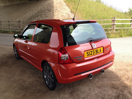

So I've had a quieter centre section made up at Exhaust UK in Sheffield, they even fitted my cat back in. Finally have a exhaust which sounds how I want it to.

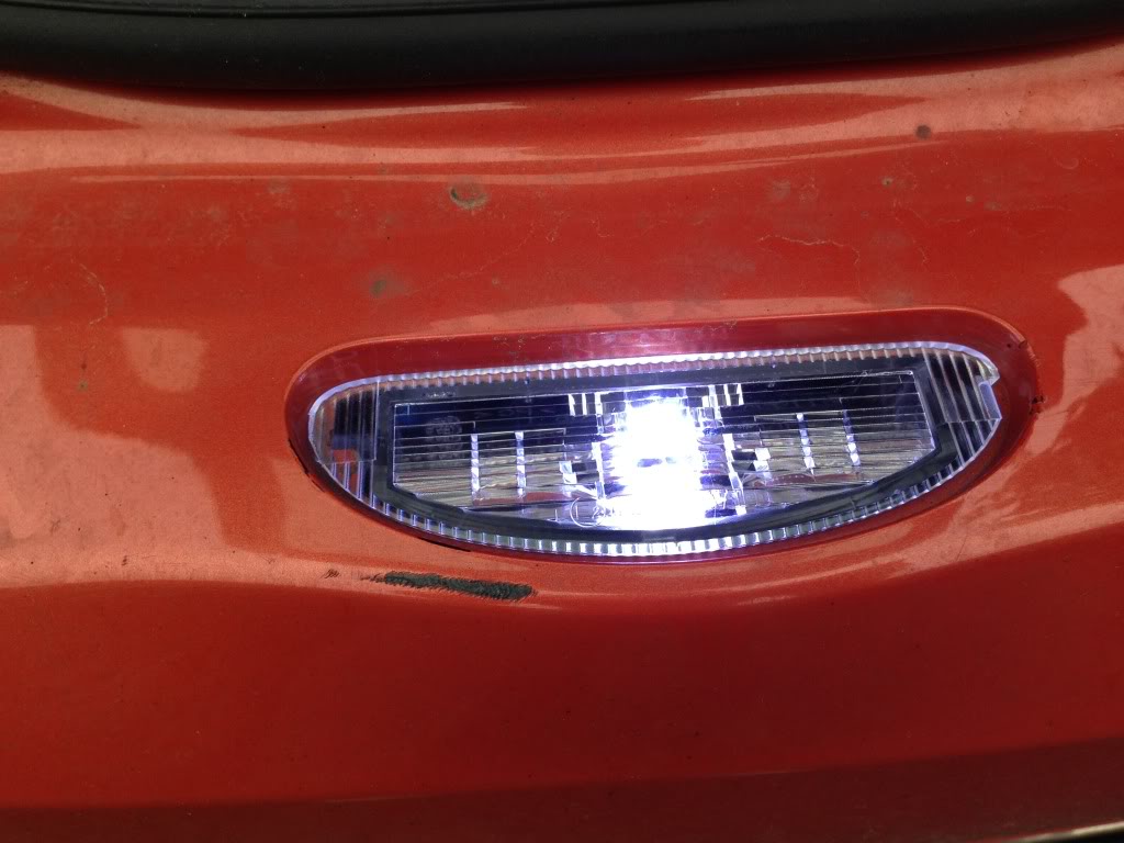

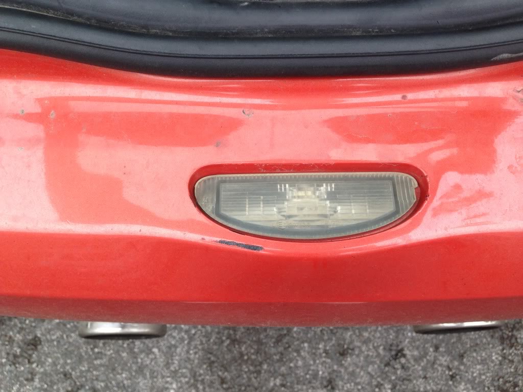

Also after my old number plate light being corroded I finally got my new one through the post.
Old manky light unit
Nice new one with LED bulb

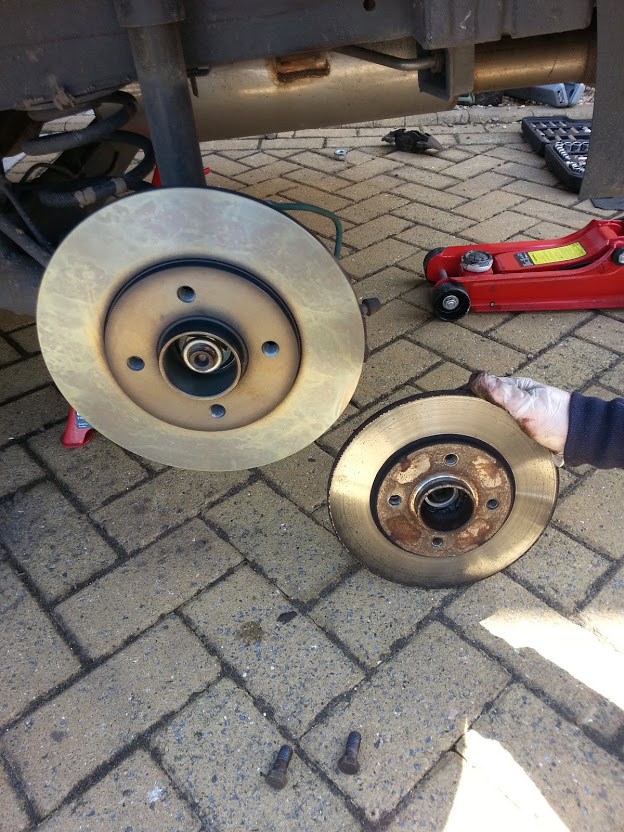

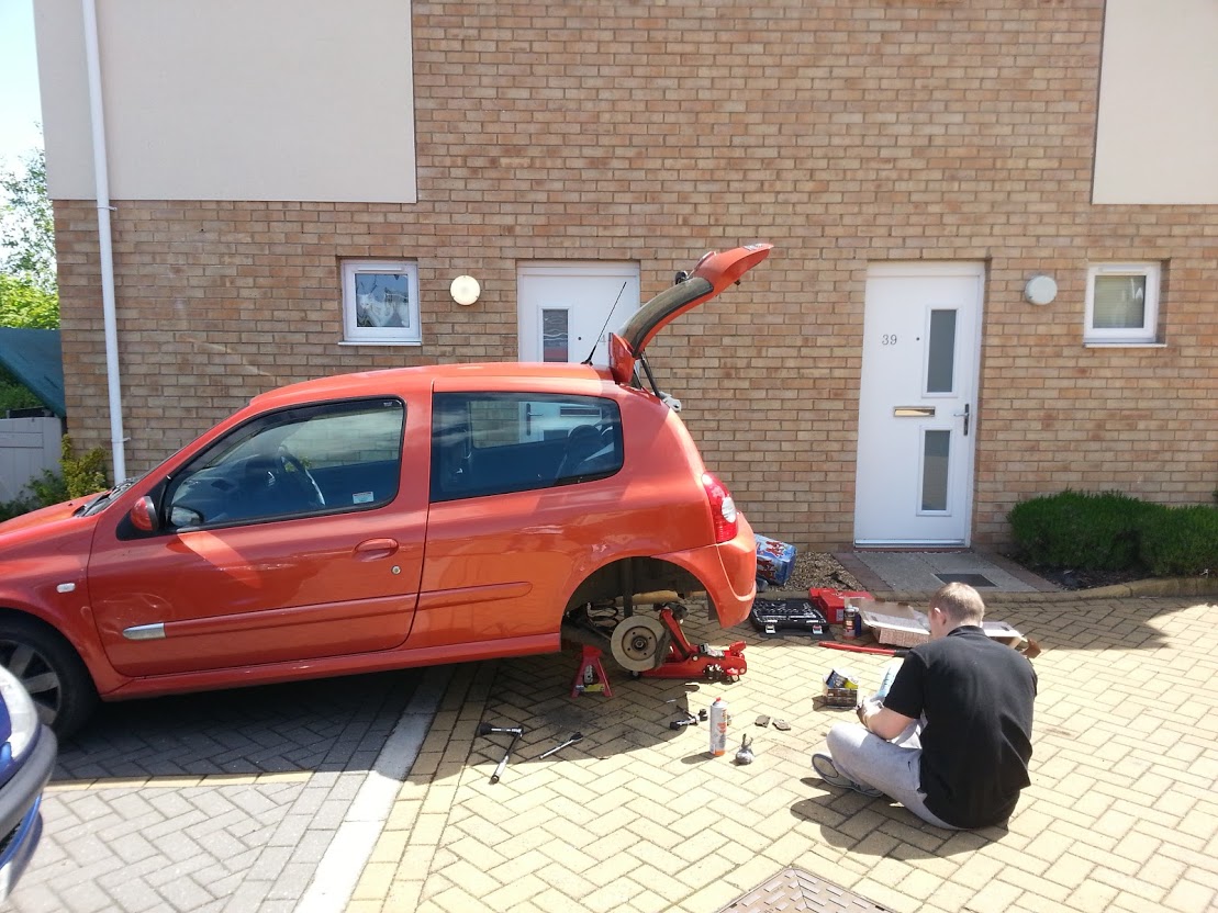

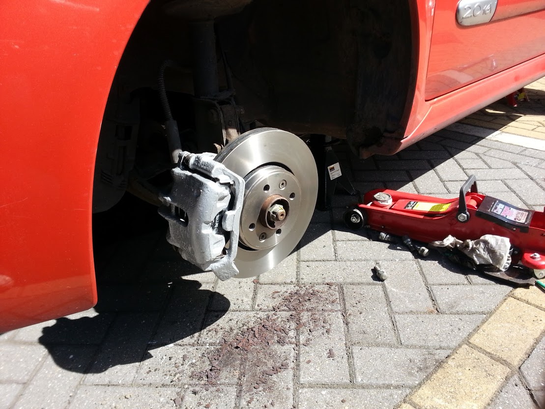

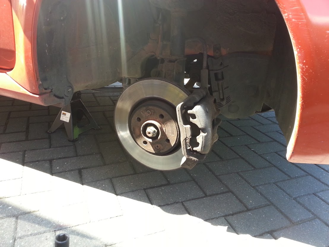

Simon popped round to mine this morning so we could change his brake discs and pads all round, and he also had a lambda sensor to replace (pre-cat).

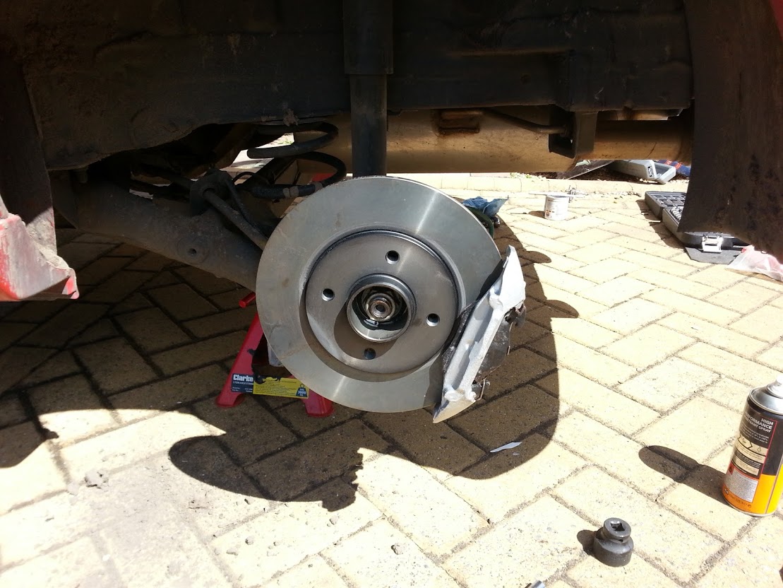

Rears first. The only brake changes I've had experience with are on my Impreza - and for anybody that follows my thread will know it was a massive pain in the ass. We kept score throughout the job to see what was easier/better designed/etc.
The rear disc on the Clio was all self-contained with bearings and stuff. This meant we needed to go to Halfords to get a 30mm impact socket for the hubnut (1-0 Subaru IMO)
New vs Old:

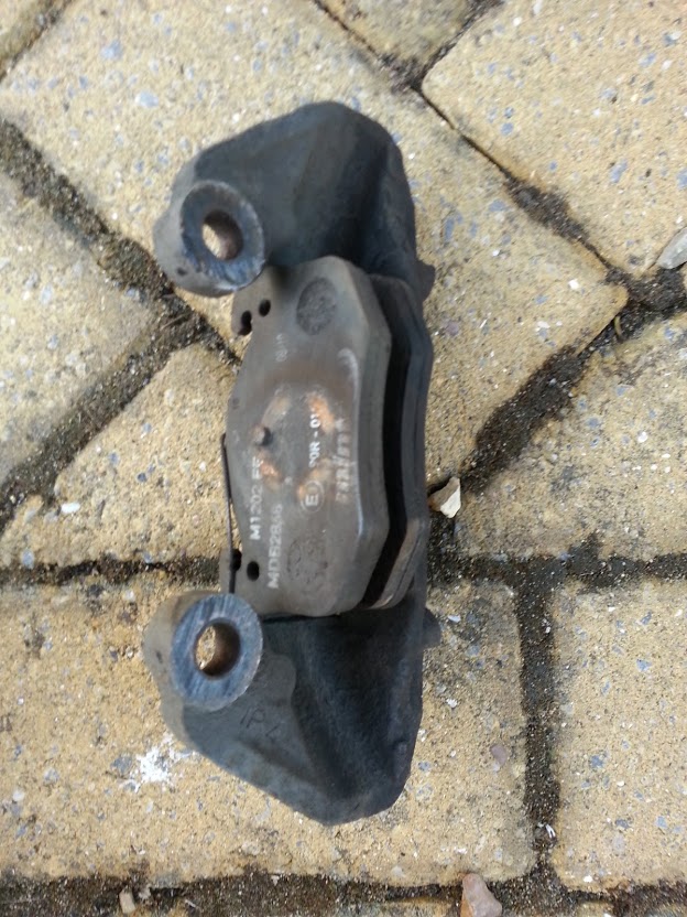

Old caliper bit thingy with the used Mintex pads in:
All of the bolts came out so easily, it wasn't even funny. (1-1)

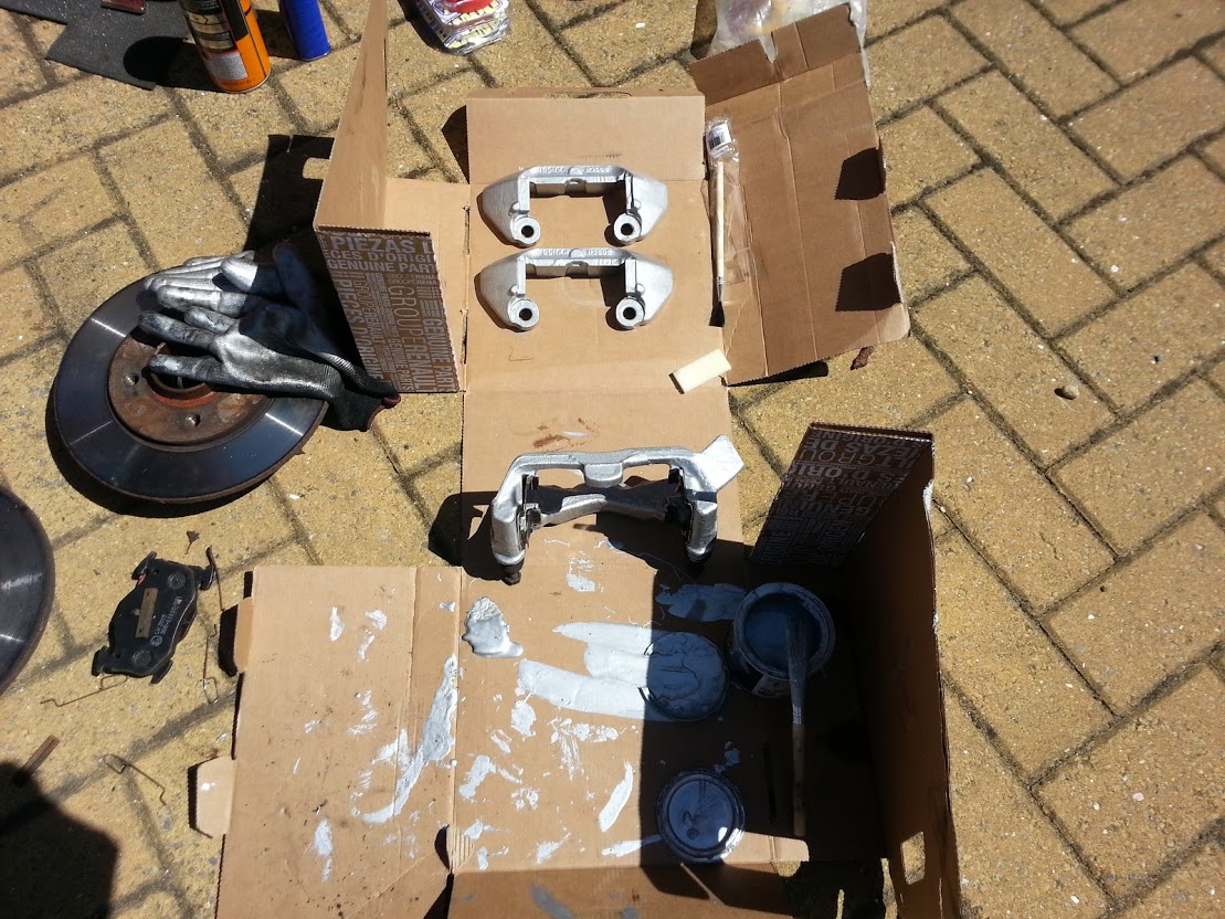

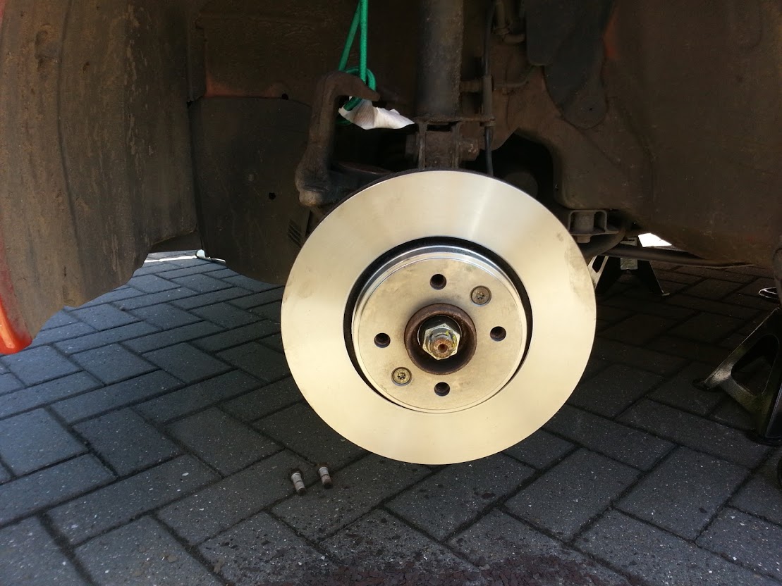

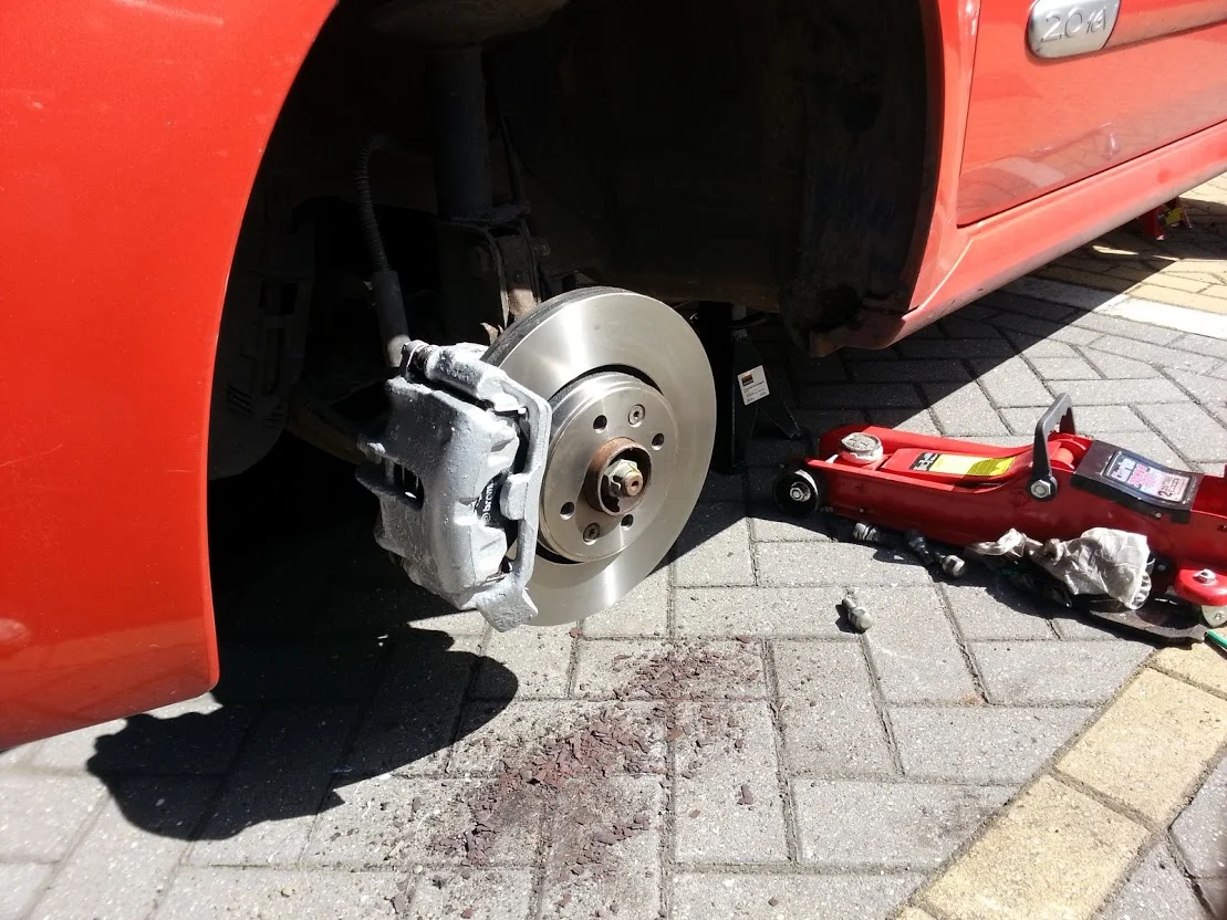

We wanted (or rather, I wanted) to clean and paint the calipers too, so after dismanting the rears we jacked the front up whilst my missus went to get us a paintbrush.
Front (old) arrangement:
New disc on:
So far, in an hour we had done what took two days on the Subaru... (2-1 Renault)
Paintbrush arrived about now, so I opened up my paintshop whilst Simon continued dismantling the fronts:
My Hammerite hadn't been opened since painting my FN2 calipers two years ago, so had a bit of skin to peel back first... hence the mess.
We got all the painting done, then went inside to watch F1 qualifying while it got something like dry.
Back out after quali, and started re-fitting the rears:
Fronts:
The front calipers were easy to remove (3-1 Renault) but replacing pads was a bit awkward compared to the Brembo's on the Impreza (3-2 Renault).
I got to work putting the wheels back on whilst Simon scurried around underneath to replace the lamda sensor.
Got the car back on it's wheels:
We cleared the Engine Management Light using my bluetooth OBDII adaptor and smartphone app, and Simon cleared off to test the brakes.

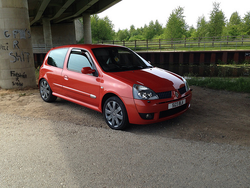

So the old girl got a wash and hoover out this afternoon whilst the sun was shining and thought I'd go grab some photos
Clio 182 - Quick Clean by Simon_89, on Flickr
and a cheeky photo of the bullet...
Got some work to do on it when I get back, need's track rod ends and lower ball joints replacing as there's some knocking coming from the front end. Quite tempted to get some cooksport springs for it seeing as suspension for cup packed 182's is a pain in the ass to find!

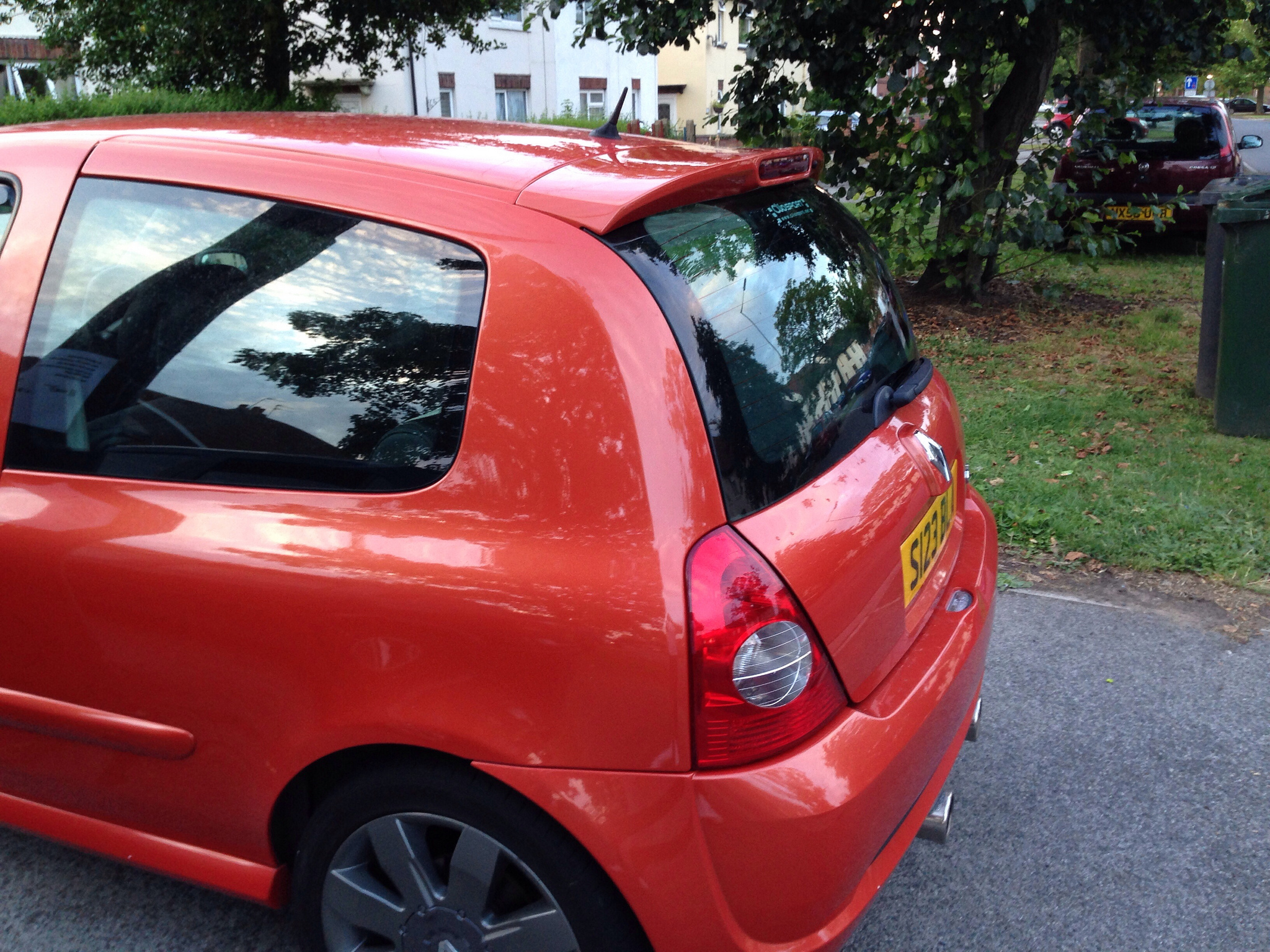

6th July 2013

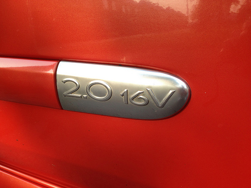

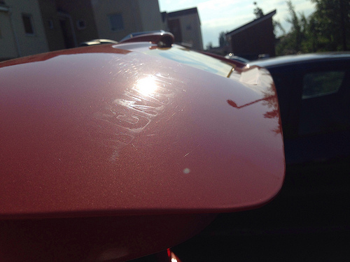

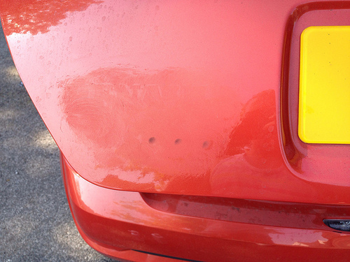

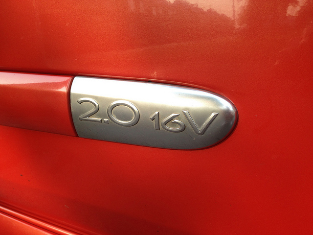

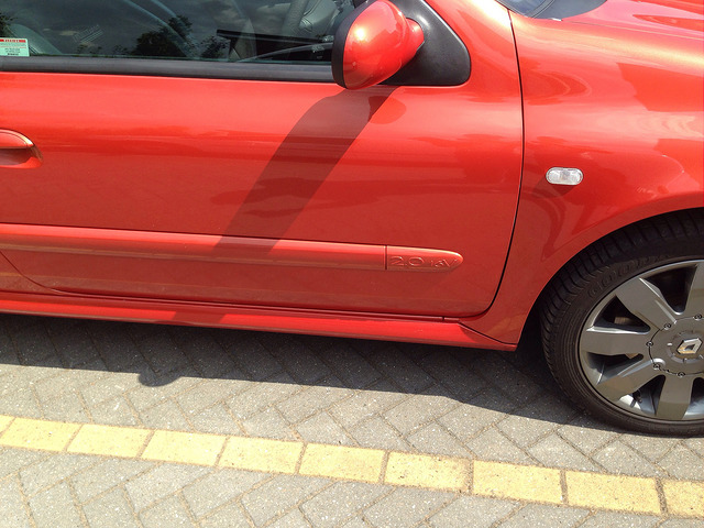

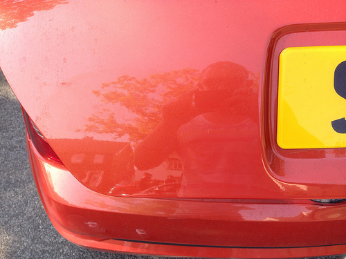

Decided to debadge the rear ready for when I purchase a RS200 badge to replace the 'Clio' badge.
Luckily with it being a red hot weekend, the badge was already softened up and came off with little effort. The only thing I was really left with was 3 water marks left in the paint from where it hasn't been washed properly.
Polish applied by Simon_89, on Flickr
Luckily with some AutoGlym Super Resin Polish the water marks came off with little to no effort
No more badges by Simon_89, on Flickr
Only problem is you can see a feint line where the badges have been, so will get my friend Kyle to use his machine polisher to do a light cut on the paint to remove the marks.
Untitled by Simon_89, on Flickr

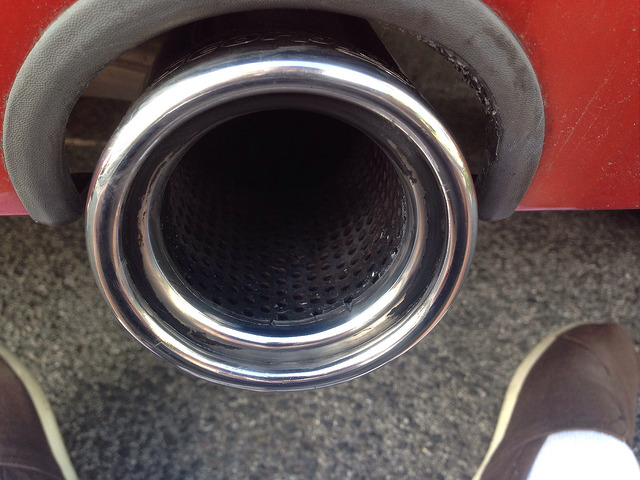

Mate how did you get your exhausts SO shiney? Products? Method?
Mine's currently dirty and want to scrub it up so it gleams like yours does! Nice job!
Simon_16v
Re: First 182 - Inferno with Cup Suspension
Just Autoglym metal polish and an old microfibre cloth. Just need to dab some onto the dried carbon and then leave for 10seconds or so and then attack full force

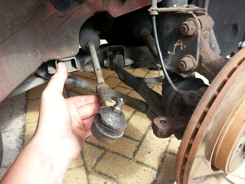

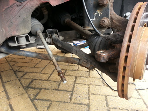

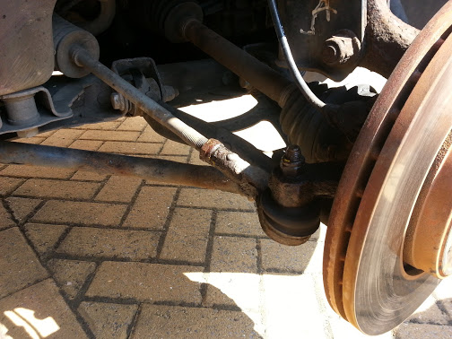

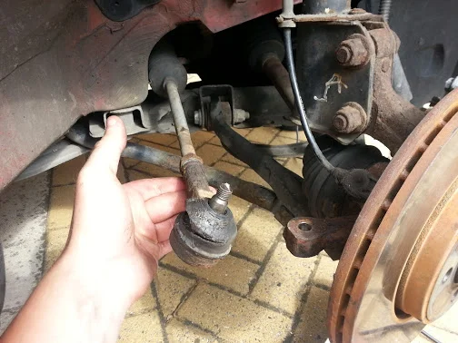

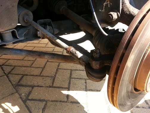

Goal on Sunday was to replace my track-rod ends which had lots of play and were knocking.
Should be an easy job if nothing is seized up:

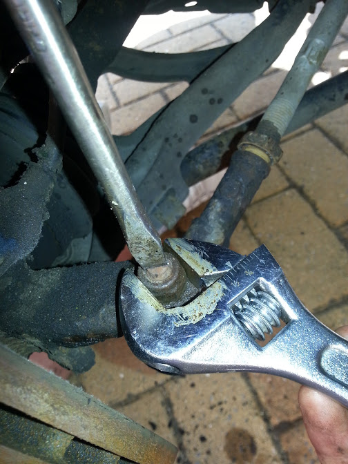

The nut holding the TRE onto the hub assembly loosened off fairly easily, but about halfway up the thread the bolt just started to spin in the joint. We tried molegripping it, but ended up using the Subaru toolkit:
Cut through half of the bolt then smacked it with a hammer, result!
Another magic solution honed on the Impreza then came into play to remove the TRE from the rod, after marking it's position roughly:
All off, time for a breather:

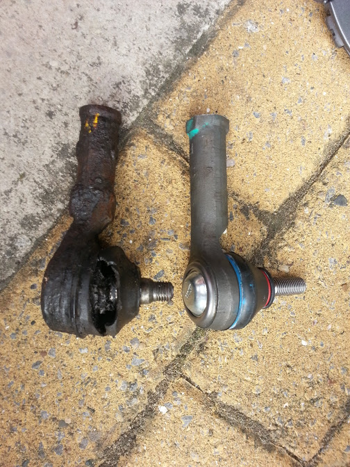

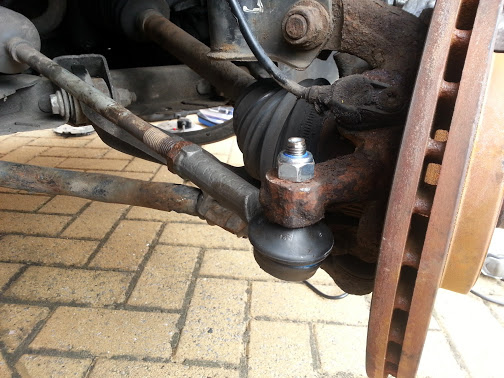

Old vs New:
Went back on with nae drama:

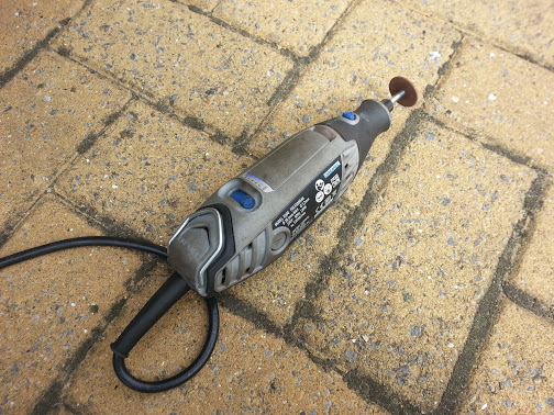

Other side should have been a rinse/repeat - but this time we couldn't slacken the nut off at all, meaning there was no room to sneak a dremel in underneath. I went to plan B which was used to dismantle my mates old shocks from his Impreza, which was to grind a slot in the bolt and then use a large flathead to hold it still whilst spannering the bolt off:
This allowed us to get about a centimetre clearance before it jammed up - then we dremelled the bolt off as before.

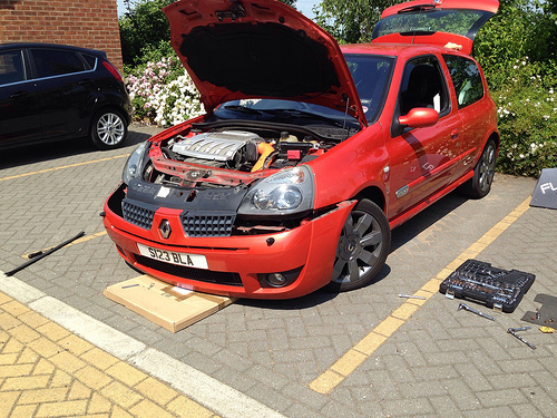

Decided today I'd go round to Kyles house and we'd tackle the front splitter I'd bought a couple of weeks ago.
Skoda Splitter by Simon_89, on Flickr

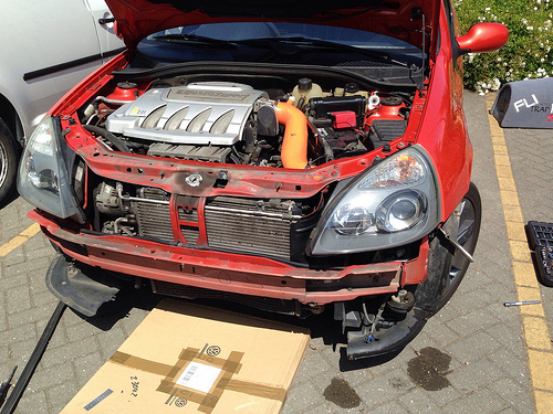

Started off removing the front bumper, 2 x 10mm bolts and 6 torx fittings and a sharp pull either side of the bumper by the wing and it looked like this
Disconnected the headlight washers and fog lights and you end up with one bumper-less Clio

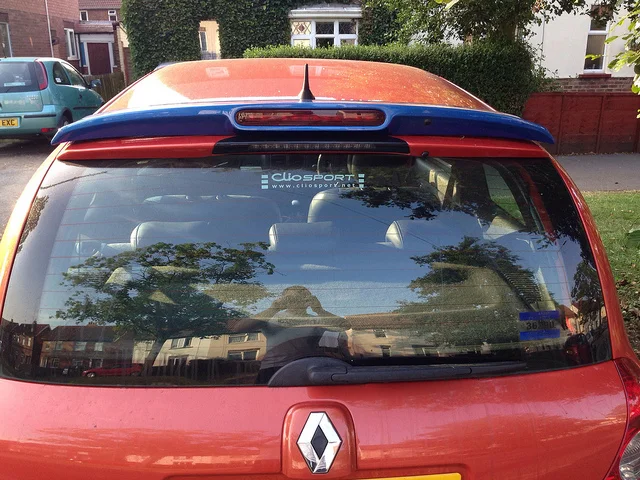

After nearly 2 weeks of waiting my cup spoiler finally arrived, got it for a lot less than they normally go for but it does need spraying as it's the wrong shade of orange
This is a decent comparison of how the spoiler looks compared to the standard spoiler

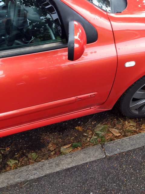

Anyway the spoiler and bullets are currently with my friend at the bodyshop he works at being prepared and sprayed tomorrow morning. Looking quite forward to getting the cup spoiler on, at least it'll look like a proper Clio then :).
The doors currently look awesome without any bullets on them :lolup:

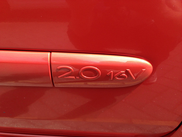

Went to meet Andy at his work this morning, his 'small' body shop location turned out to be bloody huge :lol:
He showed me his Corsa C that he bought as a write-off and is repairing and to be honest you wouldn't know it had been in an accident.
He went to show me the spoiler and badges but had some bad news that the paint on the spoiler had reacted slightly and agreed to doing it again which is awesome of him :).
The badges look awesome and I spent no time at all fitting them! I'll let the photo's do the speaking, considering the paint is pearlescent the paint match is brilliant too
Colour Coded Goodness by Simon_89, on Flickr

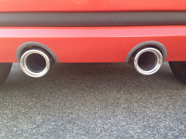

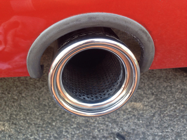

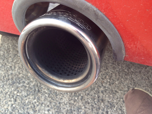

As you may have seen earlier in the thread the exhaust wasn't the cleanest with a decat and I gave it a good old scrub with some Autosol. Well with Trax coming up I decided to really get on top with the cleaning and teamed up with some more Autosol and an old toothbrush.
I had this to tackle with...
Exhaust Prep for Trax by Simon_89, on Flickr
This was the midway point before I got shouted for some burgers
and with one tailpipe done I was greeted with a nice reflection and something that looks brand new
and both tailpipes cleaned

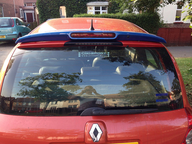

Simon_16v

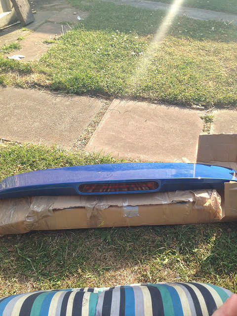

After unfortunately finding out whilst fitting the cup spoiler that the brake light didn't work I got onto Adam and got myself a new one ordered. Once I'd bought myself a TX20 bit from Halfords I decided to crack on and get it sorted this afternoon.
Working High level brake light by Simon_89, on Flickr
Don't feel like I'm one of those people who knowingly drives around with brake lights out now :clap:
