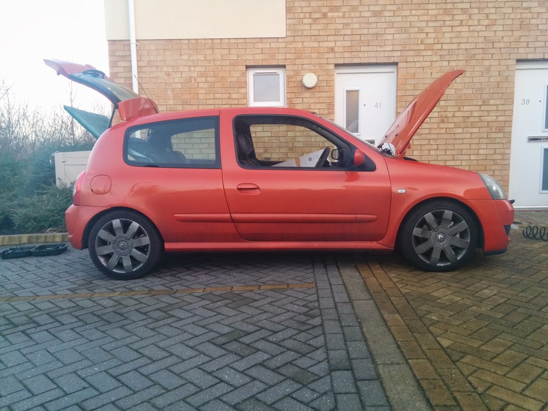

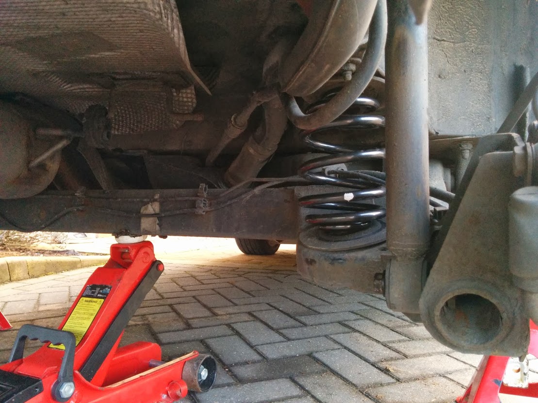

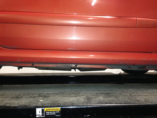

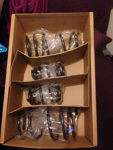

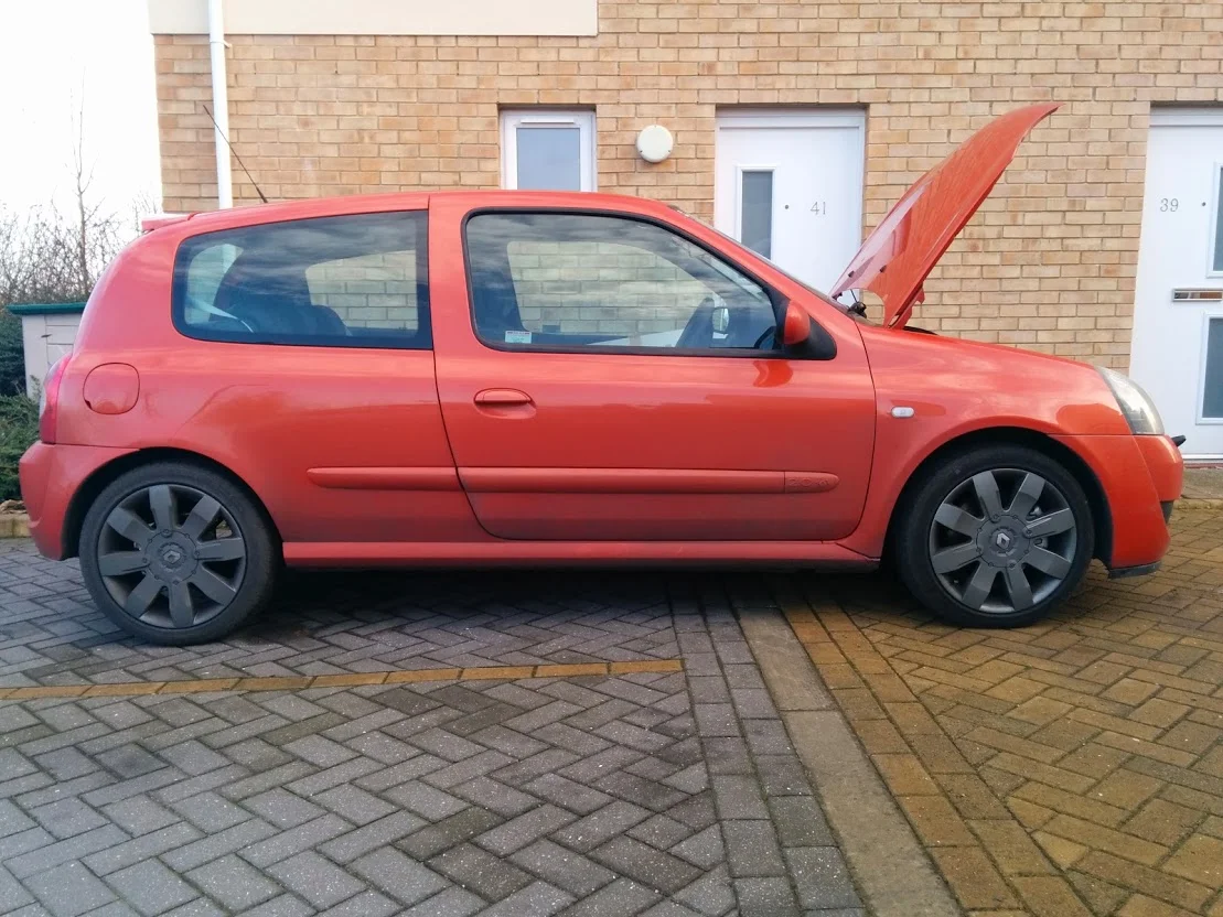

"Before" shot of the ride height:

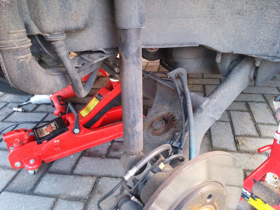

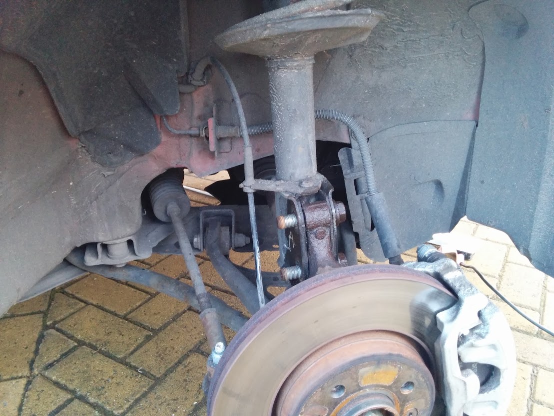

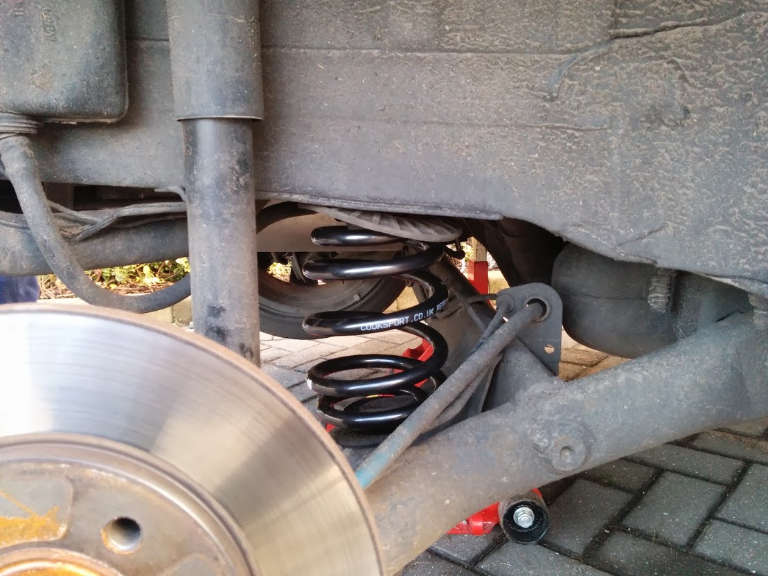

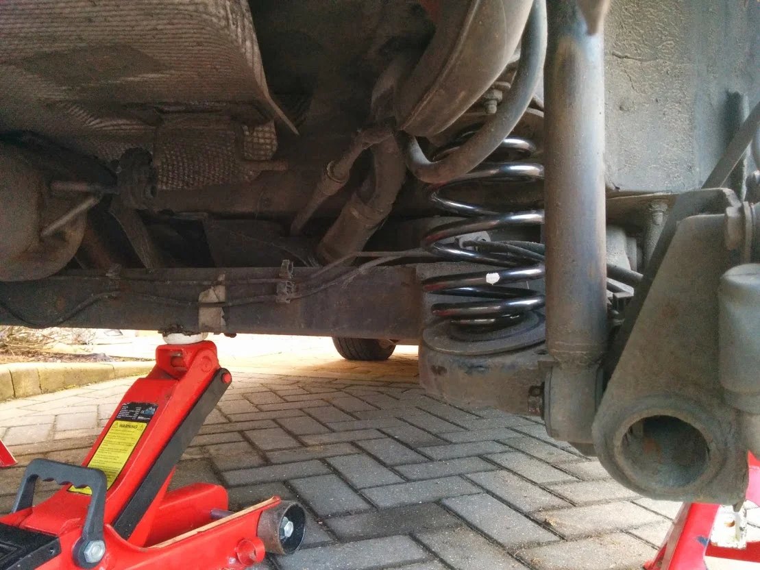

Bolts out, springs dropped out:

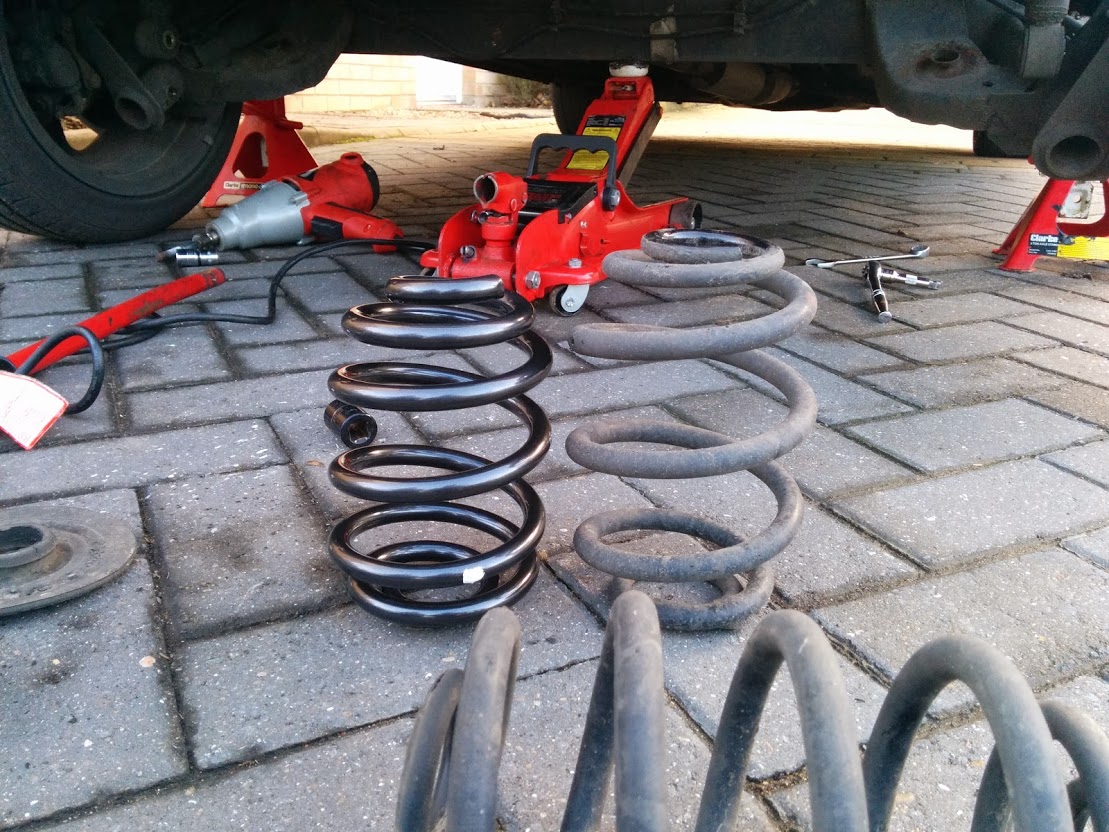

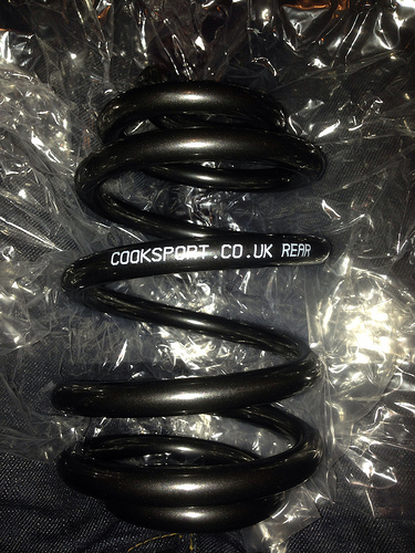

New vs Old:

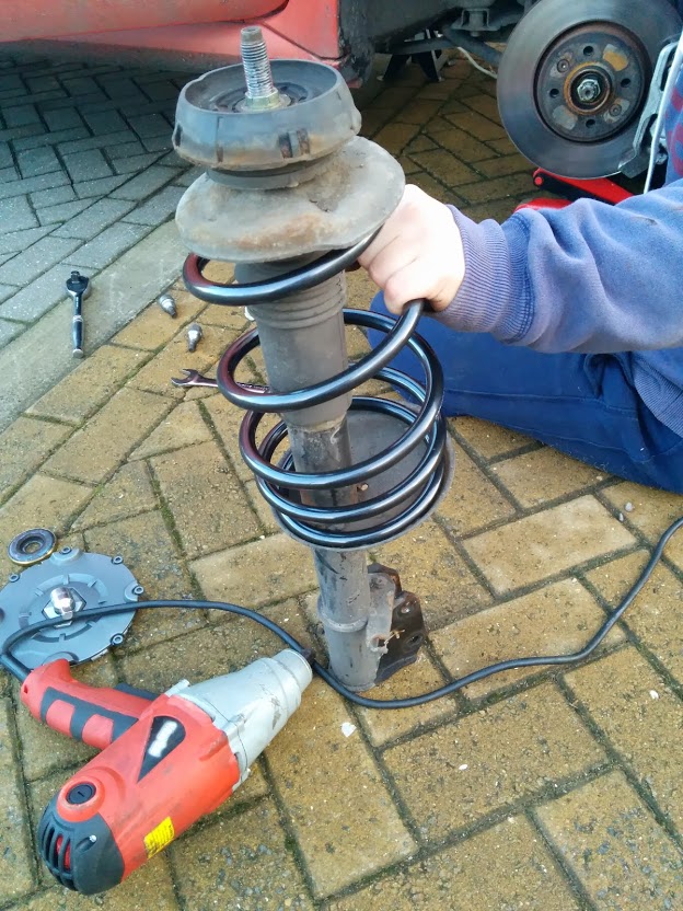

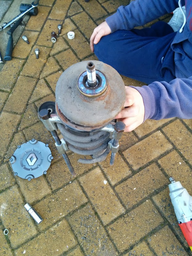

Fronts needed bullying with plusgas and rattle gun, didn't take long though - also must have got the car under 1000kgs with all of the crud I chiseled off the bolts...
I was nervous about us not being able to undo these, but they pretty much just fell off when we touched them...
Cruddy...

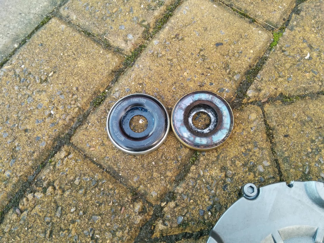

New vs Old top mount bearing:
Shiney shiney...
And the after shot, the spring you can see in front of the car is not a part we forgot to put back in... I don't think.

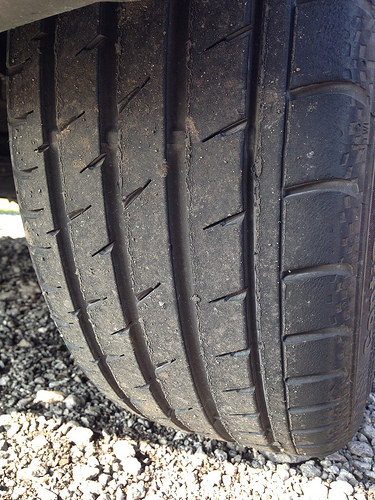

Car felt fine from the test run, no creaks rattles or bangs - but my 4000 mile old Continentals have been knackered on the inside edge, so I definitely need to sort the alignment out before the Xmas closure and potentially look at replacing 2 CS3 tyres I reckon :(

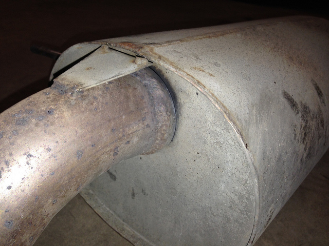

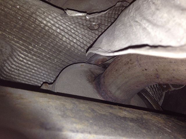

As you can see the exhaust has cracked where it enters the rear silencer, ironically the plate that is meant to strengthen the pipe has also come off. Luckily the garage I went to knows someone who can weld stainless steel and are charging me £15 for having it welded up.
Untitled by Simon_89, on Flickr
I also need to get my centre section sorted as it seems to put my cat at a funny angle and I think it is causing it to blow slightly from the cat/manifold joint

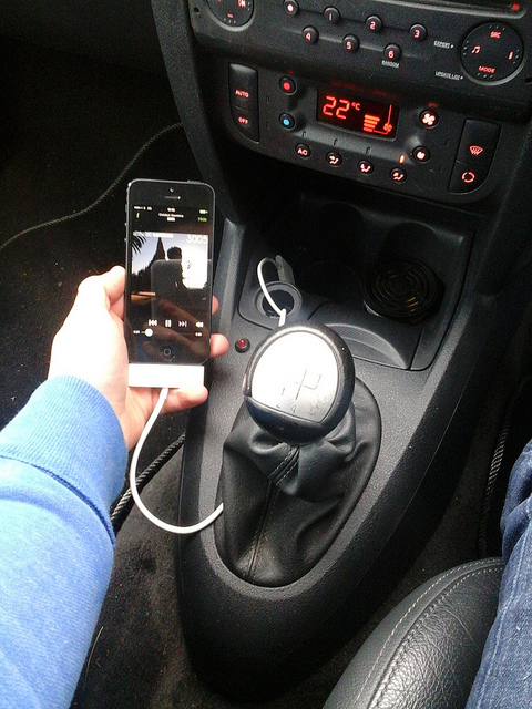

Got a few things for Xmas to allow me to listen to my iPhone a bit easier in the car, this cable utilises an aux cable and charger into a dock.
I removed the cigarette lighter, covered any exposed metal on it to prevent any possible short circuits. I then fed the cables through the hole, rerouted the original aux cable down behind the head unit and to the area beneath the cup holders. Using a twin female audio connector I simply joined the wires up that attach from the aux cable that plugs into the back of the head unit and the aux cable from the iPhone dock and hey presto an audio solution that charges and plays music whilst not having cables all over the place

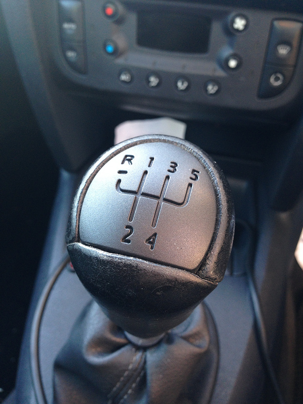

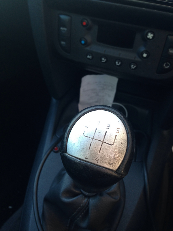

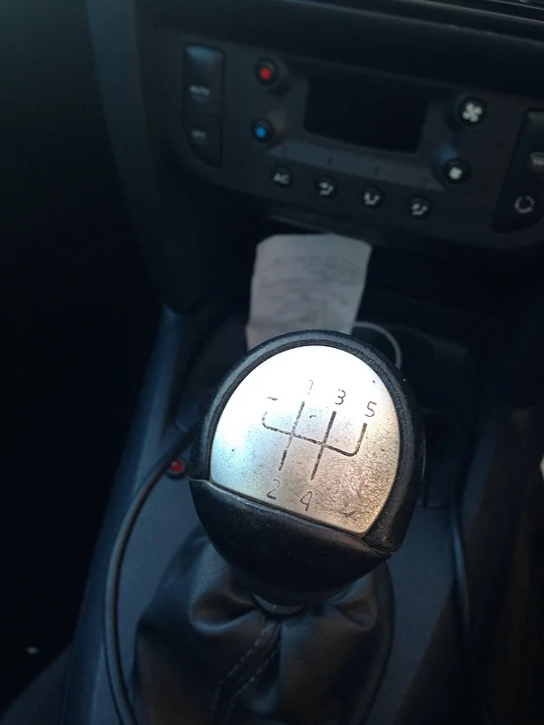

First up was to sort out the gear stick, the cover was really heavily marked and looked a mess
So I popped onto eBay and for a couple of quid I just got myself a normal Clio one, goes with my black dash strips

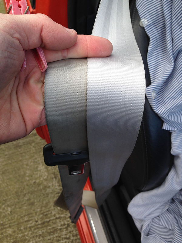

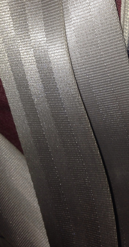

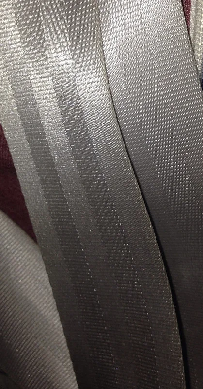

Also decided to give my seatbelts a clean yesterday after seeing a couple of people on here managing to get them silver again, unfortunately I didn't manage to get after photos as it was getting dark but you can see how bad the drivers one was
Got a couple of more things I need to update on but haven't had time to get photos of them yet.
  Inferno 182FF
How did you clean the seatbelts then? Also where do you get your resprays done? My front bumper is shocking!
Simon_16v
Just a bucket of hot water and washing up powder with a nail brush.
Clean Belts by Simon_89, on Flickr
Probably not the best photo but you can see that the difference now is minimal compared to above. Both were the drivers side which was the worst
