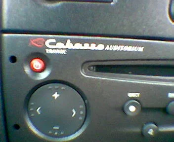

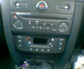

This is my headunit, sorry for the gash photos.

I think it works with both units to be honest. I'm sure Bubbles 182 has a new unit. I can't remember if I tried it in the Trophy, all I know is I couldn't get the changer under the seat. I'd make sure it works before you install it properly.
I didn't remove the dash no. Just pulled the unit out and got my hand down the back to feed the cable through a hole which lead out and under the dash. When they are factory installed they run the cable the cable out the back of the centre console and up along the top of the dash around the passenger airbag.

I was led to believe that the new headunits , cabasse update ones have a different connection for the changer lead than the older tuner list units .
Does any one know if this is true?
Lee
  BMW M2C
Get Bubbles to check which version of the Renault headunit she has. If it's the latest one then the answer is they are both the same.
The one I put in hers originally came out of my 03 plate 172, then went into my 04 182 and finally into Bubbles 05 182 as it wouldn't fit under the Recaros.
