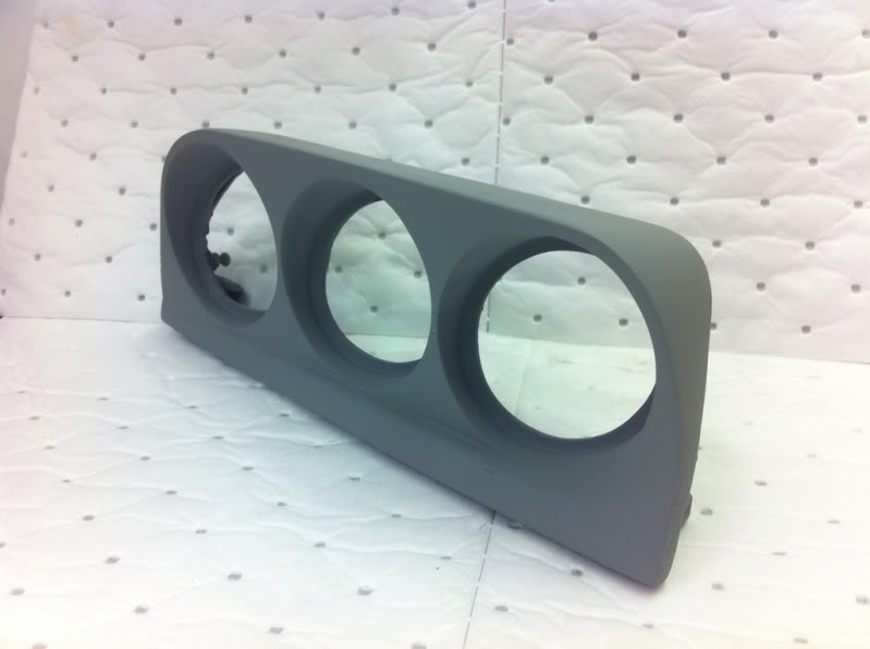

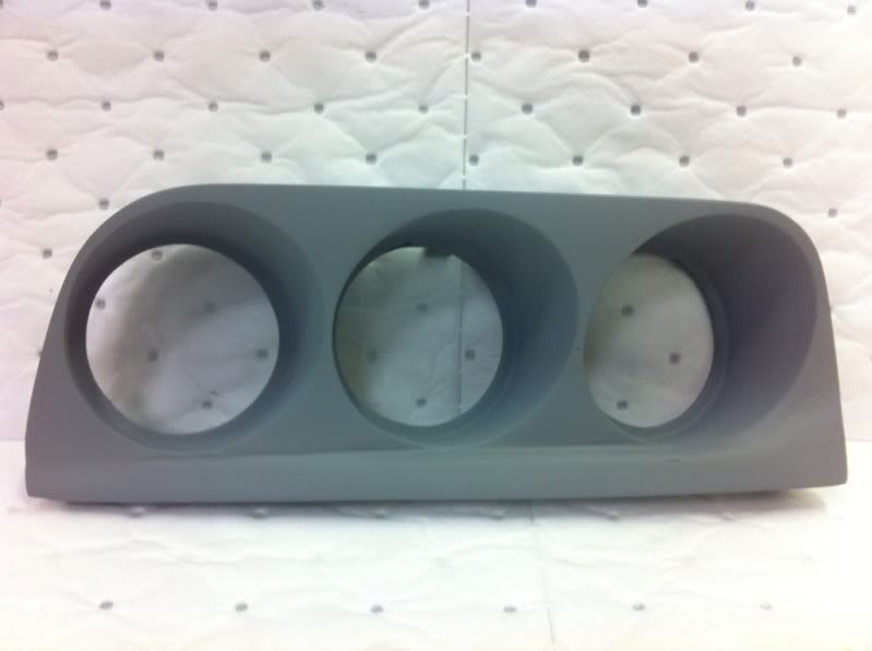

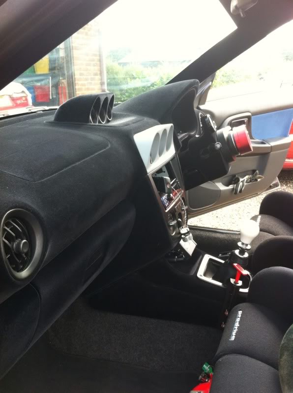

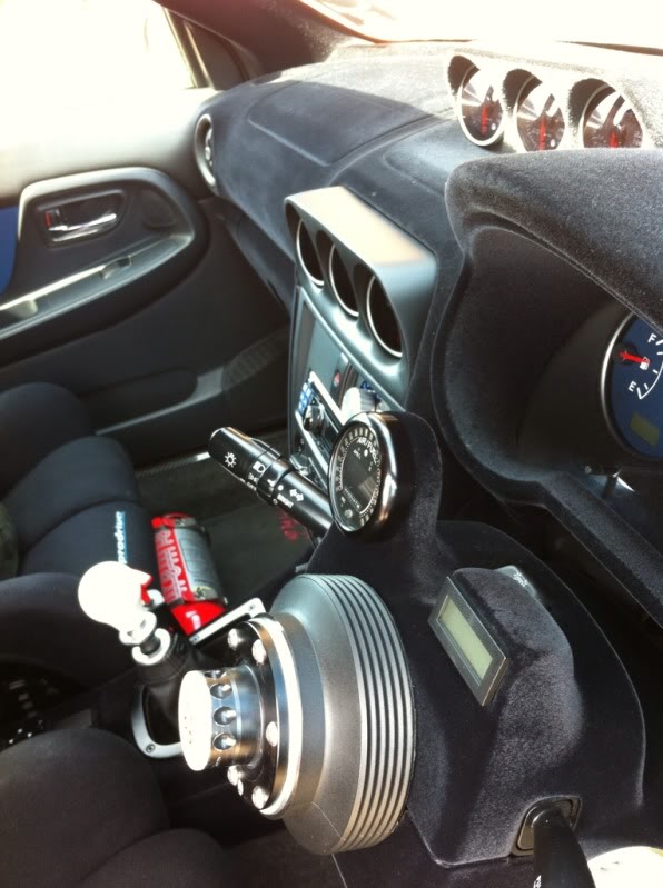

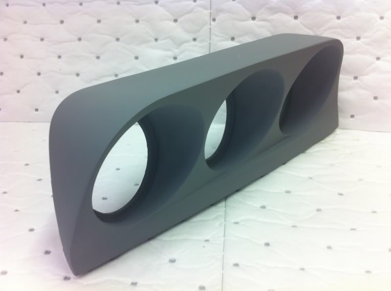

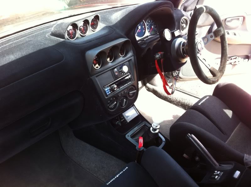

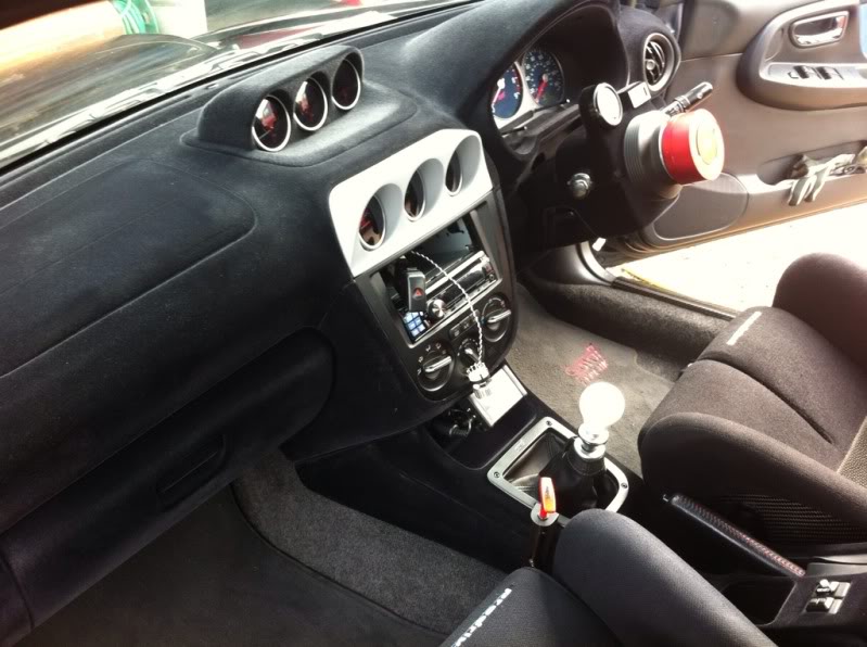

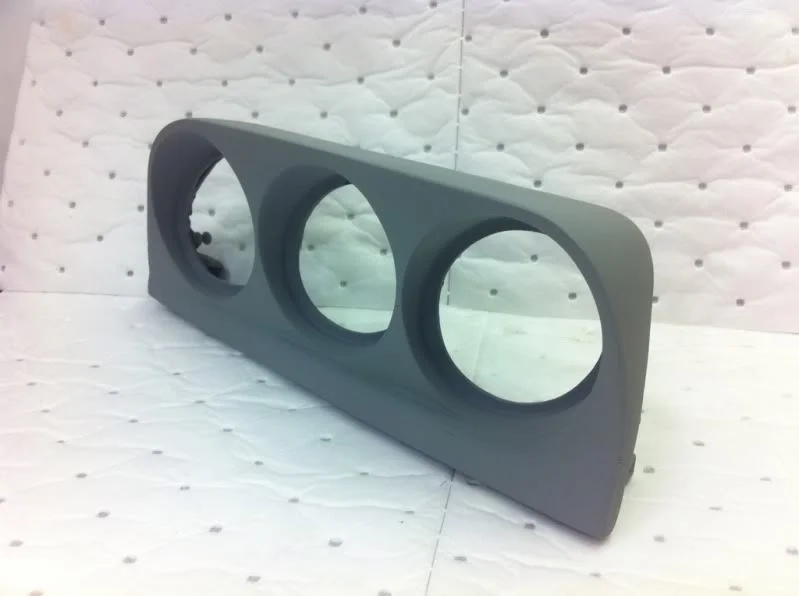

Bit more work done on the gauge pod, almost ready to paint.
frayz
I've fitted it this morning as a final test piece. Just some panel gaps to clean and that's it. The pics don't really show how it looks but it changes the dash appearance completely. Now looks more like a cockpit haha.
There will be at least one **** in there I hear you say. :D

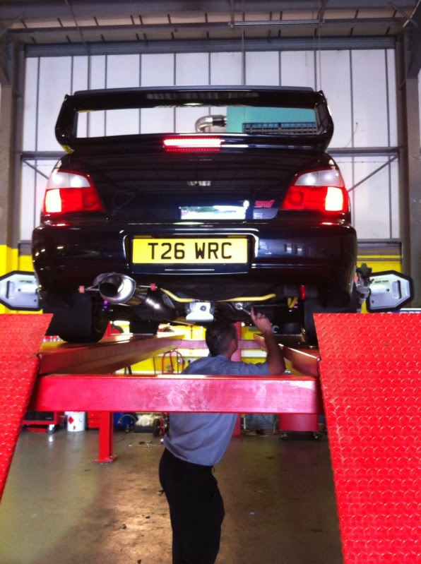

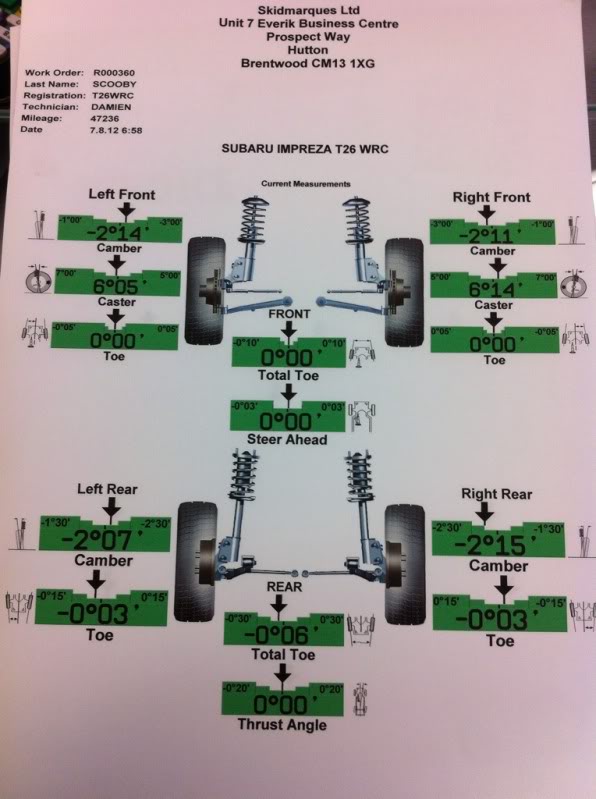

After fitting all the front end bits I went to get her geometry redone.
I always go back to Damien @ Skidmarques in Hutton, Brentwood. Known him for a long time and he always does a proper job.
Now got over 6 degrees of caster, toed out the rear a little too making the car rotate a little quicker. The handling feels even more agile and accurate. Very pleased.

Really appreciate it. In fact my alignment took no time at all due to everything being so easy to use. Half the fight of setting geometry is fighting with fasteners and siezed threads. Fortunately none of those under there :)

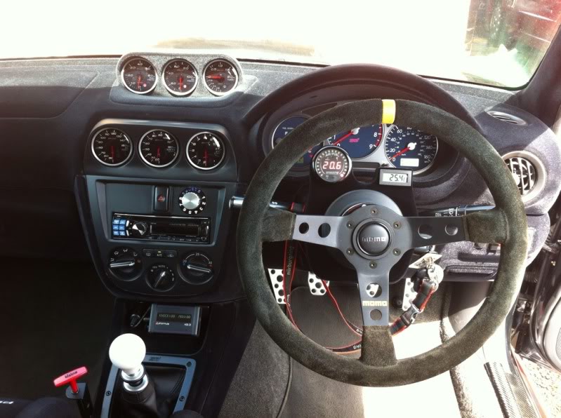

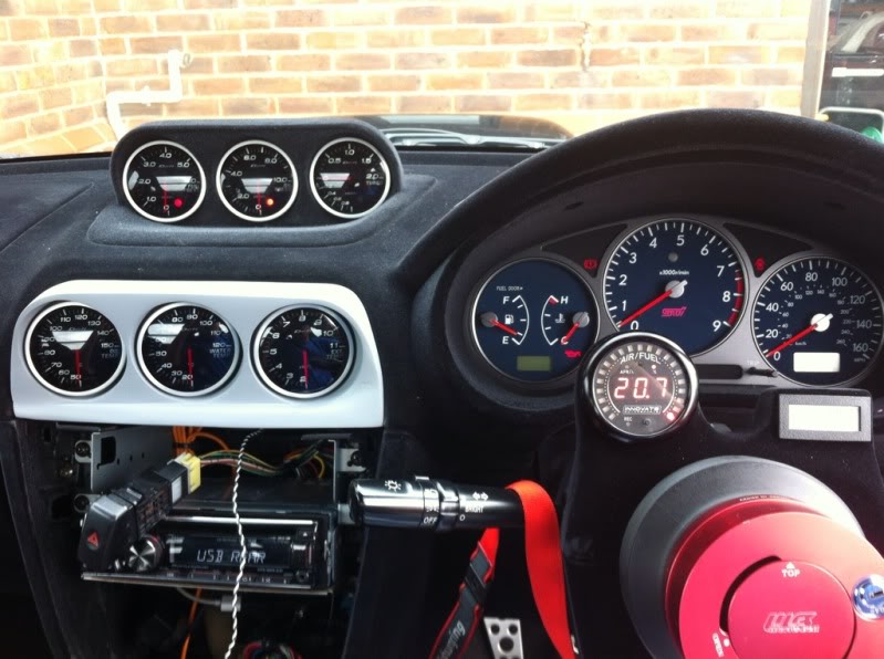

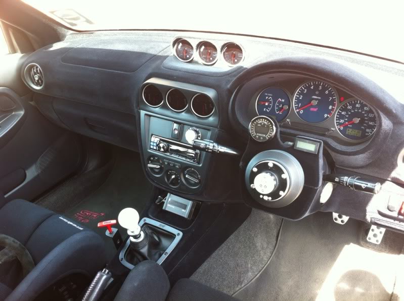

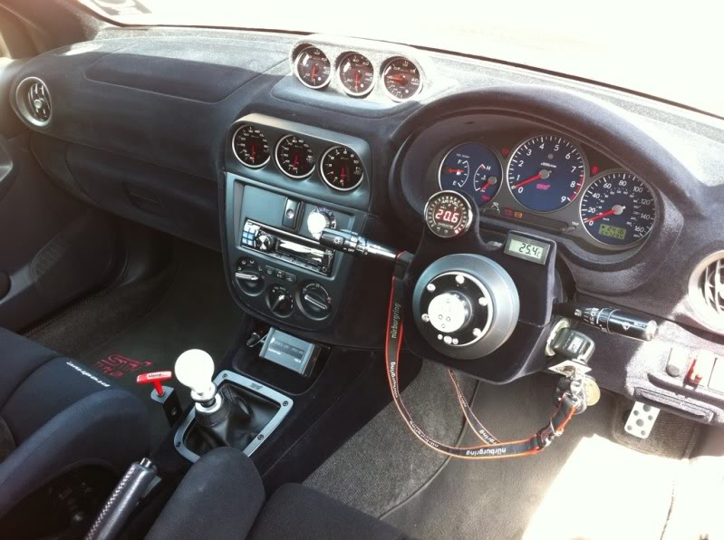

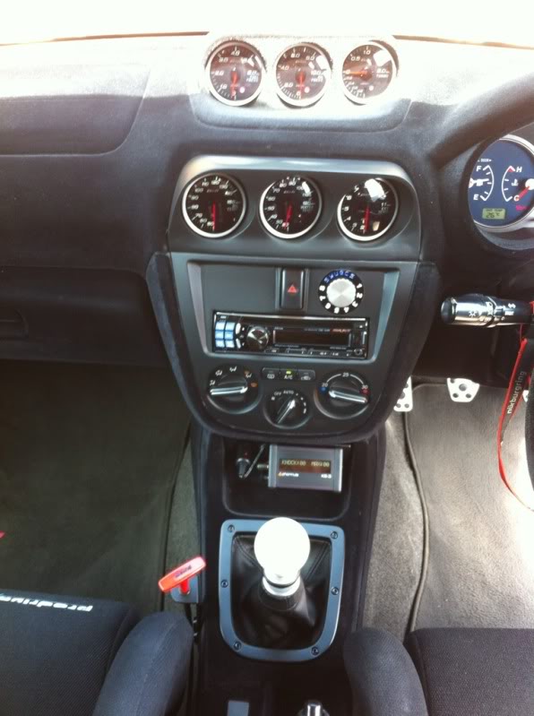

Hey guys,
Finally got the dash done, although this is a whole lot neater than having 3 in a hood and 3 up the a pillar im still quite tempted to ditch the lot in place of a single Toucan display.
Nothing will be as instant on the eye for reading data than indevidual meters but a single screen would be a whole lot neater.
I think im going to see how i get on like this and if need be take it all out and start again haha.
Any thoughts?
Sorry for the cak iphone pics, my computer wont dalk to Photobucket right now lol

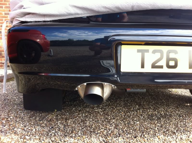

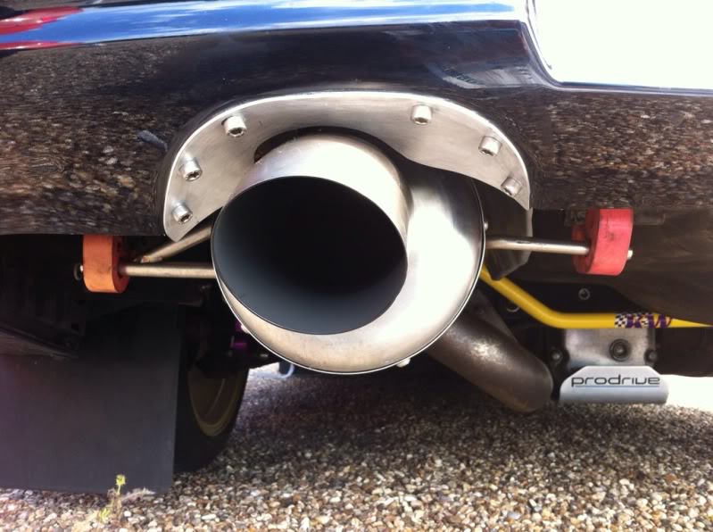

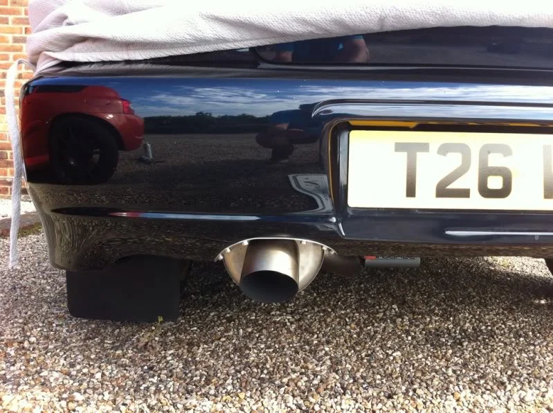

Gonna replace the horrid cap heads with some smooth buttons, to try and make it look less garish but it can't really be seen much from the rear of the car.
I was sick and tired of my bumper melting from the radiant heat of the exhaust tip so decided to finally do something proper about it.
Tried the dei self adhesive reflection mat and that burns off too.
So gone with a more permanent solution, I just hope this works.
If the exhaust tip colour I anything to go by its seeing between 270/340 degrees C.
Toasty!
