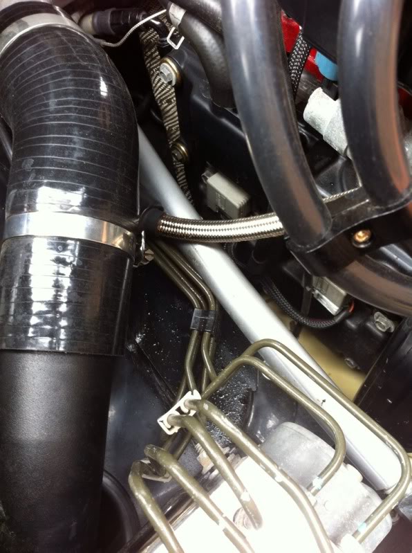

The Bomber saw a swap to NGK Racing 8 plugs tonight in preparation for mapping. I was delighted with my idea of the removable fuel pump/filter cradle too.
The whole system came out in about 3 minutes, 2x AN fittings, 1x bolt and 1x multiplug and the whole assembly lifts out for easy plug access. The drivers side is merly loosening one jubilee clip and removing the turbo intake.

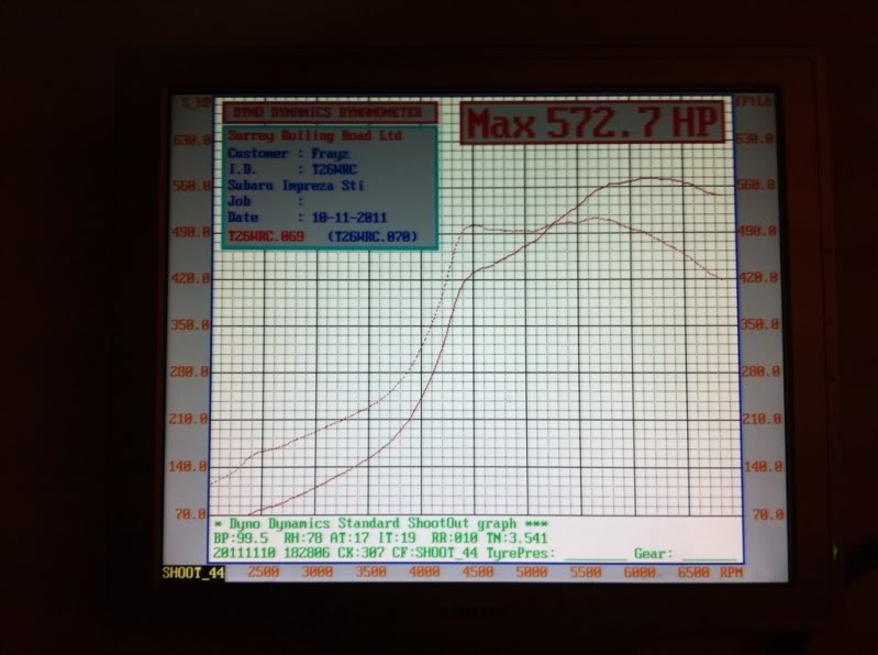

525bhp and 480lbsft on plain Vpower at 1.9 bar.
573bhp and 510lbsft with 20% meth at 2 bar.
frayz
Here ya go lads, vid was taken on my iPhone, so not the best but you get the idea. This is a 576bhp dyno pull.
We actually had abort a run that was 581bhp and climbing as it was getting a bit too near the mark lol

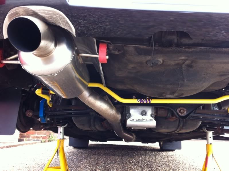

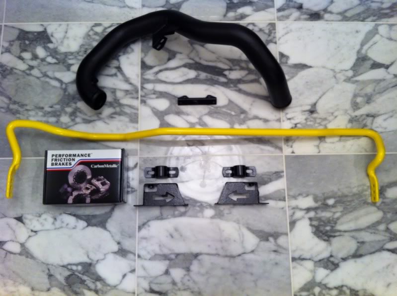

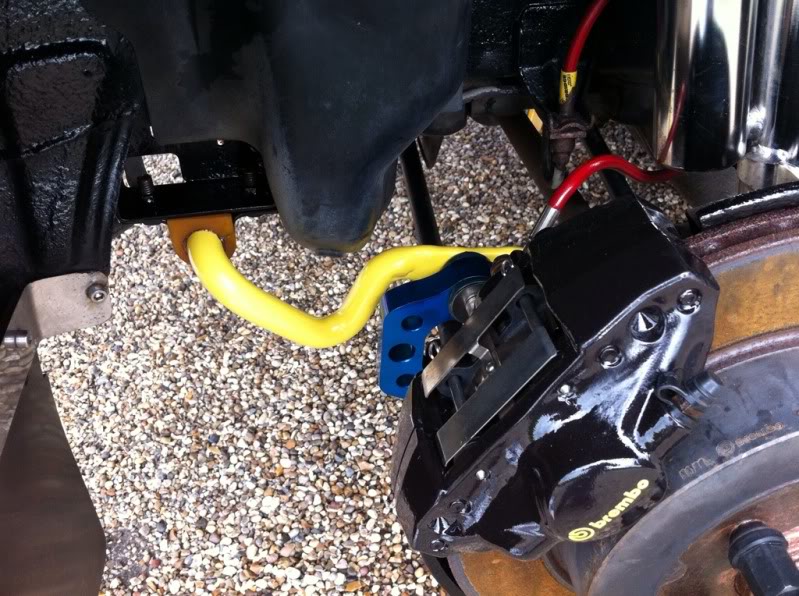

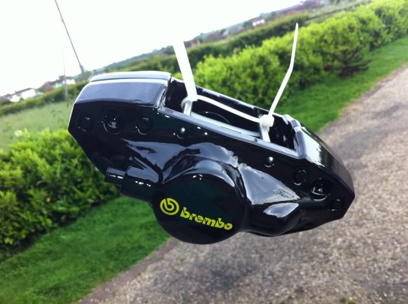

Rear Brembos have been refurbished in black/yellow to match my APs up front.
Rear diff guard got a freshen up
Rear ARB, brackets and links also got a jolly up with some fresh powdercoat. All fitted up with new stainless fasteners and new rear pads in the calipers.
None of this can be seen i know and there will be lots more going on under here, but at least I know it's all reasonably tidy again for the summer,
Also have some more bits and pieces going on but will update when I have more to show.

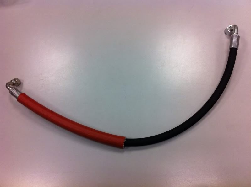

Took the old girl out for a drive last Saturday and upon coming home I gave her the usual inspection. Found some oil mist on my inner wing that I identified as PAS fluid.
On investigating further I found that my HP PAS line was leaking a small amount of fluid through the core of the hose.
I removed it before it failed, caused a fire or worse.
I took it to my hydraulics shop for a second opinion. They were very helpful as always and put the failure down to heat, and the hose being used slightly outside its rated pressure.
The shop made me up a brand new heavy duty hose there and then free of charge.

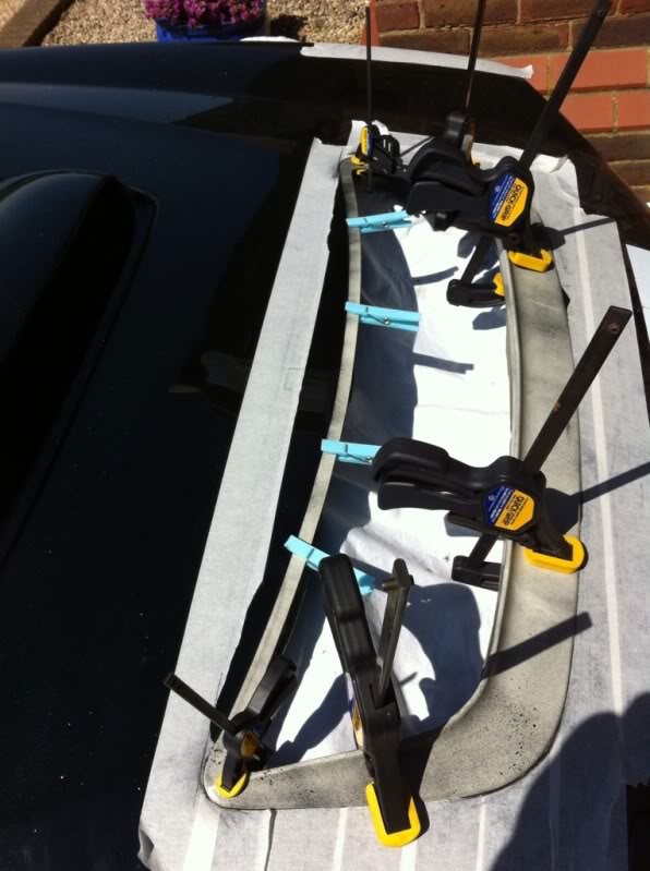

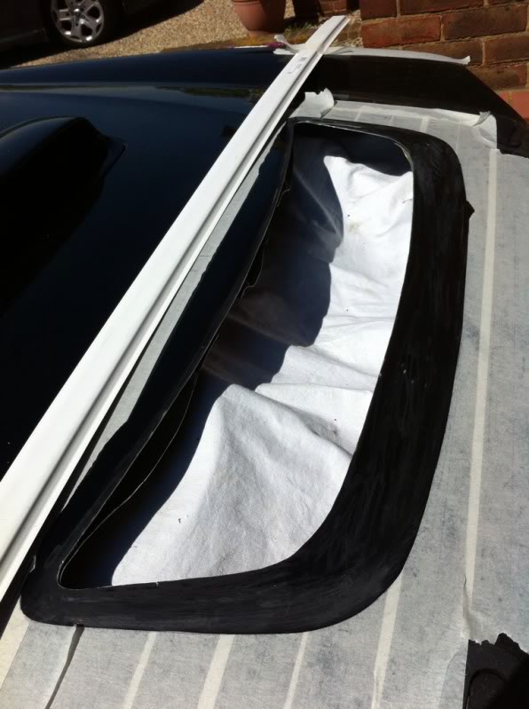

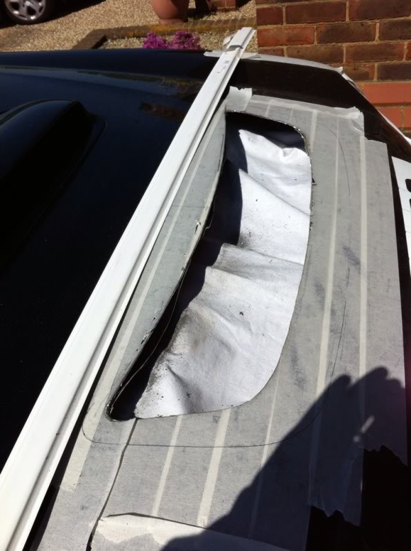

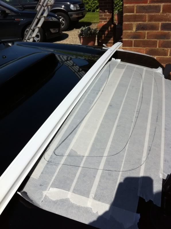

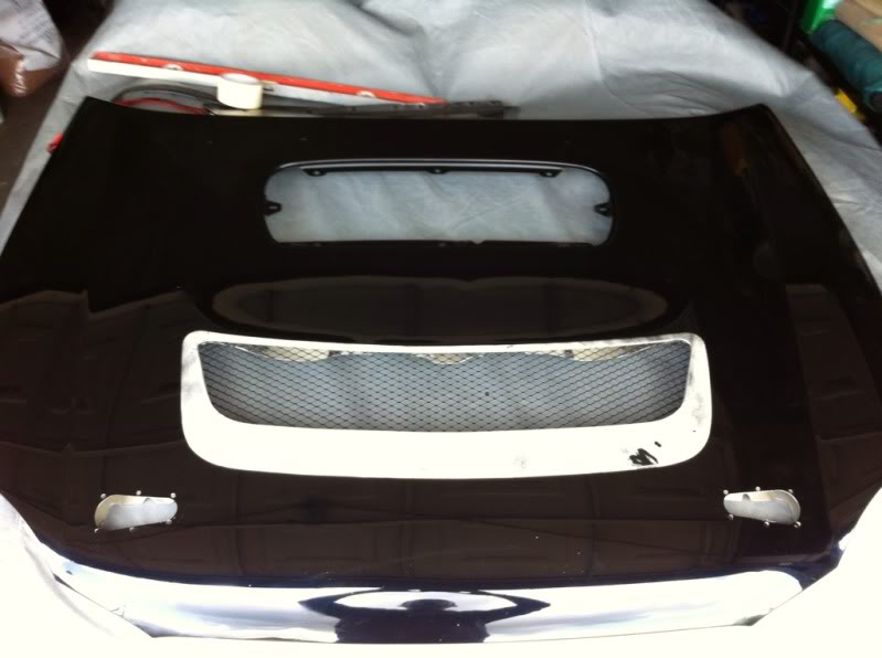

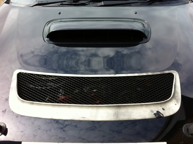

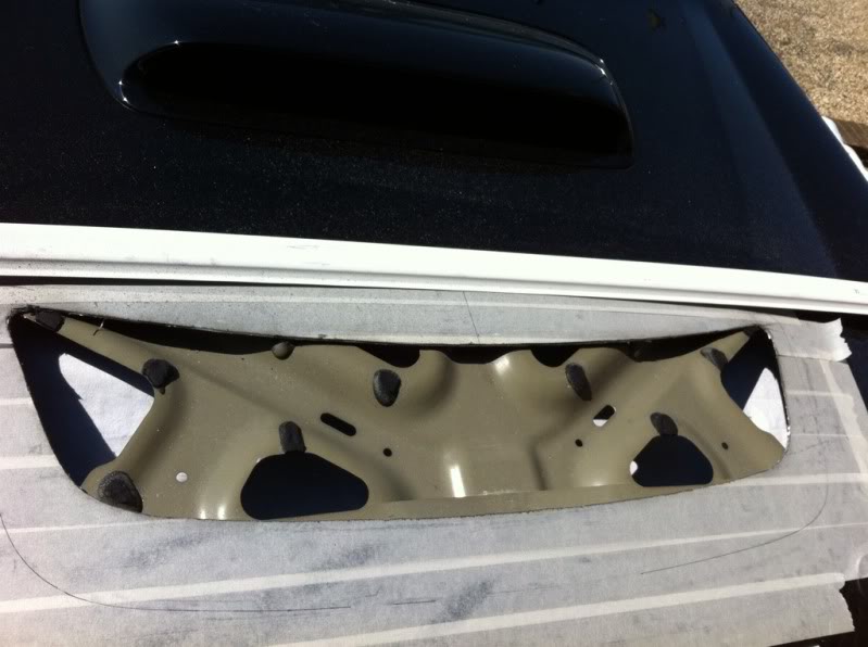

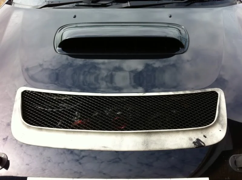

I've also been cutting the car up again. Although I'll let the photos do the talking here.
More to come soon :)

Good bit of work on the bonnet too.

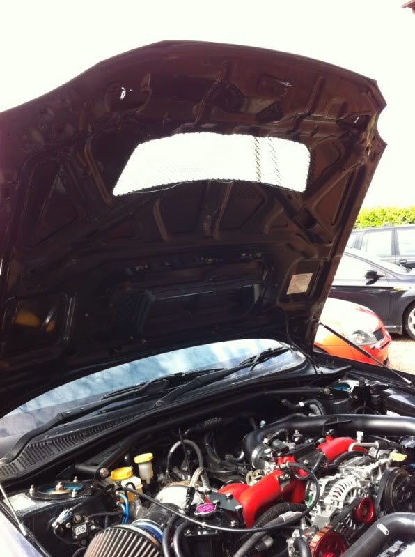

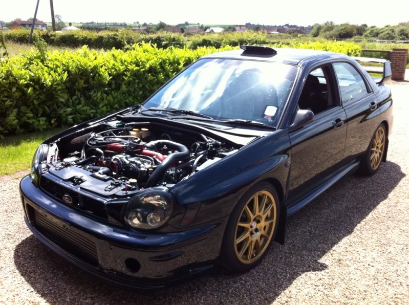

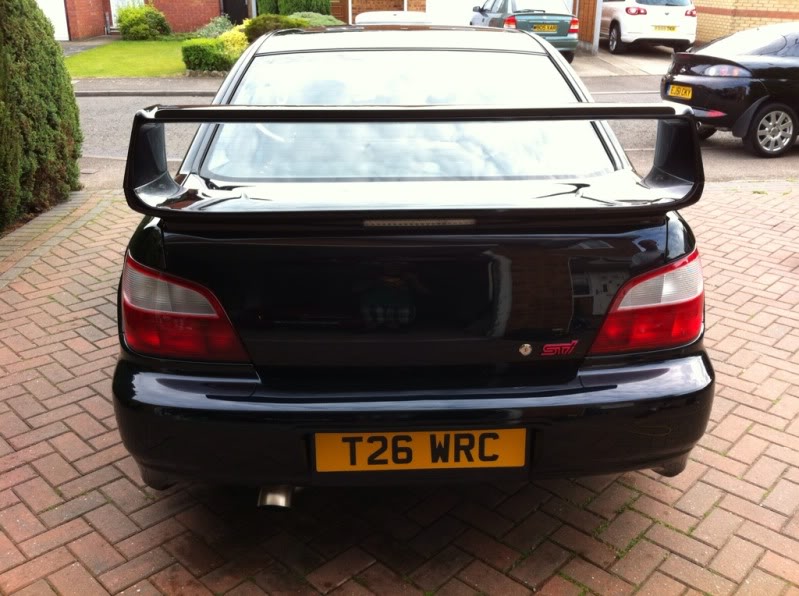

frayz

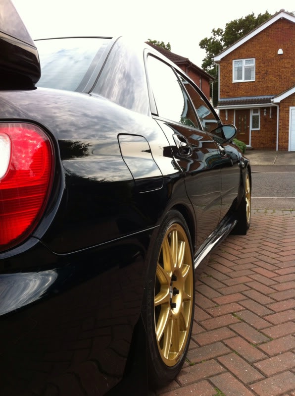

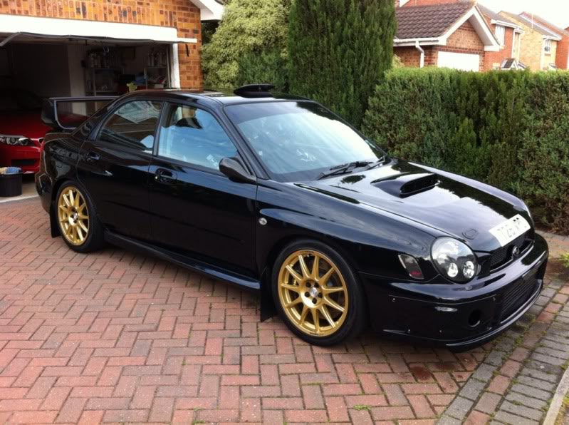

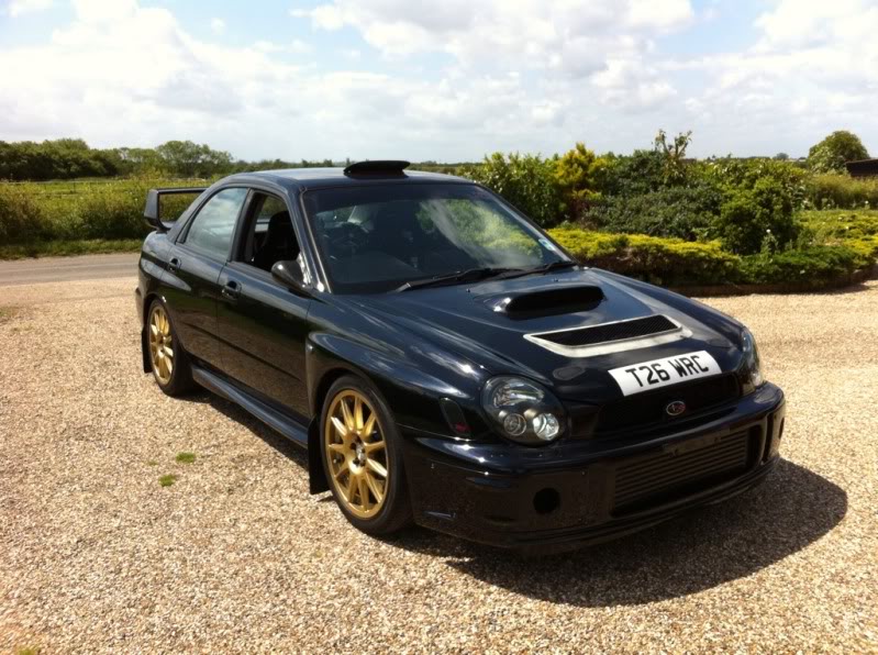

Quick snap now it all done on the exterior.
Bonnet removed and stripped for paint.
Now sporting the full on street racer look. Tempted to go for a Fast & Furious style drive. Haha.
