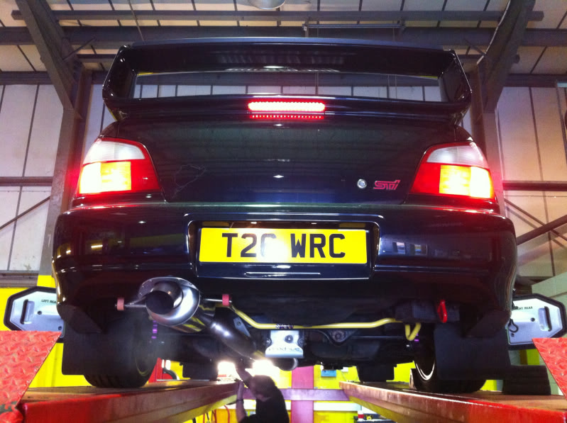

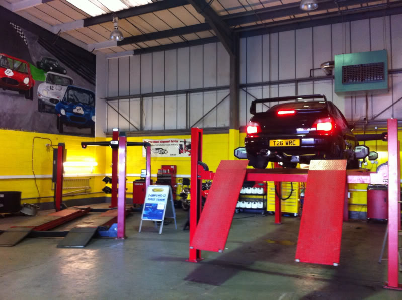

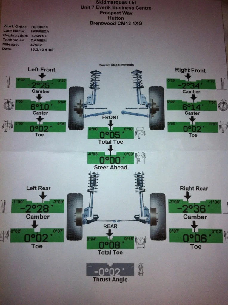

Bomber got a new setup today.
Finally starting to find a setup I like. Ill drive her for a bit and make some tweeks to the dampers, possibly raise the rear ride height slightly. Then maybe a few slight alterations on the day.
Should be fun :D

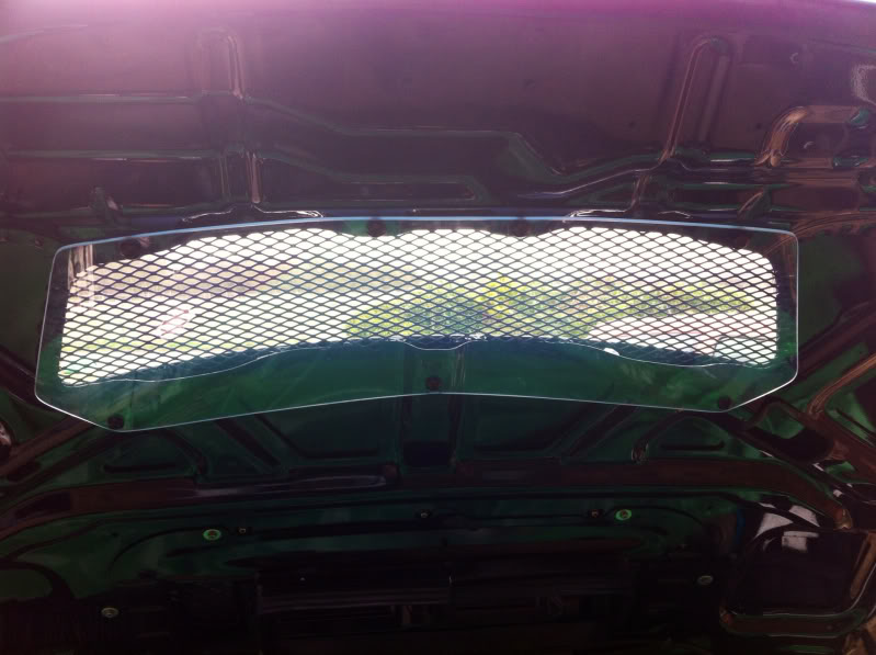

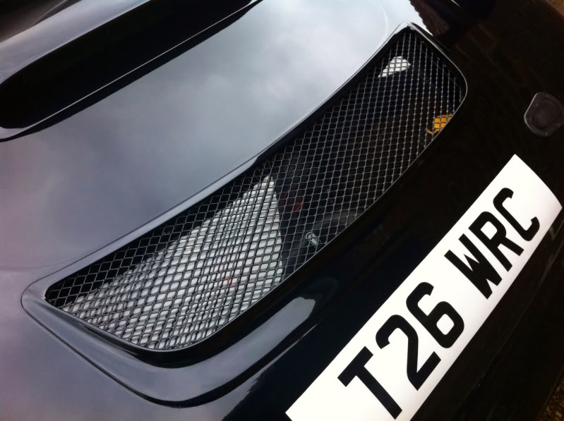

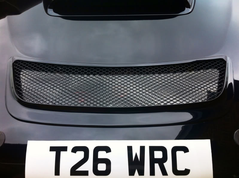

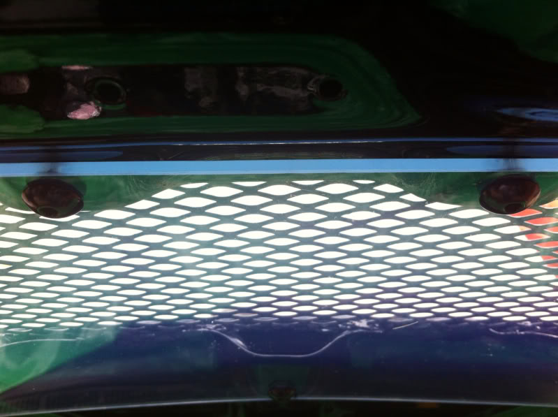

Something I've been meaning to do for a while but not got around to it.
Made up a little polycarbonate under vent shield for when the weathers bad. Initially the polycarbonate one was to be used as a template for either aluminium or carbon. But since fitted I think this looks quite cool.
Spaced from the vent so still allows heat to escape while protecting the motor from the bulk of rainwater when stationary. The depression created above the vent keeps water out on the move.
Held in with some nice alloy M5 button heads to keep the look neat.
