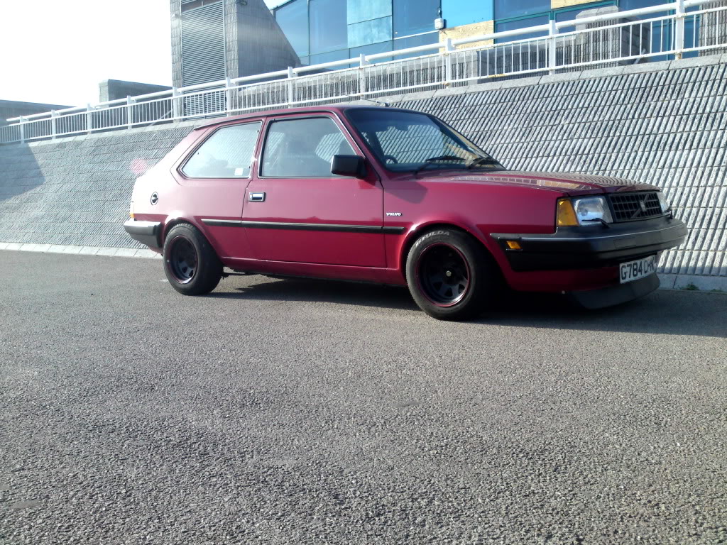

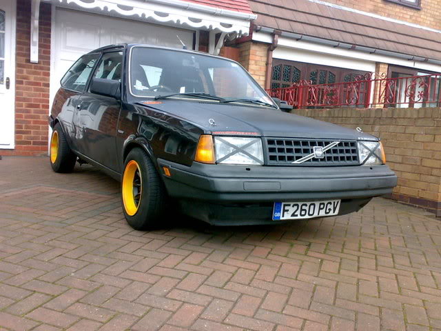

Right then, got my exhaust on, also sprayed my grill black and bought some new wheels :D
I'll put some pictures up tomorrow, I'm off to terrorize the streets lol

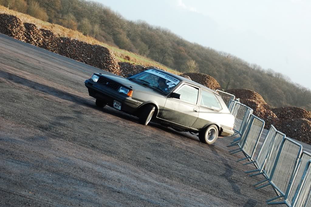

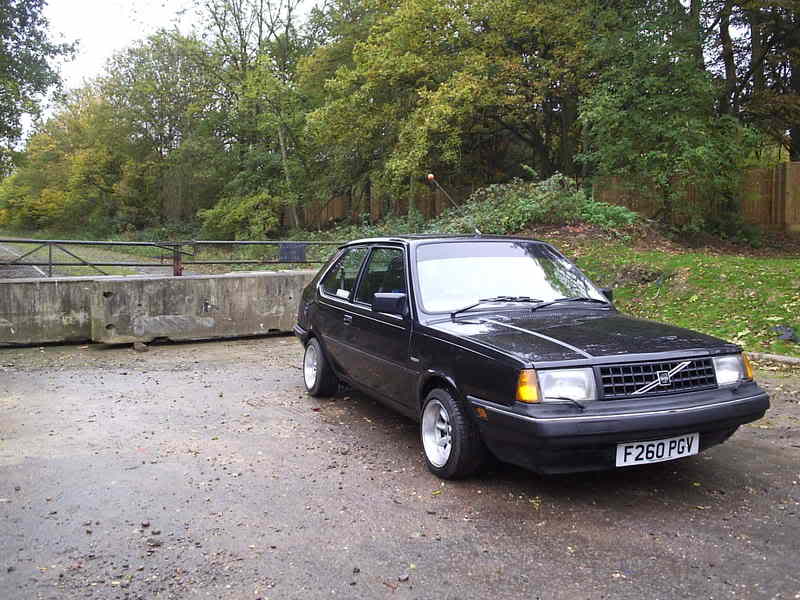

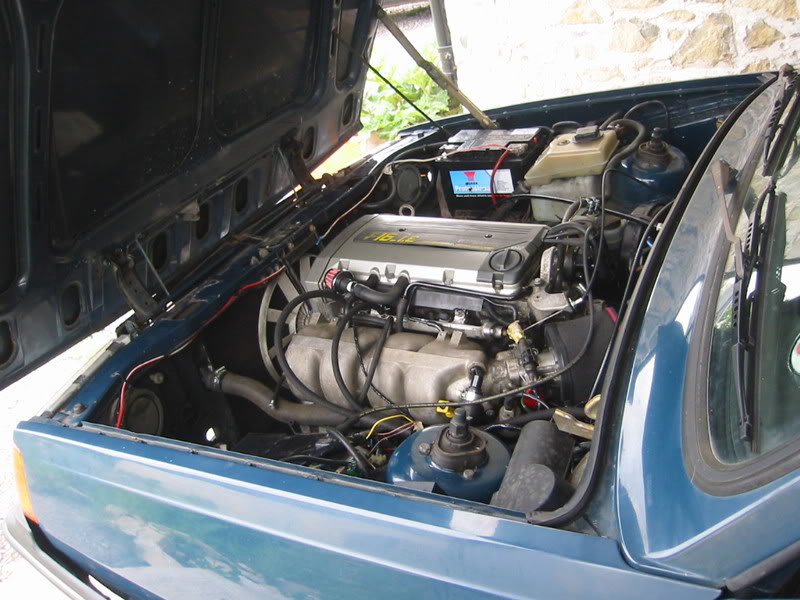

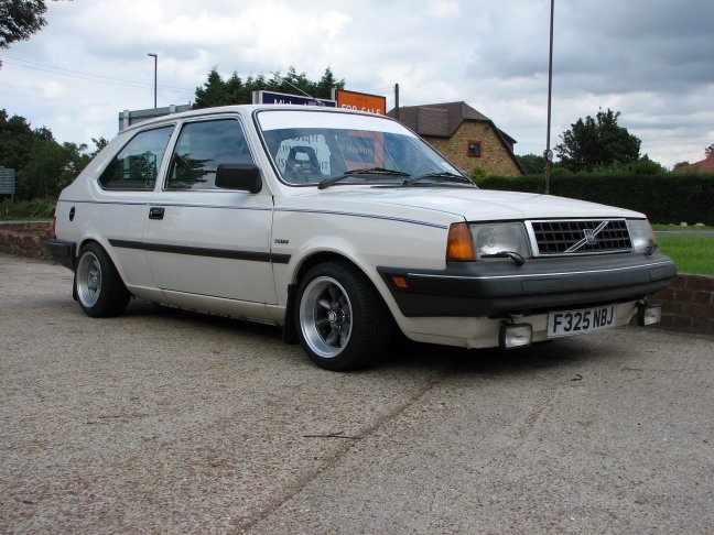

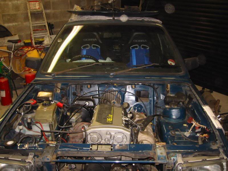

my old 340,
bought it as a 1.7 and after that died i put a 1.8 16v motor in it. the mechanical side is really easy, and wiring wasn't too bad either. you will need 1.7 bellhousing, prop and some other bits.

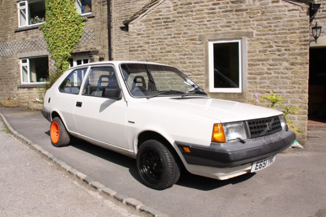

tadaaaaa done it :)

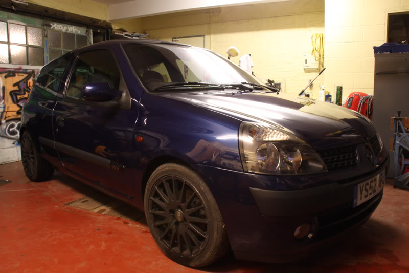

and if anyones interested, this is my old clio

-update-

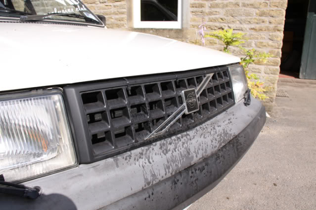

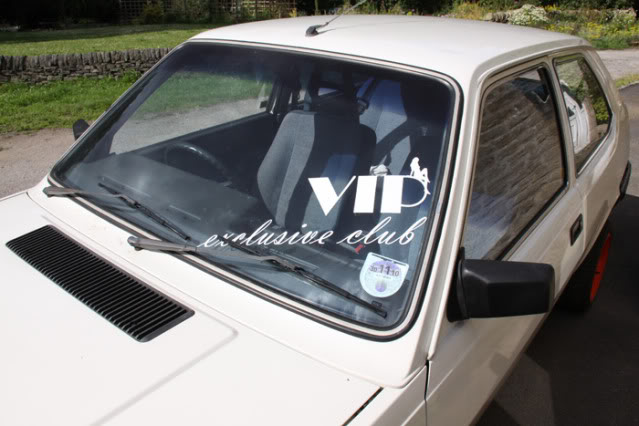

yesterday painted my grill matt black, and then hit something last night thats all over my bumper :(
and also stuck this on :rasp:

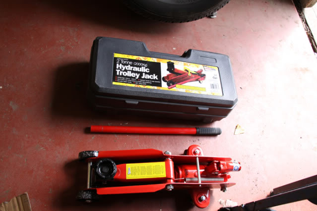

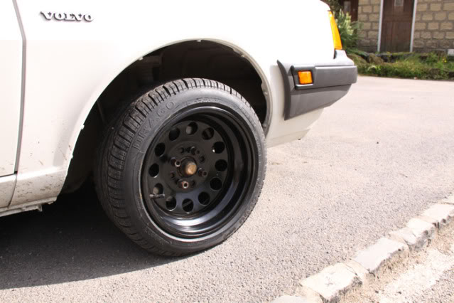

this morning i went out and bought one of these
because i was sick of the stupid volvo jack and i wanted to trial fit my new wheels...

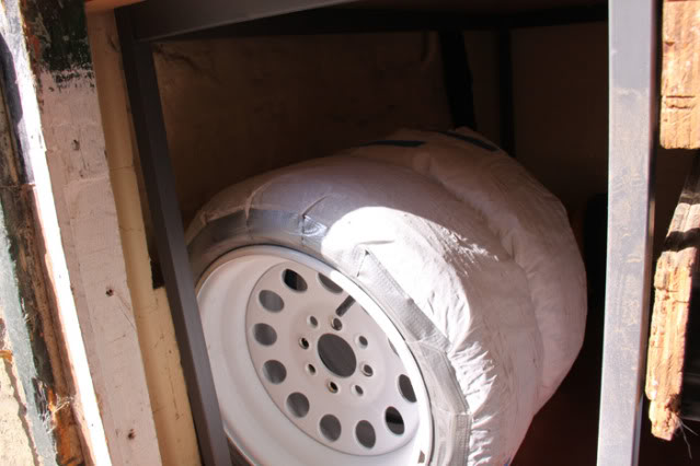

I bought 6 rims (Weller steels 13"x7") two of which had knackered tyres on, two with ok tyres, and two with brand new tyres. and then two more new tyres for spares :D

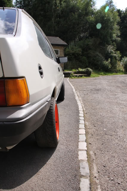

They were white to begin with and i decided to spray the two bald ones orange for cough.drifting.cough and the rest black. but ran out of black paint so for now...
they've got a slight bit of stretch too which is cool.
and then the final two ready to be sprayed...
before anyone says it, i know it looks stupid because of the ridiculous arch gap.
but i'm trying to order lowering stuff this weekend so should hopefully be slammed 3 inches next week :cool:

Even dropped 3" there'll be a ridiculous arch gap! That sticker will blend in well over on Driftworks, as will the wheels TBF!
haha didnt realise i had the driftworks colour scheme goin lol
an after havin a little measure with a ruler, there will probably be about an inch gap after lowering.
but tbh any lower than 3inch an it'll be literally sitting on the ground haha.

LOL @ VIP stickers! Will look pretty cool when lowered...
haha i think i might take the VIP bit off. too many people don't realise its a micky take lol

is that on the v300m forum? can't remember my login can't be arsed gettin new password either, it was a chap off there that bought my one. £350 is a bit steep, mine was lowered on 2" lowering blocks from peter lloyd rallying, and originally on chopped springs.i bought it like that :eek: but put a old set of g40 springs and refilled the shocks with heavier oil.
good luck with the project, whatever you do don't take the heater out winter was painfull had to spray inside with de icer lol
