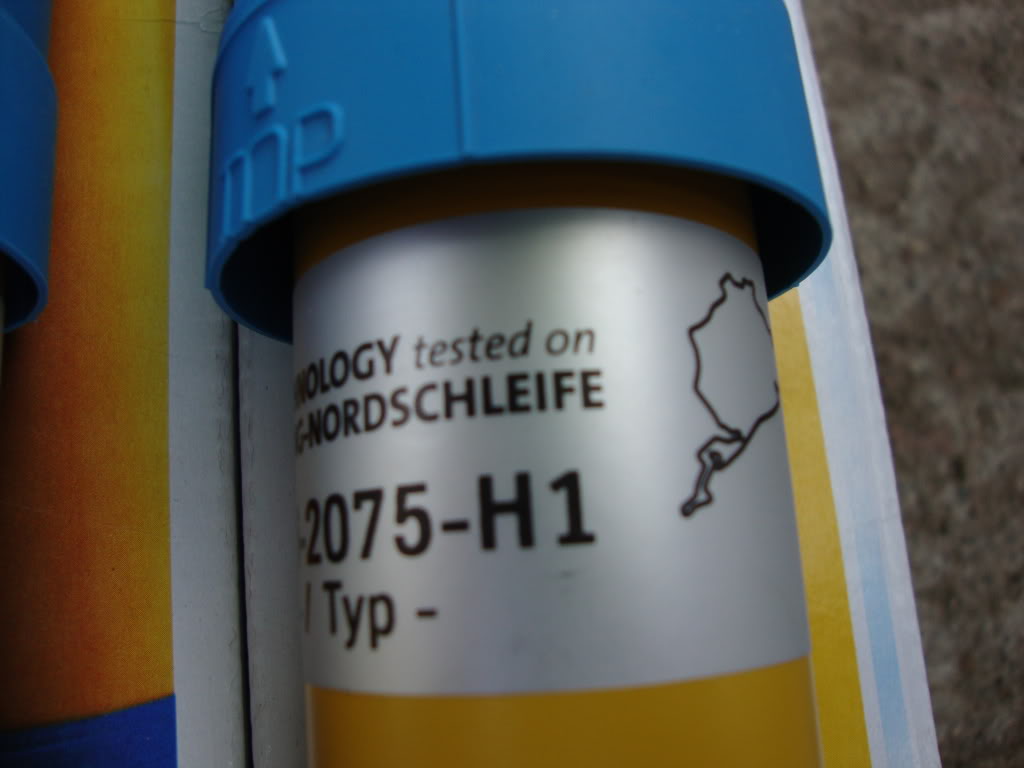

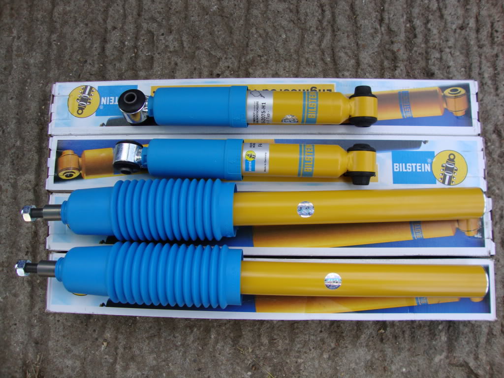

I ordered some brand new Bilstein B8's yesterday and they have arrived!
Tested on the ring

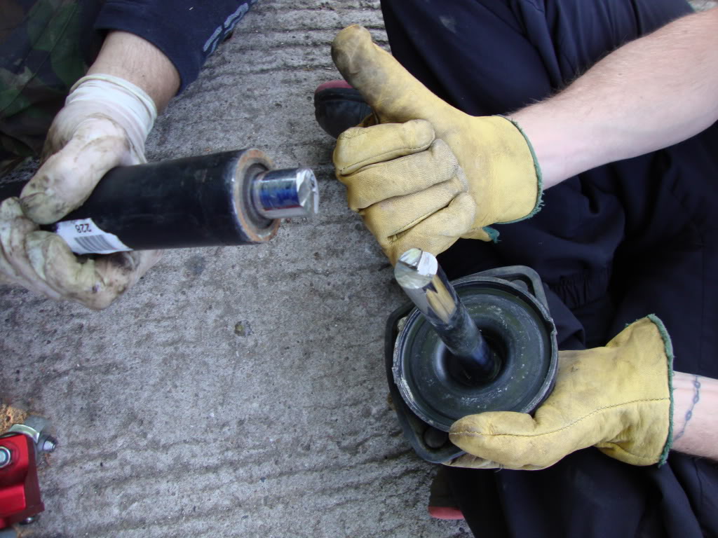

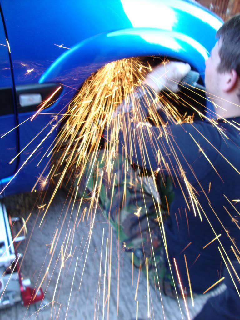

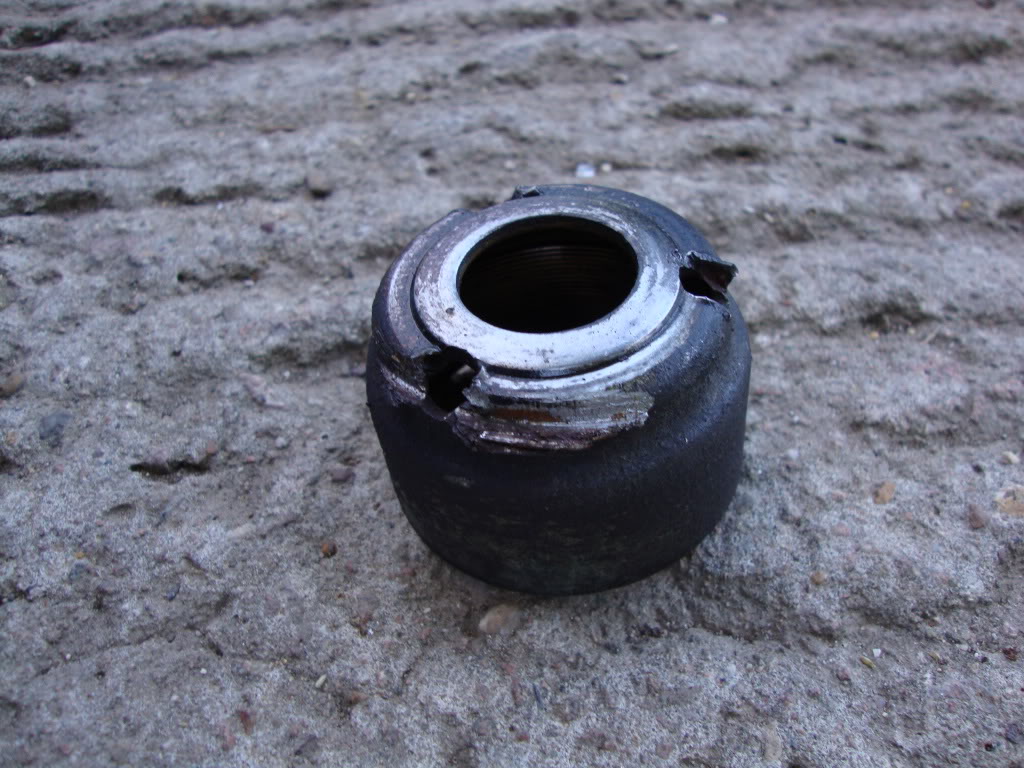

Whichever clown refitted the o/s shock had over tightend the top nut and threaded it. The nut was just spinning. This left only one solution..
Angle grind the standard shock tube.
When josh had to drill out the nut to recover the cup
This is from were the shock had been bottoming out
And another of josh admiring his work
The state of the shocks was beyond a joke. The b8's have made a massive improvement. I am going to get some eibach pro springs to complete the setup on the weekend. I have ordered some new drop links as the ones on the car are fooked. Ive also ordered some Powerflex black shore 95 front anti-roll bar bushes which are being made to order and will be with me in 10 days. When the bushes and drop links arrive ill also remove the anti-roll bar and clean it up and spray it red. I will update very soon. Enjoy

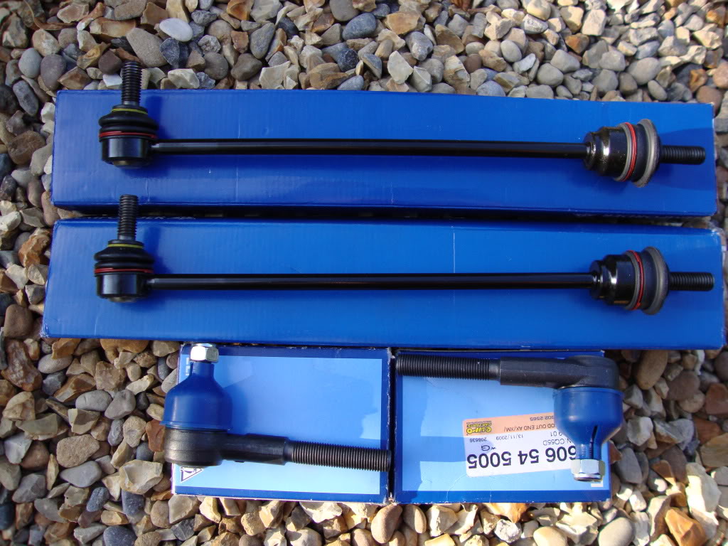

LITTLE UPDATE!
I had my brand new Lemforder (O.E) drop links and track rod ends delivered today. I will be fitting these as soon as my Black shore 95 anti-roll bar bushes come.
